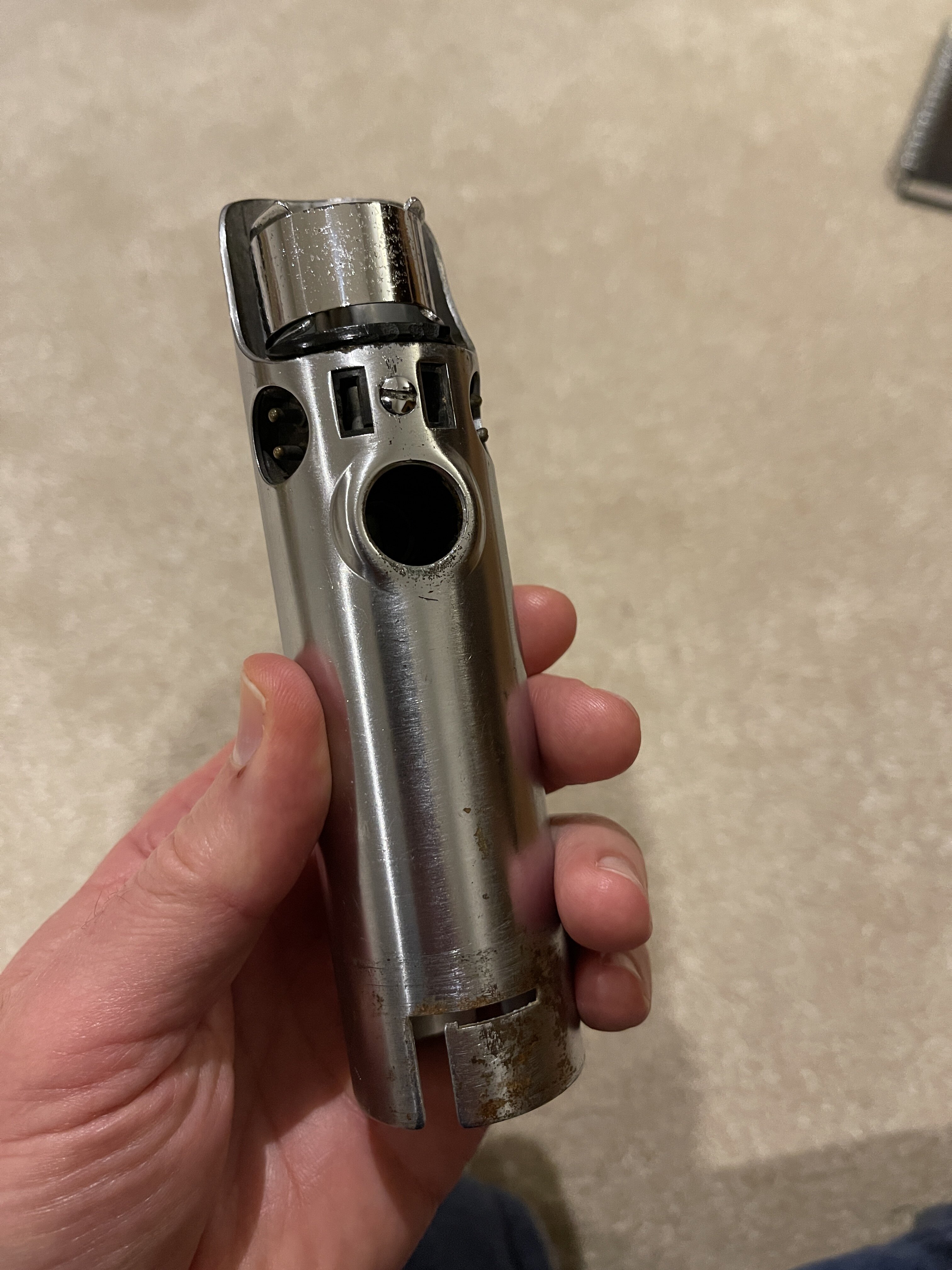

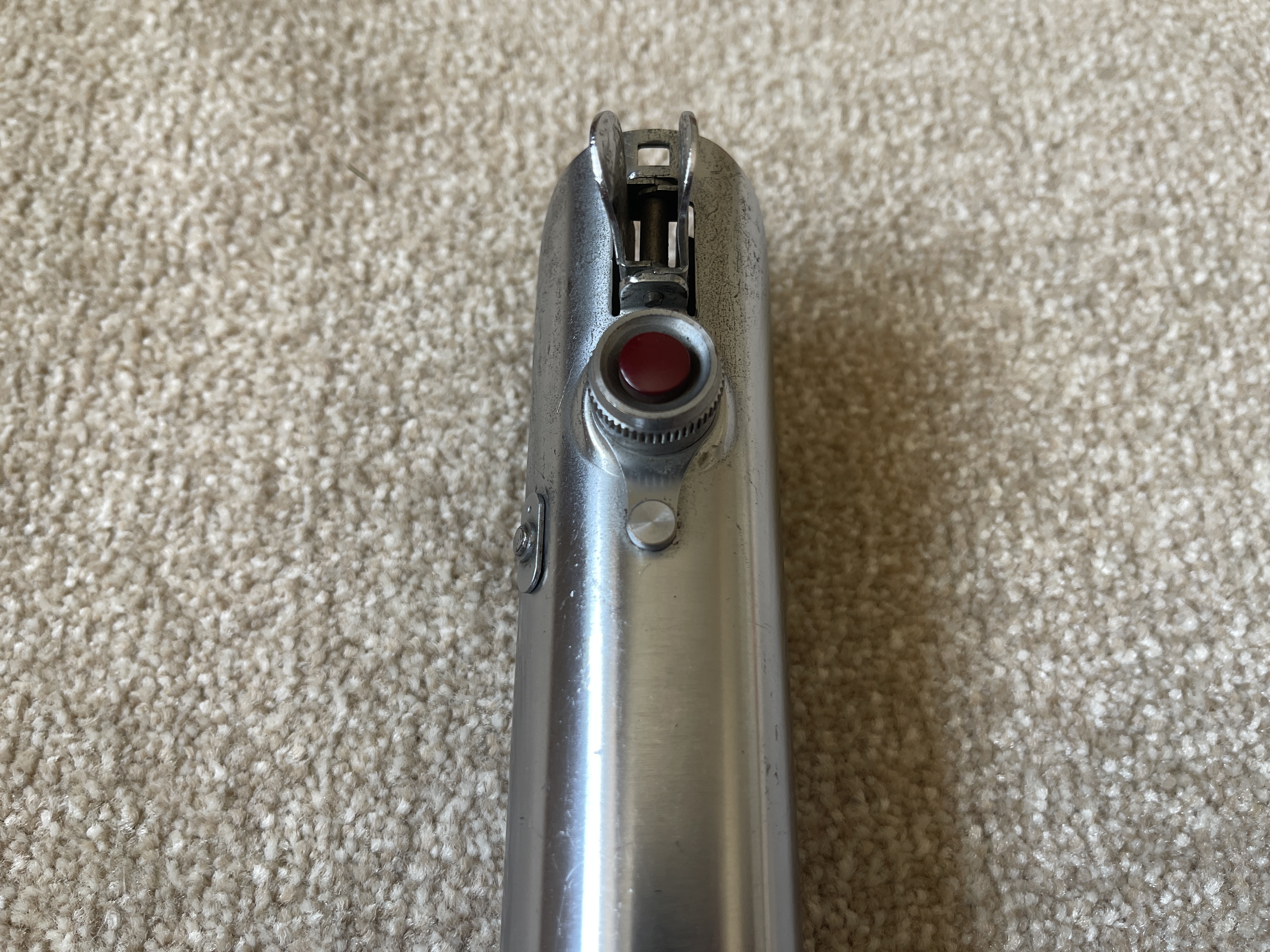

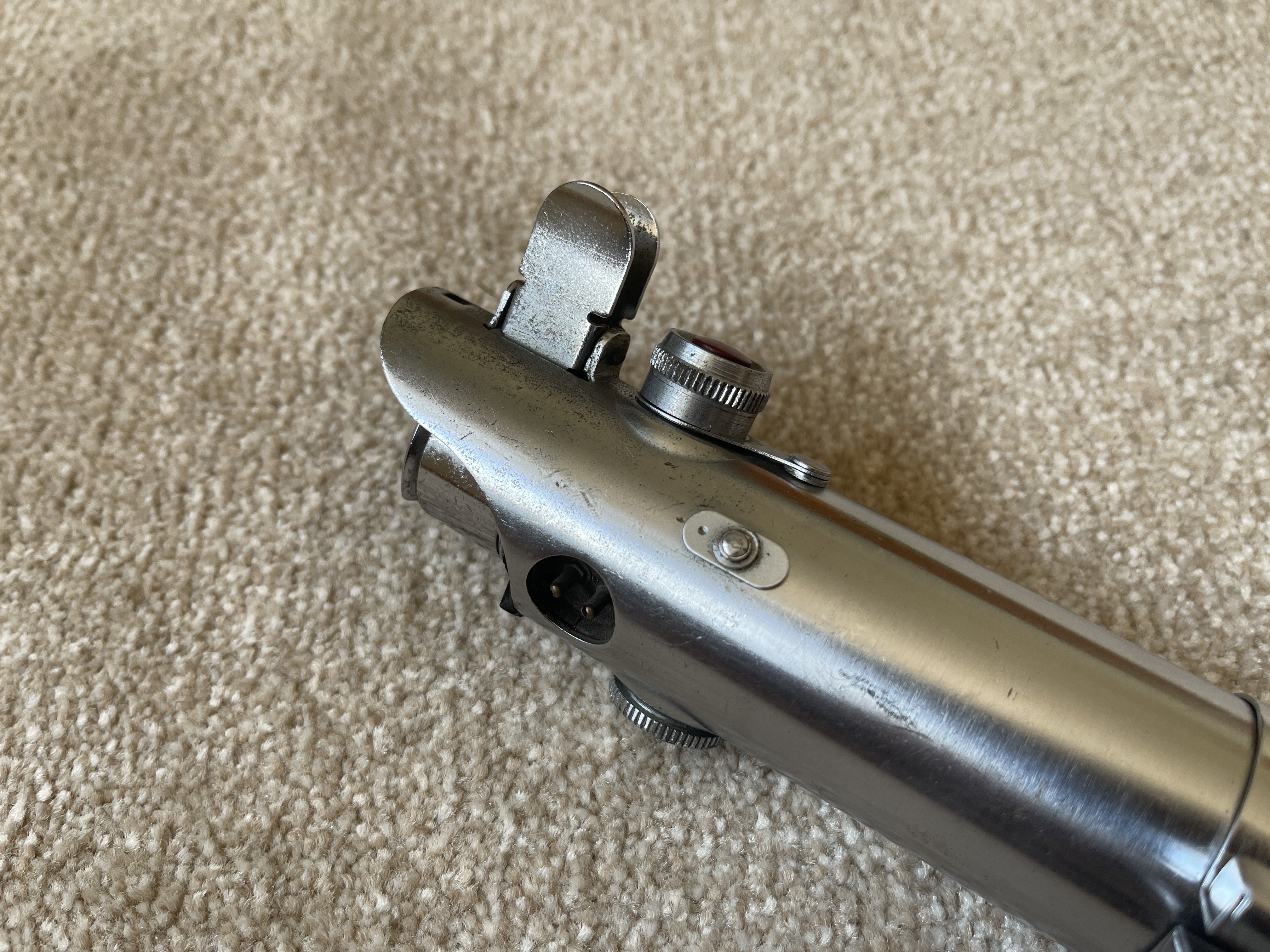

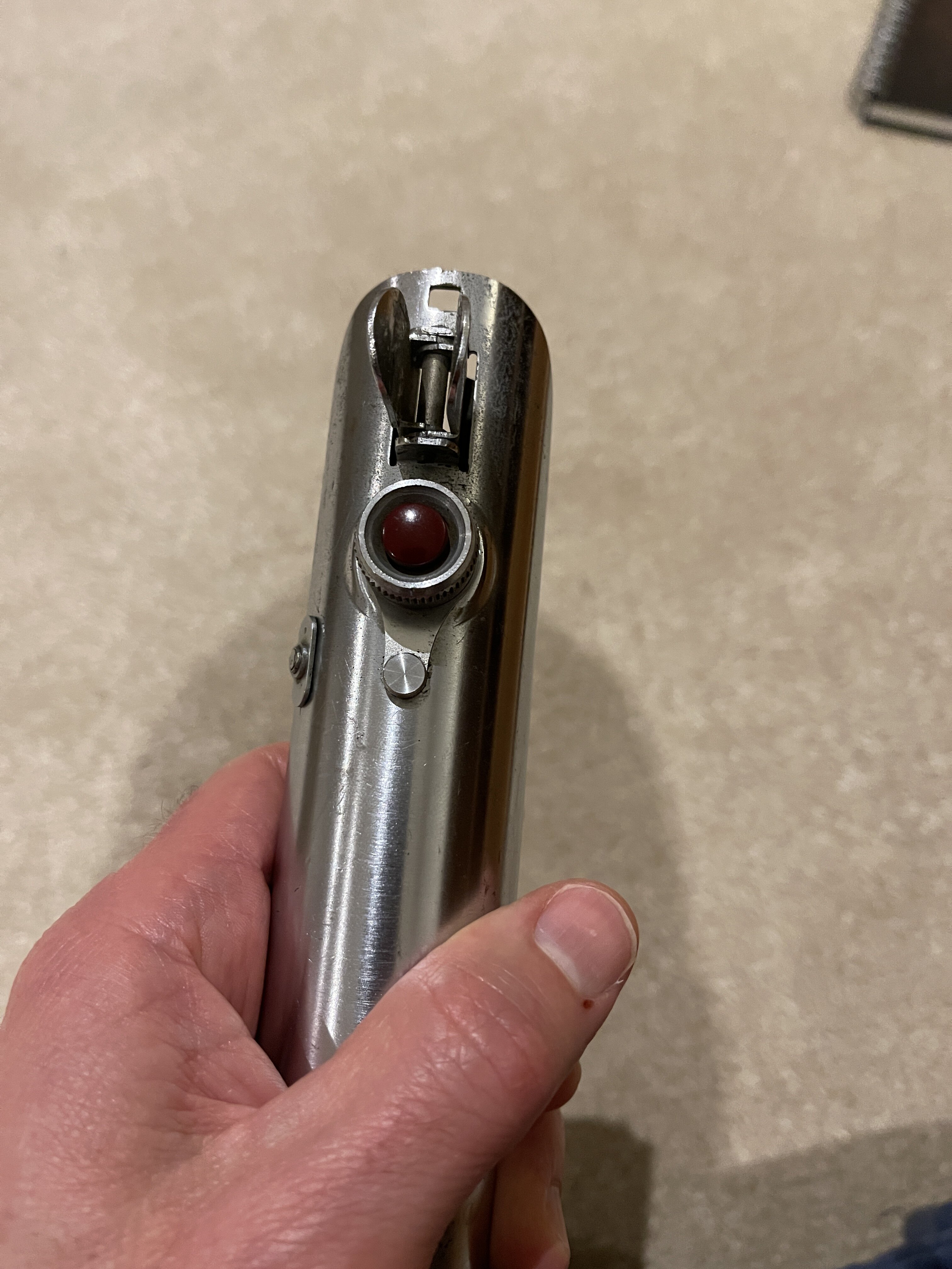

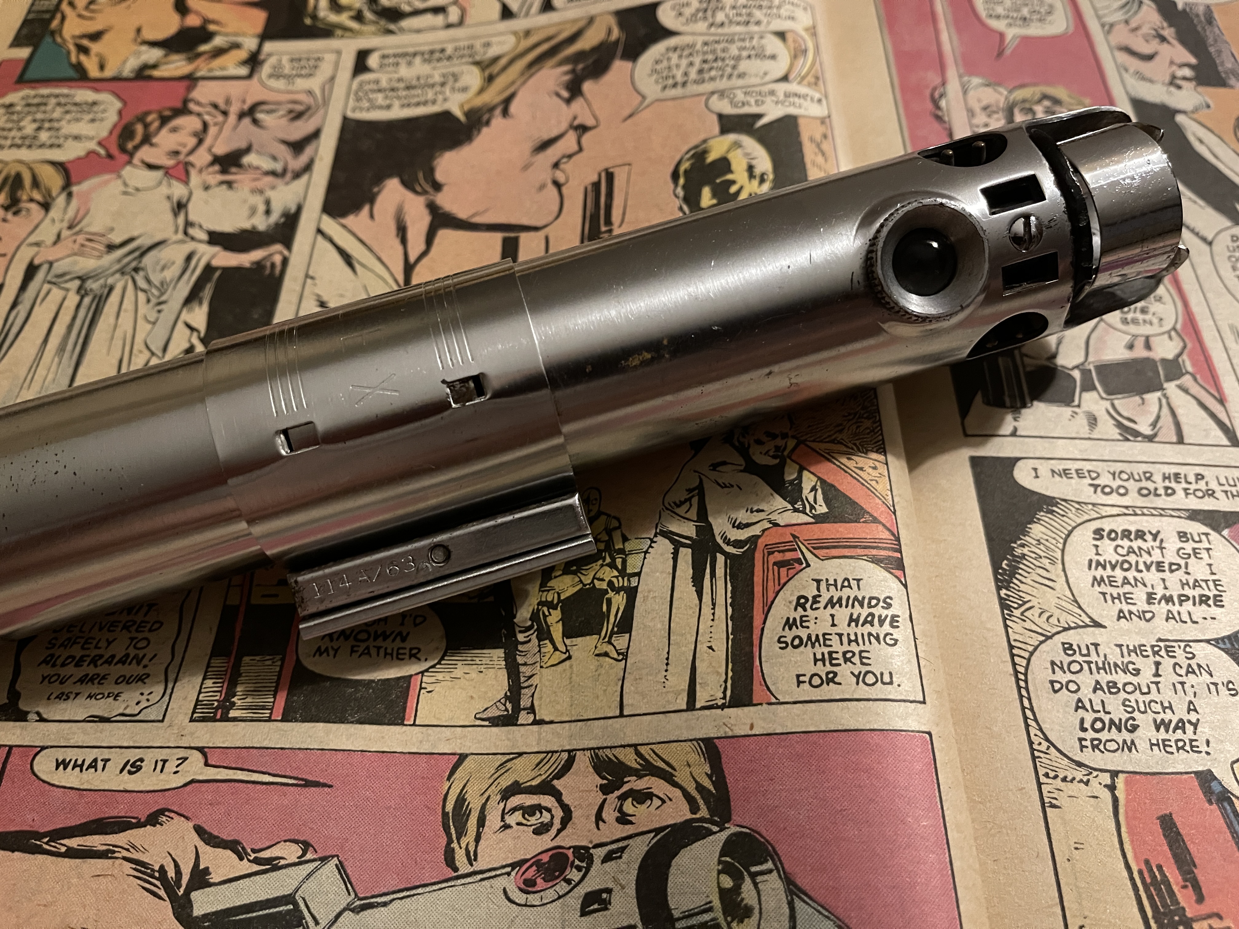

Told myself that my graflex collection was complete unless something really special came along………..
Got this last week, pretty much my dream version. If the clamp bar had been stamped that would have been nice but I’m honestly delighted with it.
The bulb assembly lip is chipped but it looks fine. I’ll add an early glass eye and possibly change the button but apart from that I’m going to leave it as is.
Delighted to have this in my collection :)(y)View attachment 1802034View attachment 1802035View attachment 1802037View attachment 1802040View attachment 1802063
Colin, this actually IS a really special piece. this is the real top half of that recent RAF folmer discovered by ChrisR. This Graflex and the other with the RAF stamp on it discovered by ChrisR in fact comes from the same seller who put them up for sale practically at the same time or a few days apart. Speaking with ChrisR privately in recent days it turned out that the eBay seller found them together and that it is very likely he inverted the top half of one with the bottom of the other. As you can see from the images that Colin showed his new top half reflects all the features that a genuine and complete RAF-Flex top half must have:
- Chrome Bunny Ears Ring (the second version)
- Chrome Bulb Socket Slotted Screw
- Straight and Round Head Brass Pins
- Thin Knurling & Single Step Folmer Red Button
- Shiny and Machined Finish Beer Tab Pin Head
Congrats Colin, you deserve it!

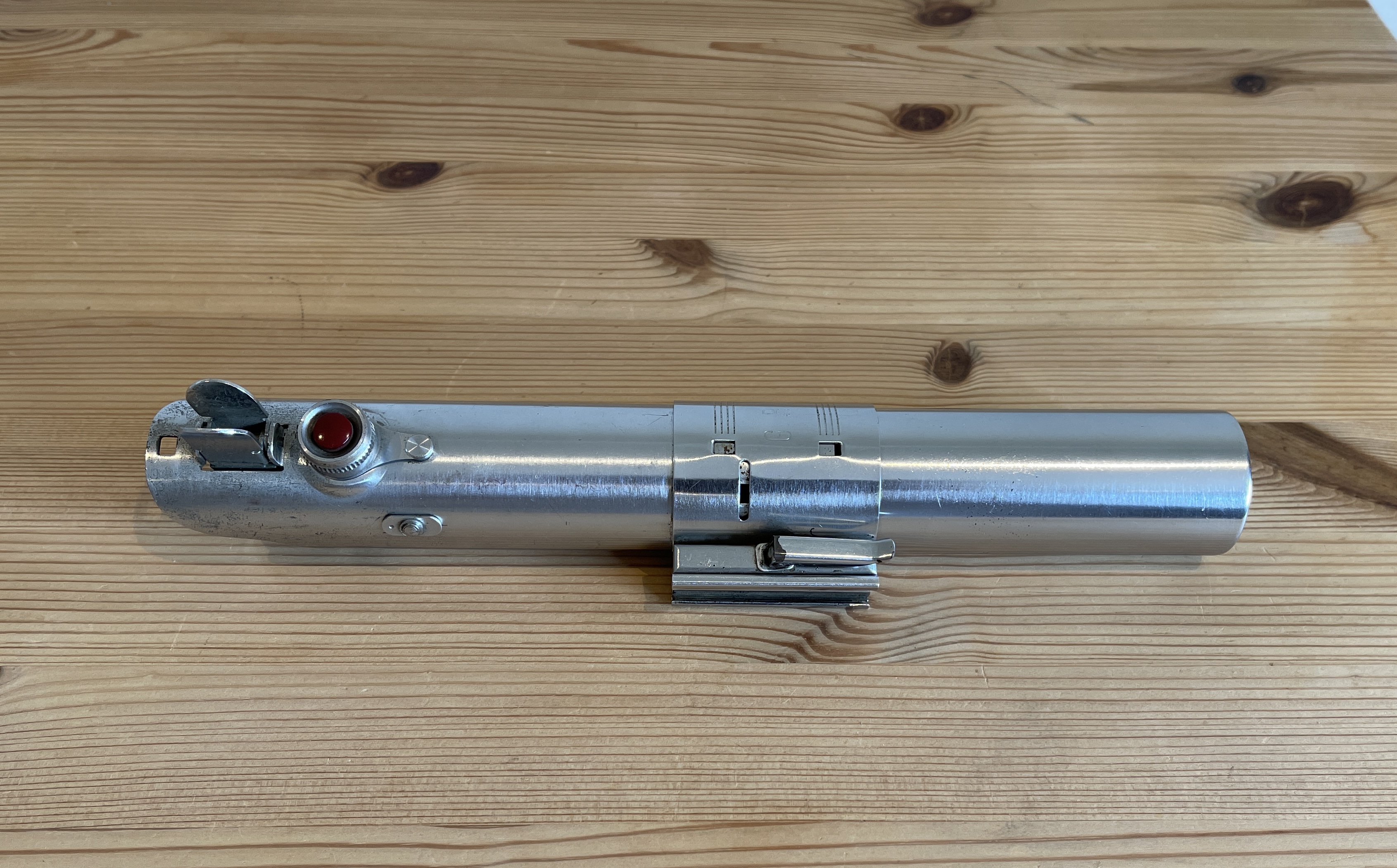

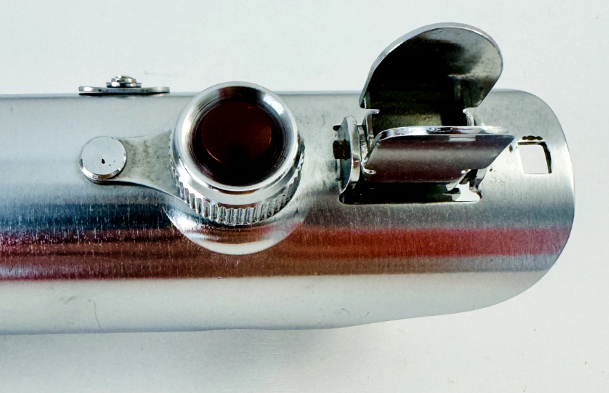

Reading through this thread it seems a shiny lever with a large rivet hasn't been found yet, correct? I recently purchased this vintage flash and noticed the lever looks like this. I haven't received it yet so I can't verify authenticity at the moment but what do you think?
The rivet head is not large enough to be accurate to the original prop. It may be larger than the average Inc style so I'm wondering if this could be a replica lever but hard to tell without more photos at different angles.
Are there any shiny Inc levers or are they all the matted silver? The lever is a part of an Inc flash.
Looking at the other end of the threads they seem to be brass unless its the reflection from the nut. I'll post the full saber to the Graflex Facts and Replica thread when I receive it.
There are no shiny INC lever at all. The finish has been changed from shiny to dull in the late folmer era and has never been changed since then.
Just to let the thread know, the lever and sidebar with nut were replica. Two tabs on the inside had been ground down, like you'd do for a V2, so thats what I'm thinking in terms of why it had replica parts. Everything else was vintage though thankfully.

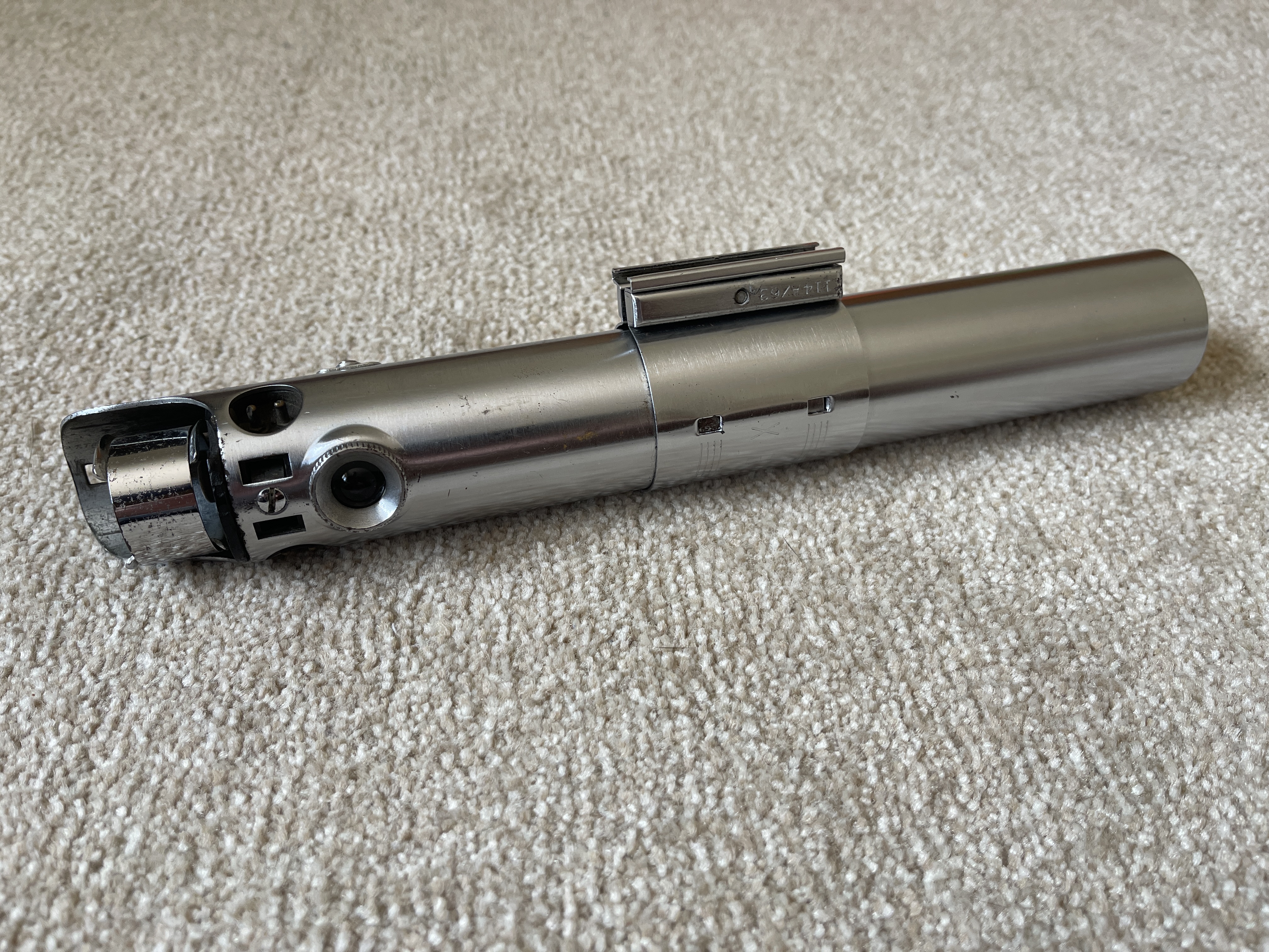

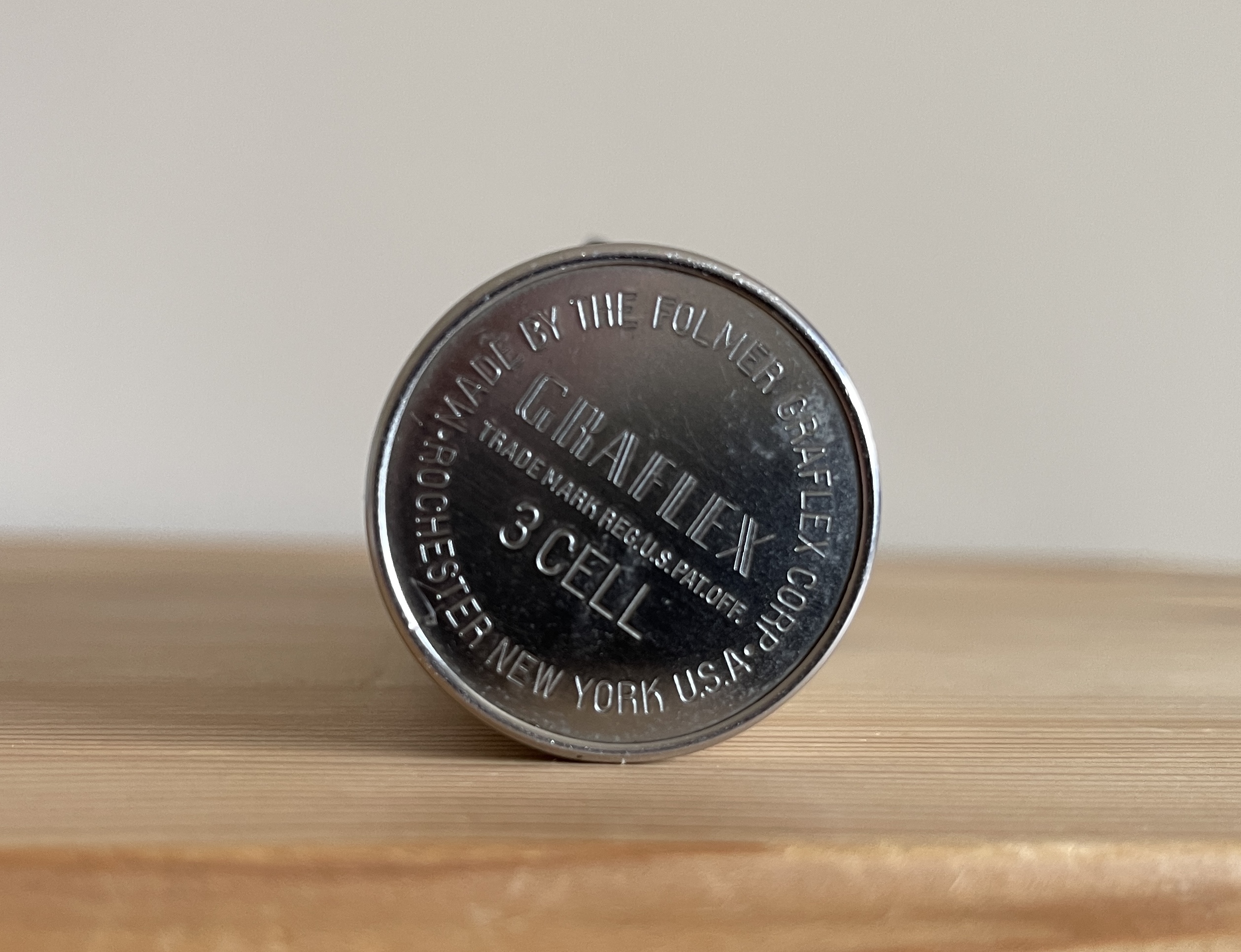

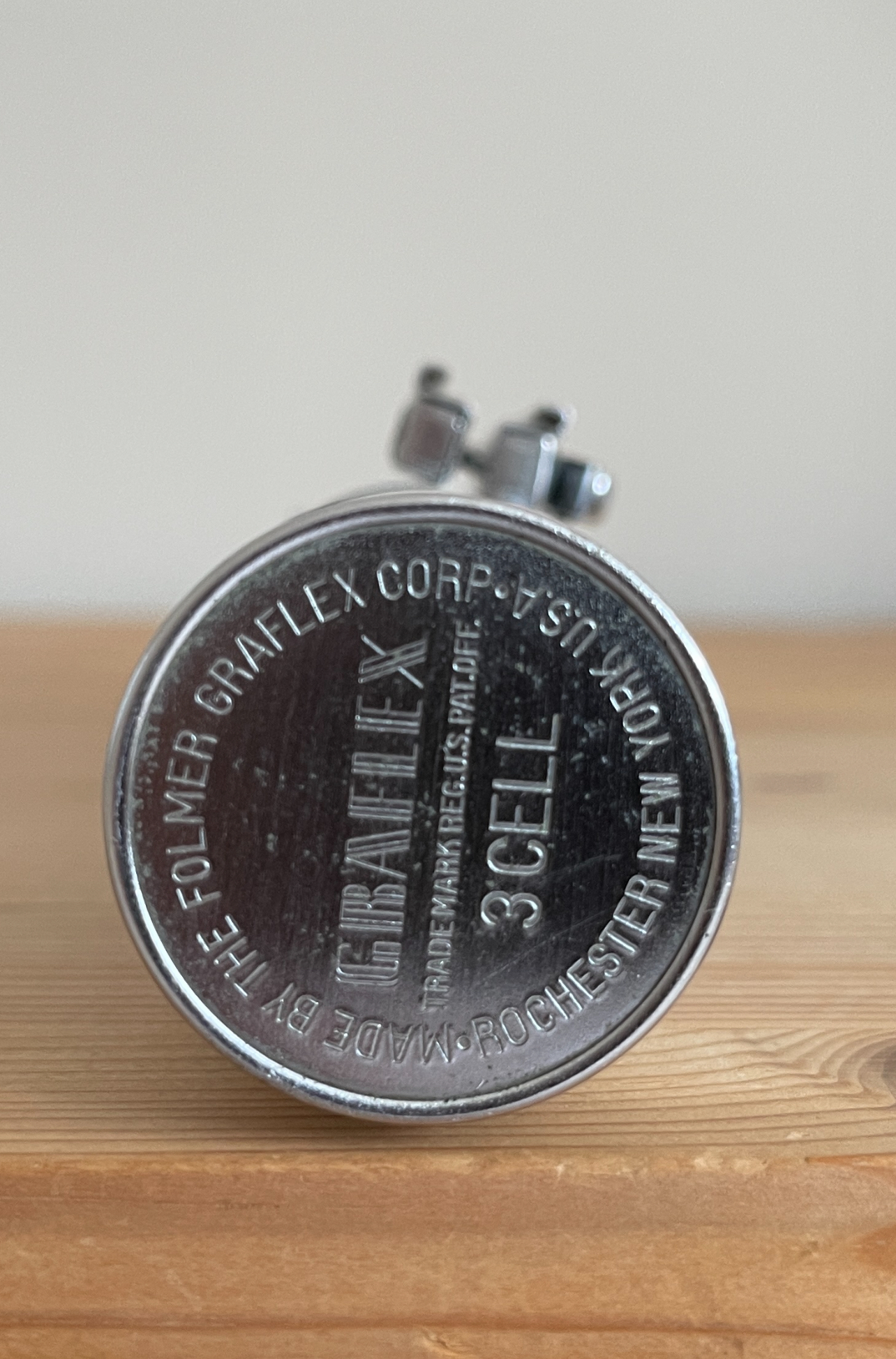

In the interest of research and discussion here is my new to me Graflex set up, I thought I was getting the smaller version but it’s the 4x5 and beautiful although the camera needs a bit of tlc especially the lens shutter but fixing them is my thing. It is recently imported from USA to UK so alas not MOD issue, although the box looks military, the box has P - 12 - PE stamped in a couple of places, is that an army thing?
The serial on the camera 365037, placing it at 1946.
The chrome on the Graflex clip seems to be flaking off, how do people feel about that, is there a good way to protect it without destroying? I suppose if I re chrome it will just be like another reproduction. It’s 3 cell, with patent and seems complete. The wire from flash to camera will need replacement, and I’ll give that a go too. There is a bit of battery juice corrosion near the glass eye, any advice on cleaning it up? Everything looks like it’s been together since new, but I think it’s had some upgrades, the camera rangefinder seems to be where the extra bracket is from, and there is a compatible but longer battery holder. The extra battery holder is aluminium and not chromed.
I’m planning on dressing this one up to be “Luke’s Camera” and maybe doing my first cosplay, so nfs. If anyone wants photos of anything I missed please let me know.
