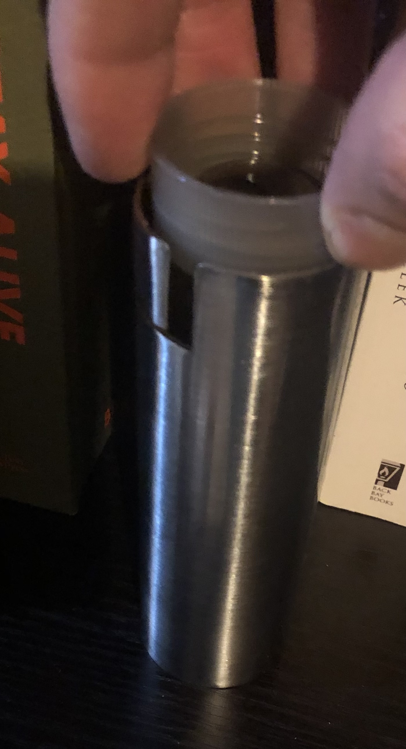

I speculate that rather than a “L-bracket” they would have inserted something more along the shape of a metal cap with a slightly smaller diameter than the interior of the flash that would hug the interior snugly and provide the surface to sink the d-ring into....similar to a paint cap?
A plastic cup just to illustrate what I’m describing:

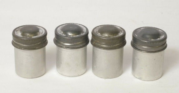

I think that makes much more sense! First thing I thought when I saw your post is of these old film canisters:
I'm not sure at all if they are the right size, but it is not hard to imagine that something similar exists that will fit just fine.
Bingo! ;)
