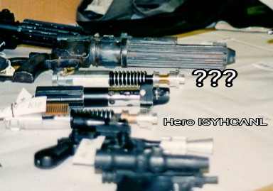

Guess it's best to ask on this thread as I dont think anybody has mentioned it yet...
A few of us are currently discussing the dimensions of the Luke ROTJ hero, and whilst digging around on here and on OriginalPropblog, I saw this photo which was taken between 96 and 97'.
What is the story with the Aluminium ROTJ under Bobas blaster? It has elements of a few of the known ROTJ hero style sabers... It seems to have quite a large wide nipple, and a brass on the first step of the emitter. Seems to have a large aluminium area on the windvane section and a brass tri ring. Is it the Yuma? I thought the Yuma became the ISYHCANL?
Yup Chris beat me too it, there are actually a few more photos of it during the time of this photo
