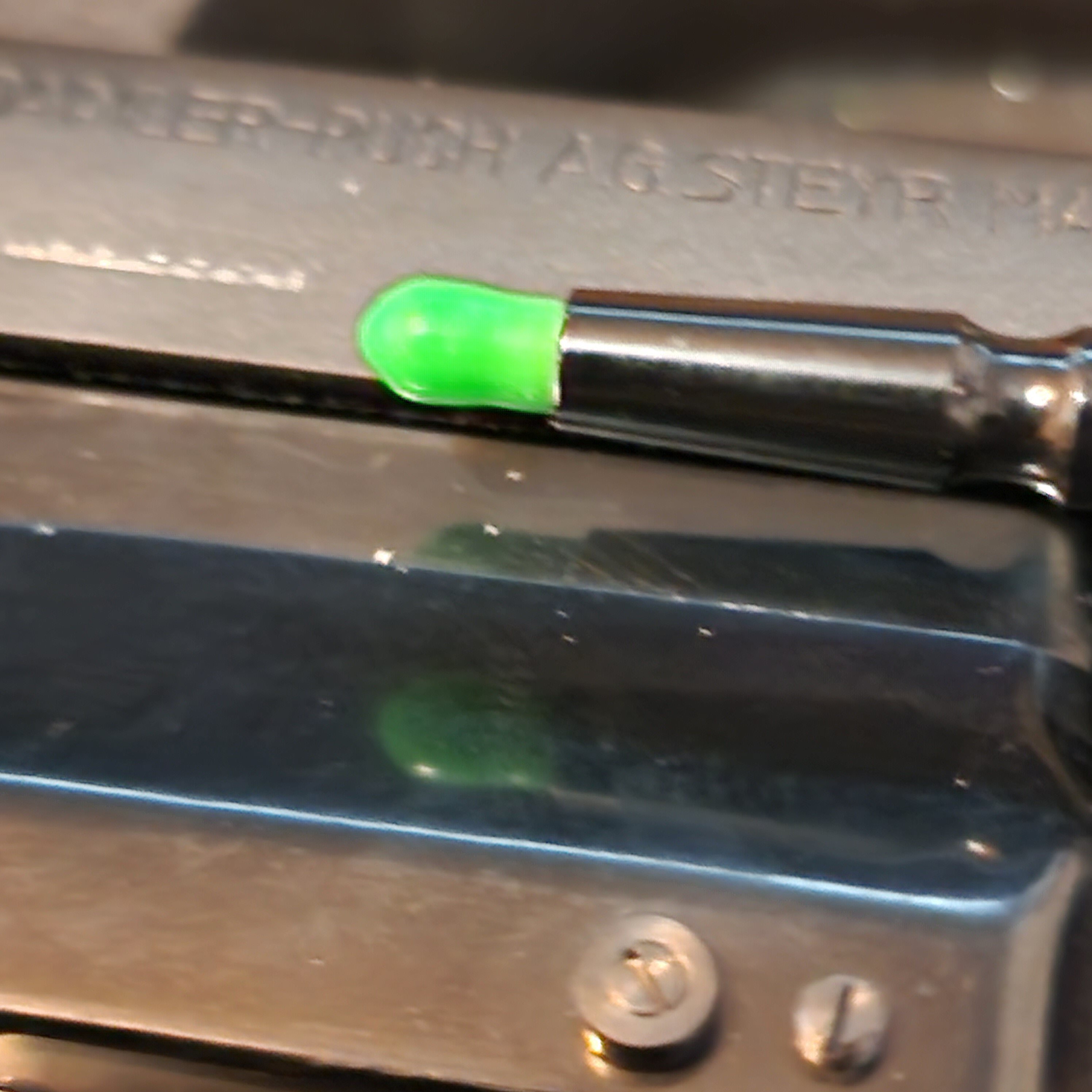

Take one of the Green Hitomi LED Lights and gently try to push it into the rod. If it doesnt fit try using some lubricant before attempting to squeeze any part of the light. If the lubricant doesn't work: Try the following. Take some small and not sharp plyers like these
and GENTLY, VERY GENTLY squeeze the lower part of the LED light together, rotate with the plyers around it. DO NOT use hard pressure, just gentle small squeezes try to fit it into the rod now using some lubricant (i used WD40)
you will realize that the LED light now at least fits in a little, you don't have to push it all the way it, just as much until it sits tight.
You can push it further in, i recommend not pushing it too far in (believe me... that costed me two of those lights...) good thing i ordered six...
You can now push to turn the lights on and slightly pull under the LED to turn them of, do so very carefully with your fingernails, you don't necessarly need to use both hands as stated on the back of the packaging
You can put the green rubber caps on the lights to blend the silver metal. Also that way it is easier to push and pull the LED.
You're almost done now.
Push your LEDs or the caps on them until they turn on
Pull on the caps until the LED's turn off.
Thats it. As i stated do not do any of this if you don't feel comfortable with slightly squeezing the Battery together. As you can see on the pictures i did not overdo it and it doesn't require much to fit them in a standard rod. I had more succes on the 3D Printed one since the rod differs slightly. It was easier to push the lights into that, but also since that rod is glued on plastic it is easier to break of.

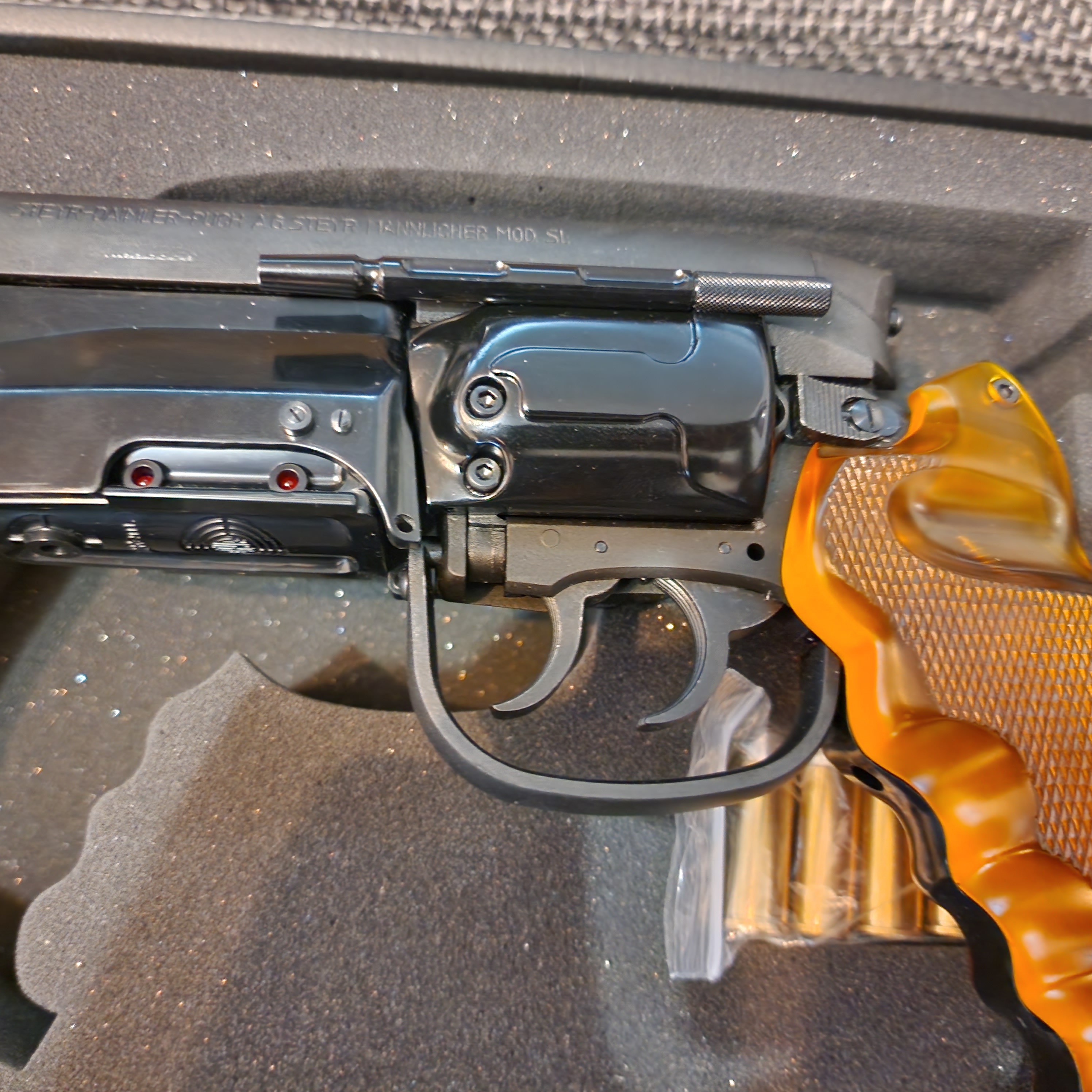

FWIW, here’s how I wired up my stock Tomen. I used the stock green LEDs that came with the replica.
I unscrewed the black metal sight rod and fed 4 VERY thin 30AWG wires through the open hole in the back of the sight rod. It’s a very tight space but it can be done, one side at a time. Then I ran the wires to a second CR2032 battery. The lights seemed to short out if I ran them all off of the same battery, but it worked if I kept the red and green lights powered separately.
I picked up the “click” activated lights, but they looked too big. I wanted to keep the green lights stock. I found good back up green LEDs, in case I needed to replace them... they were size 3.0-3.2V/3mm green/yellow lights. I added a bunch of pics and a crude diagram, if it helps. Good luck!
