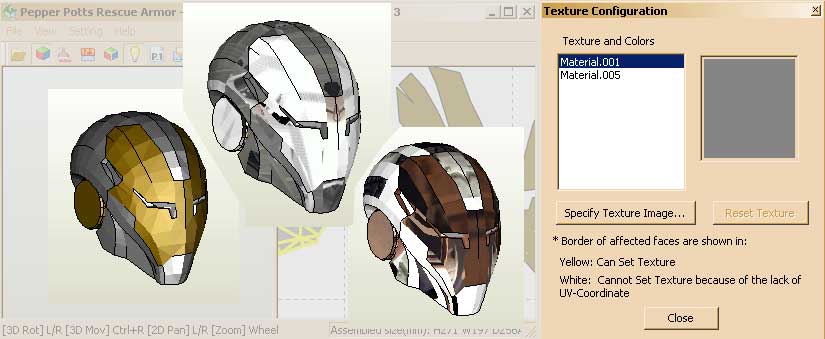

Hey anyone know if its possible to edit colors on pep files? I know I could print them on colored cardstock but I'm not interestes in printing. I'd like to see what things would look like in a different color scheme. Thx
Re: **ASSISTANCE NEEDED" editing pepakura files
Long answer : yes.
If the 3D object embedded in your pdo file is already textured, or has some UV maps, you can change the texture images through the Setting menu.
You can input an image of 1px*1px if you want to get a simple plain color.
The number of separate areas that can be set depends of the UV-map settings initially applied to the 3D object.
Yes, it is.
If you prefer re-editing the object to add mappings, then you loose all the unfolding work... :\
If you're just testing texture schemes, you shouldn't need to worry about unfolding.
