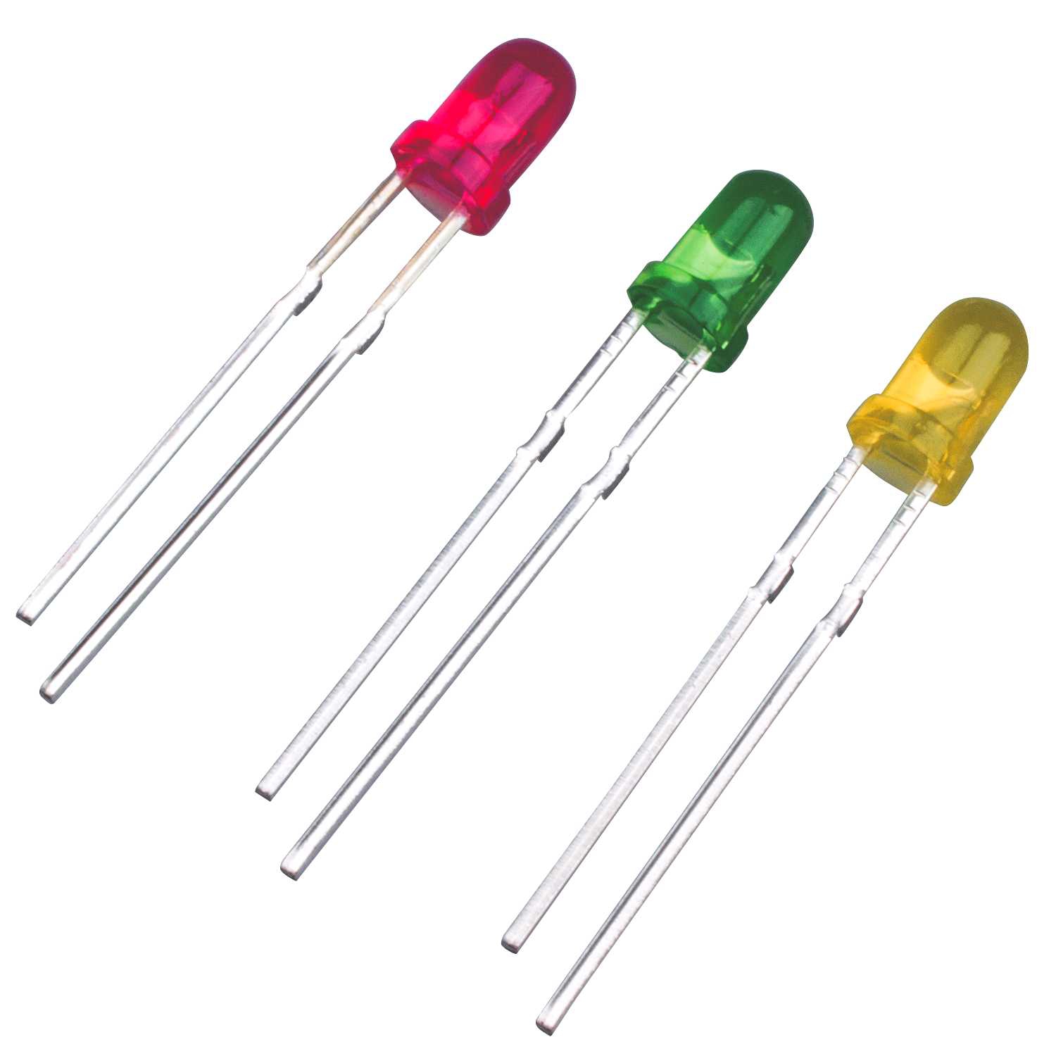

Your current LEDs are Charms candy green. Those are incorrect. The old LEDs are very close to true green. If you can find old electronics, you may be able to see the difference.

This is approximately the right green:
Because colors in digital pictures can vary, the green looks about right but the red is wrong.
Thank you for the reference. Alas, that green is hard to locate and whatever LEDs I have now is based on this era's manufacturing technology. Earlier in the thread, my problem with green LED was that I had two versions. They both looked like Charms Candy Green but when it was lit, one was a sickly yellow/green while the other was just green. I was overthinking a little since in actual Movie, they were never lit. I do have some vintage LEDs but never the 3mm ones, either with diffused or clear lens.
