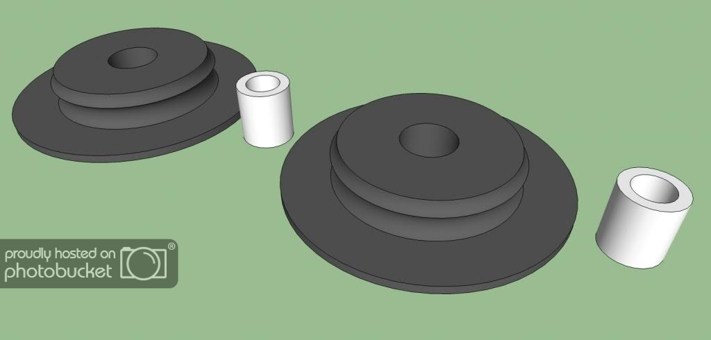

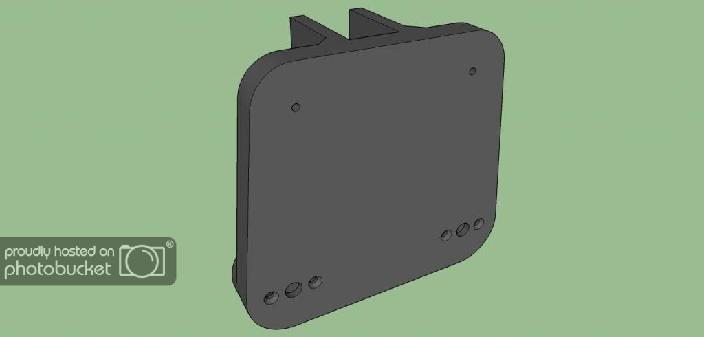

Since I've decided to run TWO motors to drive the barrel, I needed to devise a mount that not only holds 2 motors, but also holds 2 tensioning pulleys to keep the belts aligned with the slot in the barrel assembly.
Here's the bracket
The bracket will hold two 300 RPM motors, but I've also bumped up the motor pulley size to increase the barrel speed just a bit. :)
Here are the tension pulleys (two of them riding on tiny ball bearings will guide the belts between the drivers and the barrel assembly pulley.

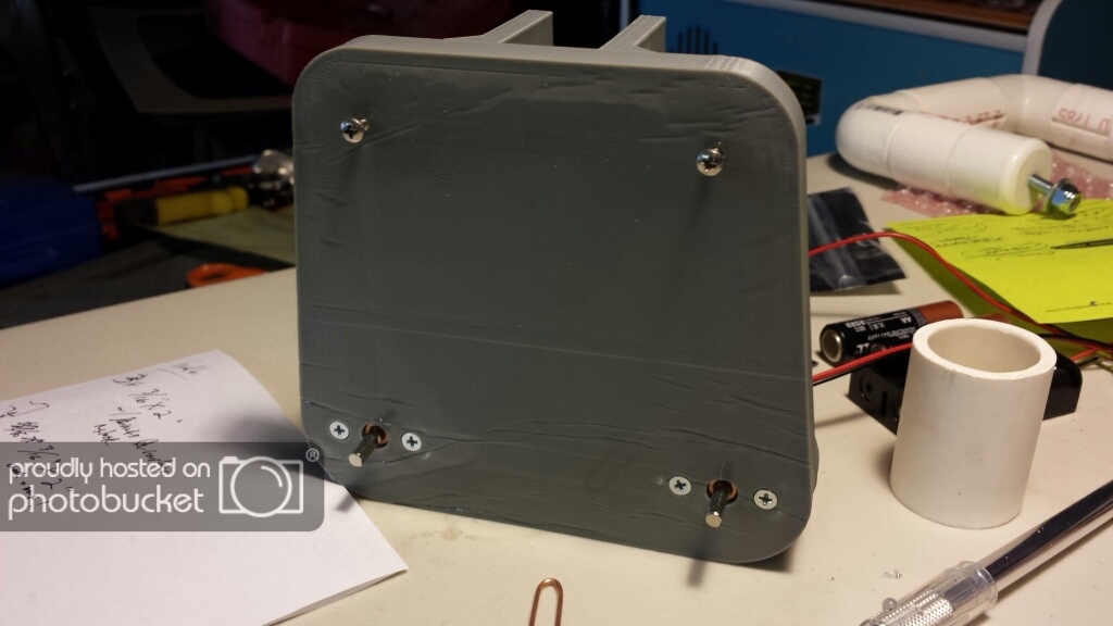

UPDATE

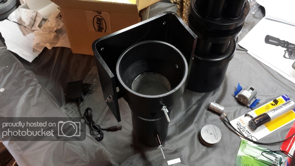

Started drilling the barrel assembly for mounting to the handle and ammo can.
With some adjustments to the front bearing holder to make it clear the carriage bolt heads.
Prepared the front of the ammo can.

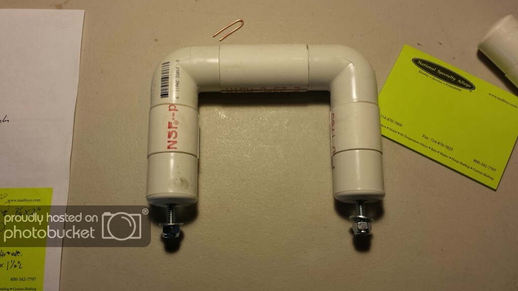

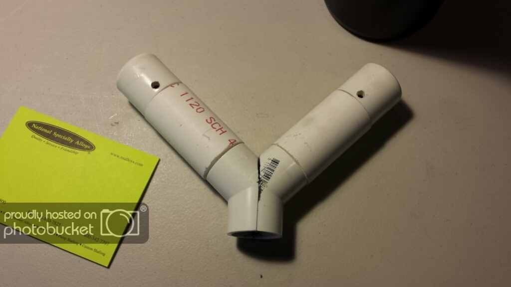

Started finishing up the handle (3/4" PVC with 1" PVC "sleeves" to keep OD nominal).
Same trick with the frame.
Motor bracket is coming along nicely.
I'm going to mount a small project box on the rear handle with all the switches, so I can operate everything with my right hand while holding the prop.
If you want the full effect of what I got done... watch the video here!

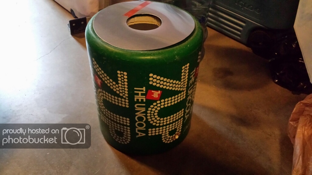

Also, I'm getting close to painting and assembling the ammo can and thought I'd share my method of mounting the speaker in the front of the can in a way that hides it while letting the sound out. :)
I'm going to hide the speaker behind perforated steel sheet... and I'll mount the ammo can nipple to the sheet with a single bolt from behind. It will provide a nice dark void around the nipple where the speaker can breathe.

Speaker installed in ammo can (7-up cooler)
Aluminum flashing installed with Shoe Goo on end of cooler... to be Bondo'd and blended into cooler structure for clean lines after flashing is wrapped around the cooler also (need to make iconic riveted flap/seam on side of can)
Handle and Frame will be made from 3/4" PVC sleeved in 1" PVC... then Bondo'd to make the structure a fairly uniform size
