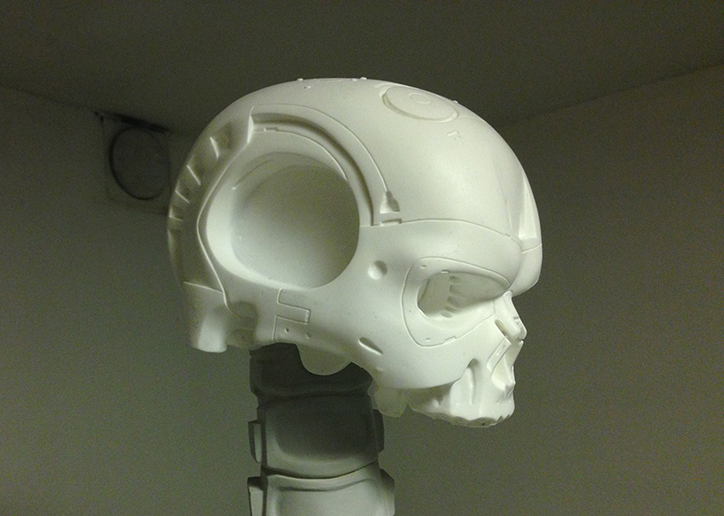

I've been making a mold of the skull, the first time around I didn't use enough catalyst, so I had to clean the skull and remake the mold from scratch.
Here is the process of the successful mold:

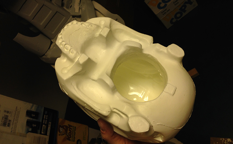

Thanks guys! :D No I haven't run a cast yet, I wanted to try the resin on a smaller part first since it's been a while since I bought it, but it still works as it's supposed to - so I'm going to run a cast tonight! :) I'll keep you posted!

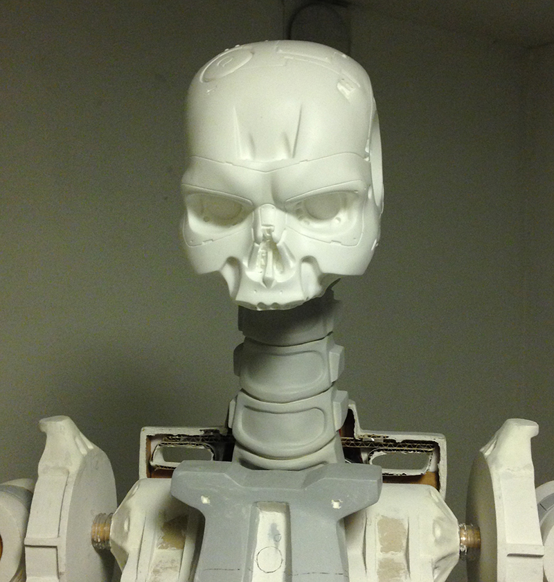

And the first cast is done, TA-DA:
There is some flash to take care of but nothing major. Overall I'm very happy with the cast! :)

Nice clean cast! :thumbsup I assume its urethane? rotated casting by hand? good even thickness??
Congratulations, it's a lot of work waiting for you, but it will be wonderful. Do you have an idea of when it will be completed?
Thanks guys! Yeah it's smooth cast 300! Great stuff and very good for rotocasting!
I pulled another cast yesterday and it came out just as good, so the mold is doing it's job! ;)
