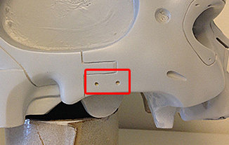

Wanted to share a small detail I have come to realize. These small holes:
Apparently no screen used endos had those. Though they can be found on for example the M1, icons and timeless skulls

Thanks for the headsup!
I looked it up, and actually the T1 and T2 endos have them, but only on the right side. I have some screengrabs where they are clearly visible. I do notice the M1 has them on both sides and so does mine. I'll remove them from the left side to make it more accurate! :)

No problemo :)
I've been checking the T2 intro and none of the endoskeletons have those visible holes, not on any side. Though it is difficult to tell sometimes ;)
Before I finish my M1 build I will definitely fill in them holes.
