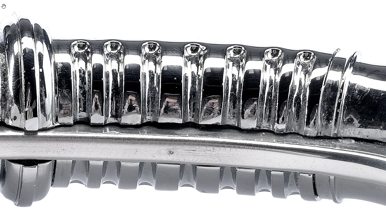

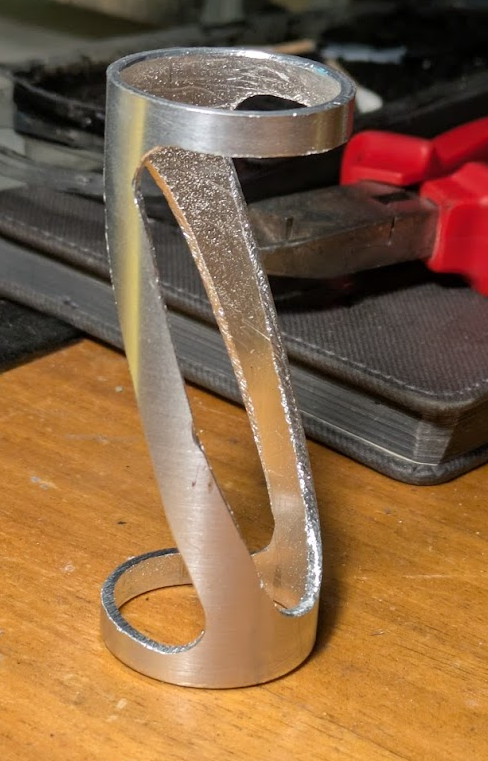

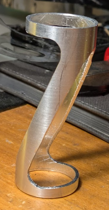

I have a feeling that the original Ep II Hero is made of tubes. If you can get it to bend right, I reckon the foregrip is two curved tubes over one another, the outer tube having the grips cut into it and the one inside creating the recess. I don't know exactly how the knuckle was done but, for me, the easiest route was to cast it in metal from a sculpt with the bend already. That had its own troubles but I think a series of bent tubes would work, too.
The Ep II Anakin was very obviously aluminum stock: tubes and solid round bar machined to shape and fit together. I think the Mace Windu was lots of machined tubes as well. It would not surprise me if the Dooku was made similarly!
Not so sure about that. The indents in the neck are quite clearly cut with a ballnose mill bit (before bending, that's where the weird irregularities come from) which makes a 2nd tube inside unnecessary. Also bending two tubes at the same time would probably not go very well and you couldn't fit them together once they were bent if you bend them seperatly.
Would love to see if this replicates the same results on the prop! I figured it was engraved with a ballnose bit and that was why it was irregular (that's how I opted to go about it on my scratch build). Until the hero pops up in auction in the future, I suppose any way is valid as long as it gets the job done.

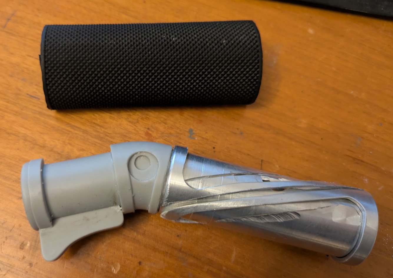

Alright, small update. I resin printed the little connector piece at the end of the hilt today. It's my first time resin printing and I am super impressed with the quality. I thought I would post-process it and then resin cast it for better quality and hardness but honestly I am really tempted to just paint it and then use it directly. I also found a bike grip that I cut apart and that I am going to use for the rubber parts of the hilt.
