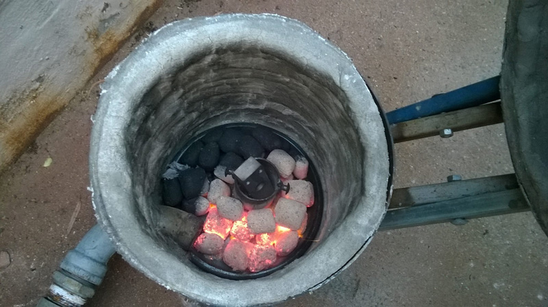

I'm going to try the BBQ beads and hair dryer first because I'm interested to see how it goes. I have a gas regulator and venturi poking into my forge so I can also drill out the port in that and stick that in for a go later.

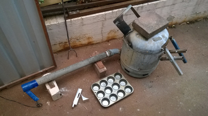

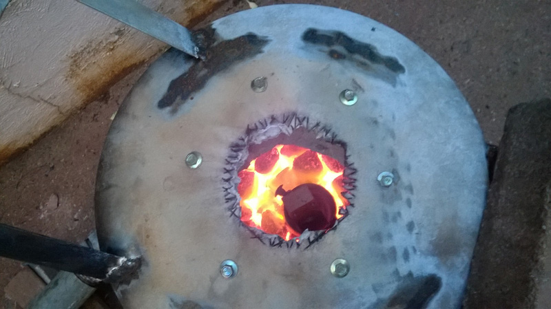

Testing the forge for the first time.
Warming up.
Inside the furnace.

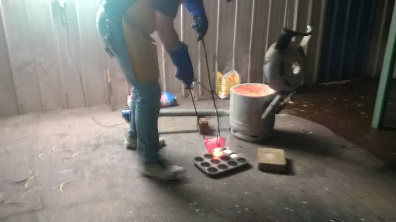

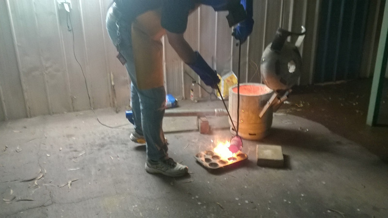

Pouring the molten aluminium.

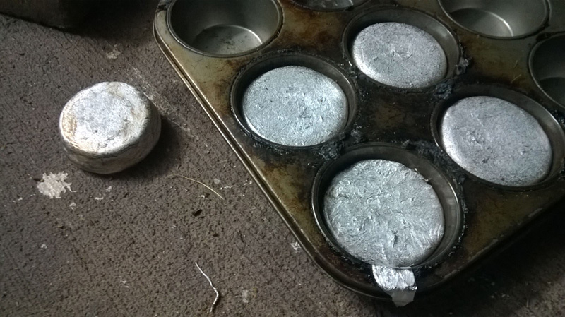

Ingots for convenience later.
