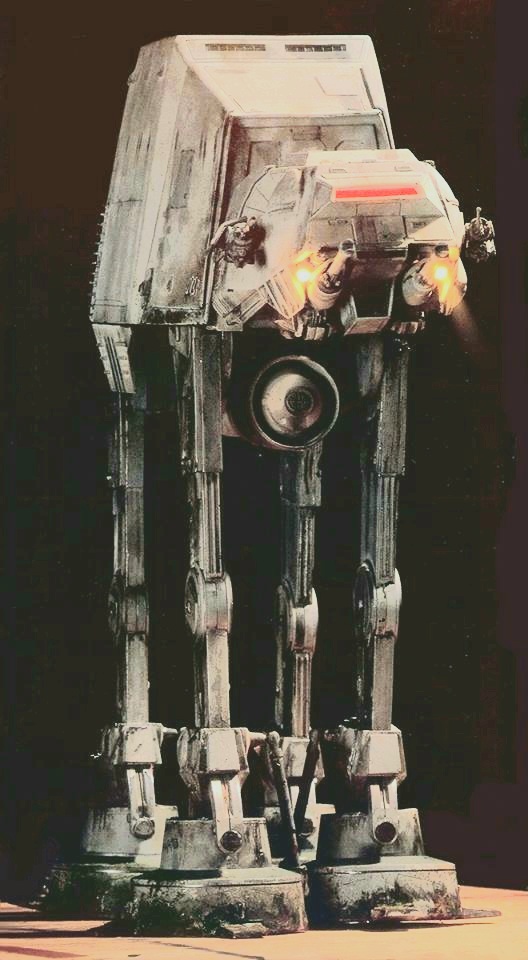

Another great upgrade starks ... here's a picture of the ILM team and 3 of their AT-AT walkers :

Gee Chaim, wouldn't you just love a high res version of that image!
Look at the toes! the center walker has 2 feet up and the toes are articulated down, the rear foot on the rear walker has a toe articulated up!
so the smaller hero models had this feature.

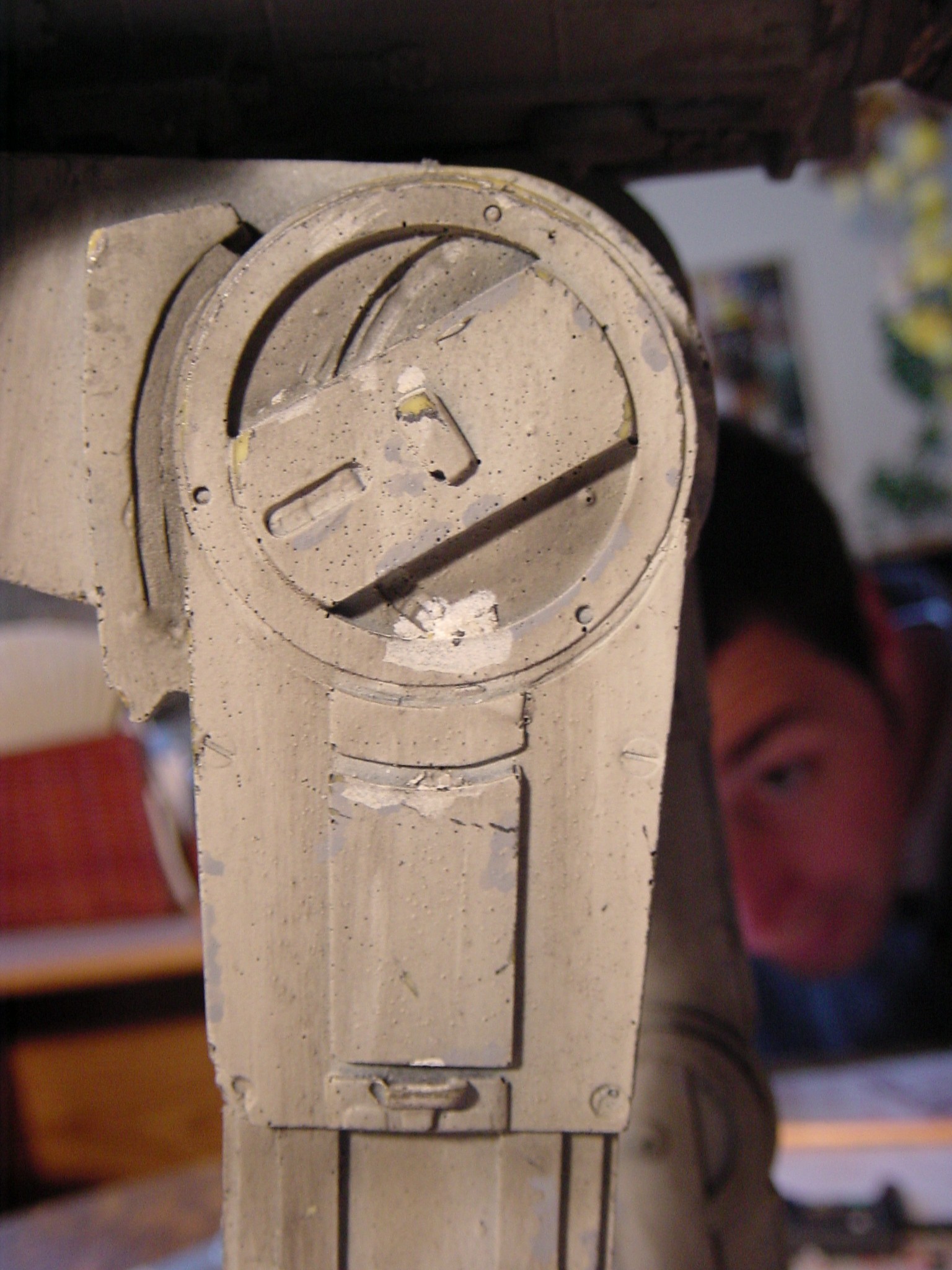

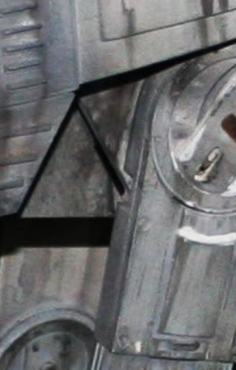

I was hoping you fella's could help me with this leg extension, the piece left of the joint:
I notice in many photo's these extensions are not present.
They seem to be attached to the leg itself and are intended to articulate up and down in a slot in the hip?
Do we think they were attached to the leg and broke off? or a removable piece?

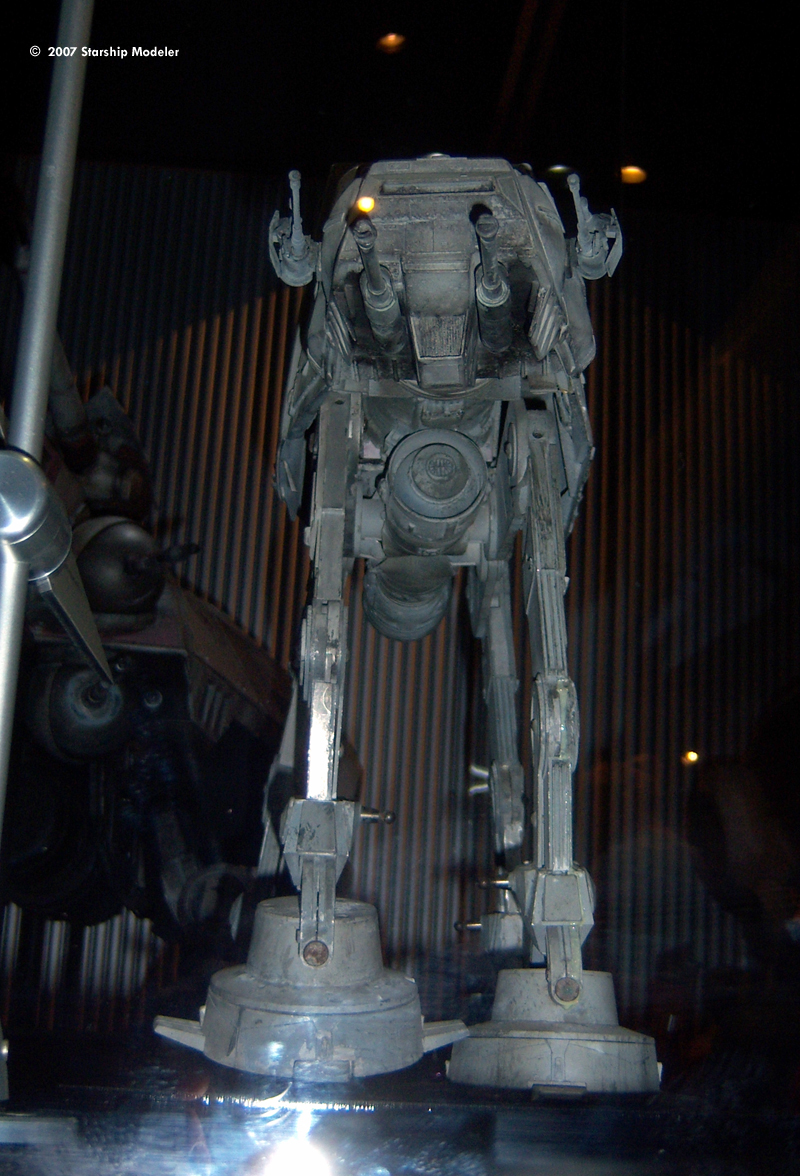

I was looking at those a few days ago and noticed they are in the screen shots and included in the Bandai kit. You get a hint of the movement again in the sequence with Luke gernading one.
As for part of the leg I think they are a separate piece based on the changes in orientation as the walker moves. They look to be a motion synchronization link to the legs as the hips move up and down. Maybe static models didn't include them or had non-moveable representations only. If motion was forced wrong I can see them breaking off. When they are missing is the full cut slot in the hip still there? You can see the motion orientation in the picture below.
I also noticed that the rectangular joint centers spin around. The ones at the hip have a slot in them. The slot in the rectangular part is on the side of the crescent slot in the joint disk behind. As it rotates a cam apparently slides back and forth. That is until you see the big close up model and then they are reversed or out of sync and there is no cam.
Slots lines up over the crescent slots behind at the hip joints and are pointing towards each other.
Notice how the rear one has rotated down slightly as the leg moves forward. You can see a hint of the cam movement I think.
Now they are pointing away from each other and the slots in the rotating center no longer line up with the crescent slots in the disk behind. No cam is present.
Now they are both pointing forward. Out of sync. The head blowing off was quite the shock to the system.

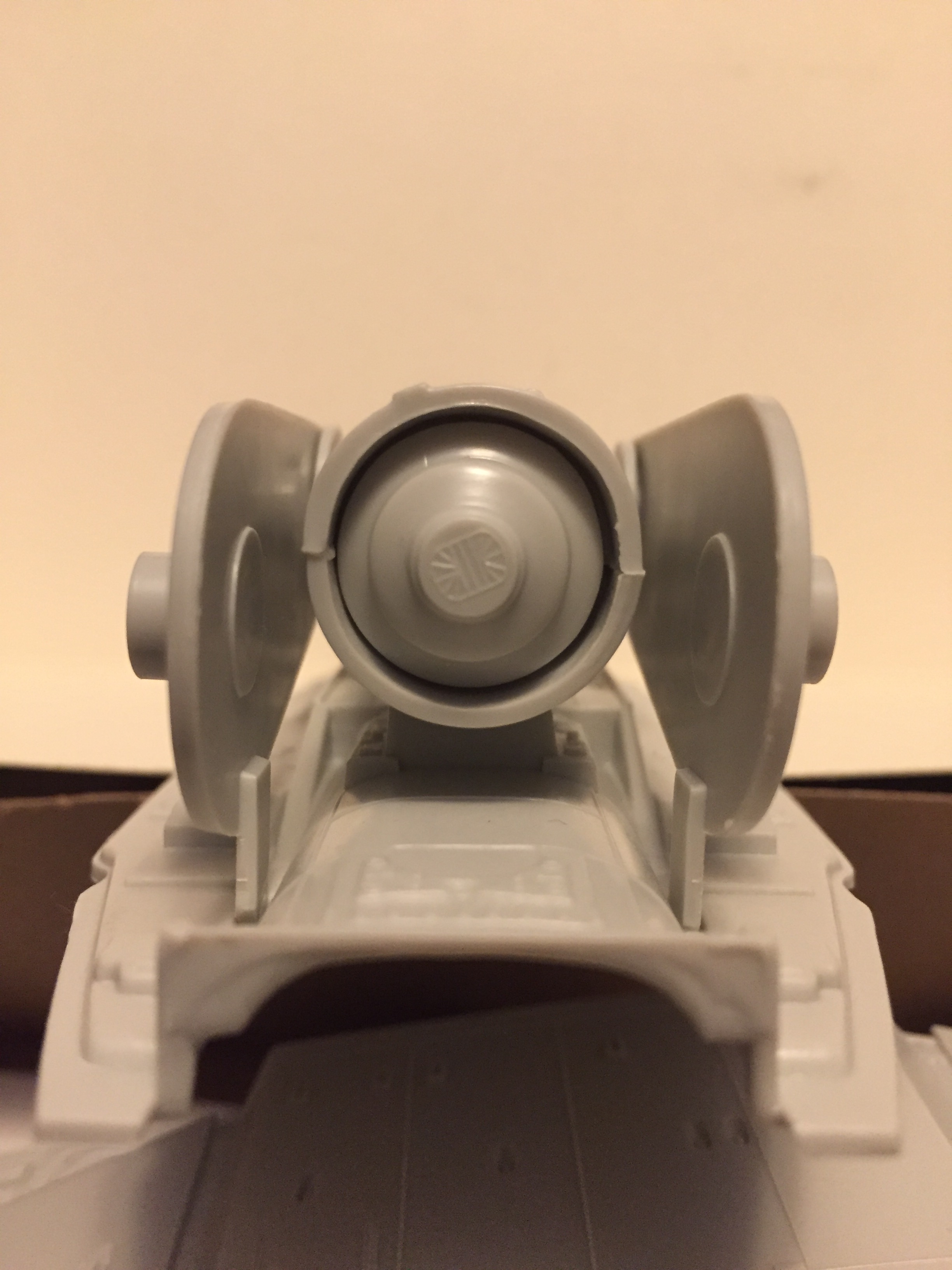

...And great job on the front piece to the drive motor and the vents. Looks like part of the original with those side vents.
I wonder if that front cap spins in the Star Wars universe as the on screen version has it vertical, or is the discrepancy just another prop error. I didn't find an on screen shot showing it horizontal.
Checked my MPC kit and it's a faintly molded detail rotated to about a 45 degree angle, neither vertical or horizontal. Given the missing armor example that they captured so well I wonder what the orientation of this in on that studio example.
Actually would be a cool effect to have it rotate back and forth as the hip blades move up and down, kind of like an exposed differential of sorts.

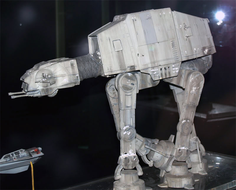

So here's the shots from those other models. I noted on this shot of the walker used in RoTJ that Analyzer shared the vent is horizontal
Also on this model. This model has the extra layer on the plating behind the side guns and the RoTJ walker does not so they're definitely two separate models. Also this can't be the resin copy as you can see the paints worn off exposing the metal legs.
So I'm satisfied I don't need to change this one back like my rear oval haha. I would say the other model with a vertical grille is a discrepancy but as mentioned earlier it is how it is on screen so either orientation I think is acceptable.

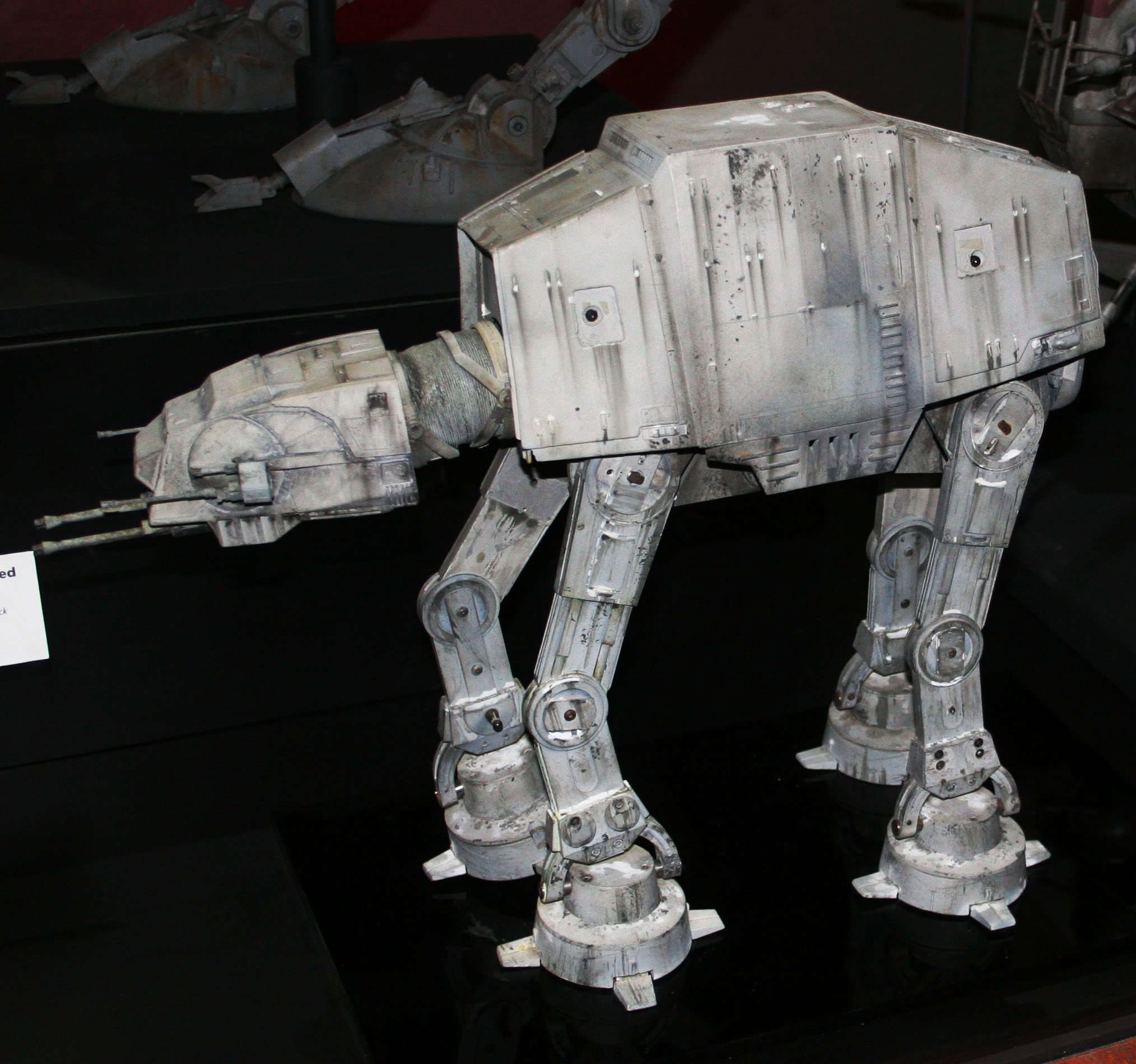

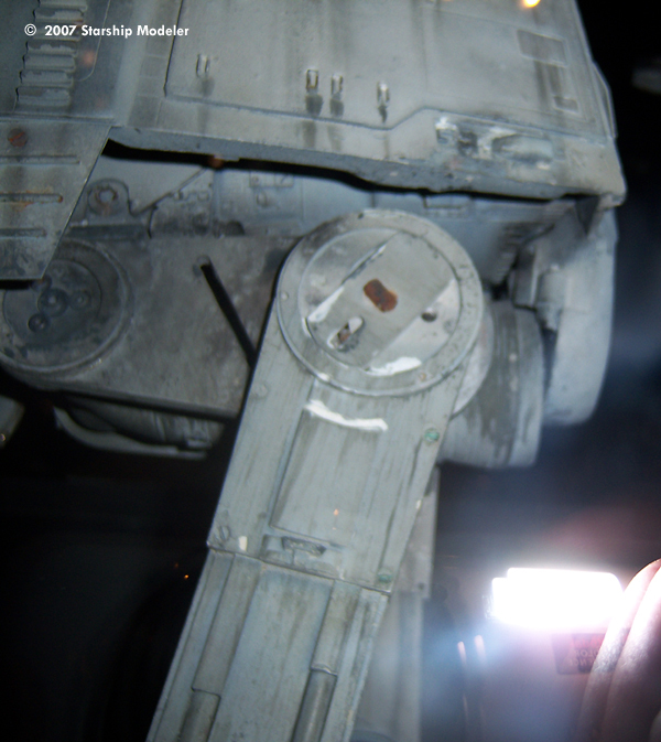

Hey Analyzer, where did this photo come from? it has occurred to me this is the resin model from the modeller magic page, all the detail on the side lines up but no broken neck at this stage.
I agree, I wouldn't change the orientation of the hub on the front drive section. Just pointing out the variations I noticed. One thing just occurred to me. Is that last shot I posted showing it vertical an added CGI shot? It looks a little different to me and that might explain the orientation.
You can also clearly see the hip joint cam I mentioned in the shots you posted. I wonder if the leg extension piece was connected to that cam. If so the motion of it might make sense and it would possibly lock the leg position in place but it might have to be moved by the animator. It is on my thinking list to further investigate the possible mechanics of that piece. Not all the models seem to have that as a separate piece.
Most likely I'm completely over analyzing the function of the leg extensions which were possibly there just because they added part movement variation to the model to make it look more complicated and cool and cause people to wonder what is the purpose and how could this work? If the last part is true the model designers certainly succeeded. :p

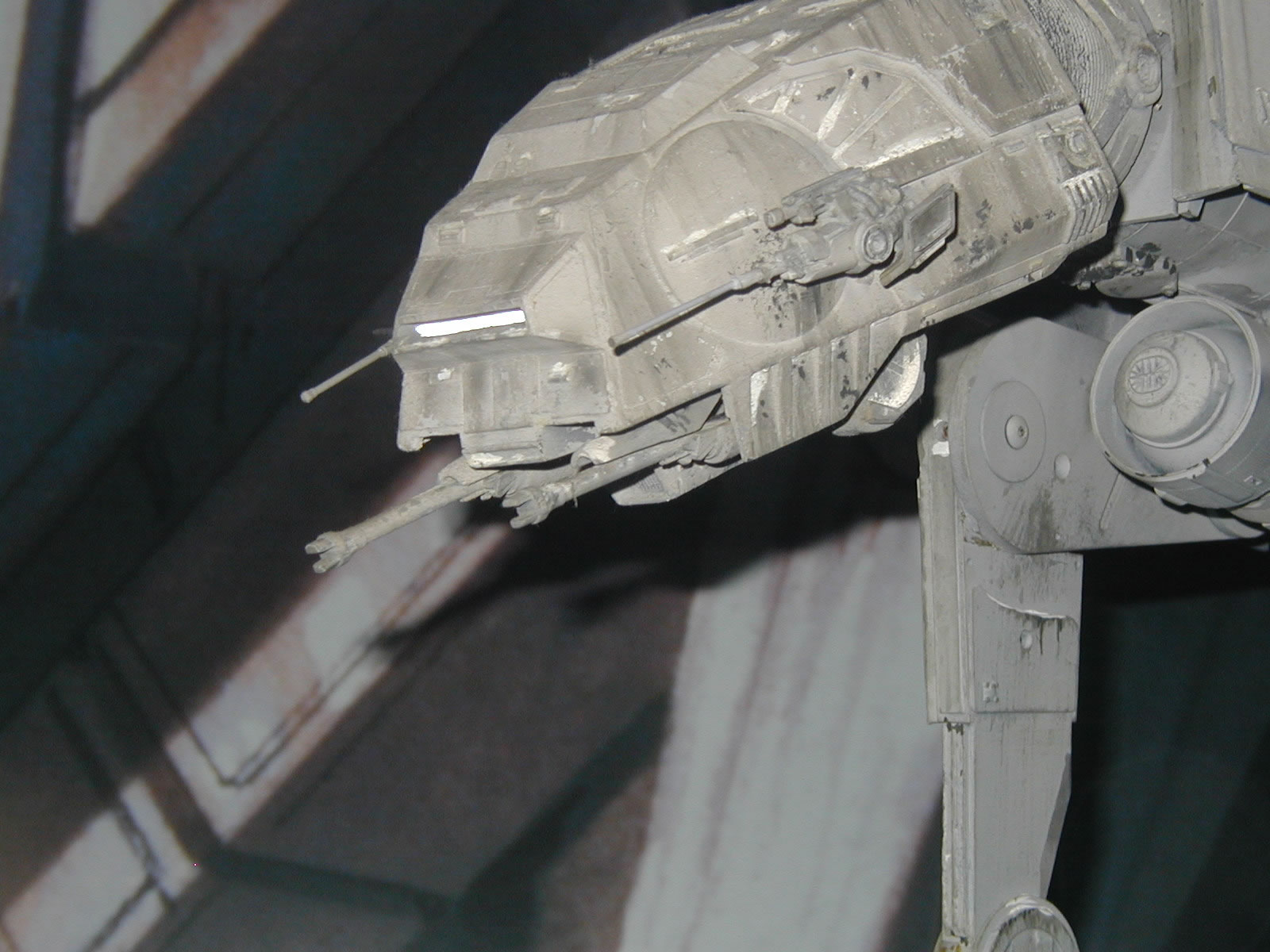

that last pic you were asking about I believe is the restored AT-AT that Duncanator had worked on?
I went and checked the photo he posted and it doesn't appear to be the same one unfortunately.

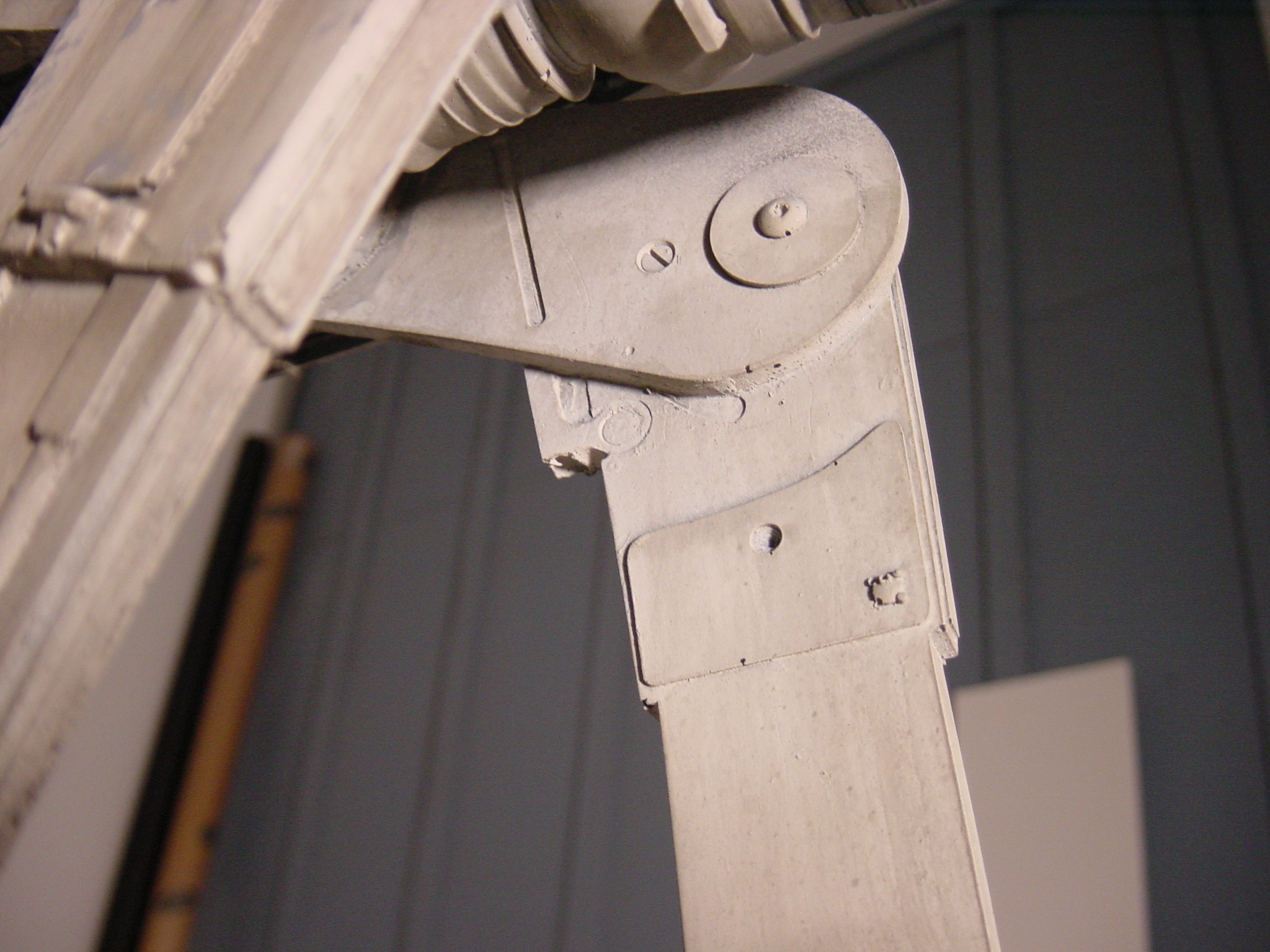

Hopefully a nail in the coffin here... there's a key slot on the leg. Definitely seems to be a locking tab.
It cant be fixed to the leg and travel in the slot as the leg moves in an arc like the slot in the cam. It had to be intended to slide out of the way then slide back down.

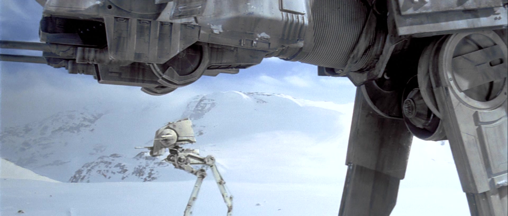

On those photos Hagoth shared of luke about to grenade the walker, you can clearly see that locking tab slid out of the way.

Ok changing my mind, looking at the resin cast... and some detail is lost in the moulding. However the inner detail of that locking tabs key show's it to be circular.
That would allow the key to rotate while the leg moves and if that tab had one circular key into the hip slot would allow the tab to move with the leg and move up the hip slot when the knee moves up like seen in Hagoths picture.
It would also be easy enough for that key to break and that part to fall off.
Edit:
I've got it, its a leg travel limiter. It locks the leg from being able to travel too far forward or back!
