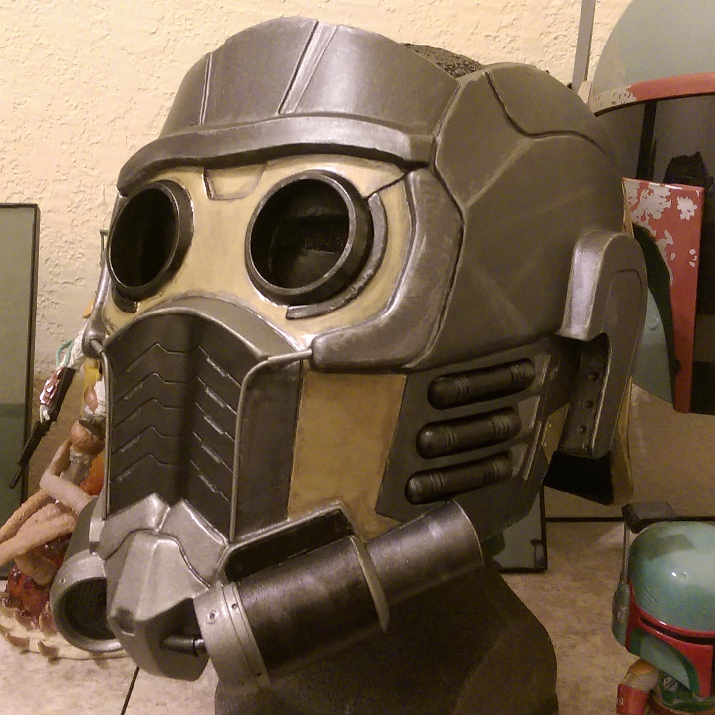

Just in case any of you choose to use spray paints, Rustoleum Universal metallic paint is amazing. Here's my weathered helmet, still needs a matte clear coat , padding, lights, and lenses.
Also, I filled in the lines on my Davy kit and cut a more movie-accurate design. Anyone else do this? Mine's a little rough but I like it much better.
For the darker portions(grill, large tubes, eyes, and cheek cylinders) I used "oil rubbed bronze"
The silver is "Flat antique nickel"
The main base coat is " Flat soft iron"
And finally "Pure gold"
I'm using spray paints as well, but I'm having a hard time with the smaller, detailed pieces. Did you just use tape to prevent overflow? Also, did you add the weathered details with a brush?
In painting RC car bodies there is a spray mask that can be employed. It may also come in a bottle with a brush. Just cover the part you want to keep paint free and cut away the rest with a sharp razor blade.
You did the same thing I did to my Davy bucket! What is the best model paint to use that doesn't leave brush strokes?
Yeah, so far I'm dissatisfied with my results though. I'm building out the back with JB weld plastic putty to match the seams for where I split the helmet. I'm hoping that I can salvage it with some serious work. :/ I have a backup plan though.
As for brush strokes... I wouldn't use anything but spray and rub'n buff. I'd only use a brush to obtain a brushed look.
Yes, I used regular old scotch blue painter's tape.....a whole lot of it lol. And yes, weathering was done with cheap-o Wal-Mart metallic acrylic paint and a brush.
There are some very fine areas that need to be silver and gray such as on the sides. That would require the paint brush. Also some of the screws and rivets require some dabs of silver or gray.
