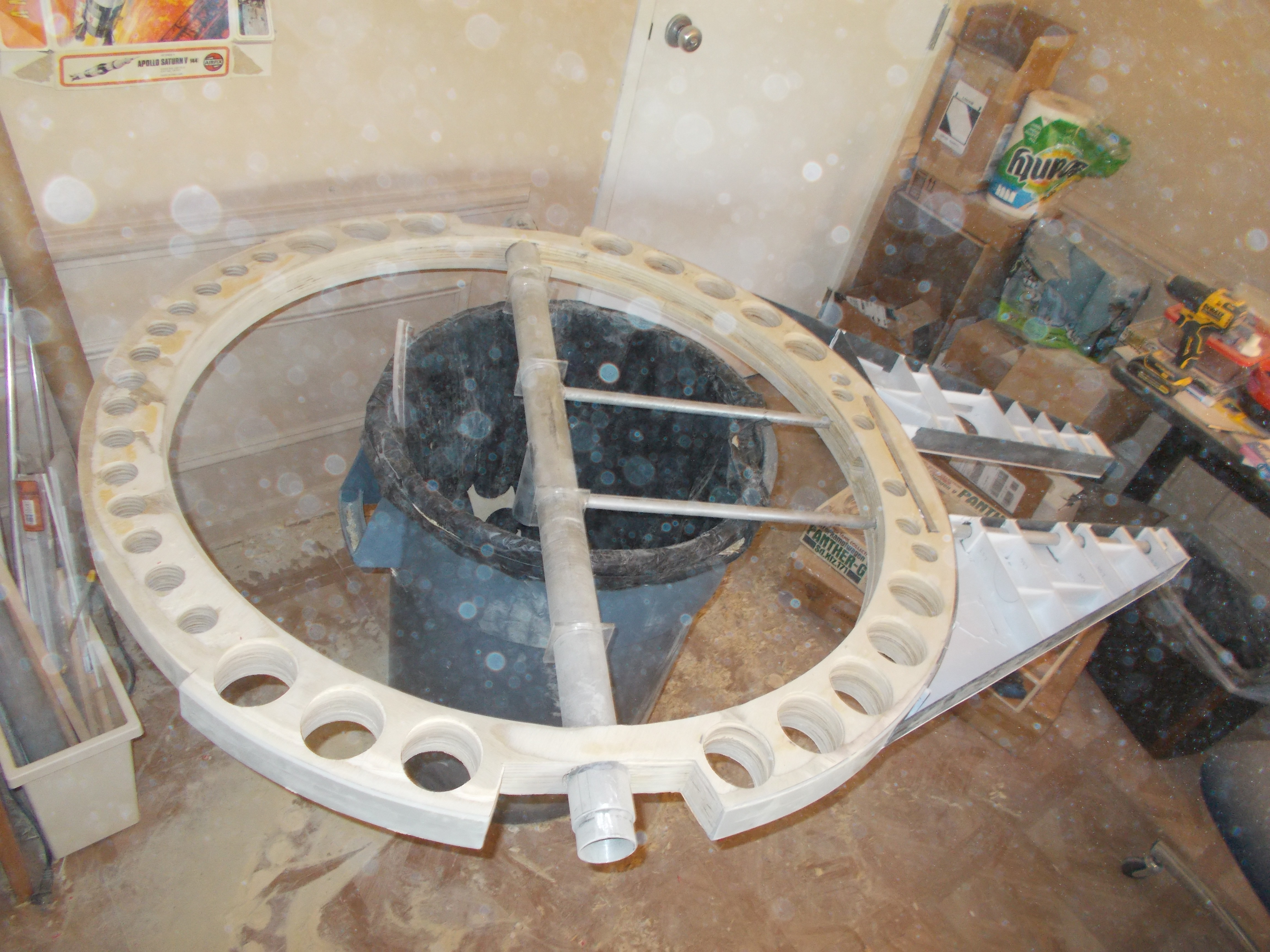

Today's regress:
Had to lighten the weight further by adding more "lightening" holes throughout the armature. Impressionist photograph a function of the amount of sawdust flying around the room.

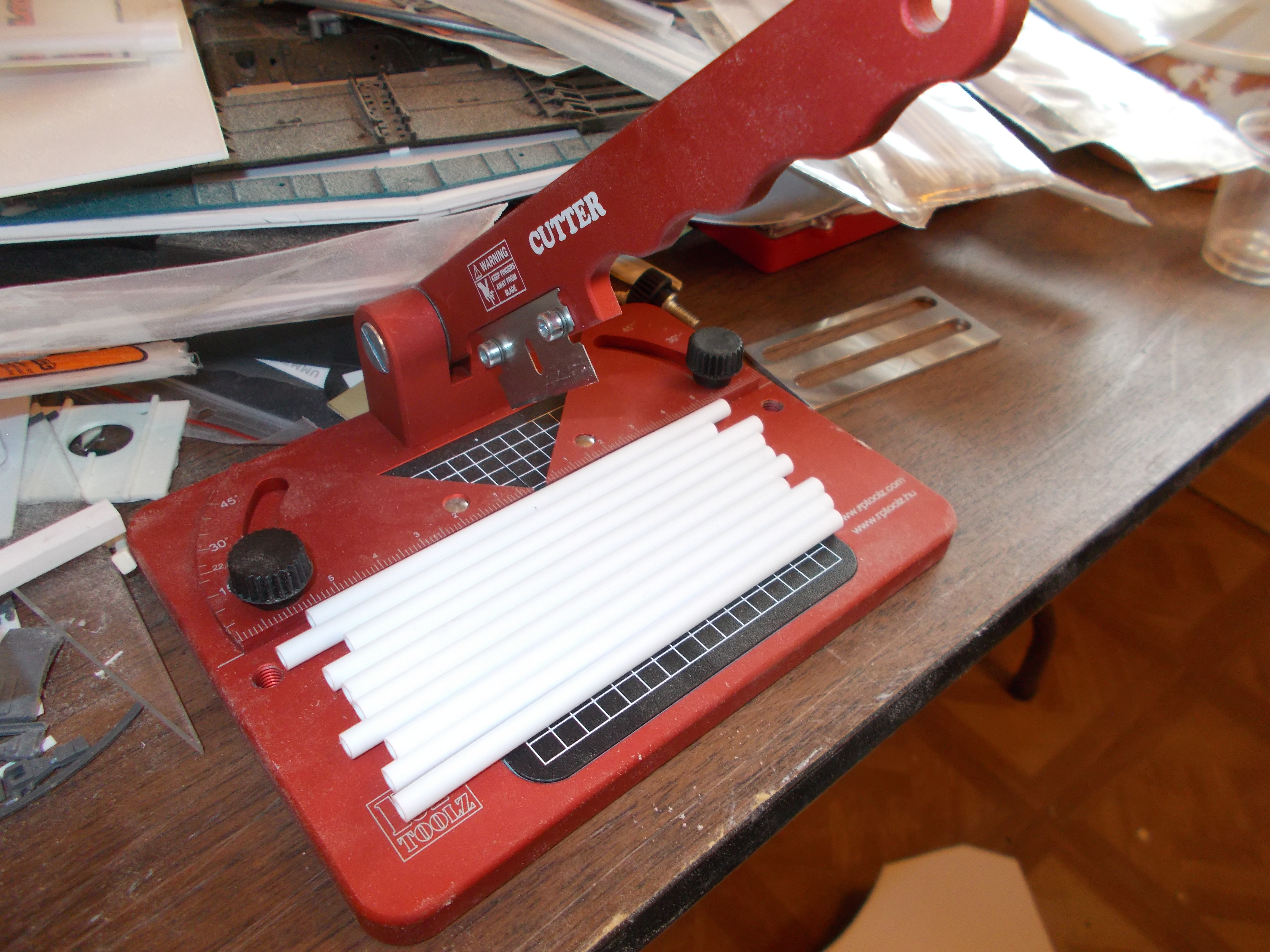

Two tools I couldn't do without, and that I highly recommend -- esp. because they are not commonly found in hobby shops:

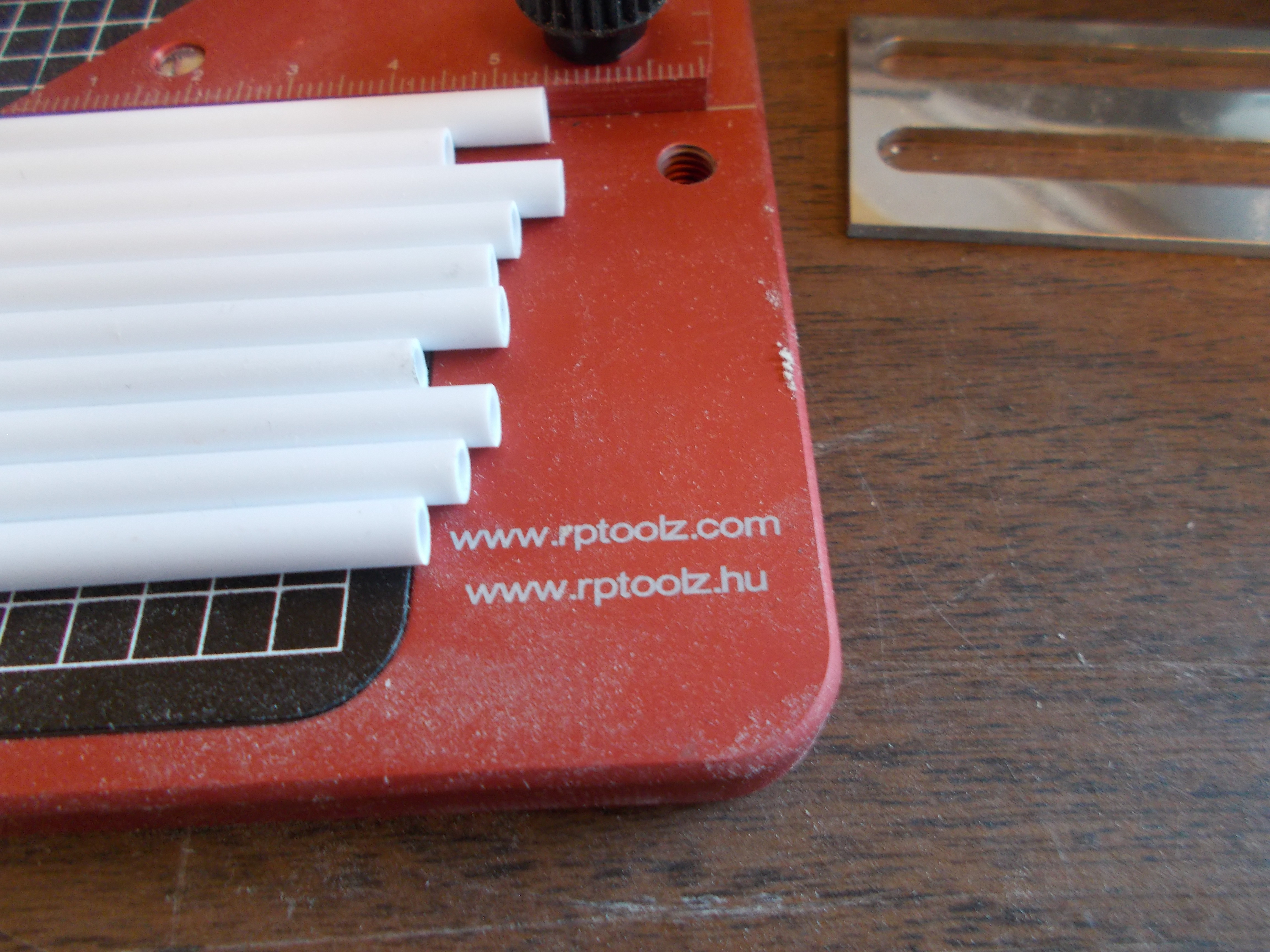

1.) The RP Toolz Cutter
Precisely duplicate any cut, at any angle, all day long, with absolute razor-blade 90-degree precision. Especially useful for cutting slowly/carefully through tubing stock without kinking/bending/bowing the tube. Available at the website pictured on the tool:

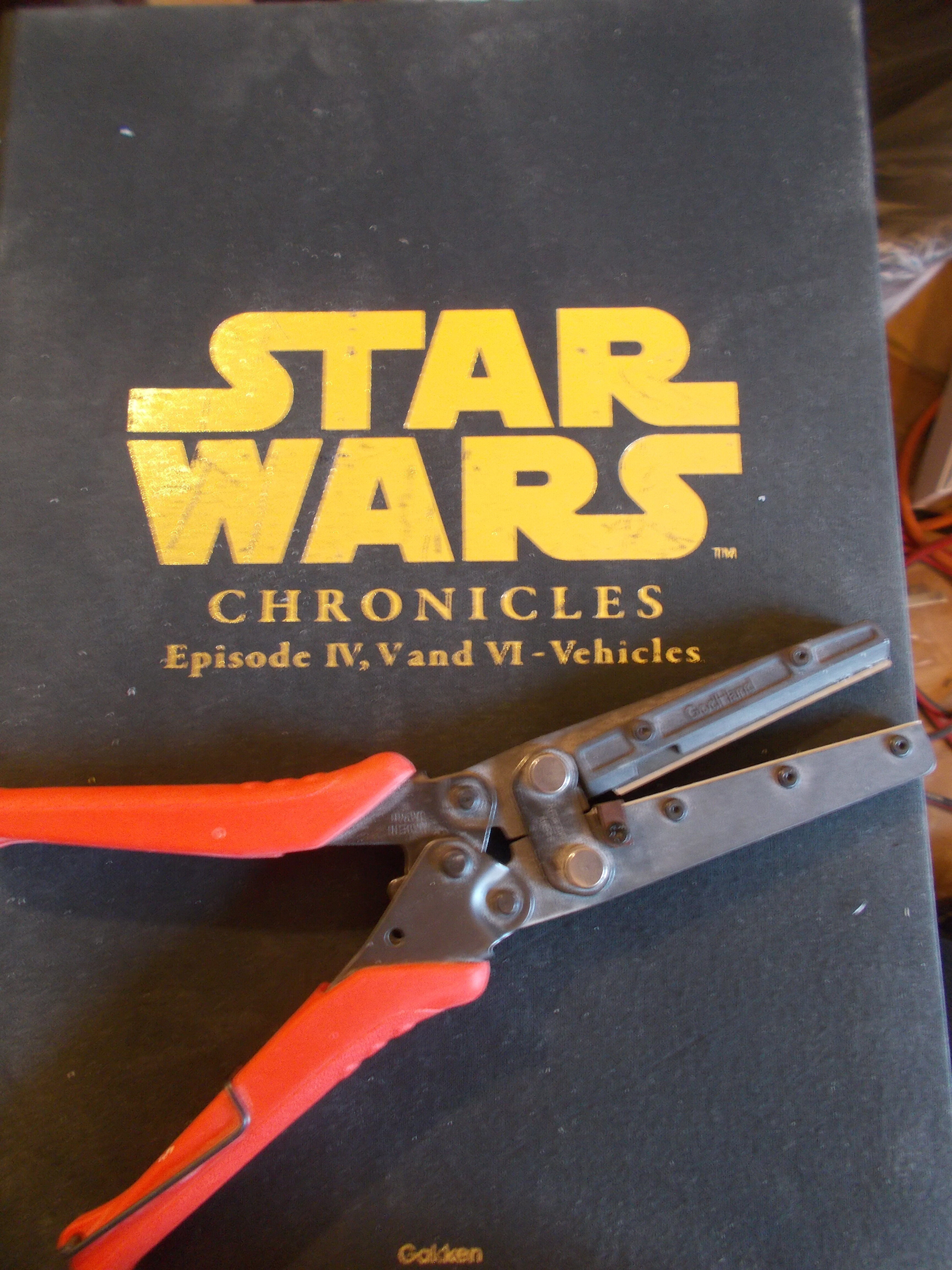

2.) The "GodHand" Long Plastic Cutter, which uses an OLFA 78mm long blade as its business end. You cannot believe what a "godsend" and time saver this tool is for cutting those long styrene strip stock pieces for the Durasteel plating on the Falcon -- couldn't think of doing without it. It's PRICEY, but completely worth it.
This shows up in some hobby shops from time to time, but is also pretty regularly available on Ebay. I don't think the maker of this meant to be sacrilegious or blasphemous when naming the tool, I think they just have a Japanese cultural interpretation of what it means for one of the "gods" to lend you a "hand"
These tools totally worth it, and will save you countless hours/headaches and frustration of asking "Why does nobody make a tool that... is specifically designed for my making a 5-foot Falcon replica?"

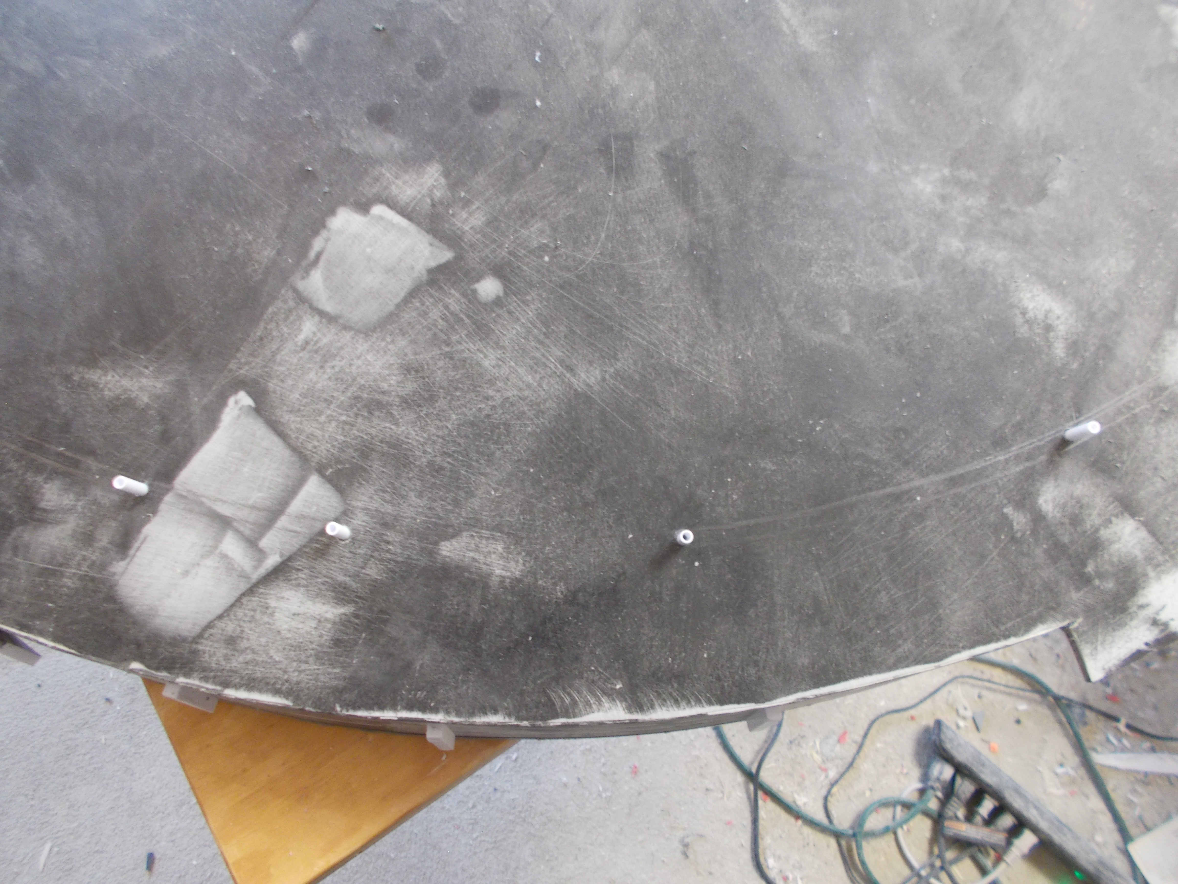

I'm adding ESB lower dome lights to my ANH Falcon, because that's the kind of Rebel I am...

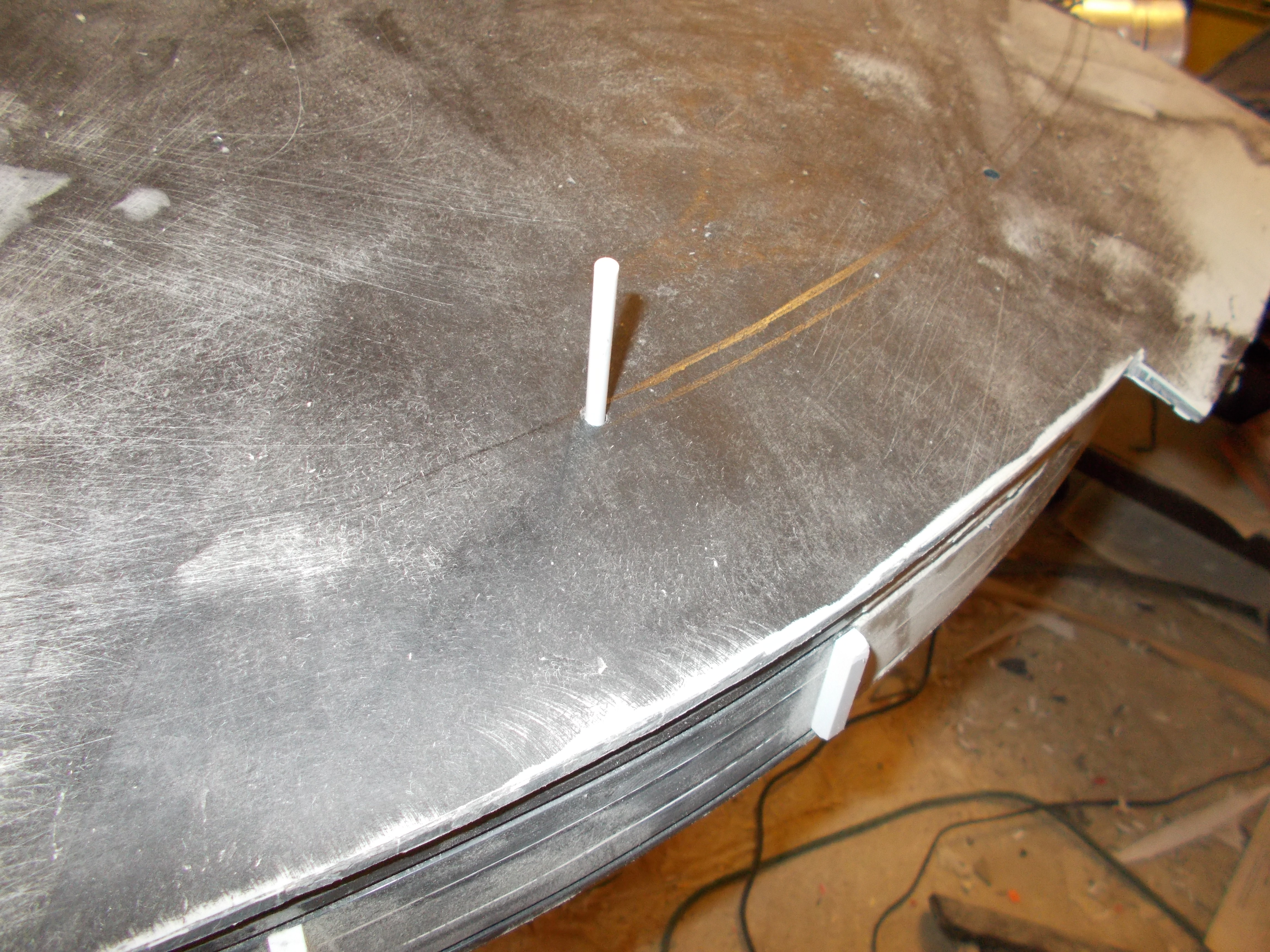

So you drill 3/16th pilot holes in your armature, insert 3/16 tube stock from Plastruct (cut perfectly on you RP Toolz Cutter), and you're in business to pre-wire and pre-run your electronics even before you glue your lower dome to the armature...
If you look closely, you'll count all 10 of them: 8 in the bow and 2 in the stern.

Haha! And speaking of GodHand… I broke a pair of God hands today… NOT happy. Grrr!

Dude,
If you got that small Godhand nipper from a hobby shop or online retailer, I'd seriously consider asking for a refund -- they cost an arm and a leg compared to other nippers, and there's no way that's not a manufacturer's defect.

Yeah. I was thinking the same thing, like a hairline in it or something. I wasn’t doing anything crazy with it. I’d have to look back and see where I bought it. Could have been a few places.
And was going to ask you, didn’t you pick the long blades up somewhere local for that long cutter? Thought maybe you said Home Depot maybe even had them. The Olfa 78mm blades? I haven’t bought new blades for mine yet, so not sure what Olfa’s part # is on those blades. Searching Amazon for 78mm Olfa just comes up with their snap-off blades. I need blades for my long cutter. Wish it came with at least one extra blade for as much as that one cost too! Haha!
