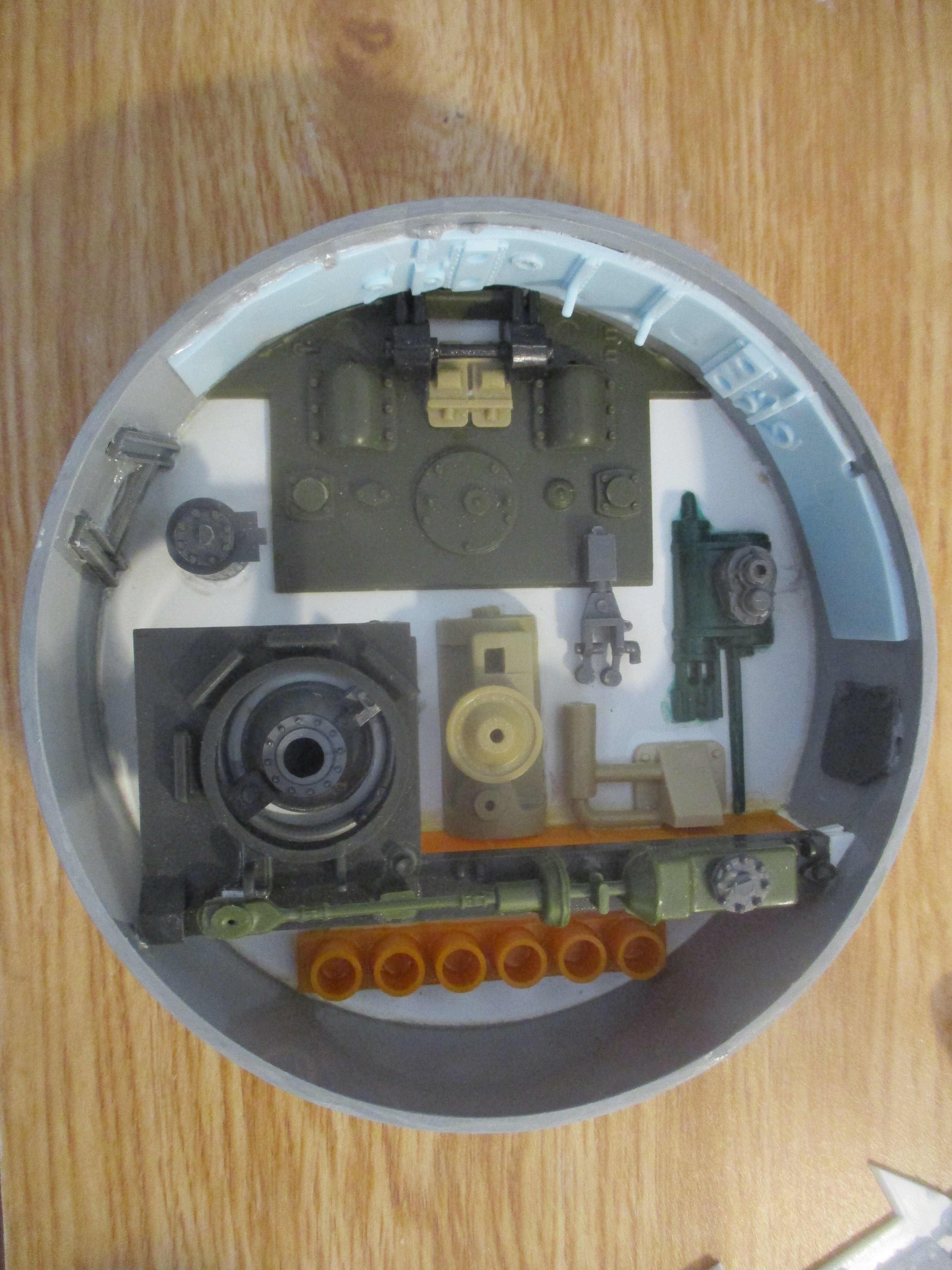

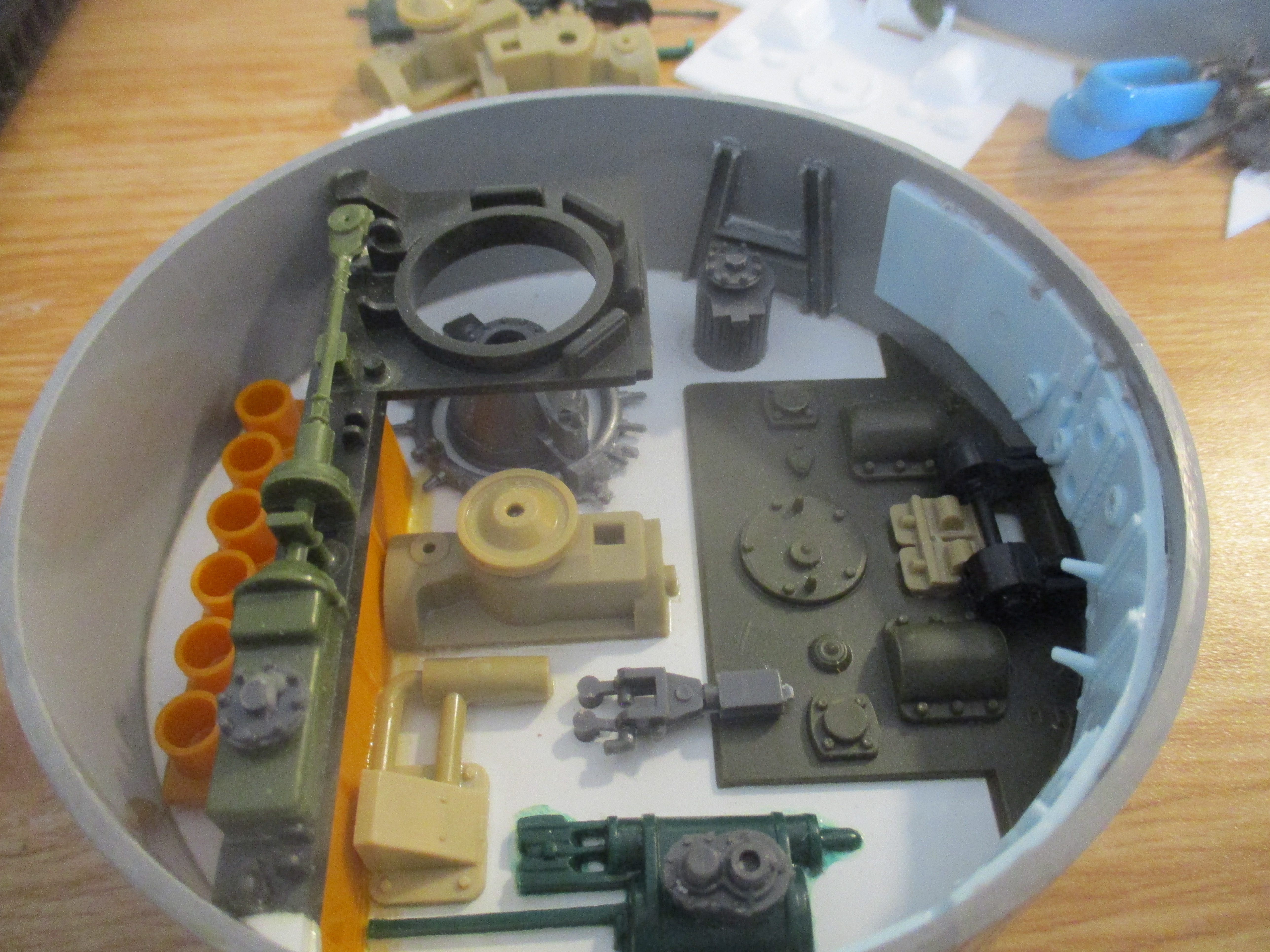

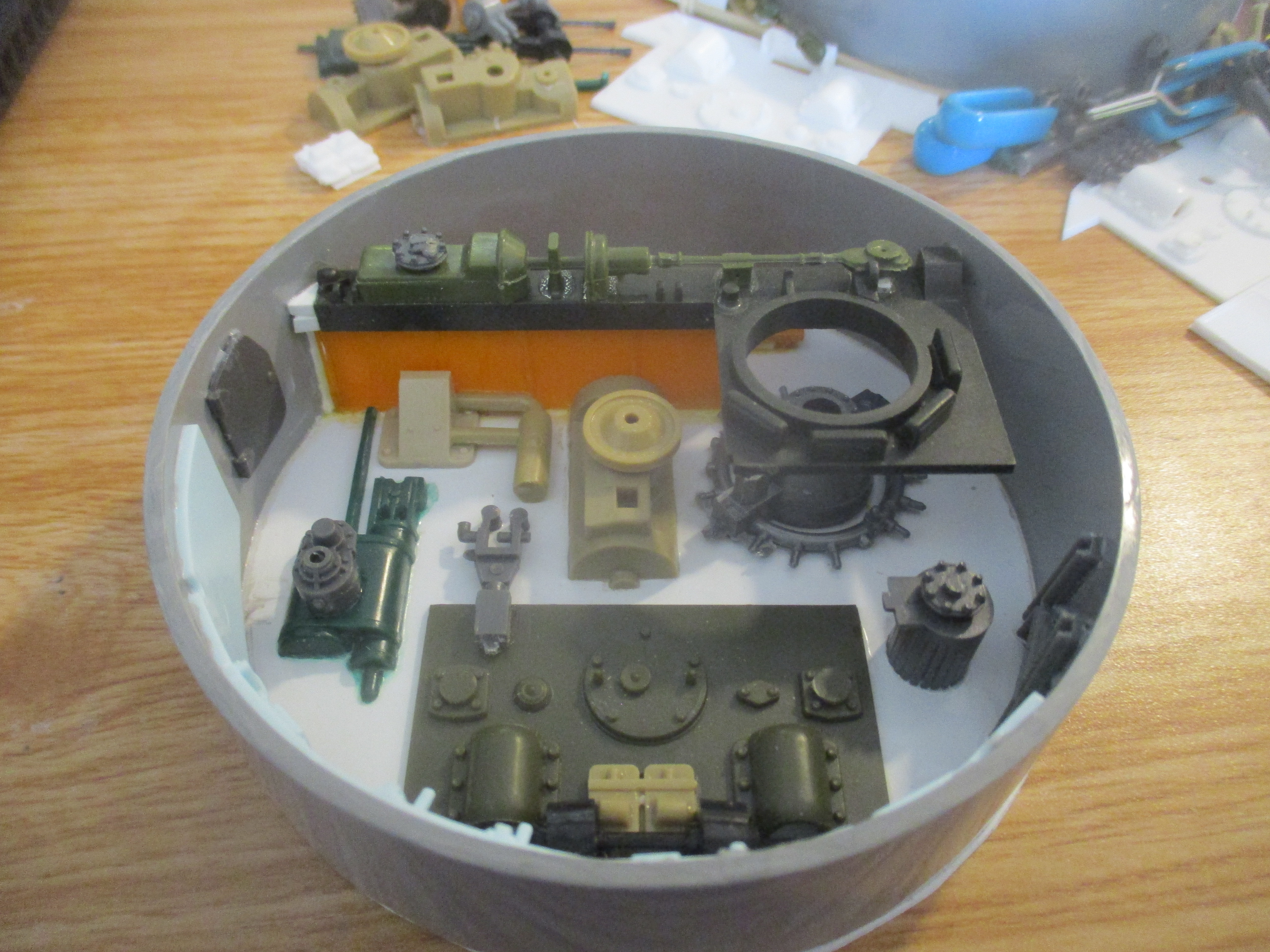

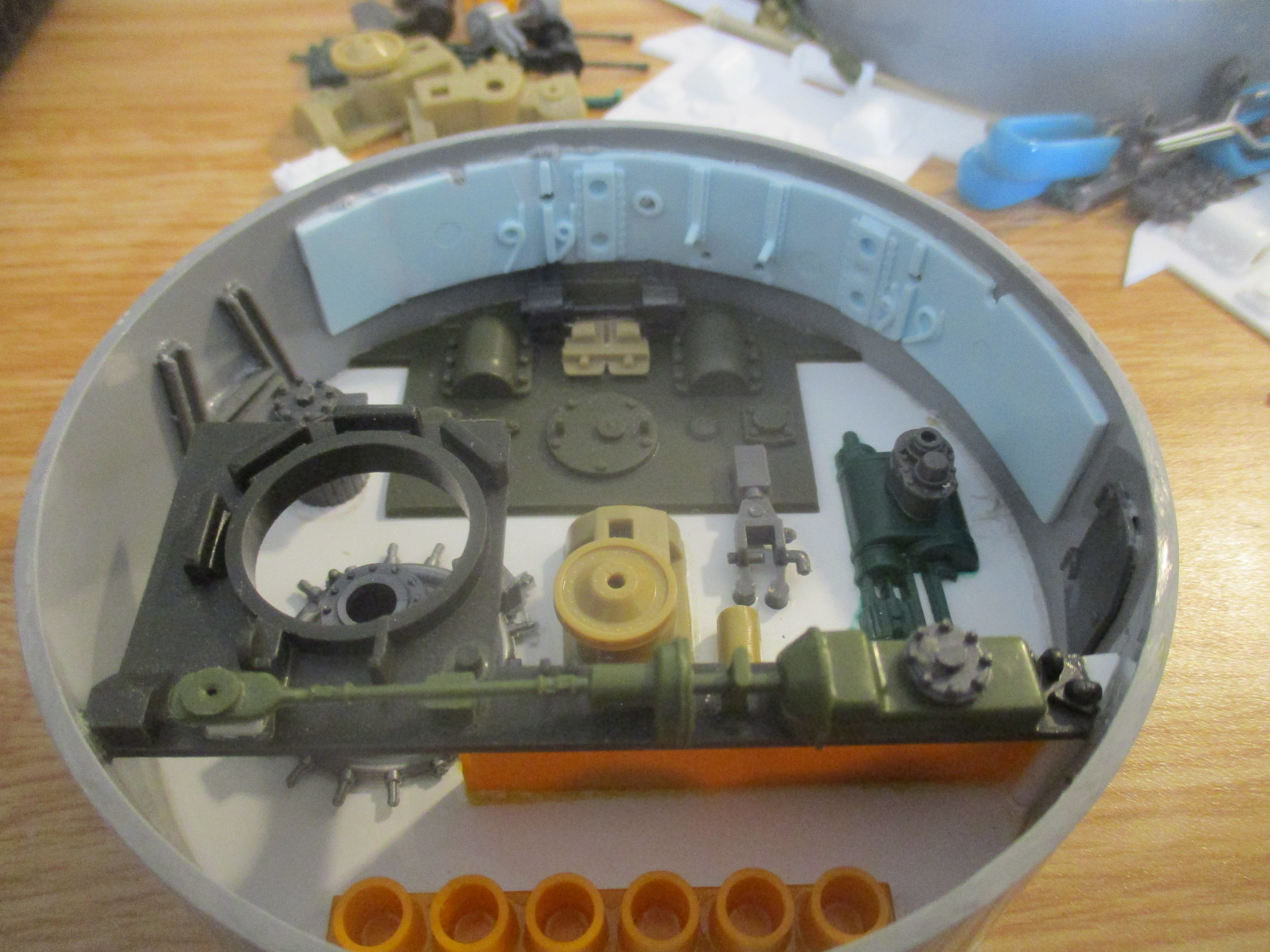

Repair work...
New hole located...
Rough cut...
Still have some underside shaving/trimming/sanding to do...
All better now...
Not quite perfect yet, but getting very very serviceable... Nothing is glued on here, just test fitting to see if things line up.
Getting there!
Excellent recovery!
