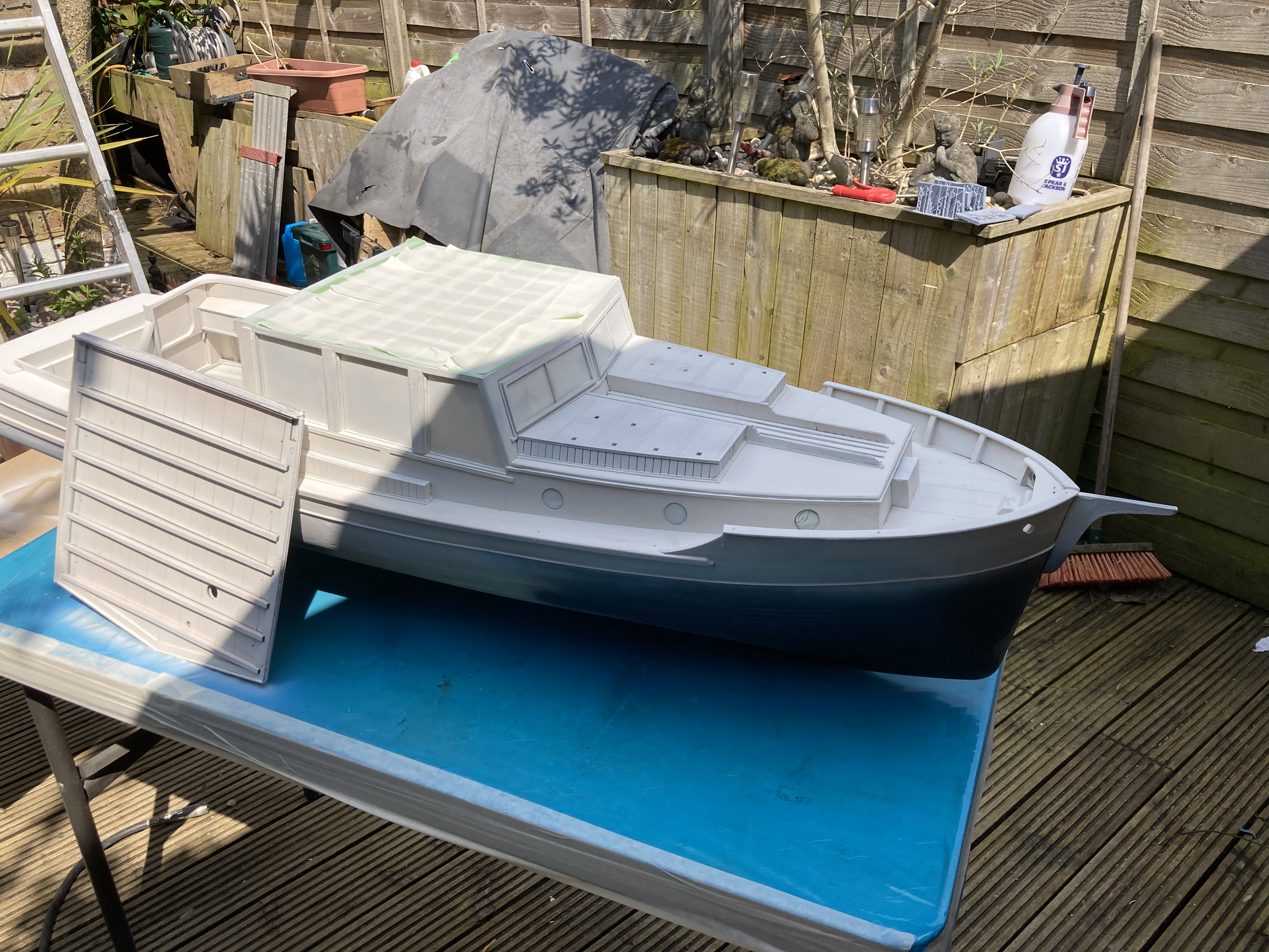

Shape are all locked in now it’s just down to all the fiddly little bits and tha mast.

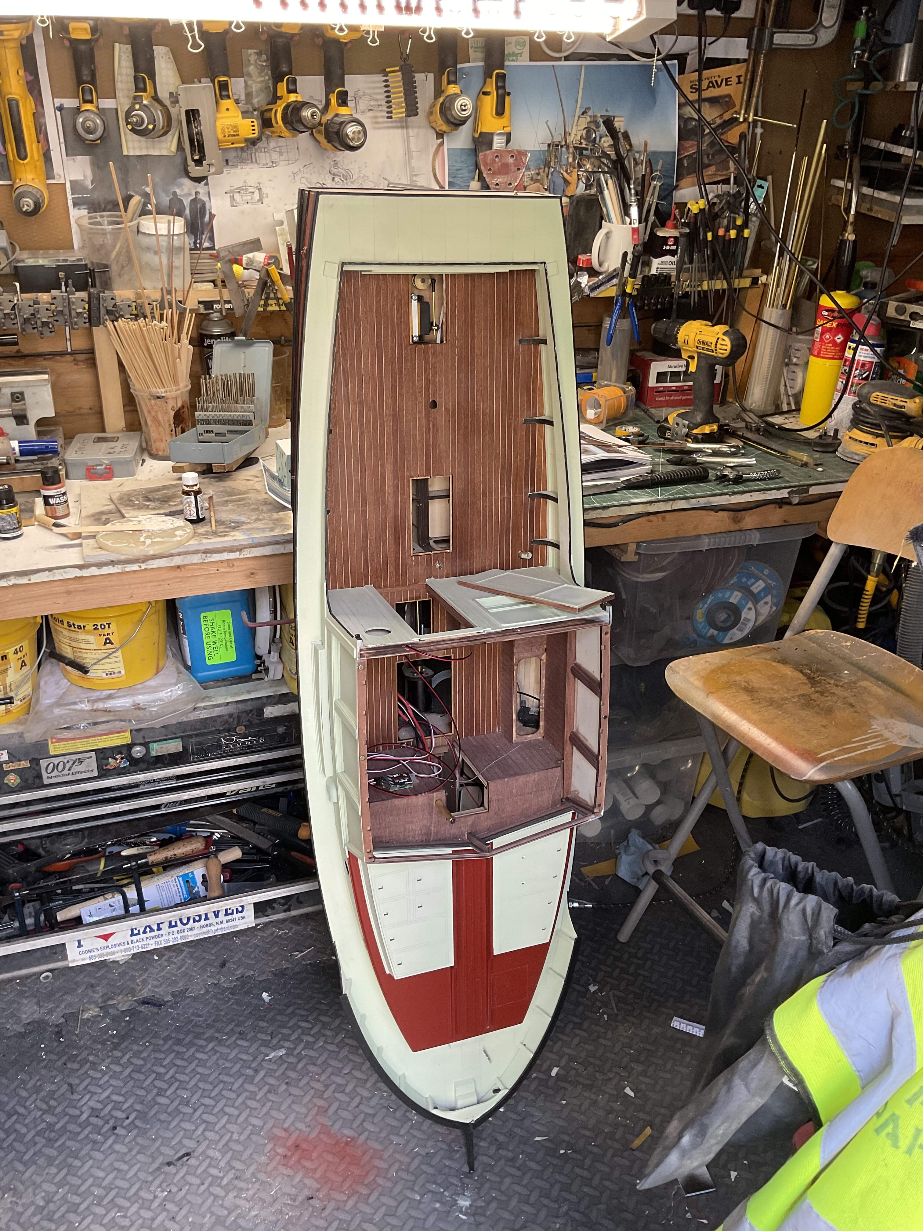

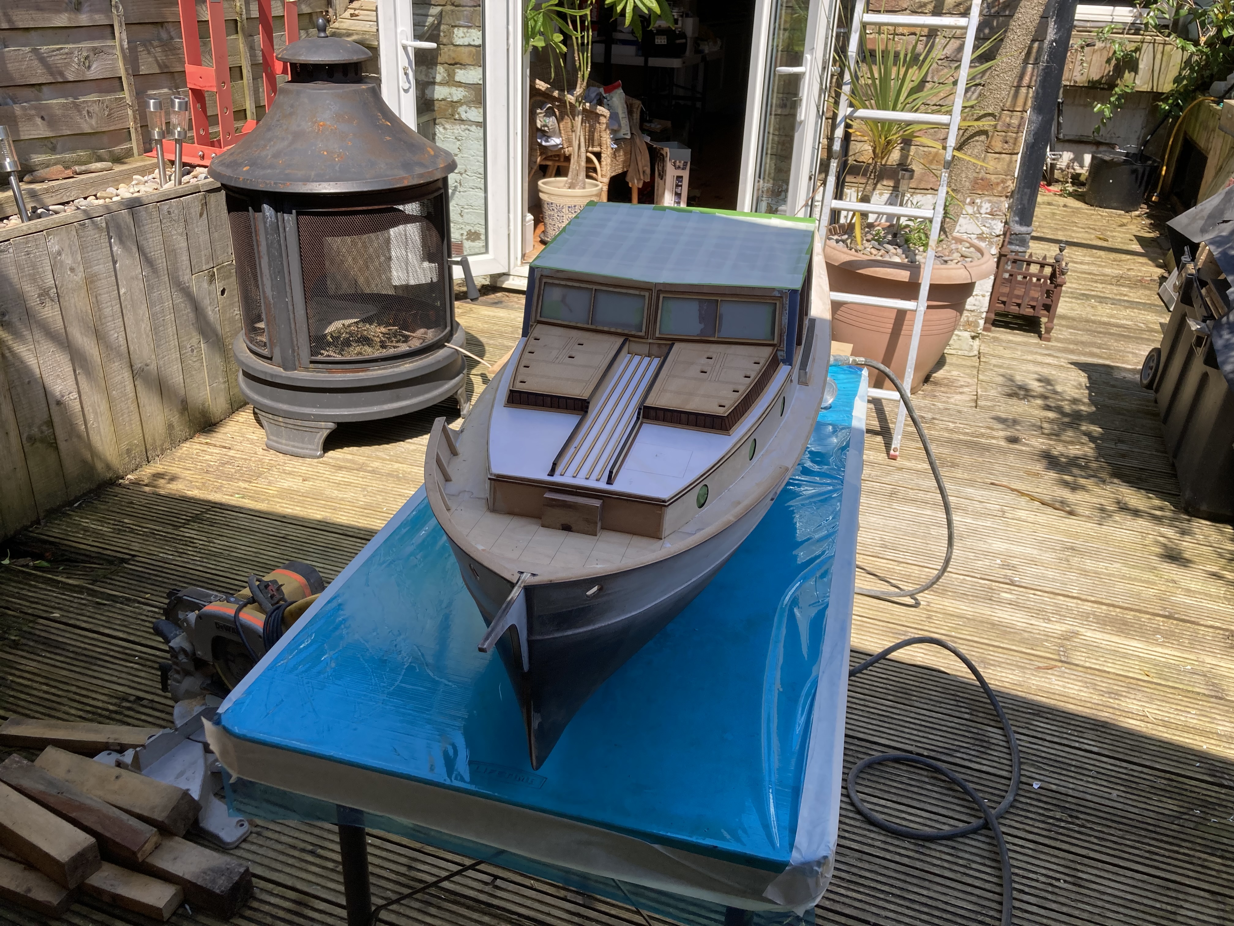

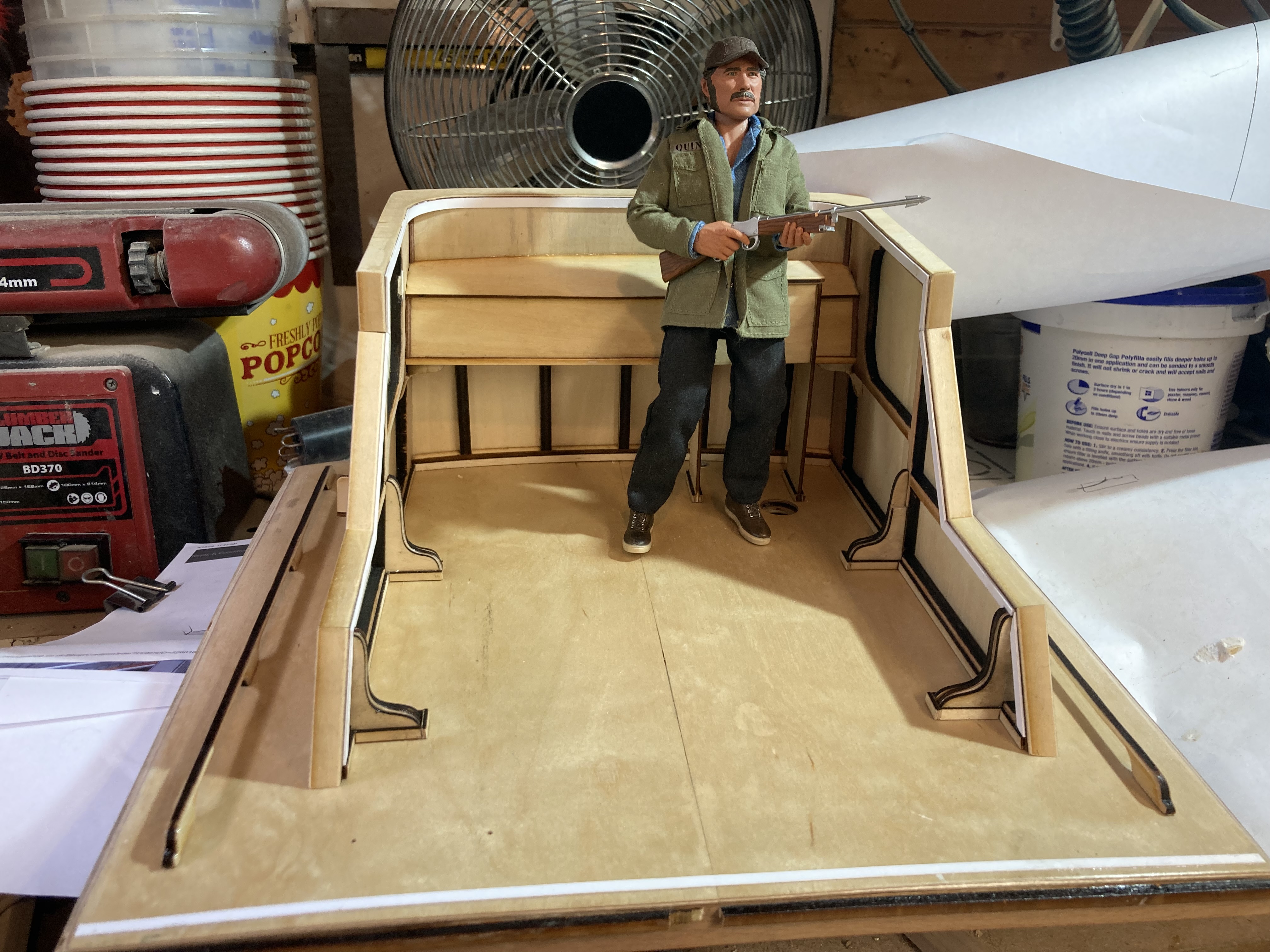

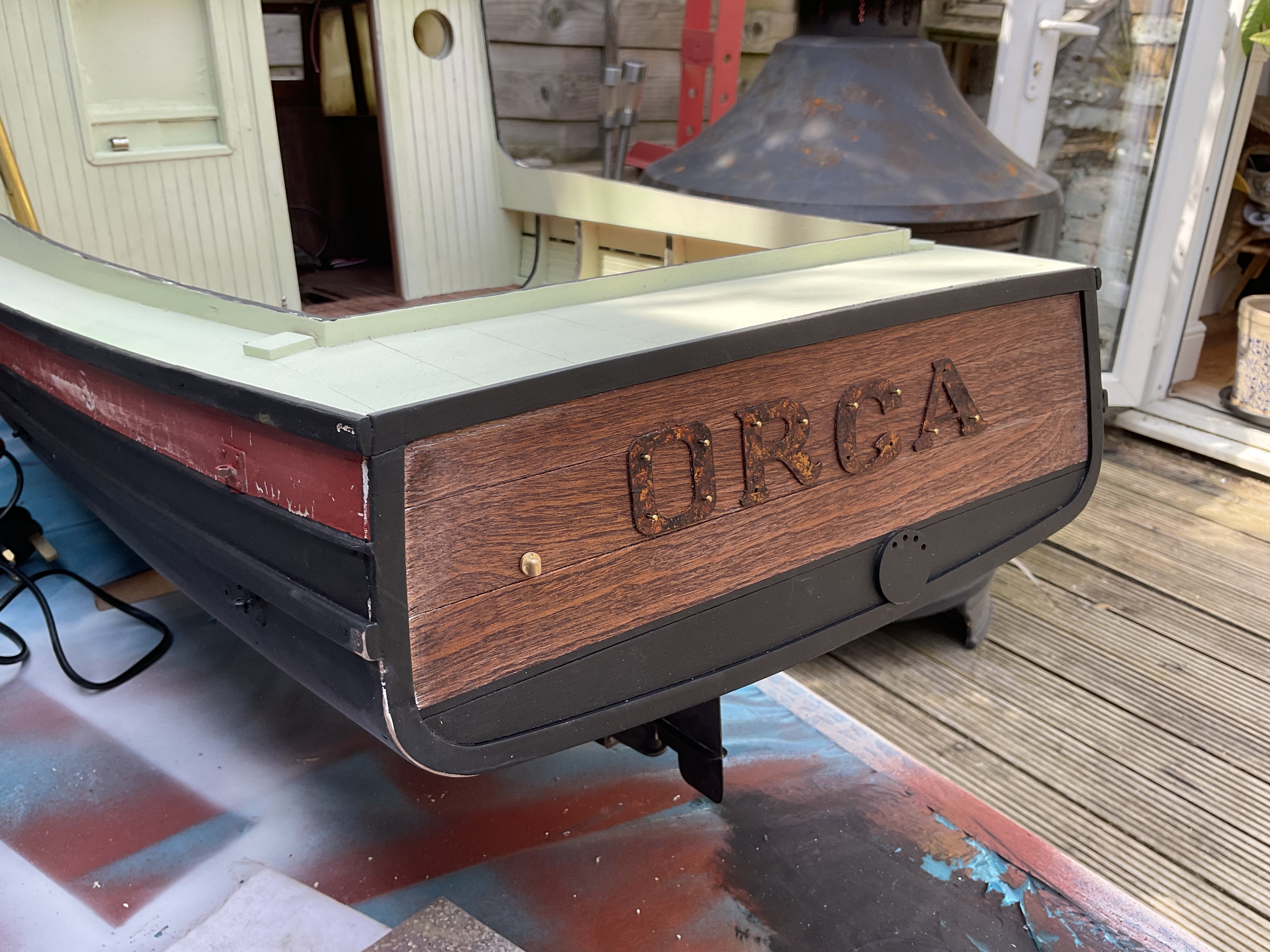

So here is where I come with cap in hand begging forgiveness form RayLuis, way back on version 1 he pointed out the my bridge was too narrow
I knew my cabin roof was a bit wide to accommodate having to make it removable and I defended my self buy saying it matched the reference I had. Well after all this time and redrawing I was so wrong, My Bridge was the right width but now knowing that it isn't centered brings a hole new spin to things We where both right.

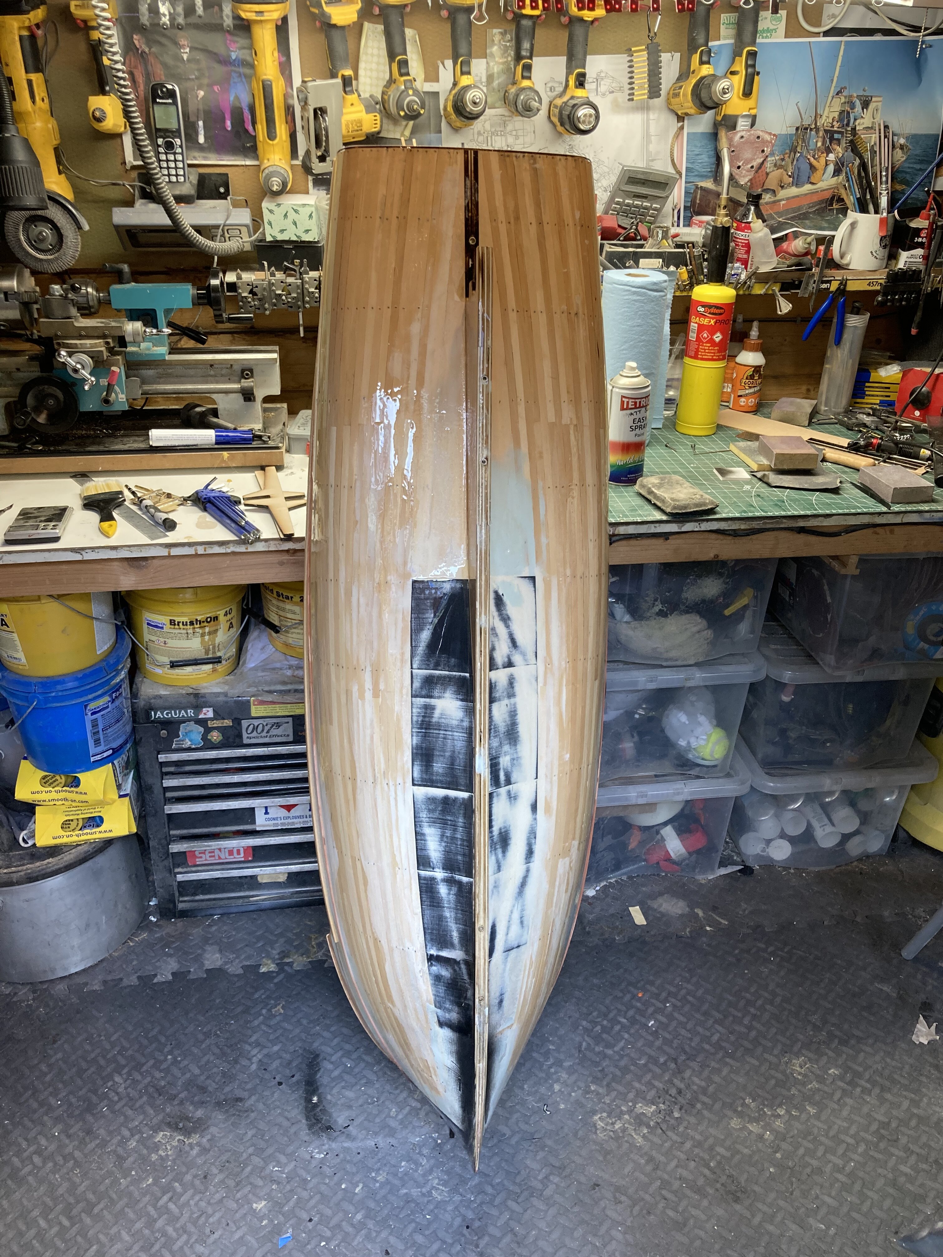

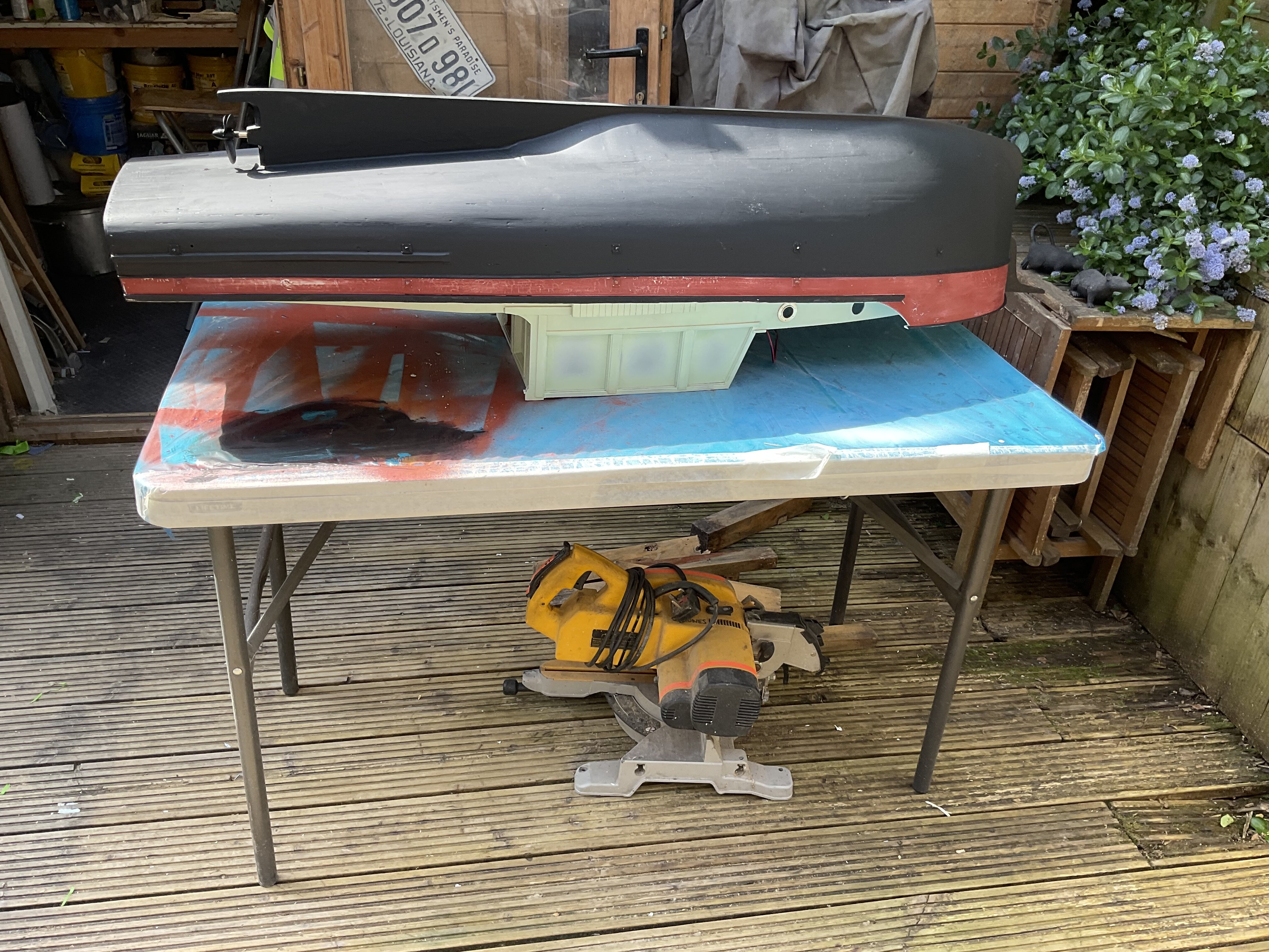

Epoxy has gone off sanding it back now, Here's where I find out if I've over done things. I need it to keep that rough planky look and not end up like a smooth surf board, which meant not being too neat with the planking, then not being too neat with the sanding an filling. Its so hard not to sand it all smooth its something in our brains, that tactile thing. but totally wrong for this old lady.

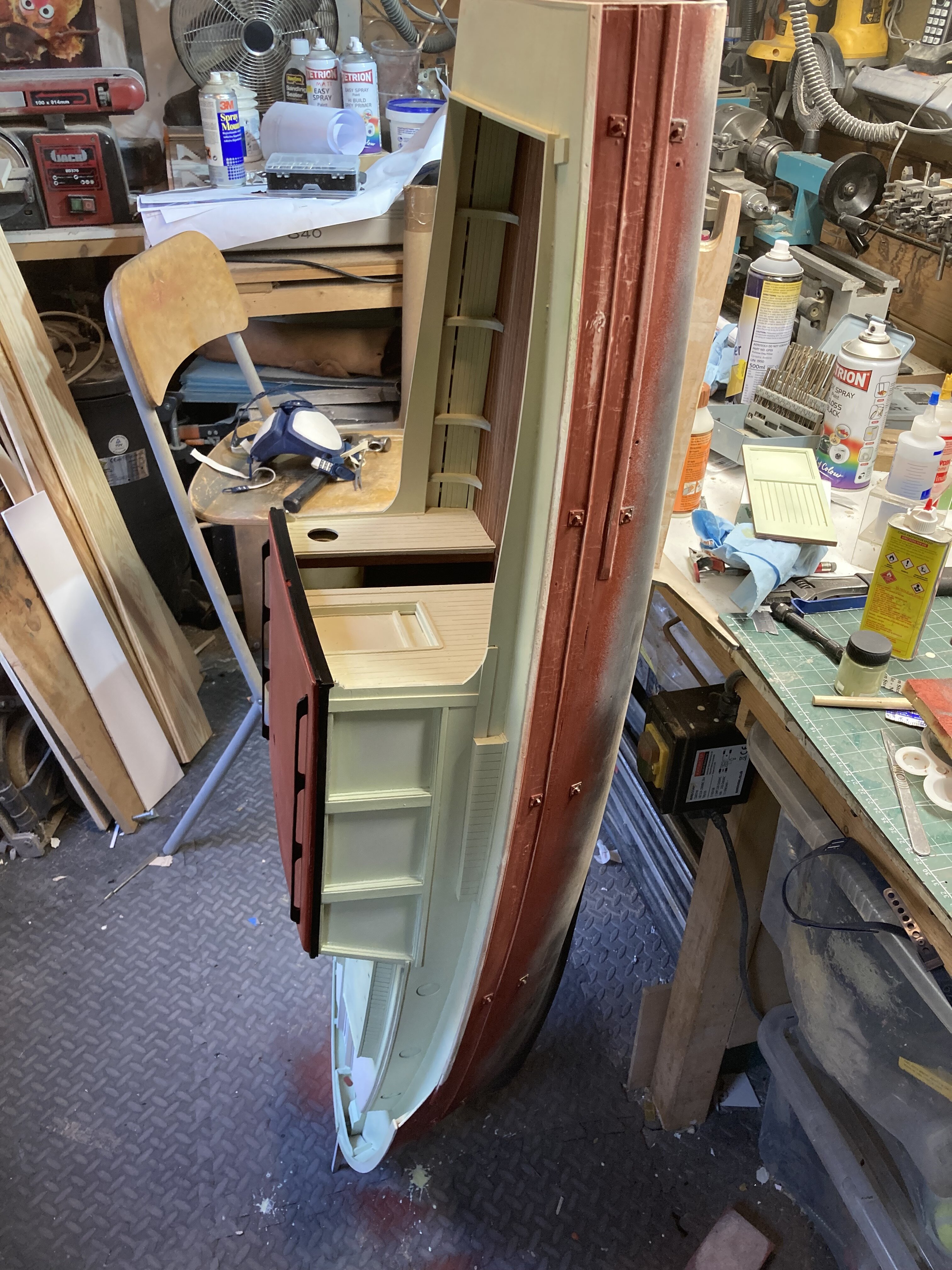

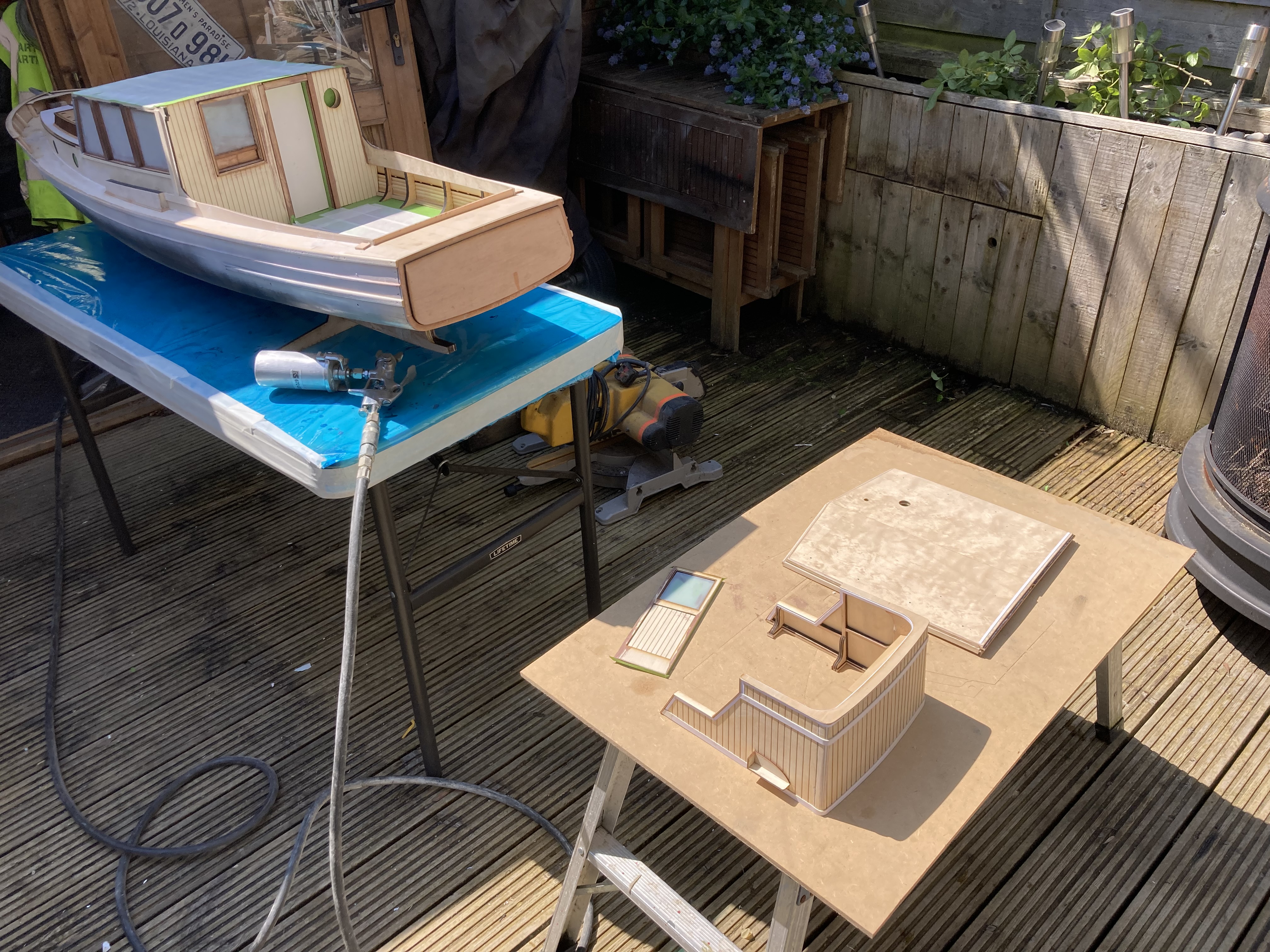

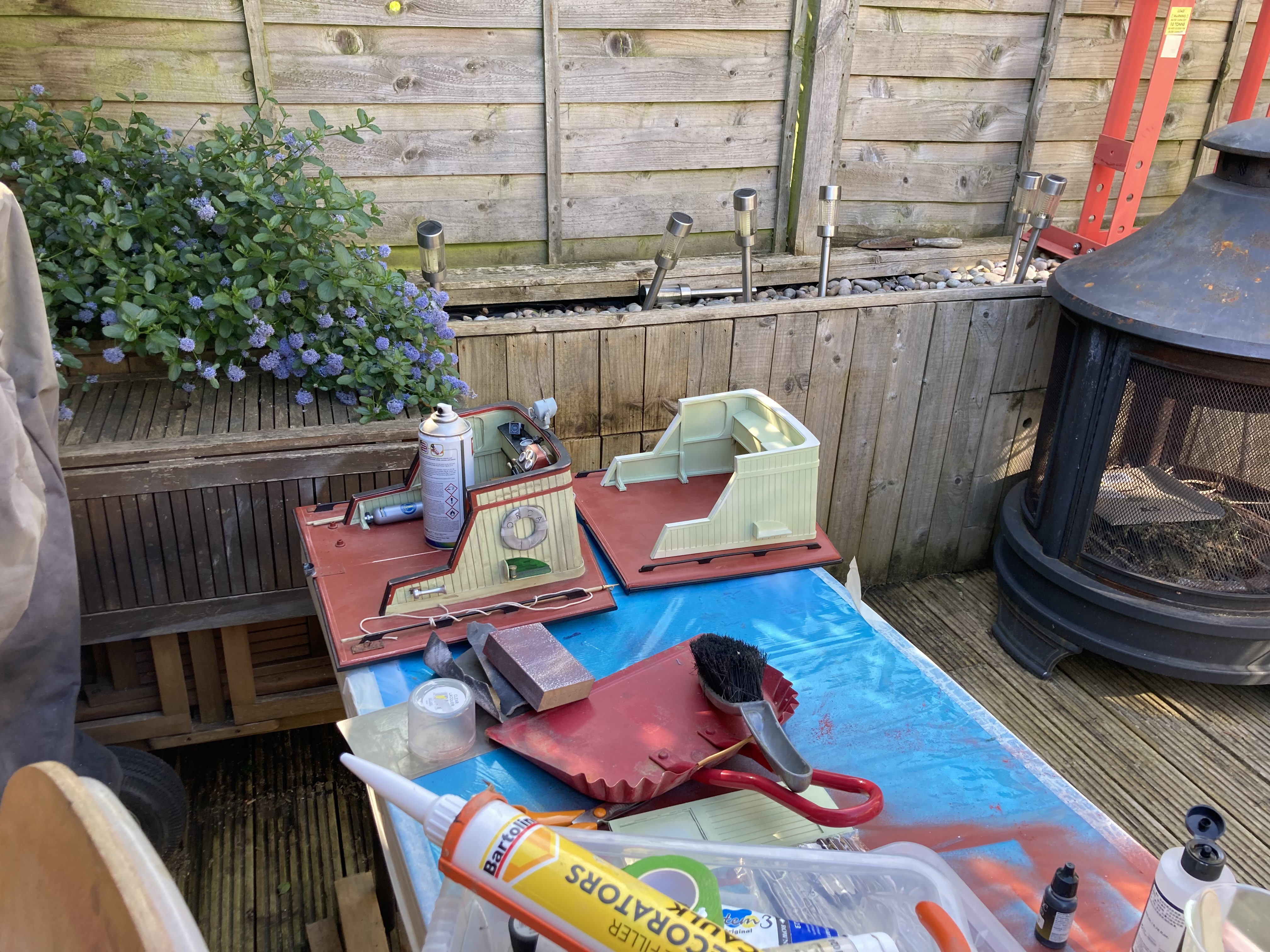

Pretty sure the colour I mixed for version 1 will have dried up by now, so a little filling some places I missed then get the air brush out. Bridge is just resting as this time it’s bolted on with the hand rails like it’s should be
Looking so cool already:cool::cool:(y)(y):love::love::notworthy::notworthy: Right you are: when do you stop being too neat for that kind of look? :unsure:

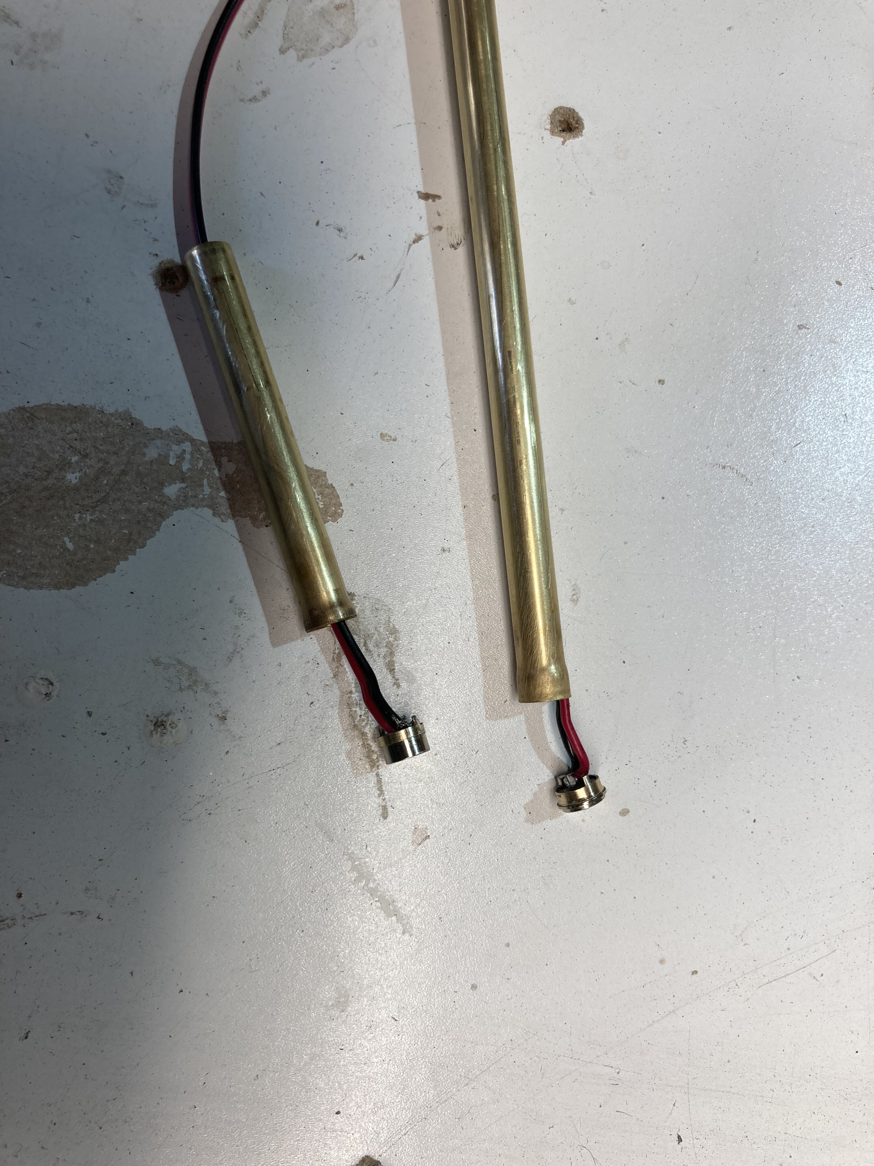

so I did manage to fine an 8mm 2 pole magnetic connector. I'll put the spot light on a little switch hidden on the bridge, It not really that much different to having it on a switch in the lower cabin? I think the mast worked fine as a 2.5mm stereo jack.
