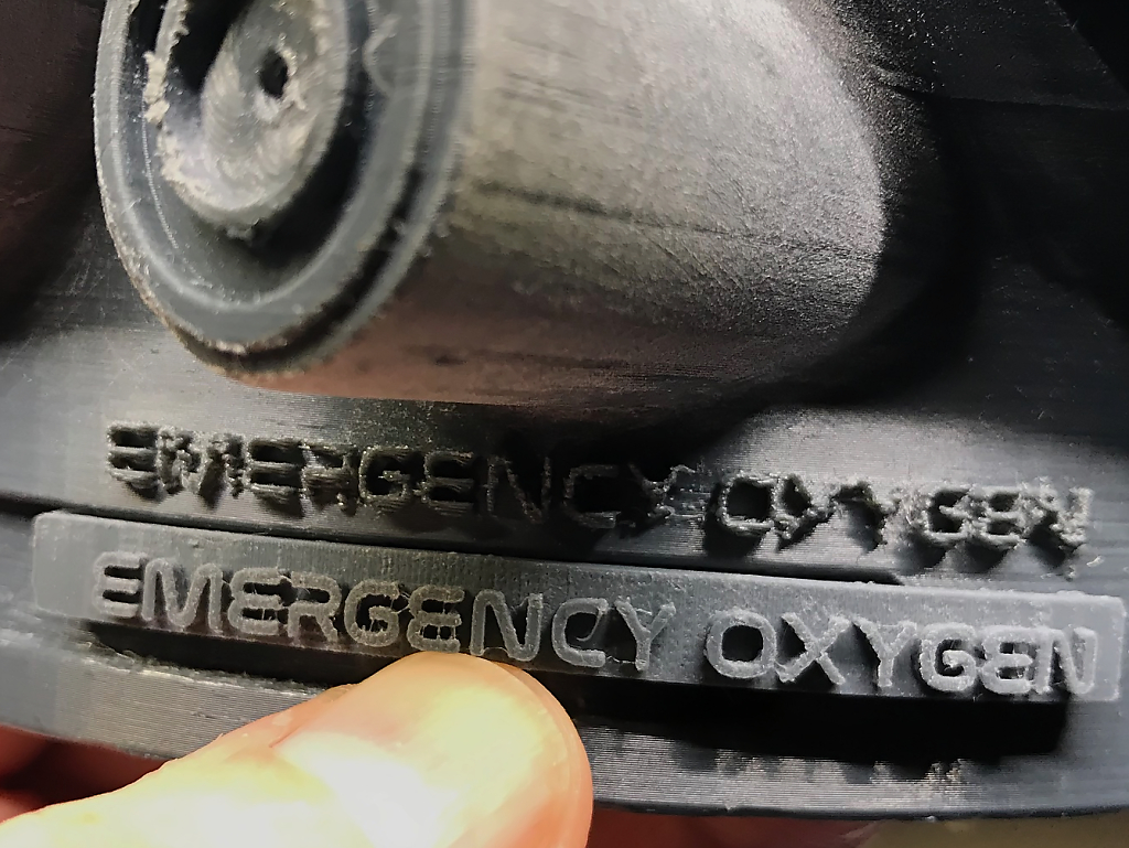

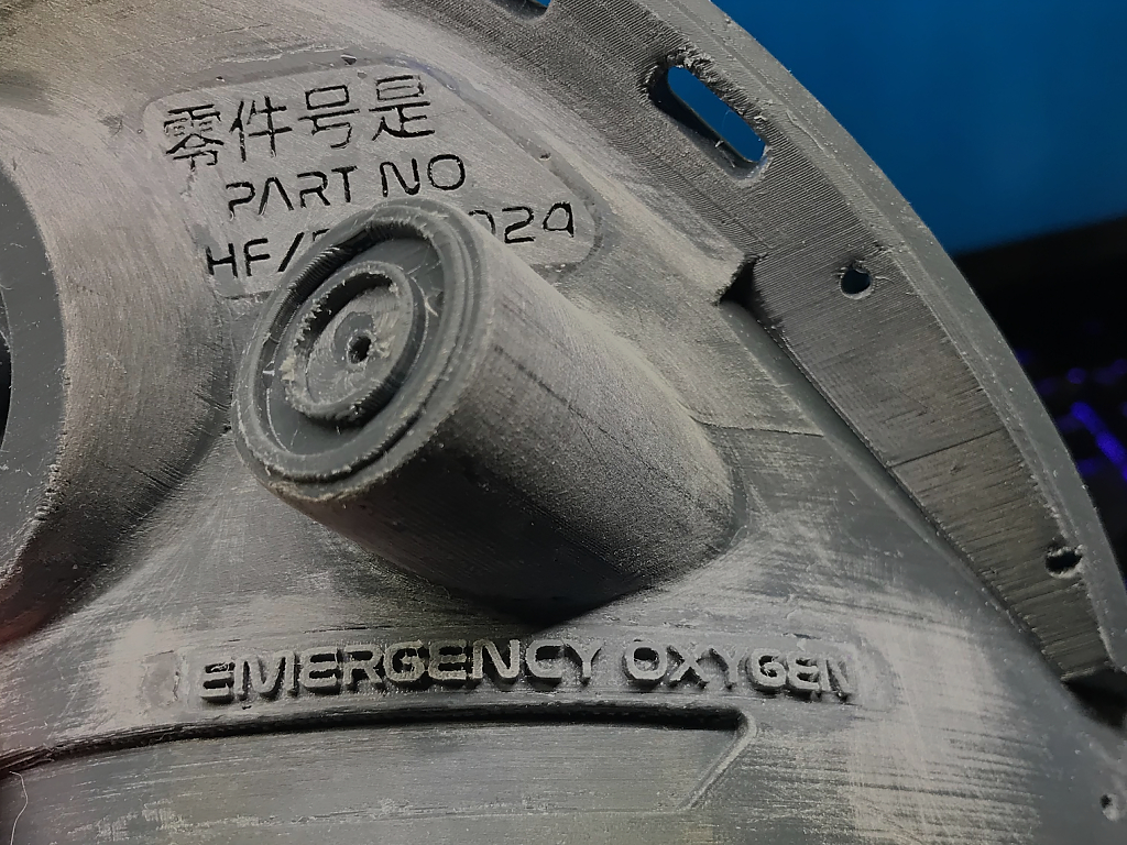

Exchanged the emergency text as well with parts printed with a 0.2mm nozzle at 0.05mm layer height.

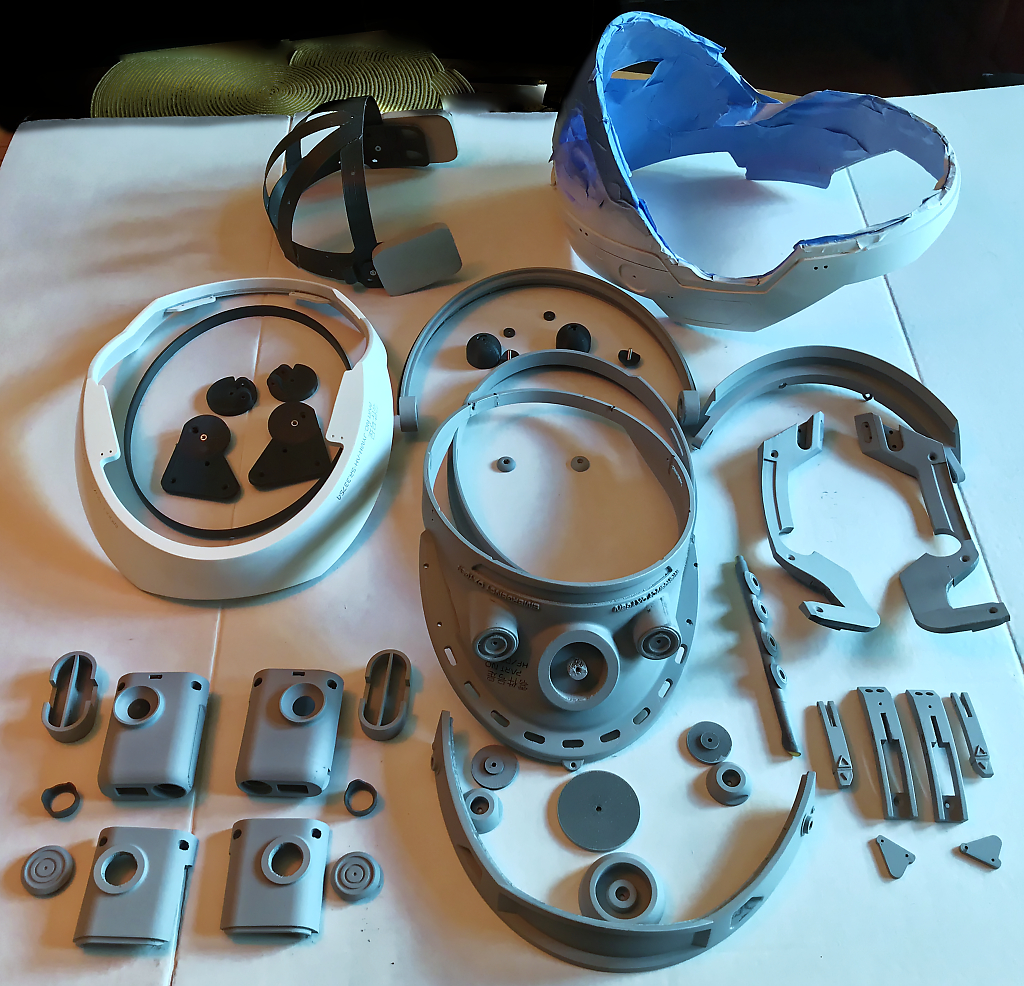

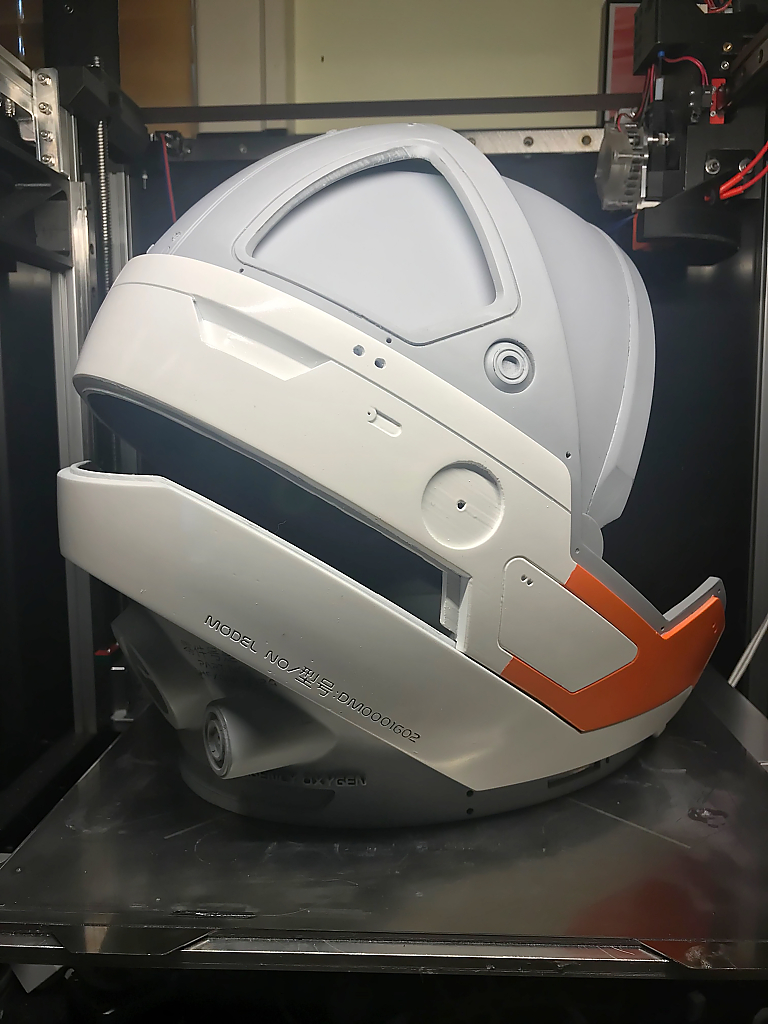

Finally, I have some time to finish the build. Ready for some paint after another wet sanding with 1000 grid.

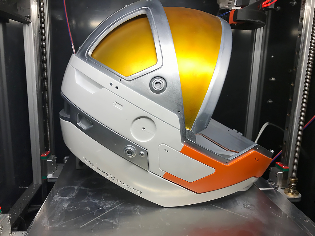

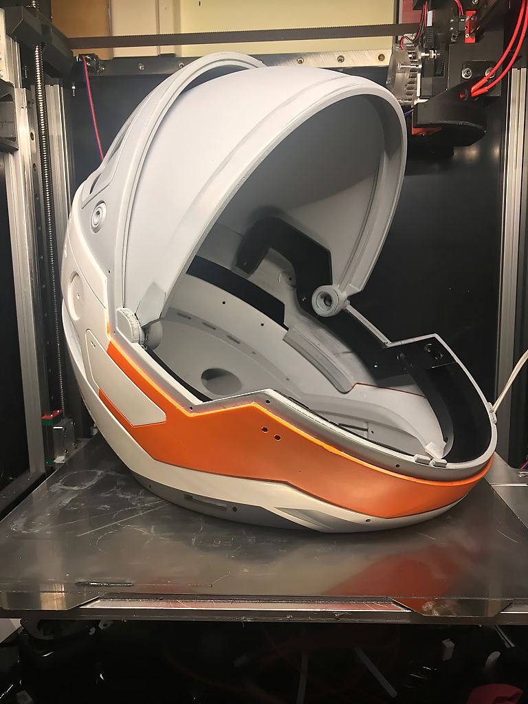

The fun part started with painting the helmet. Used Dupli-Color Filler primer, Gloss White DPE101, DAL 1608 Semi-Gloss Black and Montana pure orange 2080. May change though. Testing different metal colors again.
Working out the blue for the bottom part and clamps that I like. The foundation on primer is Turbo Dork blue steel (I hate 0.67oz bottles, now I have to wait for more), Layers of Alclad transparent blue ALC-403, transparent smoke ALC-405 and Aqua gloss clear ( I love the Alclad stuff). Last picture clamp on the left is the final result. Maybe less blue more smoke but this is close to what I want.

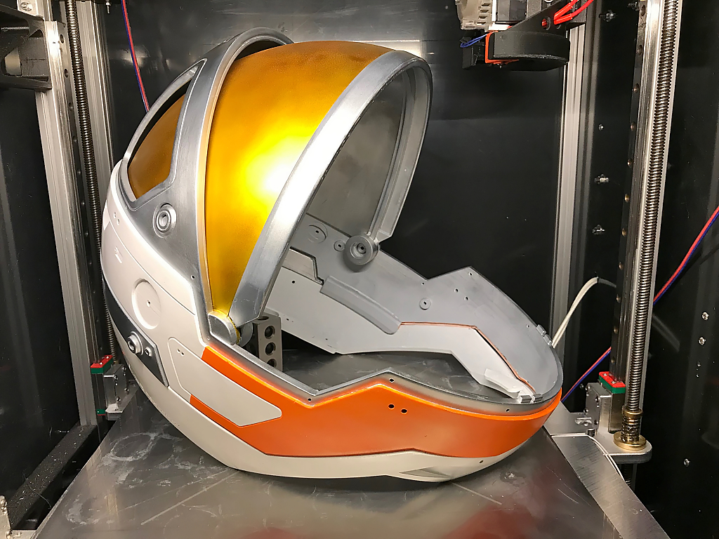

Moving along Alclad Airframe aluminium for the AL parts. protected by Aqua gloss clear. Made a shiny visor until I get around making a transparent one.
