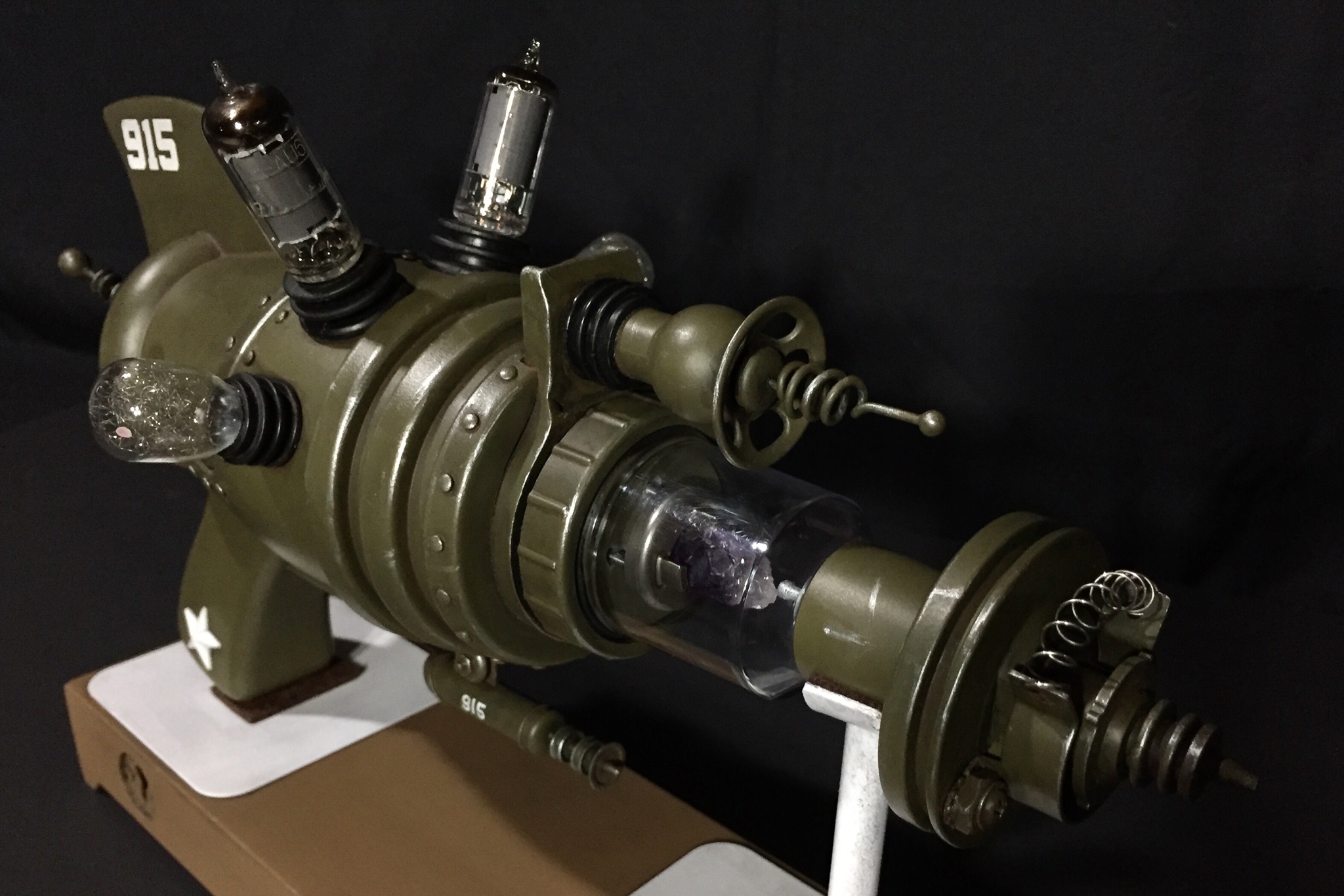

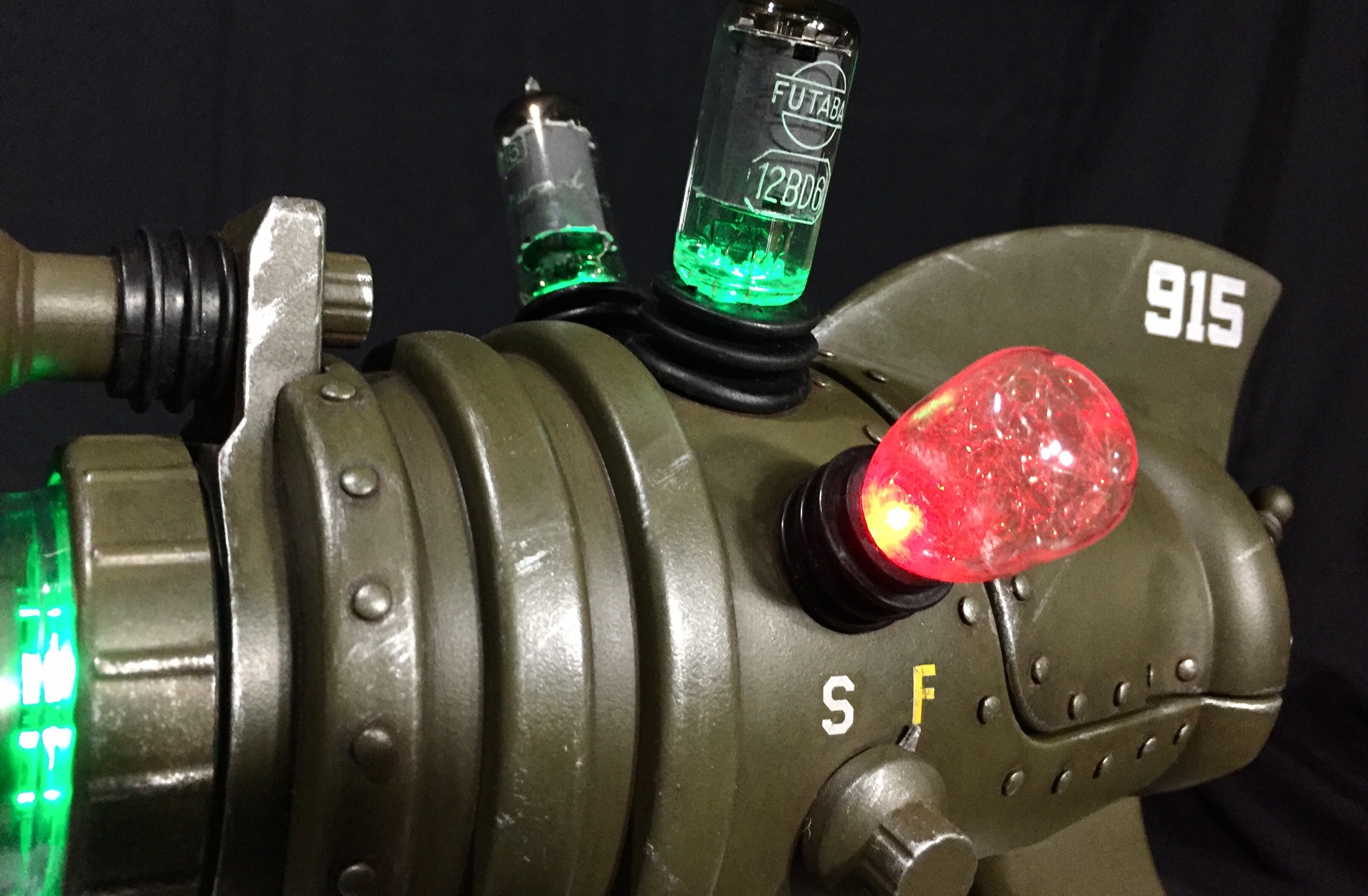

This is incredible! I absolutely love ray guns and you really pulled this one off well. Interesting to see it in military colors... and those lights really bring the whole thing together. Well done.

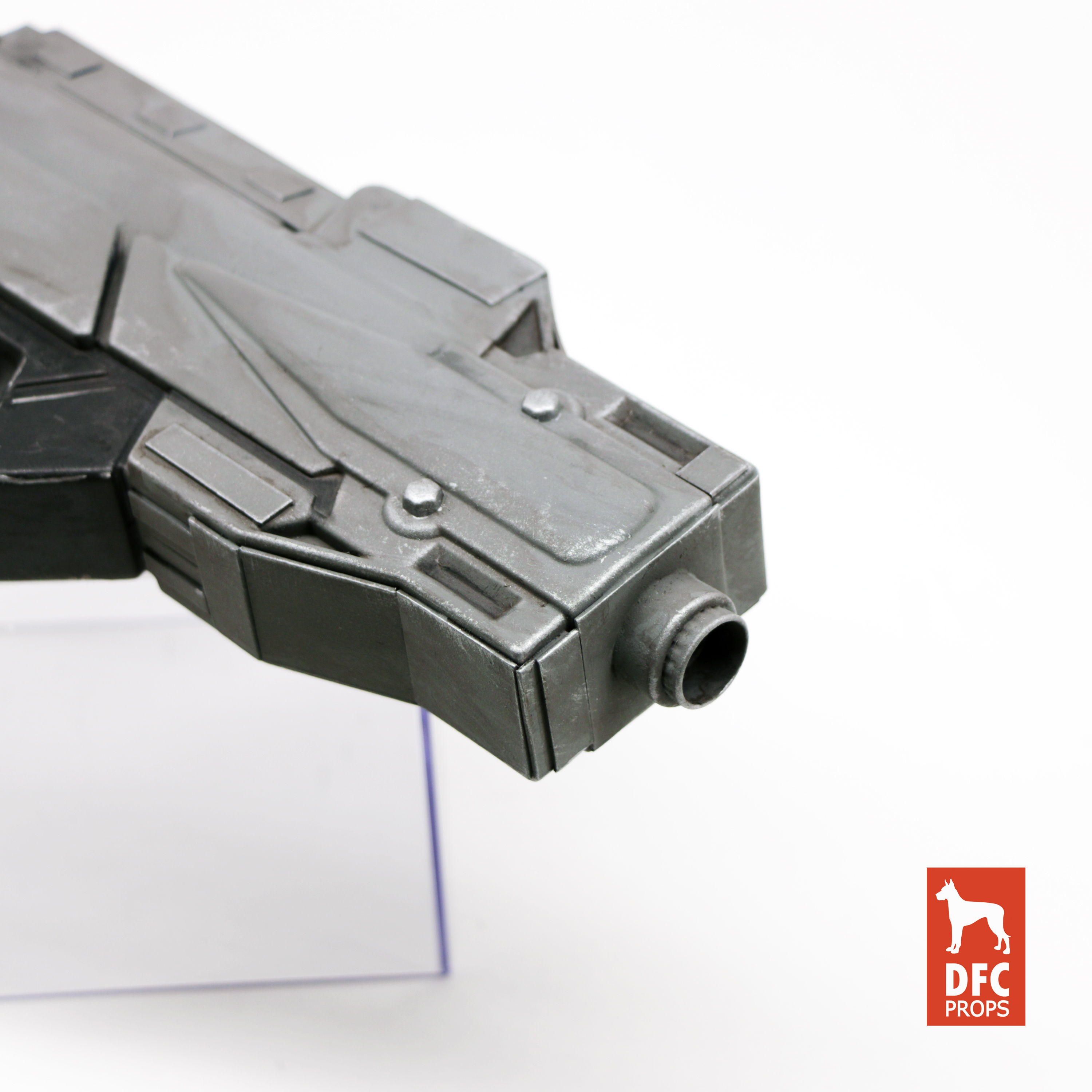

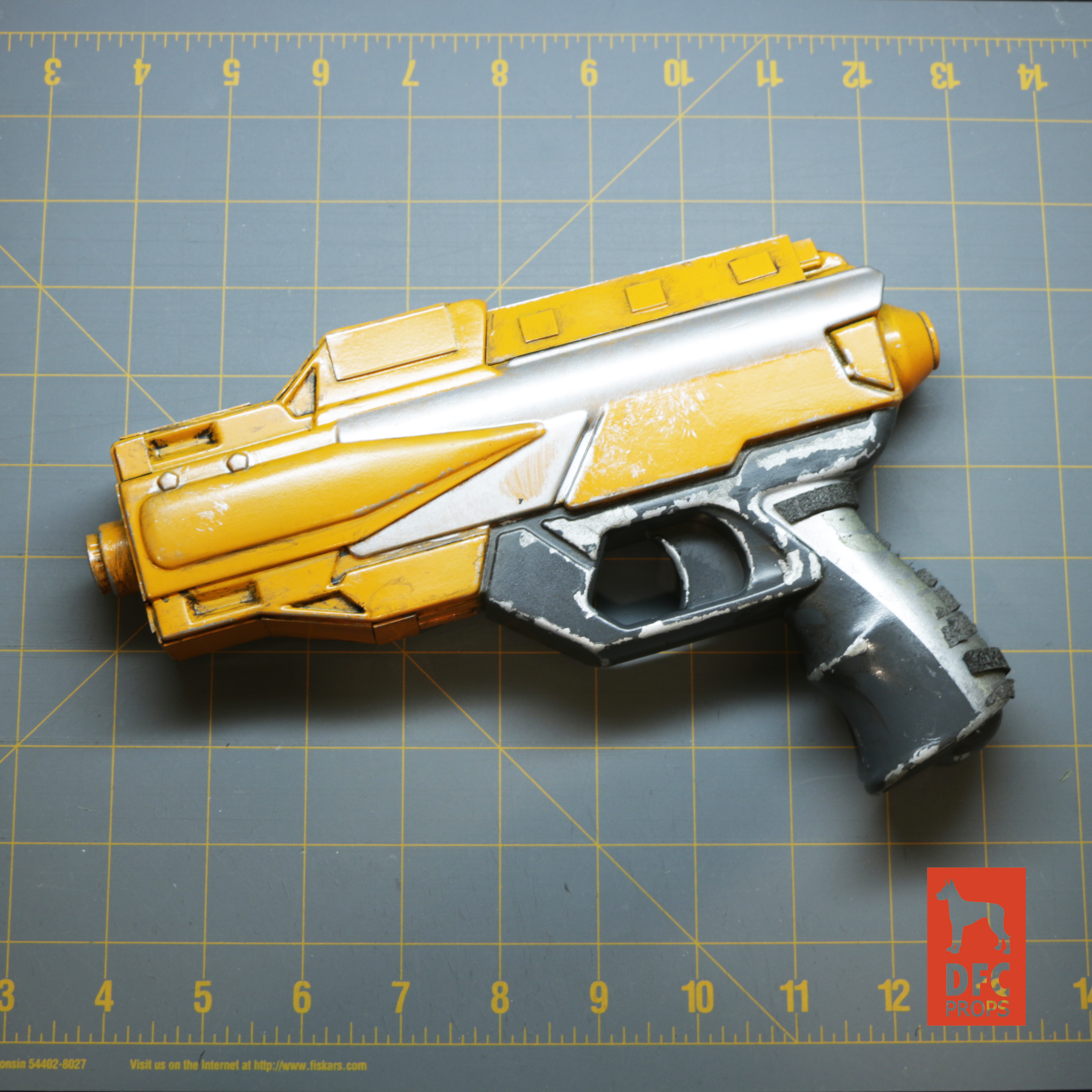

Whenever I can, I only take photos of the 'display' side of the blaster. There's a few exceptions, like the Strongarm and the Maverick to name a couple, as they have some nice details on the other side. I've never considered filling the screw-holes as I like to be able to reopen the blasters if I need to, but if it were to be an actual non-funtional prop I would probably consider using an epoxy putty like Milliput - not as structurally sound as Tamiya 2-part, but fine for gap filling and a lot cheaper.
edit: the other good thing about having a 'display' side is that I like to start with the other side whenever I'm testing out something new - I can work out any teething problems before moving into areas that will show up when the blaster is on display...

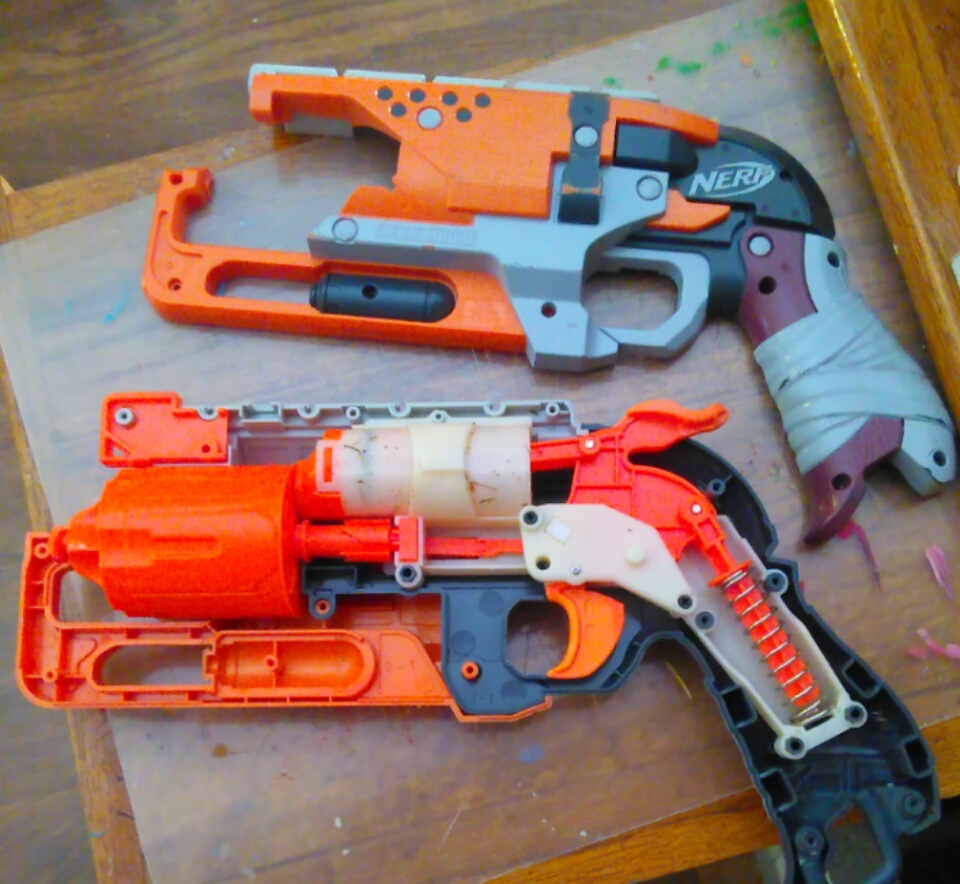

I've discovered that thrift stores are the best place to scour for Nerf guns. I got this Zombie Strike Hammershot for two bucks; I've collected an entire Nerf arsenal for less than fifty bucks total! I decided to finally customize one of these. Here's the before:
And here's the after:

I've discovered that thrift stores are the best place to scour for Nerf guns. I got this Zombie Strike Hammershot for two bucks; I've collected an entire Nerf arsenal for less than fifty bucks total! I decided to finally customize one of these. Here's the before: View attachment 1058251
Hmm... I'm slightly jealous. I rarely find Nerf guns at thrift stores near me. And if I do, they're really expensive (I mean they're priced higher than they should be... not as expensive as buying brand new). I have yet to find a place where they sell things really cheap. But that's great that you got all those Nerf guns! Nice job on the Hammershot. Love the color theme...

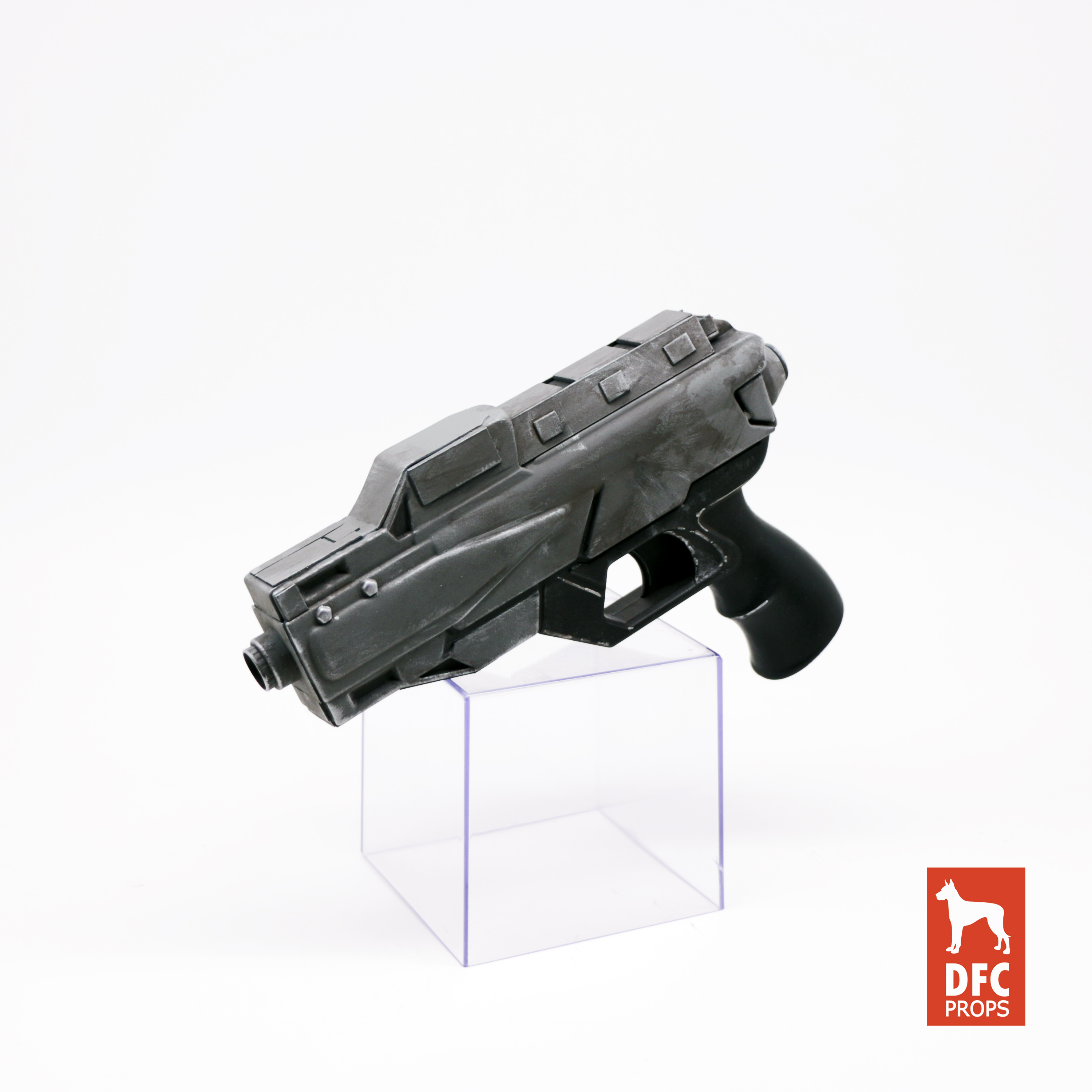

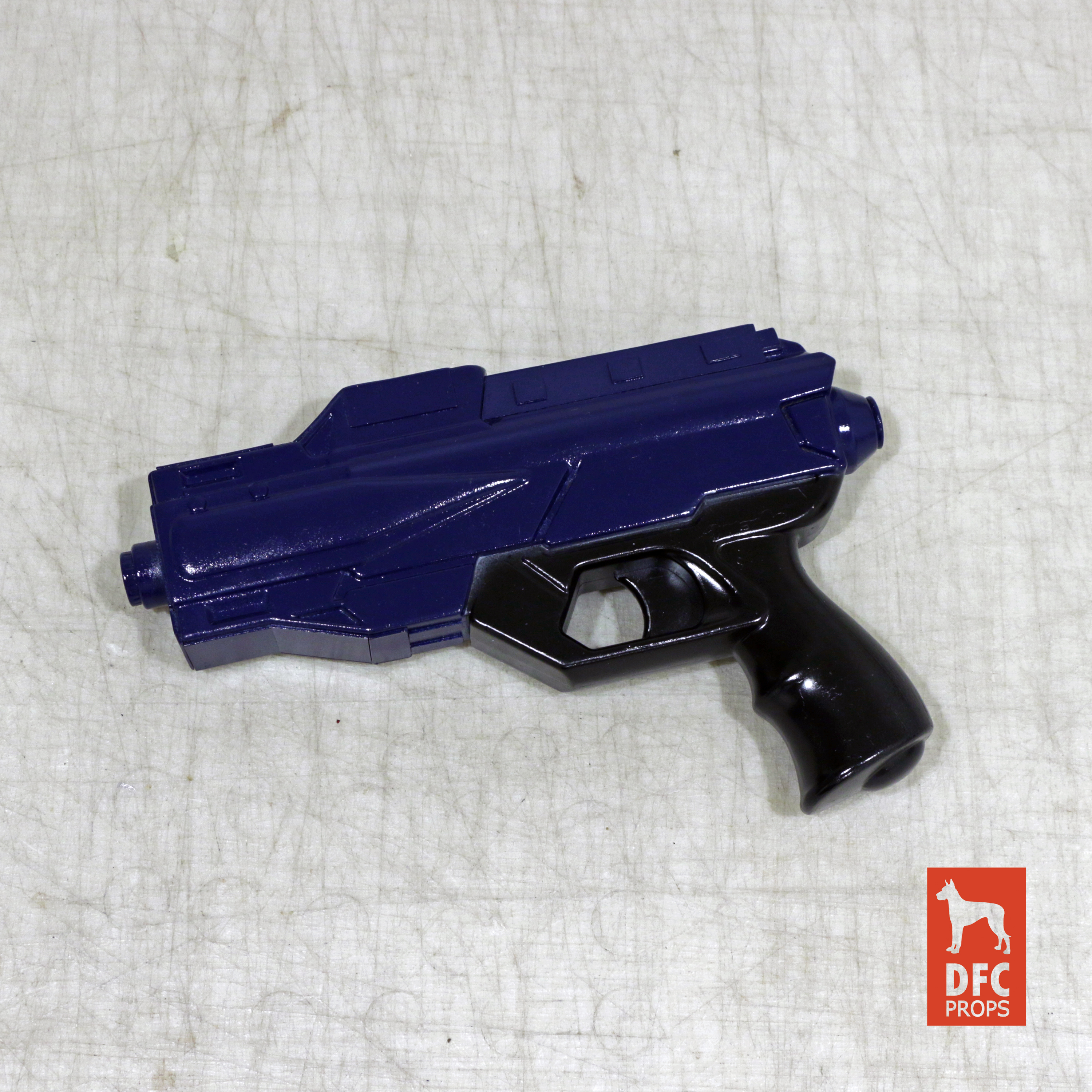

Thanks! I don't know what the deal is, but every weekend I hit the thrift stores for prop stuff, and I usually find one new model every time. Mostly at a place called America's Thrift Store (I think they're a chain).
Does this count? It's not quite a "Nerf" gun, but it was a toy dart blaster. This was meant to be a relatively quick project, but due to some mess ups and not being happy with the finish, I shelved it for a while. It started from orange, then to navy blue, and finally to grey. Not the most beautiful paint job to date, but I'm pleased with the result.

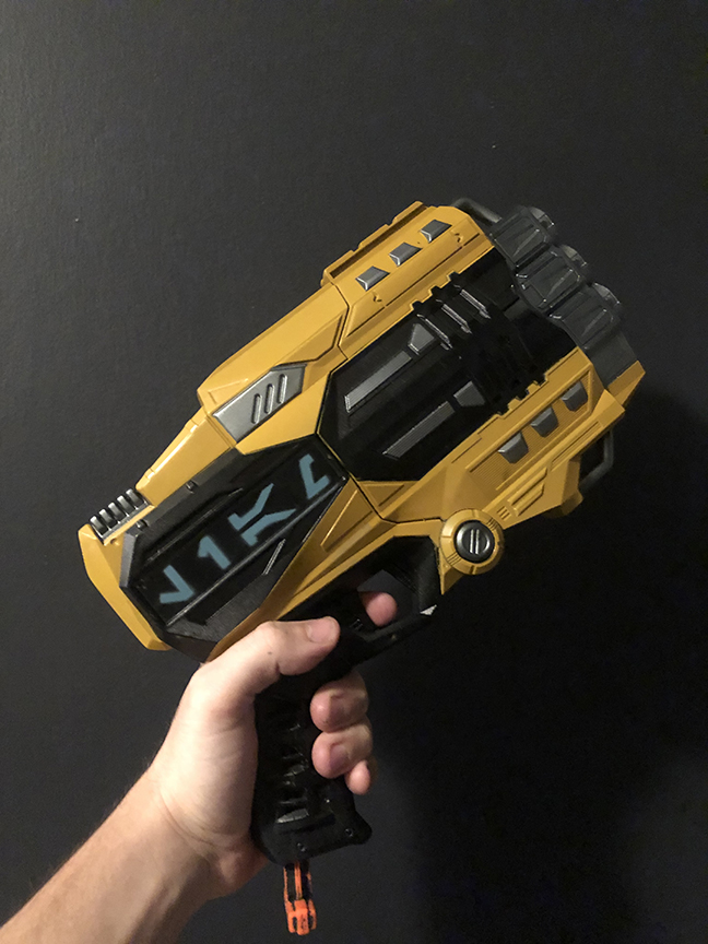

Very cool. I love the colors you picked and the Aurebesh is a nice touch. I'm pretty new to this kind of thing (only three years in the hobby so far) and you knocked it out of the park for your first one.
Most of my props I usually make "display only". I have tried to keep functionality, but as you said, the paint scrapes off the moving parts. To prevent the paint from scratching off, I usually clear coat it with a clear, matte spray paint (or gloss, depending on the look I'm going for). However, I would be careful about the parts that get a lot of friction such as the pump. If you can open up the hole where the pump goes in so it doesn't scrape against the sides, that might help... or add a soft material such as fabric so you don't have plastic rubbing against plastic.
I'm not super knowledgeable about it, but hopefully that helps. Remember that the clear coat spray paint will add an extra layer of paint, even though it doesn't look like it does.

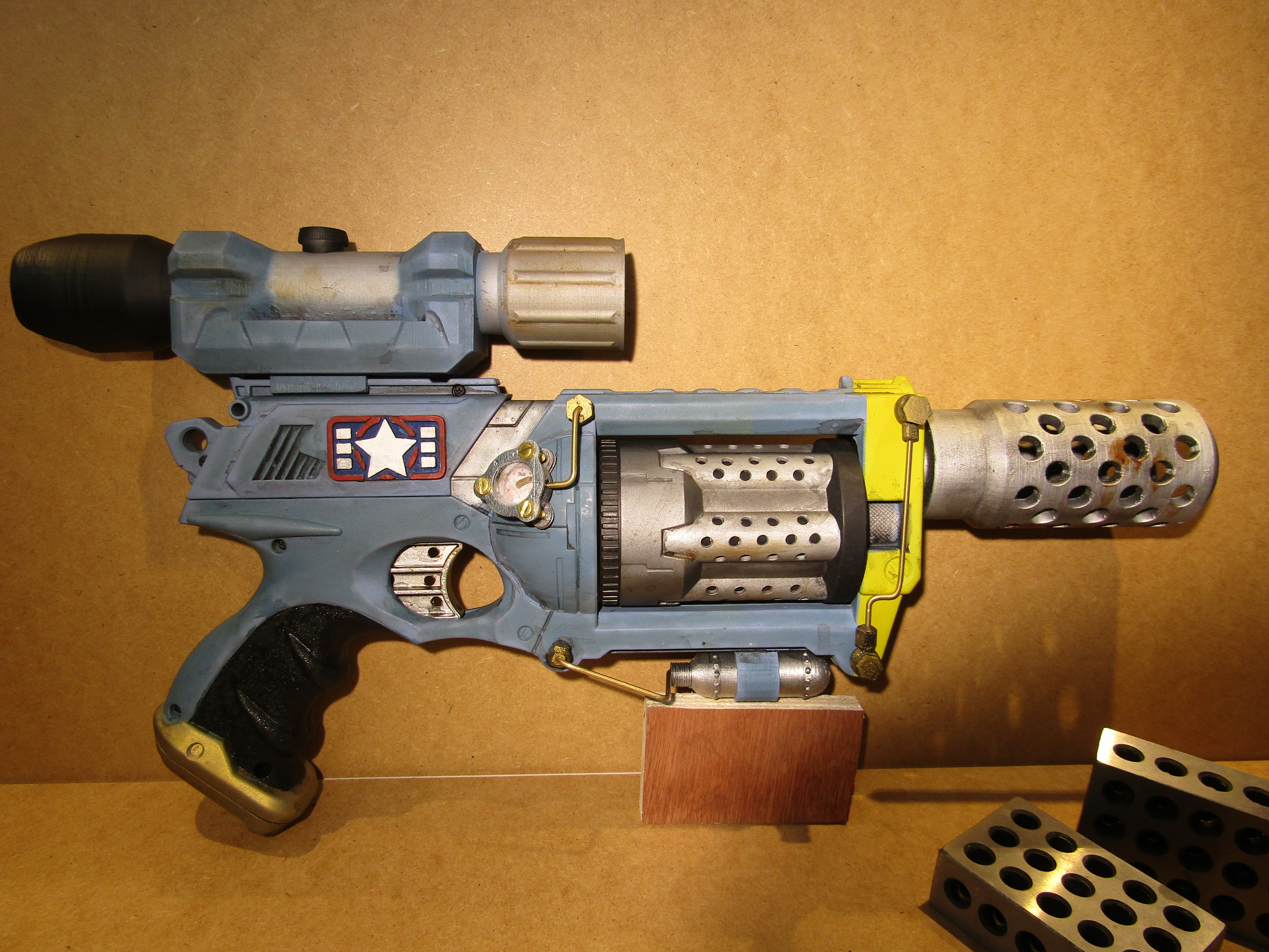

Just for fun, a Nerf maverick ,printed scope and muzzle brake along with some add on logo plates and 3D printed dials. Drilled out the magazine as well and truck bed liner for the grip. Dieselpunk style for a change.View attachment 1088294
Nice Maverick. I especially like the barrel holes and small piping. Good job!
