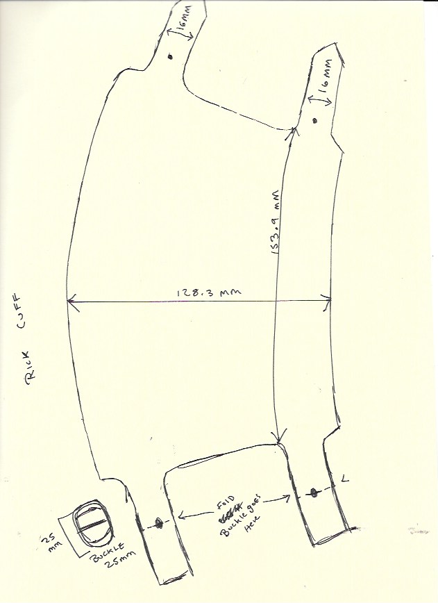

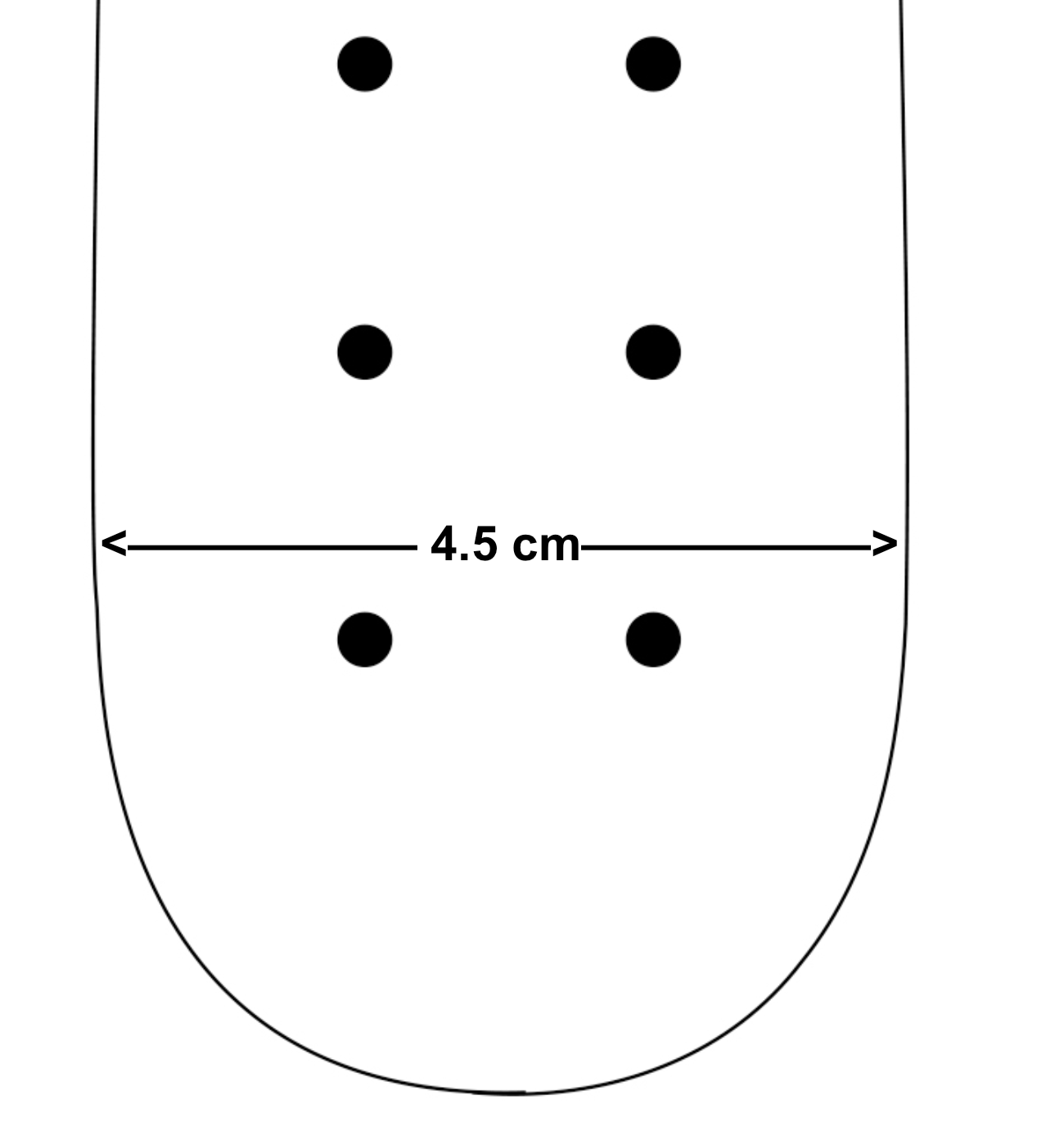

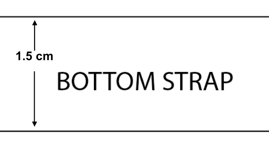

I can only add my compliments to those already offered by more experienced members; I can't begin to tell you how impressed I am by your holster rig, and I'm truly appreciative of the pattern you have so generously provided. For me, there's only one thing missing from the drawing: a scale, to show what 1 inch would be on the diagram. Perhaps it's because I have NO experience in prop-making and there's some sort of unwritten rule that everybody else but me knows! I know each person's body measurements are different, but is there any chance you could tell me one dimension somewhere on the pattern, that I can scale from, just to give me a starting point?

Absolutely!
You should scale it to your size, but start with these two measurements to scale it to my size:
Front straps with X stitch on them:
Strap that goes accross back:

Thank you, Mooniteman, that's exactly what I need. I realize that there's going to be a lot of adjustment and fitting involved, especially since we're definitely two quite different builds. I'll be using cheaper materials while I work out a pattern to suit my shape, before I move on to leather, but this at least gives me a starting point. I appreciate the info, along with the excellent pattern!

Glad I could help! Yeah scaling it up and down will totally work outside of the holsters. Those are gonna remain roughly the same. And I didn't include the strap that goes over the shoulder because it seemed kind of redundant. It's just a strap.
