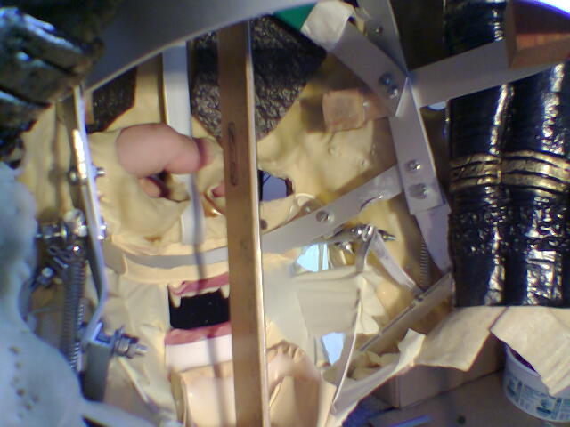

Nice work indeed!!! I have a question and a proposal, Who moves the mandibles and how?
Proposal, you might already have the answer however I thought about something that would be moved with opening and closing of the hands.
Wires attached on the fingers that when opened the mouth opens.

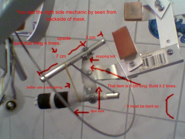

If you opening your mouth, there is stretching the wire ( look no 1) and comes up the mandibles.
it´s better to upholstering the wire (no.1) because it scratch your own skin.

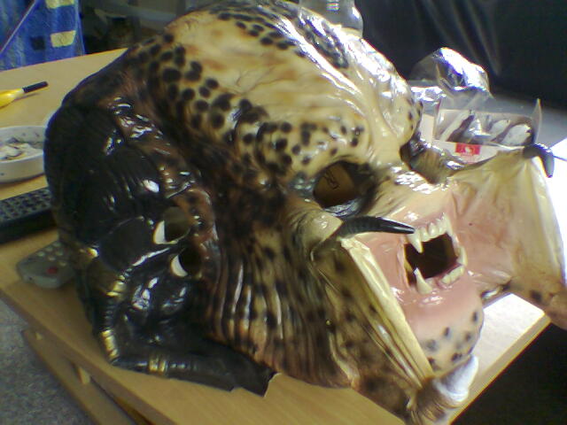

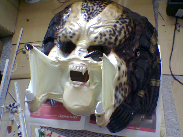

Here is a update of my old Rubie´s mask with Jaw mechanic.
I installed longer mandibles, and changed the wire´s with aluminium strive, because they are more solidly.
It looks fantastic! Any chance you could upload video of it in action? Keep up the amazing work!
Ready painted to 95%. Next work are the dreads and neck ring.

Here again. Please take longer mandibles, i think you have seen on my first post, they´re toooo short. It doesn´t look good.
Sorry, i don´t have any other pictures of my mechanic, because it all is poured in latex now.
All i have, i posted it already here.
Dont take flexi wires for the mechanic, because it do not work a long time...sorry.
I changed it with a steady aluminium.
