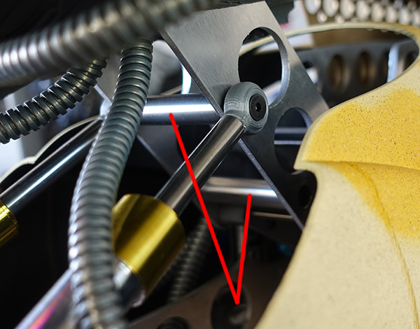

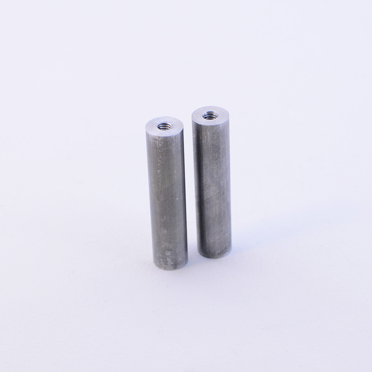

1 - the two structural back tubes:
so, those go here in case people were wondering:
those are the only parts that don't go in the front. If you have an assembled ZF-1, those are a bit annoying to remove, especially because the screws are glued, but if you have thin pliers or your girlfriend hand in my case, you can hold them securely, then unscrew them.
To re-assemble, it's pretty straight forward, however, you should use some thread glue or superglue when attaching the screws, and, don't tighten them fully! if you do, the mechanism will not work anymore of force more than it should as those are rotating points.

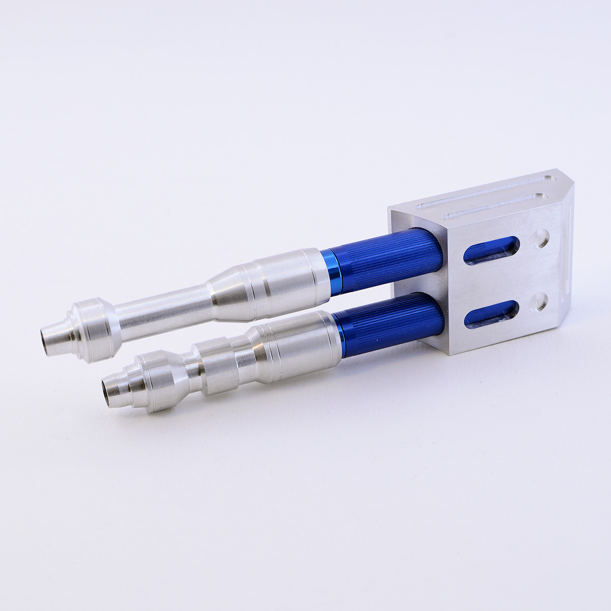

- the maglite holder:
nothing fancy here, just two screws to attach on the back from the inside of the frame. I recommend that you attach this one amongst the first weapon tips before it gets too crowded in there as it's easier to have some room for your allen key. You'll need some patience as your allen key might be too long to do full turns, but it's pretty easy to attach.
in case you need to remove the maglites, they are secured by two set screws in the back of the part (not accessible when the whole part is attached to the frame):

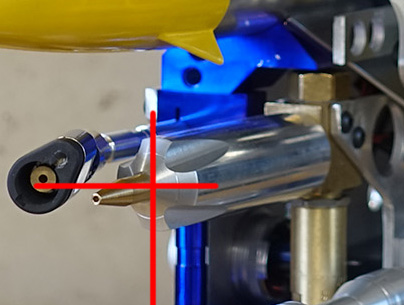

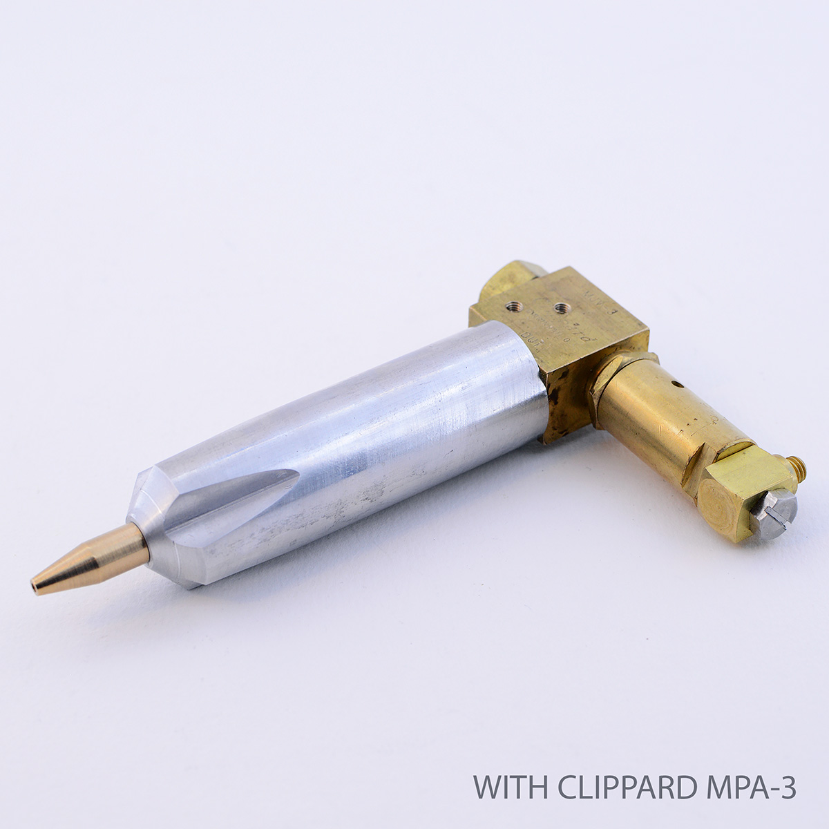

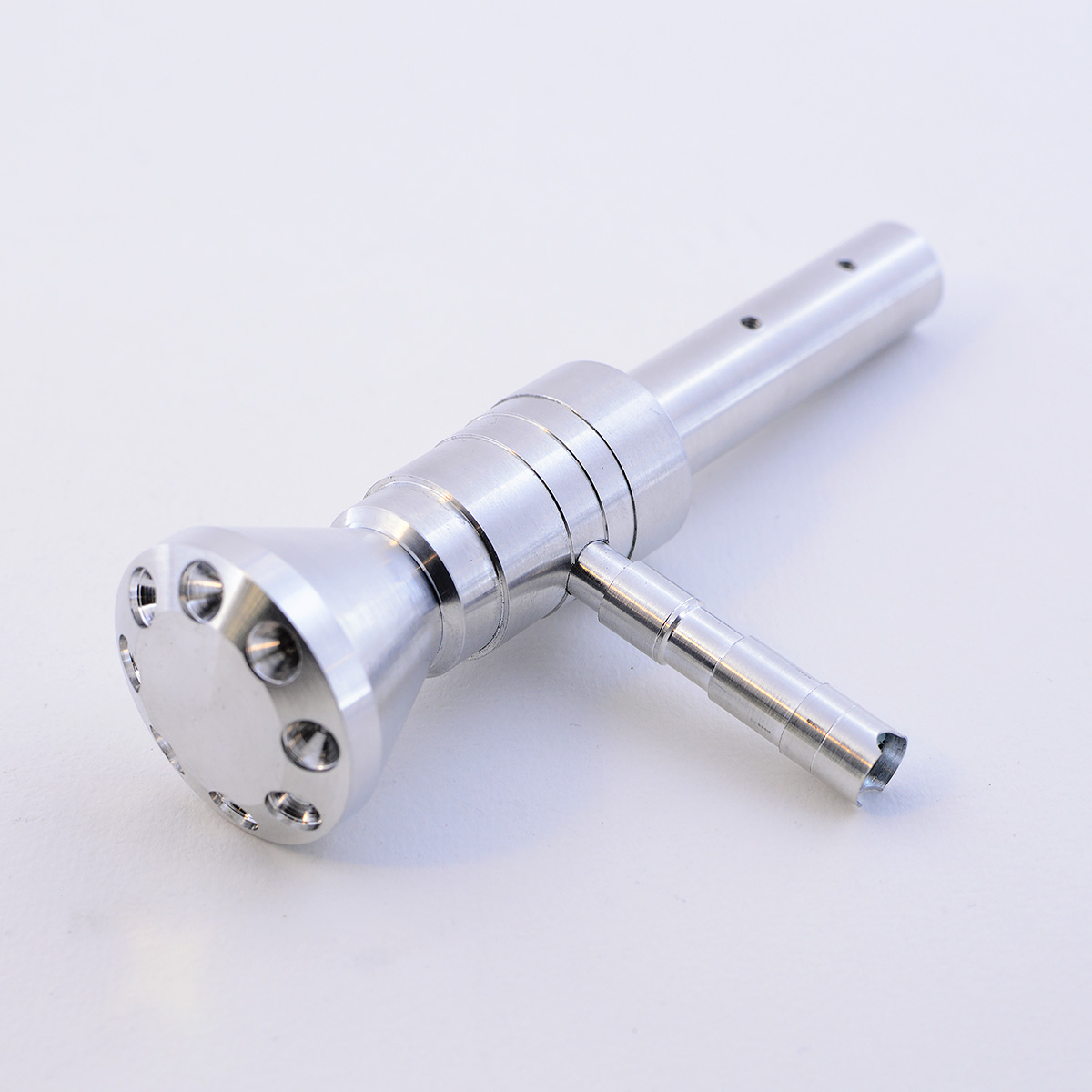

- the clippard and flame thrower:
if you took the full assembly with all clippard parts, it's pretty straight forward, just align the two holes to the frame and tighten the screws:
if you didn't get the MPA-3 part from me, it just threads directly on to the main MJV-3 block, then you can screw the little L fitting at the base with the included sloted hex bolt. The tip of the L fitting should face the back of the assembly as seen in the first photo of this paragraph.
if you want to remove the flame thrower for painting, it just unthreads counter clockwise, just with the force of your hand. make sure you tighten it back until the slots in the front are properly aligned:

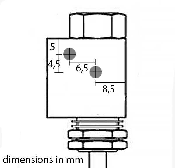

for those that need to drill and tap the clippard MJV-3 part themselves (just one person from that run, I drilled all the MJV-3 I supplied, no worries), here is an hopefully clear plan. make sure to measure twice and compare with your own ZF-1 frame! holes need to be 2.5mm and tapped to M3.

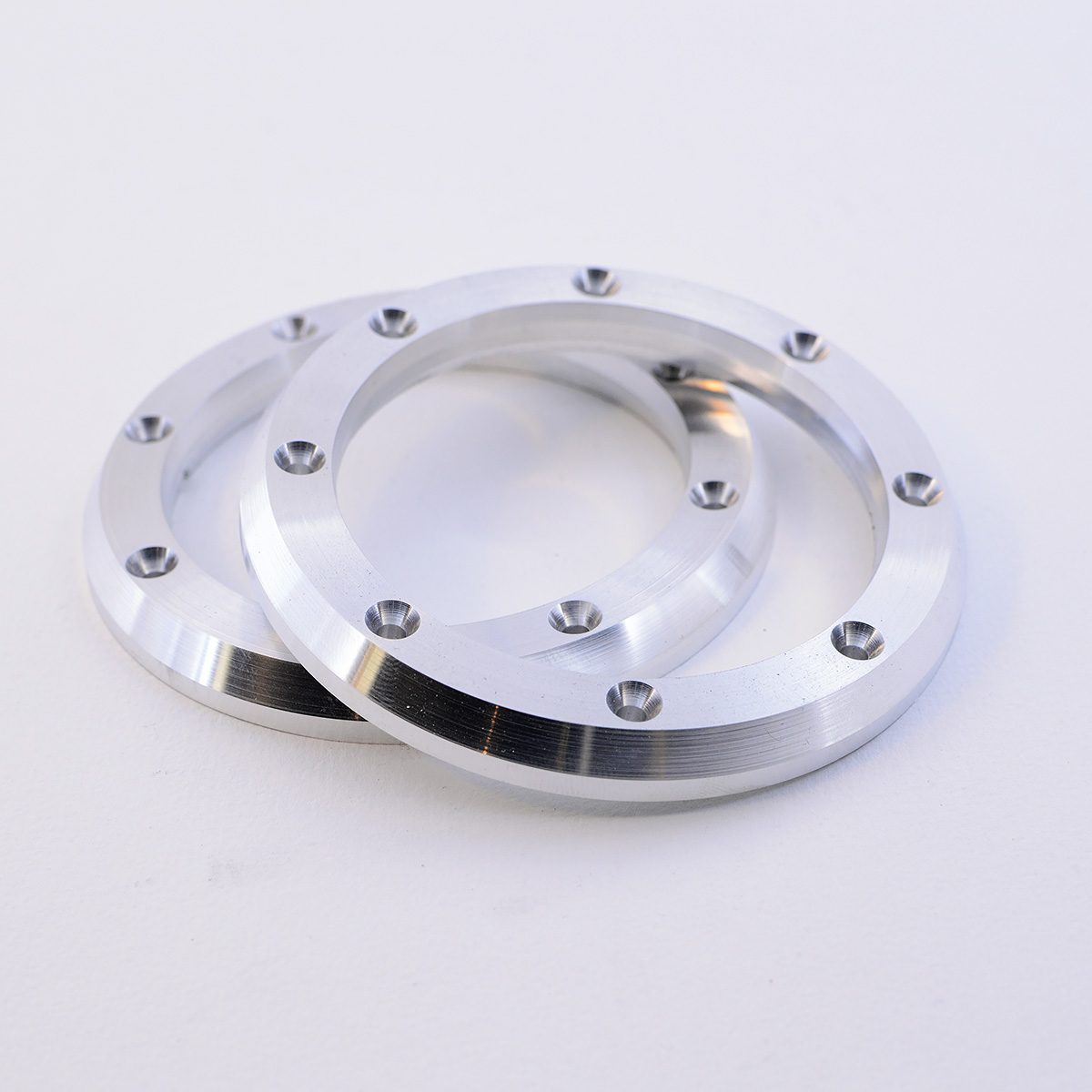

- the lateral rocket vents:
nothing special for those. position them and attach the screws without tightening them at first in a cross/engine block patern. tighten the screws when they are all in. The tolerances are pretty tight here because of the 8 holes, that's why it's best not to tighten the screws at first to have some wiggling margin, but they should fit perfectly :)

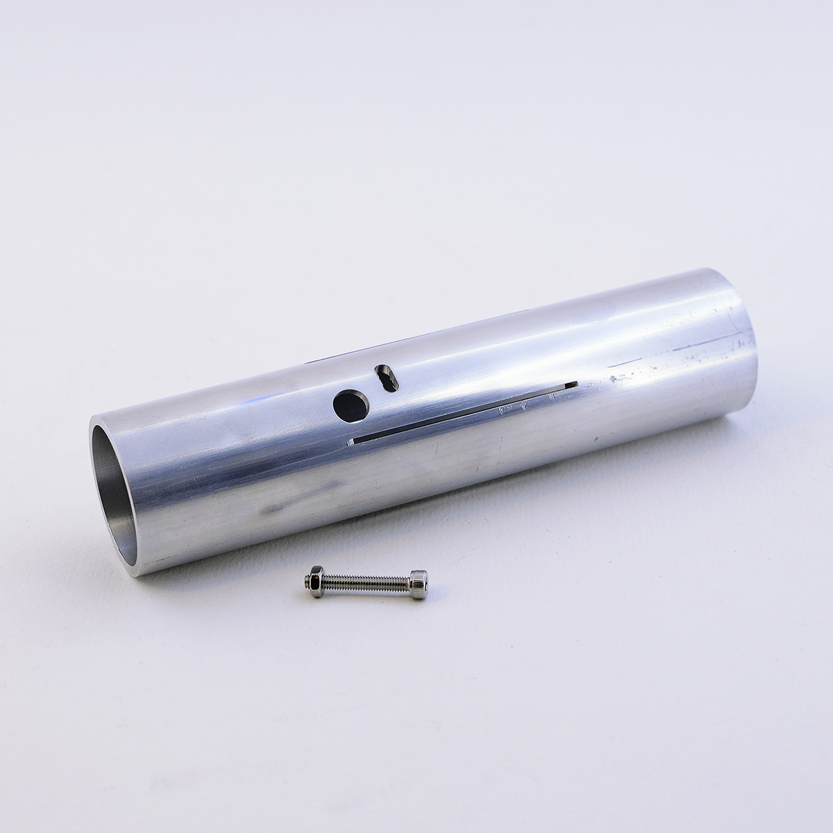

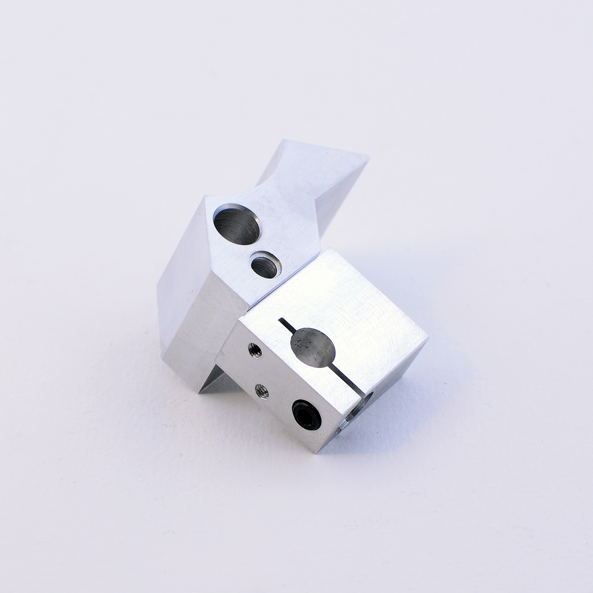

- the rocket tube, rocket support and butane torch support:
for the rocket, you need to attach the fins from Jake's kit. the side with the two holes on the tube is the front of the rocket.
if you have an already assembled ZF-1 like I did, the fins need to be removed from the printed rocket first, I just gently put some lateral and twist pressure on them, and working slowly, the superglue cracks eventually. then you just need to clean the fins with acetone.
to attach the fins, the slots on the tube are very adjusted, they might need a little bit of sanding to accept the fins. I used a piece of 220 grit sandpaper double sided taped to a thin piece of brass sheet I had lying around. A nail rasp (pretty sure that's not the correct word here, sorry!) would work as well. just sand a bit the slot on one side and test the fin. in my case, I really didn't sand too much, then pushed the fins by force, pushing them against my workbench starting from an angle of the fin, not the full length of the fin's base. you need to be carefull and not bend them, but on my kit, they are there, without glue, and they are straight and very secure :)

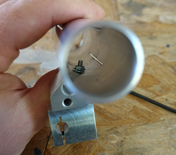

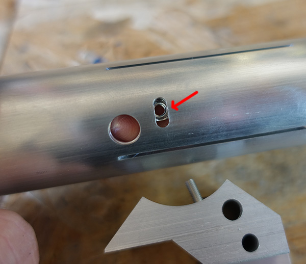

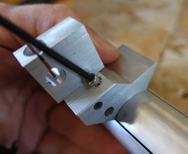

when you have that attached, you need to attach the rocket to the rocket holder. (I don't have the fins attached on the next photos as I'm using a new kit for the demo, but that's the same) the screw to do that is already attached to the rocket holder, it's the stainless steel one. remove the nut from it, put it on the tip of your index like so:
and present it in front of the slot from the front of the tube and from the inside:
then, just align the screw and rocket holder part to the nut and start threading it from the back of the holder parts:
it might look a bit complicated but it's actualy a 1 minutes job and not hard at all :)
here from the inside, without the fins again:

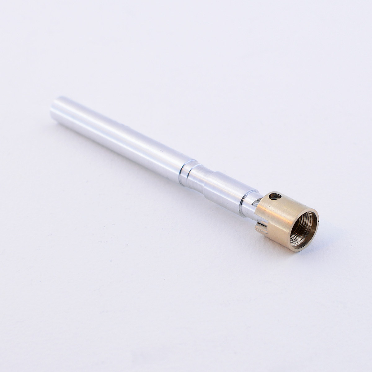

to attach this to the frame, there are just two screws, but before tightening the back one, you need to put the Butane torch holder in the front hole, the back screw will lock the torch support with a slot on it's side:
push the support tube until you think the slot is aligned, almost tighten the screw, push on the tube again until it comes in contact with the screw to be at the proper depth, then tighten the screw fully.

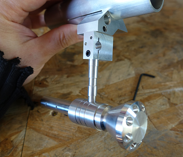

- the ice cube system:
this can be attached after the rocket holder is attached or even before in one piece with the rocket holder like showed at the end of this paragraph.
pretty easy to attach, just align the notch on the vertical tube with the screw inside the hole of the rocket holder:
push the rube inside until it touches the screws and tighten the screw a bit.
if you do that before attaching the rocket holder, you get that assembly:
then it's just a matter of threading the 2 screws at the back of the ice cube tube from the outside of the frame

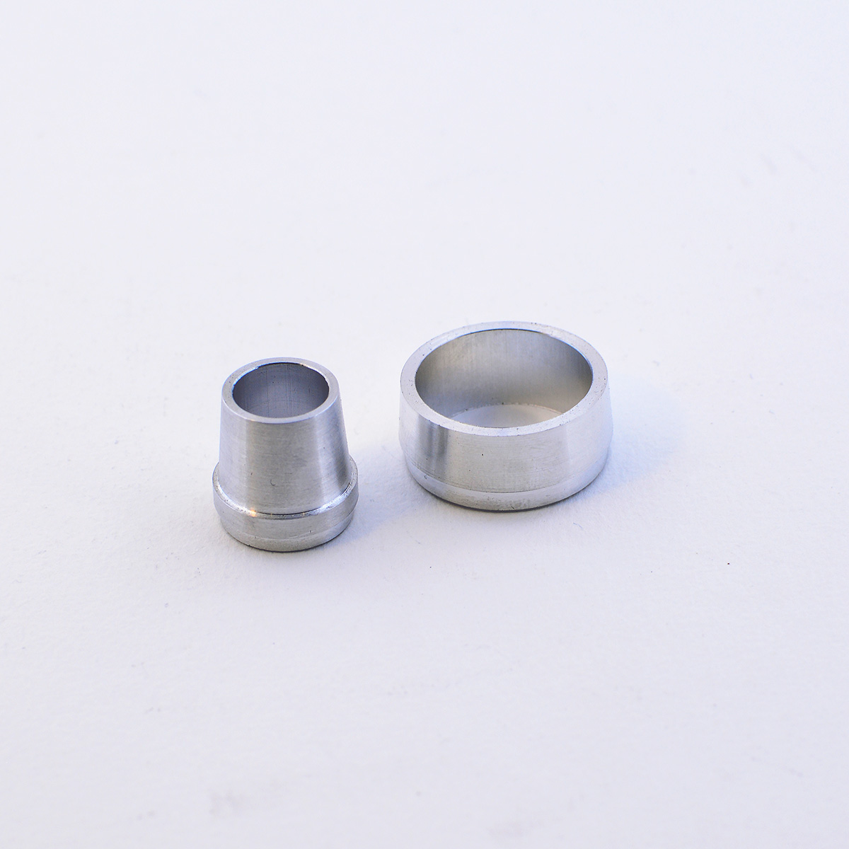

- the red button and yellow button bases:
ok, so those are intended to be glued in Jake's kit, so I proceeded the same here. That means that I turned the pieces to a theorical diameter but since those need to be a tight fit, they might need to be adjusted a bit. Actually, the frame holes might need to be adjusted a bit as it's the easiest way to do it.
if the part is too tight, wrap some sandpaper around a tube of the approximate hole size and sand the frame a bit, test, sand again. it shouldn't be much.
when it's a tight fit, put a bit of super glue or other and push the parts in place.
the yellow button/printed red button themselves needs to be glued to the bases as well.

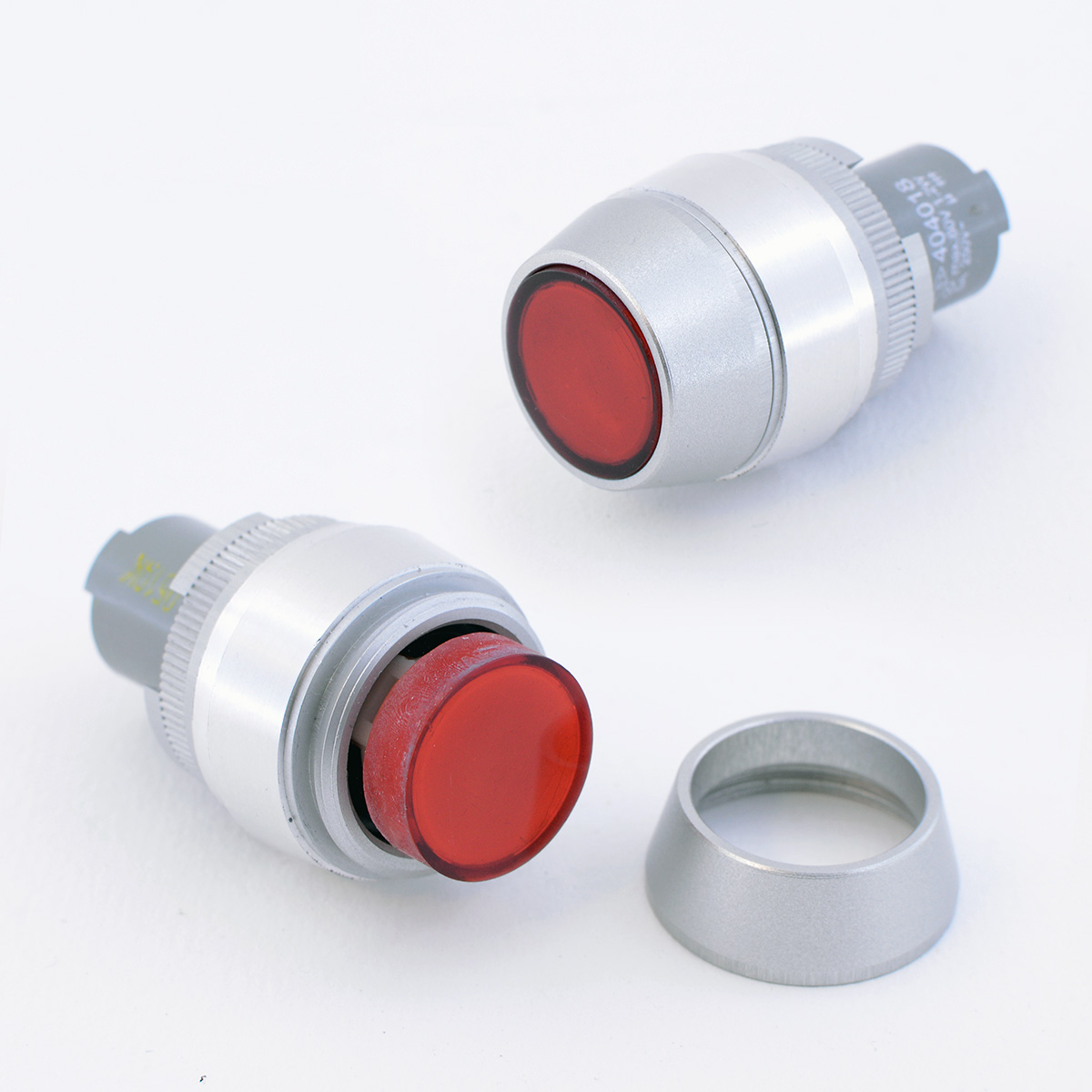

if you get a real red button, remove its nut, put the button in my aluminium base and put the nut back from the inside of the frame/base if not attached. no need to glue the real red buttons, just the base to the frame.
If you have one of the two NOS buttons that I sold, it's even easier, it all threads together without glue. as explained here:
For the red lenses that I sold. just remove the real red button bezel, and push gently on the red lens until it pops in place. Always be gentle with that part as the white base legs are pretty fragile. When you are done, put the button bezel back in place.
