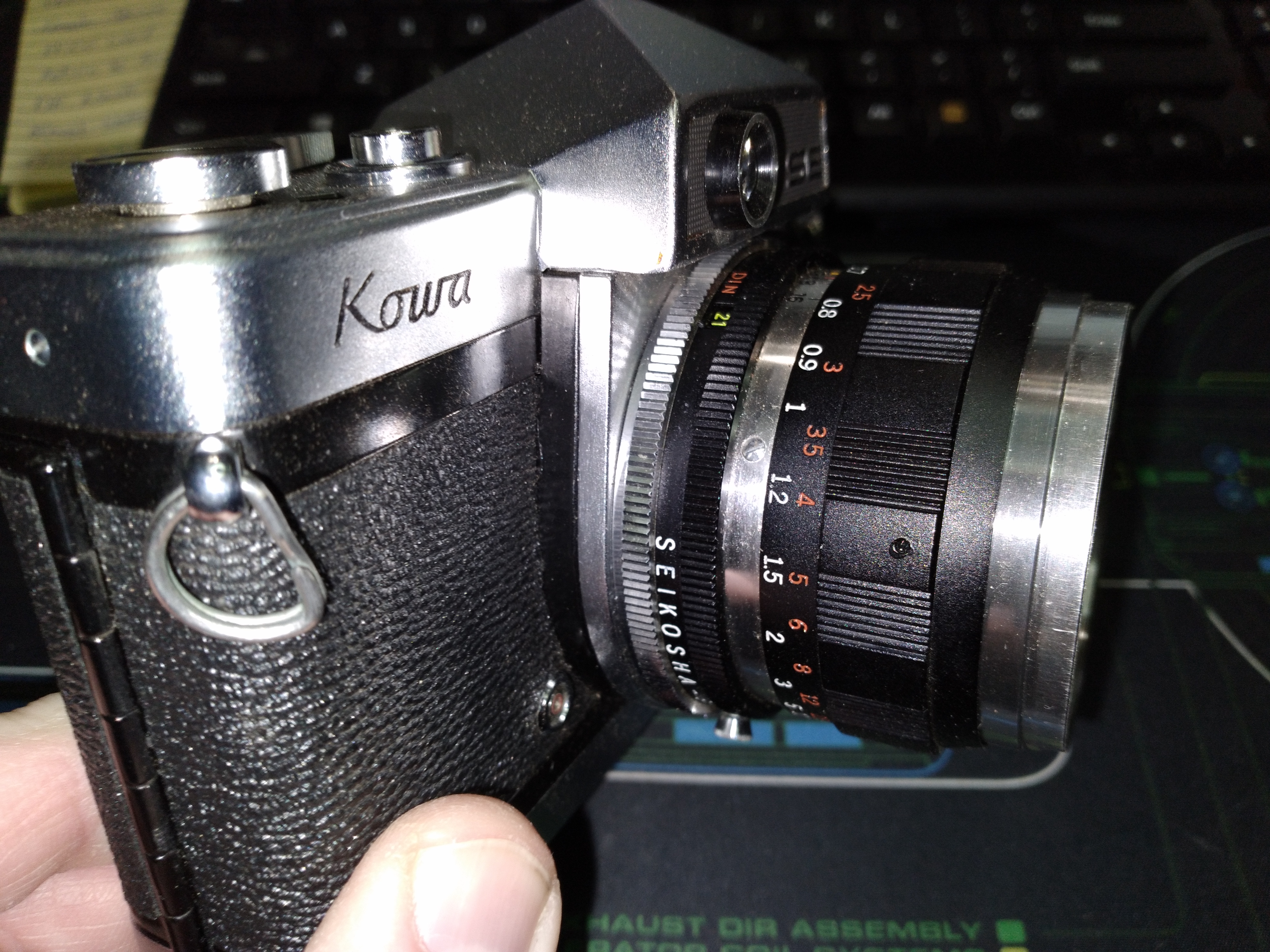

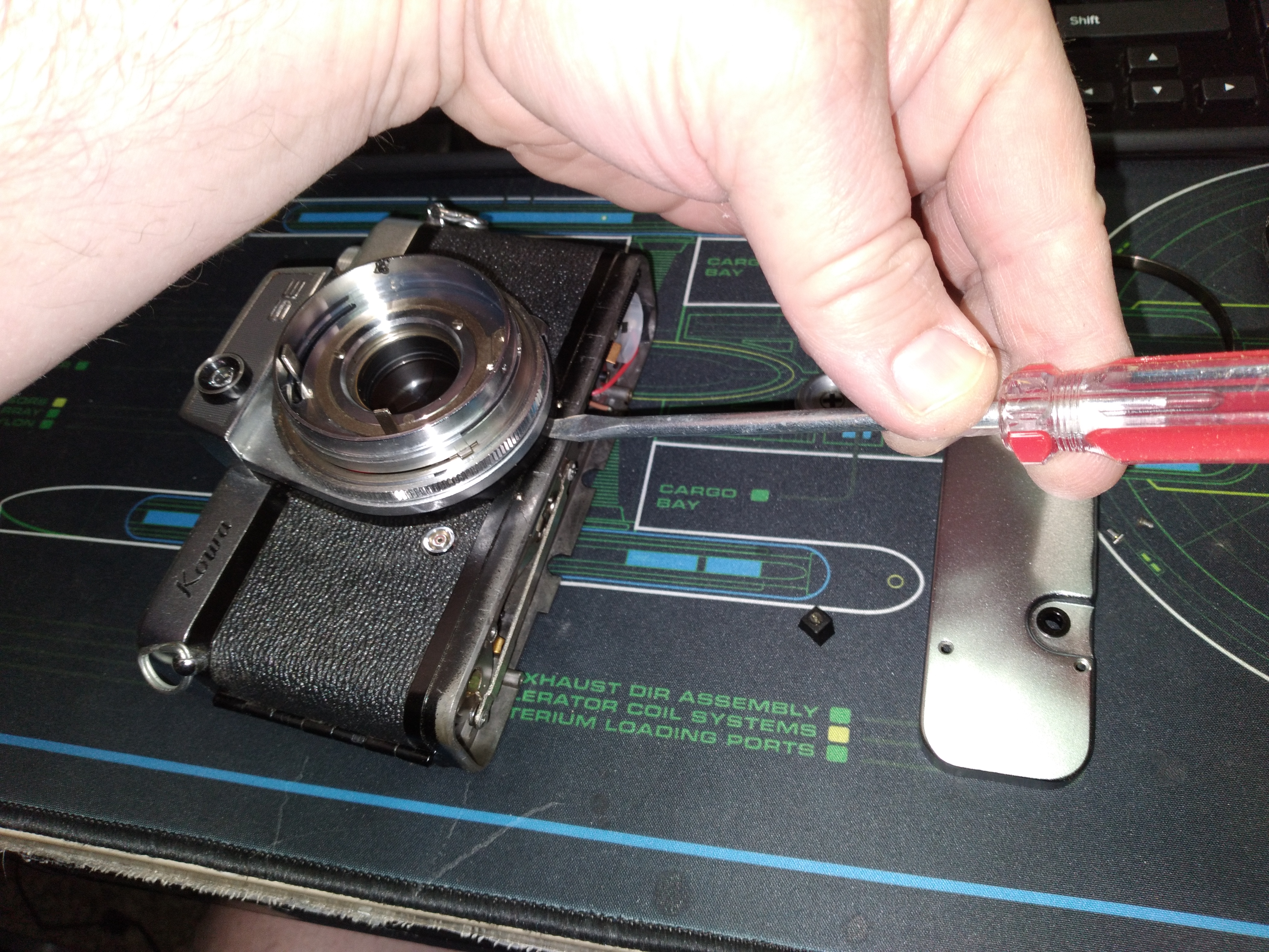

These did not come out as accurized as I would have liked but here it is. $50 each so obviously much cheaper.

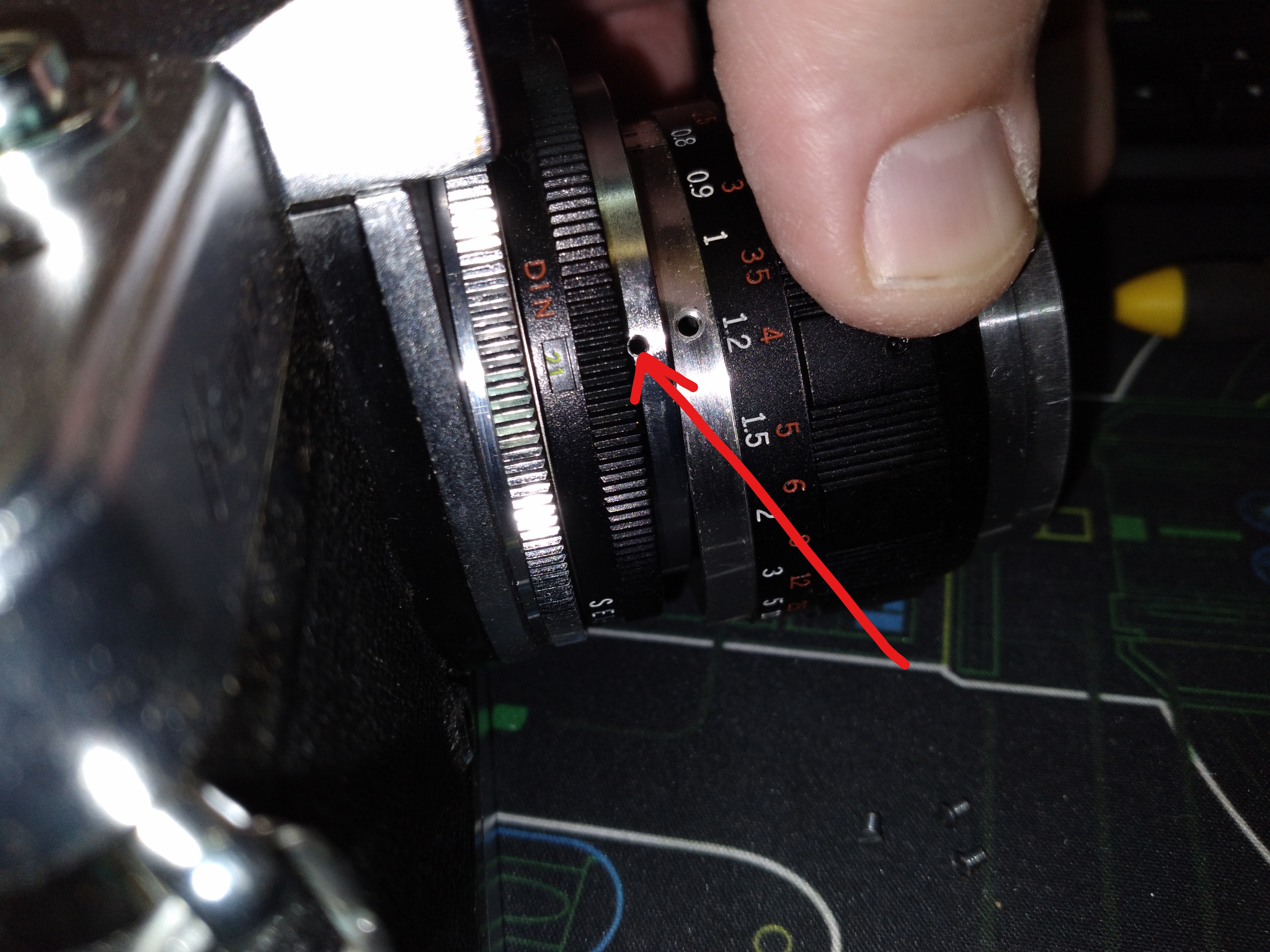

Three tiny screws around the lens. Unscrew and lens comes out easy. From their I suggest using Beeb89's method of accurizing.

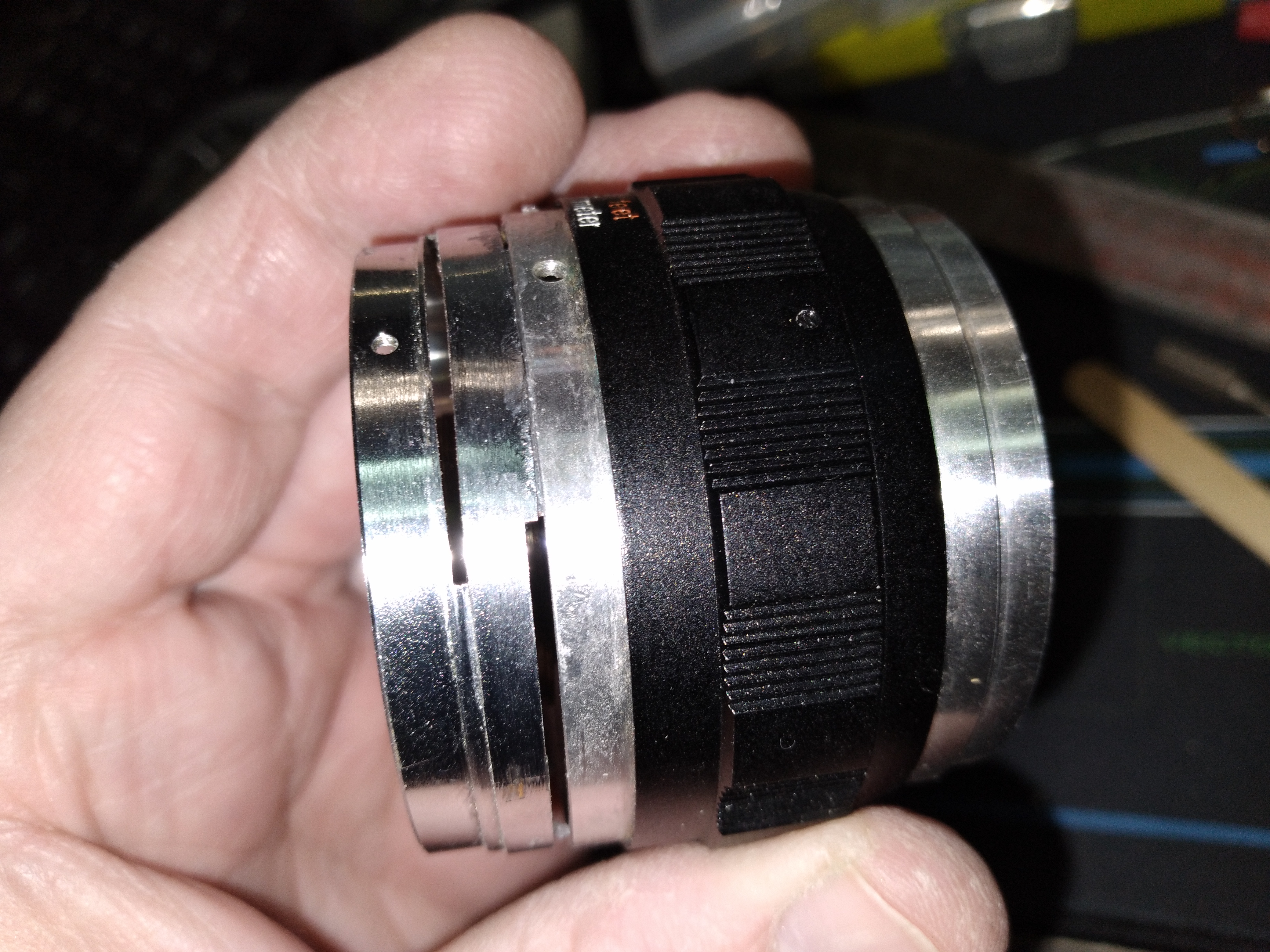

After the lens is off.
Misc. rings you can use to accurize.

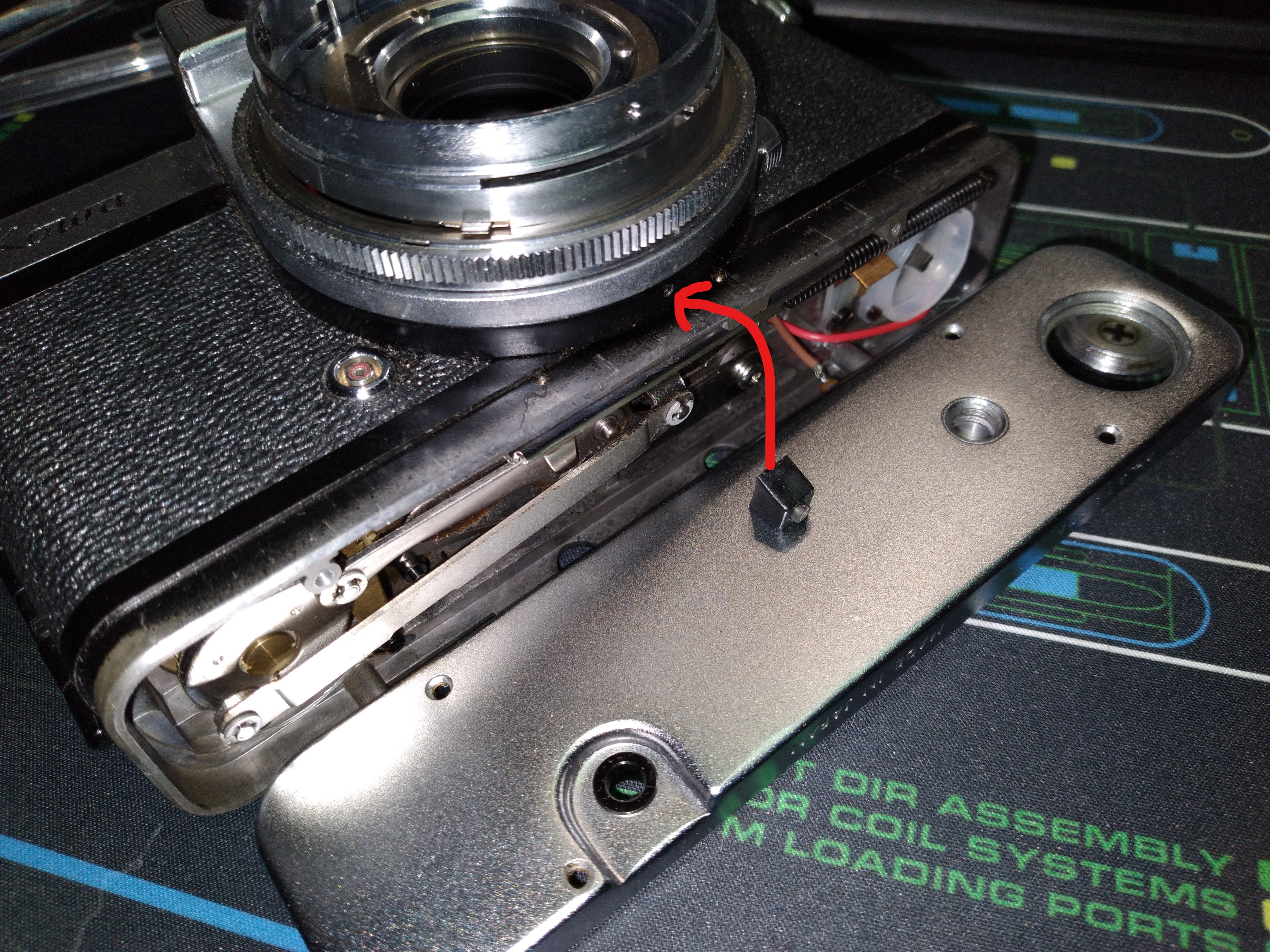

Next take off the bottom of the camera. Easy, just unscrew along with that little black scquare that is on the bottom of the lens.
That is the end of the easy stuff. Maybe someone else can figure it out but for me I gave up and started tearing things apart.
To get the back of the lens assembly off I had to insert the screw driver in and break it off. The entire rear lens assembly will come off along with part of the front of the camera.

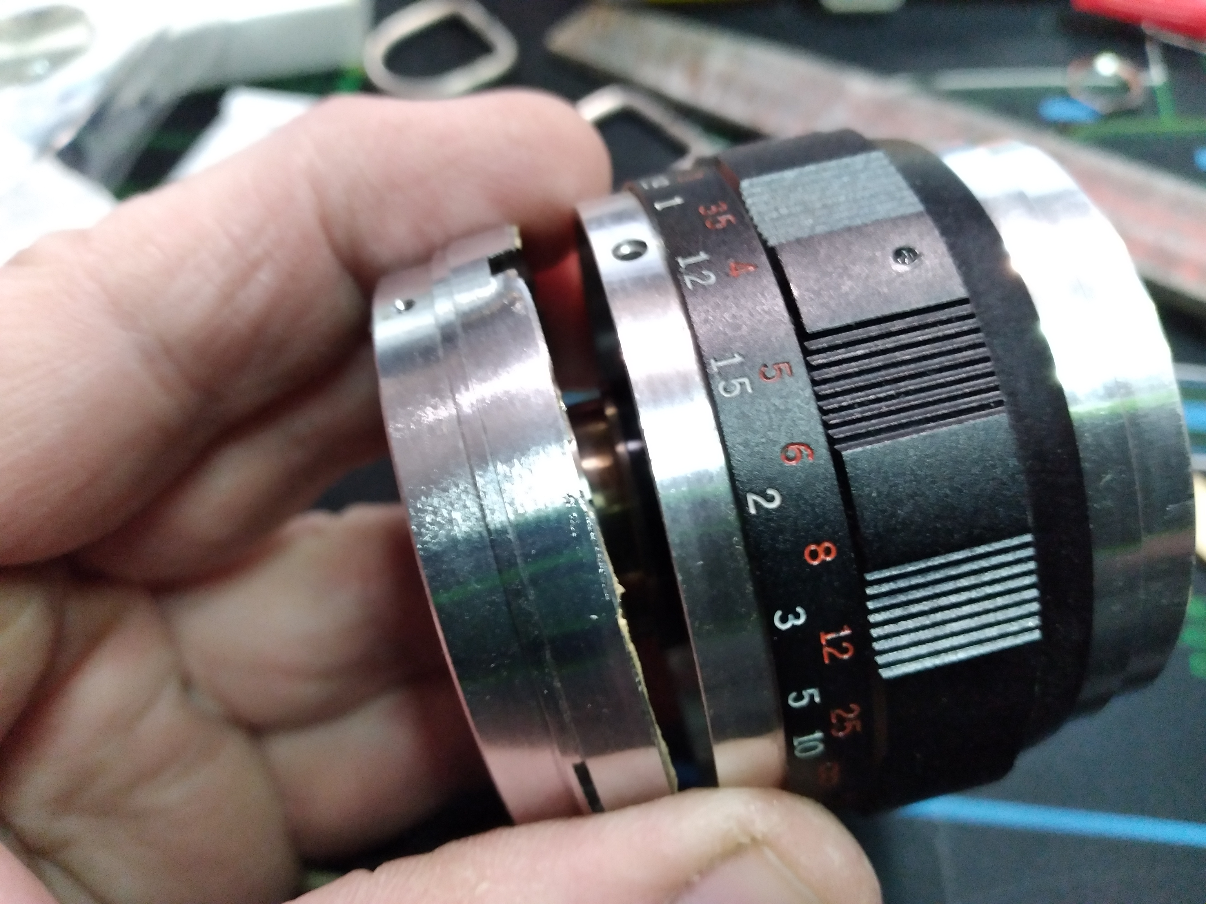

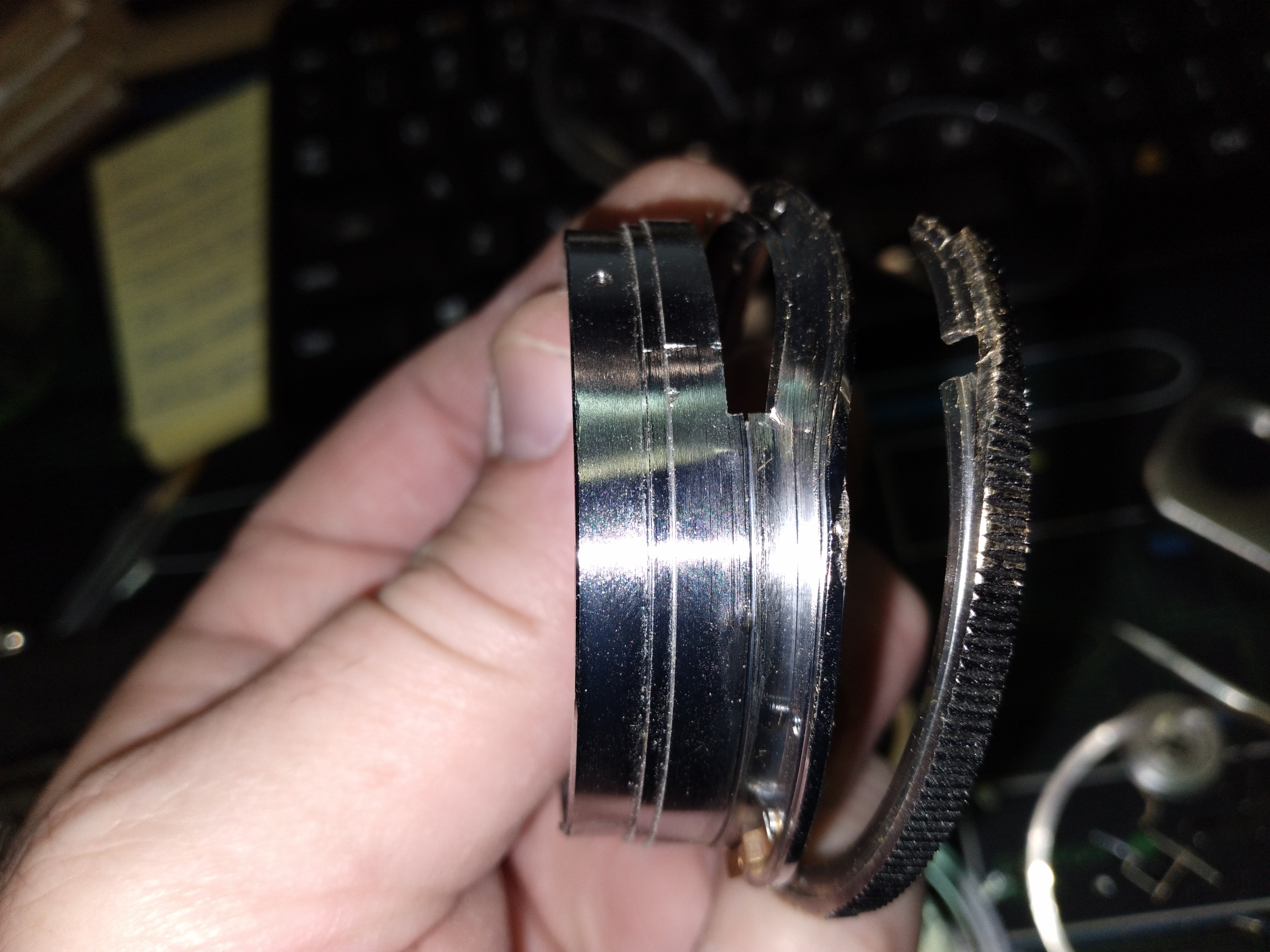

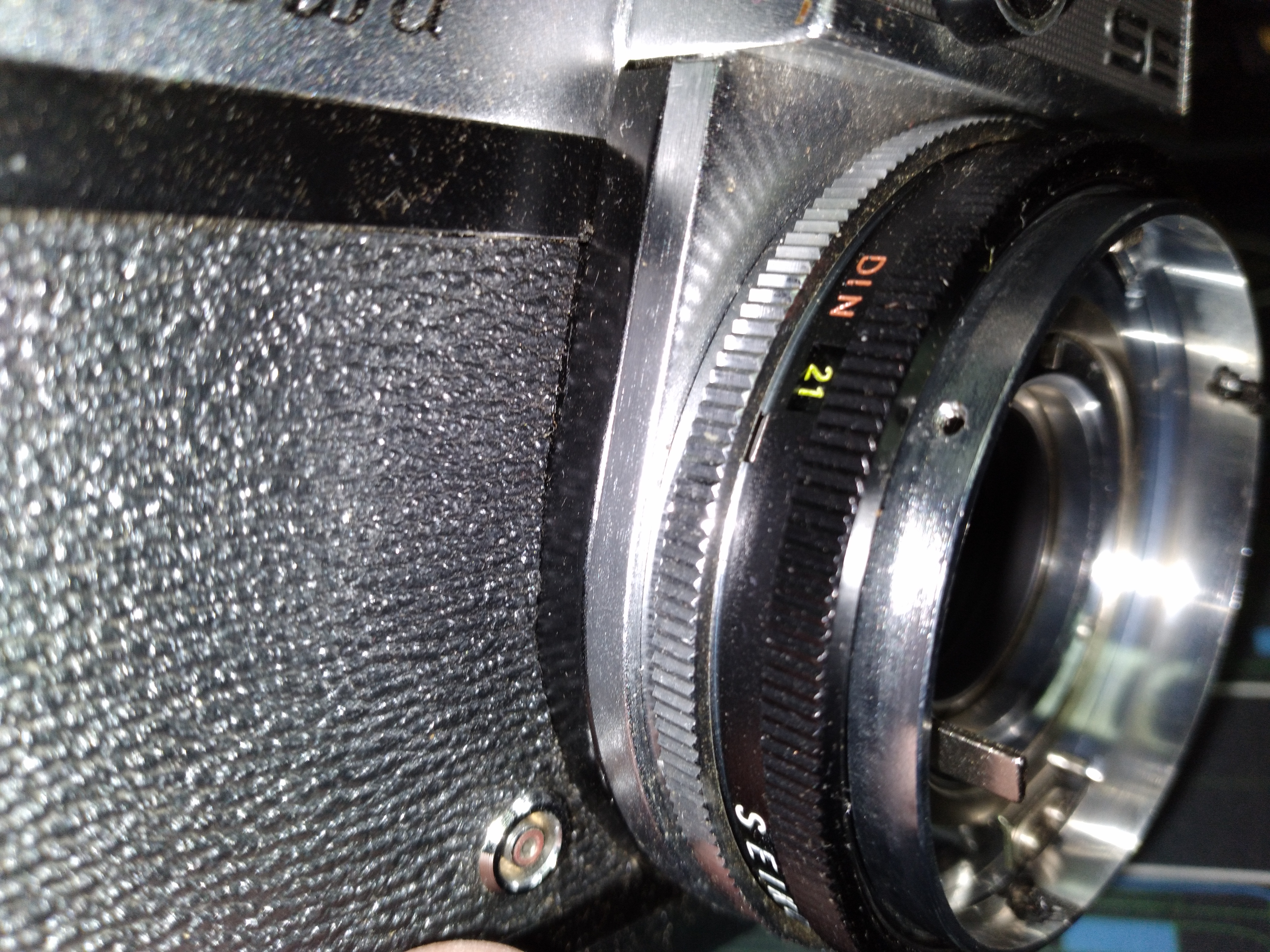

So this is how it is when you first take the lens out. Then you flip the back piece that you broke off the front of the camera.

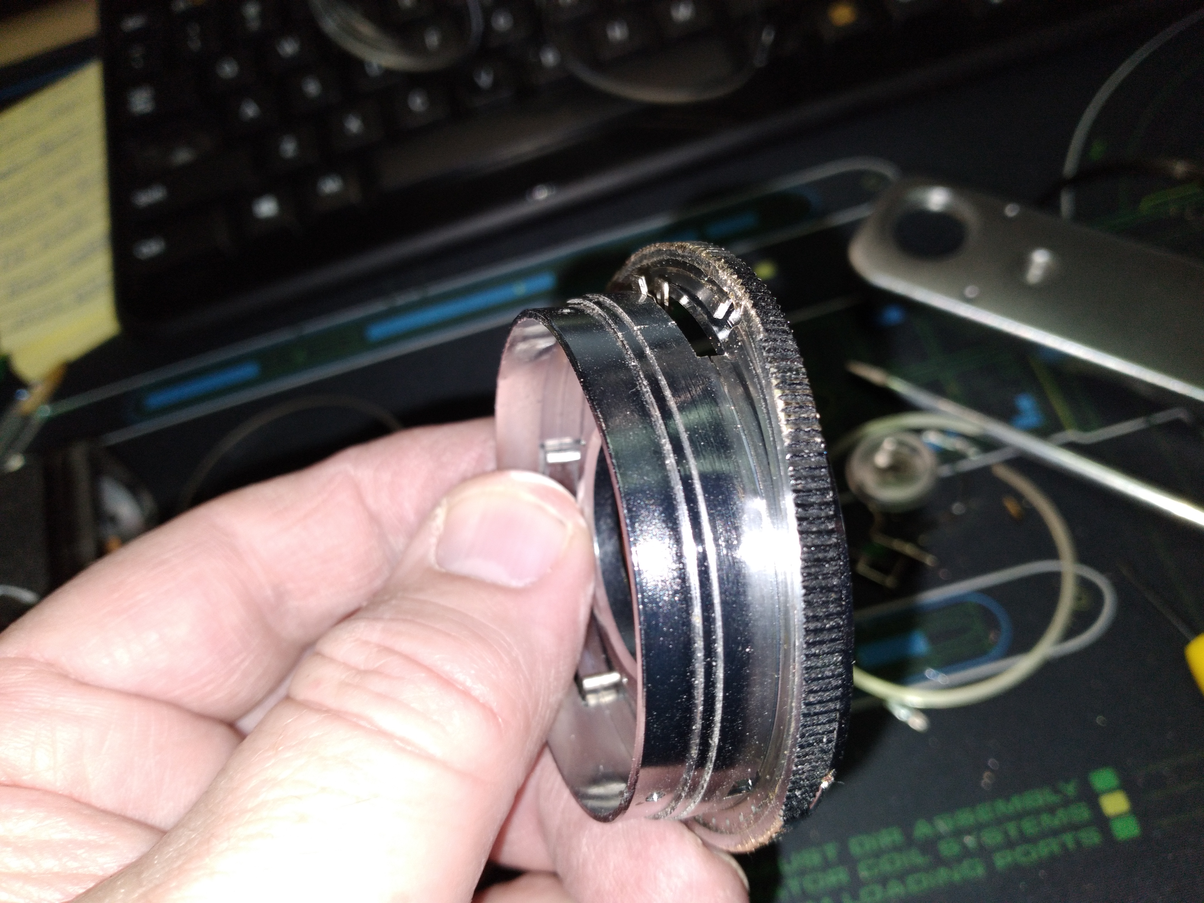

Okay this piece forms the back tapering part. Bust the tread looking thing off. If you can figure out how to more easily remove it God Bless you. I used pliers and ripped it off. Not easy.
Then cut or snap bend, break which is what I did all the way around.
more to come.....

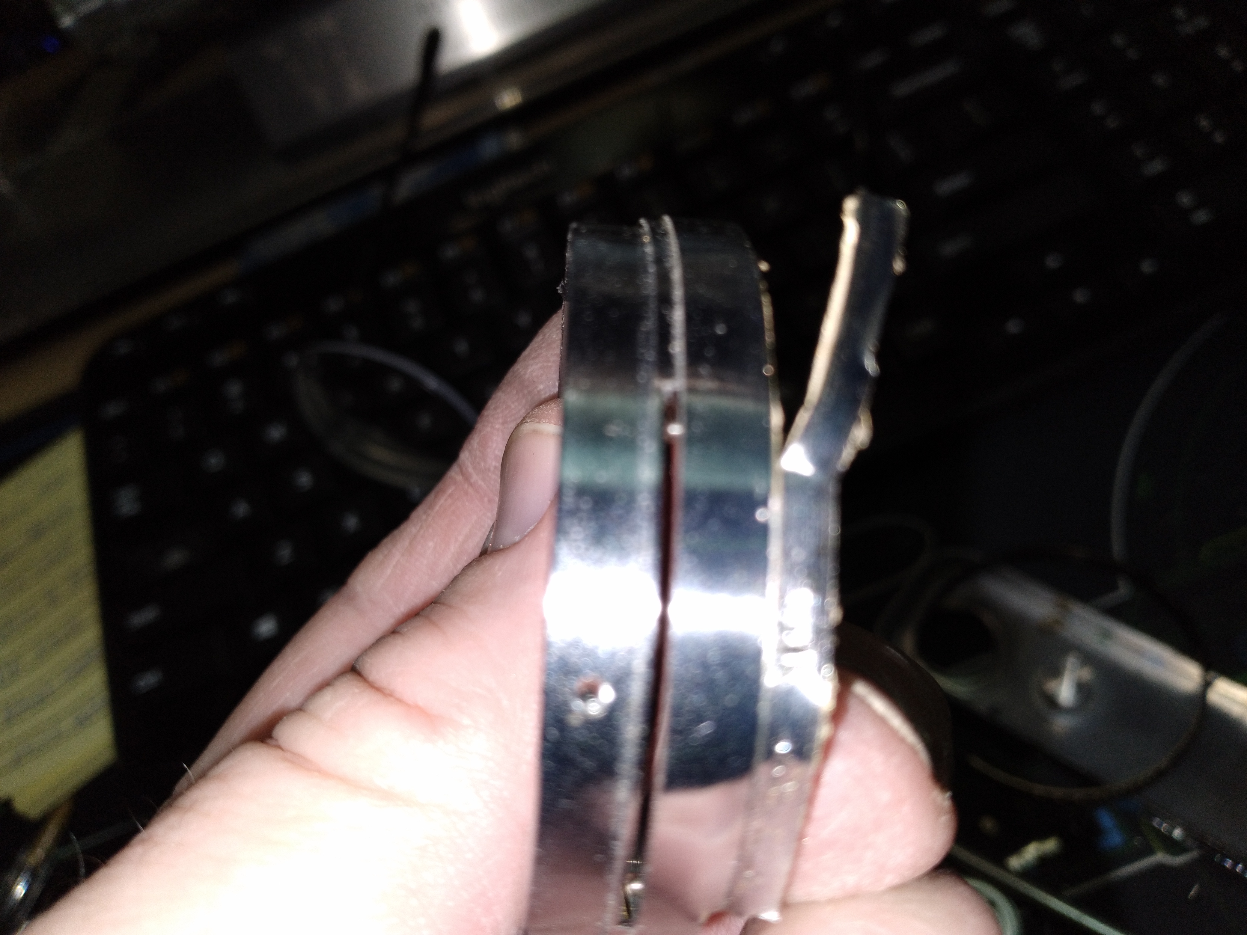

Okay now that you have cut or bent/broken off the excess this is what you have.
Even of you file the rough edge it will still be a uneven fit and you will see there is a notch area where a little lever came out. So first to glue it on use superglue gel, or something similar. It needs to be a gel. This is just to glue the two pieces together. Then, and I have not done this yet, secure it all the way around with something like JB weld.

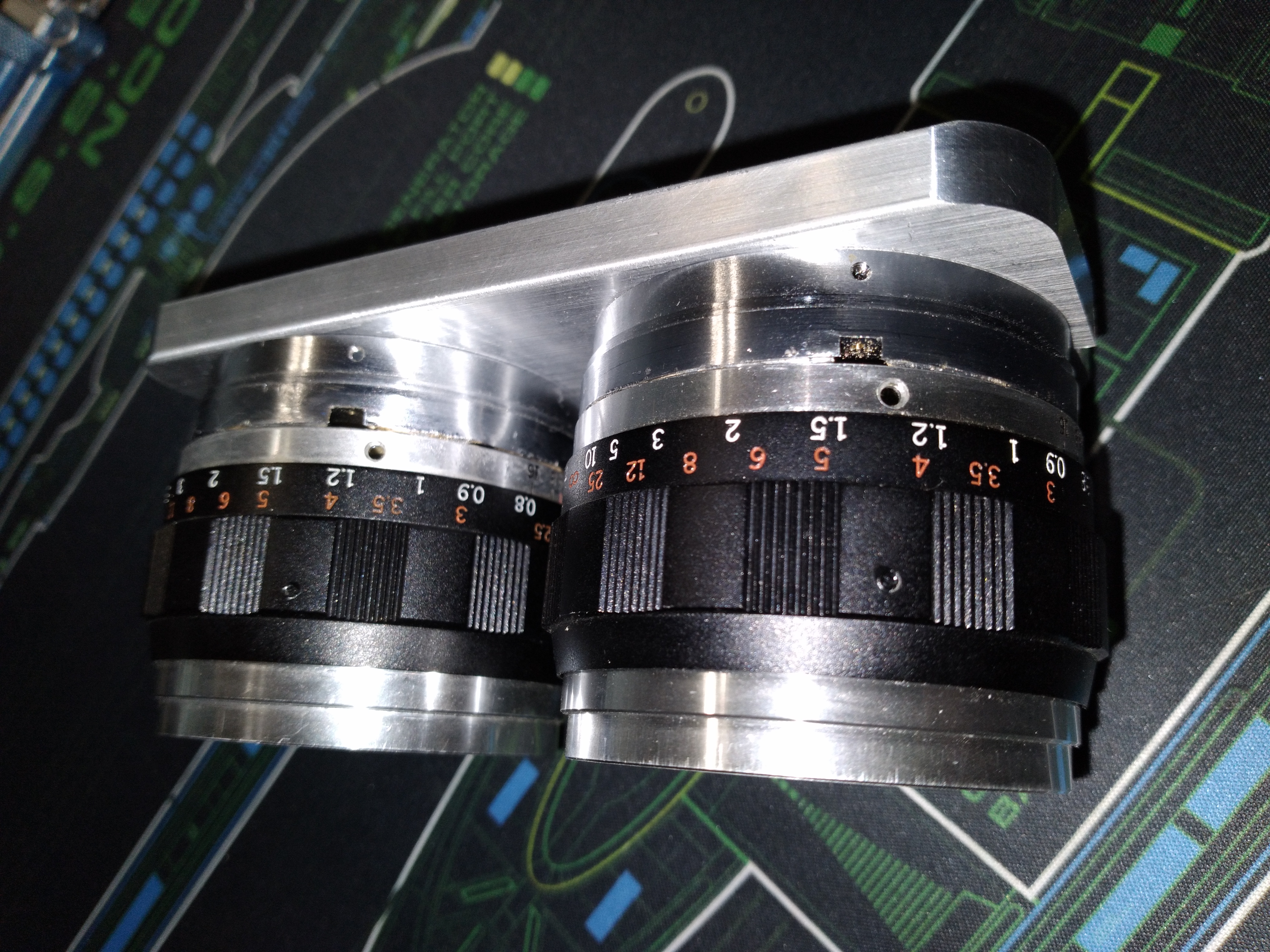

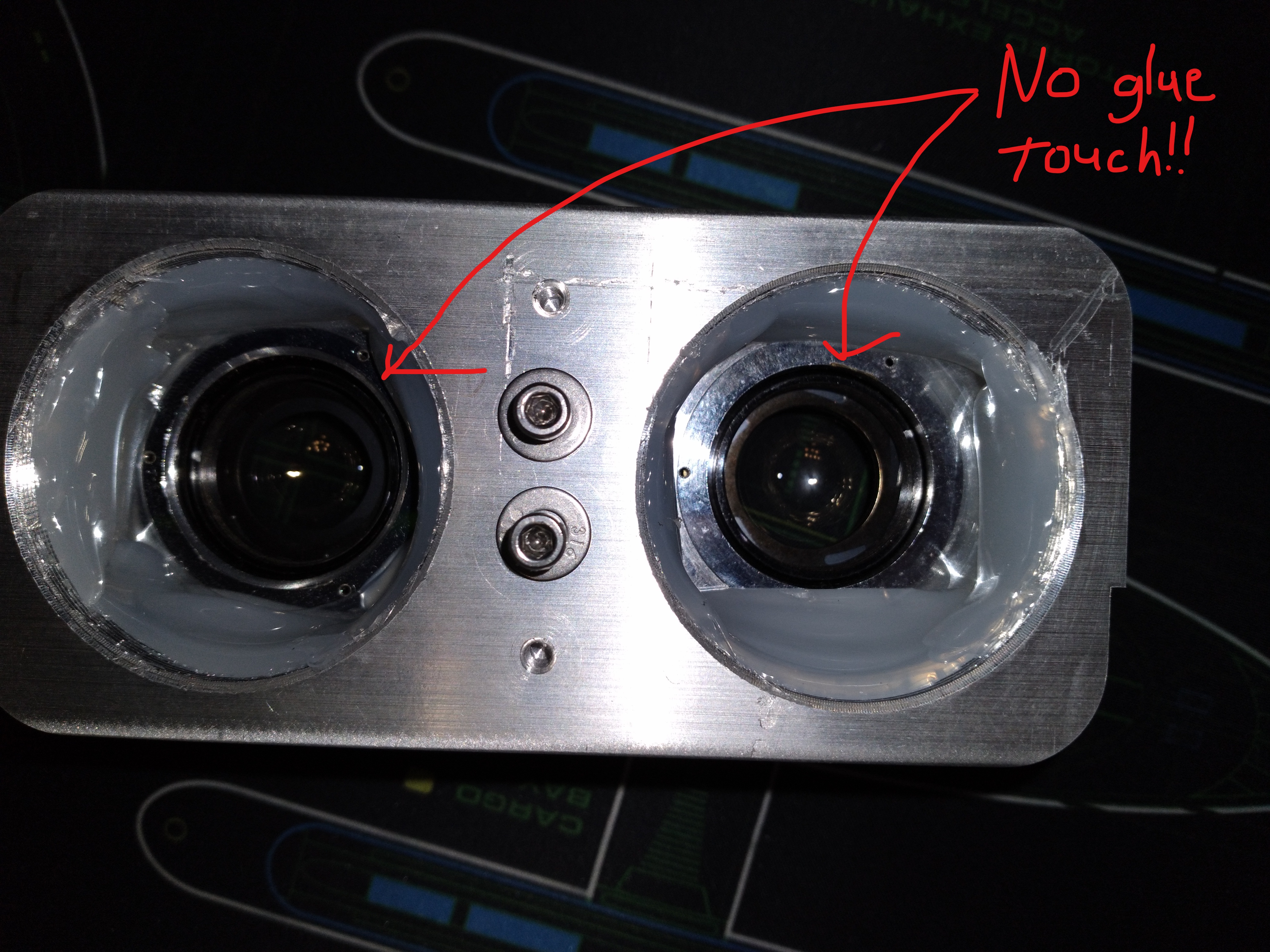

I had already bought a Dark Energy plate as I figured I would be getting resin lenses off a real one. Really wishing I snagged those Kaligar modded ones in the Junkyard right now, but I already bought these.
Anyway I hot glued them on the plate. The idea being I can take it off and use the plate if I ever manage to snag real ones, but I would likely just sell this as a set and get a new plate. Be careful not to glue the lens part in the center. If you do your lenses won't spin. Do one side at a time giving the glue time to dry and not hitting the center.
Still need to JB weld the seem and add the detail ring but you get the idea.

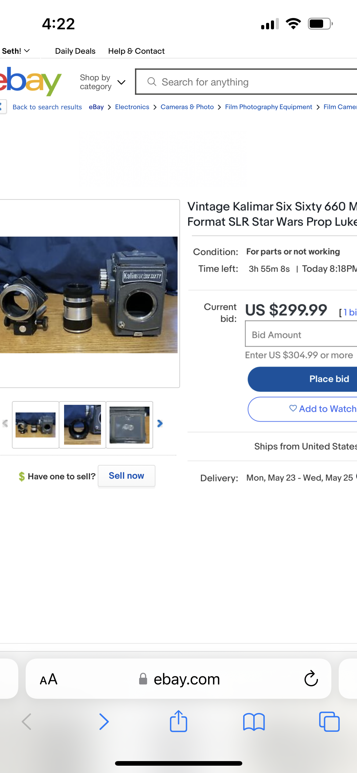

This one? It’s not mine. I hate to break it to you, it’s probably going to get worse. These will one day dry up.
Gee thanks! Lol
Like I said, go for it. :love: :lol: (y) :eek: It just amazes me how much a piece of an old camera goes for. There were tons of these and you would not think there are that many fans who want macros compared to how may of these there were made worldwide back in the day, but man oh man.
If I had the coin I would snag the full build one in the Junk Yard. I have been so tempted to break my no credit rule, but I resisted.
Congrats on the sale by the way.
Yep that’s the one, it wasn’t me that bought it though, I’ve seen them go for much higher as well. Though there are alternatives,
Haco, Soligor, Fujitsu, Fodor all made very similar cameras. Though those also are not cheap.

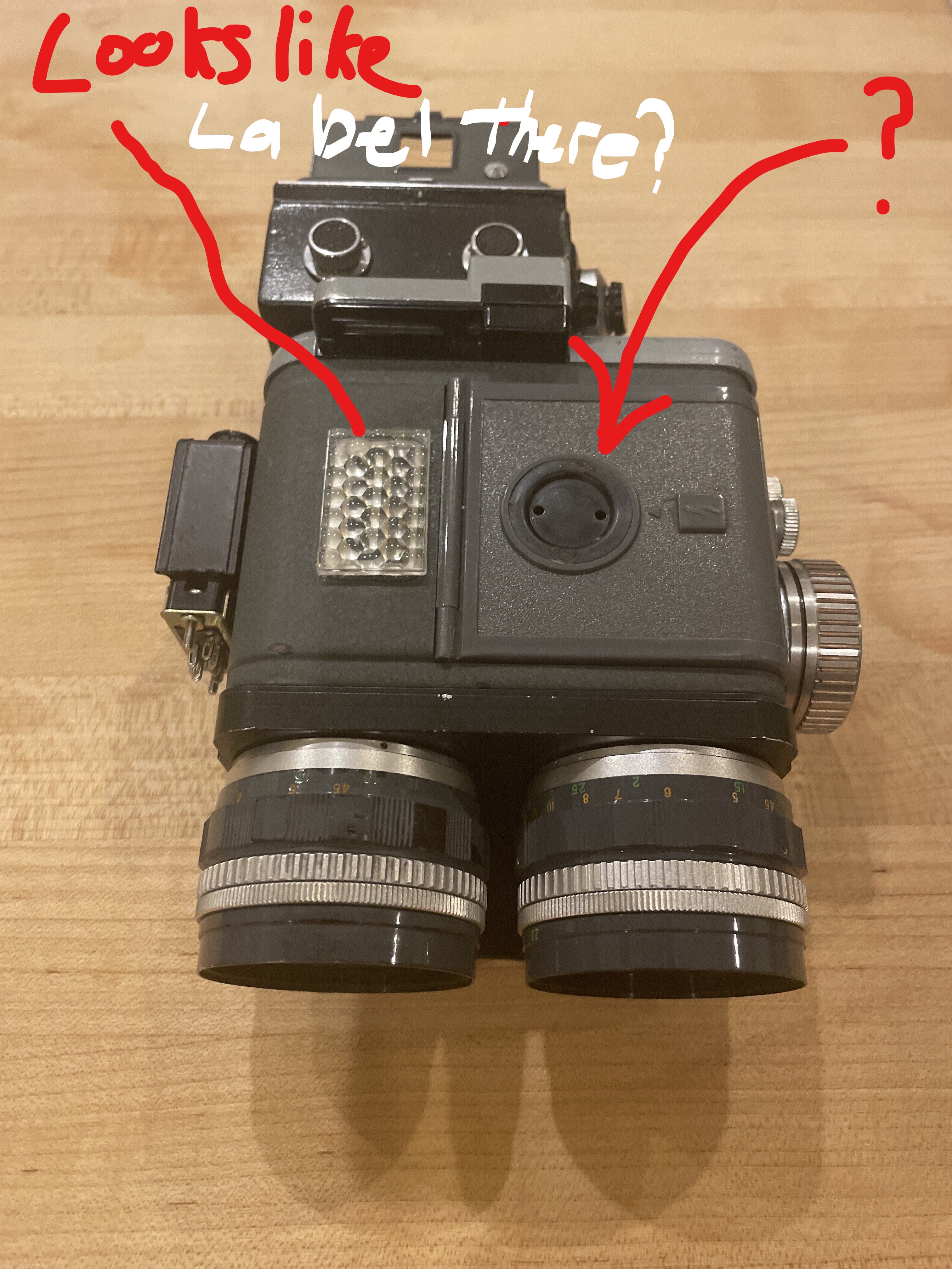

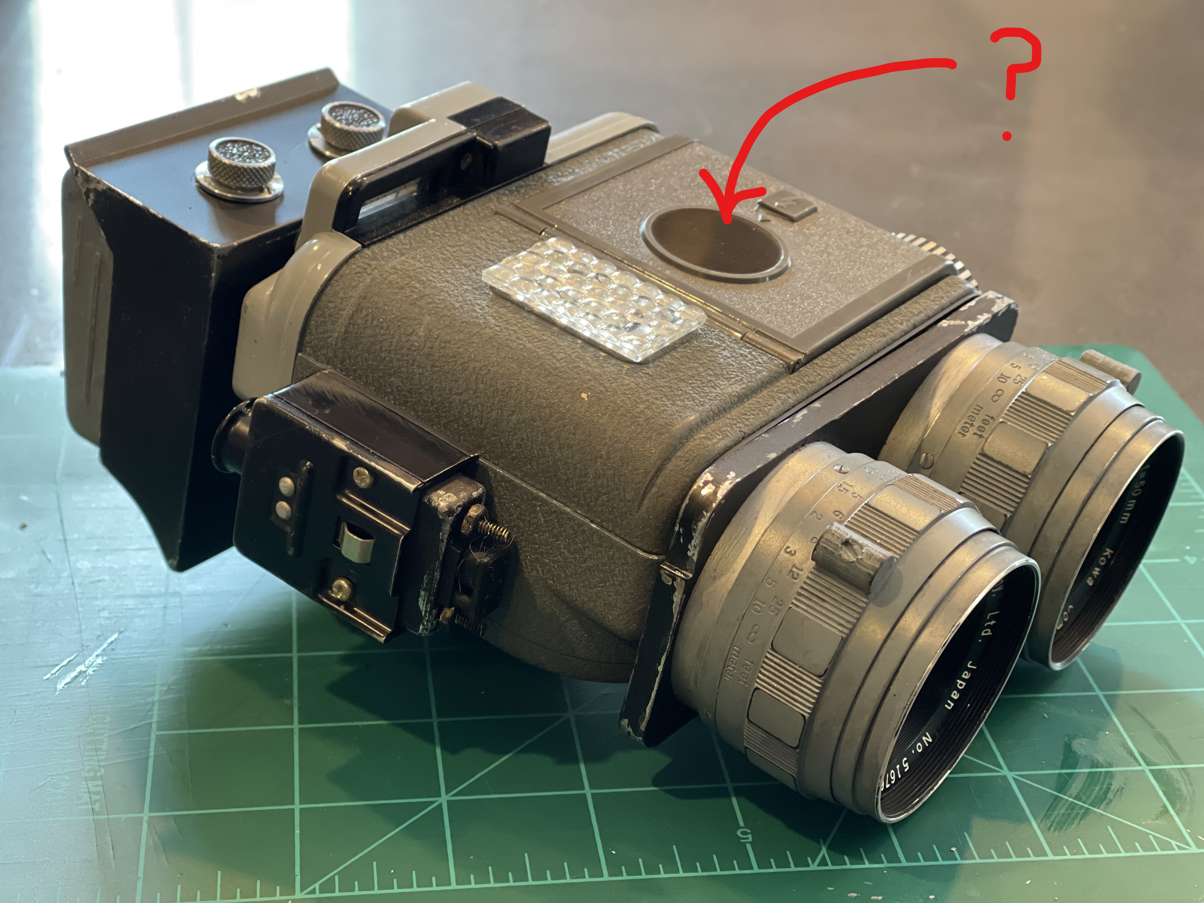

Need help again.
Which black circle is correct? The first one that is a flipped numbered disc from the Eumig:
Or this one. Also is the bubble piece over the Eumig label or is the label removed?
Thanks
Need help again.
Thanks
The bubble strip is definitely over the label, they tend to always cover up anything that says it’s from Earth. Also the disk is there but I’m guessing it could have fallen off later which typically happens with Star Wars props. I have it on mine, I’d have to dig up all my references if you want specifics. I do have a reference photo of it missing in an exhibit after Star Wars but in ANH I believe it’s there.
