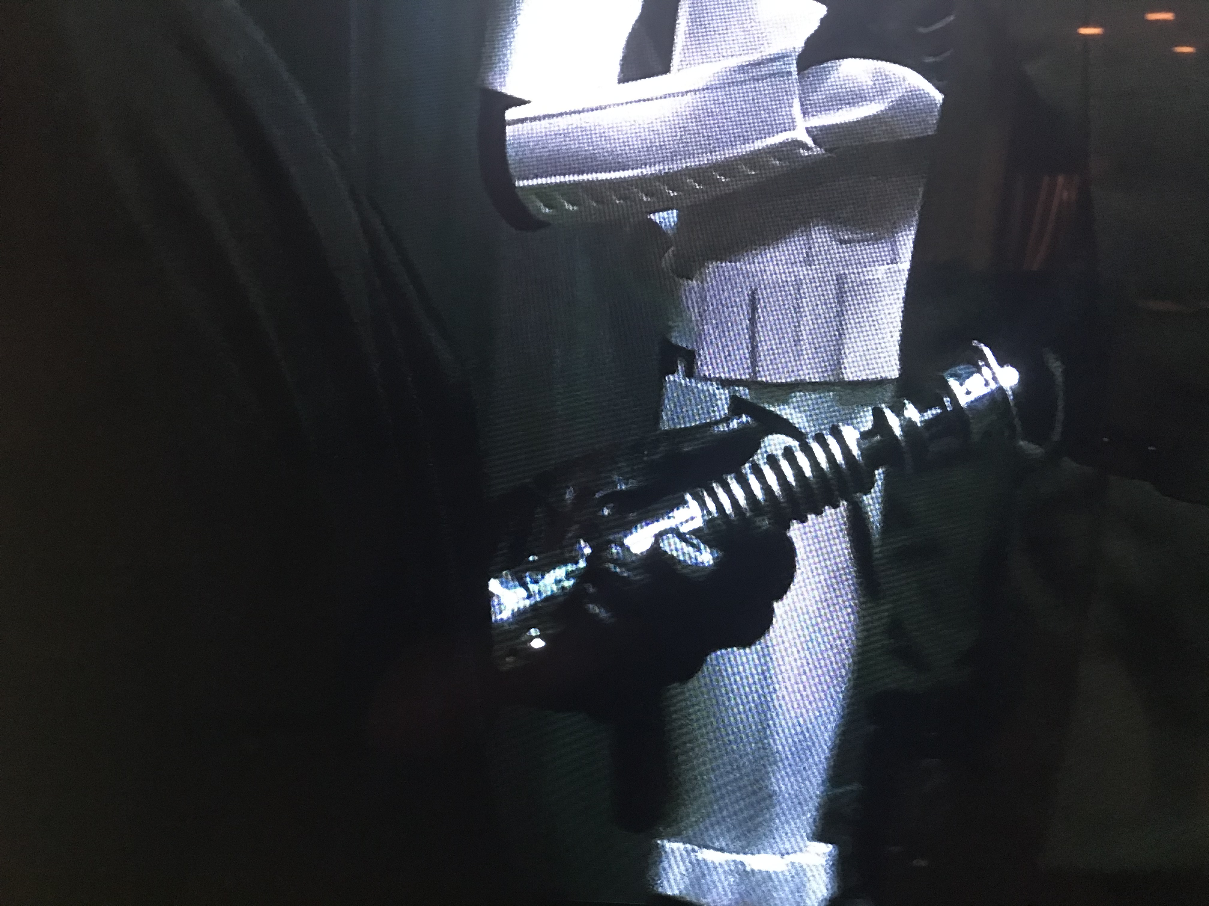

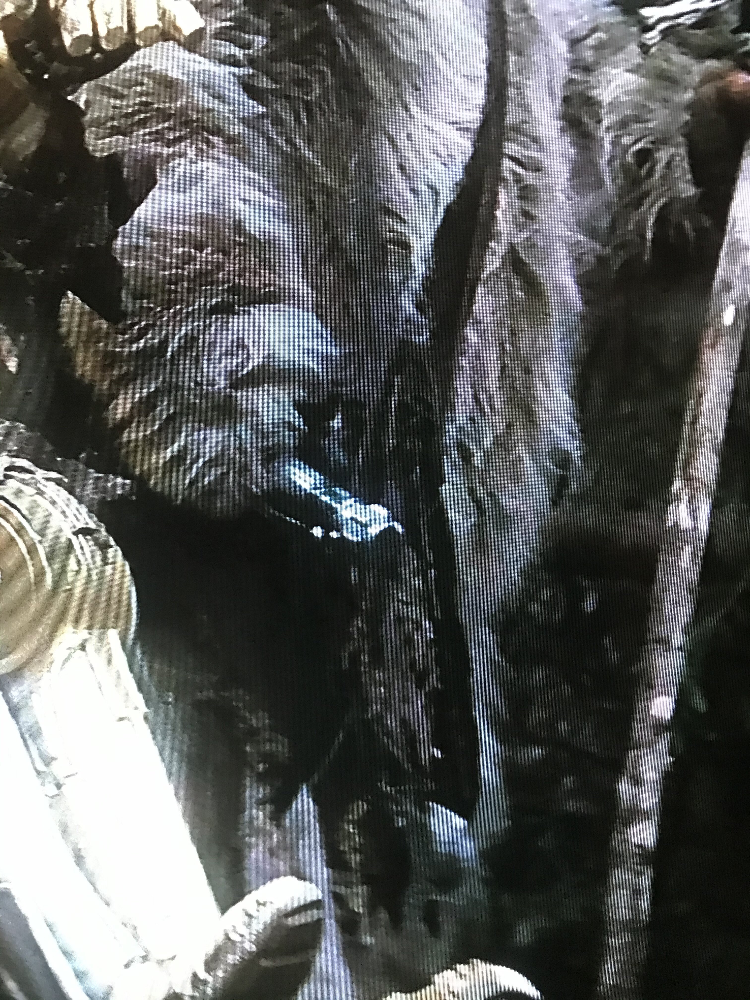

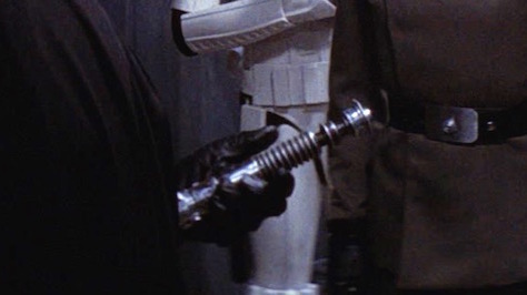

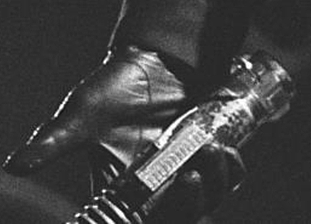

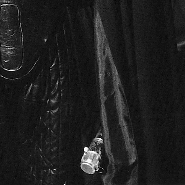

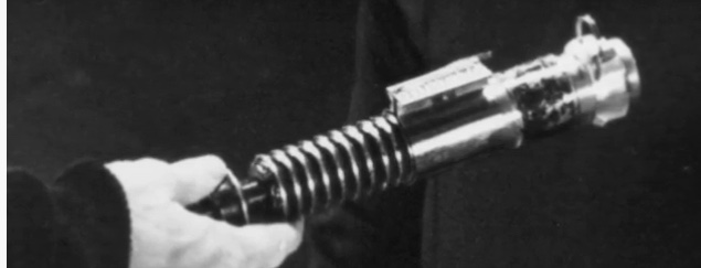

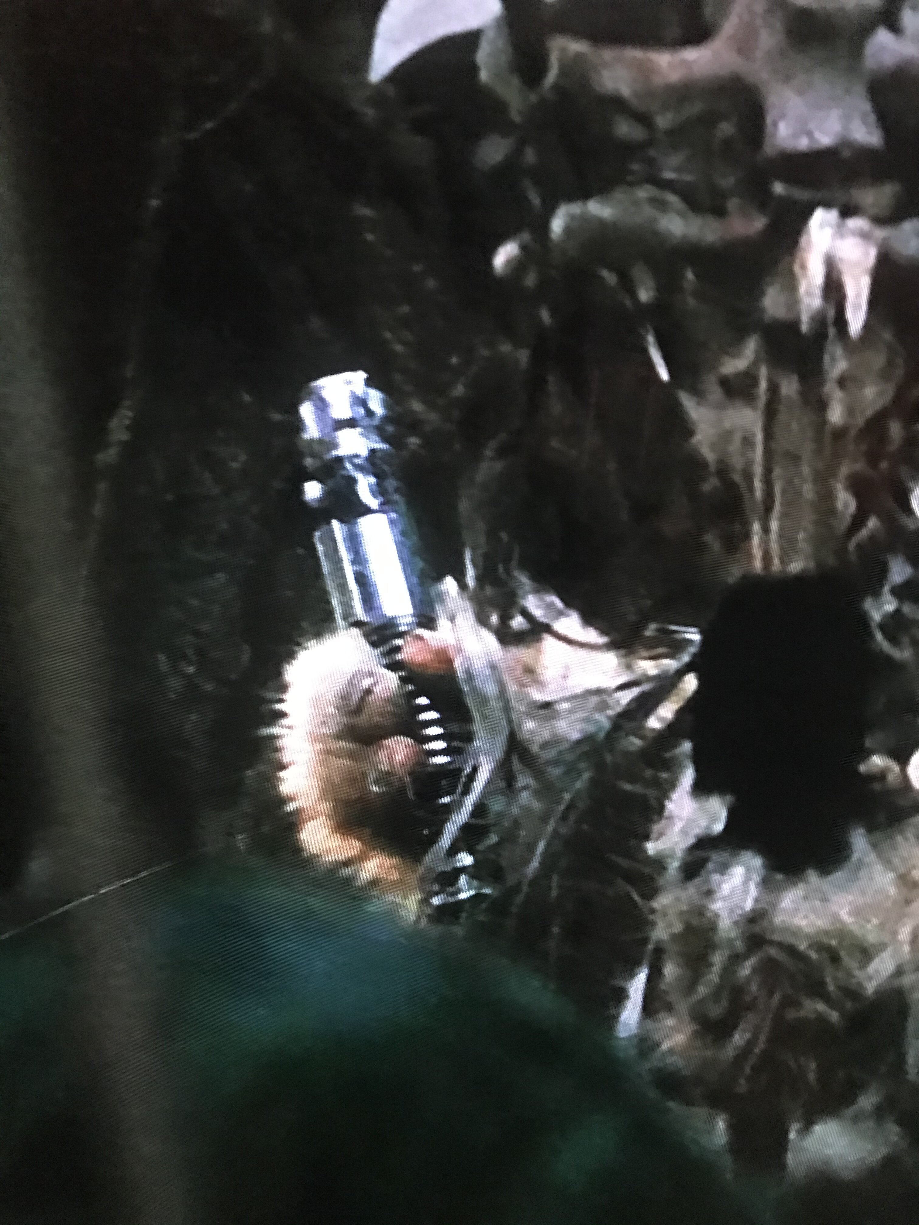

I don’t know which was filmed when. The V2 still has more booster paint in the sandstorm, Ewok village, and some throne room scenes.
Random pics for reference. I have my AS painted as the saber is now. I’ll be painting my SH with this amount of weathering.
