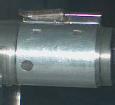

Question for the v3 clamp DIYers - where do you drill the center hole? Is there a good template floating around?
My only reference is this:
and I think it is over the L or somewhere in-between the F and the L (but still closer to L) of the "G R A F L E X" label.
Trooper_Trent and I made a template that you can download and print out, let me see if I can find it
First post, at the bottom. Make sure your printer is set to 100% scale
this is hilarious, we have secret info that contradicts one another :D:unsure: maybe we'll get some good shots of the thing in the near future. If it is unmodified, they must have taken material off the clamp area of the cast, I have a copy of the unmodified cast and it's too big
I can confirm 1000% the hole in the box is unmodified.
I use Roman's out of convenience but when I do them myself, it's somewhere between "L" and "F" and closer to "F." Though looking at this now I'll have to revise it.
