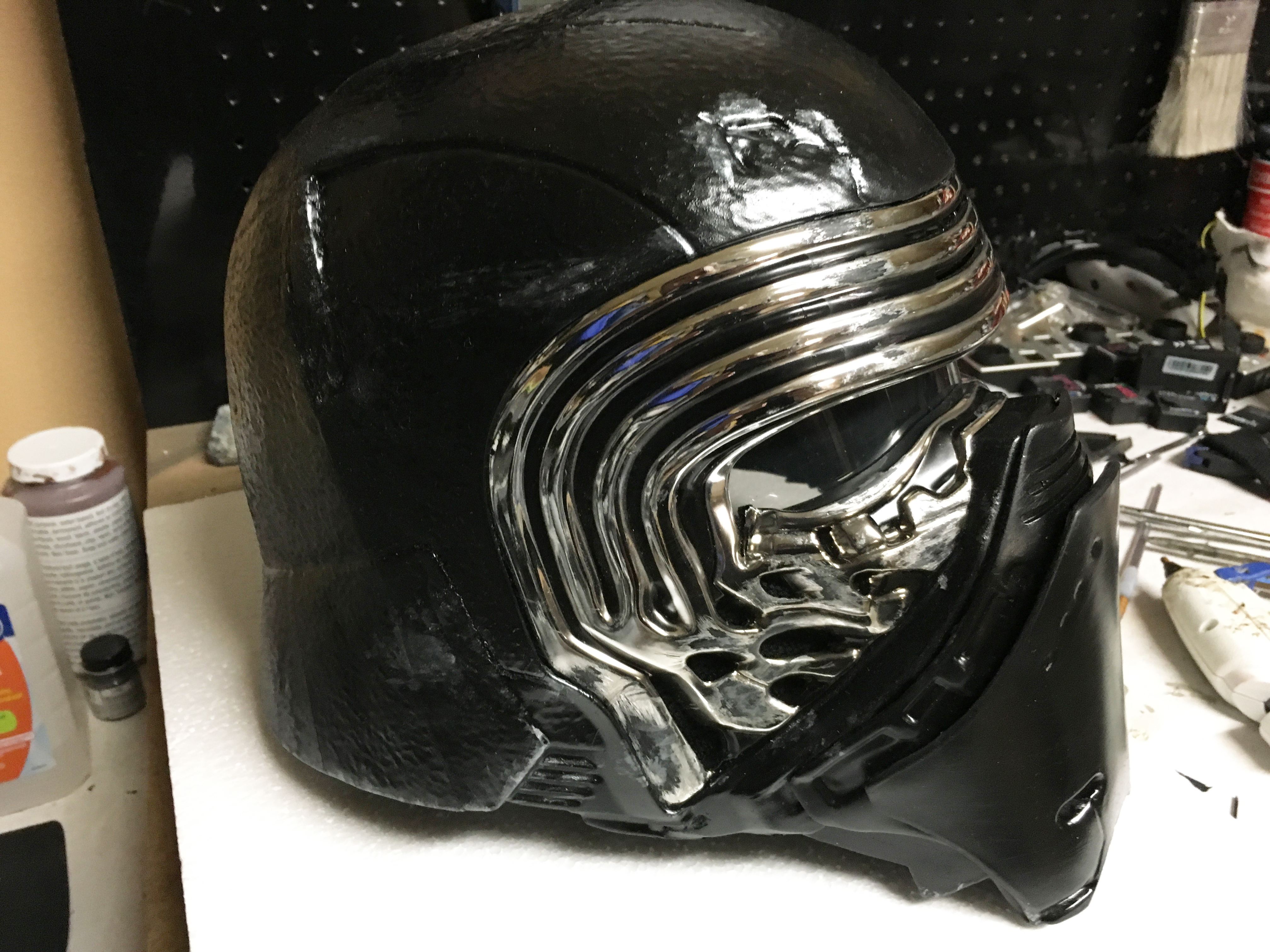

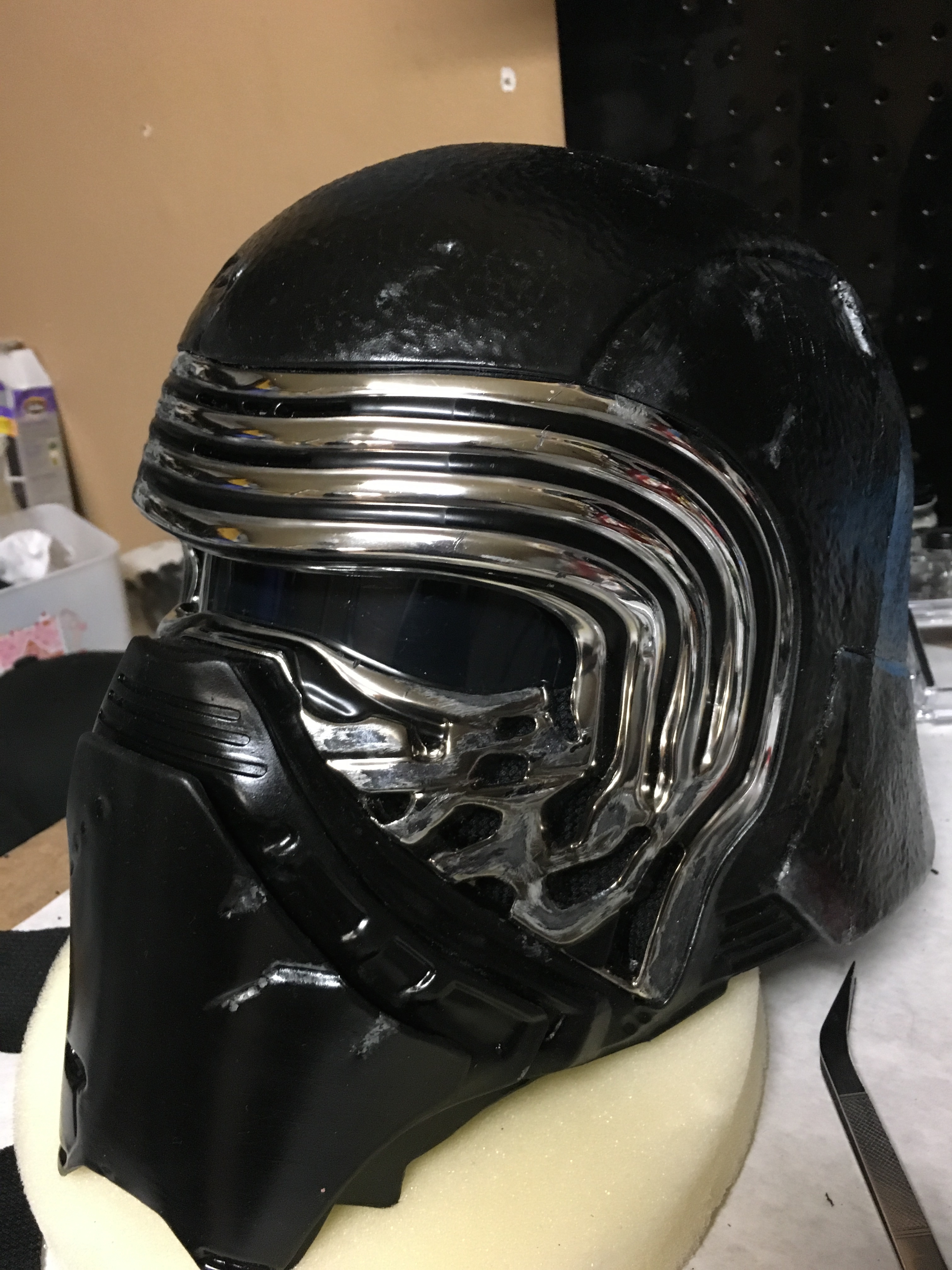

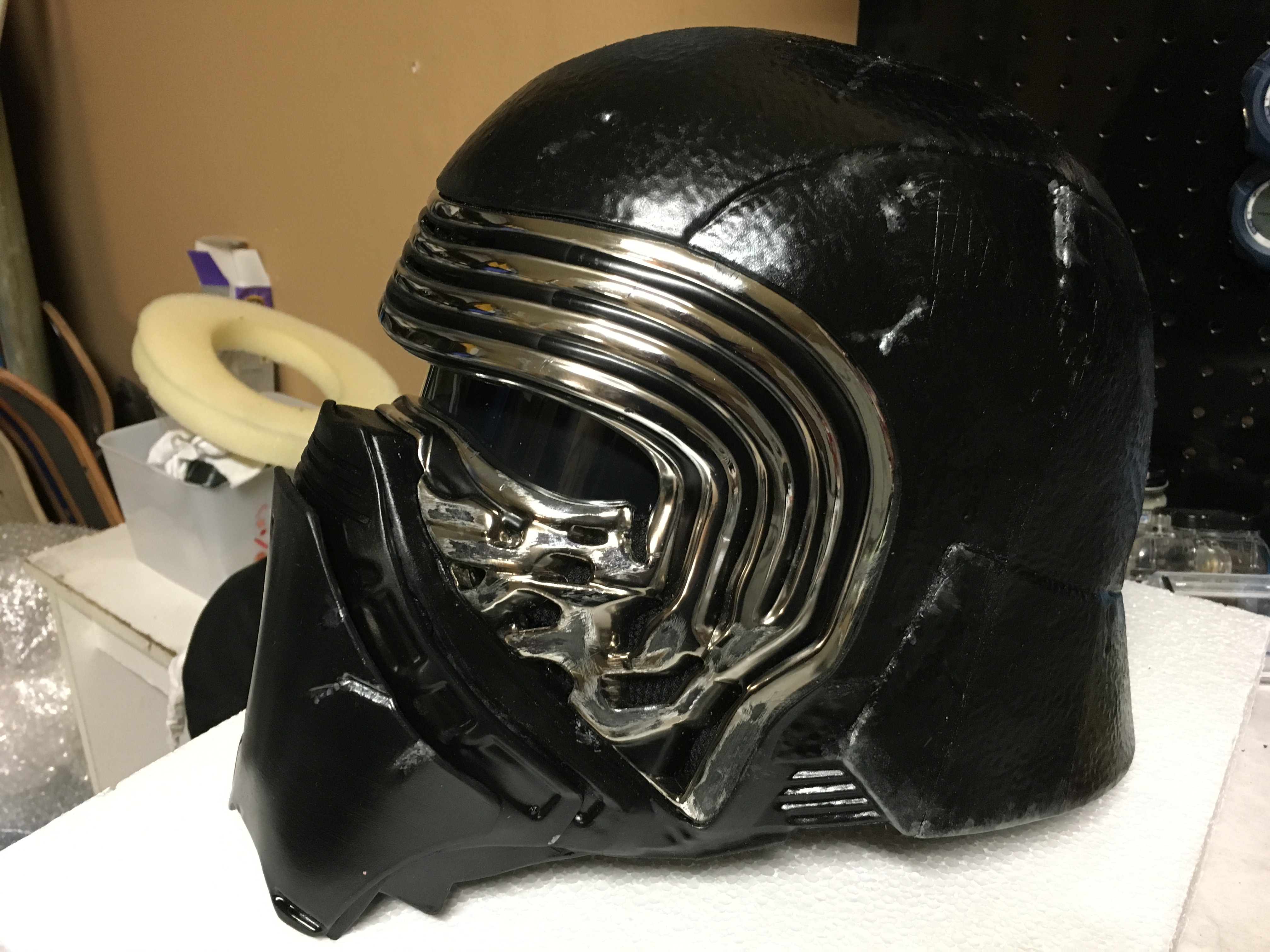

Damn brother, just when I thought I had killed it with my mod. I find your thread and now want to tear mine down and re-work it. Your helmet is freaking insane. I ended up cutting off the nose and attaching on the disney ($26) mask. It has a much better nose piece. Love what you did with the chrome and the nose piece. I want to go back and fix mine now. Yours looks so good. Here is a pic of mine, I still need to replace the visor but was not sure what to use. Will visit the hardware store tomorrow. Thanks for the inspiration...planning on reworking mine now.

Thanks man, I saw your post on the BS helmet thread, Although I like the smaller one better, since my front snoot is removable I might take out a disney store mask and make mine switchable. The nose part really makes the helmet look great from the side, the original one made it look like a toy.
