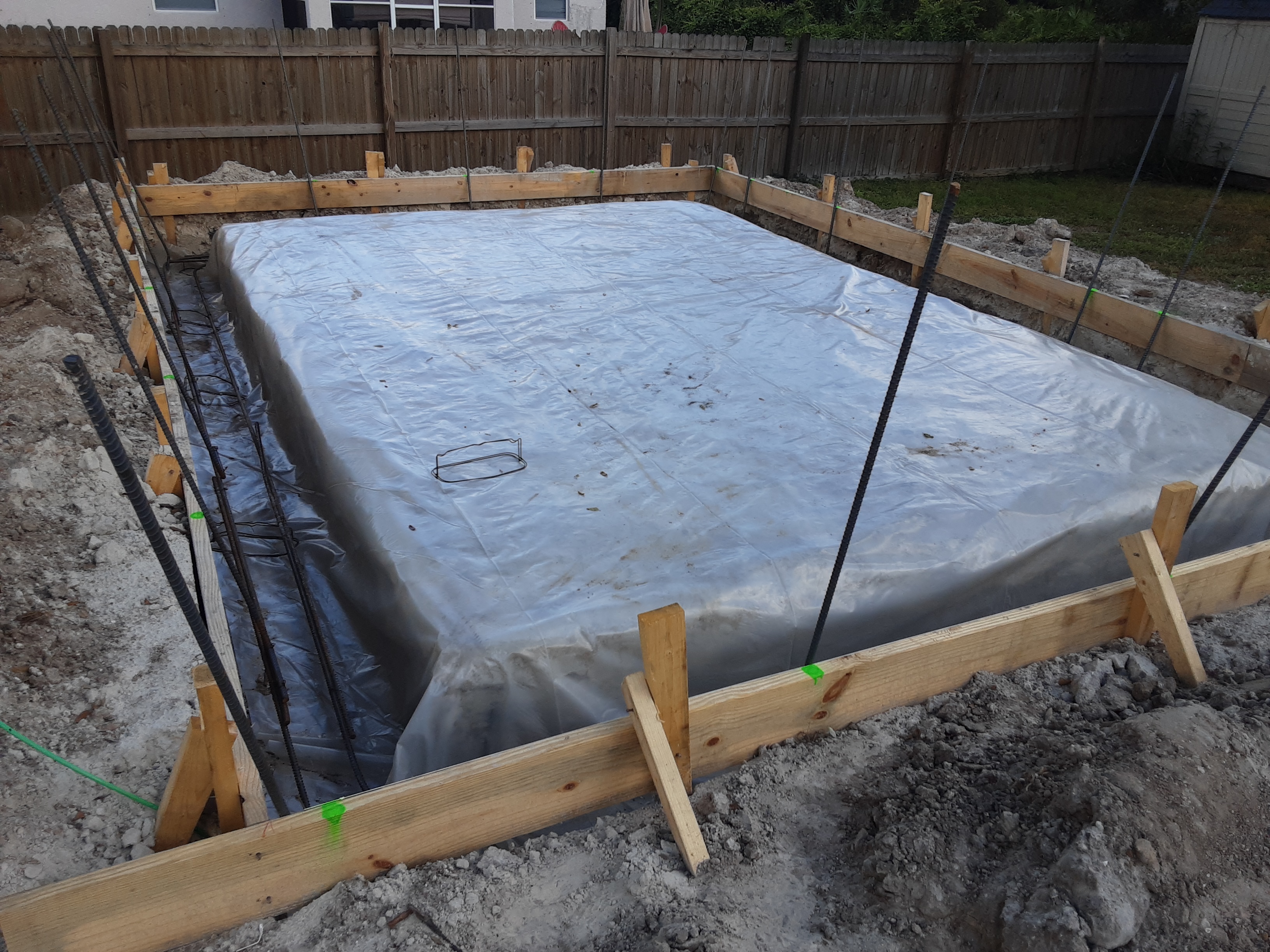

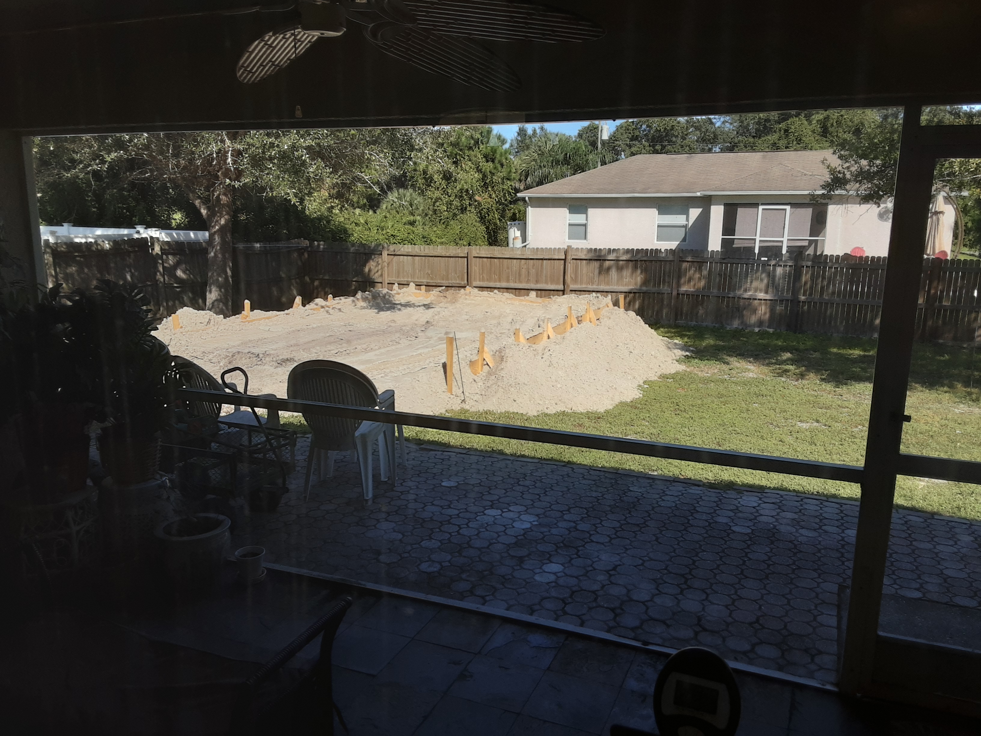

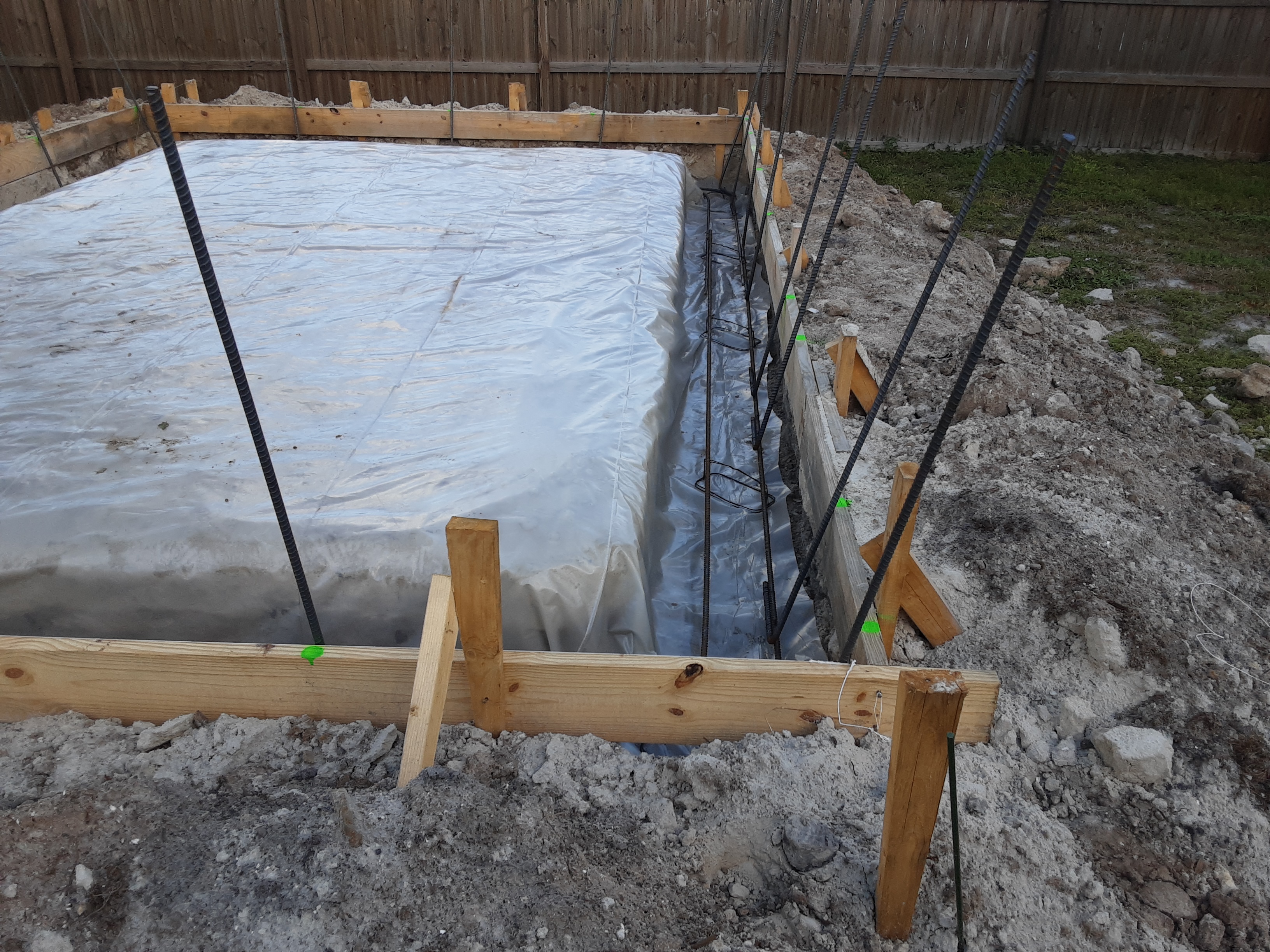

So far, what you see is the slab formed and the footers dug out. Next step is the footer steel, footer electrical bond and a termite treatment. Updates coming soon

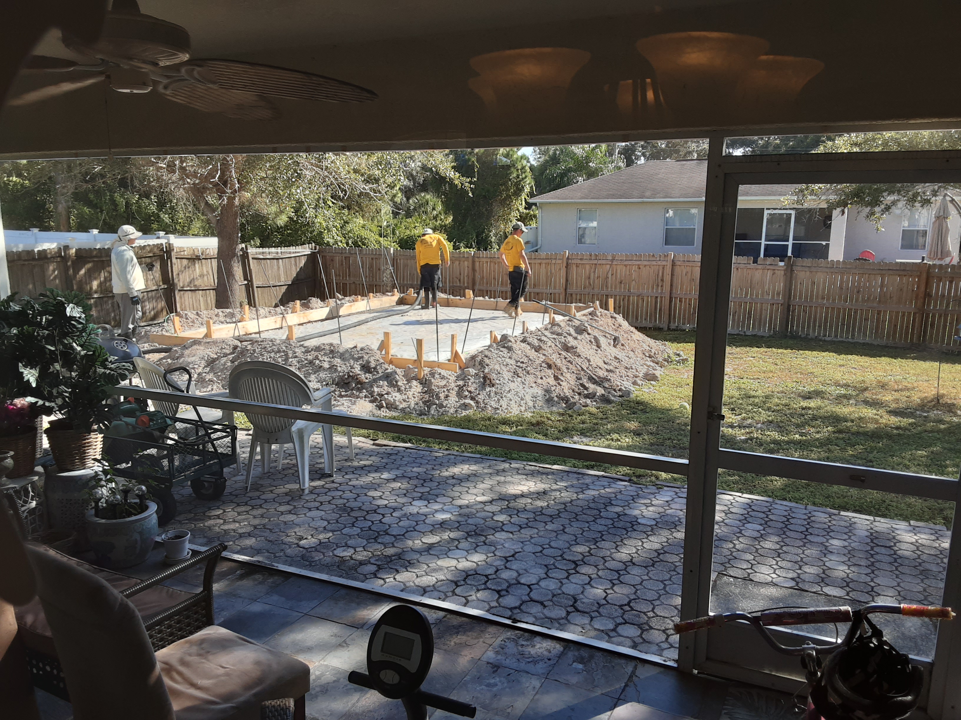

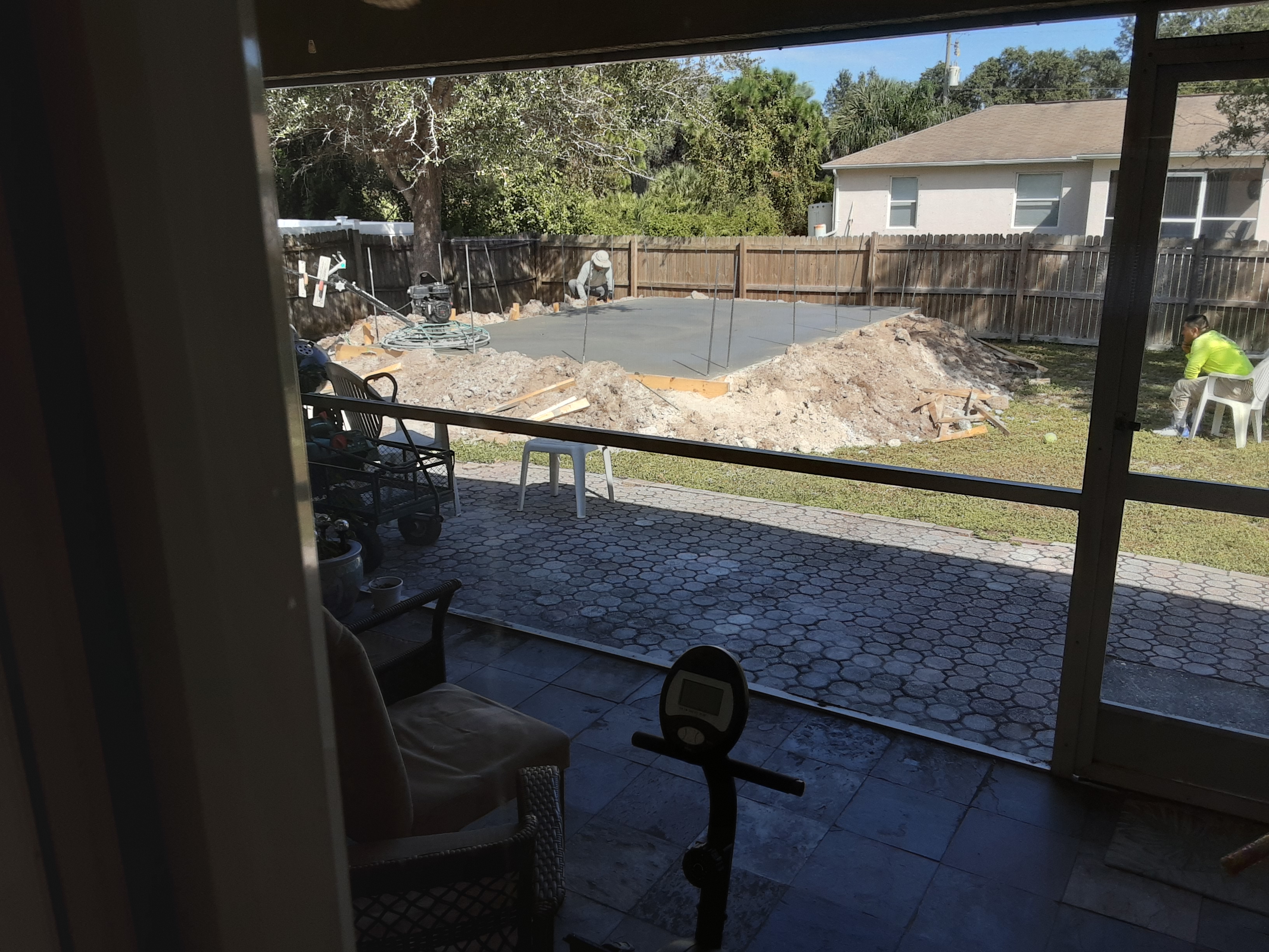

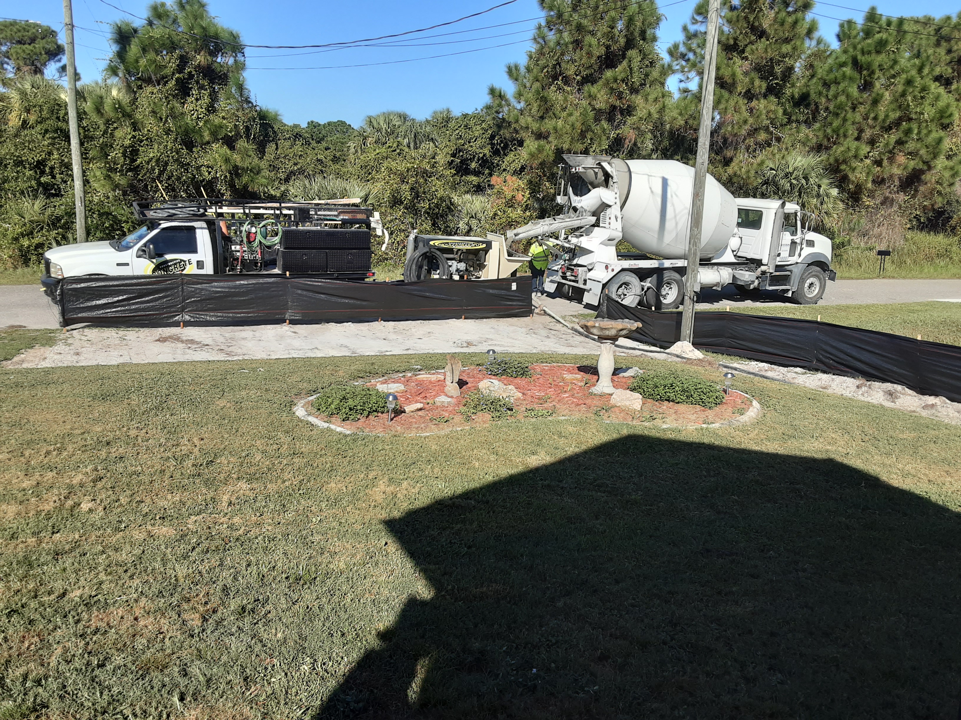

Poured today.
They used a pump to bring it to my backyard. Ready for blocks after it hardens for a few days.

You're much higher and you're soil is actually soil and not sand like ours is. Swimming pools are 5 foot deep on the average and have to be built using a sump pump through the entire process before finishing and filling otherwise water gets in and it will literally pop out of the ground. Go figure. Lol. If they have deeper pools, they're built up or pretty old.

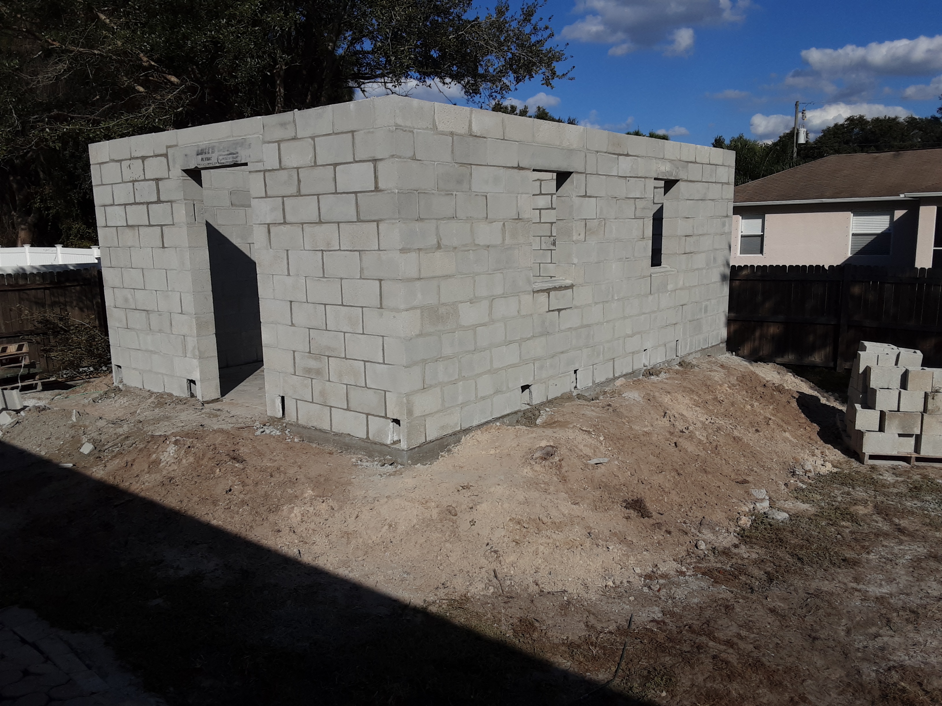

I could have gone the stem wall route but that would have cost a lot more.(more than double) It would still have the same deck height however instead of fill, it would be solid concrete on the sides with some fill in the middle. Footers would be under the stem wall.
My daughter sent me a text saying "there's a building in our backyard "
Sure enough, yep.

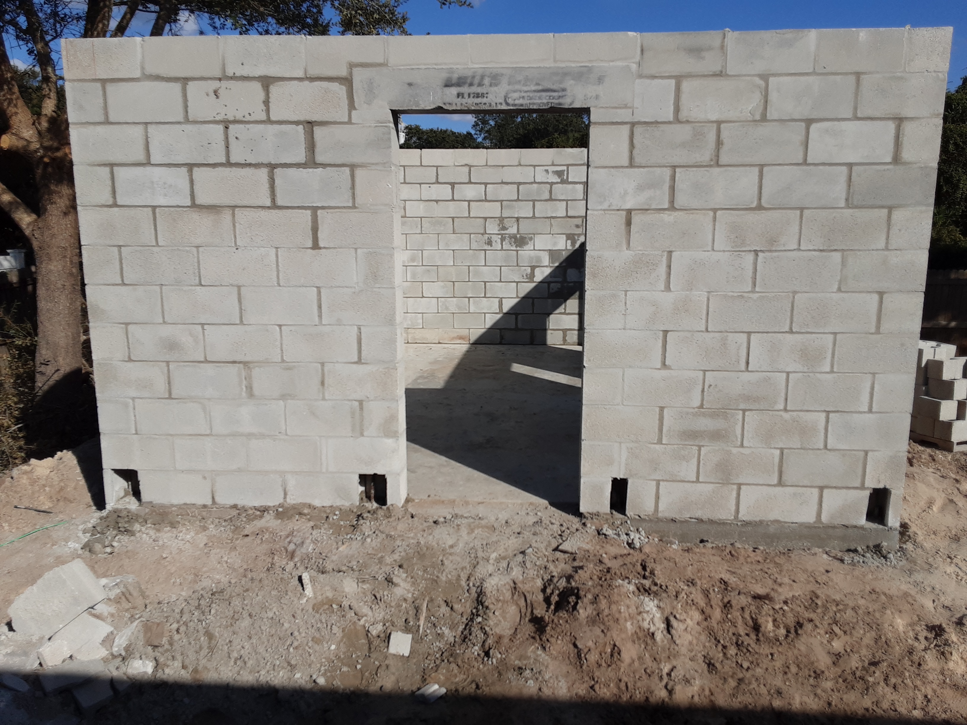

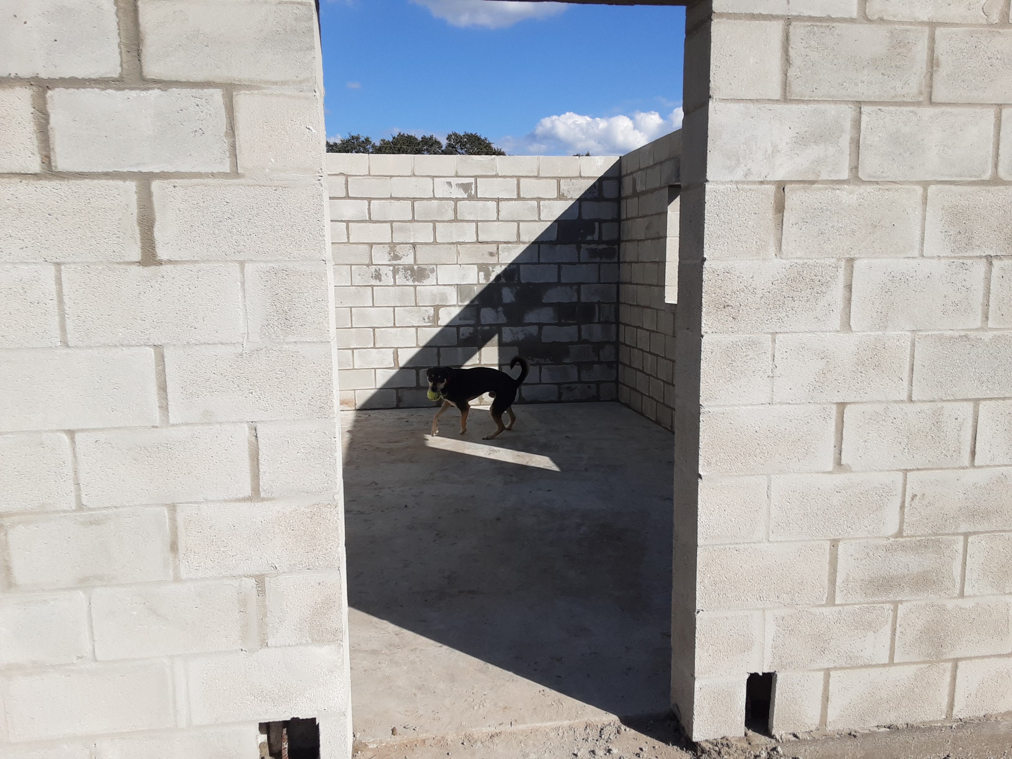

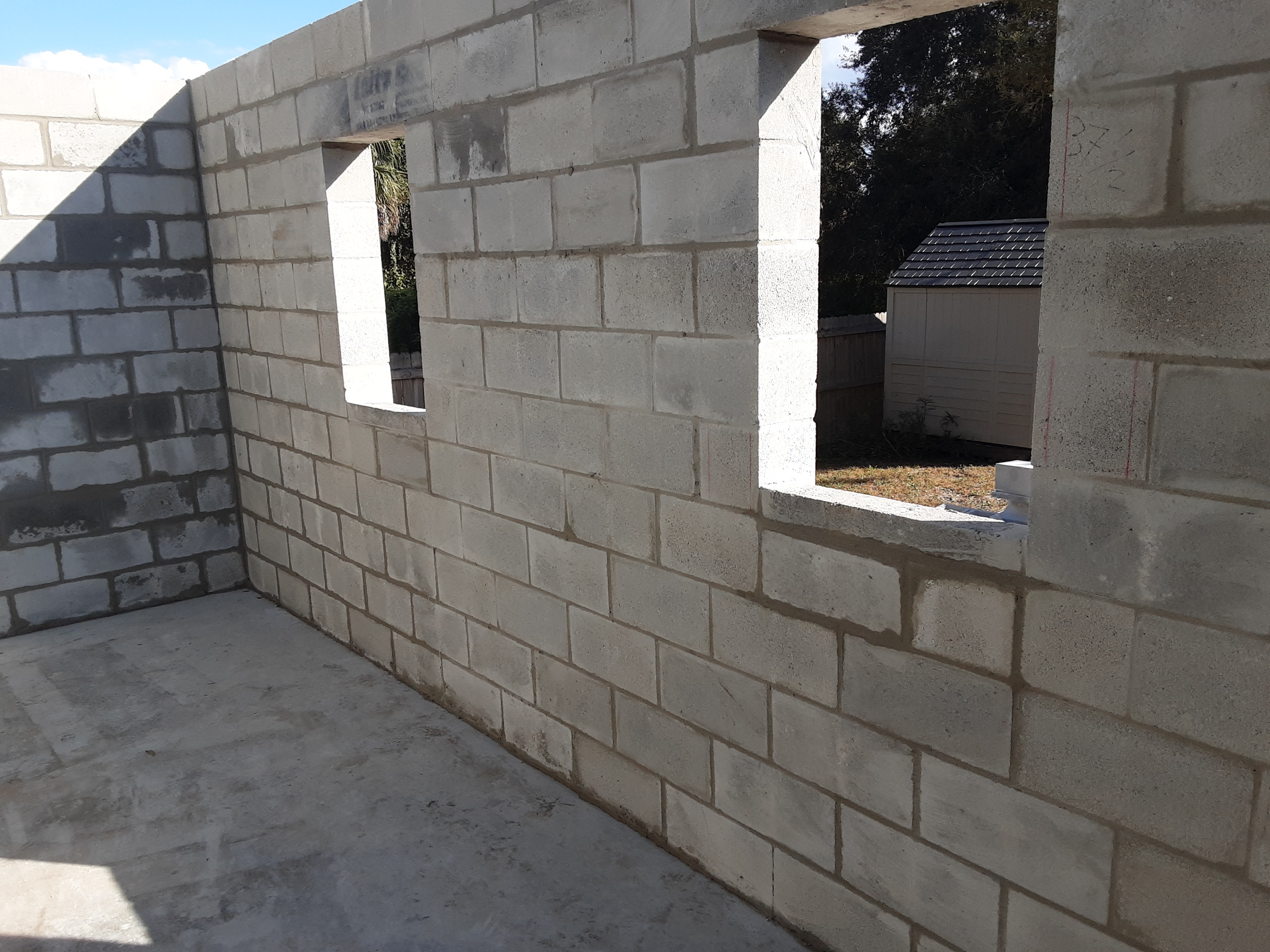

Next step is the rebar reinforcement with solid pour concrete every 2 feet. That's what the cuts are on the bottom of the walls. They're inspection ports. You will also see the hurricane straps sticking out of the top during the next phase.
wow! block building i had no idea!
This will be a vault . I have to protect my props and toys. :lol: ;) :lol:
Partially true-- This is being built as living area so it has to be built to meet current local Florida building codes. Solid pour concrete blocks at 2 feet and Hurricane straps on the roof, impact glass windows storm rated door and fully climate controlled
