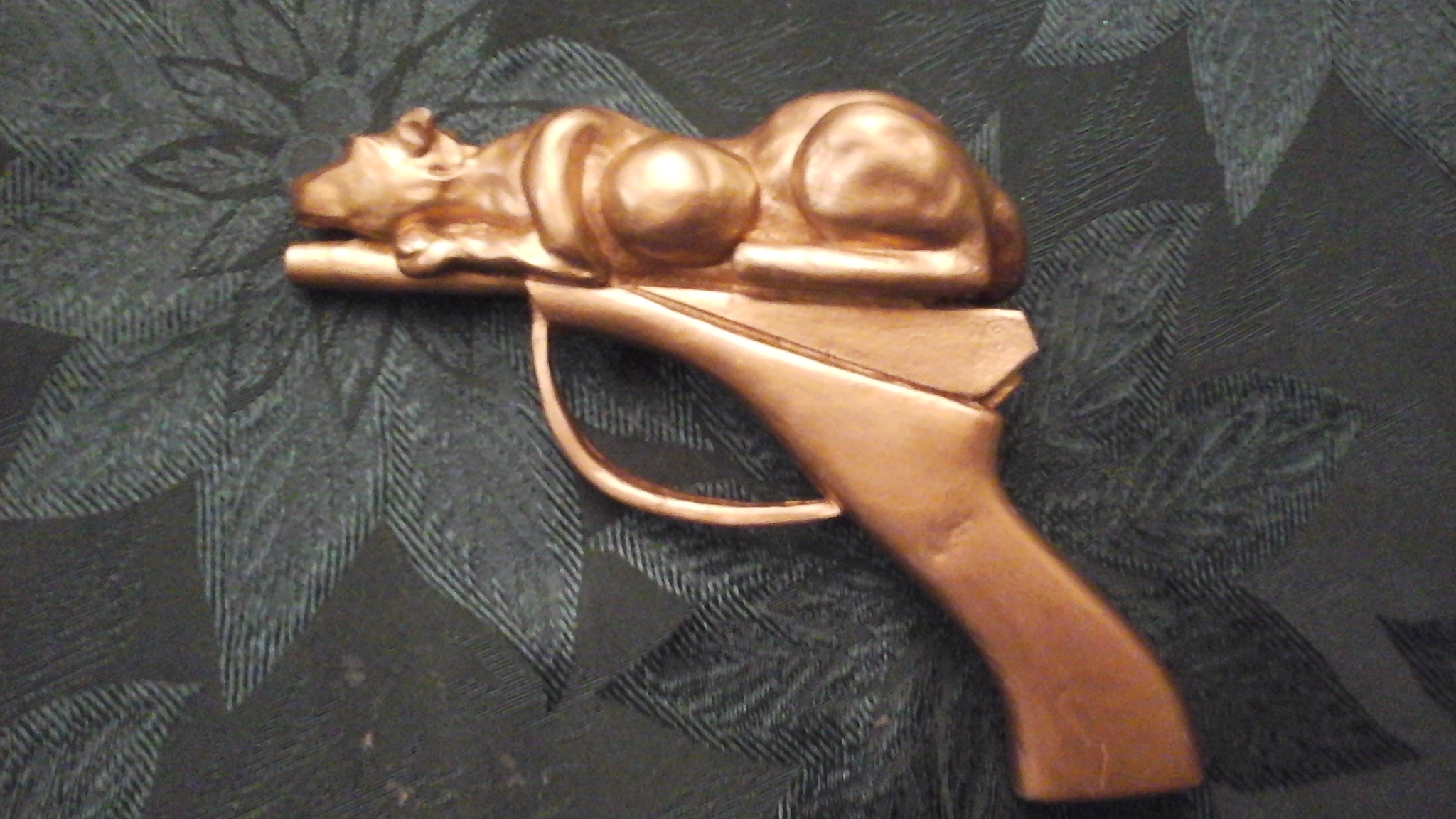

Kinda looks like it could be a star wars blaster. Wasn't there a character that looked like a cat.

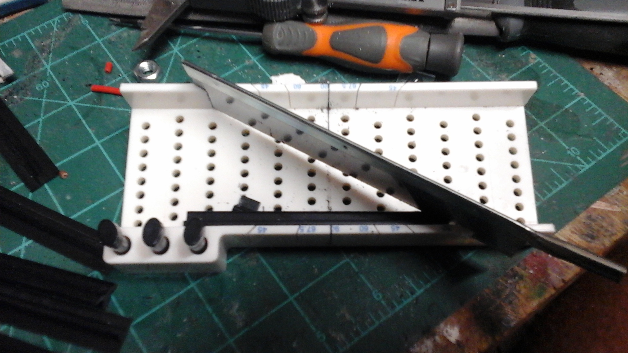

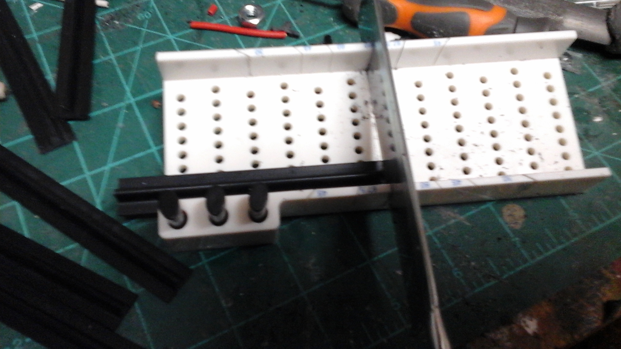

In light of romans latest update (graflexs are so close to shipping) I went ahead and cut my t tracks from Roy based off his ANH blueprint. My miter box came in very handy for this.

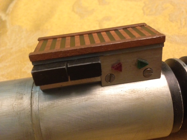

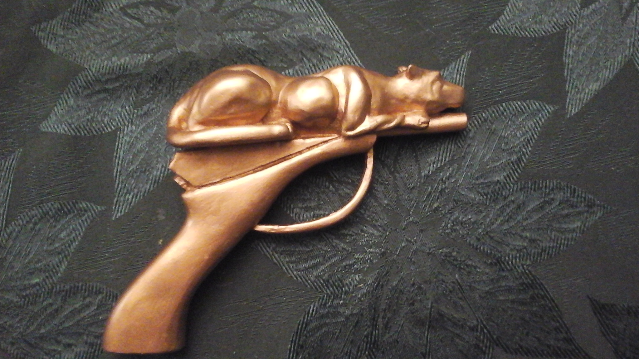

Been busy with work and getting ready for Christmas but finished this beauty
I didn't paint it. I used gold rub n buff. The spray would be too uniform and even. The rub n buff gave me the ability to polish up the parts that stand out while the under sides carry a different finish to look more realistic.

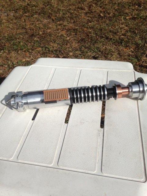

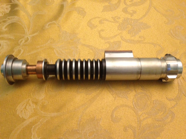

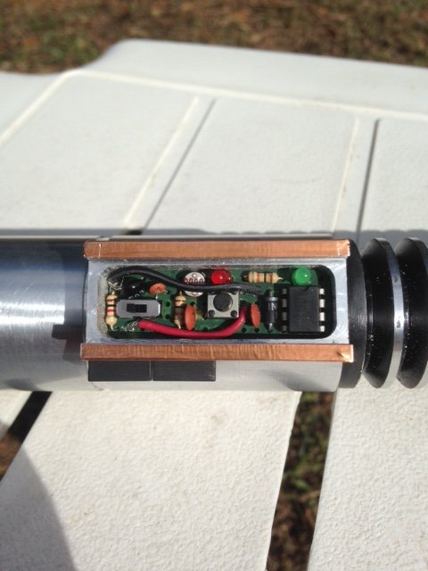

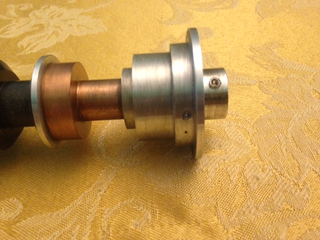

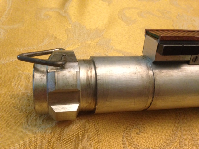

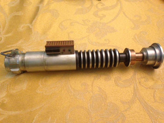

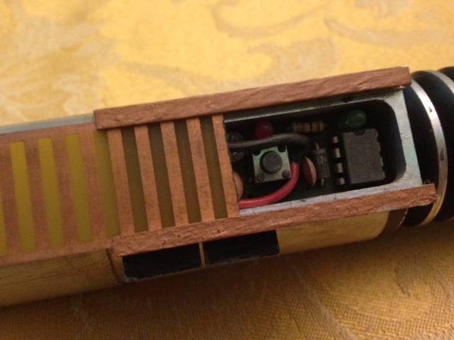

I went back over my hero saber from nicksdad. I decided to weather it some more, remove the copper foil and add copper paint. I also darkened up the inside of the control box and drilled out and tapped the 8-32 threads for the screw on the emitter as well as add another hole that I spied from Chaim's thread on the hero.
Before
After
Before
After

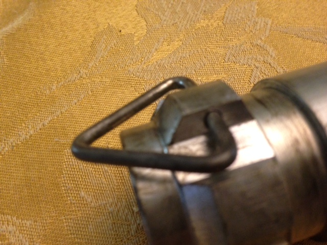

Here's a funky tip on how I weathered my ring. It's not painted! I used vinegar and black coffee. Just like an Easter egg. Same principle. I put the ring in a cup and poured vinegar in just to cover it and added some black coffee., about a shot glass. I let it sit for about a day. Once I liked the color I pulled it out.
looks great kevin!!!
Thank you, however I have to give Chaim's thread all the credit. I like how most have kept theirs new and clean but I really like the way Chaim did his. So after reading his post for a while, I dug mine out and remade it.
I might have to send my emitter to you and have you tap it and add the set screw... it looks great!

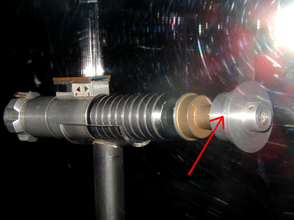

I have an extra screw lol. Came in a 2 pack. Simple hex allan head 8-32. Did you notice the other hole. It's drilled out to a 6-32 but un tapped. Chaïm found this in some research photos so of course I had to do it. Monkey see monkey do, lol. The screw is 1/4 inch long and fits perfect. Just deep enough to go inside without being visible inside the opening, and not sticking outside the emitter. The secret hole found by chaim is only drilled out around 1/4 inch at most. I drybrushed a hint of black around it so it stands out better.

Thanks Kevin for your kind words ... I think you maybe the first to actually replicat that additional hole ... it's not even on mine ... I just happen to notice it :)
