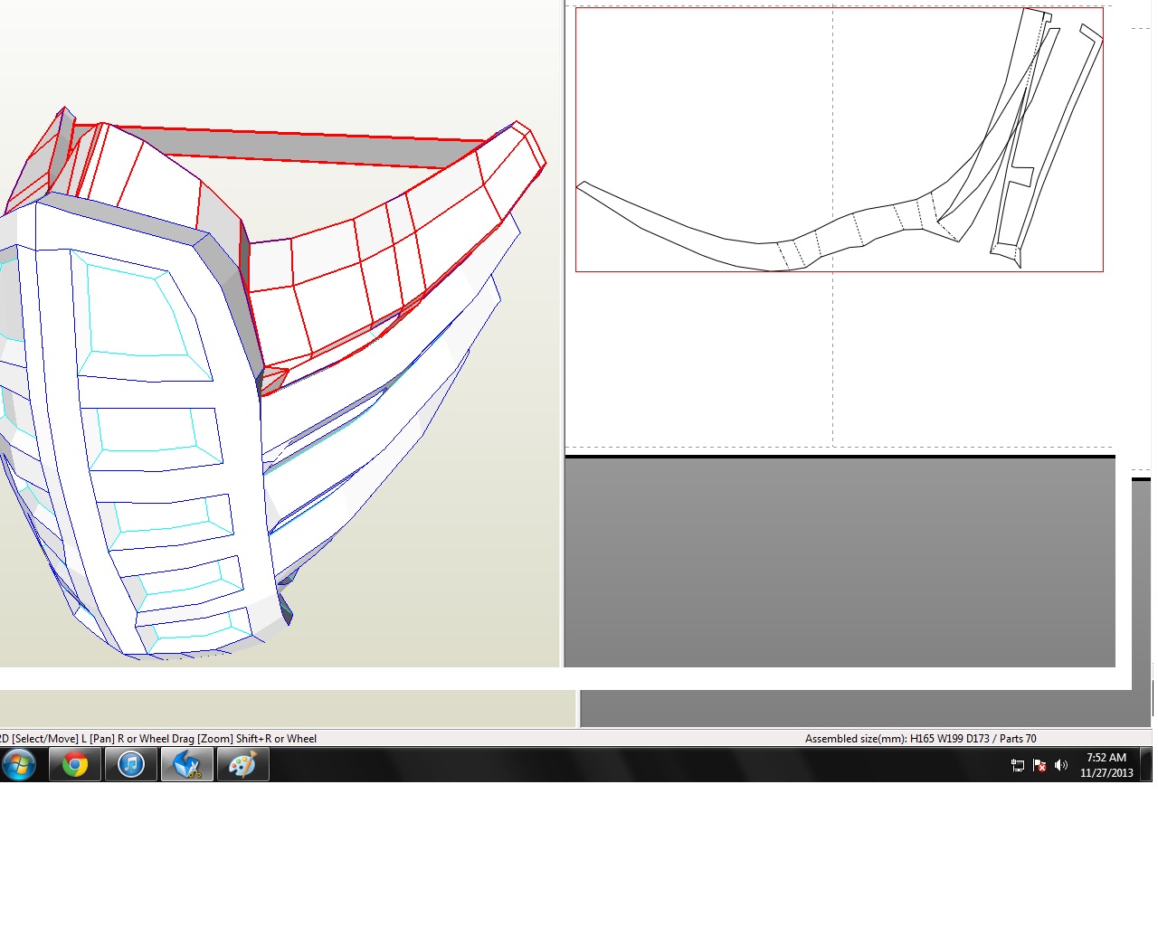

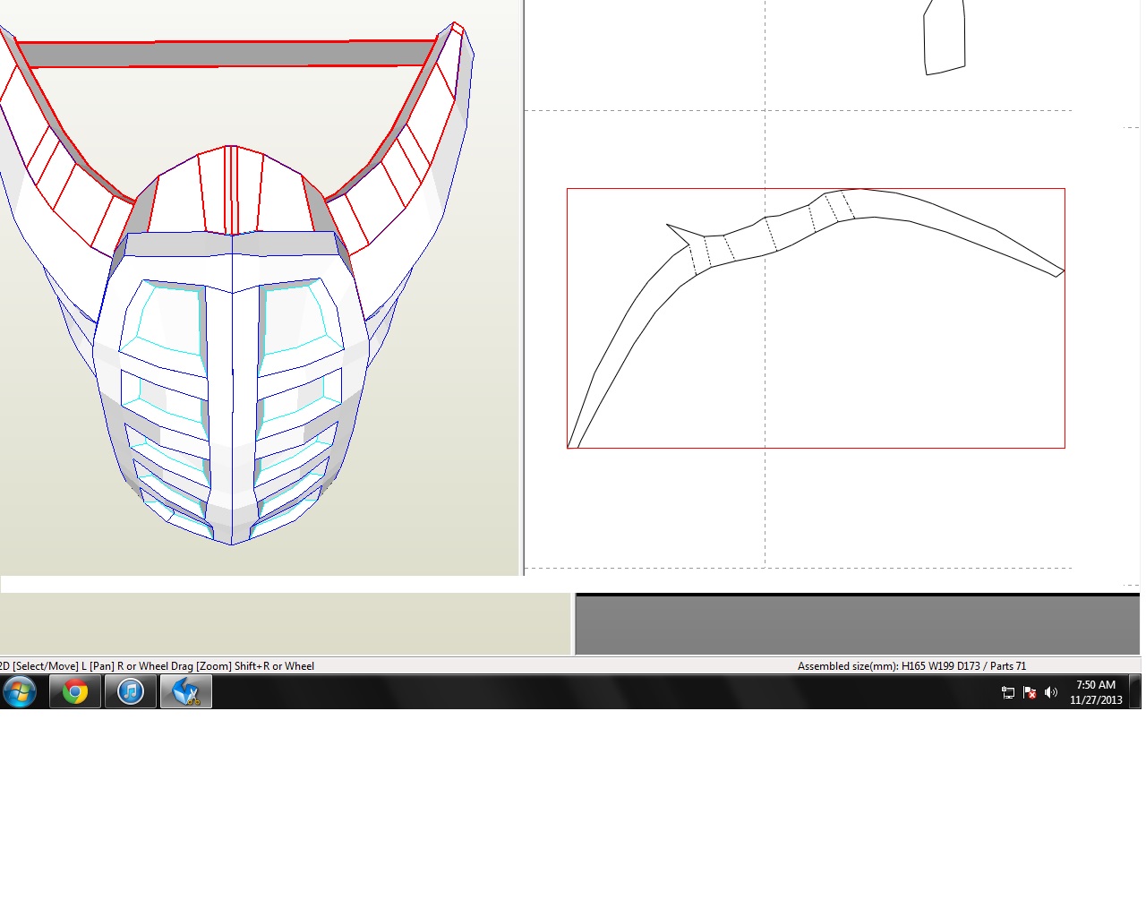

Hey Jf, i was trying out your method on modifying files for foam your way and its not working for me because some pieces i can make them as on piece but others just look really bad on the program and i am guessing ill have to join them manually once cut out. But thats not how you do it since your files are as one piece in the program and you barely need to mod them by hand. So my question is , do you unfold completely the file?? Like make it again??? Or do you just mod the file as it already is???
At the beggining I used to quickly join the pieces of an already unfolded file in order to get larger ones and save time when building. But the fact apeared that a foam build is much cleaner if the seams -insignificant in a paper build- are located at some strategic places, along the design of a suit part or over the edges of a helmet... Moreover, some unfolder use the hateful function "join adjacent edges" that can not be unset unless you undo the unfold and start over.
So, I actually always undo the previous unfold (if any) to start from zero.

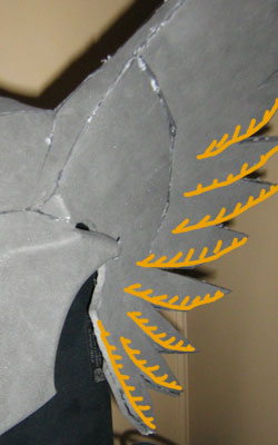

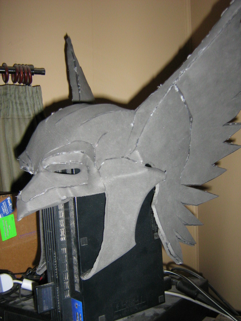

Love that! I'm gonna bevel the edges for sure, but sculpting some feathers sounds brilliant! Working on that tonight after work!
- - - Updated - - -
I'm using techniques for construction I learned from your Deathstroke build video!
Thank you very much for posting that.... Means quite a bit knowing it's helping a little. Even if there are no explosions.....
Alright, kinda hard to see, but I've bevelled the edges now. Time to start resining-looking forward to the paint job!001.JPG
- - - Updated - - -
Actually, it needs some Bondo as well, I think.
