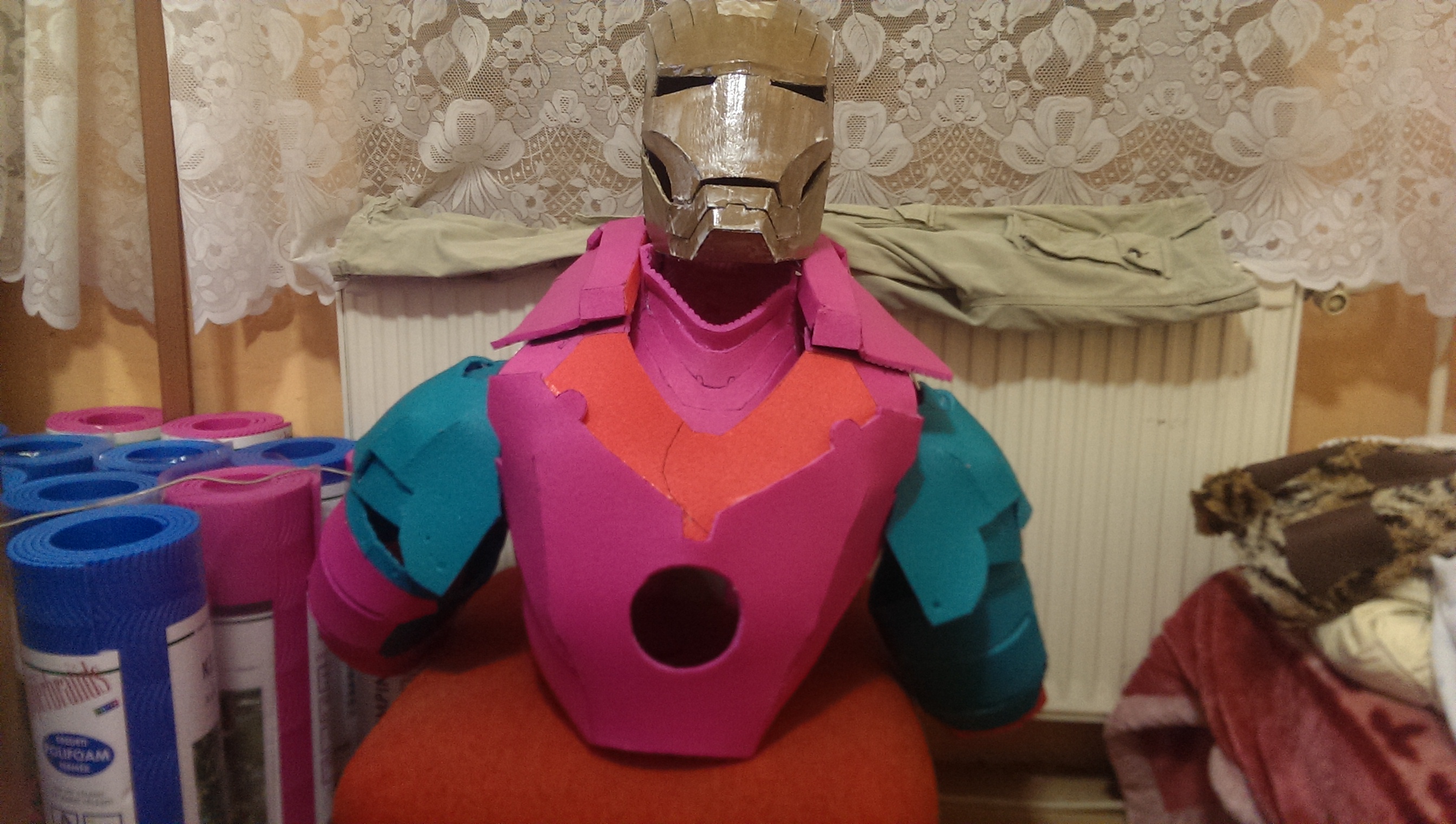

I started my very first build Iron man Mk3..
I hope im in a good way :) i never done like it before...
You treat the cardboard the same way as card stock, resin it and glass it etc

Do you think 3.2mm foam is to thin as a base for a Iron man suit.
It would be coated with apoxy resin bringing it up to about 5mm before paint.

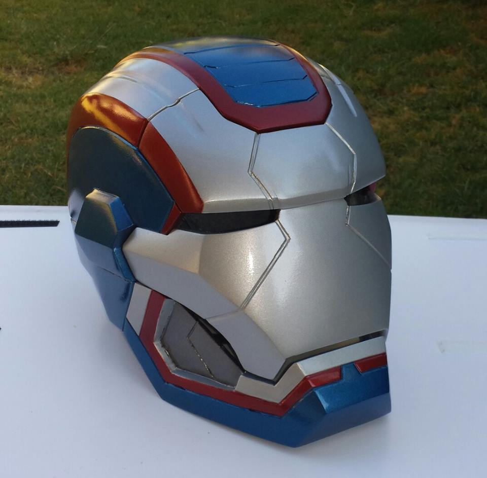

if you are looking at using cardboard... this is my cardboard Iron Patriot helmet using JFcustoms foam unfold, as you can see it does work and very well based on the effort you are willing to put into it. I have also fiberglassed a torso chest/back this way but i dont know if i'll use it as its far to stiff and ridged for a funtional costume, foam flexes which allows you to do alot.

Nice work there Dadpool! Is that the glassed chest/back in the photo?
Your helmet looks AMAZING! Do you have any photos from the build?
