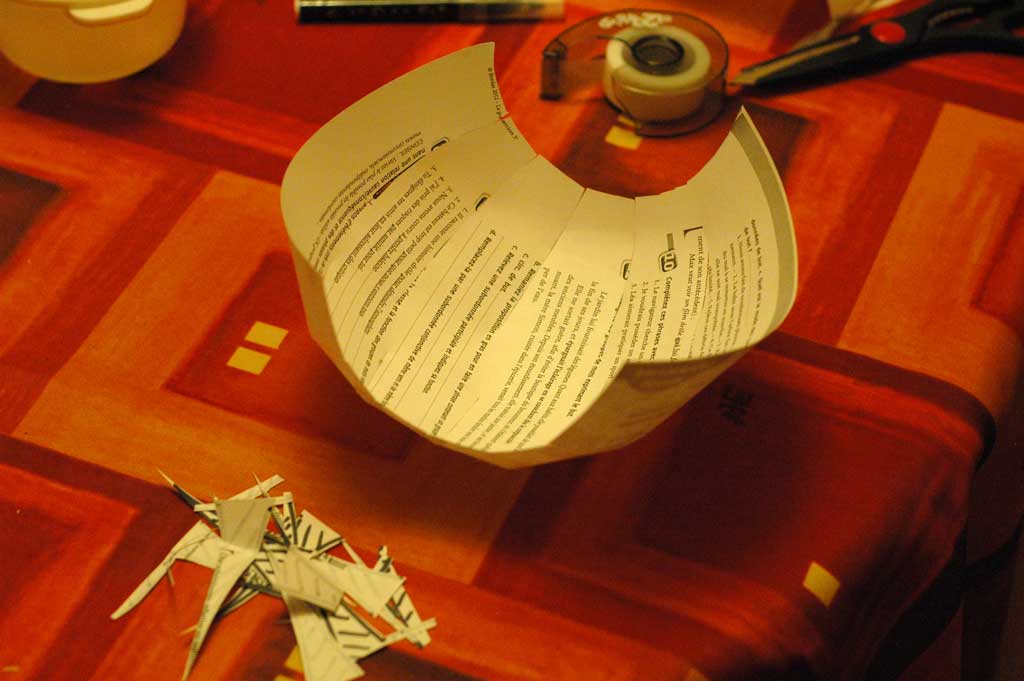

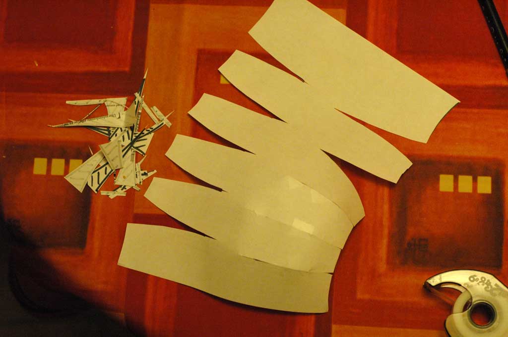

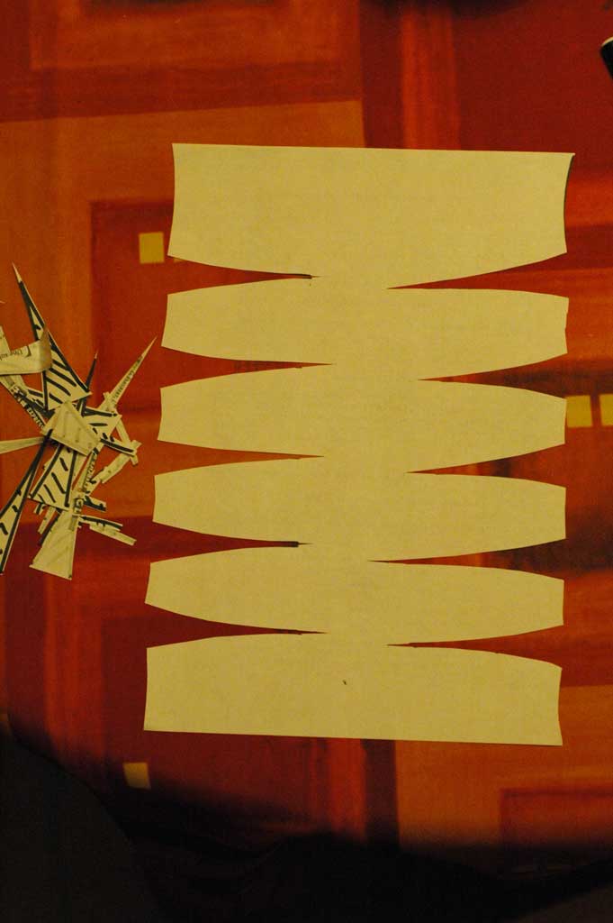

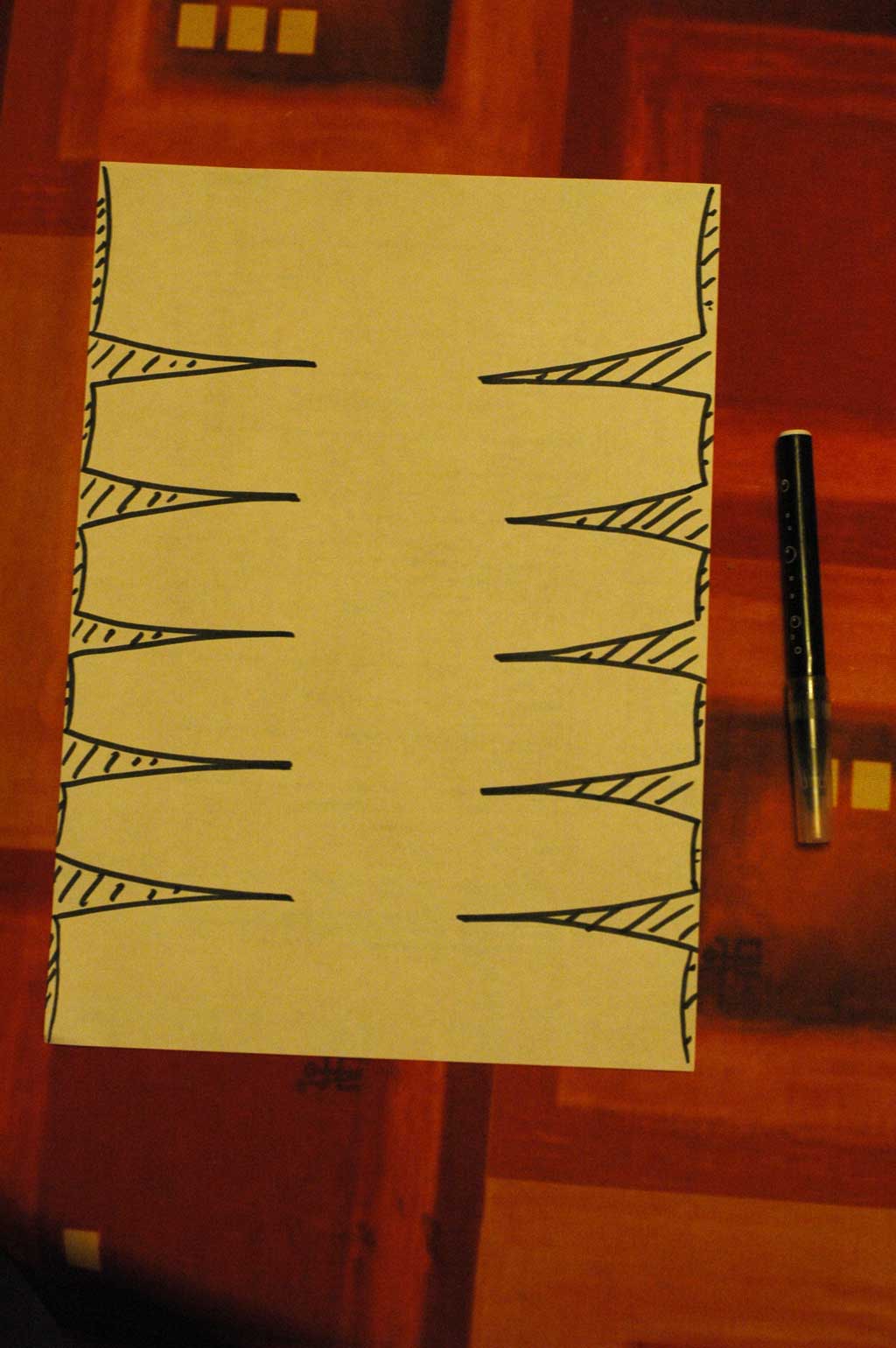

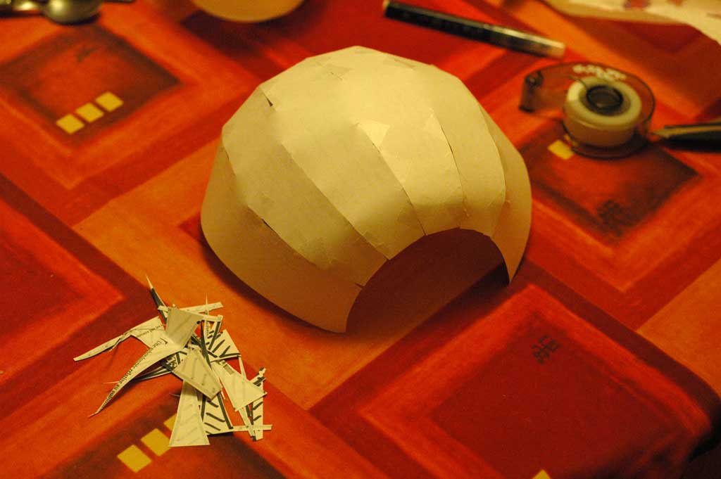

The only part I'm having problems with is the curved part of the shoulder I can't seem to heat it enough to make the curves even with thinner pieces of foam.
Here is the simplest method ever, you can easily freehand it, and no heat required :
(I took paper and tape instead of foam and glue, but the main idea remains unchanged)
