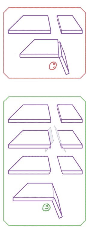

By suitable I don't mean at all that the other guys who unfold for foam should better drop their work right through the gogs. Not at all. By suitable I mean that the templates below can only be used under certain restriction of material :
at first you must use some foam mats, or foam roll, or whatever else, much larger than a common paper sheet. Then, you may use some cheap foam, because these templates generate a impressive amount of waste. And at last, the more your foam is flexible, the more easy will be your build. This point depends mainly of the thickness of this foam. I would recommend somewhere between 5 and 10mm. I use 7mm.
The way I unfold allows each curve and bulge-shaped effect to be obtained without the need of a heat gun. It has occurred that these templates work fairly well with corrugated cardboard, and also, through proper tweaking, for aluminium panels.
But if you plan to use some sheets of foam of one square foot, or one inch thick, or almost unbendable, you won't be able to use these templates. About flexibility, here's a quick illustration of what you'll often have to do with your foam (yea I know, it's paper on the photos, but it's only an illustration) :

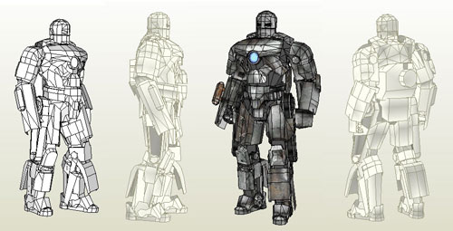

For Iron Man mark 4 and 6 I robbed Robo3687's files, I stole the mark VII in DarkSide501st's pockets, and Dancin_fool has modeled the mark III. A big thank to you, without your work all of us would still keep saving the world in underpants.
If it happens you find here a(n other) file that is not fully credited, please contact me.
All male suits are default scaled for a 6' guy.
Here we are :
View attachment 870968View attachment 870969View attachment 870970
robo3687's Iron Man Mark 4/6 - unfold for foam by JFcustom.rar

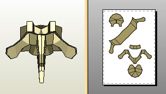

I've colorized here where to connect the parts together :
And here, how I connected collar plates to the top of the back/chest :

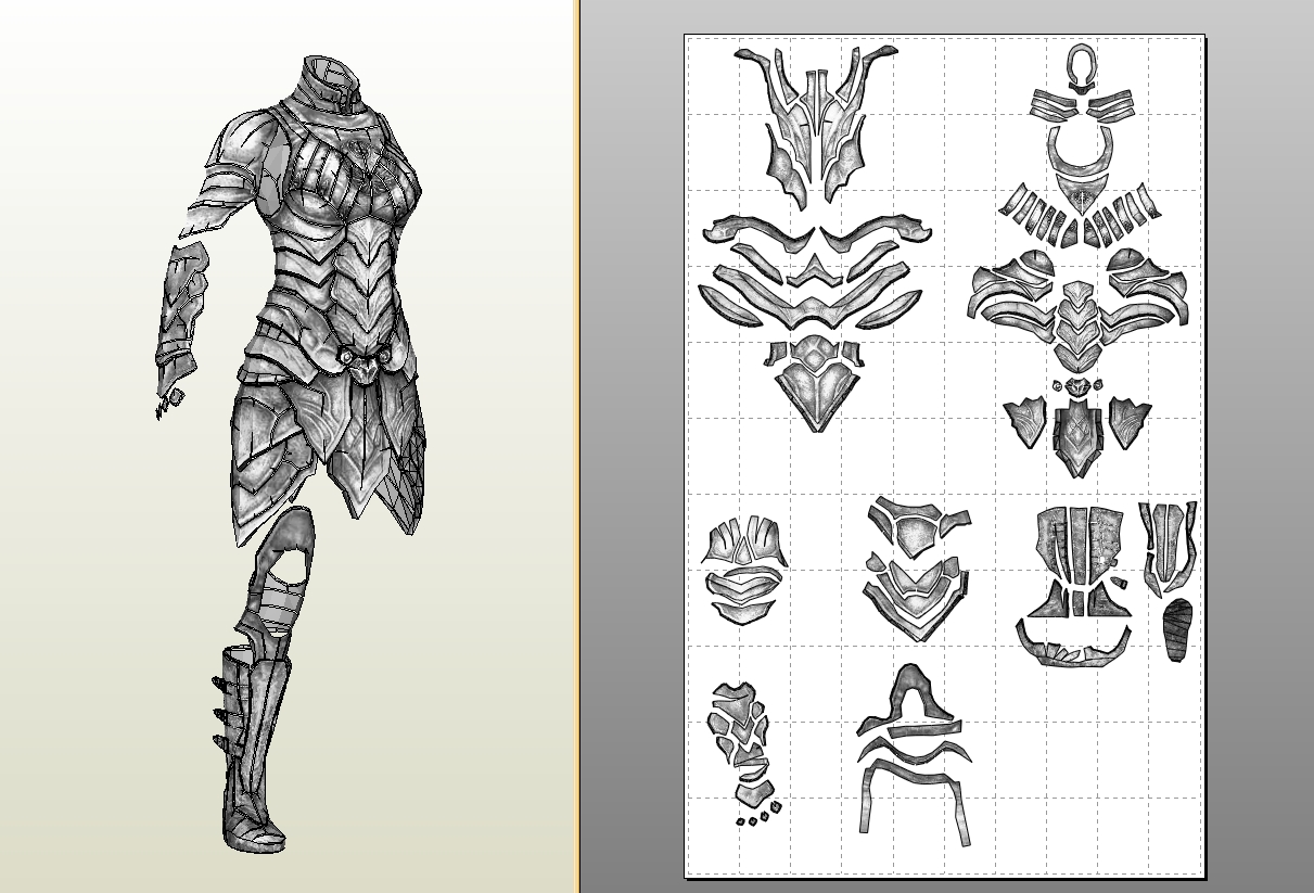

Nightingale female suit - The Elder Scrolls V - Skyrim - foam unfold JFcustom.rar
View attachment 871013View attachment 871014View attachment 871015View attachment 871016

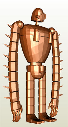

View attachment 871023View attachment 871024Laputa's Soldier - 7ft tall display - foam unfold JFcustom.rar

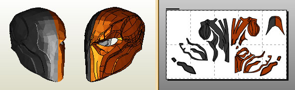

JFcustom's Arkham-Deathstroke.pdo
Injustice - Deathstroke Helmet - JFC foam.pdo

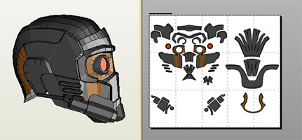

Guardians of the Galaxy - StarLord helmet.pdo - model and foam unfold JFcustom.pdo

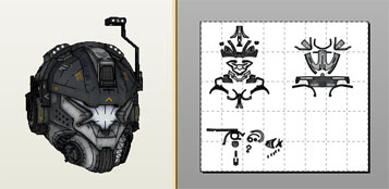

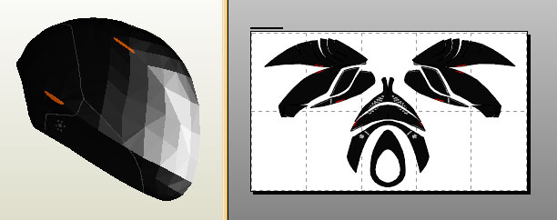

Titanfall pilot helmet 1 - JFC foam.pdo

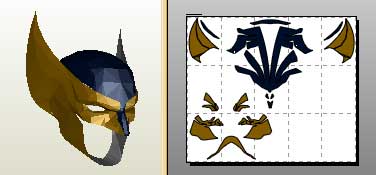

Wolverine cowl - foam unfold JFcustom

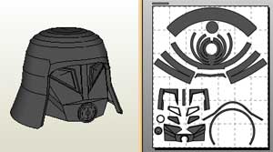

Dark Vader helmet - foam unfold JFcustom.pdo

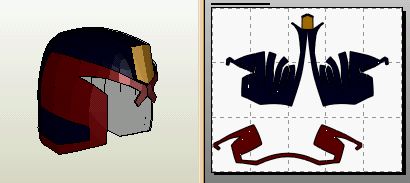

Dredd 2012 helmet by Dung0Beetle and Blaxmyth - Foam edit and unfold JFcustom.pdo

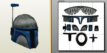

Jango FETT helmet - foam unfold JFcustom.rar

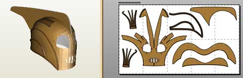

Rocketeer helmet - edit and foam unfold JFcustom.pdo

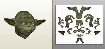

Yoda's head.rar

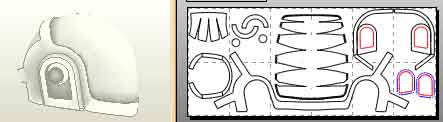

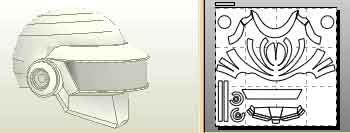

Daft Punk - Cama900's GuyMan Helmet - Foam edit and unfold JFcustom.pdo
Daft Punk - Dung0Beetle's Thomas Helmet - Foam edit and unfold JFcustom.pdo

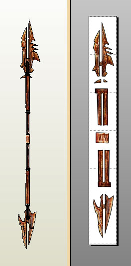

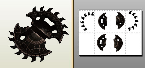

predator-battledisc.pdo
spear.pdo
and trophys :

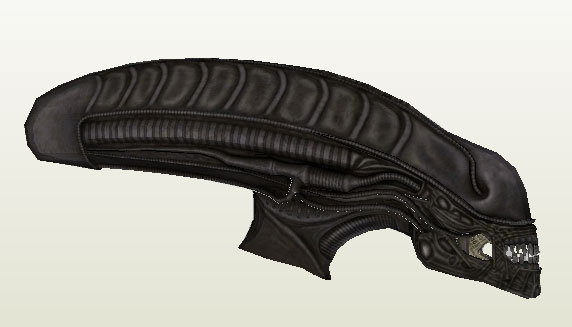

Alien head - provided by Movieman - foam unfold JFcustom

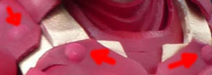

And to both solve the issue of the lower eyes that happen to bulge way out, as described here, and improve the details of the ears area, here's an enhanced unfolding version of Sharkhead's Iron Man Helmet :
View attachment 871076View attachment 871077 View attachment 871078

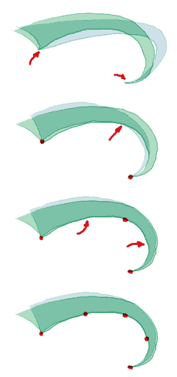

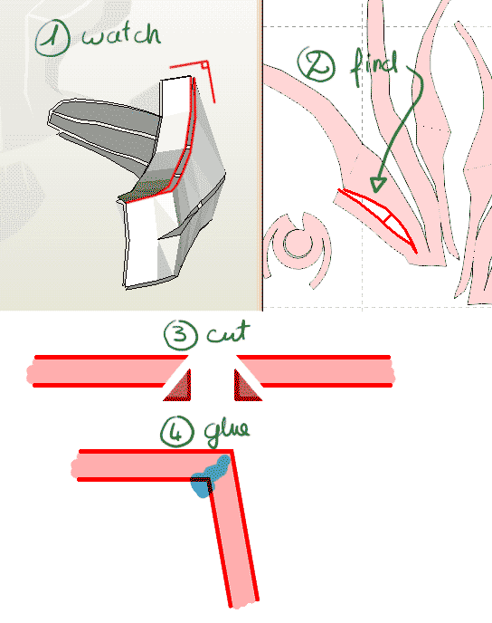

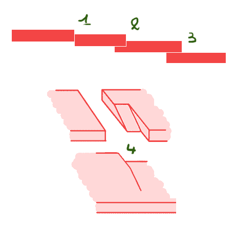

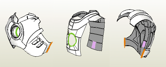

Tip : at the horn gluing stage we have three loooong pieces to snap together. To be sure to obtain a well curved horn, you may want to face them up first and glue them point by point, this way :
This process should be applied to glue correctly any long side in general.
You may also applie these process if needed : thin the foam on the gluing area, or plainly cut up your pieces of foam without caring about the dot-lined overlap you'll see on the pep files. Illustration :

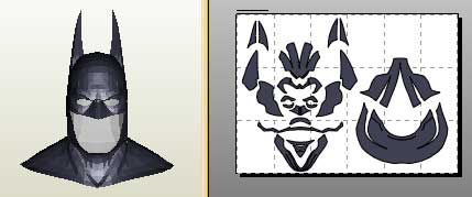

The dotted lines along the borders of the paper templates are here to delimitate
- the real outter side of the suit (in grey)
from
- the strip that will recieve glue and will be overlapped (in blue) by another piece of foam.
If you're using your 12mm foam, by thinning the blue area you can act like if you were working with some 6mm foam, or you can also completely remove this blue edge depending of the method you plan to assemble your foam pieces.

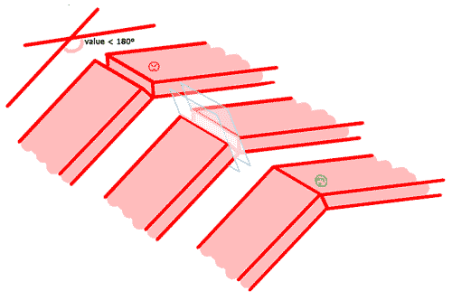

One simple thing also is you don't have to mix the dotted lines that represent a mountain or a valley, with the dotted lines that delimit a gluing area. But it might not be much harder on the templates than on the picture below :
In case of doubt, always refer to the 3D view of Pepakura viewer... :)

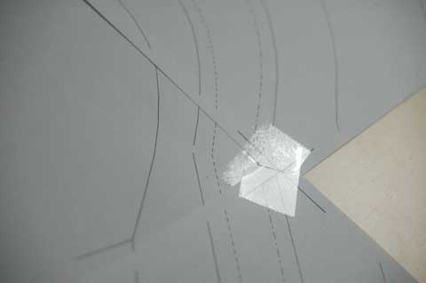

I've also been asked to show the way I translate the dotlines from the paper patterns to the inner side of the foam pieces.
We assume a suit is always symetric, we have only one paper template (let's say it's the right side one) and we are at the point we've already managed to cut up two mirrored foam pieces from it.
So, here I lay down the right paper template over the inner side of the left foam piece. With a pen I punch a hole at every strategical point, in order to locate the placement of the lines.
When removing the paper, I see the dots my pen made.
From them I can draw the same lines onto my foam.
Now, I flip my paper mask and lay it over the other foam part, the right side one.
The printed side of the paper is hidden, I can't see my dot lines anymore but I don't care : I still have my previous dot holes. I use my pen once more to mark the placement of these holes.
Here I am. Now I can bin my paper pattern...
...and trace the lines on this second and last foam piece.

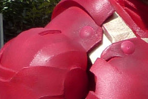

To fill the remaining gaps, and unexpected valleys, and overall every 'factory-dammages', I don't think any sandable product can go well. Because foam is flexible, and something you can sand is not. As a result your join will keep on breaking at every bending. I've successfully tryed a simple and common alternative : the silicone bathroom mastic-glue-gun.
It sticks, it fills, it's slick and smooth, and it can be shaped. The only thing is you must paint it or primer it with any spray you want before it's dry, or nothing will further hold on to this stuff.

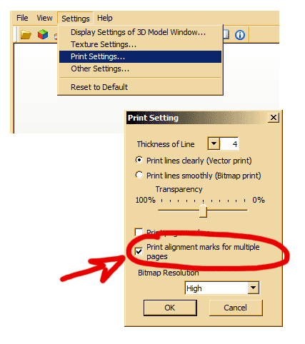

Howto :
After having ticked "print alignment marks for multiple pages" in "setting / print setting", you can print your pages. Then, cut away the top and left margins of each of them, and then tape all of them together to obtain a laaarge single page.
Then, cut out your paper pieces just like they are.
If these pieces are too large for your foam hight or width, you'll have to choose between cutting your piece of paper in smaller parts to match your foam sheets size, of seaming multiple foam sheets to obtain a single and large enough foam sheet to match your paper piece size.
Step by step :
Be sure to set A4 or Letter properly, or you'll run the risk to print outside the paper.

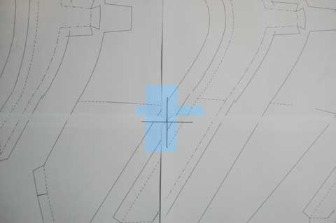

You should tape the sheets before cutting the patterns :
1. print your sheets
2. tape your sheets
2.1- match the alignment marks
2.2- tape the corners
2.3- tape the whole meeting sides

It's simple as possible : each time the surface of the armor makes an angular outward inflection (not a simple curve, but an real palpable angle), you must make the angled cuts.
Shaping mountains and valleys :
You'll often have to give a shape to a single piece of foam in order to decrease the amount of seams. This will help a lot :
I've been asked many times for a detailed howto, so here are the steps to follow :
To make a valley, the only trick is not to cut your foam from side to side. Your blade should never cross the outer side of the foam piece.
1- draw your valley with any pen on the inner side of your foam piece,
2- cut along this line by an angle of 90° in a single pass, without perforate the foam,
3- fold your valley to its desired angle,
4- apply glue inside the notch,
5- wait...
6- release, it's done.
Making a mountain is nearly the same, but you have to make a double cut, in order to remove a long toblerone-shaped piece of foam.
1- draw your mountain on the inner side,
2- cut on either side of this line by an angle of 45°, more or less depending of the desired salient of your mountain, each cut in a single pass, without perforate the foam,
3- remove the toblerone, and apply glue inside the notch,
4- fold your mountain to its desired angle,
5- wait...

And here are some close'ups of the way I use the overlaps to build quite cleanly most of a suit's parts. Here, a back part.
View attachment 871109 View attachment 871110 View attachment 871111 View attachment 871112 View attachment 871113 View attachment 871114
No this picture hasn't been photoshopized, and yes I use a common glue gun :
strengthening rotating joins (glue is used as standalone) :
Many of you asked me the way I get net junctions and how I could glue pieces together without any glue overflow. In fact, there IS always glue overflow... but not outside the suit.
bad -> View attachment 871117
good -> View attachment 871118
Easy.

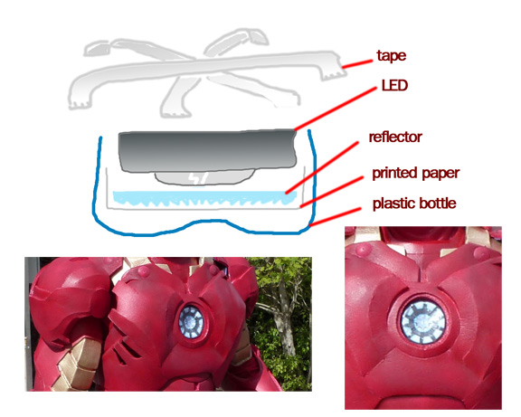

my cheapest operational ARK reactor for moneyless
- you need -
An Evian bottle bottom, 2 inchs height :
View attachment 871128 View attachment 871129
One of this kind of pics, of your choice, printed on the thiner paper you can find, cut along the dotted, and then oiled for a better transparency :
View attachment 871131 View attachment 871132 View attachment 871133 View attachment 871134
View attachment 871135 View attachment 871136 View attachment 871137 View attachment 871138
A 80mm white round reflector, as you can find at the front of caravans or trailers (keep only the transparent part, of course, but better is to specify it however) :
A led(s) push-spot
View attachment 871140 View attachment 871141 View attachment 871142
and a roll of tape
- HOW TO -
Fill your bottle's bottom with
1. pic of the ARK, printed side turned down,
2. reflector, rugged side down, slicky side up in front of the leds,
3. led spot, lights turned to the reflector
4. cross tape your bottom's bottle to keep all inside in place.
5. Insert the thing in your chest, it fits perfectly, and holds alone.
Push, it works.
Price : 2$

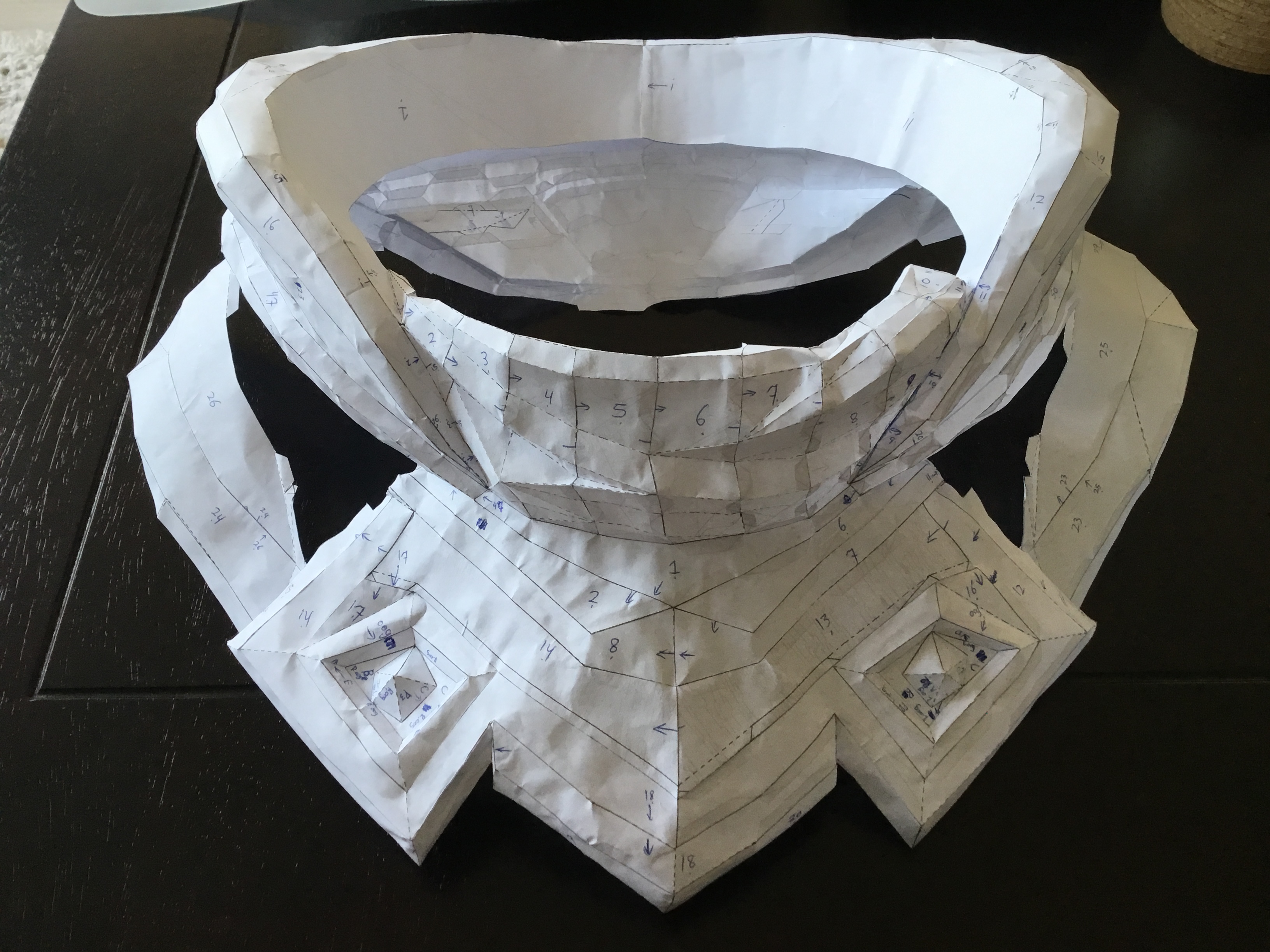

Paper test; I'm glad it fit after all this tedious work:

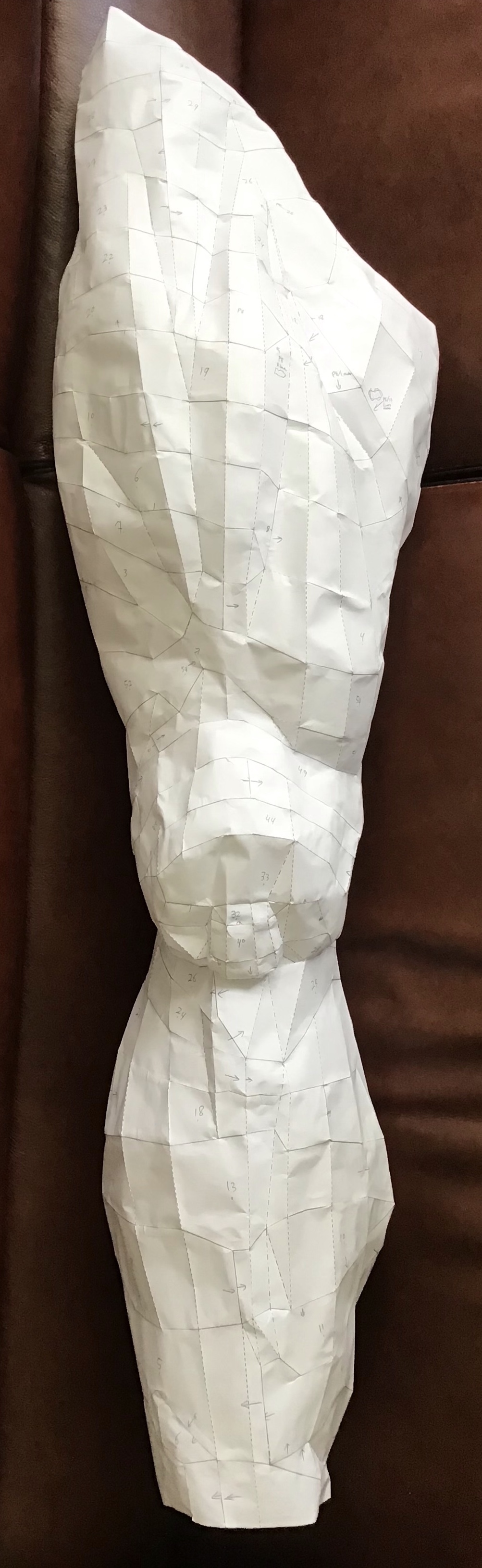

Eventhough it's an awesome concept and I definitely appreciate the existing files, a word of caution for those of us planning to use the Pepakura "Nanosuit 2" files;
I paper-tested the limbs belonging to that model and could fit mine in there twice. You might want to consider stretching a 3D file of that particular limb/armor part first in Win10 "3D Builder" , then open and unfold in Pepakura Designer. Obtaining a file doesn't automatically mean it's your posture, just because you scaled it to your body height.
These are fictional postures or so I've learned (Thank you for teaching me this, laellee )
Finally finished my (4th) modified (paper test) leg from the Nanosuit:
Despite making it thinner, the calf is still the size of a balloon and mine can swim in it, so I will have to unfold and scale it separately (unless it's for Marvel's Rhino, then big is better). At the same time I already know I have some extra space in the knee, so to me that's just a matter of tucking in the (bottom of the) thigh/knee as to make it stay in place.To be continued...
George can you get away with sectioning the back of the calf? Maybe cut a strip out of the back (like an elongated pie-cut) to take out some of the mass in the calf? Could be a quicker solution :cool:
laellee thanks for your suggestion. I would resort to it if not for the asymmetry of the model which will cause the model to warp in an attempt to reclose the sides. I would then have to freehand the sides to match eachother, which could pose a problem and above all wouldn't make the model any prettier:cautious: Let me gather my thoughts...
Thanks again
I will upload later...
