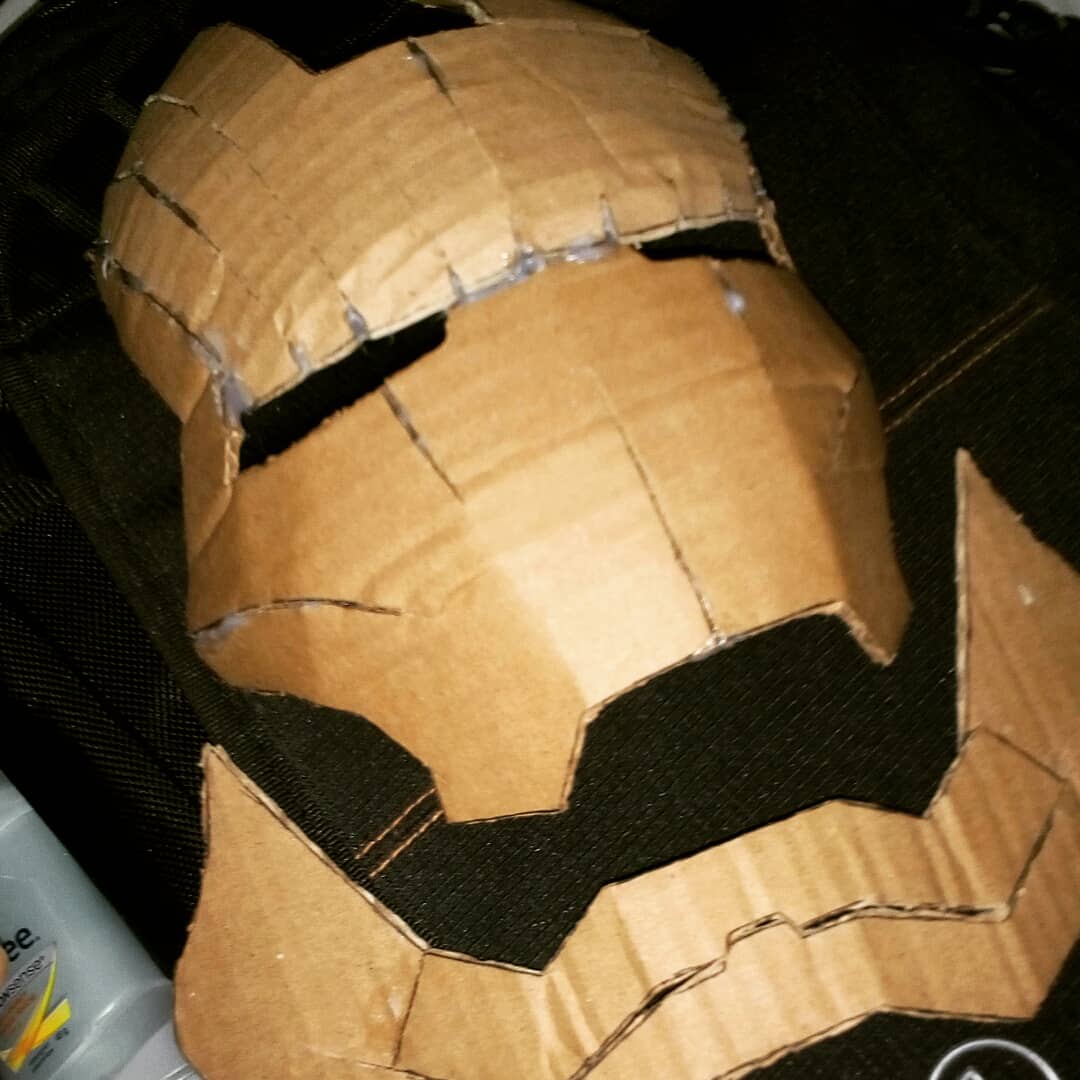

I feel like I did something wrong. How do I connect the jaw to the faceplate?
EDIT: This is MkIII btw
The jaw will not connect as a perfect seam to the faceplate, it's meant to be a separate piece on most all of the models. When you build the main body (rear) of the helmet, you will then see where the jaw attaches to that base piece, and it will make the faceplate placement make a lot more sense :thumbsup
Thanks! I never got around to assembling the back part of the helmet.

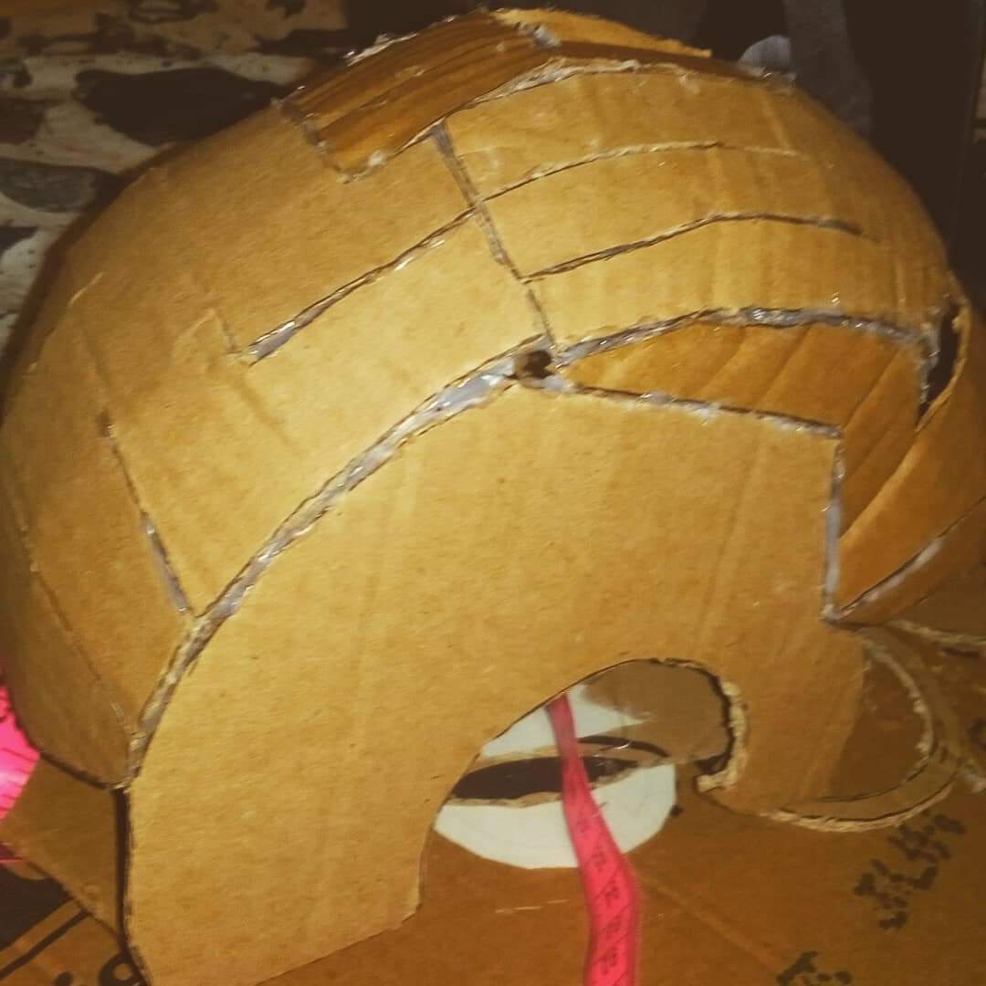

Quick question: I'm almost done with the helmet and I've noticed that there's some gaps in certain spots. Is there any way I could fill them?
JfCustom mentions "paintable silicon caulking" on page 1 of this thread,although I am not sure whether this applies to foam only.
Yep you can use paintable acrylic latex caulk, with silicone, specifically Alex Plus: http://www.dap.com/media/53591/alexplus_ctg_tube_pairshotbig.jpg
It comes in both squeeze tubes and tubes for caulking guns, I fill seams using my finger, and then wipe off excess with a wet rag, works great. It is also paintable, a lot of other caulks won't take finishes over the top very well. Any way, my workflow usually goes like this:
Spray the piece with 2 plastidip coats to get a uniform color, it makes the gaps, pinholes, etc a lot easier to see.
Fill the gaps, wiping off excess. I let the stuff set for at least a hour before continuing
Spray again with plastidip, I spray pretty heavy as it levels out to a degree on it's own
Spray on primer/finish paint. If you find more spots to fill, just add more caulk, let it cure, and spray your paint right over the repair. :thumbsup
That caulking also works well to simulate weld joints.
