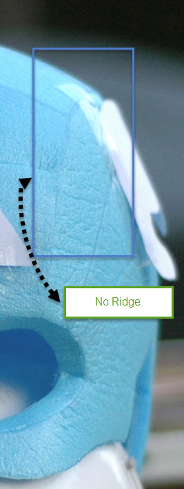

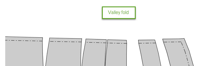

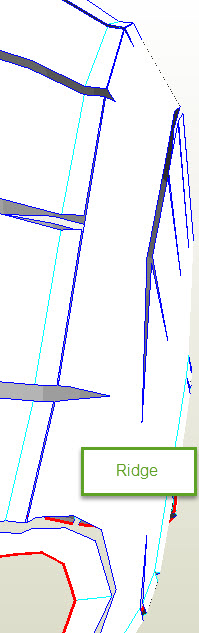

Hey guys, quick question and this may be a simple answer. I posted this question in the Captain America thread that the helm in the first post was linked to, but seeing as it was a bit of a necro I am guessing it may not be answered.
With the CA helm, I noted a bit of a ridge running down both sides of the dome. The pep file actually has a valley fold marked at the edge of dome piece that I expect would form this ridge. However, all of the builds I have seen don't seem to have this ridge.
Can I assume that the valley fold lines were just ignored and the side of the helm was just joined to the dome edge? Or am I missing something?

View attachment 400676View attachment 400677View attachment 400678
I'd say most people have just ignored it; it would be MUCH easier to just join the edge as a smooth transition, rather than go through the work of defining that extra bevel with a back cut (especially with it so close to an edge).
Thanks Iaellee. I had spoken to someone else about this and they suggested the same thing.
I also noticed a couple of things about the design - lines are partially included for the sides of the helm as well - 1 side shows 1/2 a line and the other side shows none. Also, along the bottom it has the same valley fold requirement which none of the completed builds include. So I made an educated guess that those fold indicators aren't required (or may just be left over remnants from the unfold). I am guessing that this is the way to approach it - look at the designs/images and make your own call on whether it is required or not. There's not always a black and white answer...
