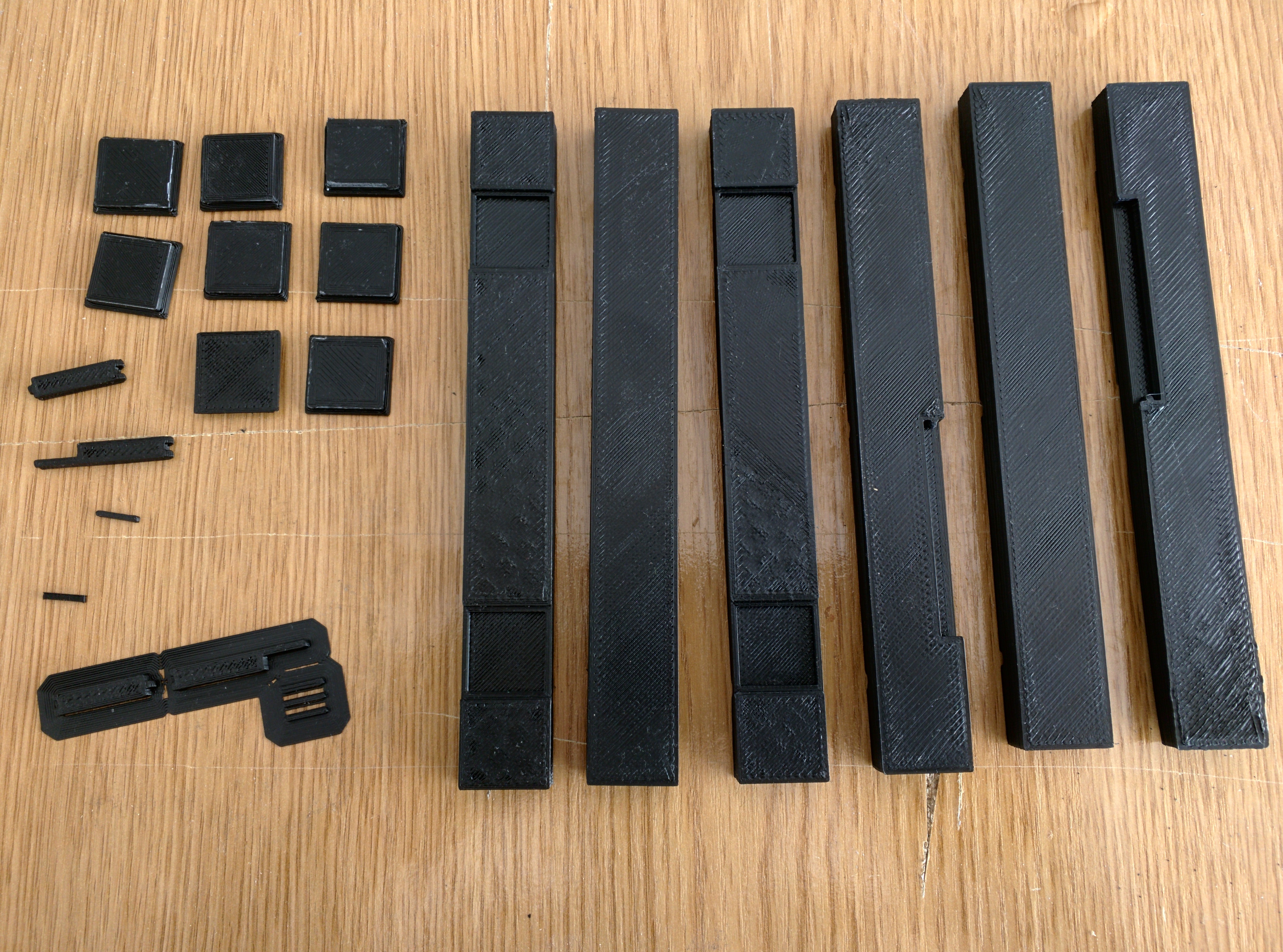

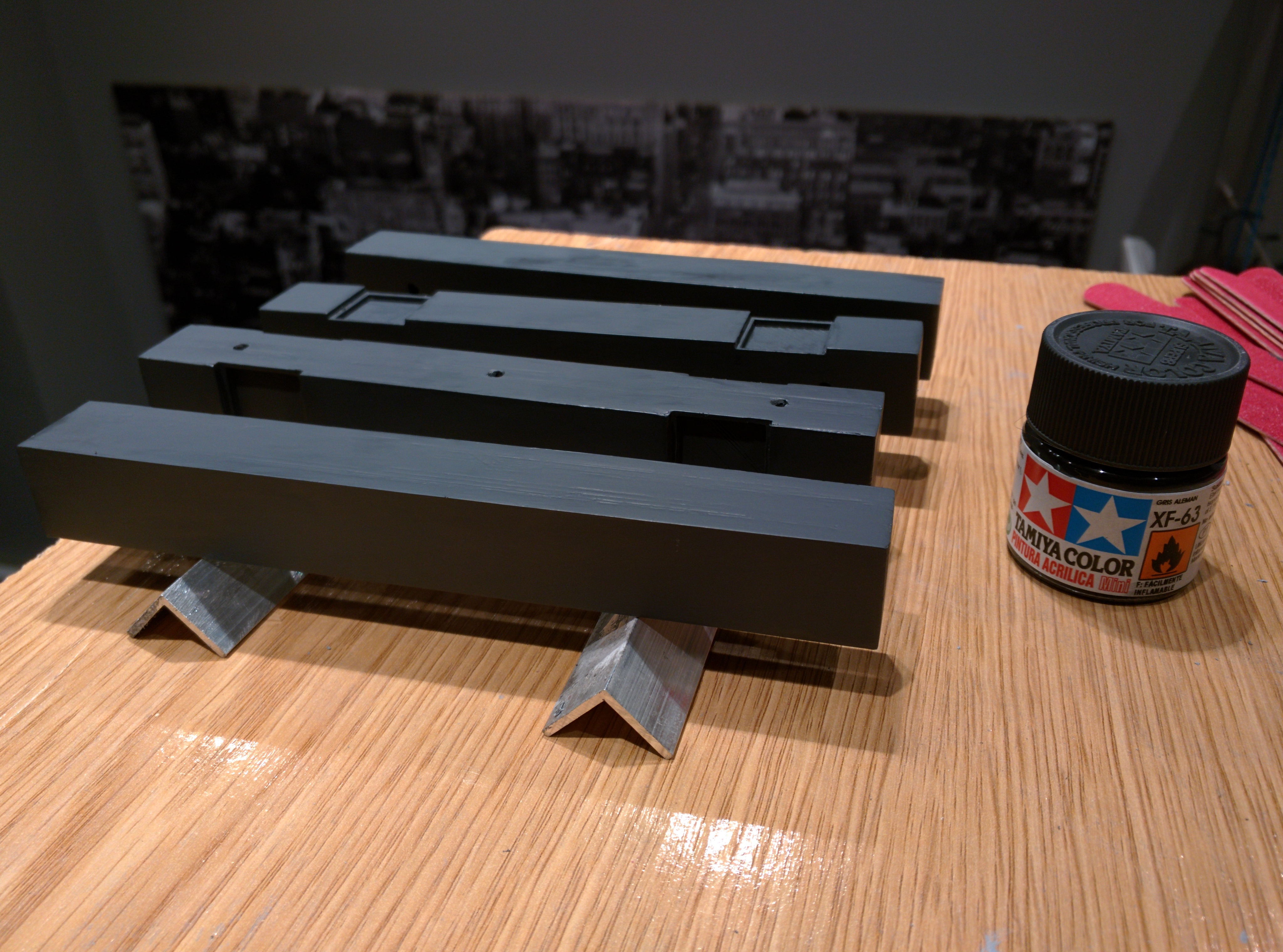

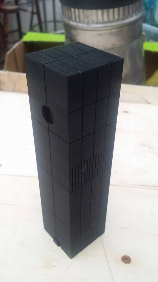

Finished printing the first of 8 parts of my 1/6 scale TARS. Annoyingly realized after 10 hours of printing that I'd put the hole for the top magnet in the wrong place. I'll use this piece to test paint instead.
This looks sweet, how difficult will it be to get it nice and smooth though? I'm not all that familiar with 3d printing material.

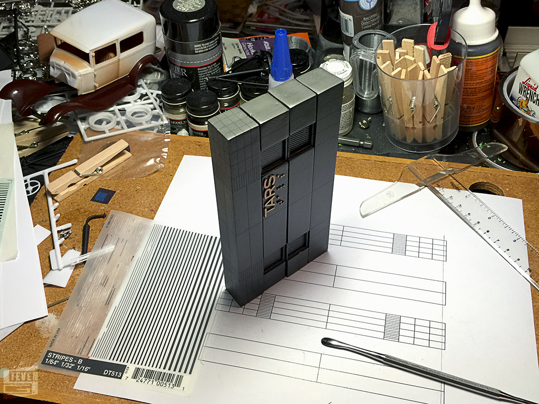

I'm still trying to find some black pinstripe decals for the panel lines on my TARS.
For the lines you can take some black vinyl and exacto some thin lines, just a thought, or you can print the lines on some model decal sheet on a clear piece and just lay it on.
Well, I found some panel lines! The bad part is they are dry transfer not water slide decals. I was hesitant because I've never used dry transfer for a model before. But my options were running out so I gave it a go. So far it's working out, maybe not as exact as I would like. It's also very tedious work. But I think after a clear coat and weathering it will have the look I'm aiming for.
That look good, you might want to try clear coating a test panel with the transfers on paint before coating your model, you never know how the transfers react to the clear coat. Dont ruin what you have so far.

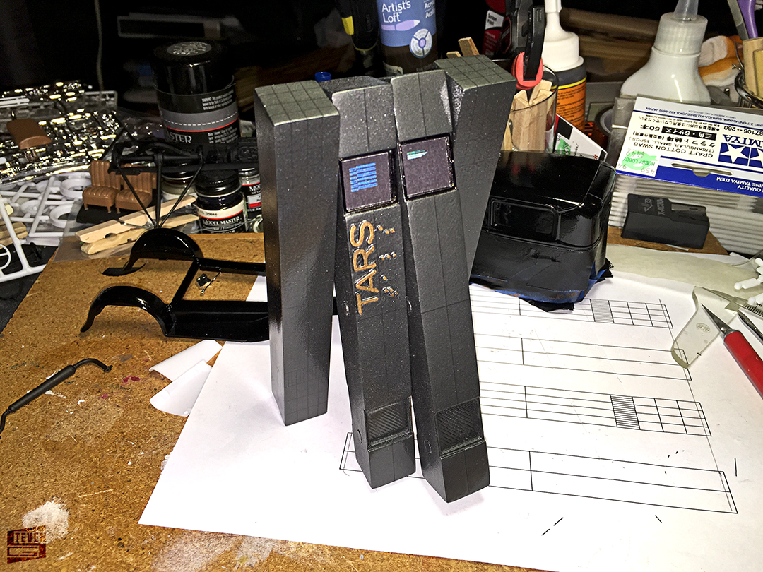

I've added panel lines and sealed them with a high gloss clear coat. Next step is to cut and glue the clear squares for the 8 display screens. The final step will be to add weathering, I'm going for a TARS that has been working hard for many years helping to set up mankind's new home world. The kid's call the old and worn robot uncle TARS.
Here is a progress shot:

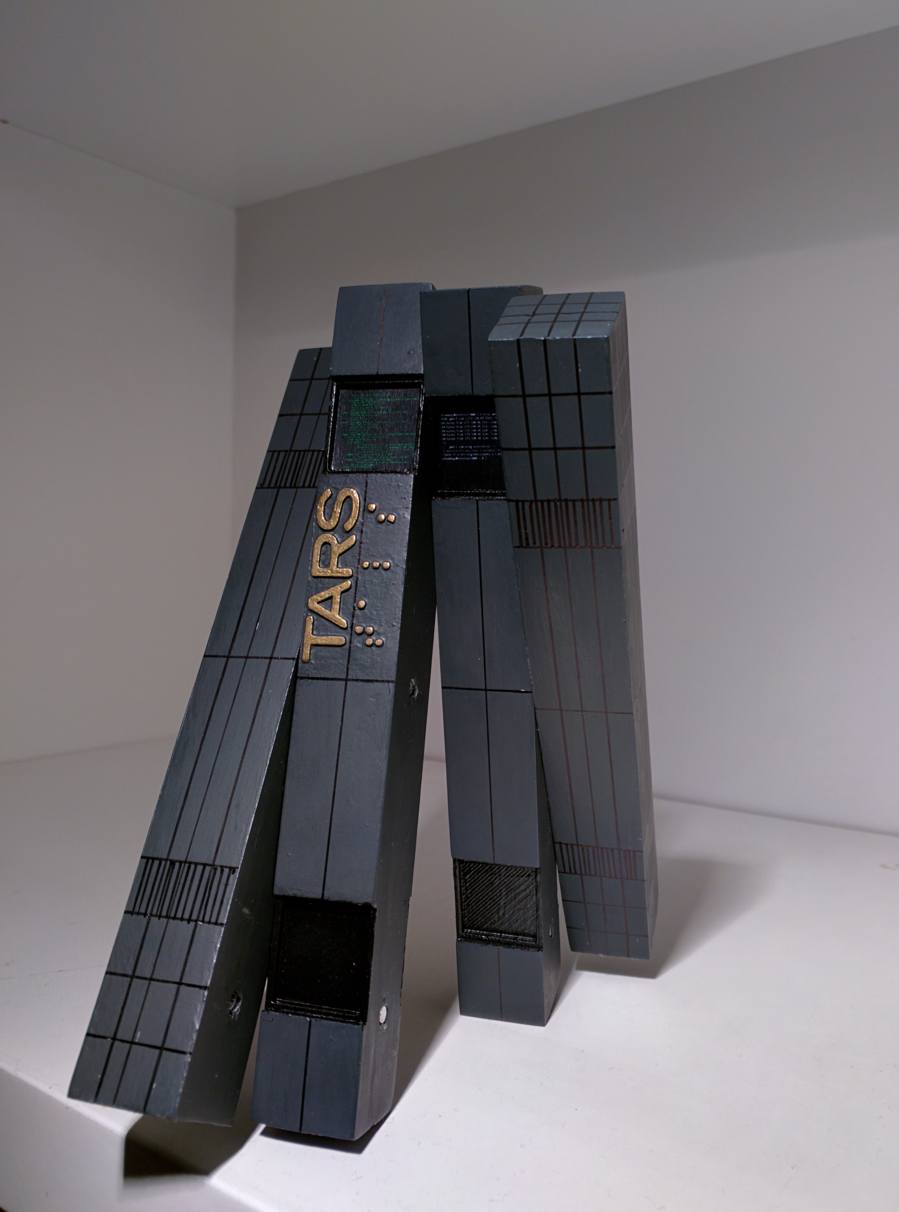

Hi, guys!
This is my first post here, in the RPF. I landed here thanks to asavage's podcast (highly recommended). This is also my first time making a model and painting it, so please be merciful :p
I loved Interstellar, and most of all, TARS the robot and it's simplicity.
Luckily I found this post, and since I've made myself a RepRap 3D printer, and steveng posted some 3D files (many thanks for that!), I decided to make a model.

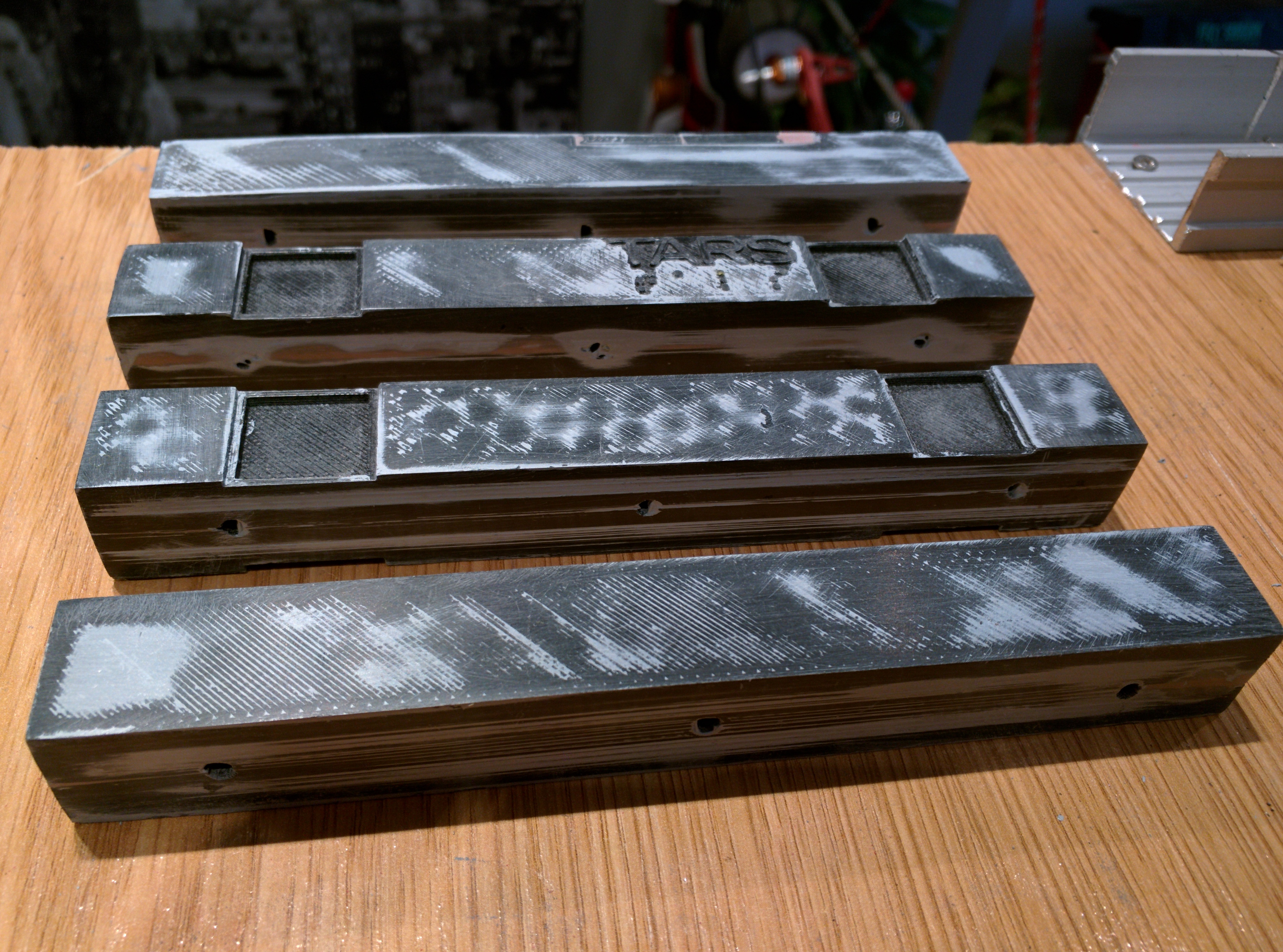

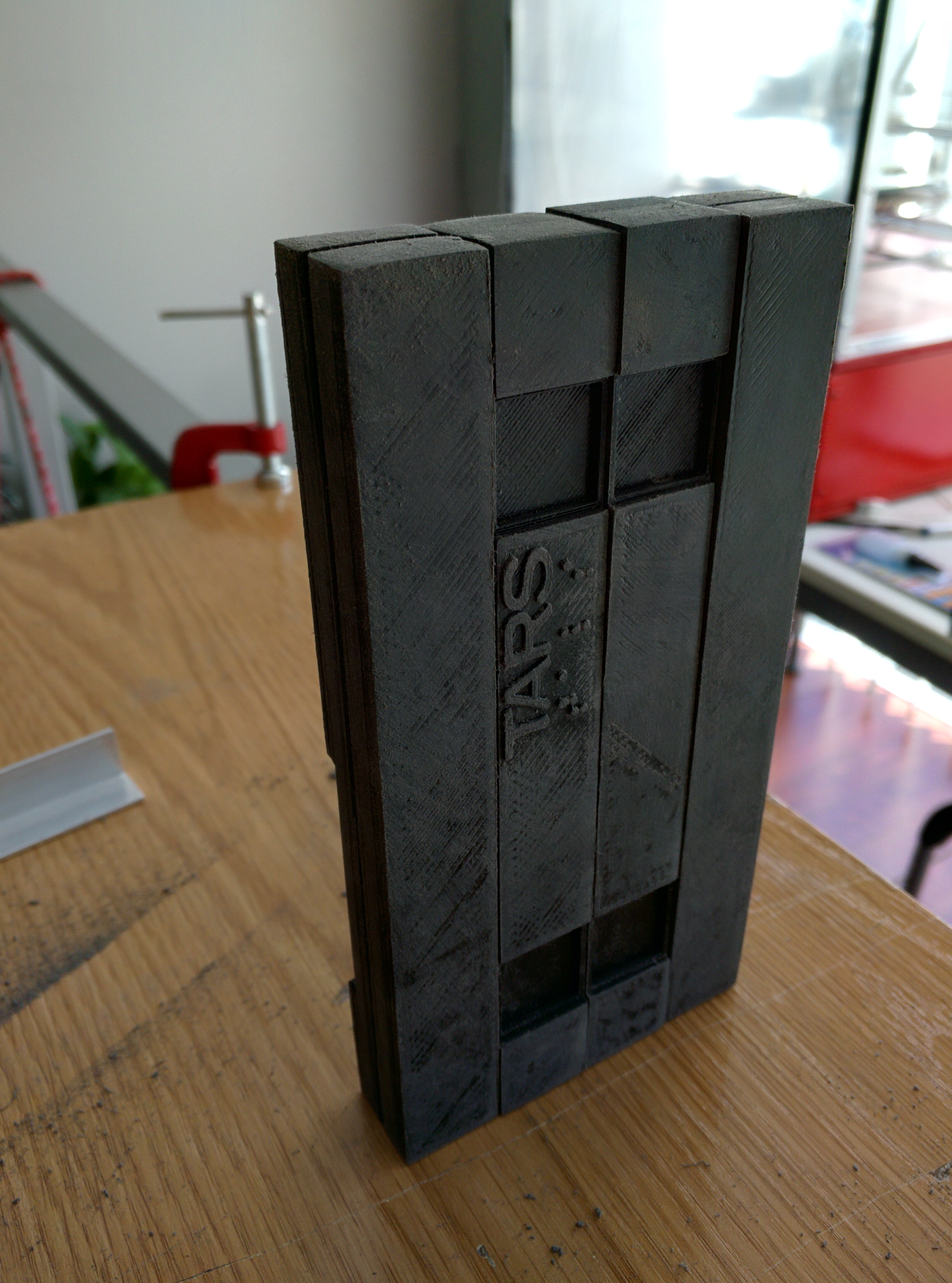

These are the steps I followed with some pictures:
  1. 3D printed steveng's model.

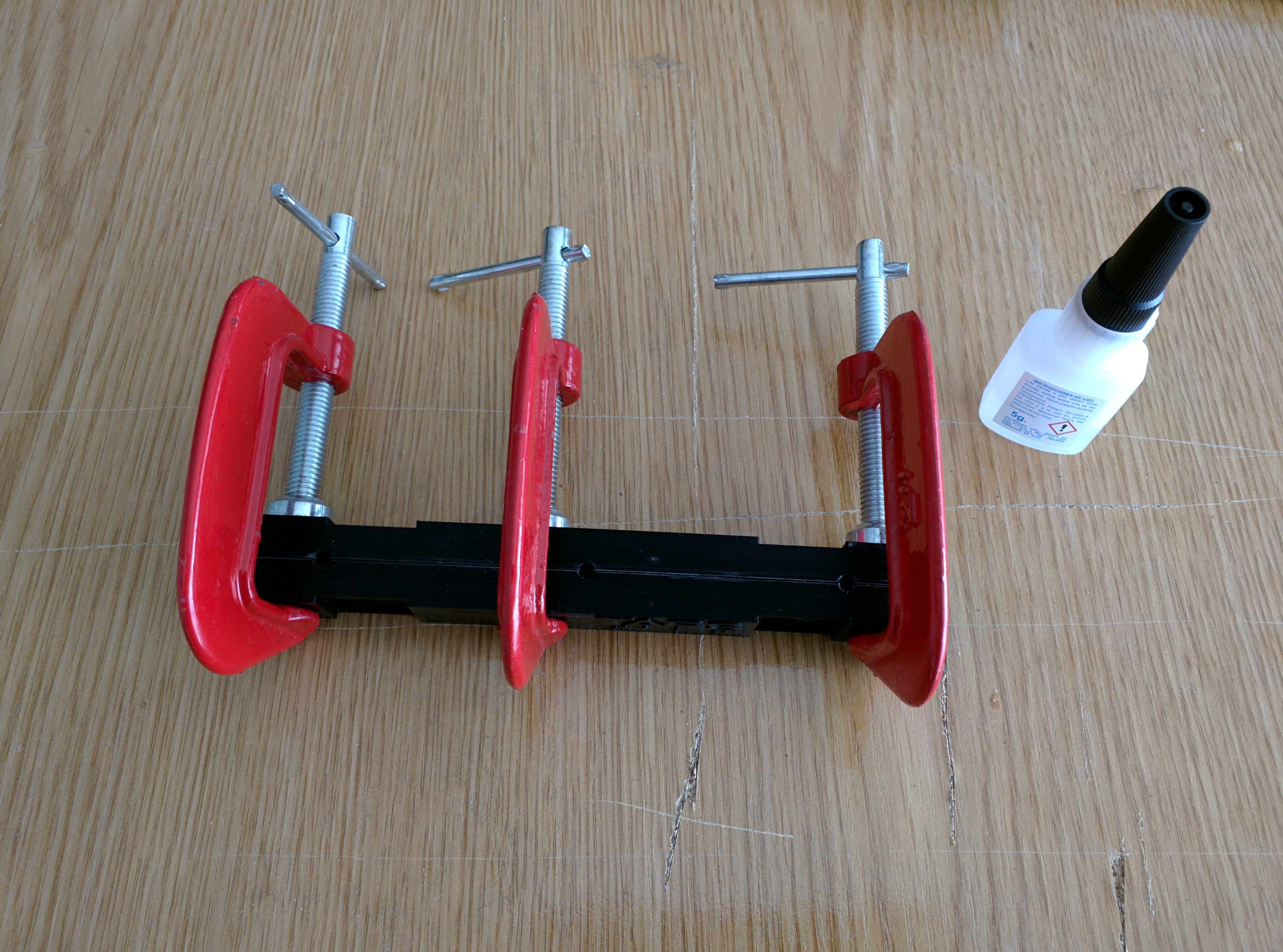

  2. Superglued the parts together.
  3. Sanded the ABS plastic.

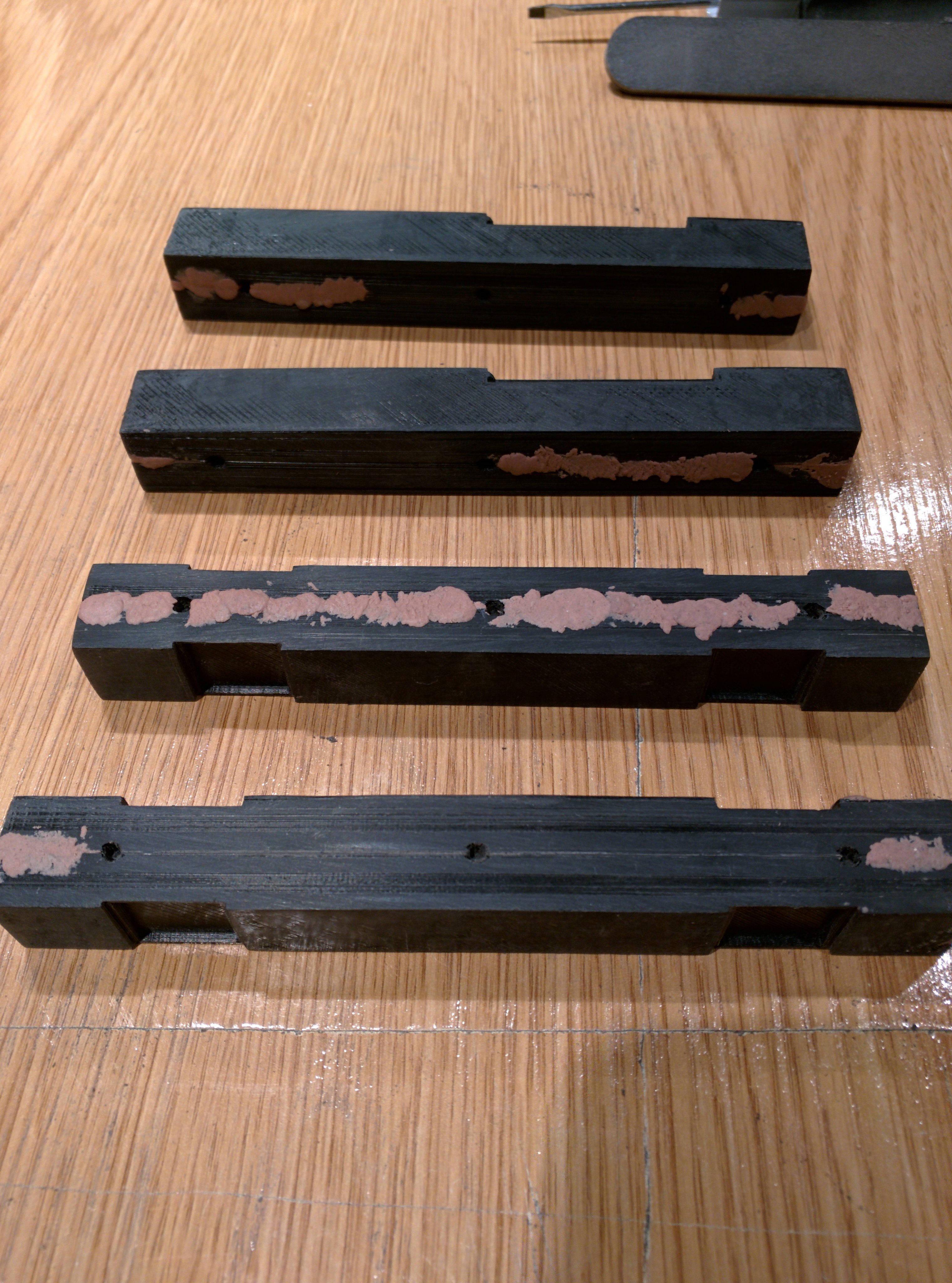

  4. Added epoxy to fill the big gaps.
  5. Sanded the epoxy (forgot to take pictures here).
  6. Added putty to erase the finer details of the 3D printing process.
  7. Sanded the putty.

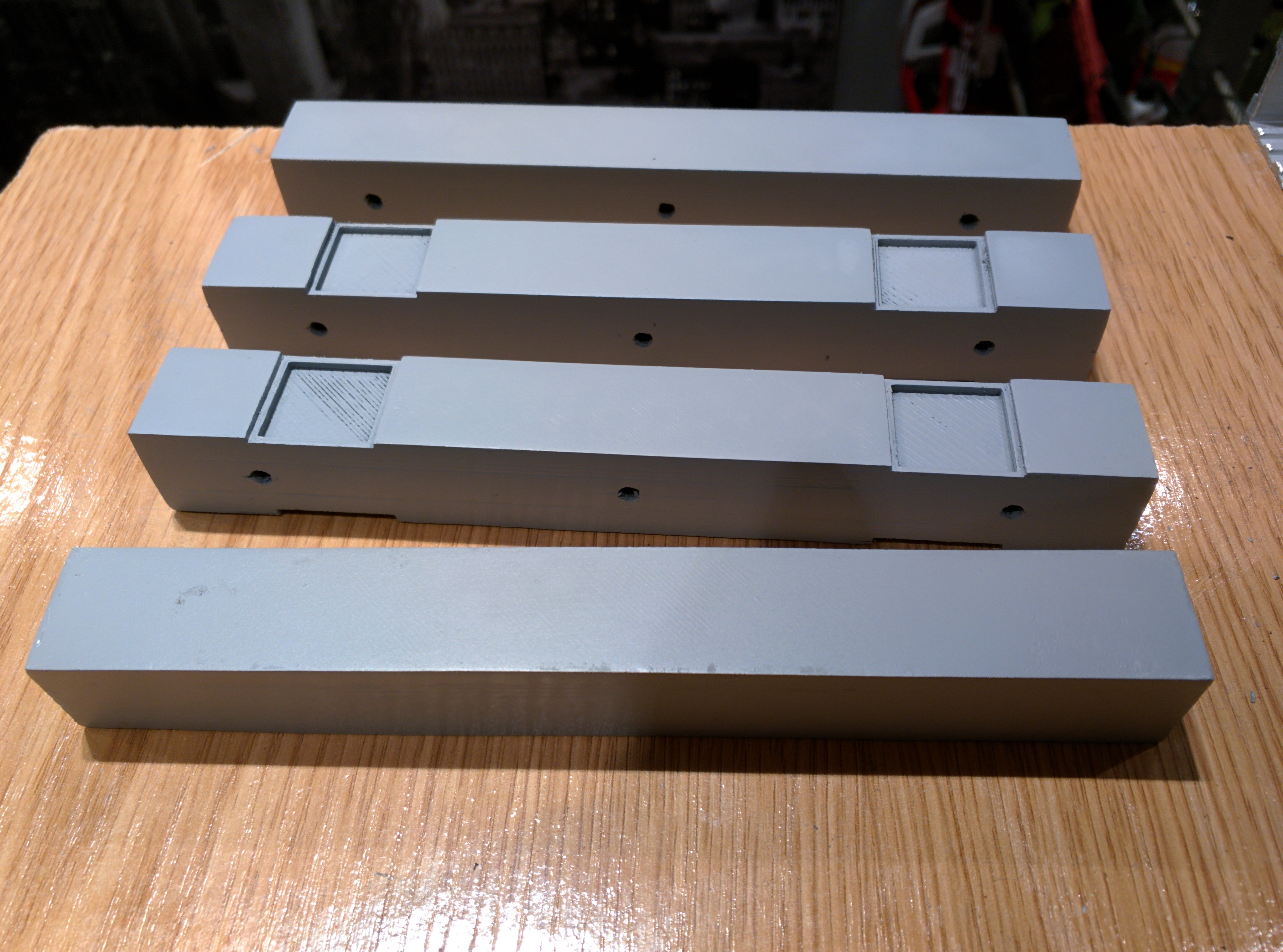

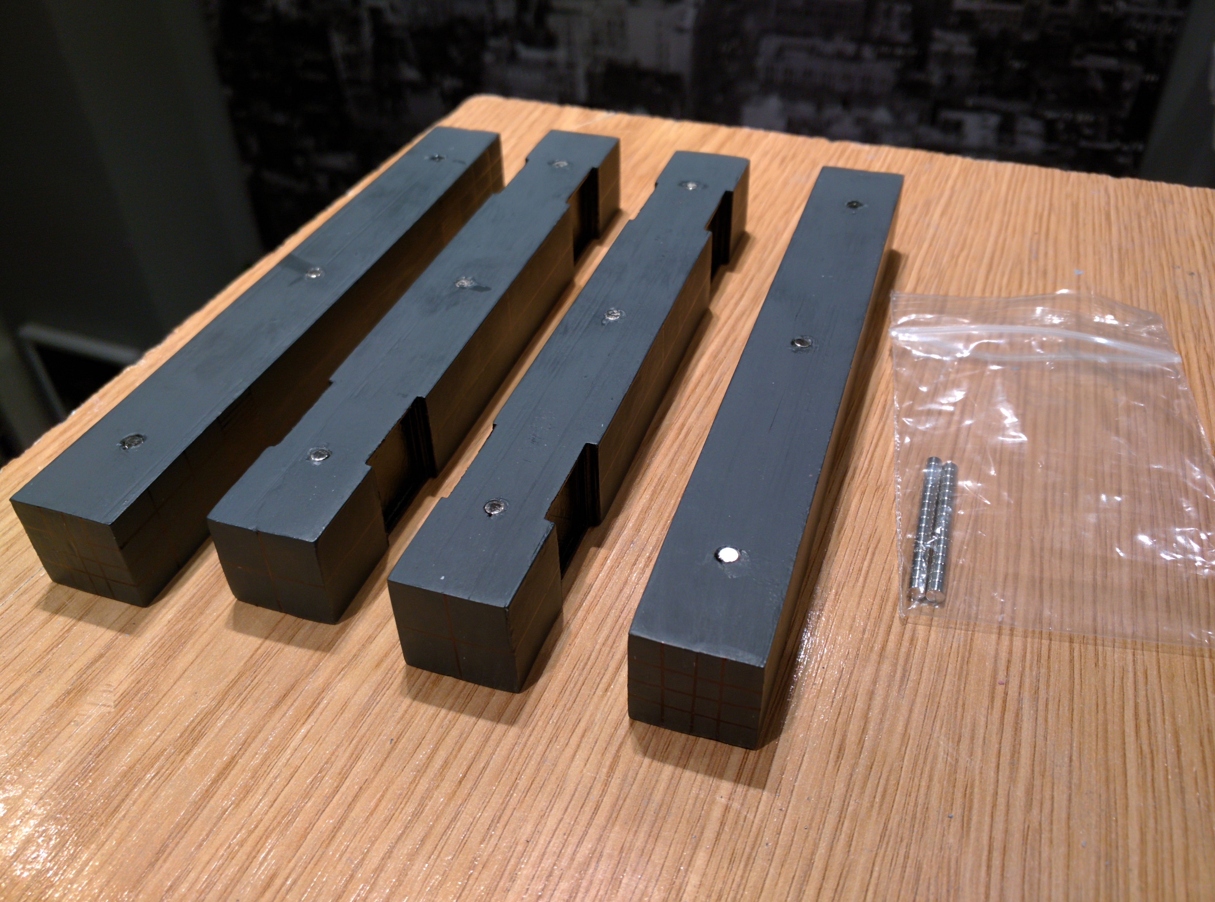

  8. Drilled the magnets holes.

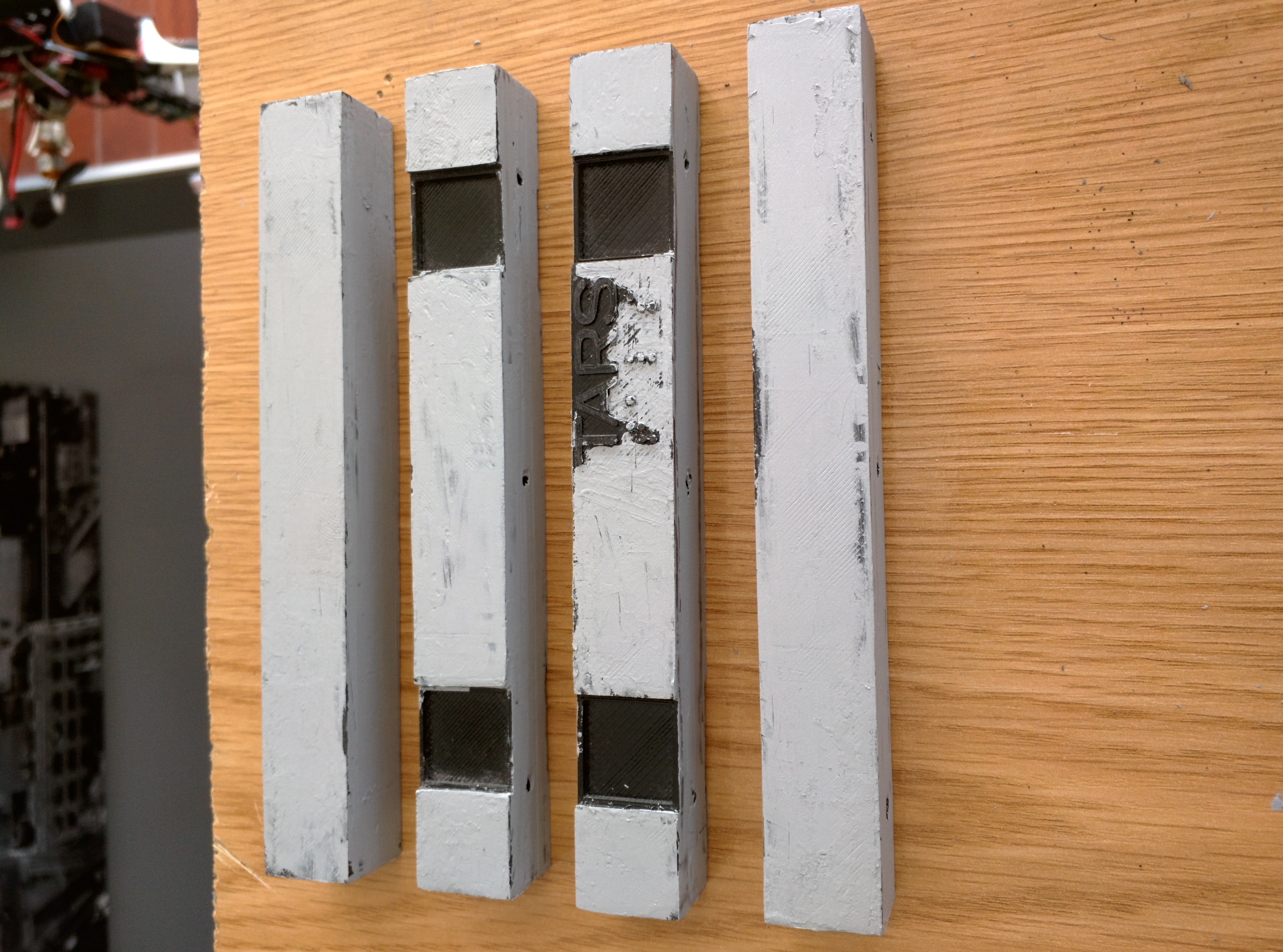

  9. Sprayed with primer.

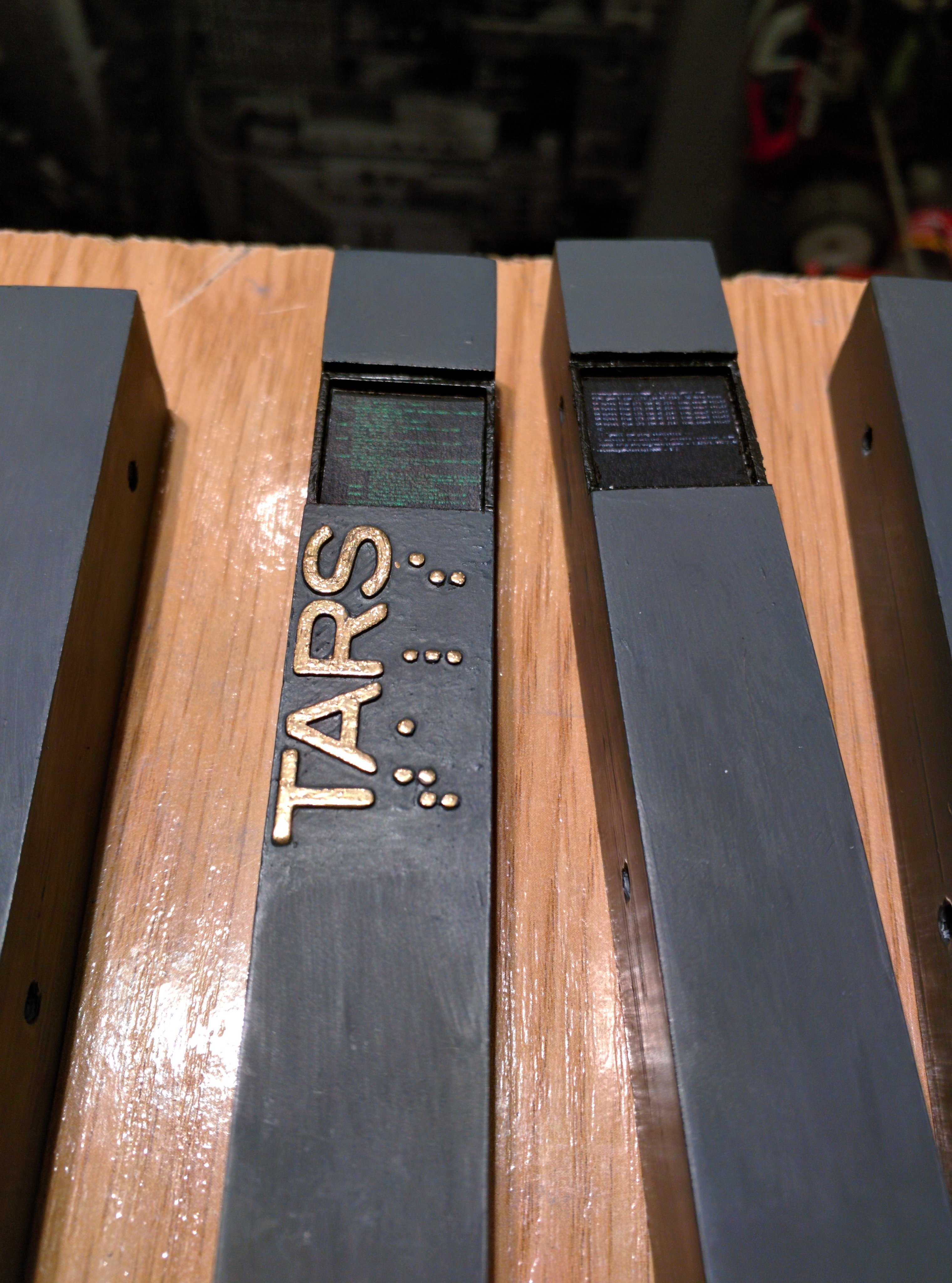

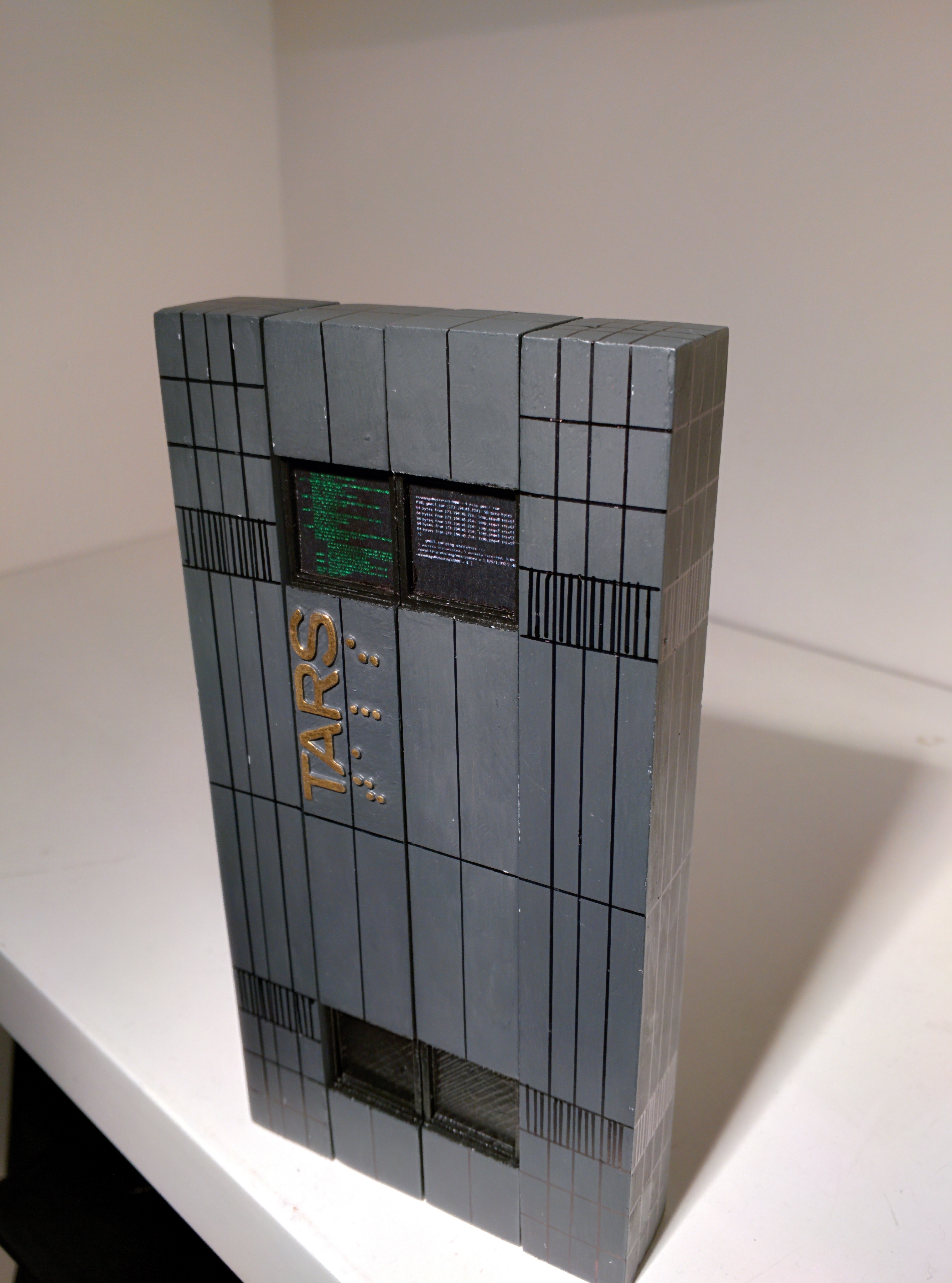

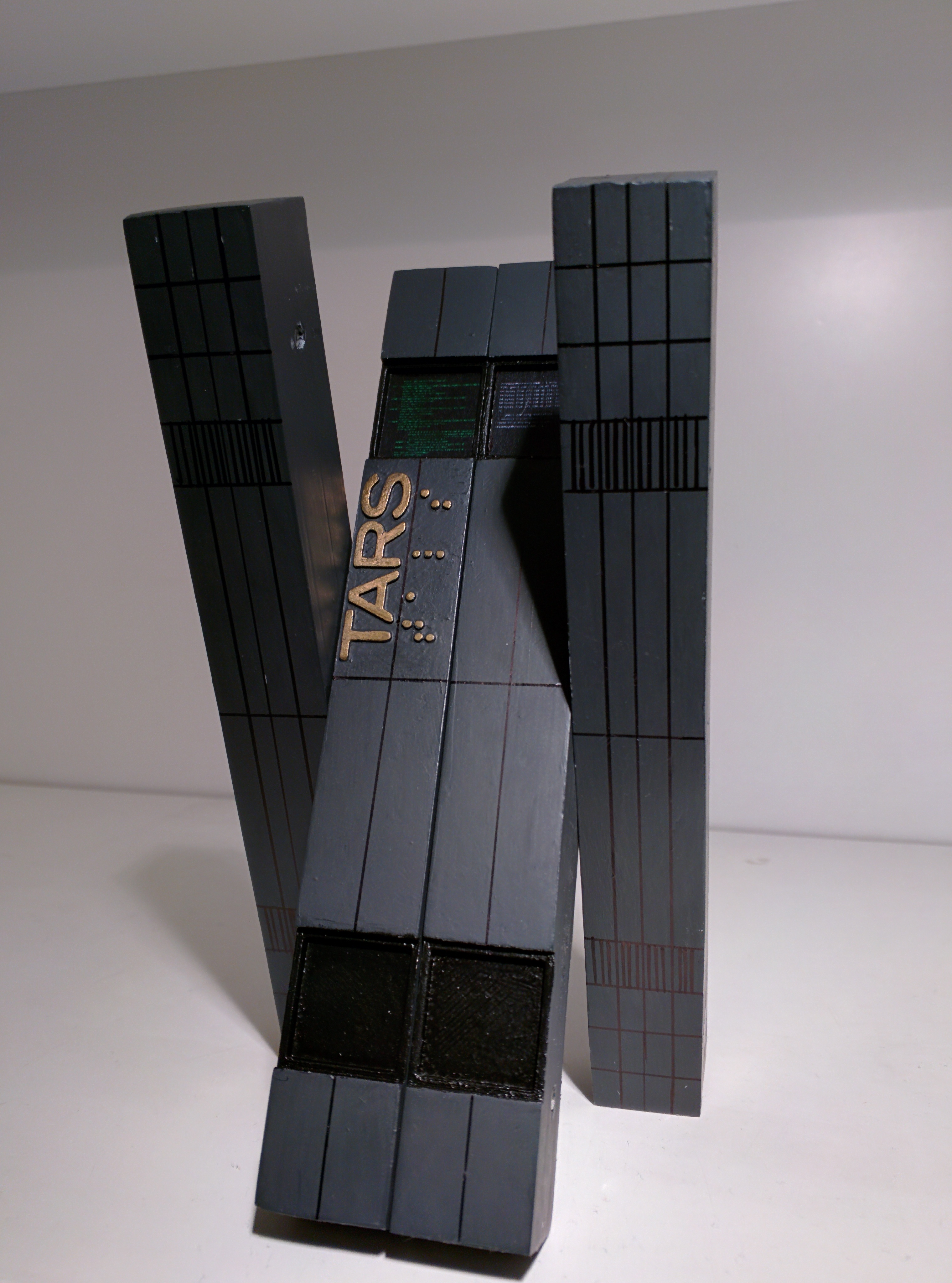

  10. Painted with model paint. I'm not sure if I did a good color choice, but I'm happy with it.

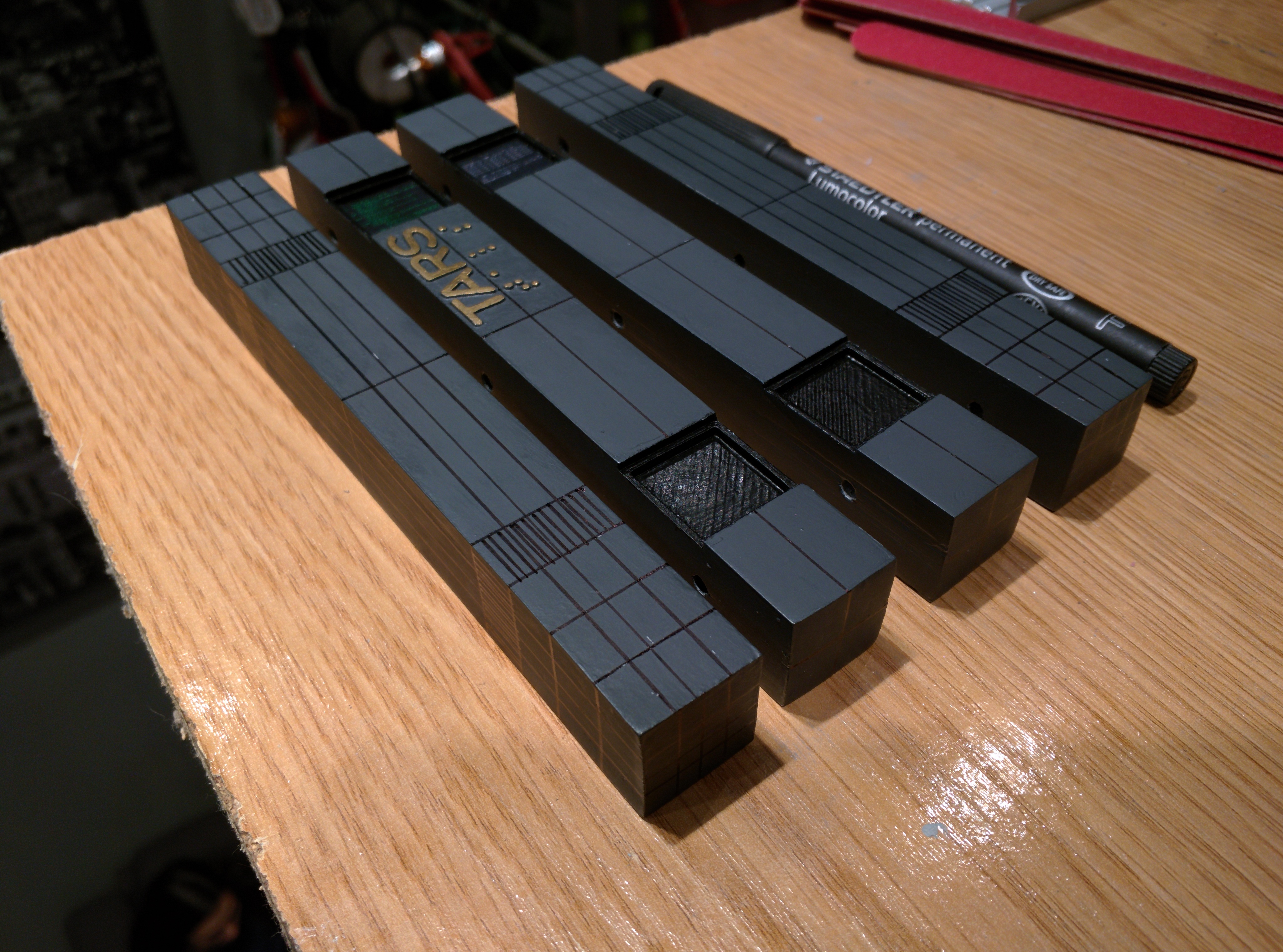

  11. Printed the screens in paper, and fitted them in the model.
  12. Painted the TARS letters and the braille dots with a golden colored pen.
  13. Painted the strips with a thin-tip black pen. I think I may have ruined the whole model by doing this, but still it's better than plain gray.
  14. Superglued the magnets inside the holes.
  15. And that's it! It's finished.
I was thinking in adding a polycarbonate layer over the screens to make it look better. I just have to find a place to buy it in the correct thickness.
Let me know what you think! I can take it :p
Thanks again for the files and the idea!
