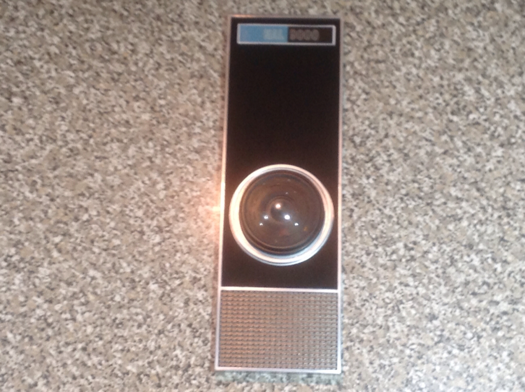

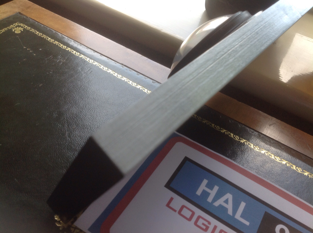

Thi sis the silver rub n buff frame...it looks better in the flesh than photos, the print lines look ok as machined ally and this effect saved a lot of sanding ,....lol...

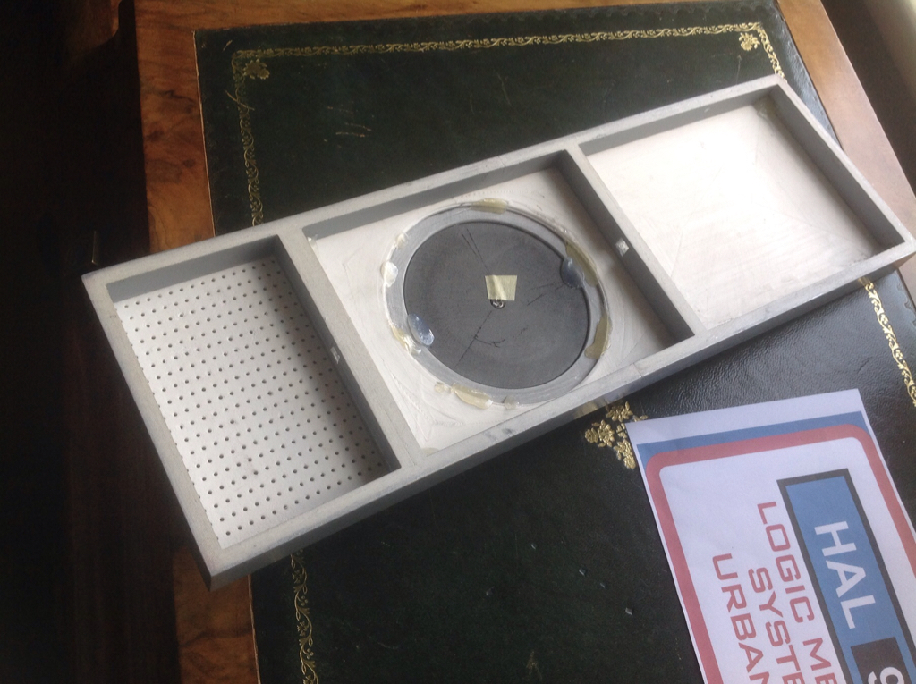

I've assembled the main components using hot glue, as this gives me the ability to dis assemble it for upgrades later on ....I'm just too impatient to get a complete ish HAL at the moment.
The led ive tot from the fake camera is a flashing one, so when a replacement non flashing led arrives from eBay I'll finalise the electrics .
Sent from my iPad using Tapatalk
