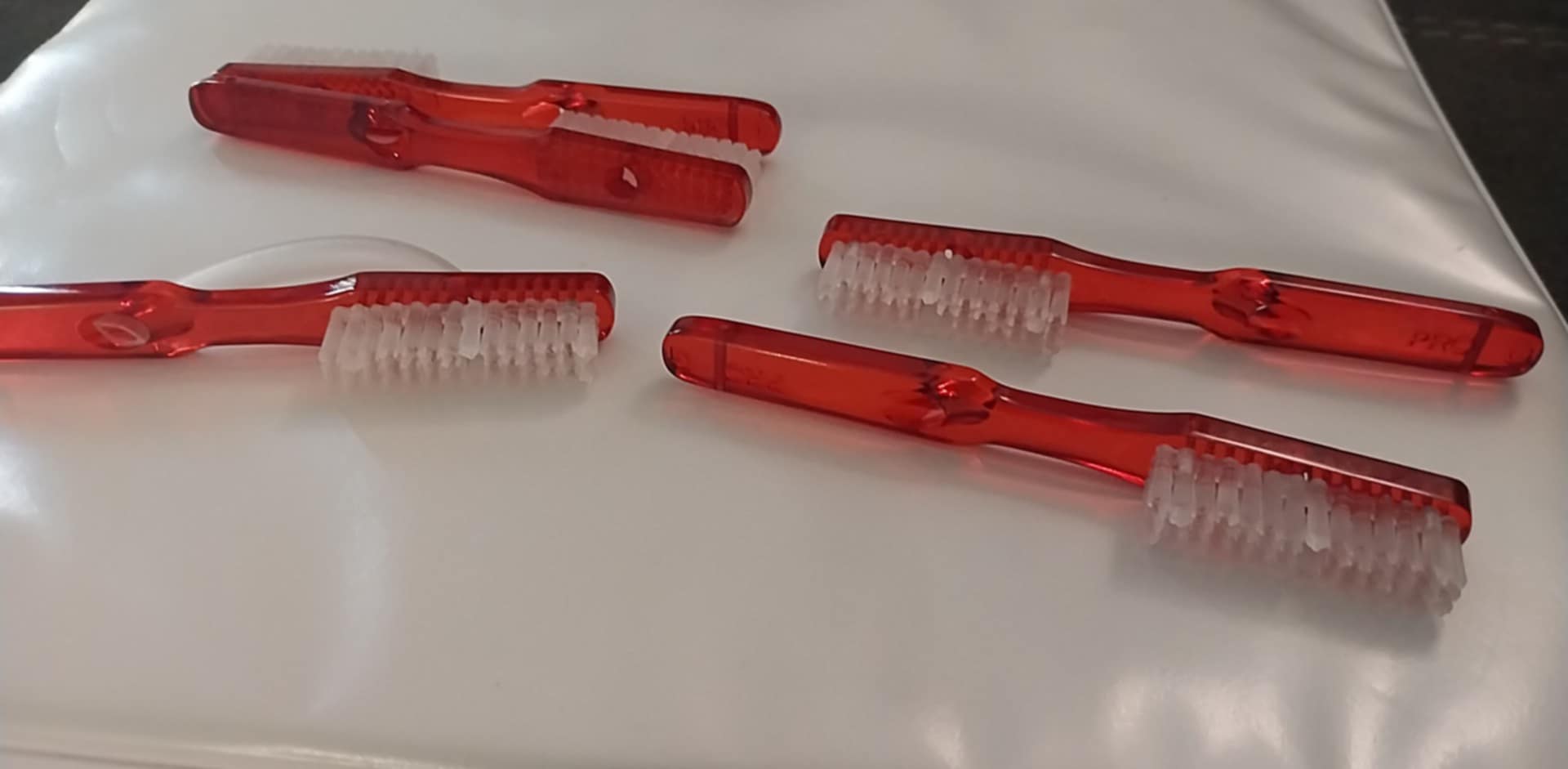

Toothbrushes are resin dyed, the 'bristles' on these examples are a one-piece translucent resin insert that was sculpted to look like individual tufts. While it is possible to hand-tuft a toothbrush head (and the finished handles do have slotting for them), it proved to be INSANELY labor intensive. I am very satisfied with these, they look even better than I had anticipated.
