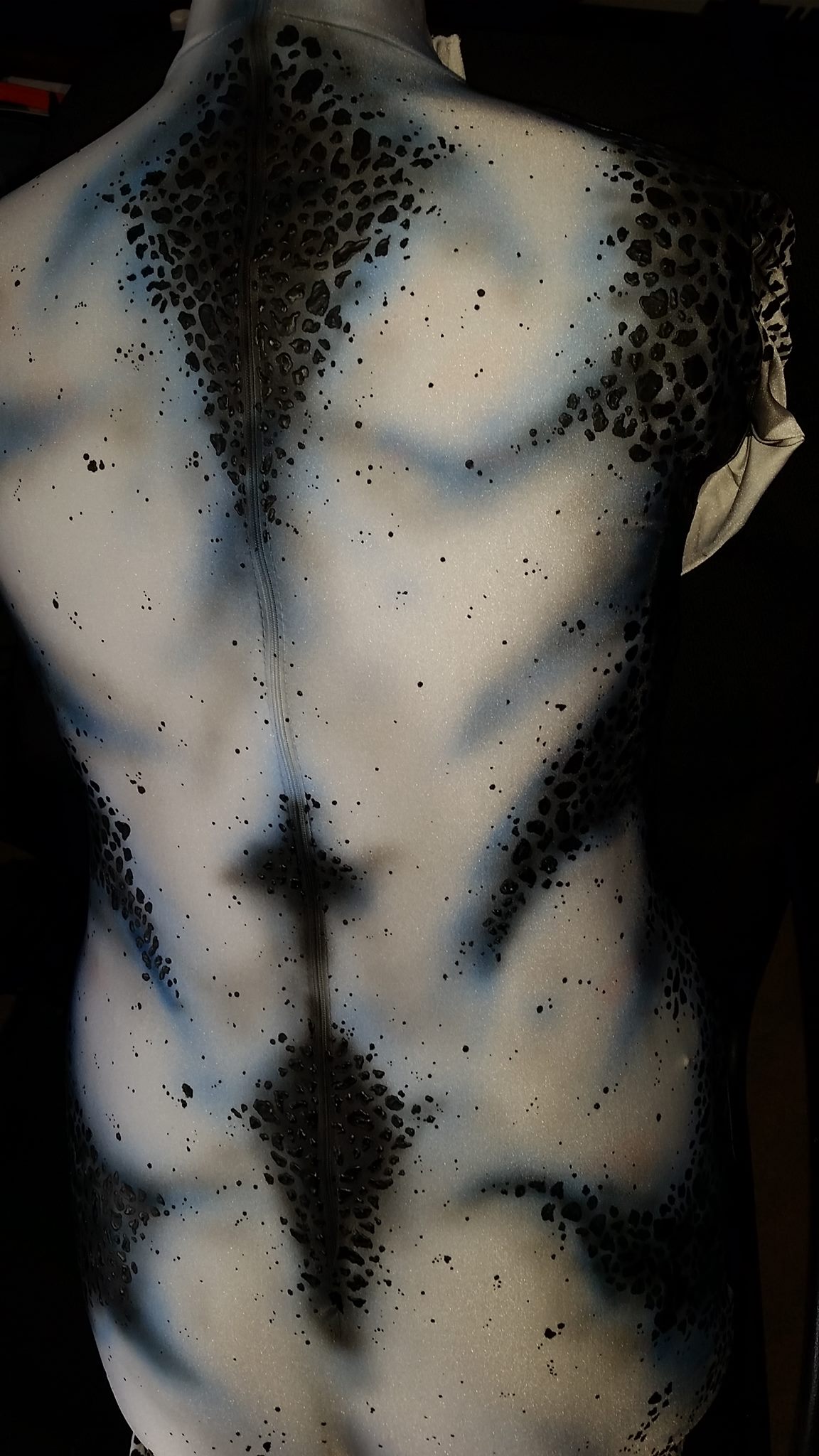

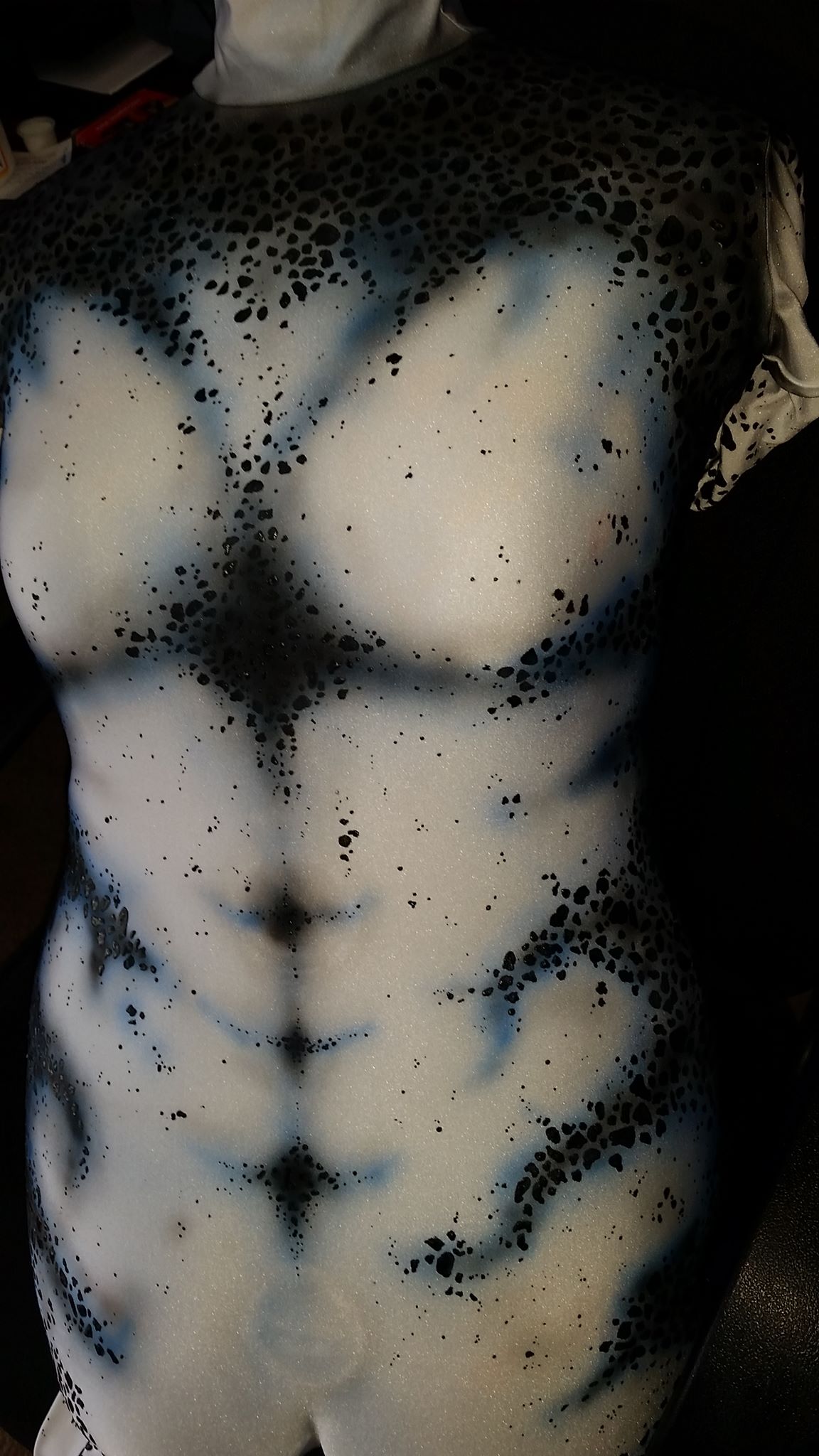

Suit
I don't know, I just kind of went at it with a focus of at least make it looks like you got boobs. I didn't pay too much attention to muscle anatomy as I am trying to go a little more sleeker in design.
FRONT
BACK
It's two weeks before Dragon*con, I gotta keep bustin out what I can get done, so just been focusing my whole time lately on cranking her out. And I still have to paint my fiance's whole predator!!!!
Again WOW. I really like this suit paint up. Love the spot patterns and colors. This is one of the best morph suit paint ups I've seen. Can't wait to see this whole build togather. You have some amazing natural skills and talent !
