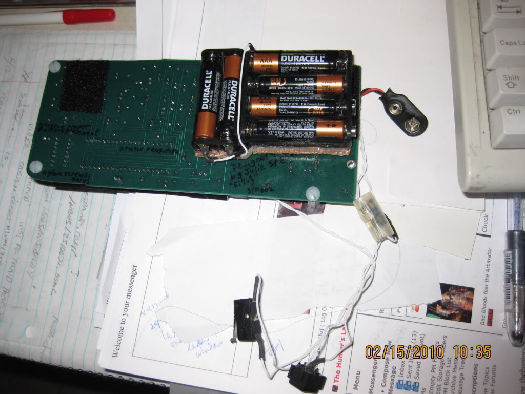

Speaking of said shop, I popped in after work and got some AAA battery holders and made some 6 packs** (BATTERIES, not BEER :( )
here's a couple pix,
on the board:
and now the board is skinnier (yup, I put it on a diet ):

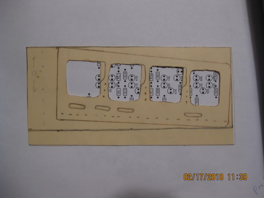

People have been asking about the P2, so a countdown that fits Biohunter76’s P2 gaunt is coming to life, the schematic, layout, IC programming, parts purchase and board order are done, so its rolling :)

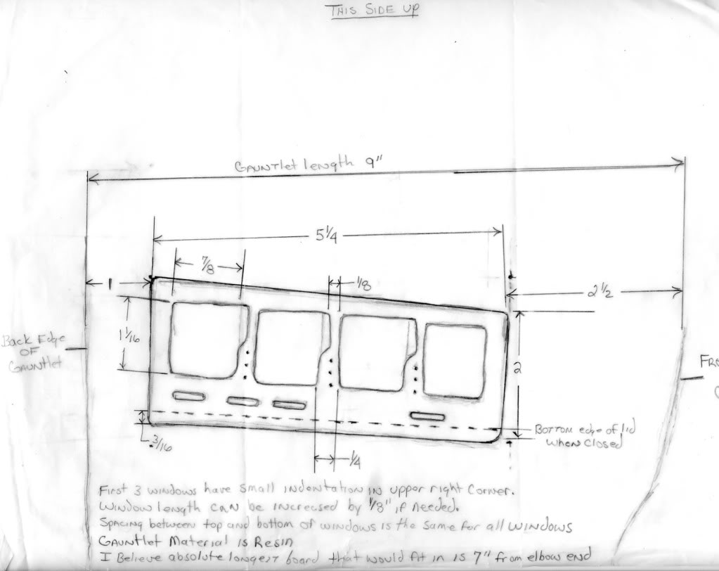

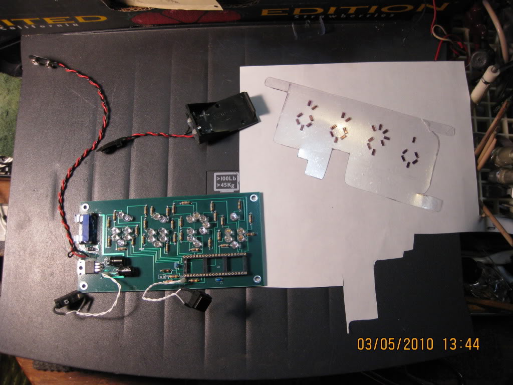

I used the AVP sequence, and just left the rightmost window off….but needed different size and placement of the windows -- again thanks to Dieabolic for the sketch he sent & Biohunter76 for the gaunt! – the sketch matches the gaunt to a T and that’s what made the template possible.

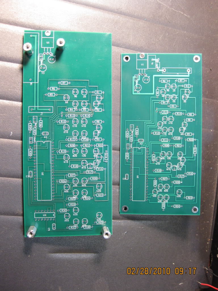

Then the schematic is drawn, and from that a layout is done; I use ExpressPCB, it has a schematic capture and PCB layout that work together. You can download the programs from their website: http://www.expresspcb.com/.
Since I had the AVP done, it was a matter of editing the schematic and layout and doing a little rearranging.
Since the layout prints 1:1 it made it easier to move the LEDs to fit the template.
Before:
After:
the two boards compared, P2 on right, AVP on left:
Coming soon to this thread: A built P2 board with the same sequence as the AVP, but without the fifth window. Boards came in Friday and I have all the parts, so am going to start building

To answer your question, Xdmray, it fits a Biohunter76 P2 gaunt.
Here's the tracing of it that Dieabolic did off of his gaunt & sent to me; see if it matches what you have:

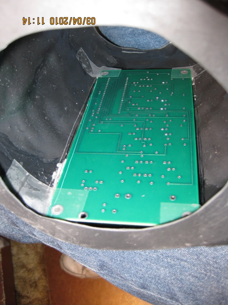

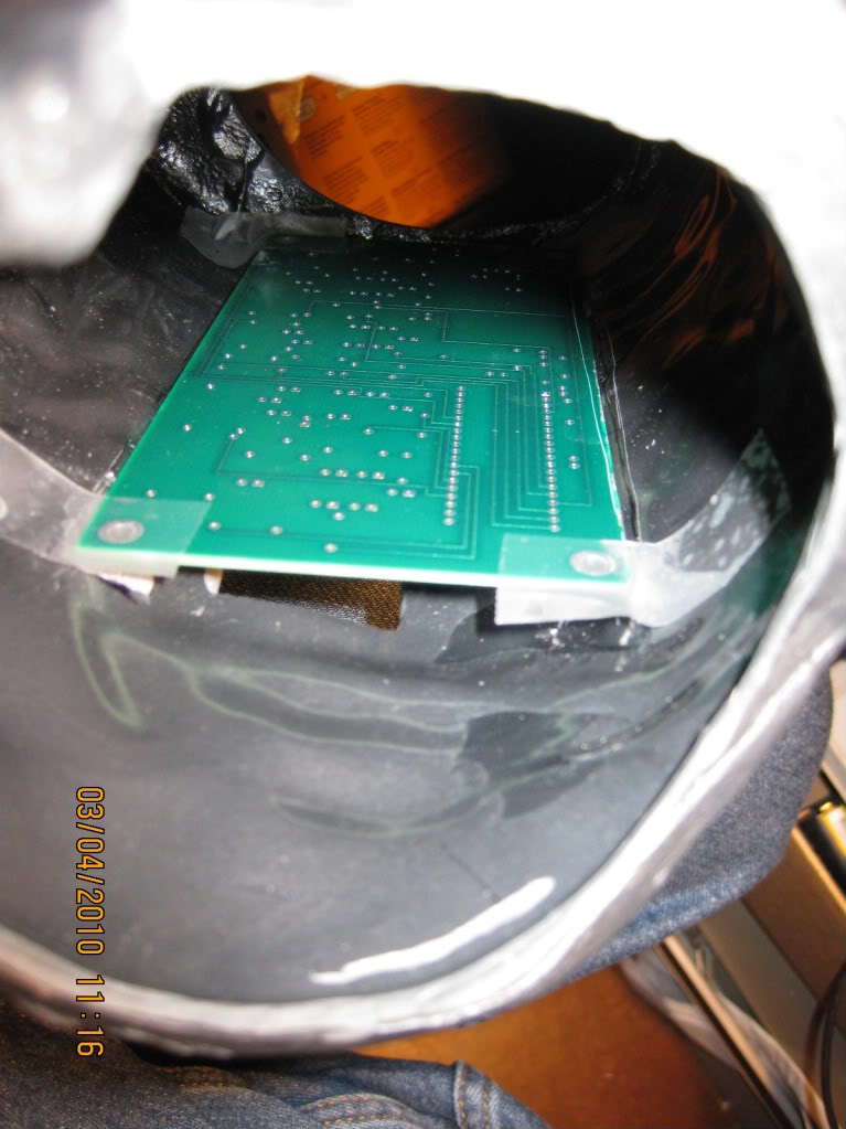

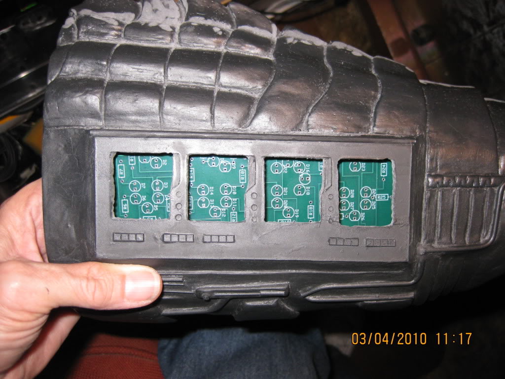

More progress pix
Fit fit and more fit; Exacto knife the inside where the board corners meets the gaunt so it doesn't wobble
the wrist end:
the elbow end :

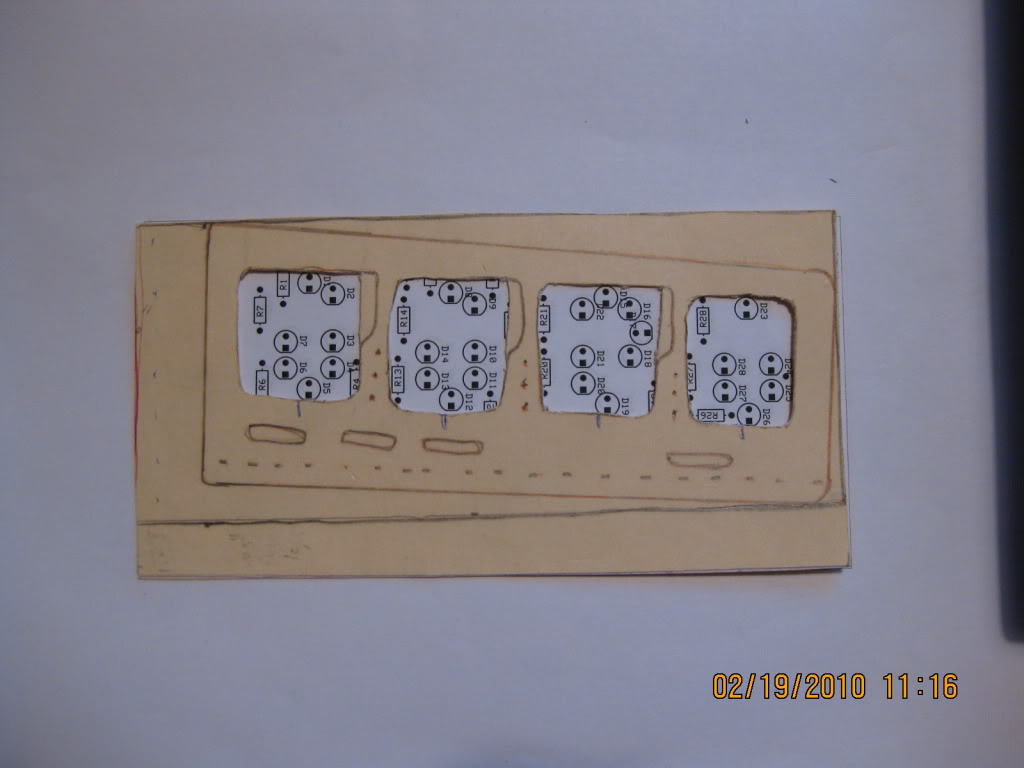

Windows and LED positions match:

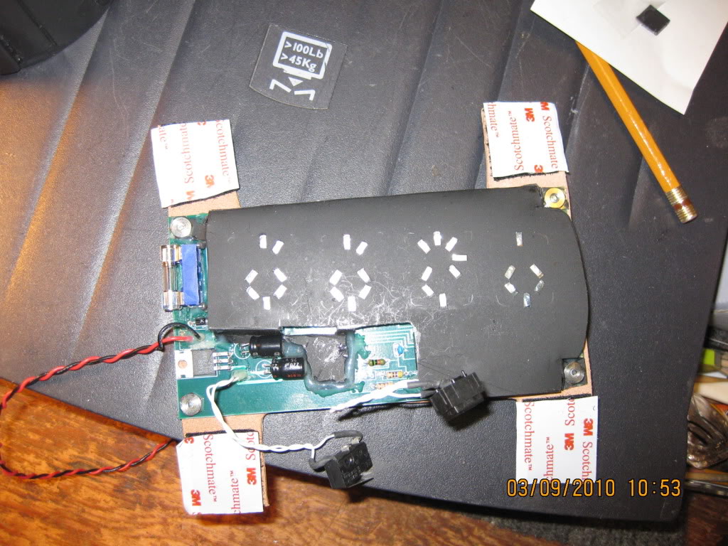

The built board and the overlay under construction:

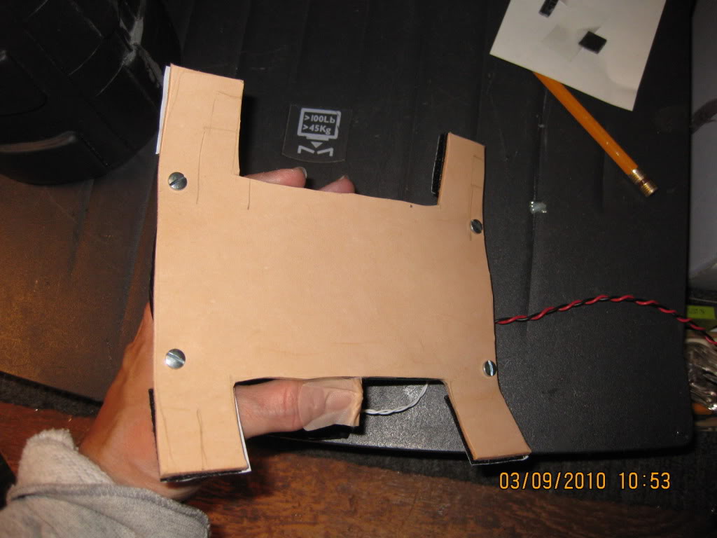

Board and overlay with the leather backing and velcro that holds it in; short screws and nuts secure it:
Front
back

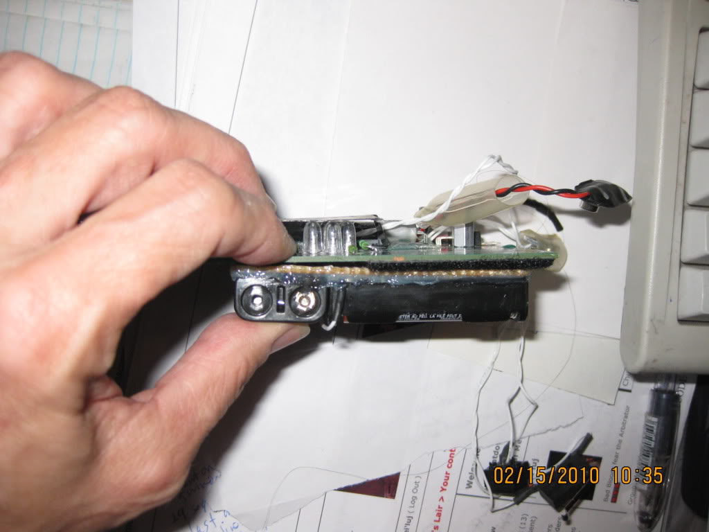

There's enough room in the "wing" part at the elbow end for the 9v battery; it velcros in also.
It runs!
