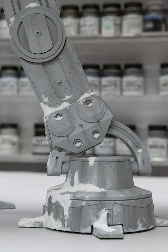

Thanks Stu! Yes, dtssyst pointed out over on the Merlin Models Discord forum for this model that baking soda will yellow over time. The key there is to mix in a bit of white paint he adds. And that matches up with another technique I saw on the web that called for a mix of PVA glue, white paint, and baking soda - very similar to your suggestion. I think now that I've practiced my technique with the shaving foam/baking soda mix I'll move to a more permanent solution as you suggest. I just wanted to be sure I didn't botch it up with a permanent technique right off.

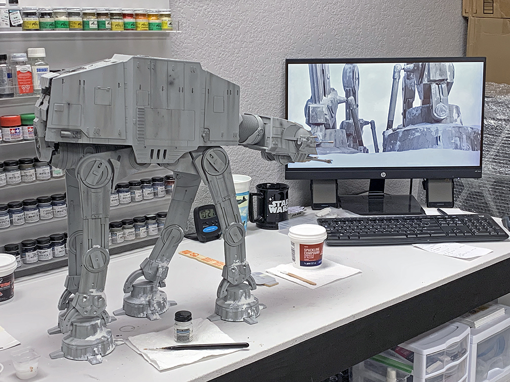

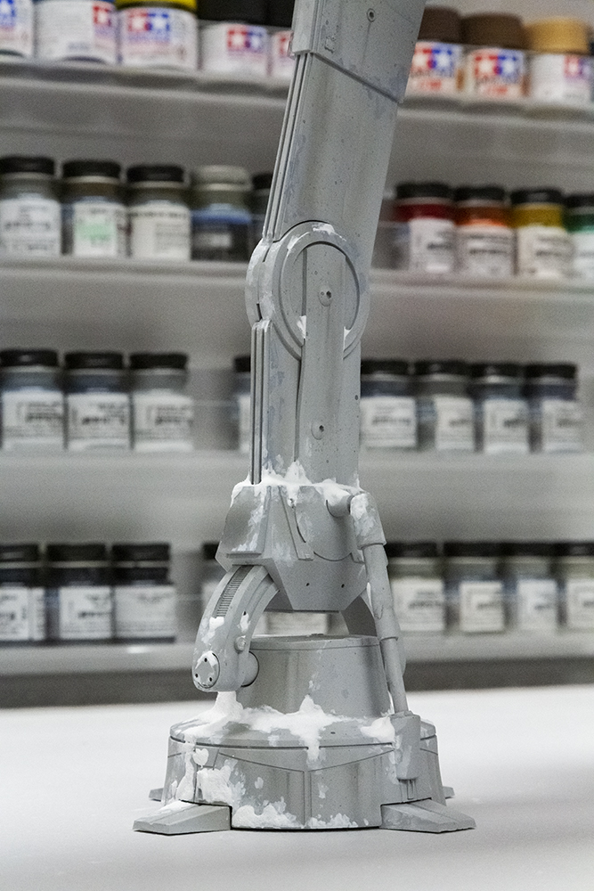

Slow progress on my end the last week, but getting some snow back on the feet, using this screenshot image as a style guide:
I did decide to ditch the shaving foam/baking soda mix in favor of Chris's lightweight wall filler, white paint, and water. More web research indicates that it's not so much the baking soda itself that is yellowing, but acid-containing PVA glue. If you choose acid-free or 'kid safe' PVA you're probably okay with yellowing. But, that said, some people report other problems with baking soda itself having to do with corrosion of the underlying paints and plastics, leaving yucky residues with time. I figured let's just avoid it altogether no matter what the potential problems.
The lightweight wall filler, mixed with a bit of white paint for good measure, and then thinned appropriately with water paints on like thick paint and hardens to a hard foam-like consistency. I then add a bit more white paint dabbling to blend and add lighter snow and that snow dusting look matching the screenshot style guide. I'm working the non-hero, 'back' side for practice, before moving over to the hero display side. I'm happy with this so far and am moving on around the feet and then up to the body...

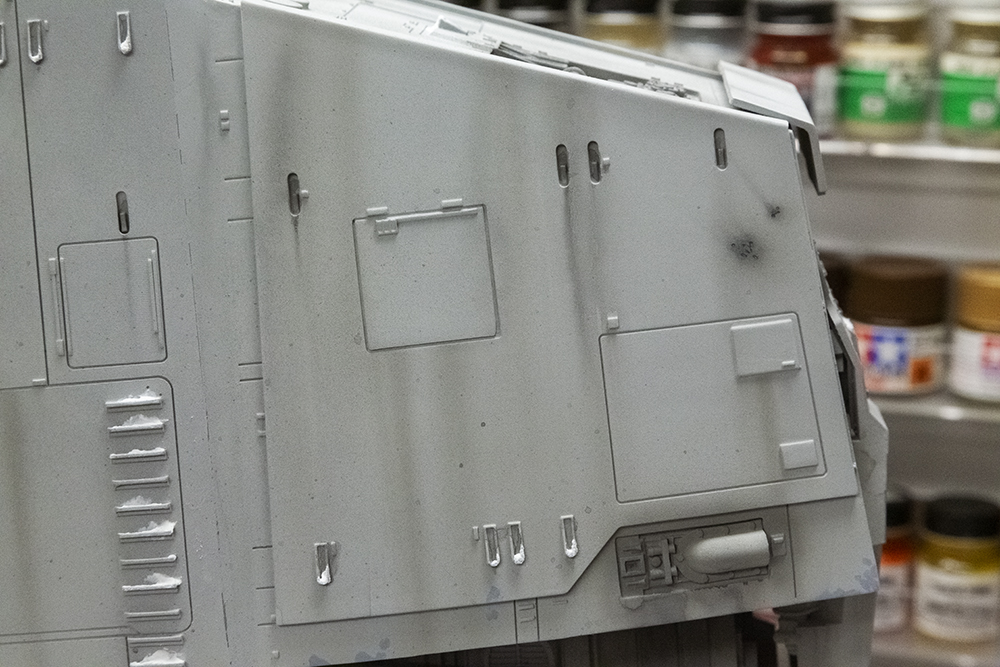

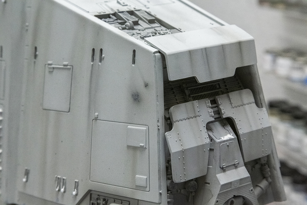

Having seen how Merlin Models is painting theirs, and seeing your technique, I’m probably going to follow your technique. I think yours has turned out amazing. Is there any risk of the pencil weathering wearing off or fading over time?
Very nicely done!
I’ve found that once the pencil line is drawn down and blended by the q-tip it becomes very durable to casual touch. I guess if you were to really work on it with your finger it might smear more but I’m handling this all over during the snow work with no problems. I suppose you could surface matte coat when all done if you were worried it might need some protection.

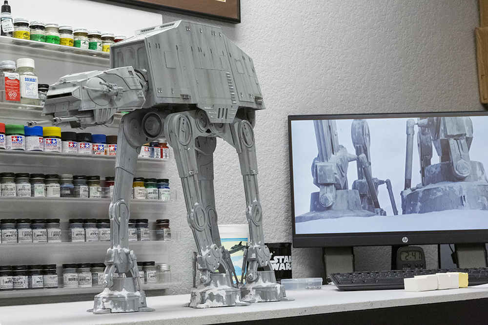

Okay, pretty much done I believe (standard disclaimer that that means I stare at it for several days and make tweaks to mistakes and things I missed :) )...
It's been an incredibly fun build and again, hats off to all the folks at Merlin Models for producing such a great kit! Thanks to all here for their advice and tips.

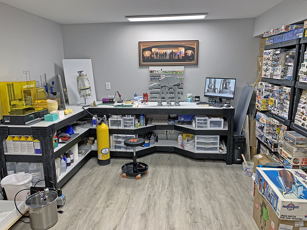

Really turned out awesome and the snow really looks to be in scale with the model now. Your work space is nice; I'm envious!
