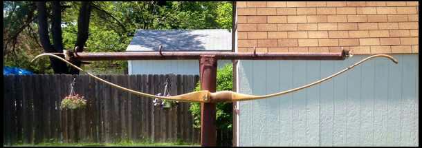

After quite a long google search, I can't find any one piece recurves that match the distinct shape of the riser that I am looking at from production stills. It may indeed be custom. No bow I have seen matches the shape of the riser just above her hand. I haven't seen a single other recurve that has a perfectly smooth sight window (or I guess it's perfectly smooth because it has no sight window).
So far the most similar results that I've turned up are custom bow makers, but given the simplicity of the design, it really shouldn't be hard to have a bowmaker replicate one for me. Obviously I'll need to come up with a set of working dimensions for the riser and the overall length, but I think if I get in touch with the right person, it should easily be doable.
I am going to keep looking though when I get time. you never know what I may sniff out on the internet. :)
The closest bows that I've found are some of the 50's style recurves I've done a ton of research but was hoping you would find something different. The first pic is a bear recurve. the second a mingo youth recurve but is too small. The third is a great northerns bow hunting ghost and I've emailed a bunch of custom bow makers and none of them supplied the bows for the movies. The fourth is some vintage hoyt recurve. Also during the training scene when katniss grabs the bow off the rack the bow on the top looks like the bow in mockingjay uploadfromtaptalk1411329645142.jpg uploadfromtaptalk1411329555110.jpg uploadfromtaptalk1411329509727.jpguploadfromtaptalk1411329489392.jpg
I have seen all of those so far, and I'm even considering (dependent on more reference material) purchasing one and sanding it into the proper shape (which may or may not be possible given the depth of the sight window on the base bow). It may compromise the structure of the bow for full time heavy usage, but given the low price points of them (relative to the hoyt buffalo) I'm really not that concerned about it. I have heard whispers that this may not be the final bow though, and that the actual mockingjay bow may end up looking different. If that is the case, then I may not end up replicating this bow at all.
If it ends up that nothing else will work, I'm sure I will end up contacting a custom recurve bow maker and they should easily be able to replicate a design this simple.
I'm pretty sure it is the final bow but there is a possibility it isn't because one of the guys from hout said that they will be using the buffalo for the next two movies but since the release is only a good two months away we shall wait and find out
I've done some more research and emailed hoyt here's what she said " No one here knows, due to disclosure policies we wouldn’t be able to give that information out, sorry."
