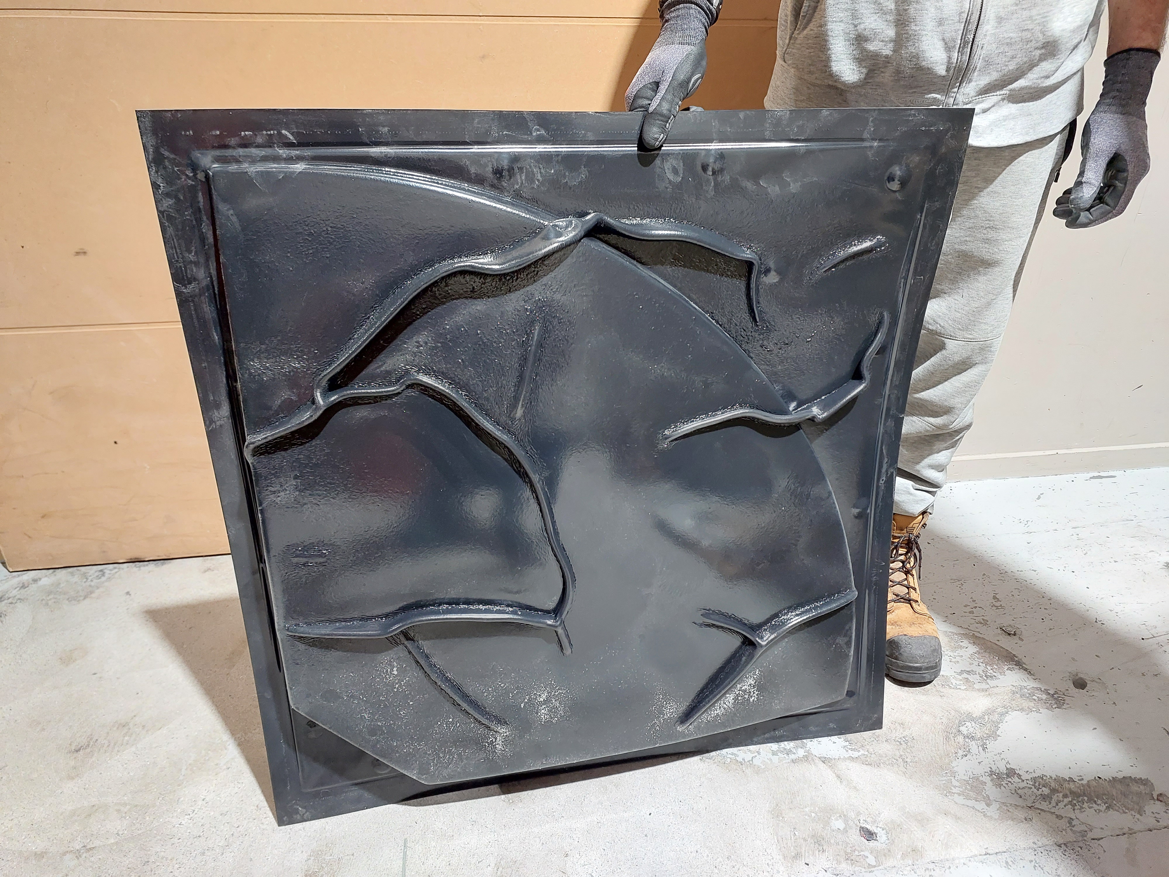

Here's a pic of a reject test pull that turned out quite interesting. Looks very much like a molten moonscape kind of appearance & would make a great base for a ship or whatever, vehicle perhaps?. Anyway, I left it at the factory as no room here to have just lying around. This happens when the ABS is not quite dried out enough & the machine too hot!. All the pulls after a few test shots are stunningly perfect!.
