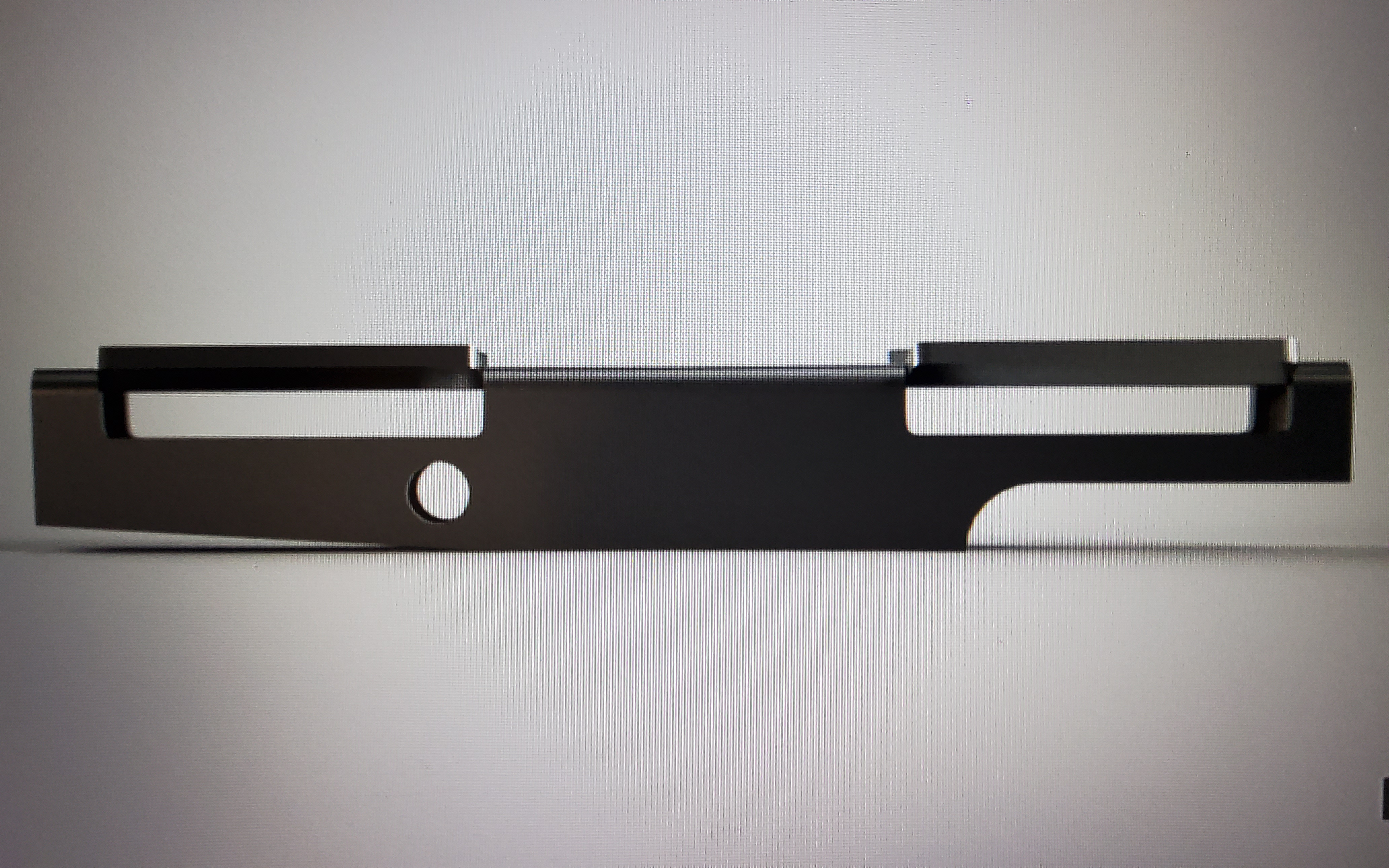

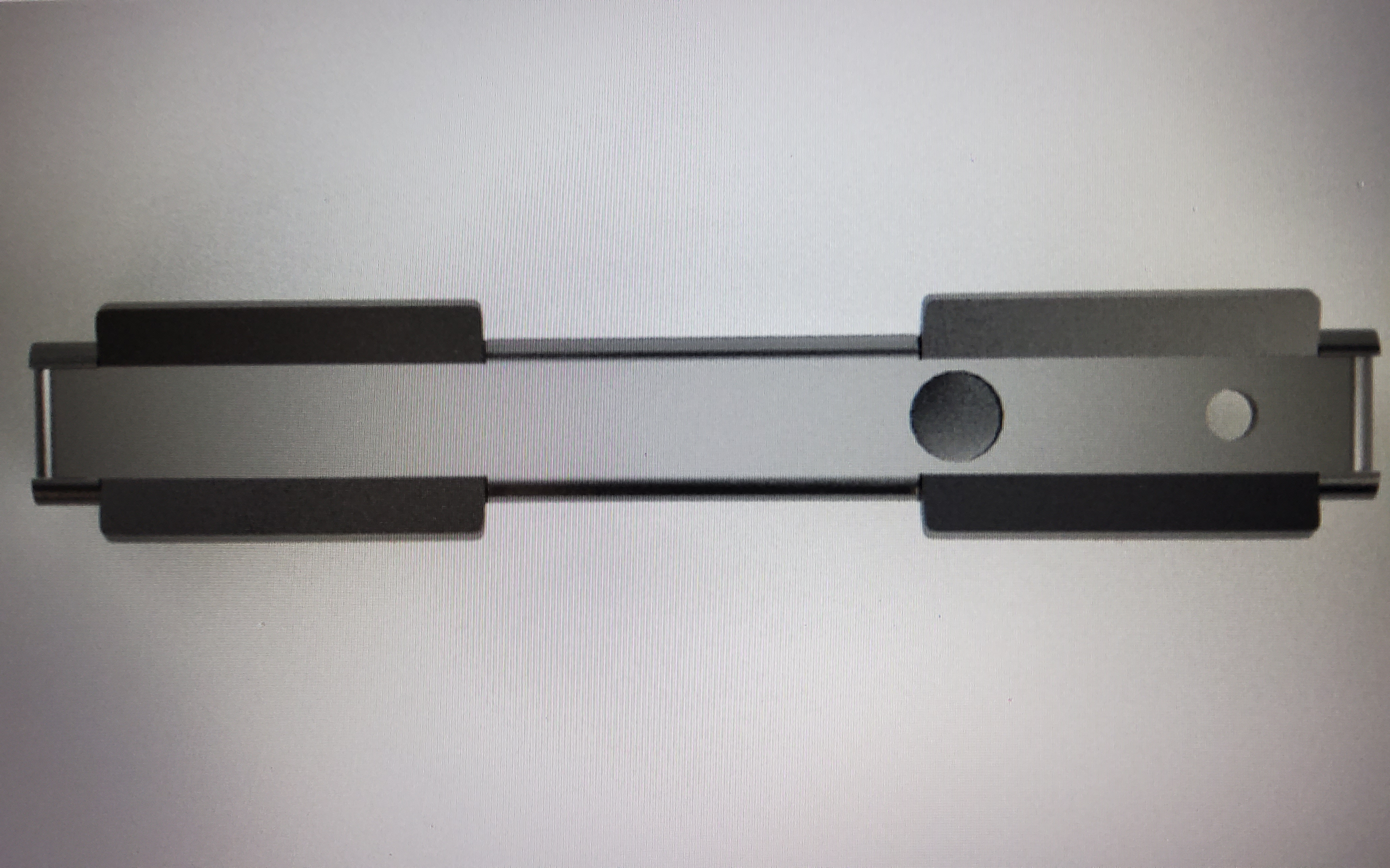

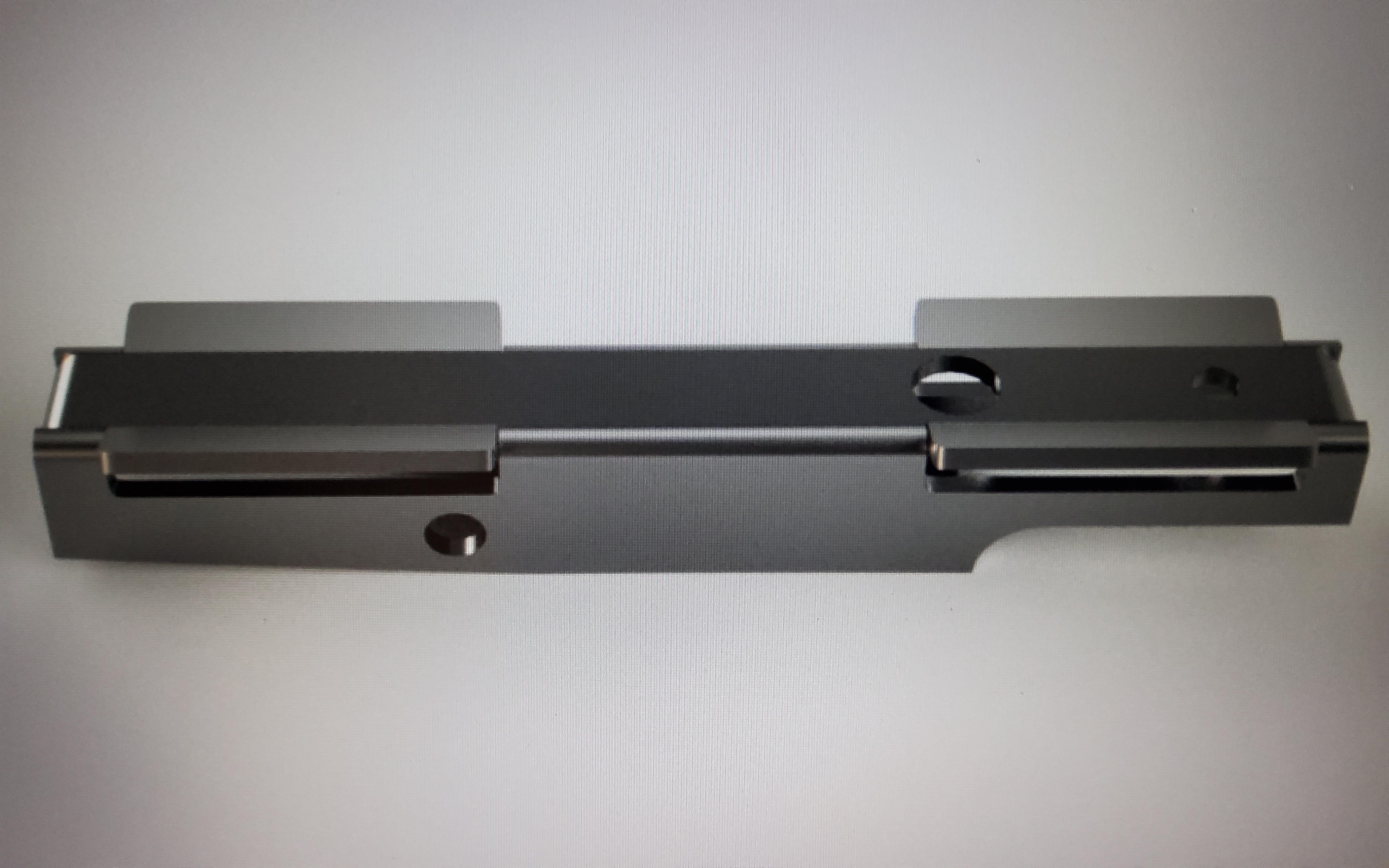

Here's the pictures of the new fully sheet metal scope mount in cad form:)
View attachment 1445978View attachment 1445979View attachment 1445980

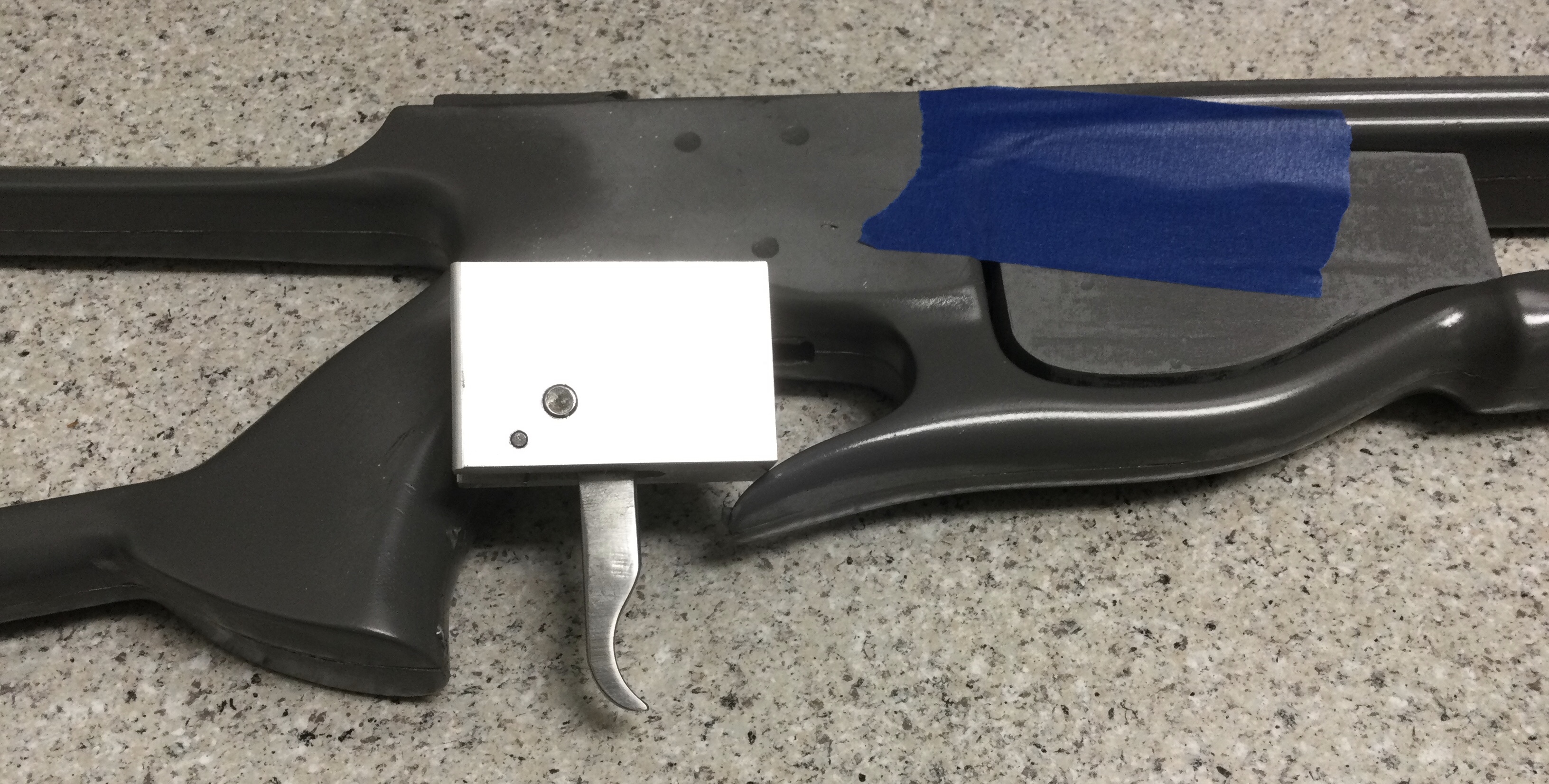

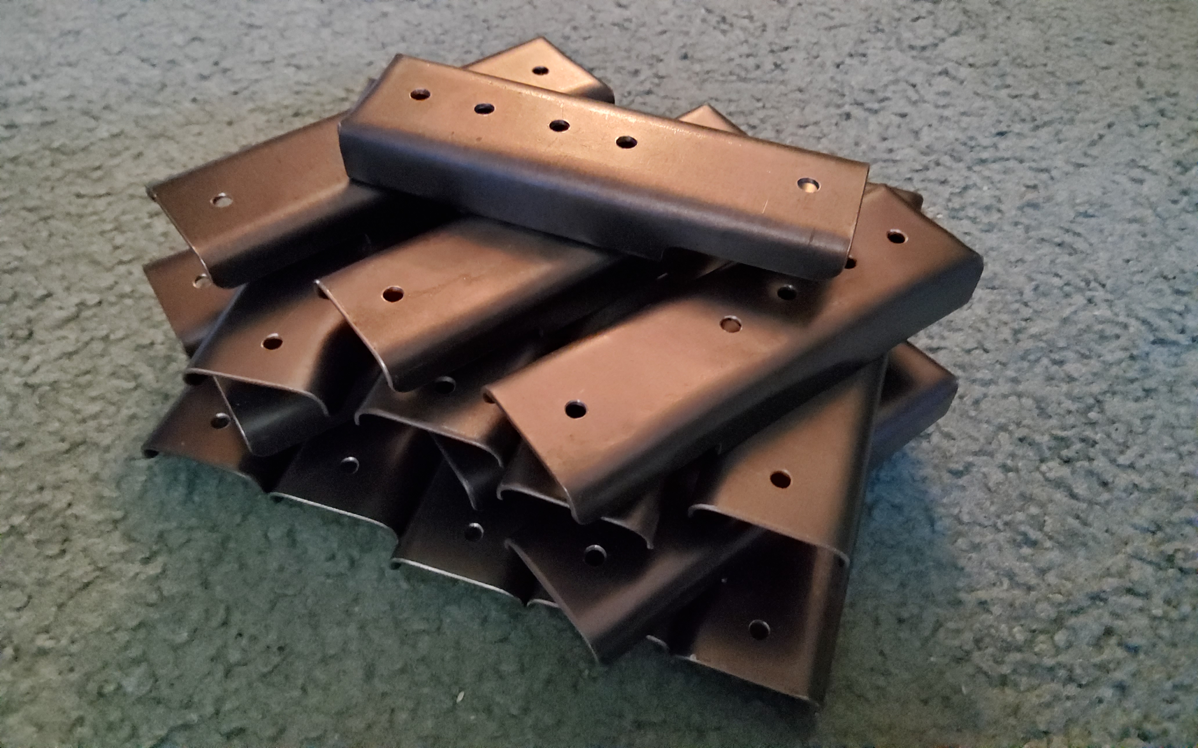

I also got a bunch of trigger covers finished up as well this weekend!
And these trigger covers are comparable w/ the trigger group that Portumac is making ?
To be honest, I think it would be F.A.B. If someone could lay out all the parts to show how they are installed and take some snaps as I’m a bit lost on where some of these go and how to attach them.
I don't unfortunately have one of those triggers to reference but there shouldn't be any fitting issues of the cover, since the trigger is recessed in the frames rectangular opening.
The cover sits right on top of the rectangular block near the back end of that rectangular opening, with the front of the cover hiding the triggers top.
I am working on an instruction sheet as well to go with the parts, so hopefully that will help.

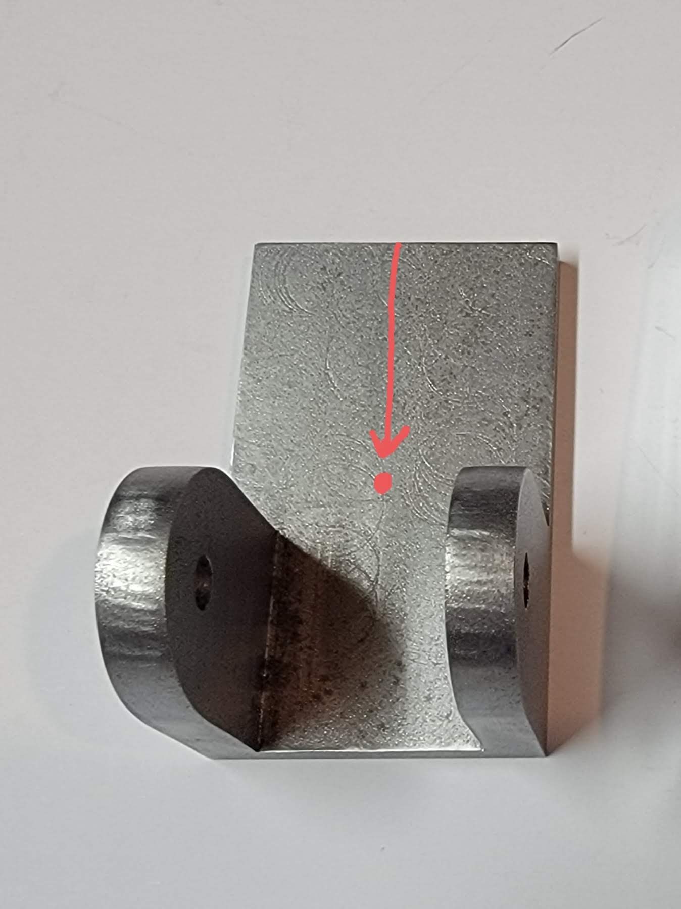

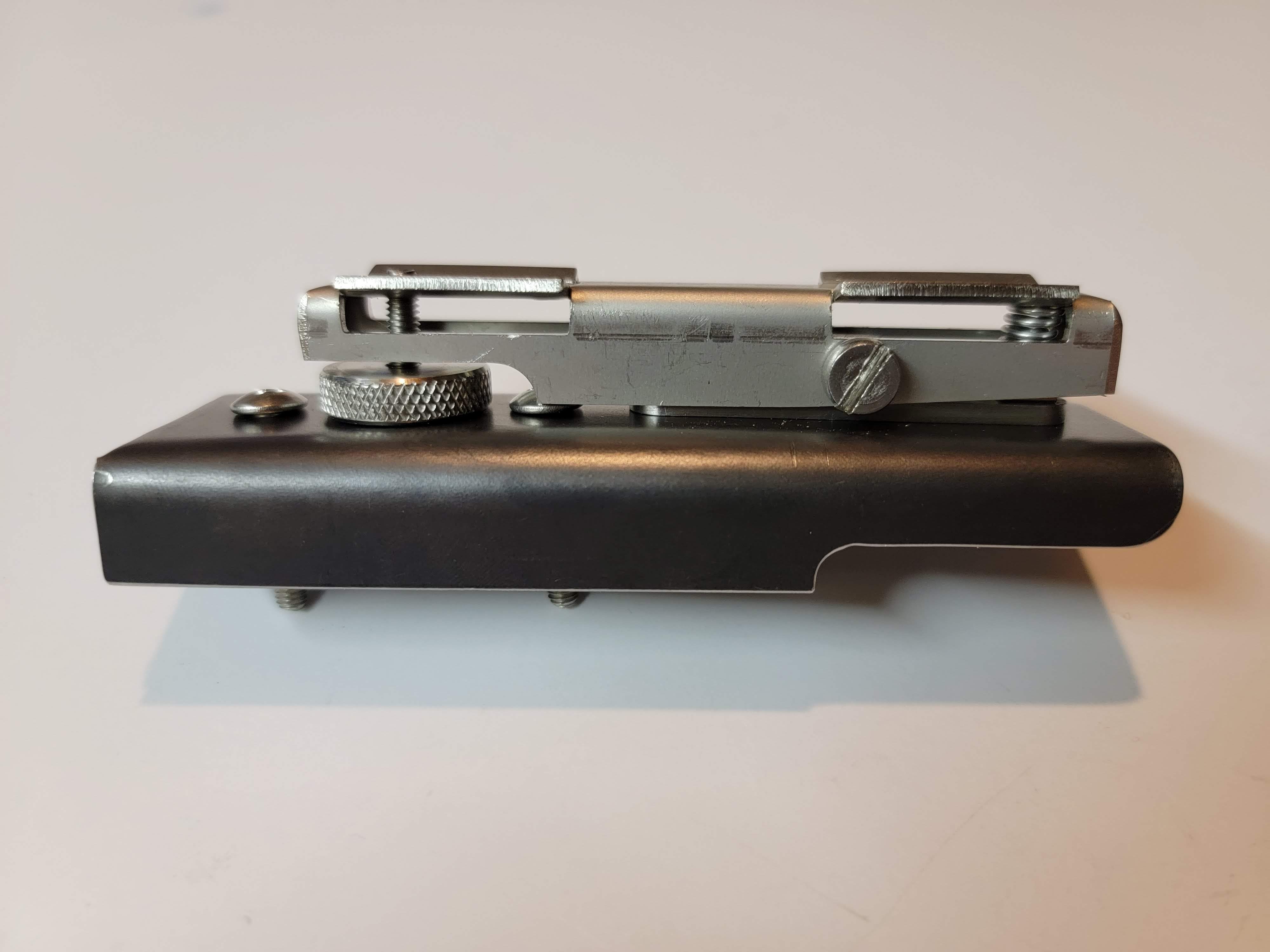

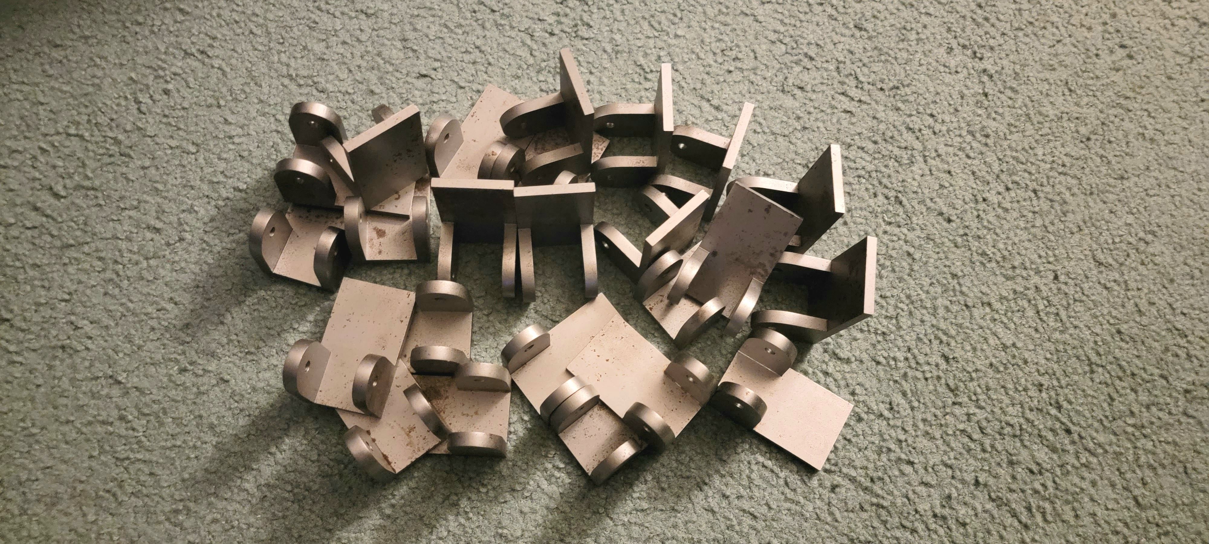

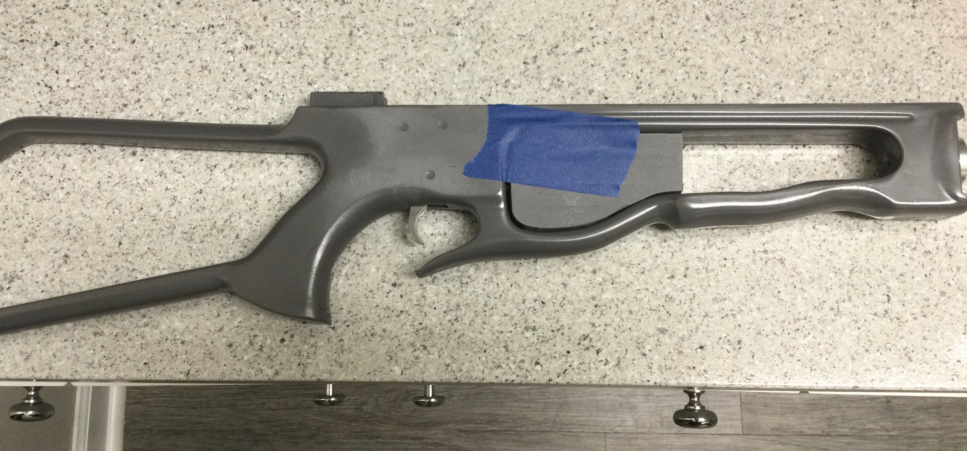

Hi everyone I just received the scope mounts today and also have an update on the hinges for the barrel support. Here's a picture of the scope mounts which came out amazing and I will have plenty even for the waitlists. I also fully assembled one with the trigger cover:)
Here's a picture of the hinges, they don't have the attachment hole drilled into them as I had a few members ask to drill it themselves to make sure it fits their frames.
I have since for that reason decided to let everyone drill their own attachment hole so that it will for sure fit perfectly to your bowcasters frame.
(If you do need me to drill your hole just send me a message and I can drill the hole to 1.29in from top to center for you.)
I am doing the finishing touches at this point and I am starting to get orders ready to ship, so thank you guys and I look forward to getting everyone their parts!

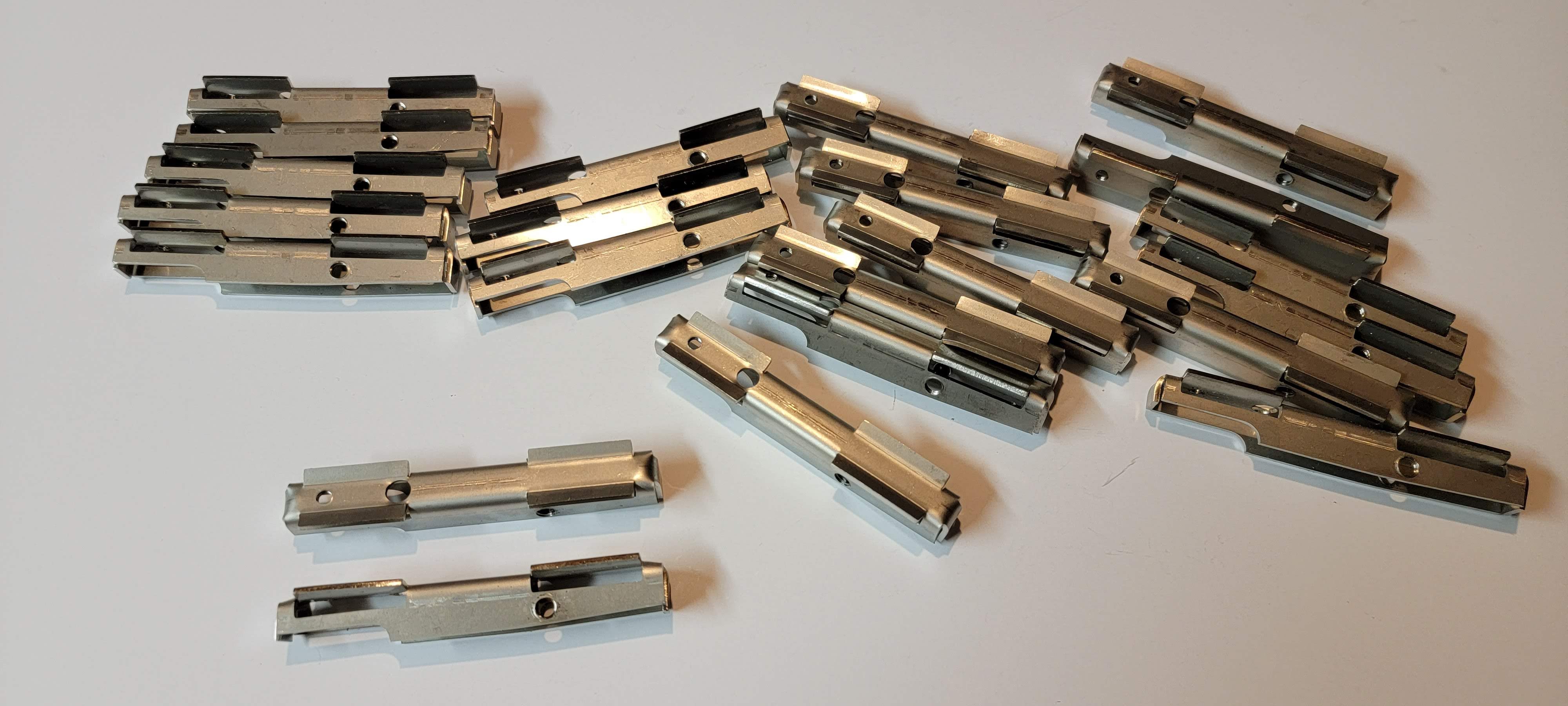

Here are the stainless steel real stock clips I had to make. I didn't want to make that many, but the set up time was too expensive at my local sheet metal shop to just make 2 or 3 clips. I'm offering each clip for $30.00, two machine screws will be included. The holws will fit 6-32 screws, or 6 sheet metal or wood screws. These will fit any frame. I think now we all be able to finish our Bowcasters' prop projects soon.

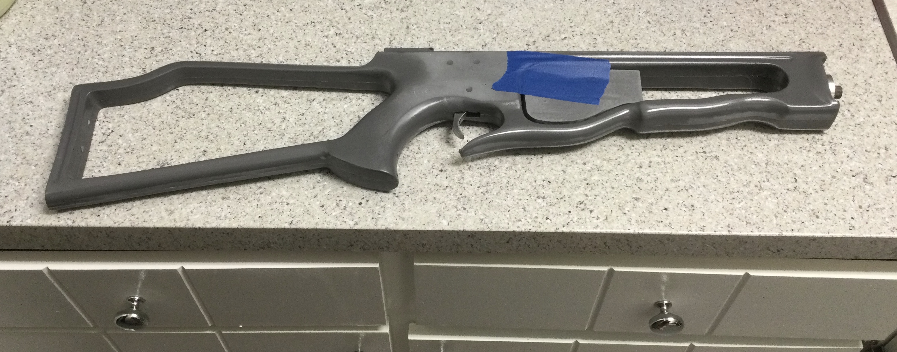

I just received Portumac s awesome trigger assembly. Holy cow this baby has some weight to it! It’s awesome!!
I have done nothing to this bowcaster frame, as I’m waiting on getting every in first. I will say, as an impatient person, it has not been an easy wait.
However! I couldn’t help myself with this trigger. I had to try & pop it in ( nothing permanent ), & it goes right in so beautifully!!
It’s been a very long time since I’ve “PEW PEW”’d around the house with my bowcaster... but I did tonight!!
It looks so much better WITH a trigger sticking out of the frame!
PROGRESS! It’s a beautiful thing.

Question. How does the barrel mount, the U shaped cockeyed thing with the slanted screw, mount to the trigger cover/scope mount?
Thanks again to both of you for doing this.
I'm still working on the instruction booklet which will explain everything in more detail with pictures.
But first you'll want to raise the scope mount with the dial until it is as high as possible. Next loosen the diagonal screw and place it through one bracket and then under the scope mount and in front of the dial, then through the second bracket. Lastly using the dial lower the scope mount until it sits on top of the screw and holds it down fairly tight.
Also you'll want to insert the barrel and tighten it in the mount before attaching the mount to the scope mount and cover, as it will be easier to attach that way.
