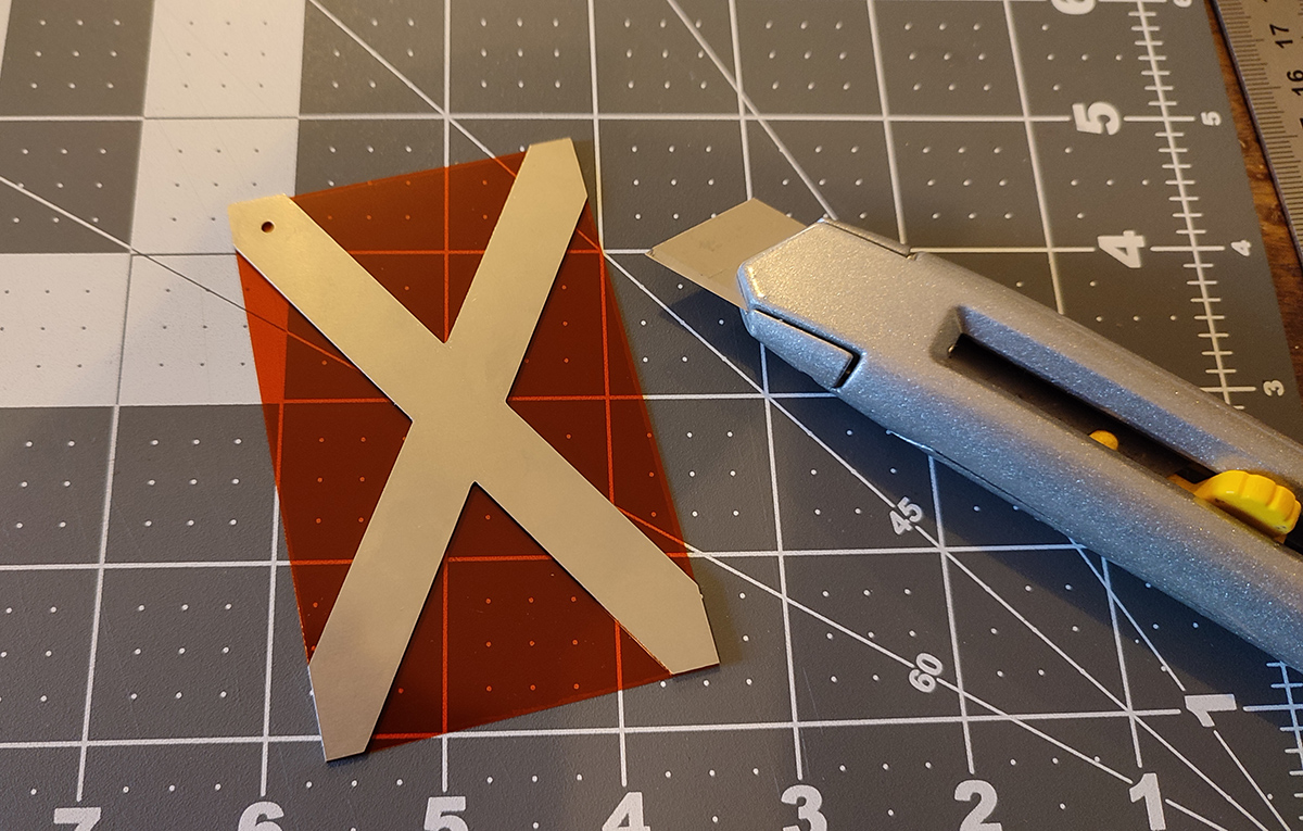

Limited Run Blade Runner police badges with vintage Amberlith X. *** last badges in stock ***
I know almost nothing about amberlith, is the backing removed at this point, or do you do that after cutting out the X?
Hey, I'll explain all this when I assemble the badges :) including showing a test of a different technique I tried today. I'm trying to document this run a bit better as I realized I didn't take many photos last time.
But, at this point the backing is still on, I use a scalpel to remove it when putting the badges together.
40 X done at this moment, my fingers hurt!
Cheers

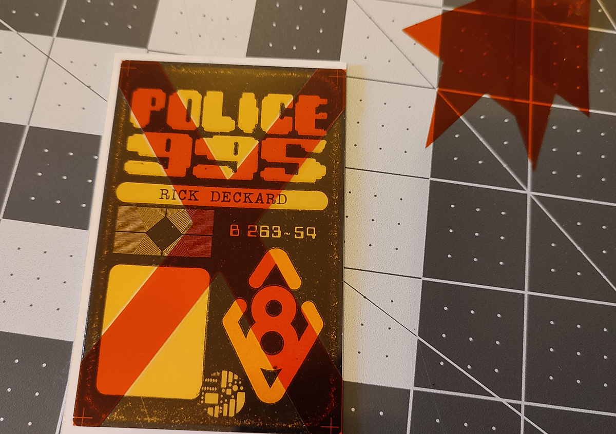

it adds up an extra step in the begining, because I normally use my template to cut the X directly, here I first need to cut a perfect rectangle, then scribe the X carefully, only going through the layer of amberlith itself:
then peeling off the parts we don't want. And here you can already see the issue we are going to have sadly. The amberlith being so old, the color has bleed through the backing.
anyways, still want to go through with this to see how the X would look and if they could possibly have used that technique.
all pieces of unwanted amberlith removed, I put a little bit of tacky glue where the photo goes so the plastic rectangle doesn't move too much.
(not white glue like in the Earl Hays video! white glue does absolutely nothing with the amberlith backing)
looks like I didn't take photos of the next steps. Cutting the borders according to the white crosses visible above, then cutting the corners. The amberlith with backing being more rigid, the corners are cutting nicelly.

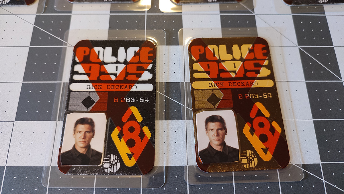

Here is the laminated result next to a normal badge.
There is a weird white/clear line all around the X, apparently cutting and peeling off the amberlith cleaned the backing in that part for some reason. But appart from the very obvious yellow hue all over, the result is extremely similar to the way I normally do my badges.
SO, sadly, there is no way for me to do the badges that way anymore because of the age of the amberlith, but it is enterely possible they used that technique at the time, pretty fun stuff!

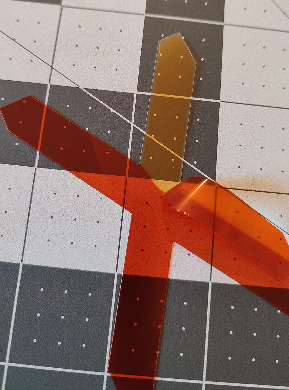

first, we need to peel off the amberlith from its backing material. YES, like most of us know, there is a backing to the amberlith, it is very rigid and thick. the amberlith itself is extremely thin.
I use an Xacto knife for this, carefully, for both top edges and carefull peel off each side, especially carefull where they join as this is where they will tear off, as seen on the right when only peeling off from one corner:
look how thin and flimsy that thing is compared to the backing:

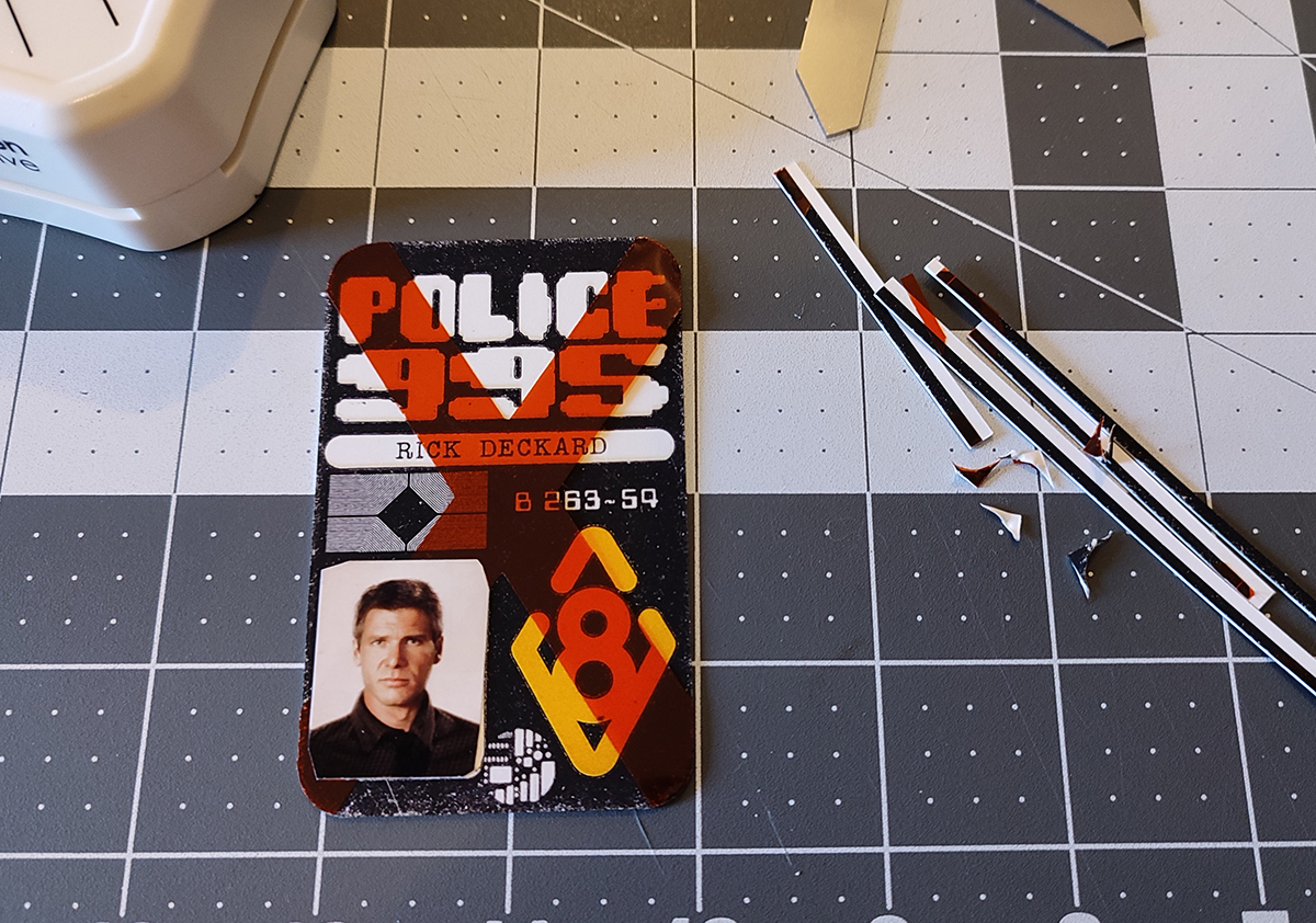

so, I finished all the Deckard badges for this run, just the 3 other characters left to do :)
In the end, 33 perfect badges, 13 rejected! that's always the worst part about this project, I'm pretty drastic about the validation but there are so many things that can go wrong at any step.
But, let me tell you, I'm so happy about the validated badges!
After 150 badges done, I have finally figured out the perfect way to laminate them and my round corners are finally all coming up just perfect :) This new run is just about a lot of really small details and I was already really happy about my first run, but I'm glad that I managed to push things even further this time and not just mindlessly do a bunch more :)
I hope you guys will love them!
