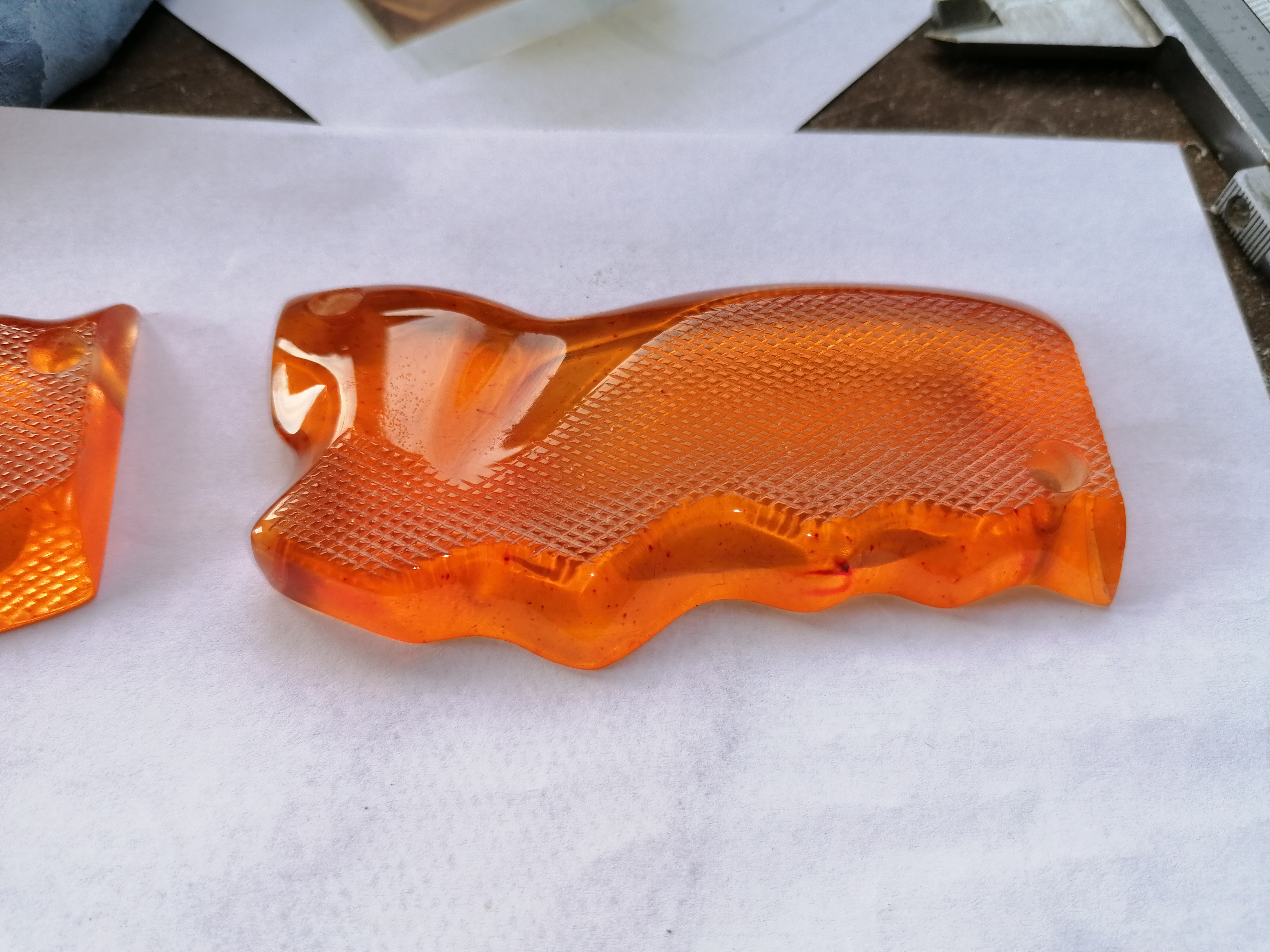

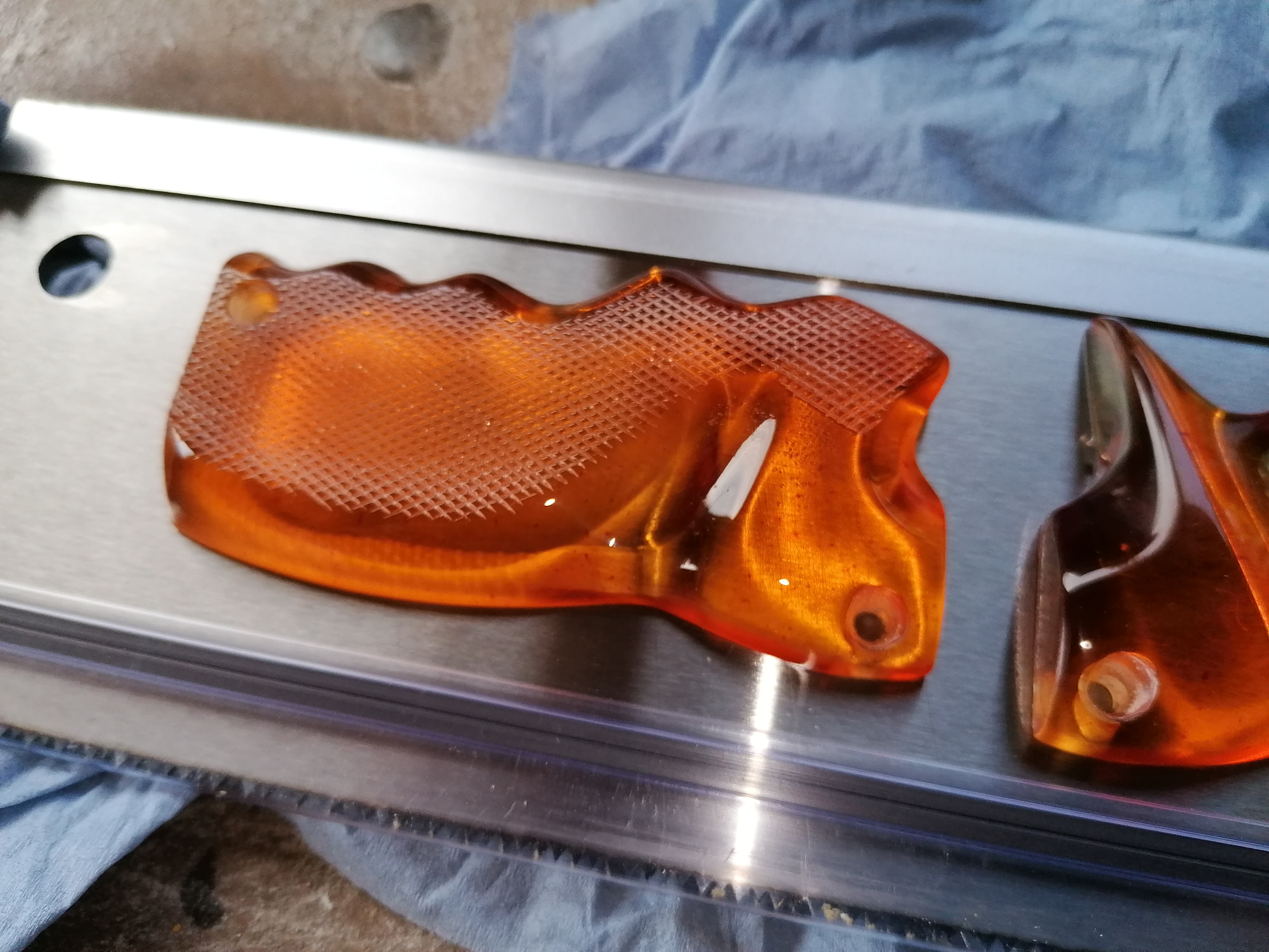

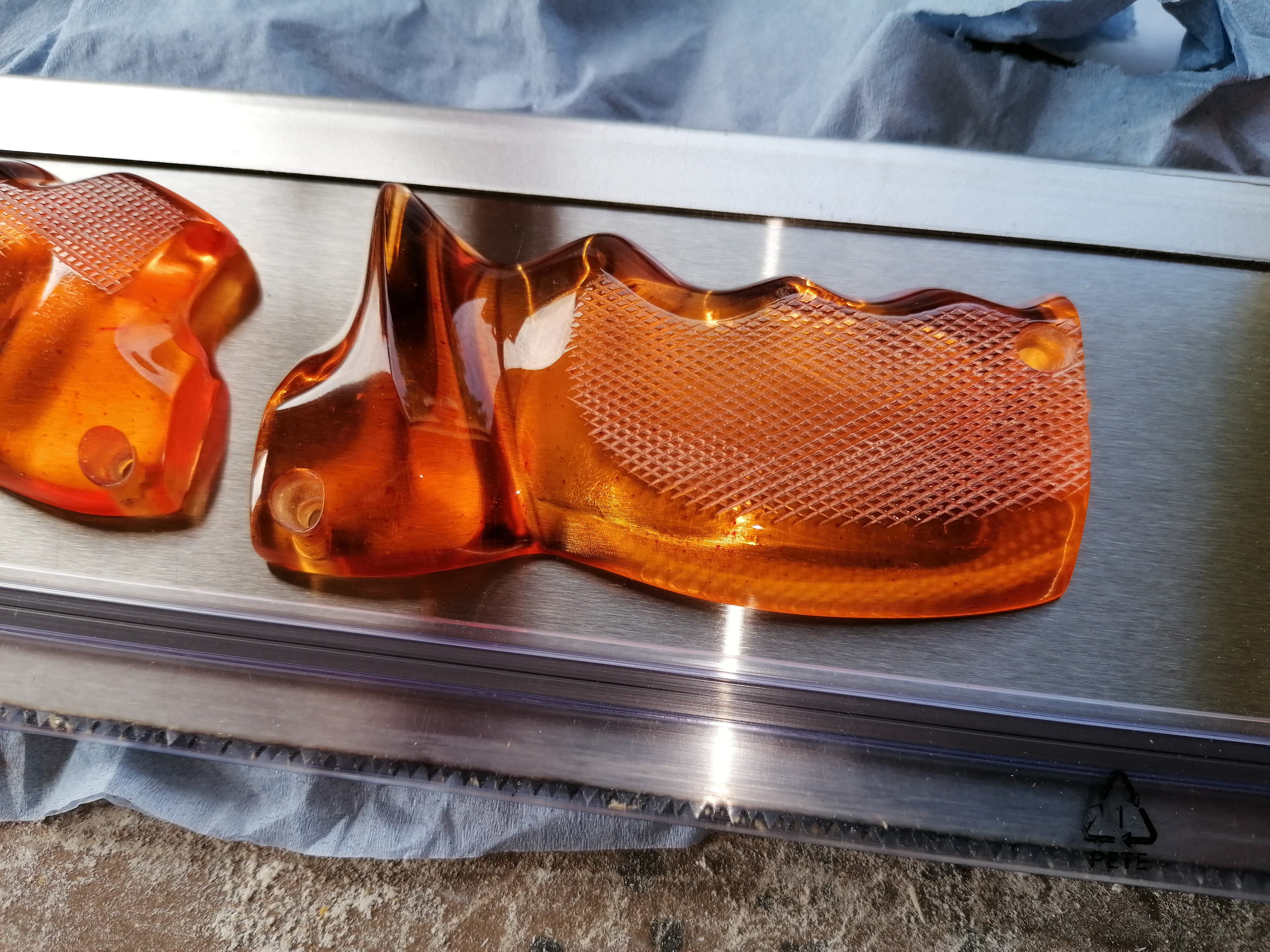

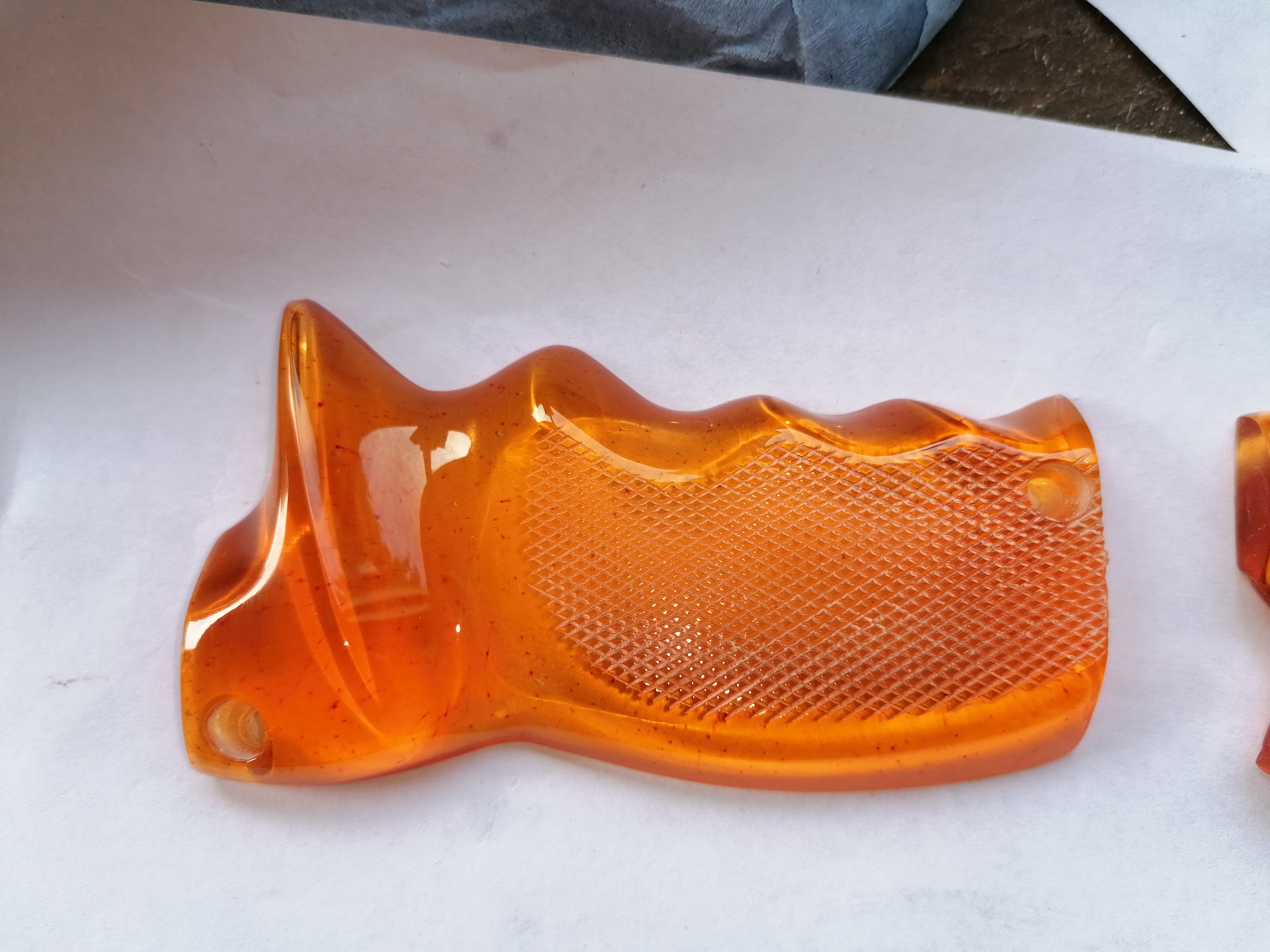

Got the grips polished. Some pitting came up on one which was annoying - will deal with it later. The polish really showed up the unmixed pigment which I'm really unhappy with. Against a white background it stands out quite a bit.
They do look better against a brushed steel finish, so hopefully they'll be OK. If not I'll mould them and vacuum cast a better set - don't particularly want to go to that bother, but we'll see how it looks at the end...

Excellent work polishing those grips, do you have any tips you could pass along, mine are a bit foggy as well.
Thanks. I used polishing wheels on a bench grinder to get at really deep polish. It's fast, you only need to work it to 800 grit by hand and it gives the best finish by far.
The trick to getting a really good polish is to work up the grades of paper and make sure you eliminate the marks from the coarser grades before you move on to the next.
Use a reasonably coarse paper to smooth out the casting - 240 or 180 or so. Try and do all of your sanding in one direction. When you move on to a finer grade sand at right angles to the direction of the previous grade and you can see when you've taken out all of the coarser scratches. Work up the grades 320, 400, 600, 800. I'll normally start wet sanding around 600.
Always try and sand in one direction rather than in a circular motion - you'll never see when you've removed all the coarser scratches if they're swirls and any you do miss will stick out like a sore thumb on the final polish.
If I'm using a wheel, I'll stop at 800 and use medium and fine compounds on soft wheels.
If I can't use a wheel I'd go for a polishing mop in a dremel with a polish like T-Cut or Auto Glym. In that case I'd continue hand sanding to 2000 grit before polishing.
You can get a decent result without a dremel too - use the back of a piece of fine wet and dry (the paper side) to work the surface with T-Cut or your polish of choice.
Fantastic advice, thank you so much for taking the time to respond. Excited to get my grips looking like yours.

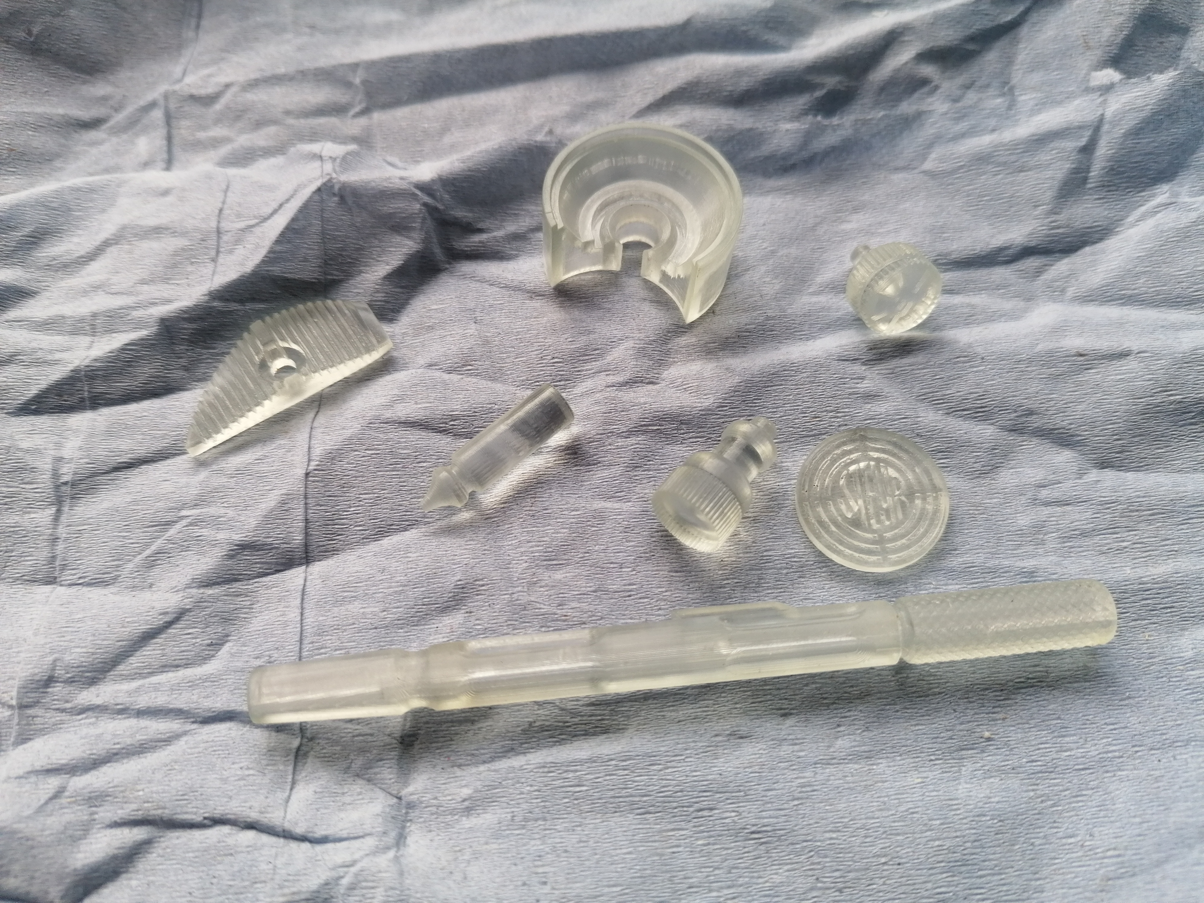

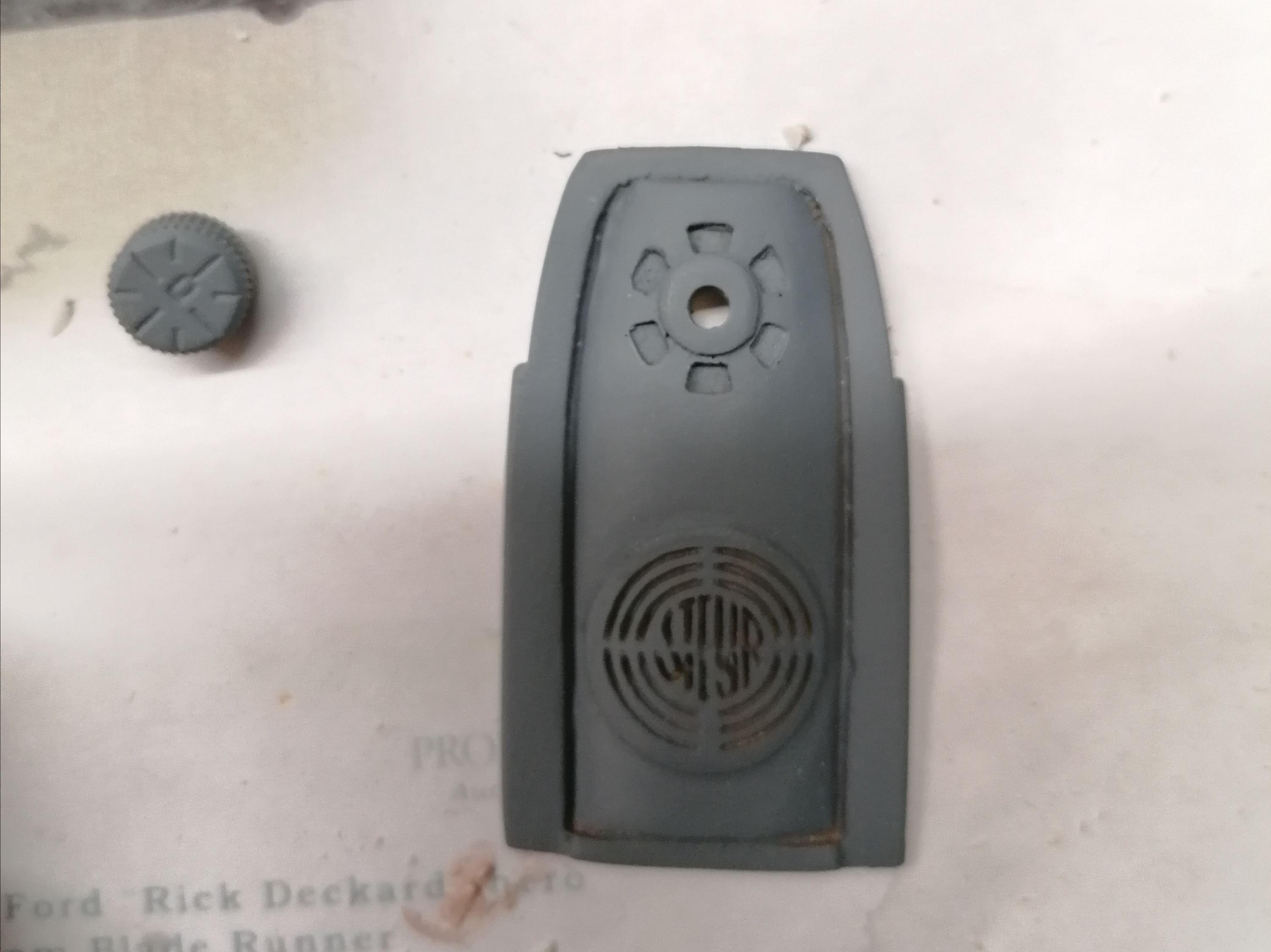

Some parts fresh off the SLA machine!
A correct front end and binding post, along with a Steyr safety and screwdriver thingy to replace the kit ones which were so bad it wasn't worth fixing them. Those two parts seem a bit bigger than they should be (at least for this kit) so I'll sort that out.
I printed a weaver knob, but I'm in two minds whether I'll use it or go with the slotted screw.
I also printed a Steyr logo to go on the bottom of the mag. Probably should have made it a bit more curved but I didn't have the kit part to hand when I did the cad. Such is life...

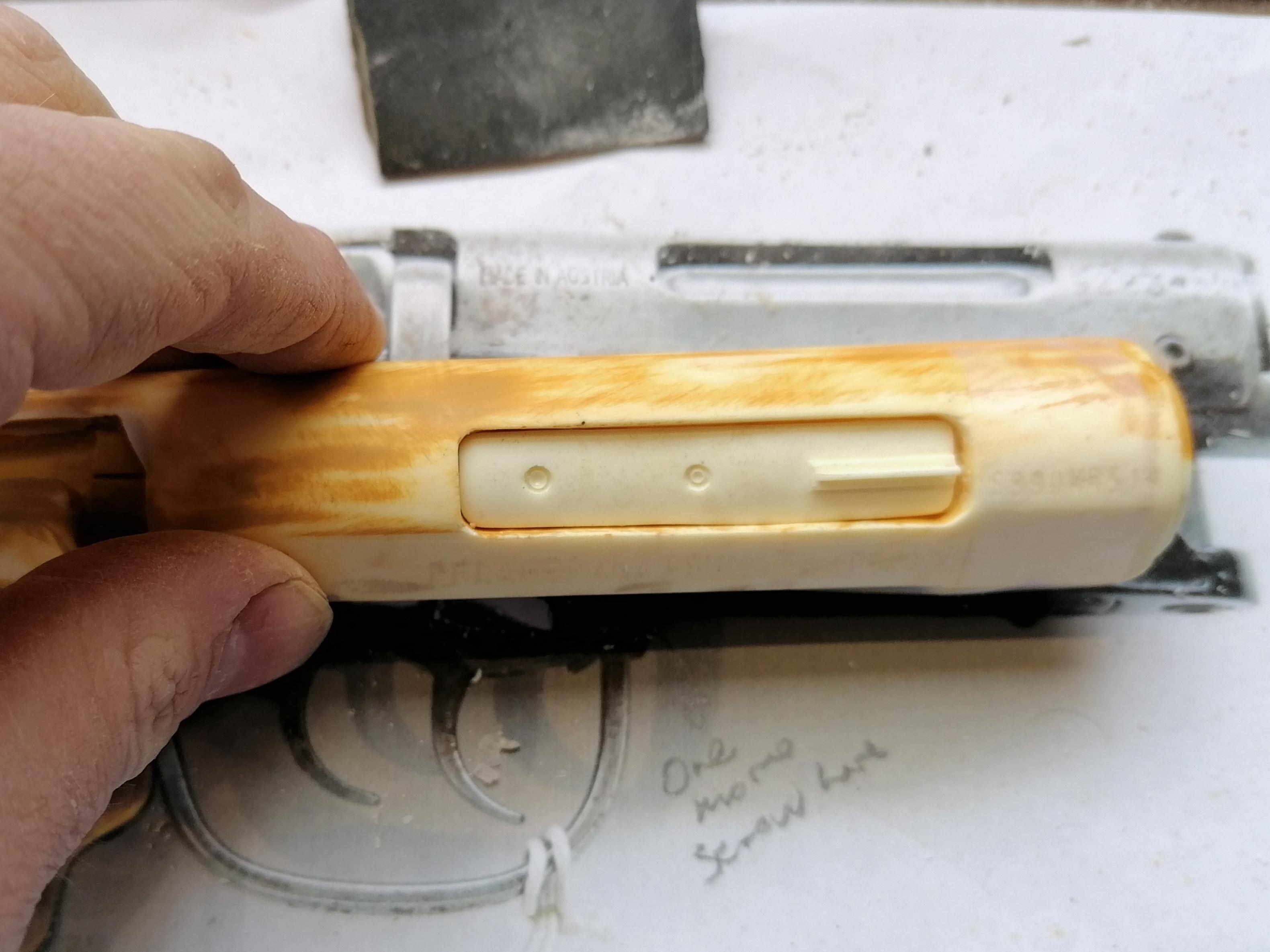

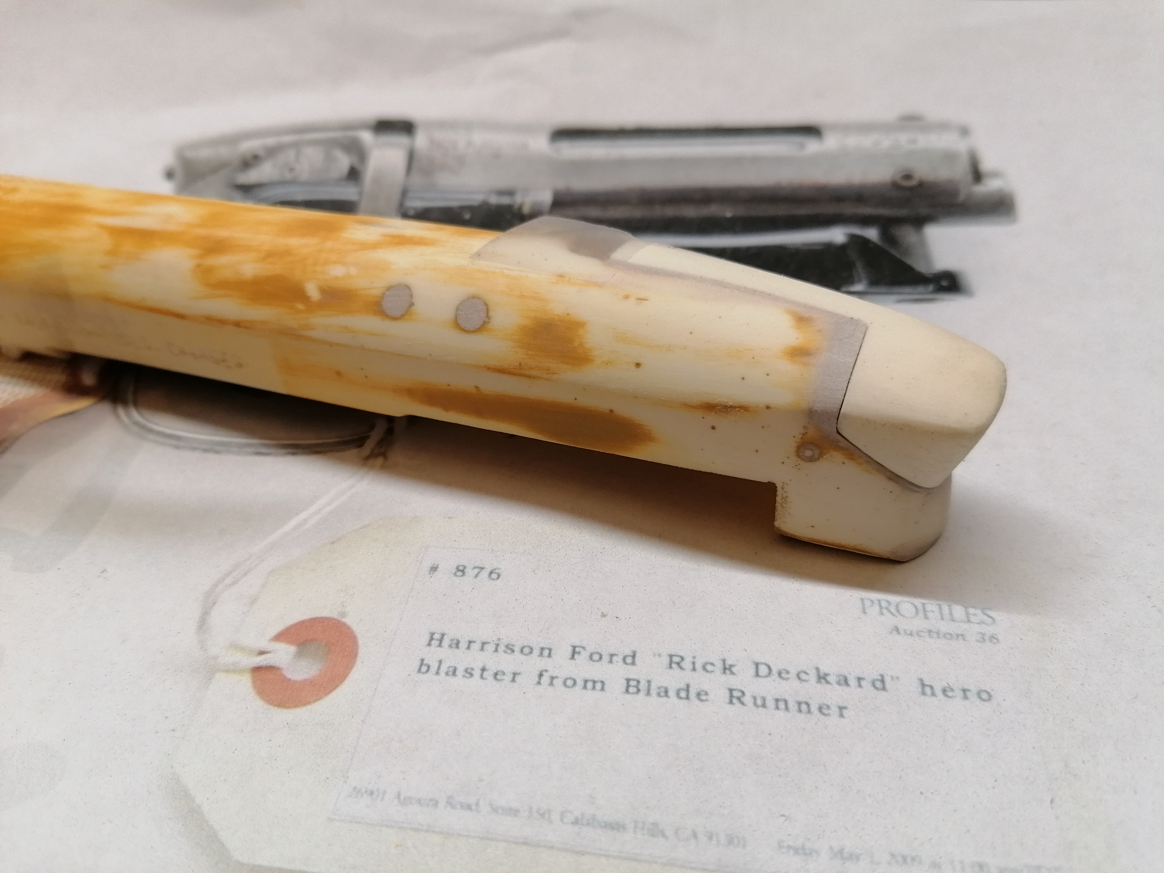

Here's a case of modelmaker OCD in action...

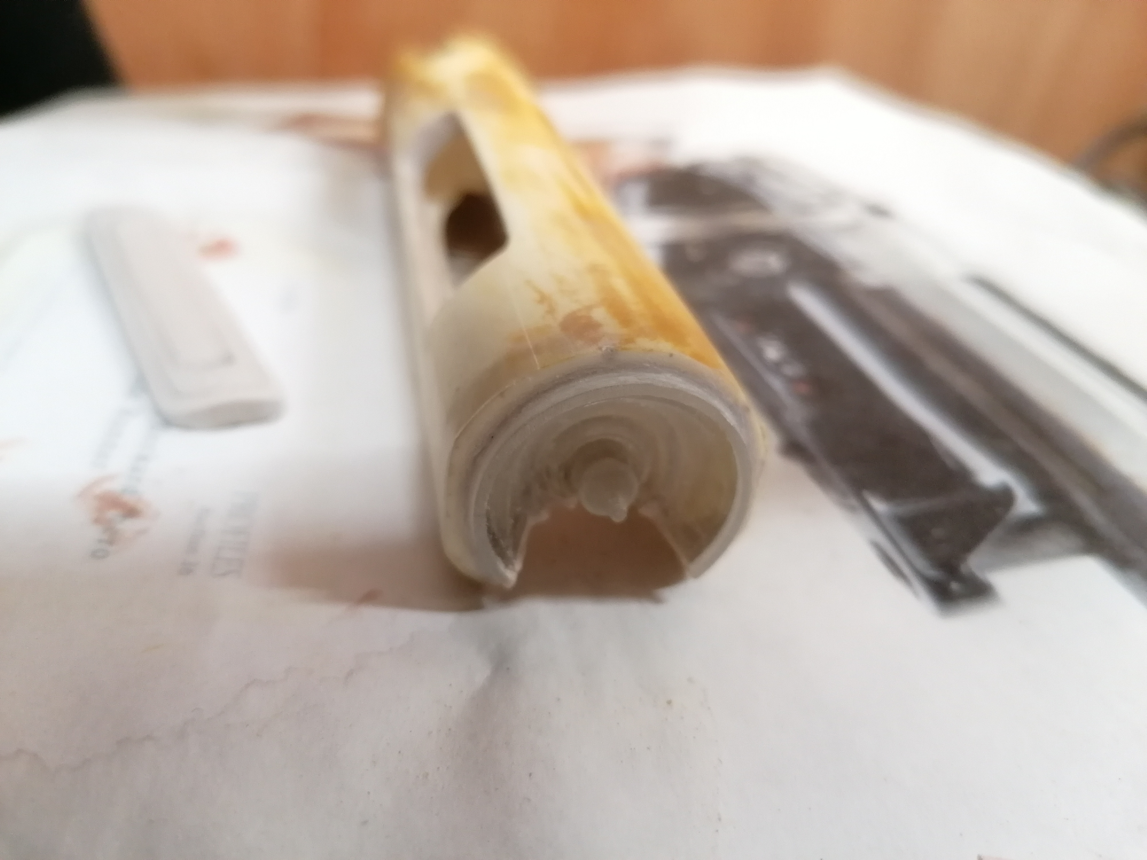

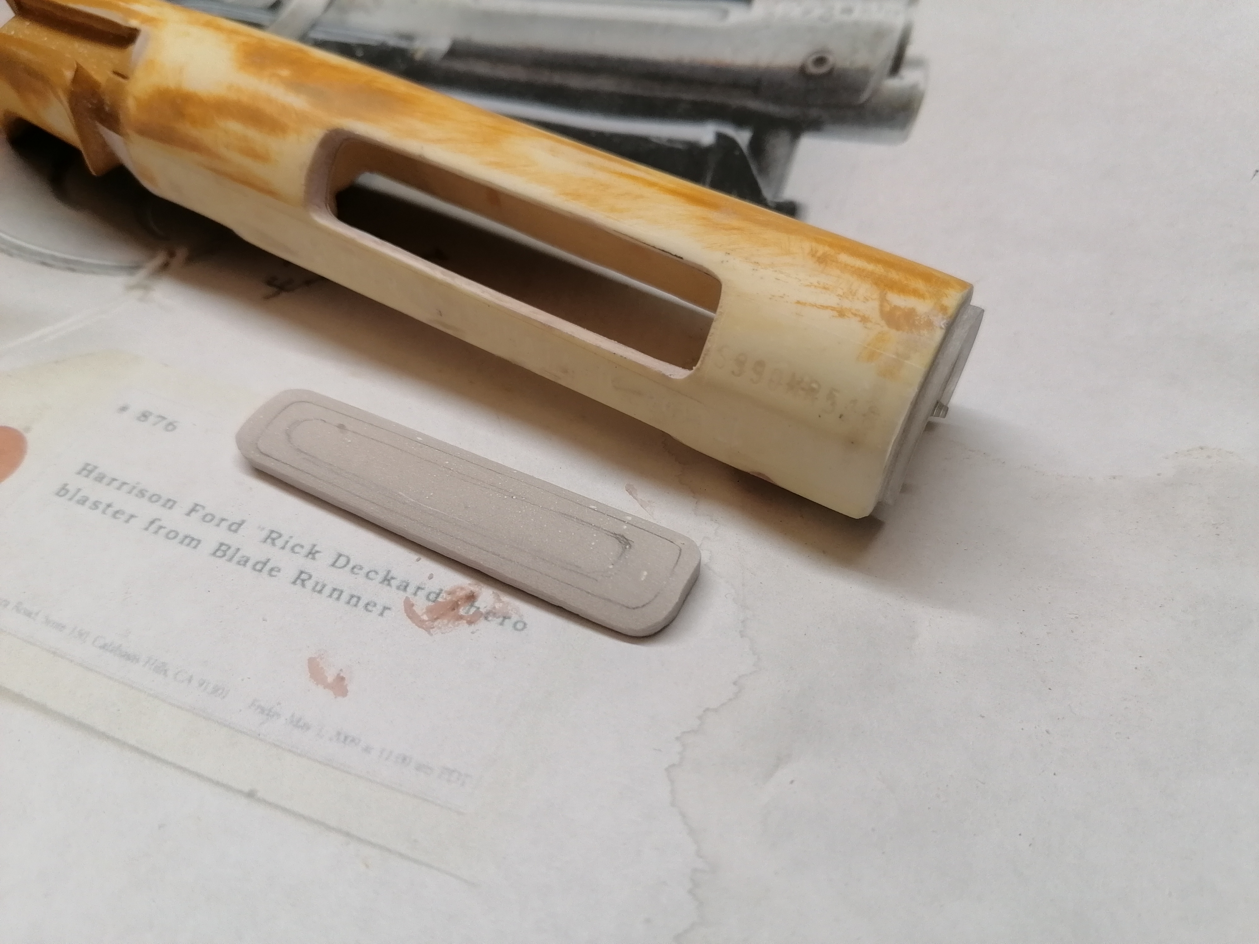

The insert with the ejector port detail on the kit isn't representative of the real thing, plus it's a terrible fit. Couldn't be having that!
I originally made up a new insert moulded to the slot on the receiver, but I still wasn't happy with it. Ultimately it looked like a piece that was dropped onto a hole rather than a bolt behind the port.

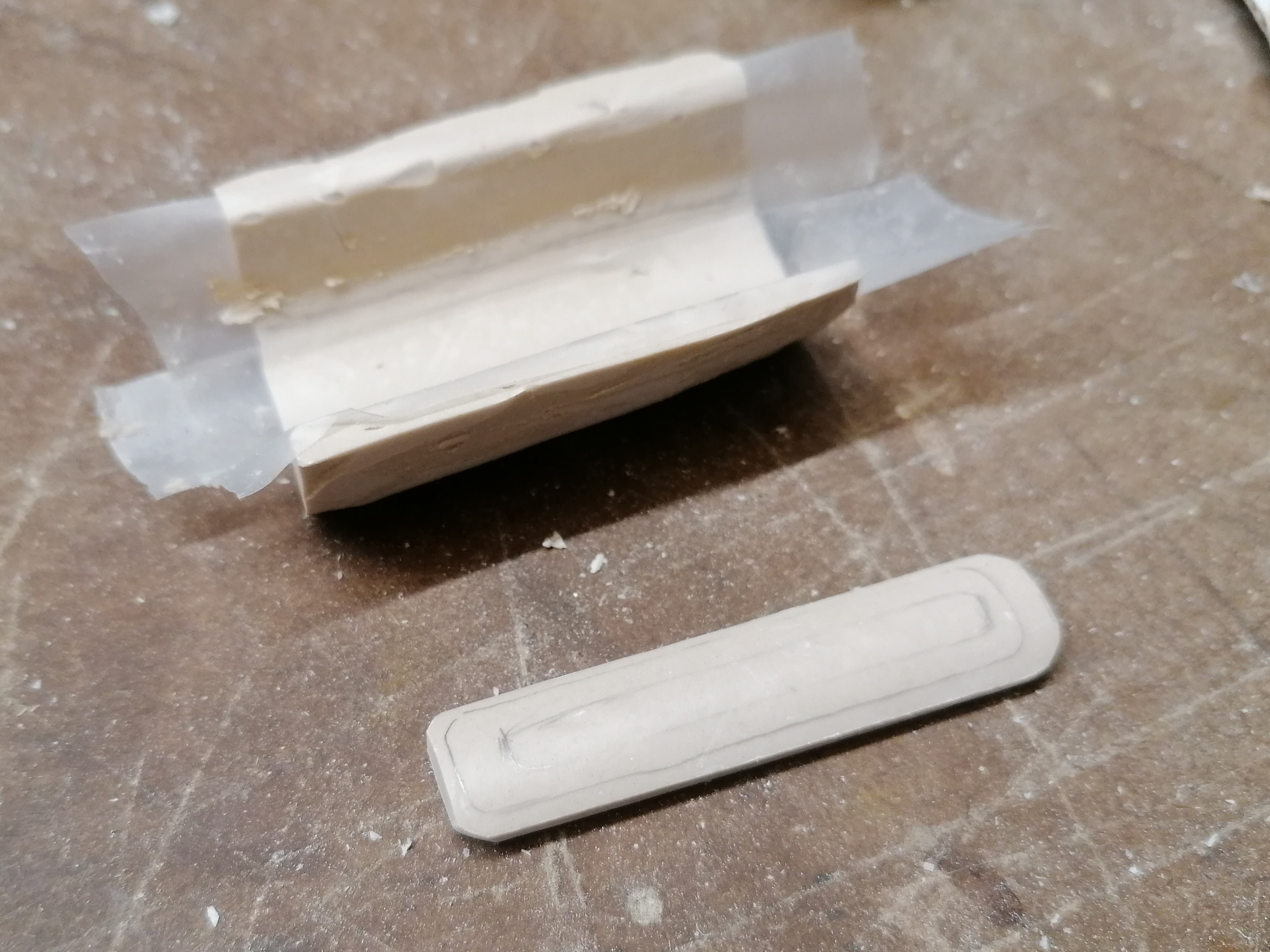

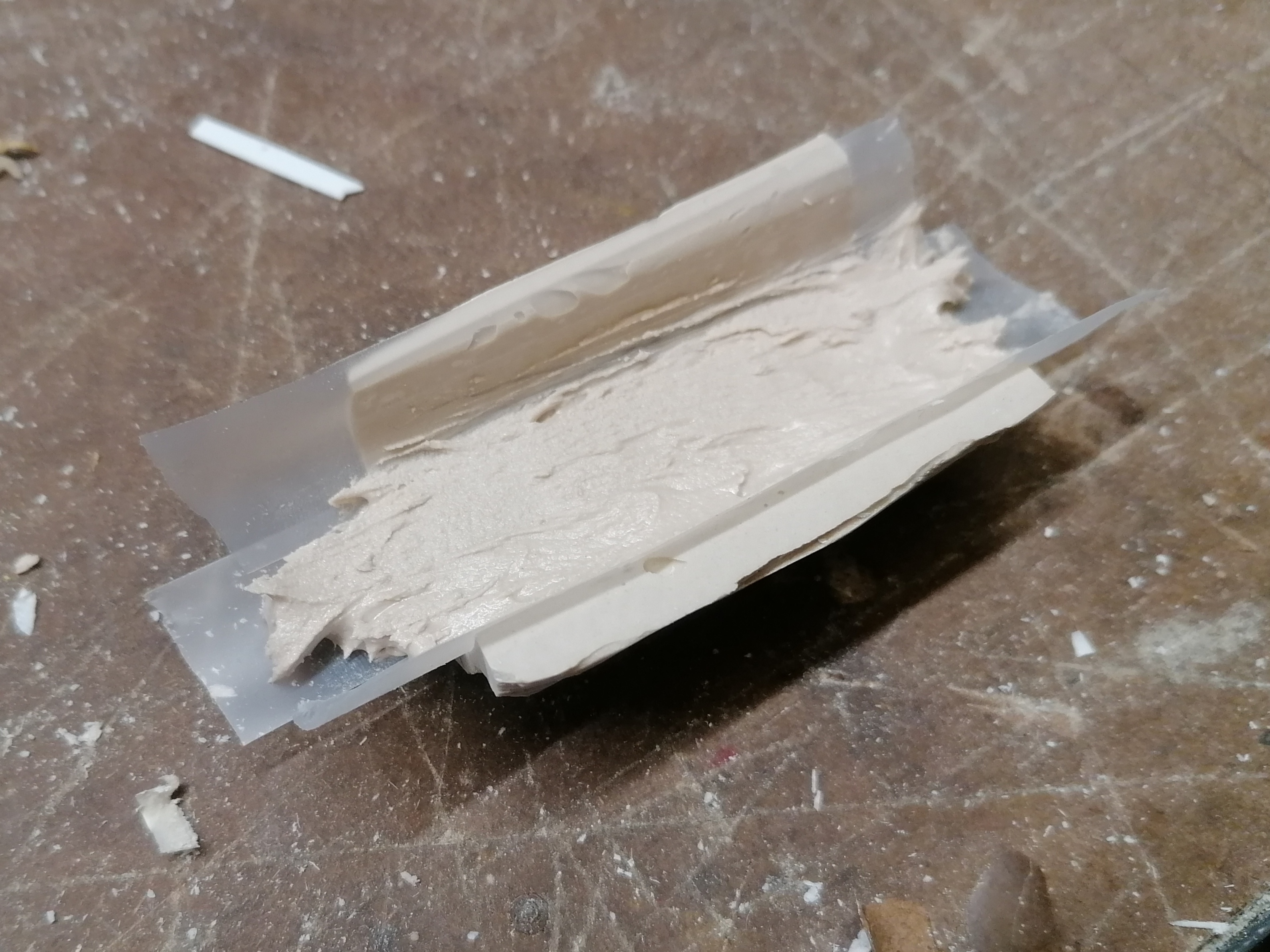

There was only one thing for it, time to get carving! I opened up the ejector port to the inside of the part and widened the back of the hole to give the appearance of the real thing. At the same time I cut out the awful looking front end to make way for my printed replacement.

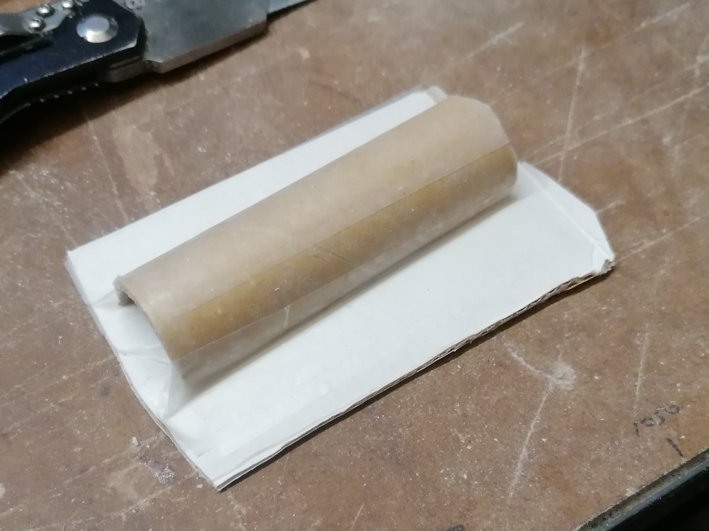

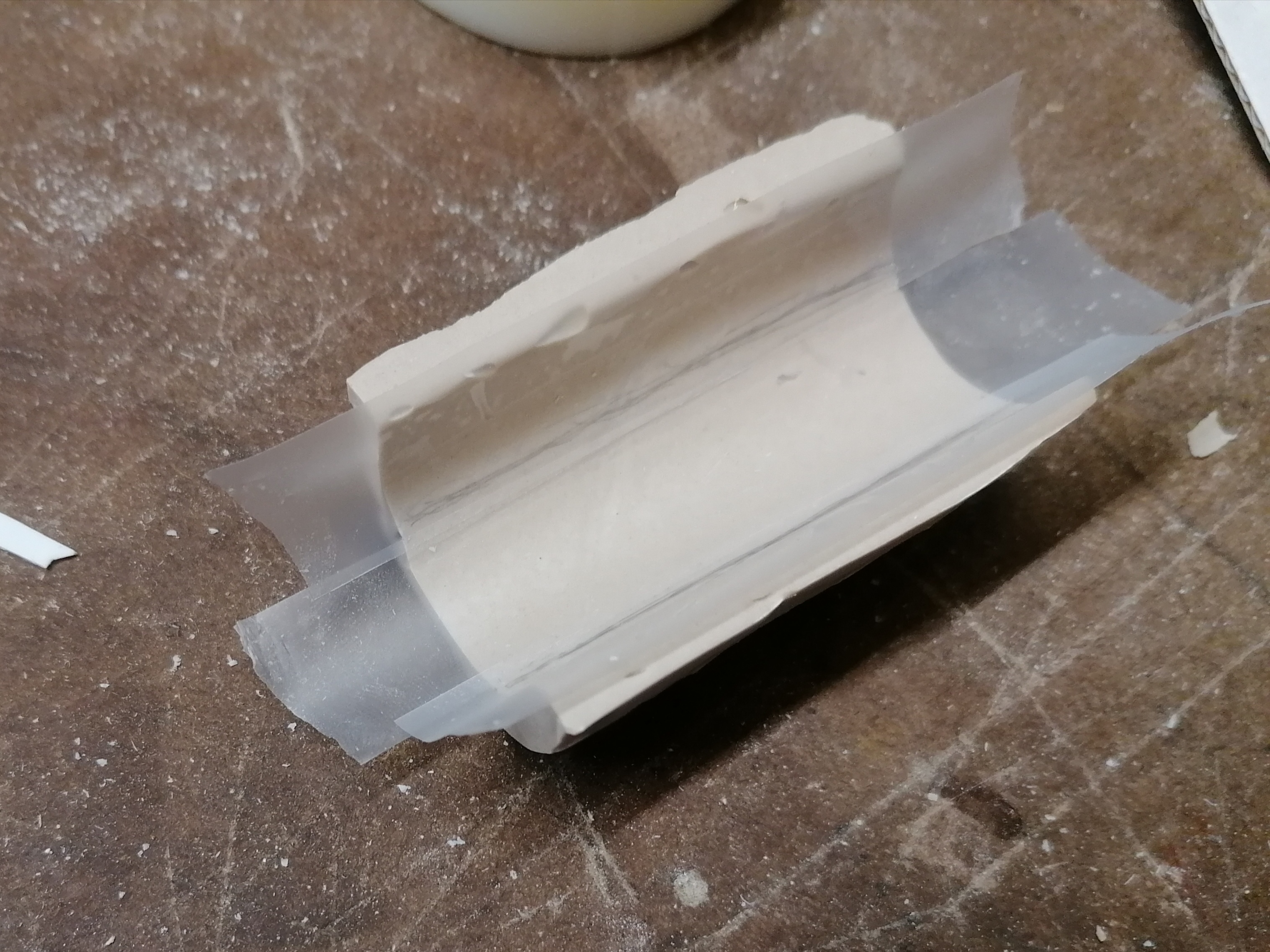

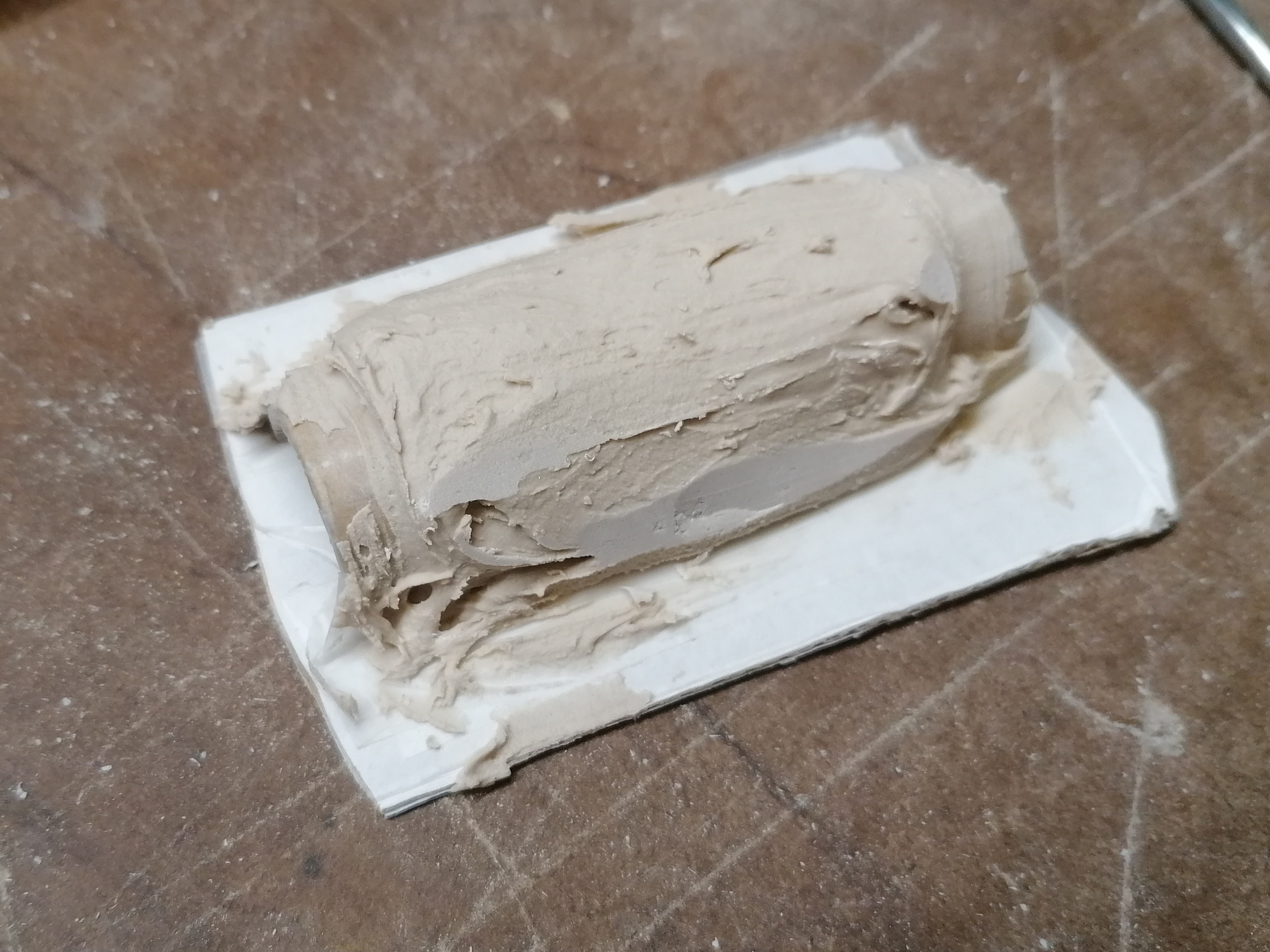

I used a piece of cardboard tube of the right diameter to make a filler mould, covering it with scotch tape to keep the filler from sticking. When it was set, I taped up the inner face of the mould and filled it with filler to make my bolt.
Some sanding and fitting later and I've got a bolt that fits neatly into the ejector port - I still need to add the detail to it.
It was rather a lot of work for what appears to be very little difference, but it looks a hell of a lot better to me!

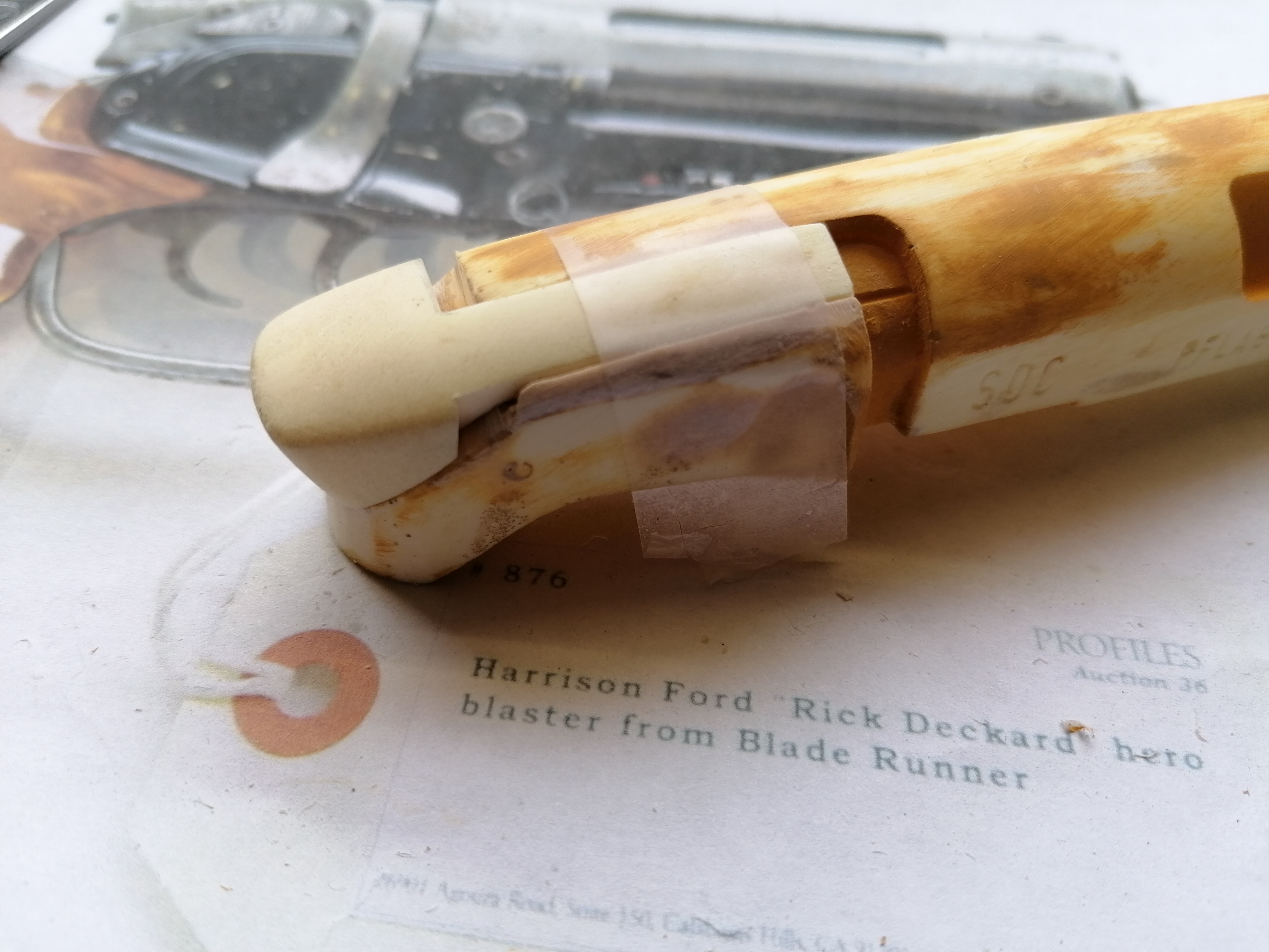

The new front end was a fairly simple matter of cutting a recess and dropping in the printed replacement. Some filling of the gaps and sanding to the right profile and it was done and dusted. It looks one hell of lot better!
Overall a very dusty weekend of cutting, carving, filling and sanding, but it's really improved two problem areas of the kit.

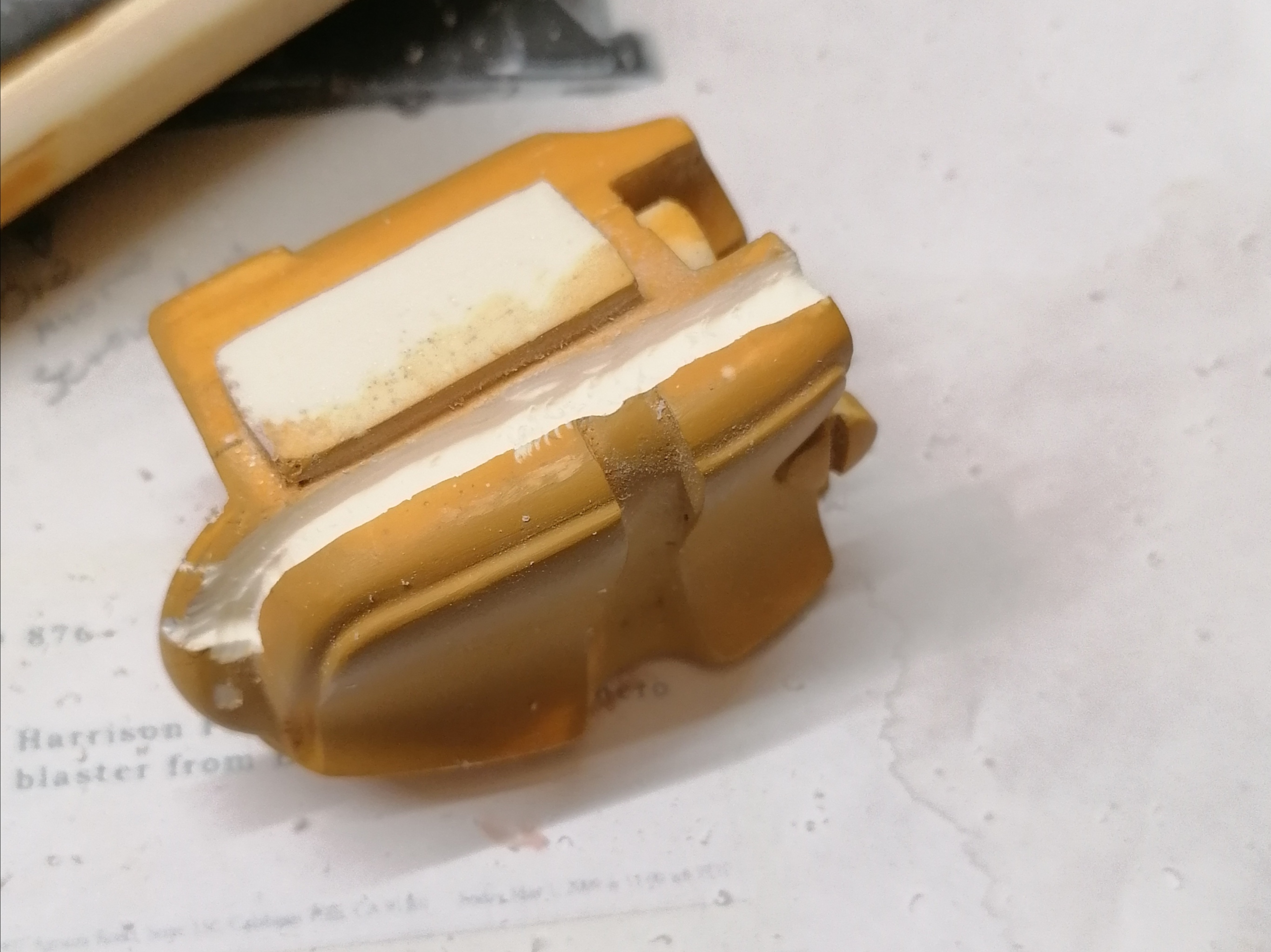

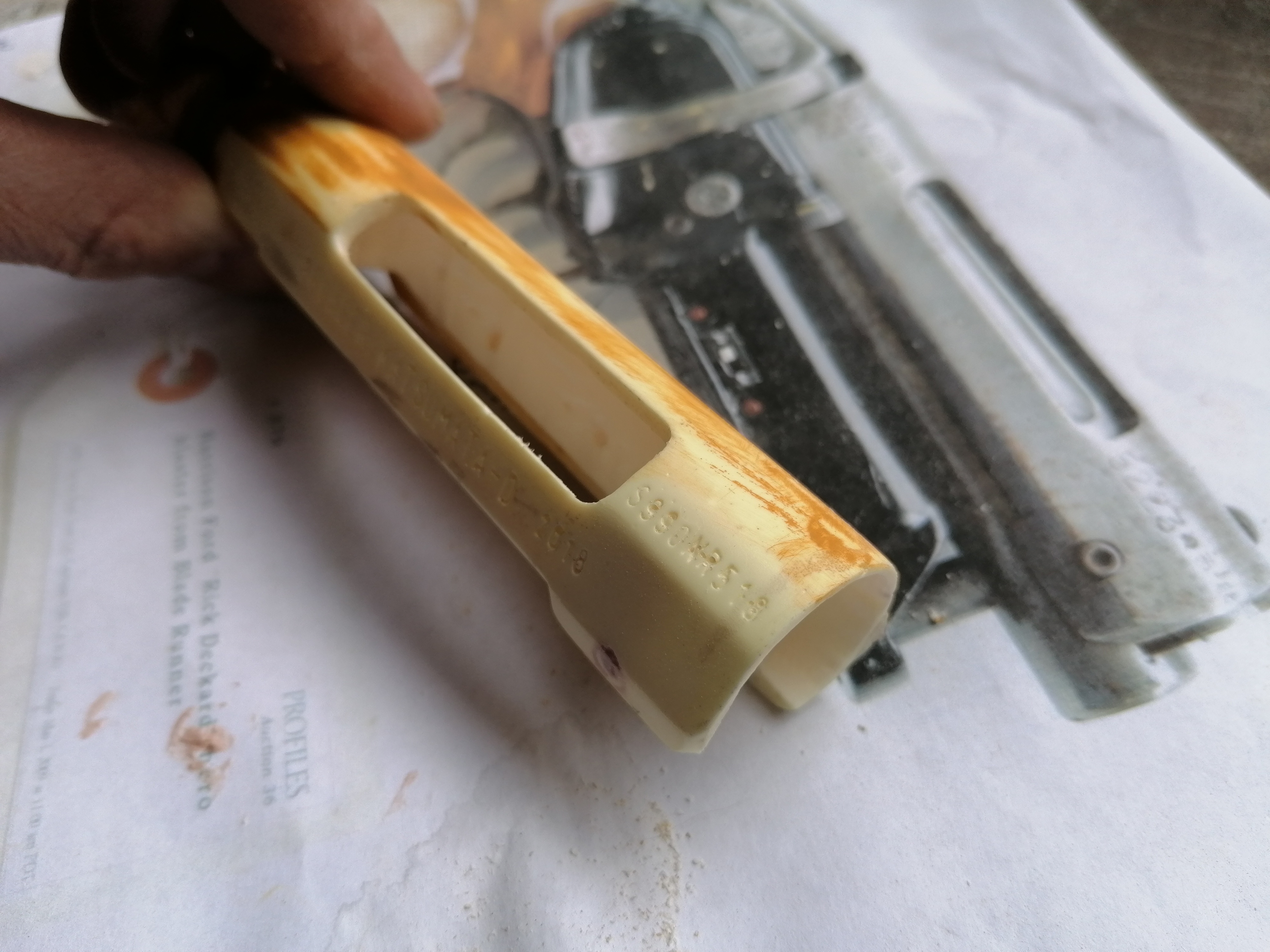

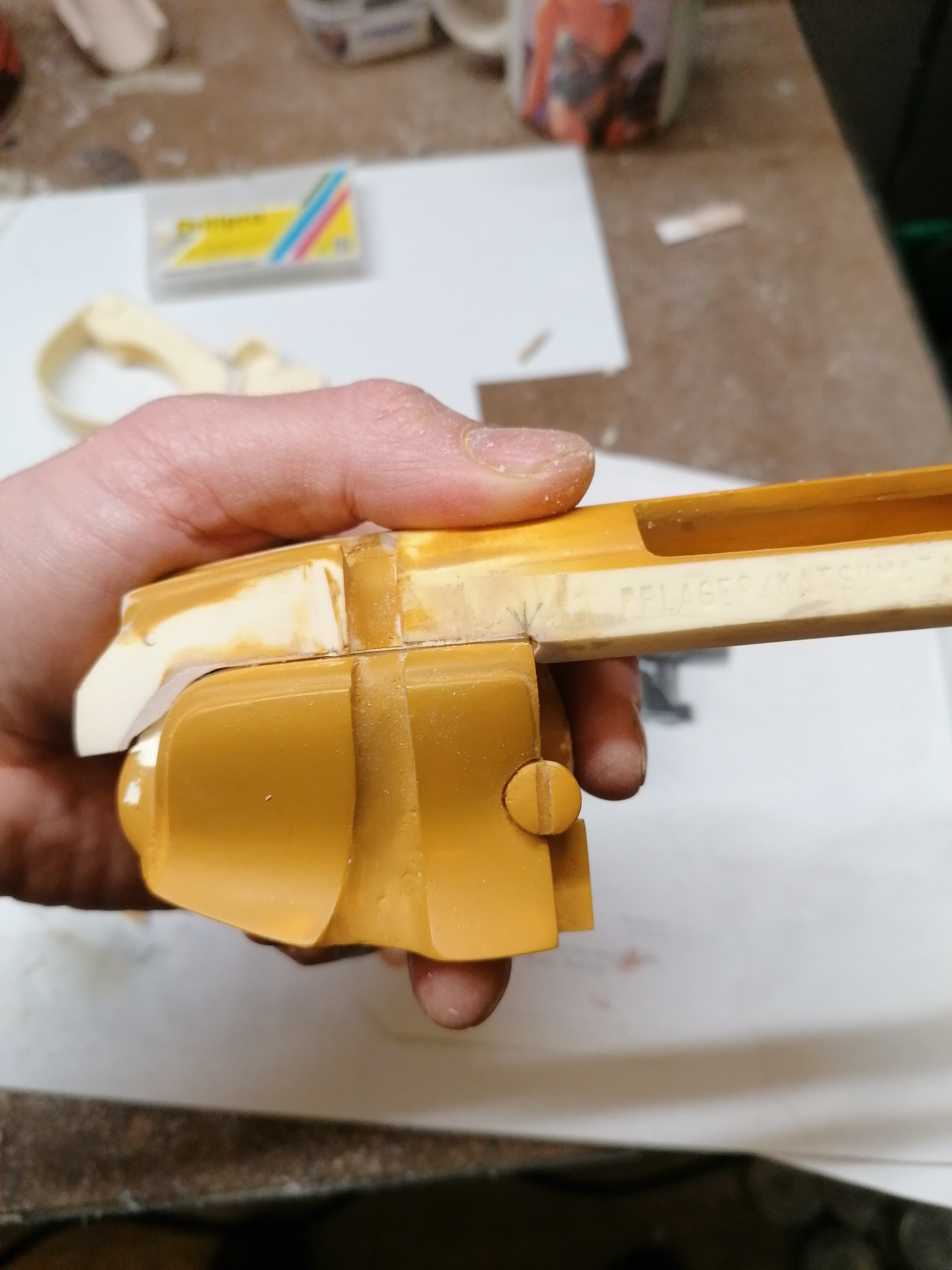

Oh god, I've done it again! I swear I just can't help myself!

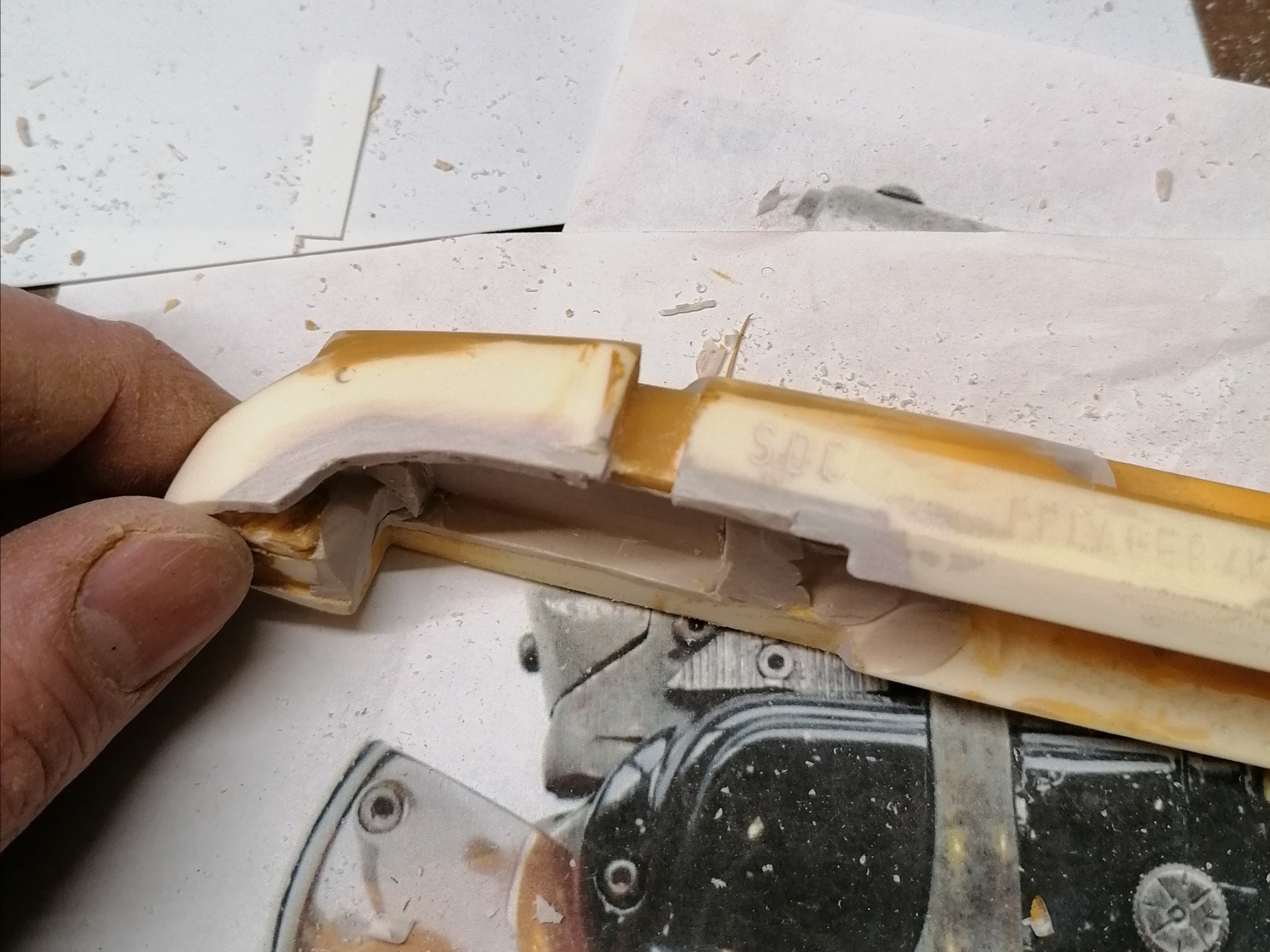

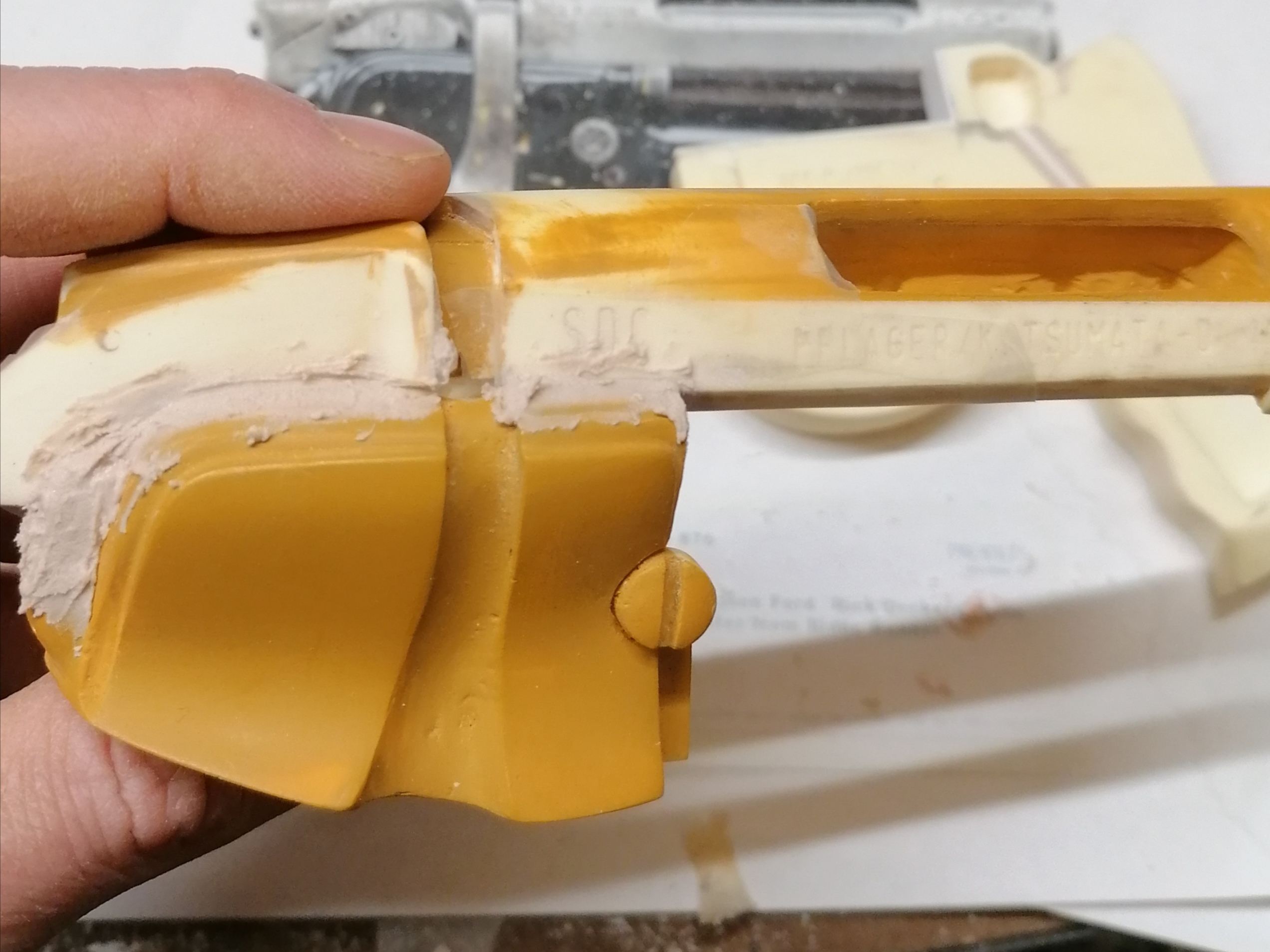

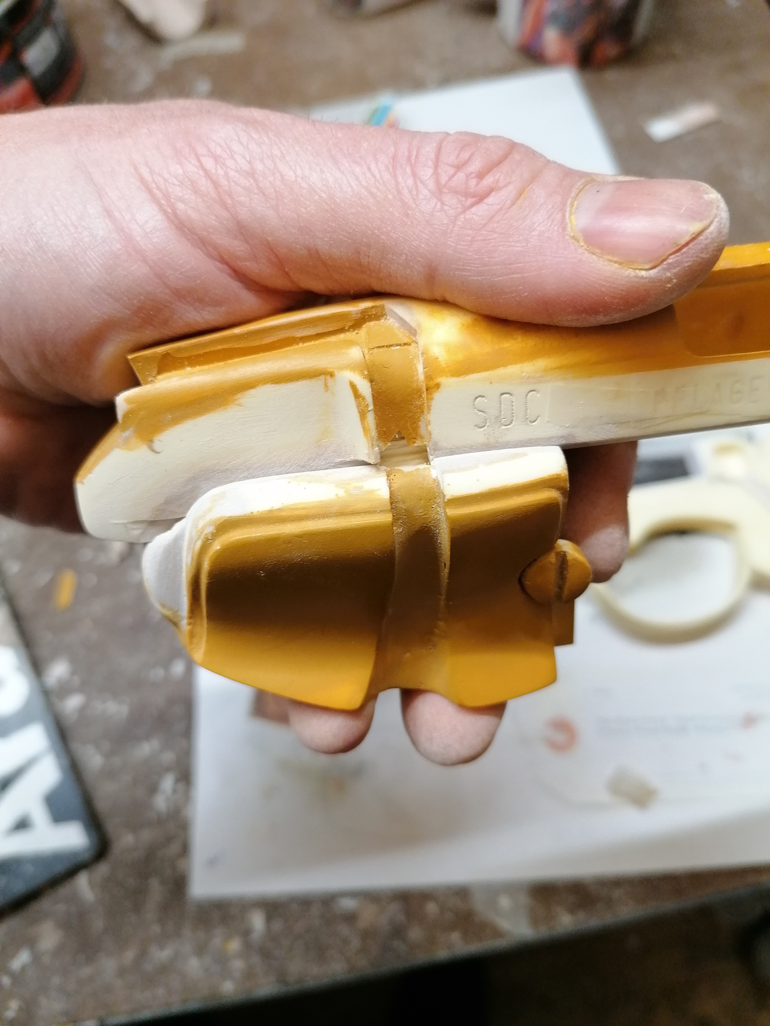

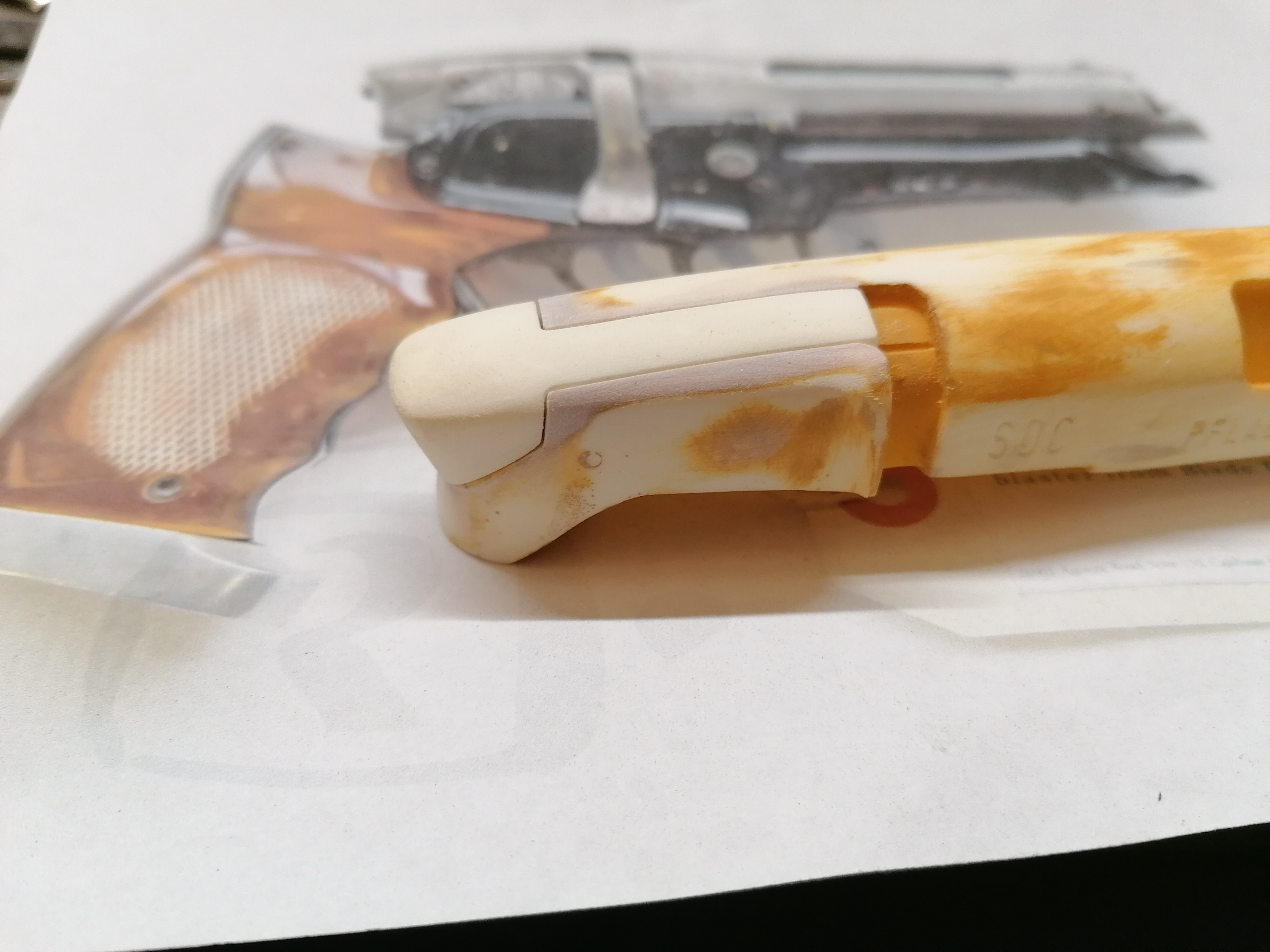

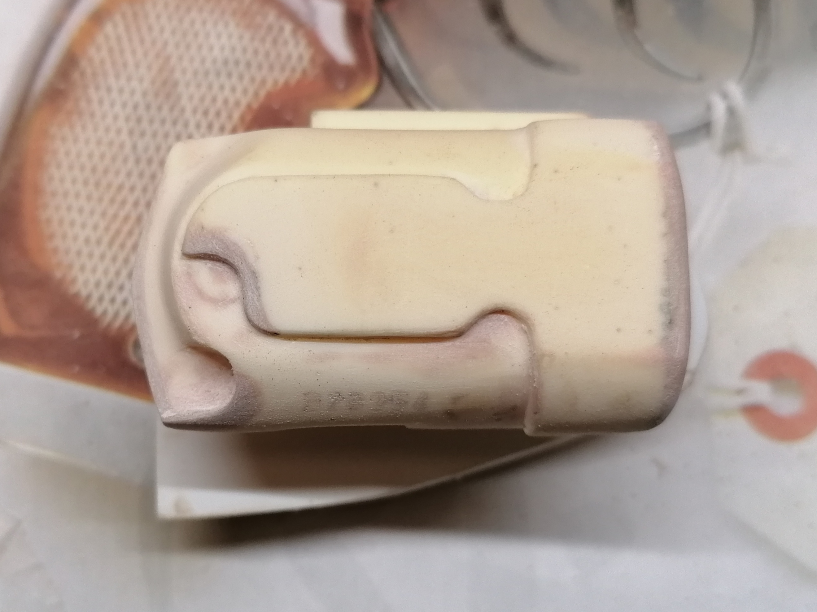

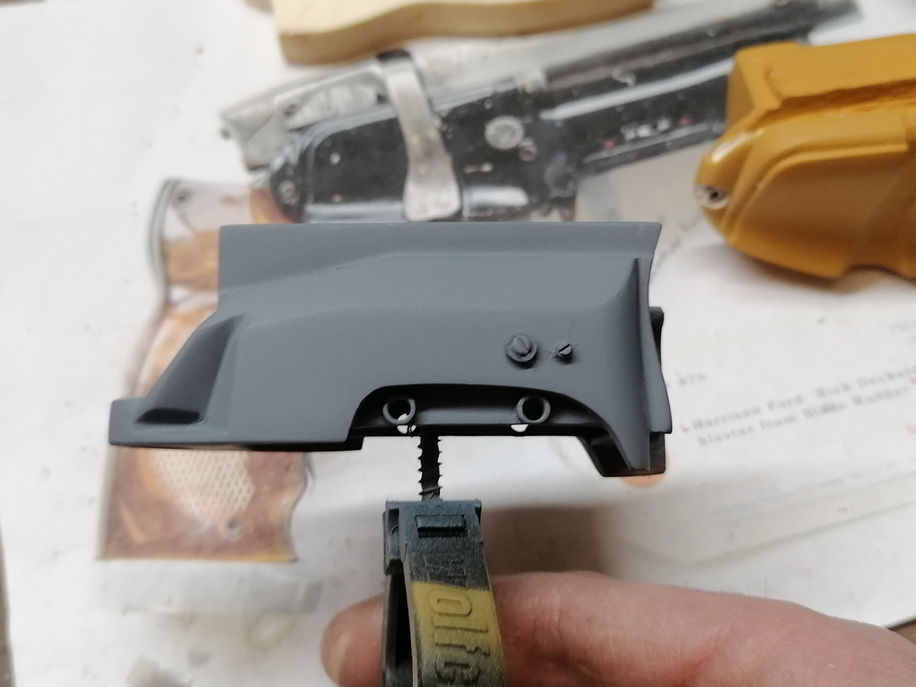

Despite blending it down with filler, I still wasn't very happy with the fit of the upper Steyr receiver - particularly at the back end of it. It just didn't look right to me with the upper reciver sitting stop the lower and not behind it.
The only thing for it was to carve a channel in the lower receiver part, extend the sides of the upper and then back fill the lower to meet it. That would make it much more presentable and have the join going in the right direction to my eye...
There's still some reshaping of the curves at the back needed, but it's already looking much better to me. I didn't do anything on the other side as that seam will eventually be hidden.
A lot of work for something so seemingly inconsequential, but I'm the one who'll have to look at it!

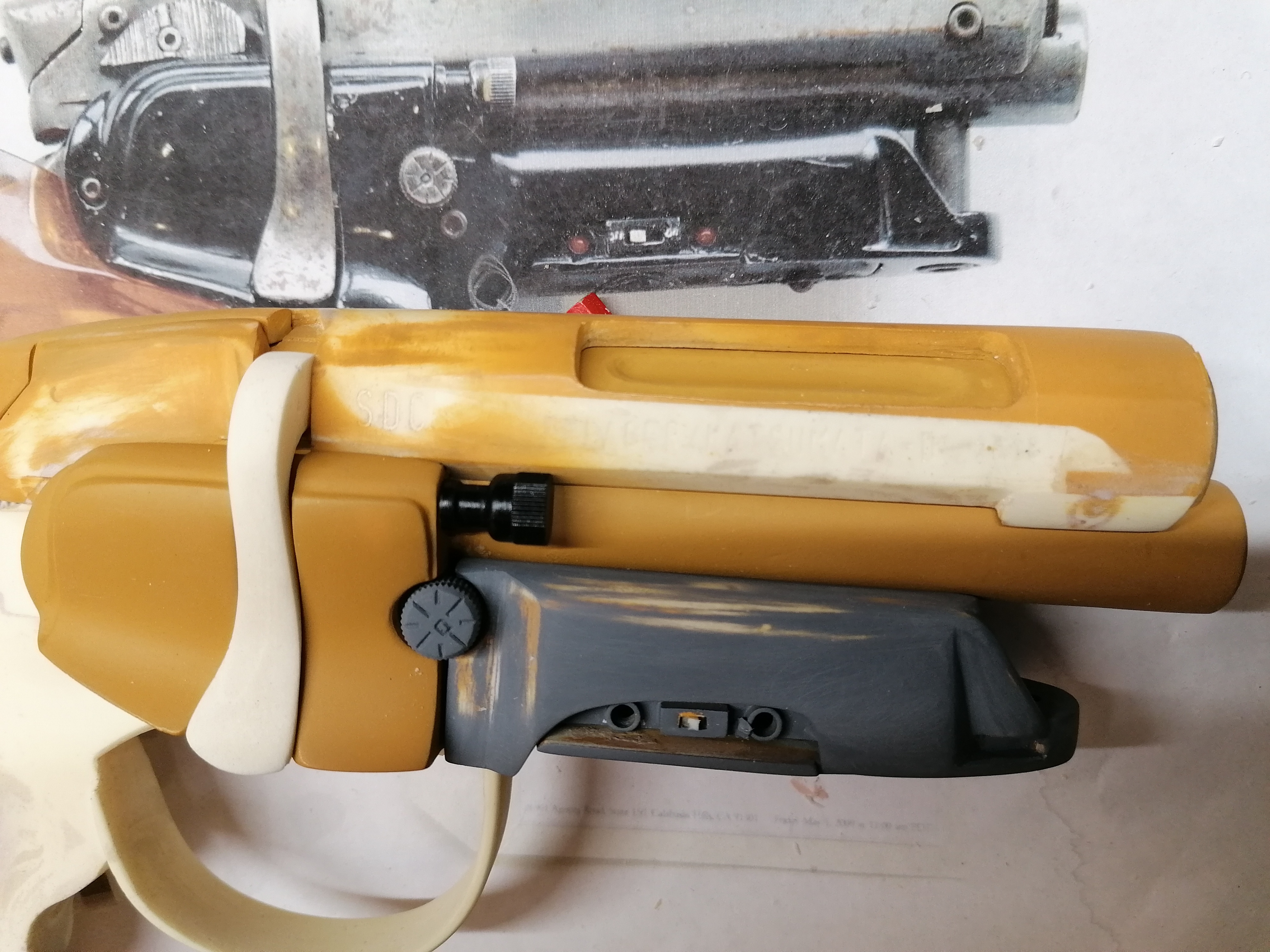

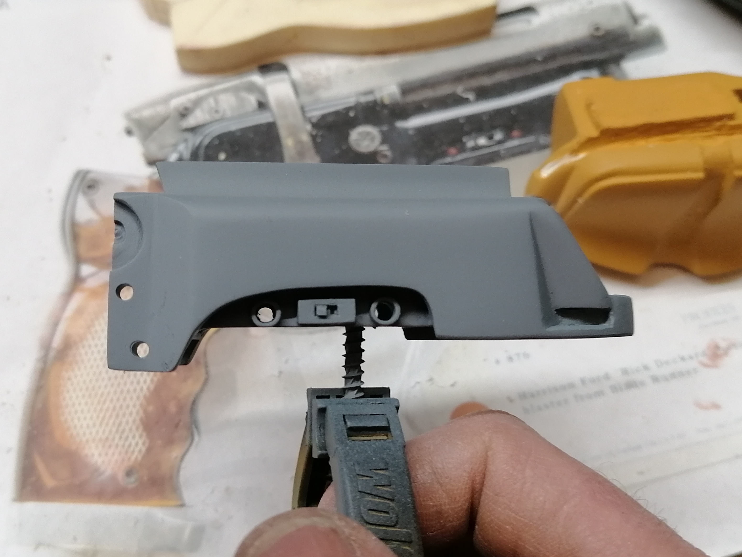

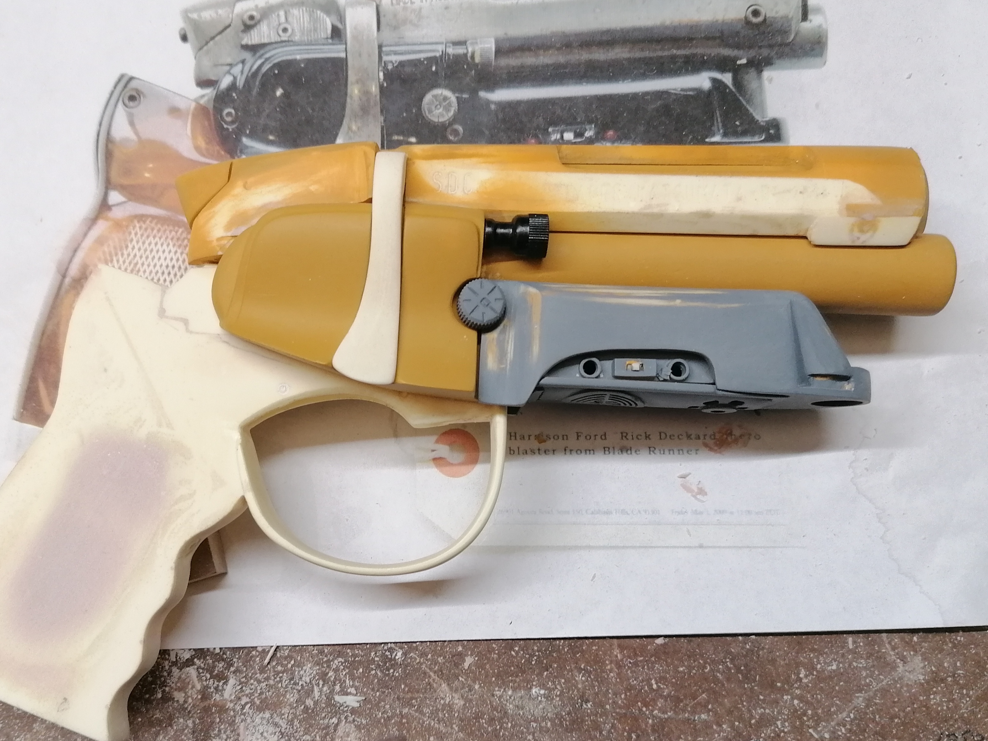

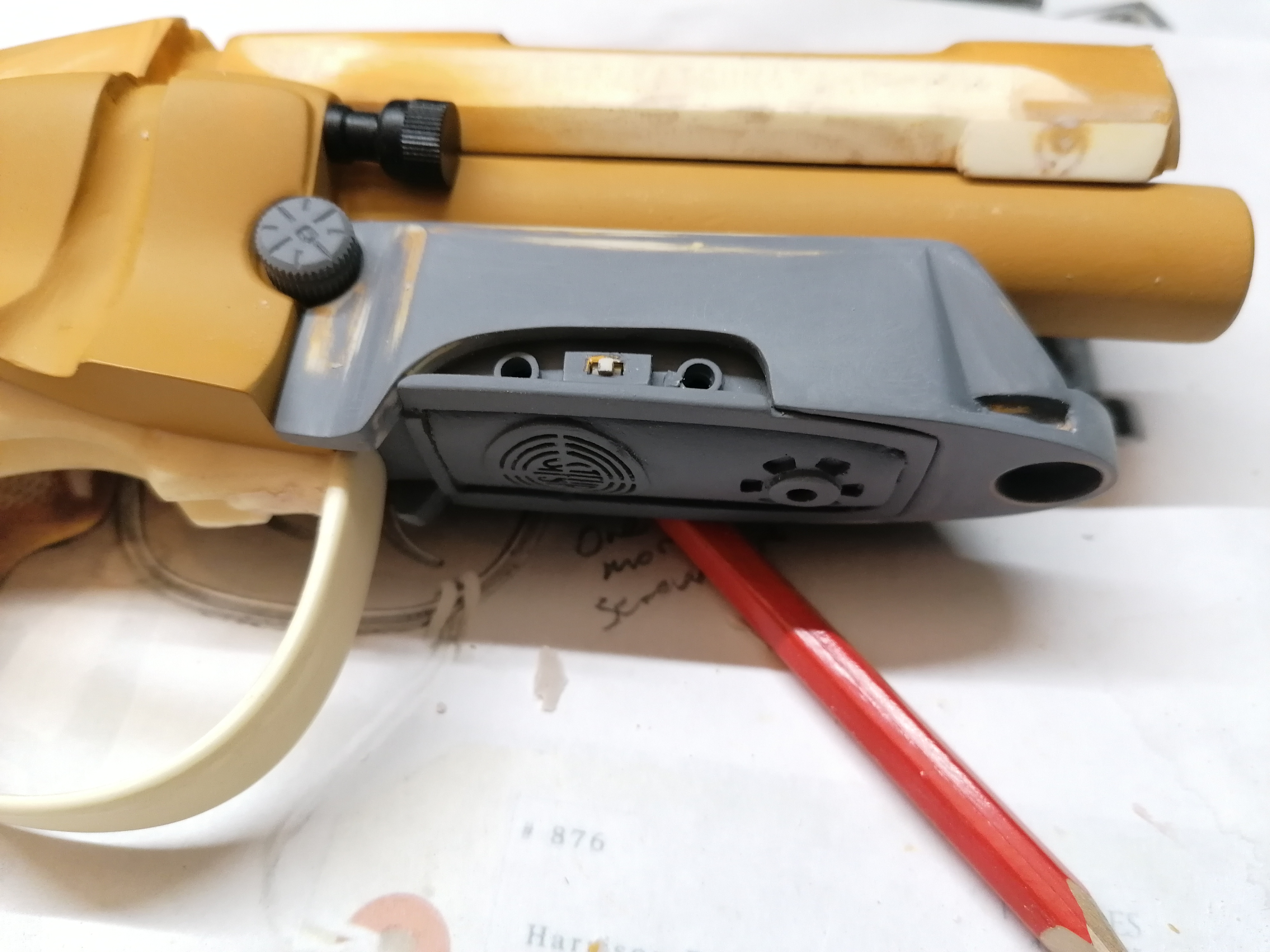

Progress! I've pretty much finished fettling and adjusting the shape of the major components and am starting to prep surfaces for paint. Everything now is a tight fit and locates well.
Replaced the Steyr logo on the foot of the mag, realised too late that I'd printed an inset logo rather than a raised one. As it's all going to be a satin black it'll not be too visible anyway, I can live with that!
The mag foot now sits neatly into the magwell. I also added the missing switch - a dummy in this case as I had to cut one down to size. I'll control the lights from elsewhere later on...
Decided to replace the big slotted screw with the weaver knob, so did that and located the binding post at the same time. I also added the groove onto the new plate for the ejector port.
Overall its beginning to take shape nicely, though shipping delays are melting my head.
Next big jobs are replace the trigger guard and fit the triggers (waiting for material), add all the screws (waiting for screws) and sort the wiring - at least I've got everything I need for that!

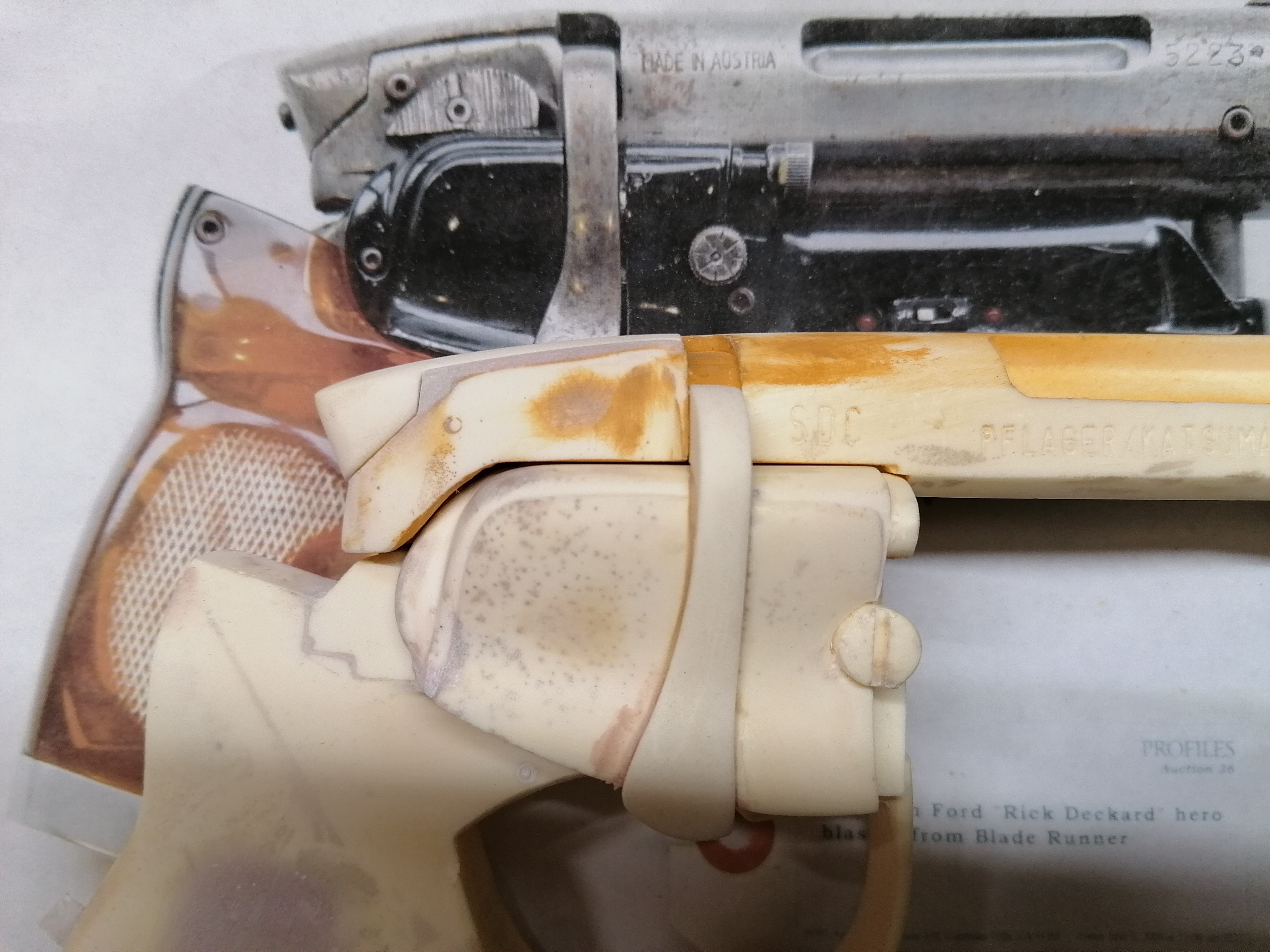

Small update tonight.
Royal Mail seems to have got moving again and a flurry of packages (some 6 weeks late!) arrived this week, including all my screws. I've spent far too much time fiddling with tiny screws, modifying tiny screws, drilling holes and generally being driven mad by screws Still, things are looking good, even if most of the screwheads won't go on until all the priming is done - no point in risking losing the detail!

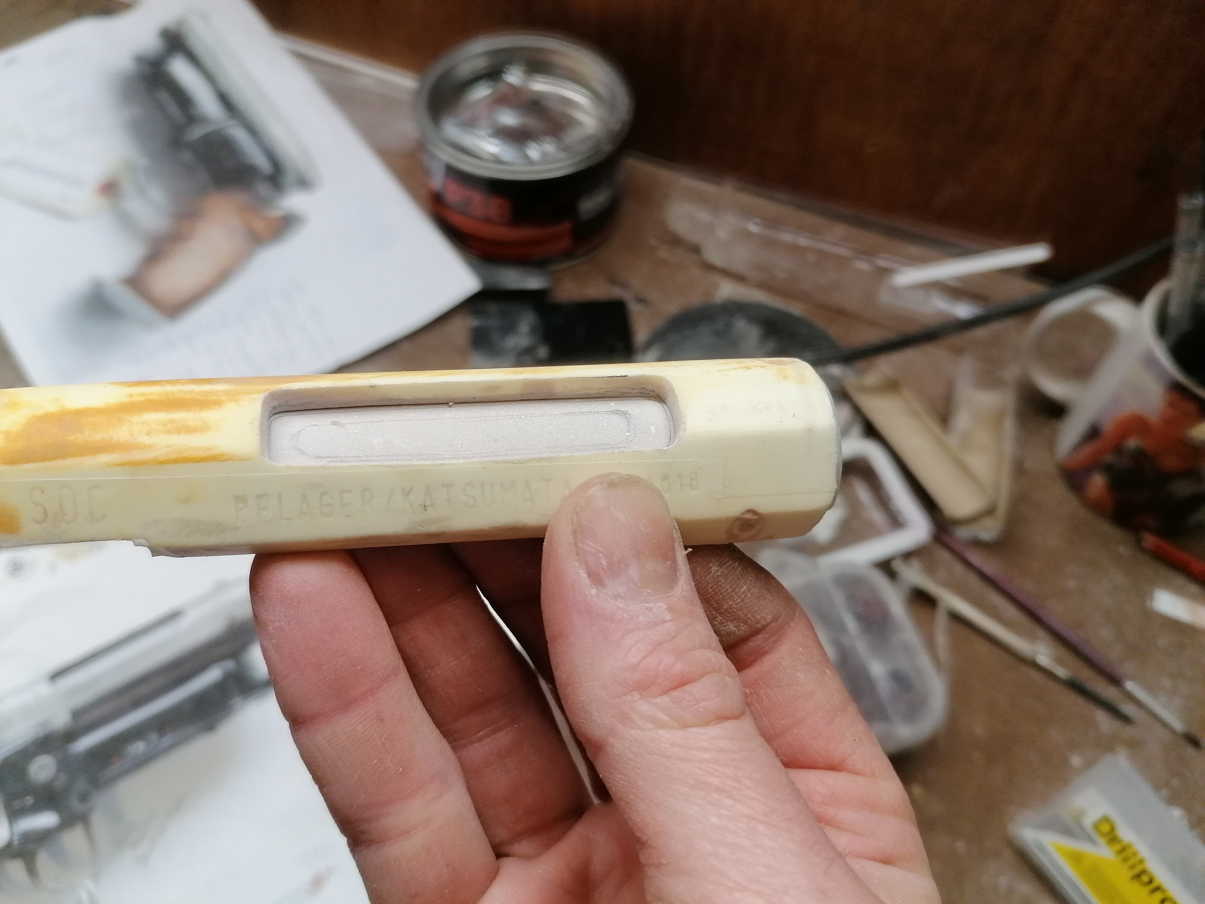

I've removed most of the text from the Steyr receiver as it was beyond saving with pin bubbles. Thankfully the Pflager-Katsumata text is OK - I want to keep that. I'm thinking of SLA printing the serial number and Steyr-mannlicher text and insetting them into the appropriate places.

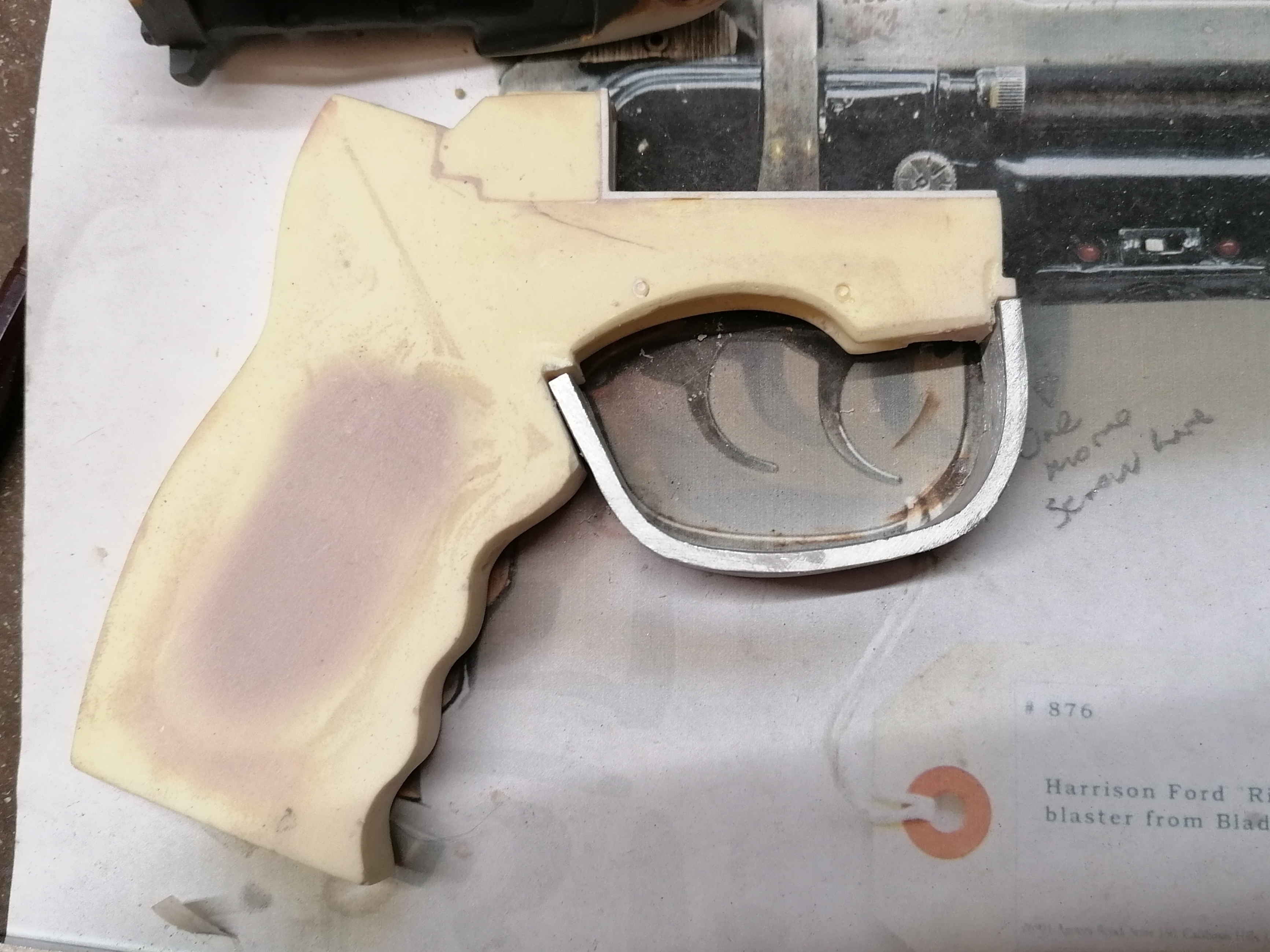

Started work on a new trigger guard. Will also fabricate two new triggers from aluminium.
