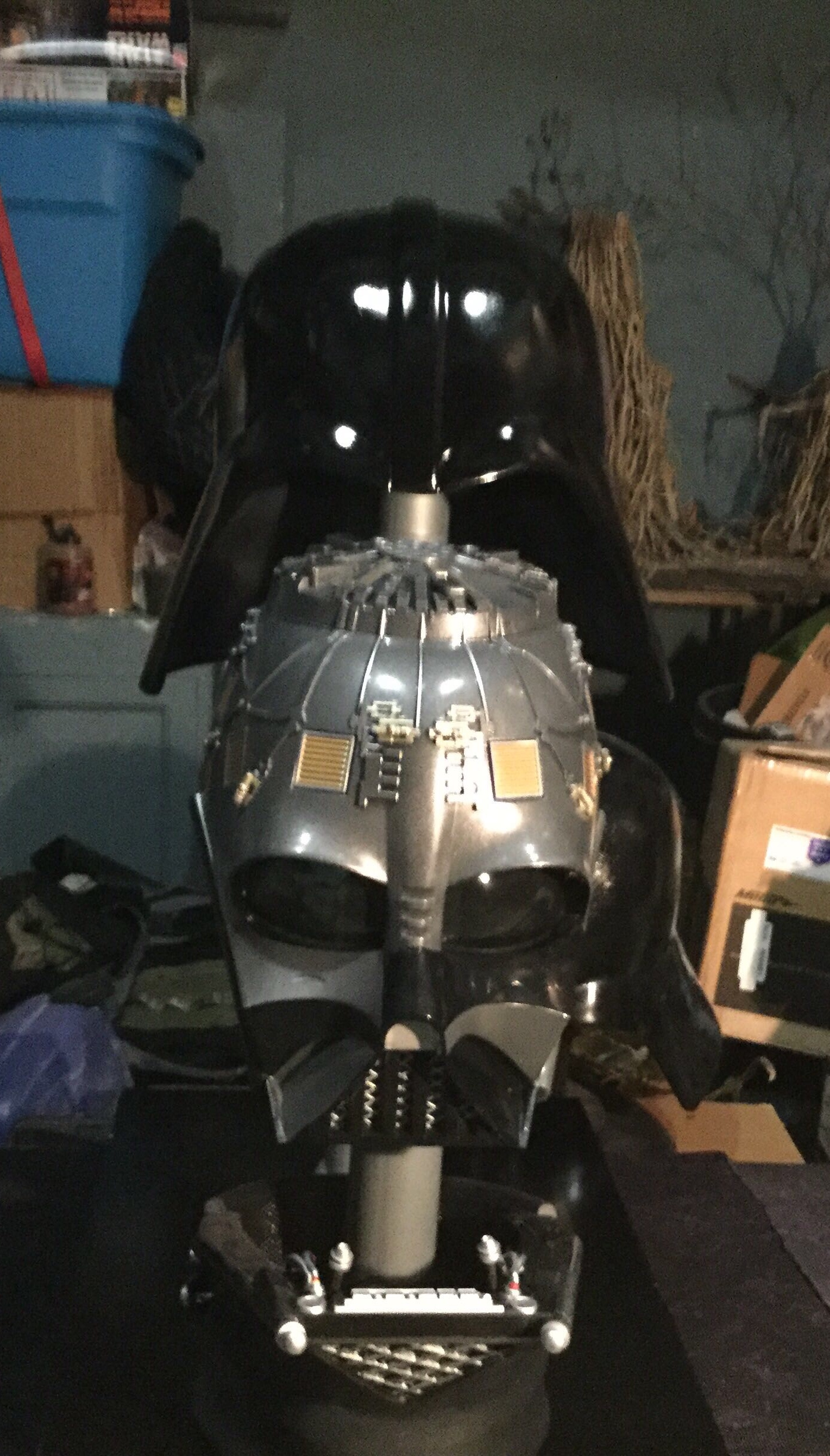

hi everybody , i get the helmet a couple days ago , i am making mods, i do have some accurate helmets to compare, so these project has been a lot of fun, i like these helmet great project loots of fun , check the images, added neck extension, metal greeblies , paint interior , exterior, and then i decided to fix the dome that its to small , thanks and enjoy your vader black series

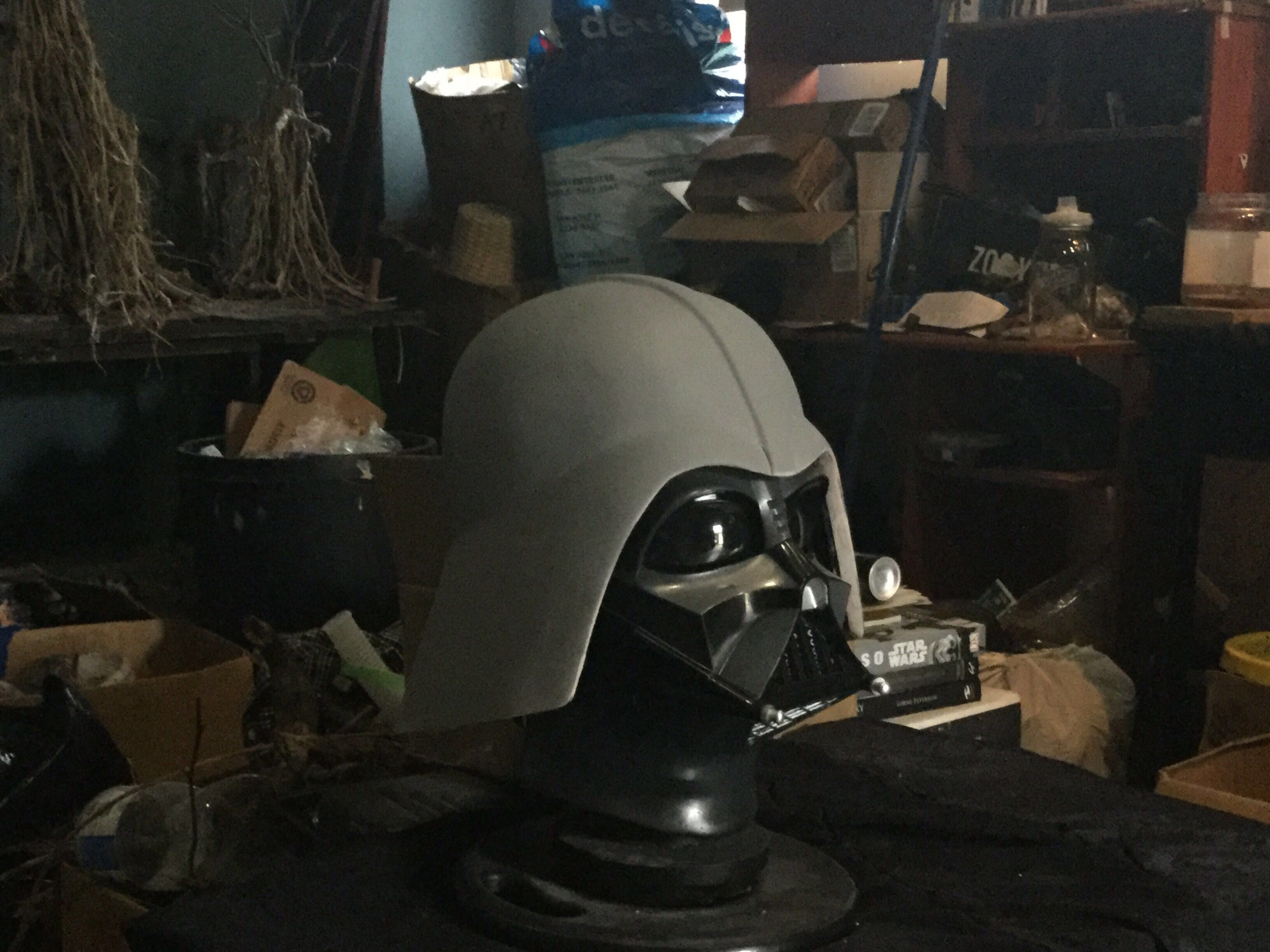

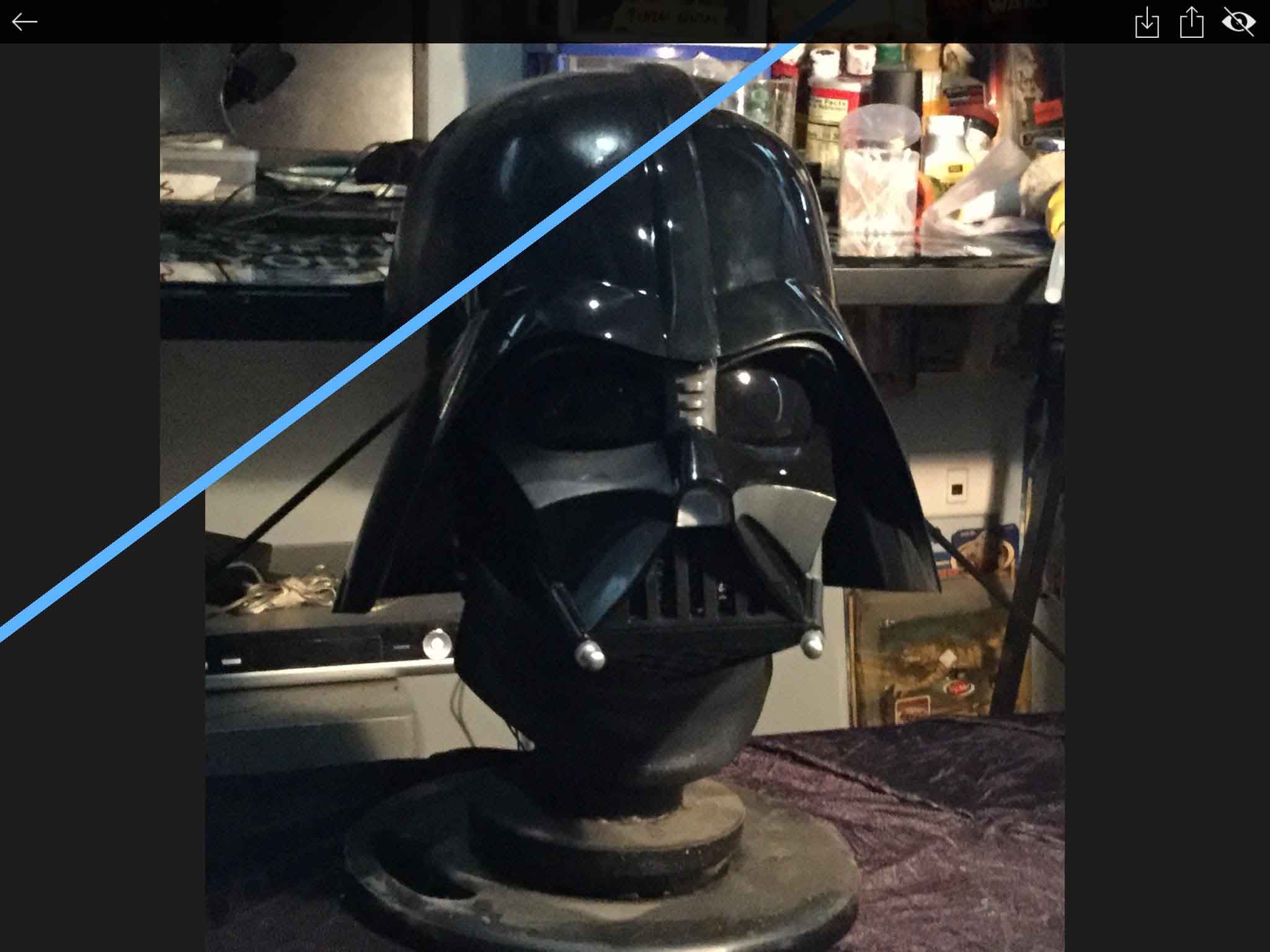

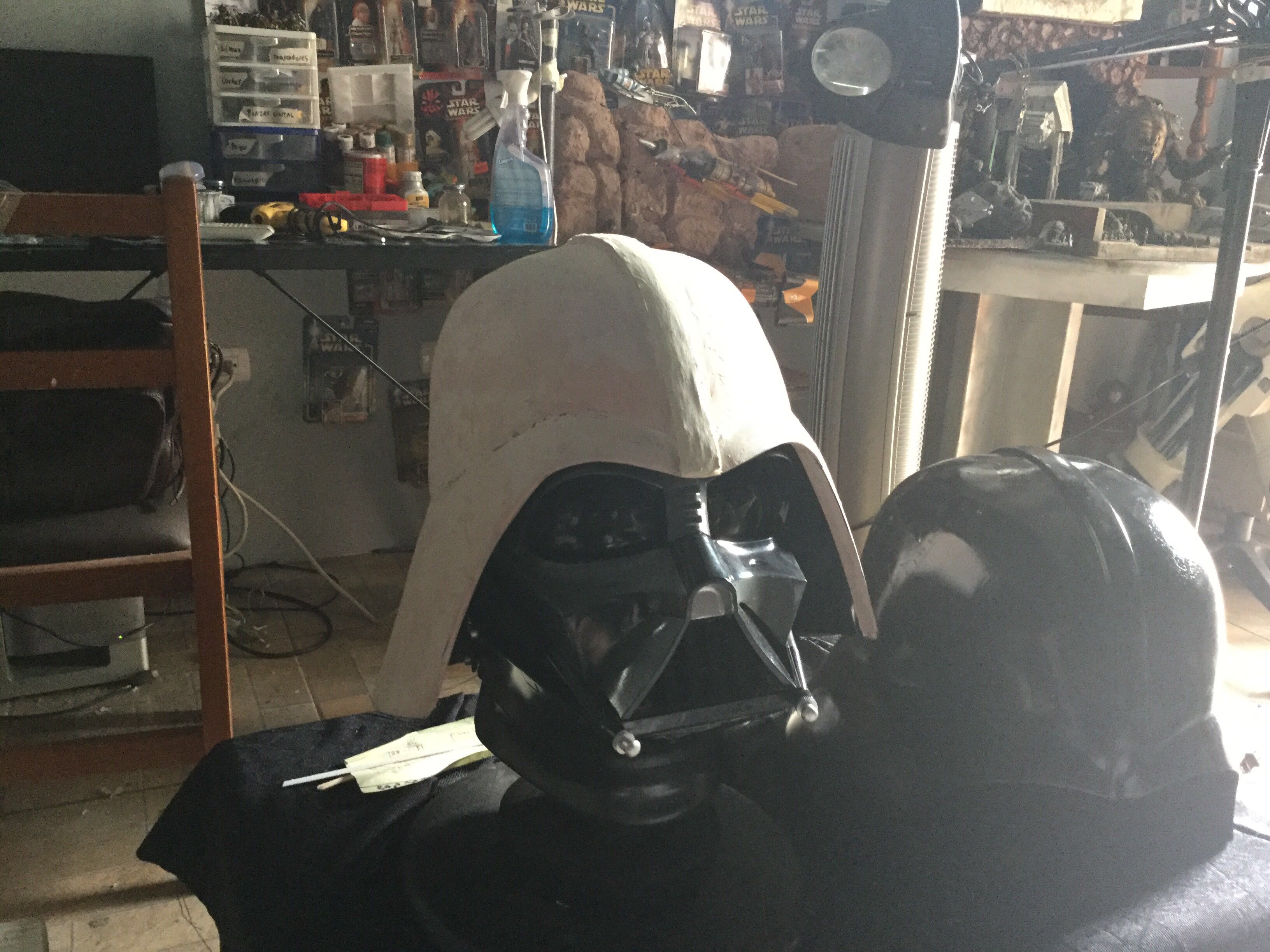

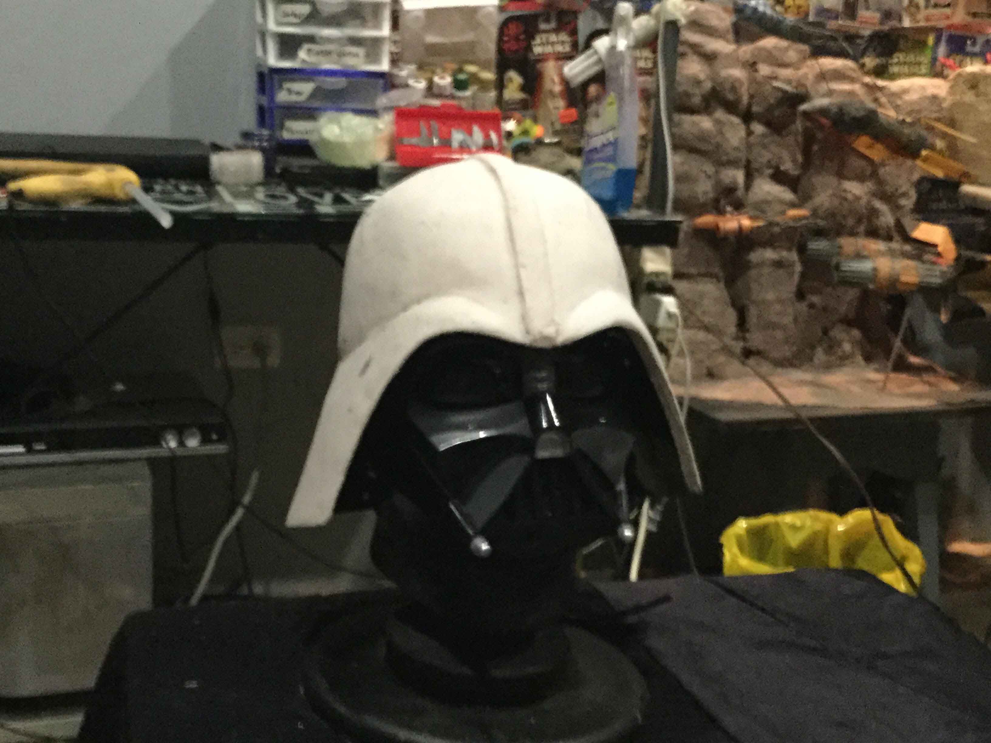

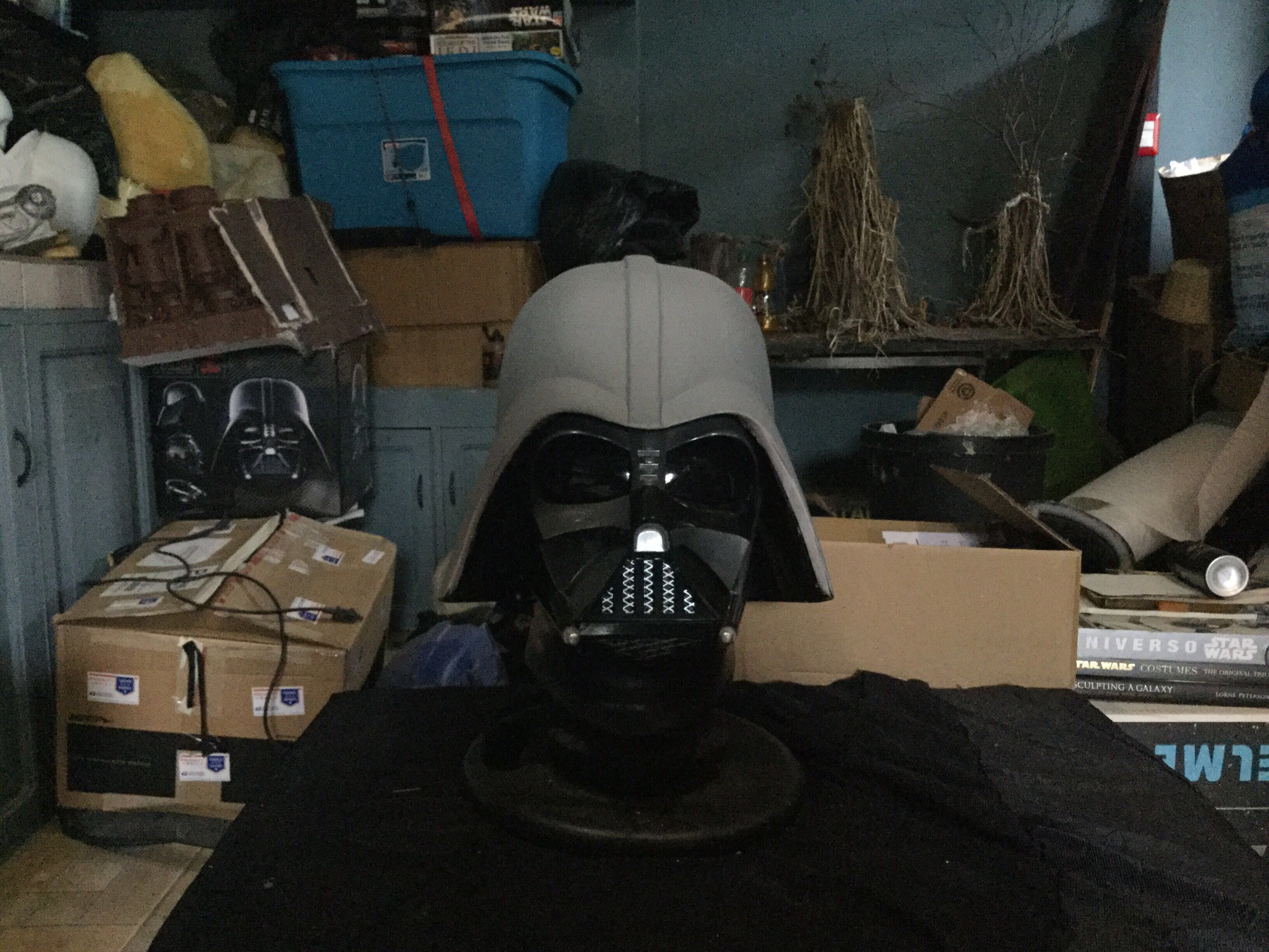

Almost finished the dome , I compare with spfx dome and return of Jedi gs helmet , use them as reference of my sculpt , helmet flare in hasbro it’s fine 30 cm , same as spfx and Jedi dome , main problem were the dome lack of volume almost 4 to 5 cm in top and sides probably 2 cm , I add lots of bondo , first I use aluminium foil paper , then hot glue to surface gave overall volume bondo on top of that , so I didn’t have to use double the amount of bondo , I was researching for the Jedi helmets and the neck on the reveal from ilm it’s indeed the shortest , but several other helmets was used in Jedi , and neck vary in couple of them , my neck it’s larger , maybe I’ll fix that latter , back to the dome , I almost finish the sculpt, most of the proportions are now ok but not perfect I try to maintain asymmetry sculpt in it, since original domes are asymmetric , mine helmeit’s not perfect but much better than the original hasbro sculpt, when I finish the helmet I will post some photos also I will put it inside the original box to see how that fit, these helmet it’s pretty cool for a toy and a nice project to work, dome also should be repositioned higher , as Jedi domes were higher , thanks , First photo it’s ilm original reveal helmet, second and third are Mark Cfo return of Jedi helmet I compare distance from chin triangle to neck , I know it’s some angle distortion from images but I think my neck it’s a little bit larger will trim that after finish the dome ,EB99A85E-D67D-4266-BD63-ACDCD5C46E8D.png458B5DC0-52E4-4372-959D-764DE0AD53A0.png7EB9BC23-8383-45C9-A297-DB967596D268.pngD76722FE-B318-4988-B8C5-AF8C244E8949.jpeg70CFFA38-5A43-4E3F-9E59-7EF0C7A593A3.jpeg
Hi everybody , after 4 days working on the dome finally I have something that’s feels ok, yesterday I mark with a marker where the crease line should go then I carved using a round file , after that I use bondo on the sides of the dome to fill any space to have an even surface besides that carved line , then use sandpaper to make line less deep , and add some primer to saw results , to copy the pattern of that line from both sides I use some soldering wire on top on and acurrate dome then use tape to put in on top of my dome and go tracing a line with a pen , still need to wet sand with sandpaper the hole dome and fill some details with bondo , thanks , the hardest part of these project definitely the dome , but I love the challenge , even do I have acurrate helmets efx limited, Cfo gs helmet, i stiil don’t regreat working on theese mods for the black series , next project after I done the display for theese helmet ,will be a rubies supreme helmet mod to make it loot better as close to acurrate as possible , I will make a tutorial with all the images for the black series mods , thanks 5FFD7E72-DBC0-4D19-8F60-EDA6C48A5E10.jpeg5852A2EF-D0F9-4729-B7D9-C0CF69863528.jpeg506DFAF5-AAED-4170-8309-1FEC014CCF84.jpegD39E898B-E0DA-4740-842F-B0381B449472.jpeg14DEA84D-93D1-440F-A1D5-C50E603525F7.jpeg9B3F202D-C8B4-4F80-A473-428465CE3BAA.jpeg6243AC8A-DB74-4DC4-9566-DF973834D399.jpeg7631996A-759C-4C53-8306-67F699676CF5.jpeg

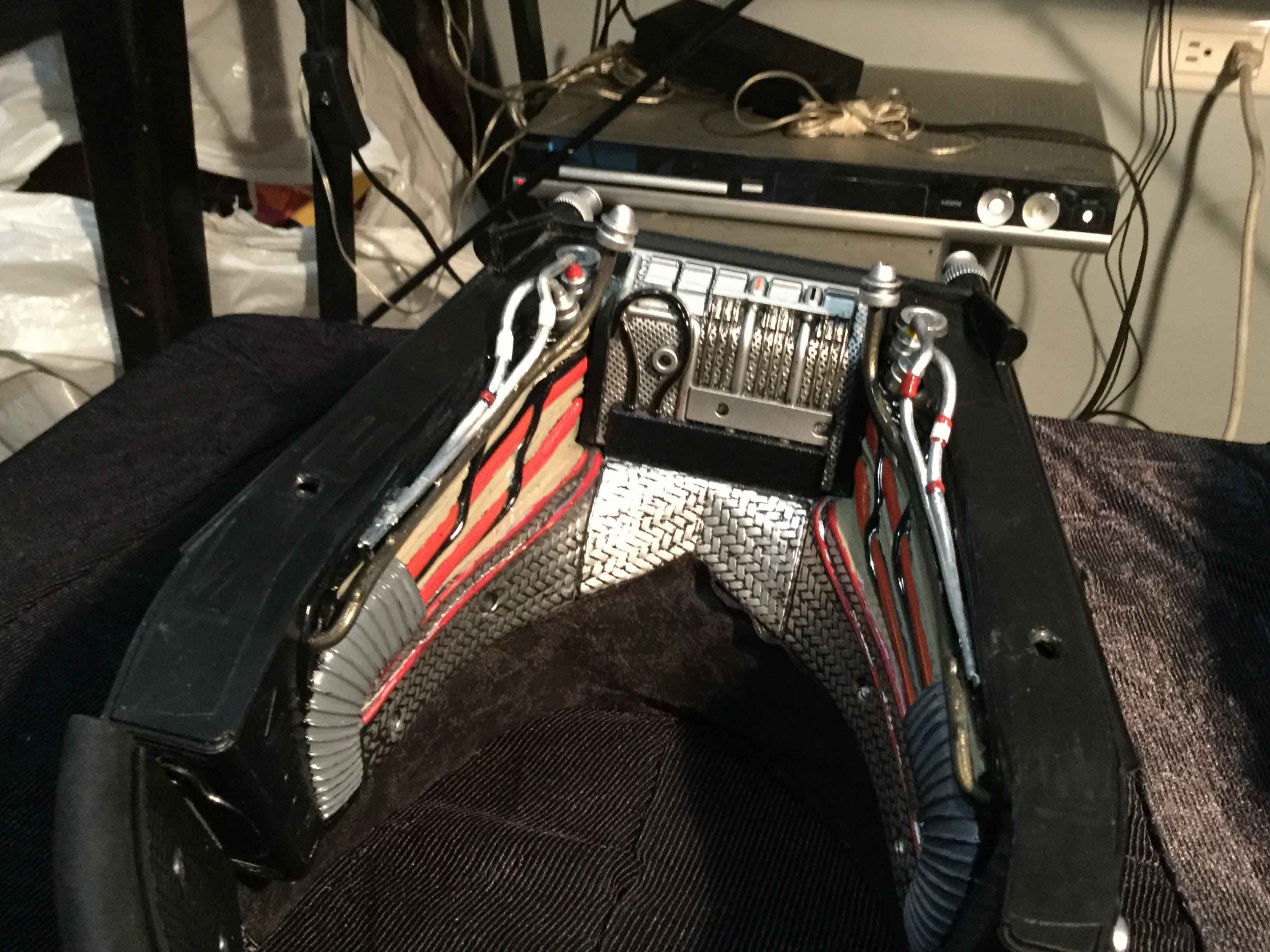

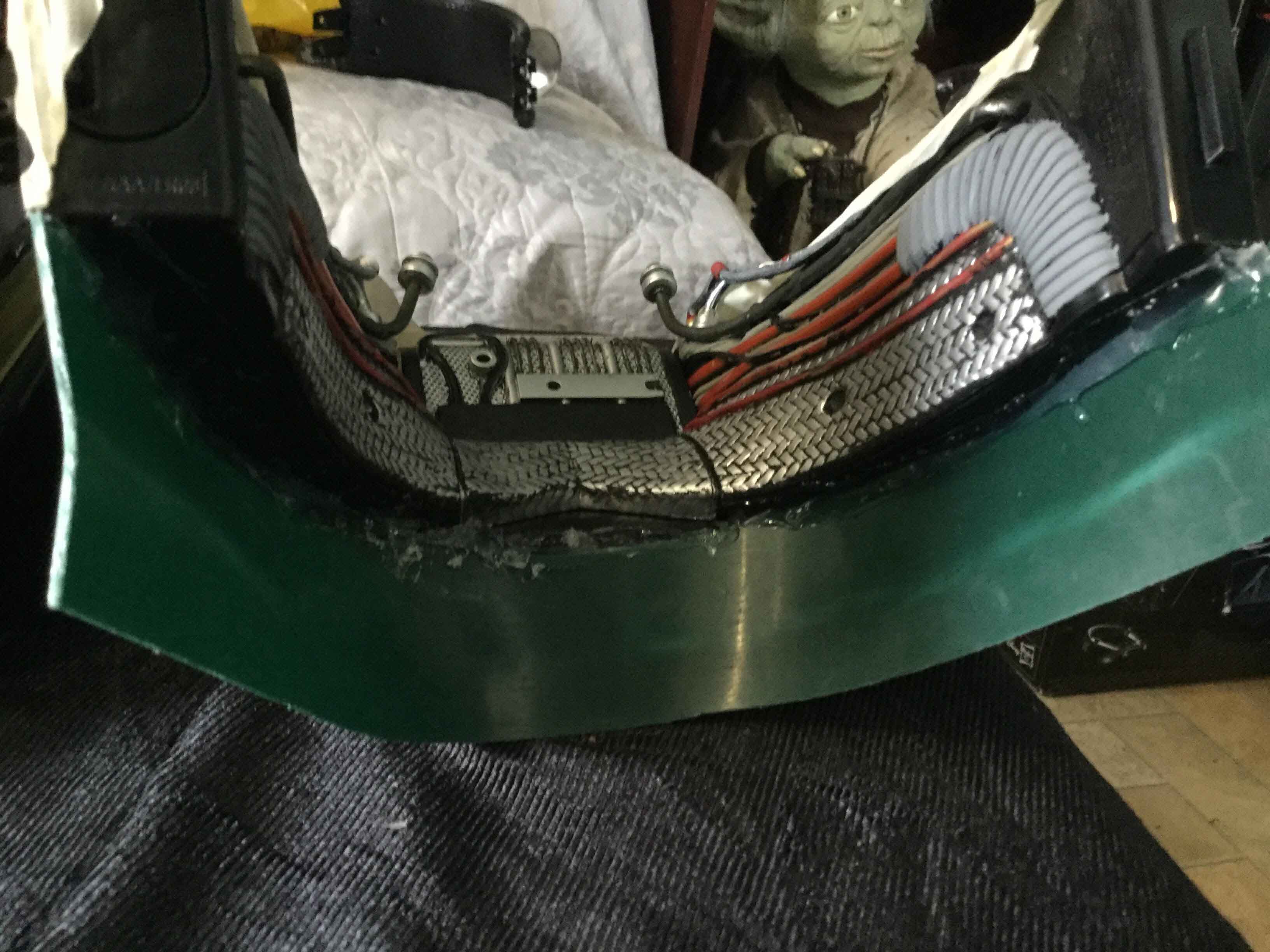

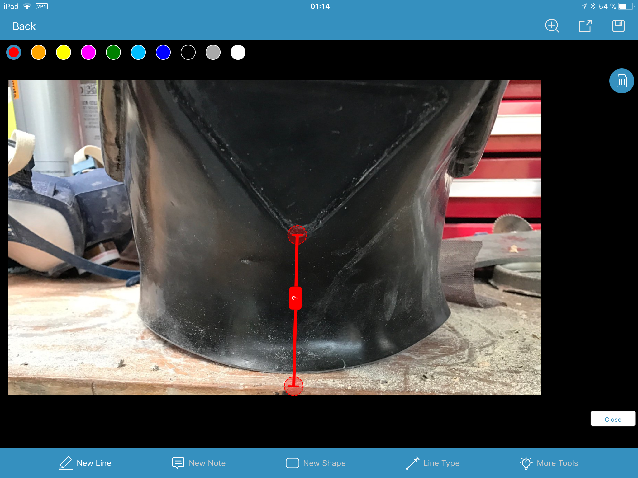

Copper tubing and stainless braided material arrived to dress up the inside of the lower jaw. This is a very fun project.

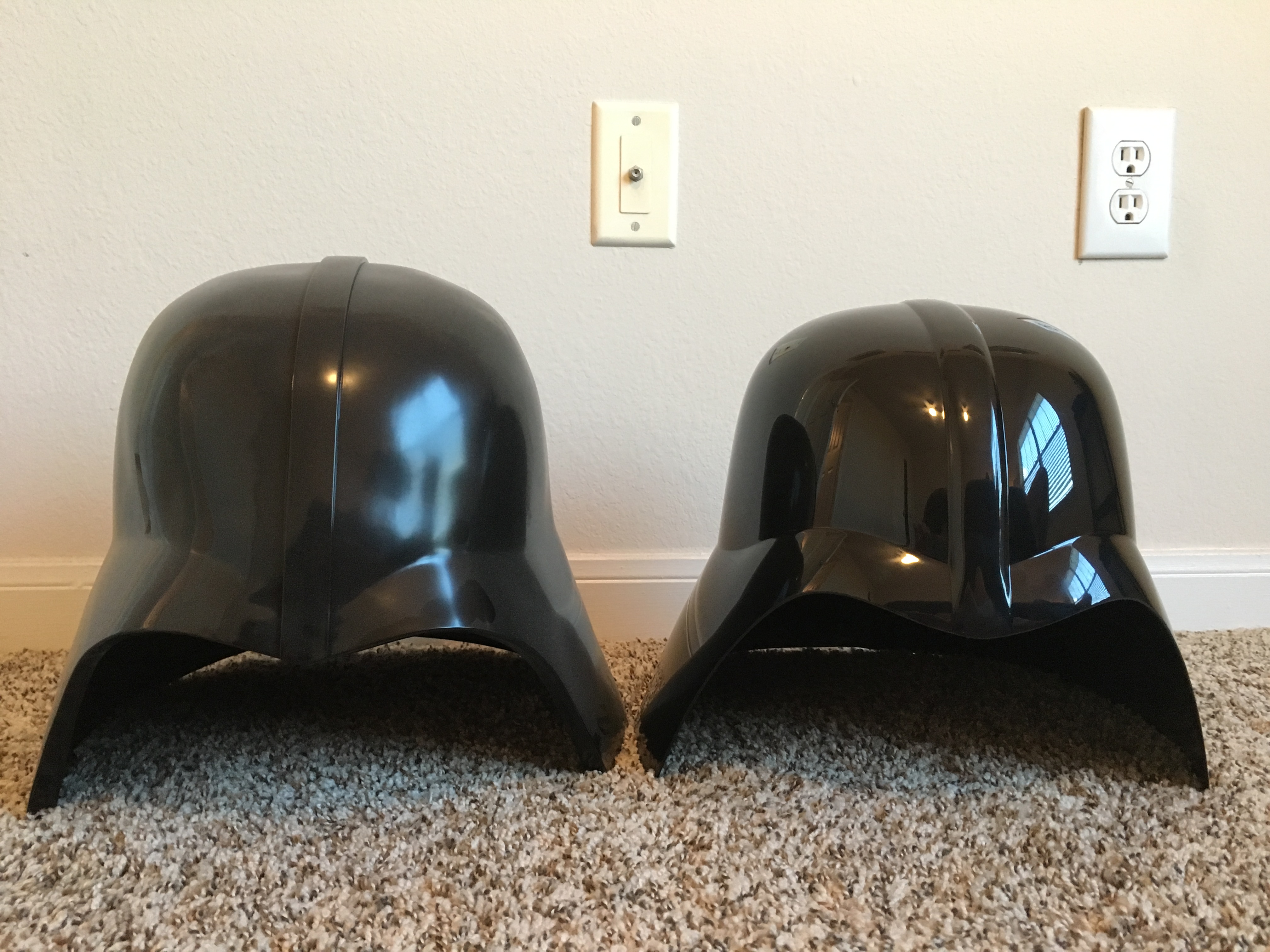

eFX dome next to the BS:
