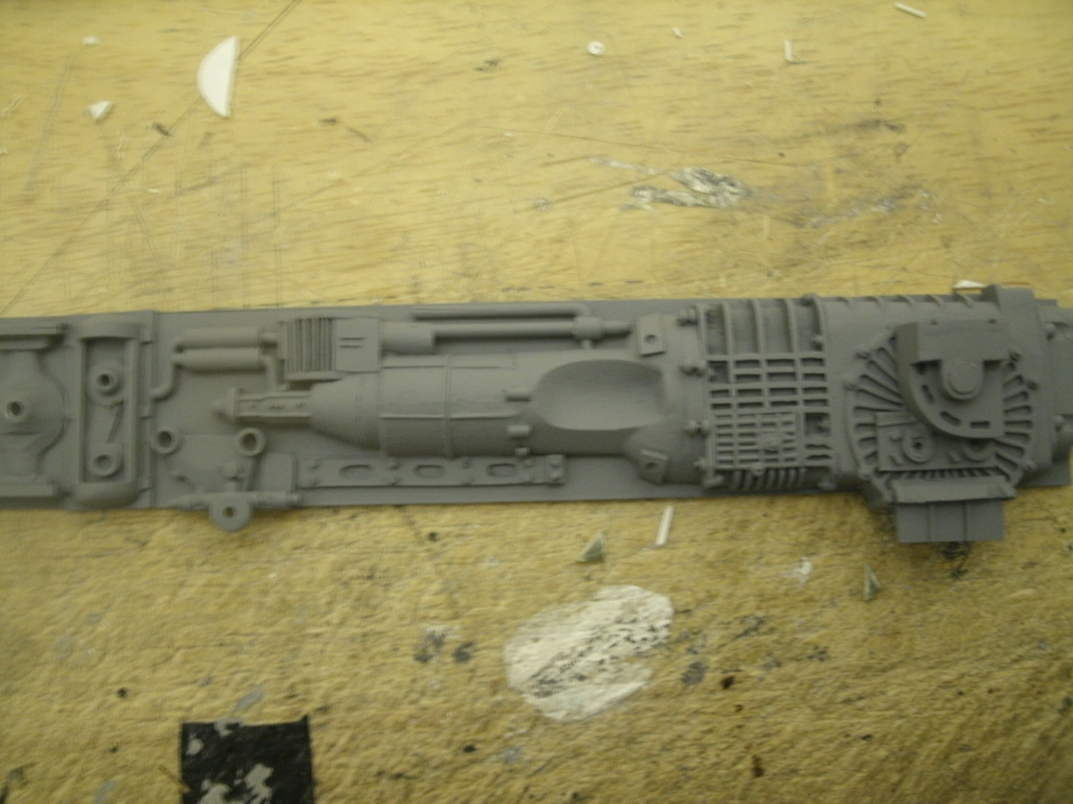

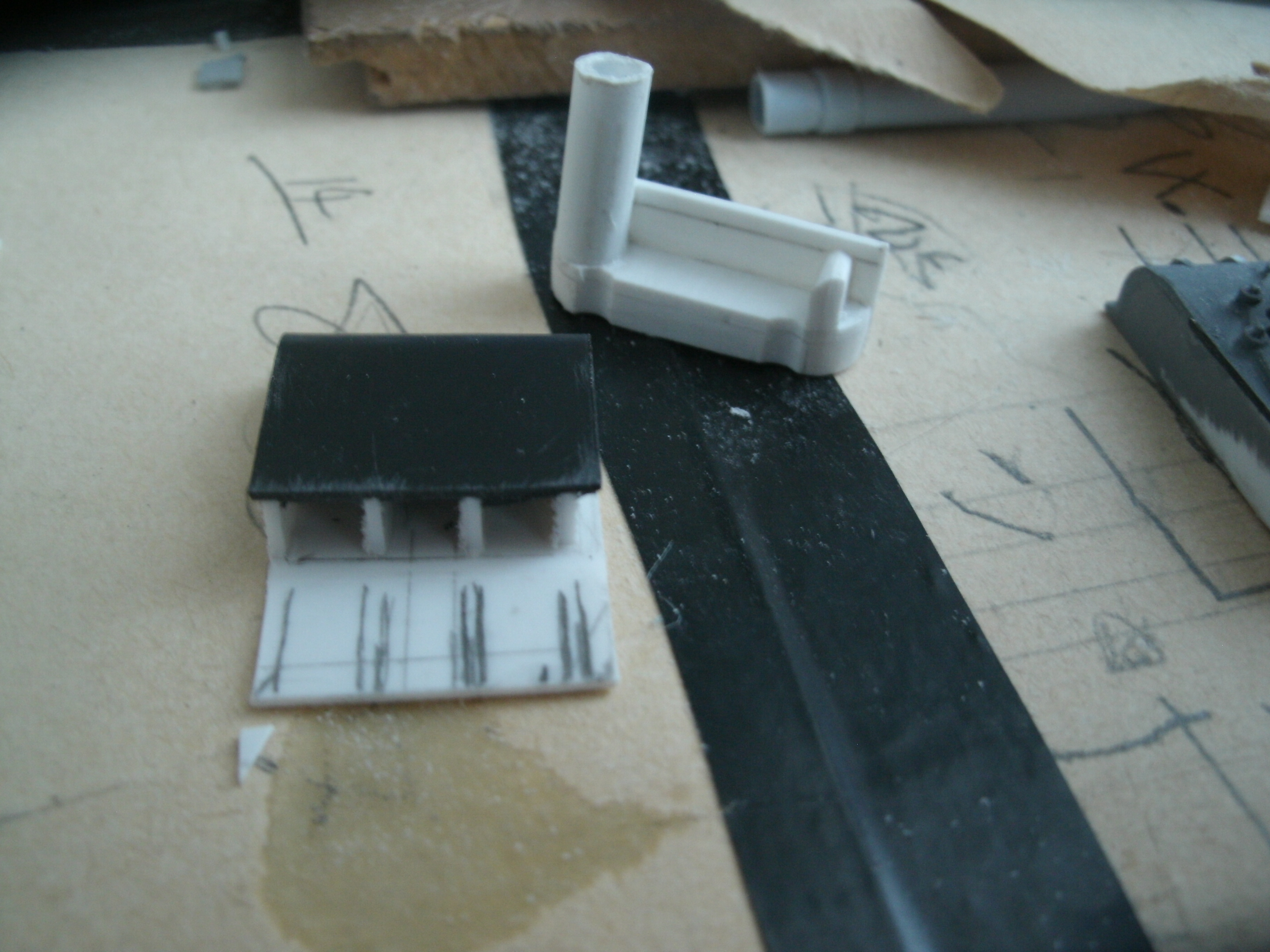

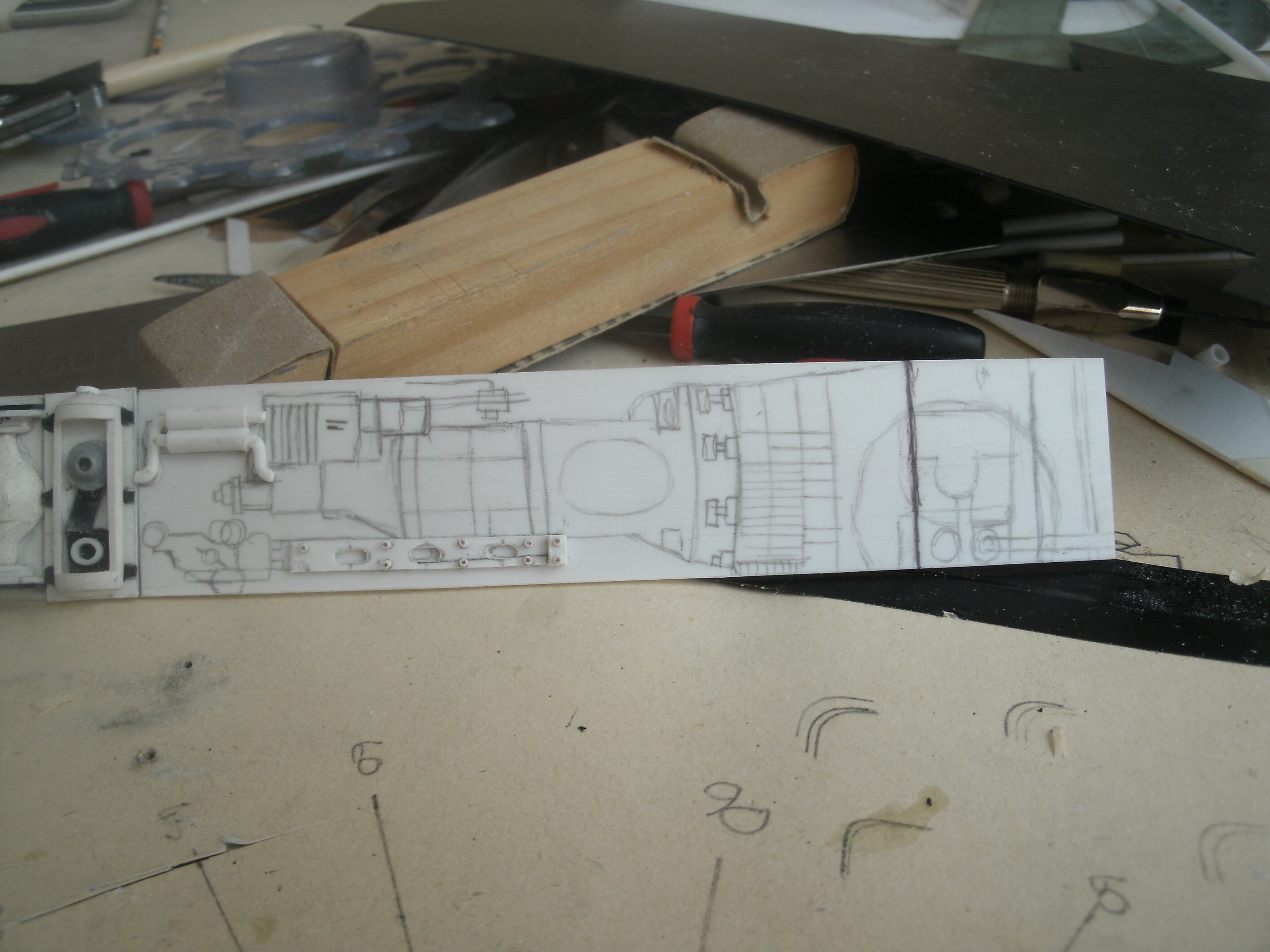

here is another update,ive been makin up the side mandible detail on the far side to the cockpit.
first off i made the side plate and the two shaped right angled pieces that are on the top and bottom of the plate.
next i drew up the detail with a pencil just to plan roughly where things are gonna go.
as ya can see i`ve already started makin bits on the side,so i carried on buildin bits down the side,with bits of pens,lolly sticks
and styrene.the black styrene is half mil thick and the white is 1 mil thick.

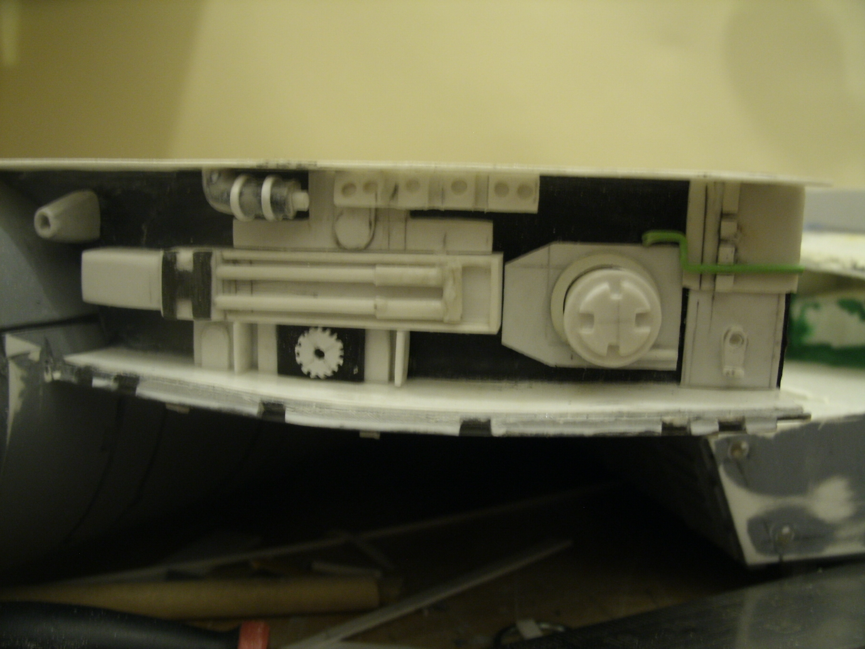

here is a shot of the whole side..well of the finished detail so far.

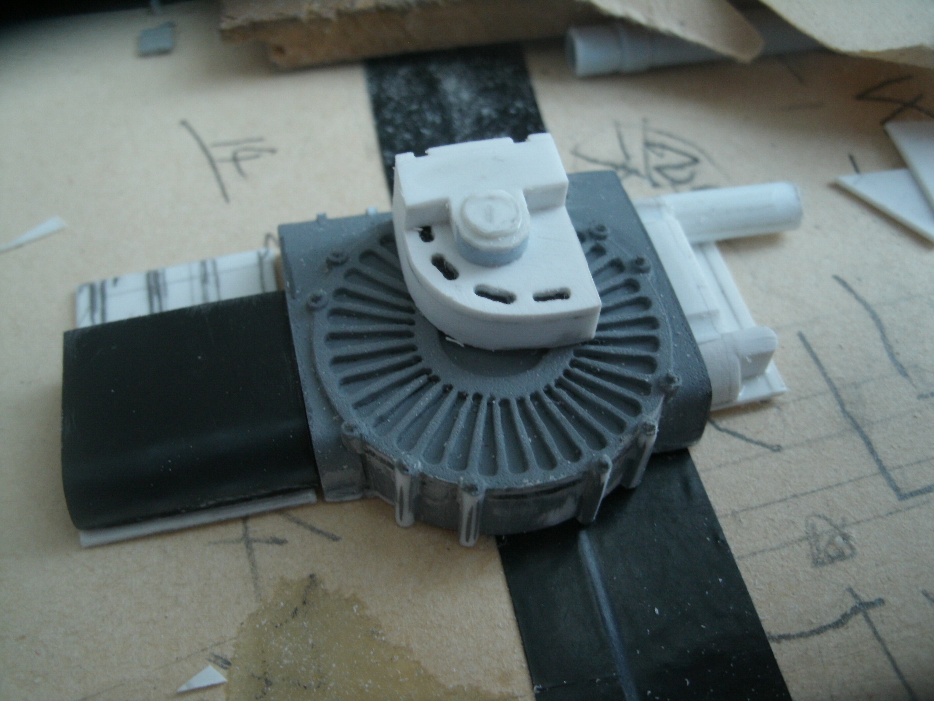

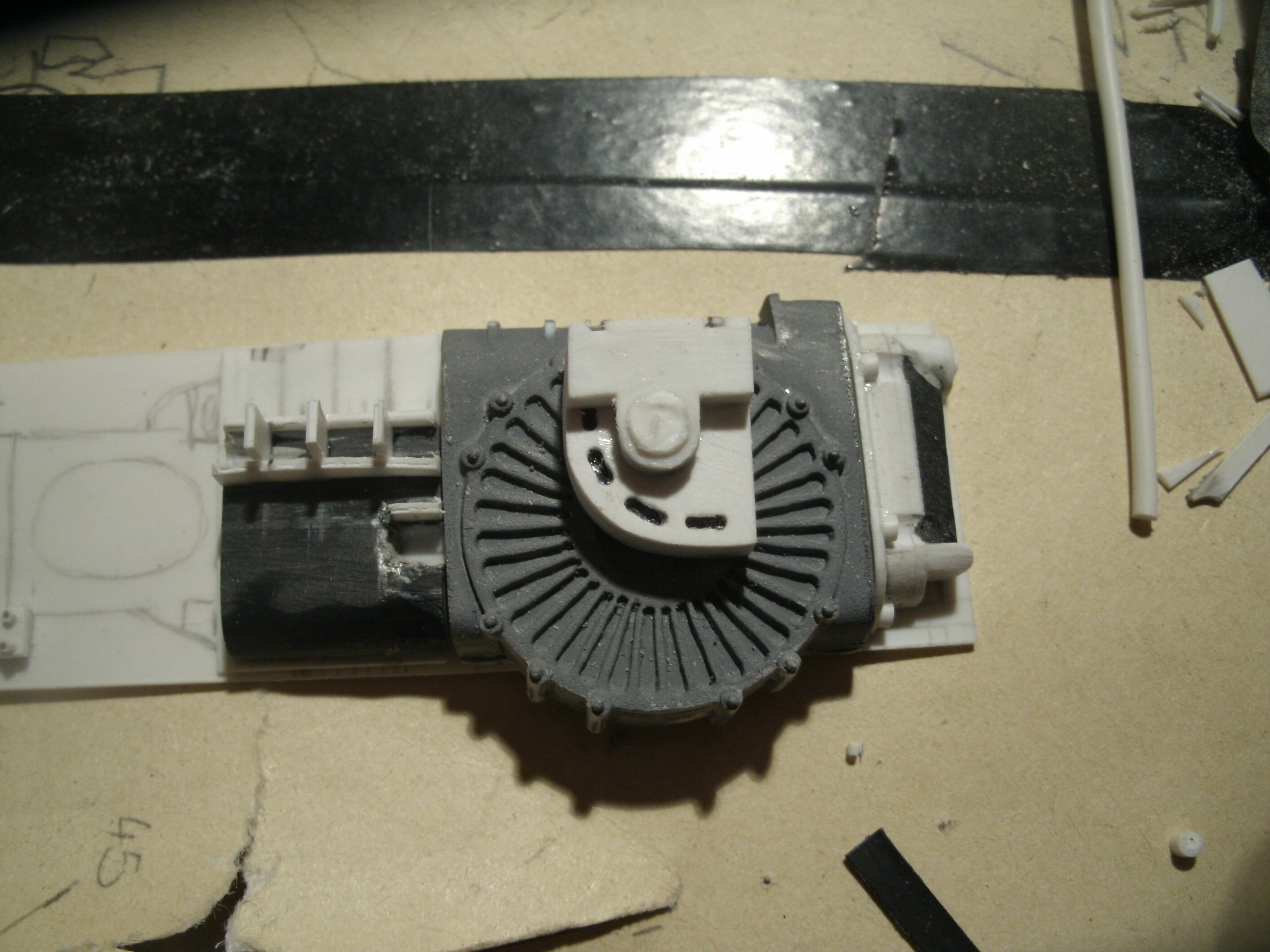

and finally i`ve made a start on the gearbox part i had to break it down into sub sections just to make it easy to build
well thats it for this one,i`ll try and get the gearbox bit finished up before my next update...cheers peza,hope ya like

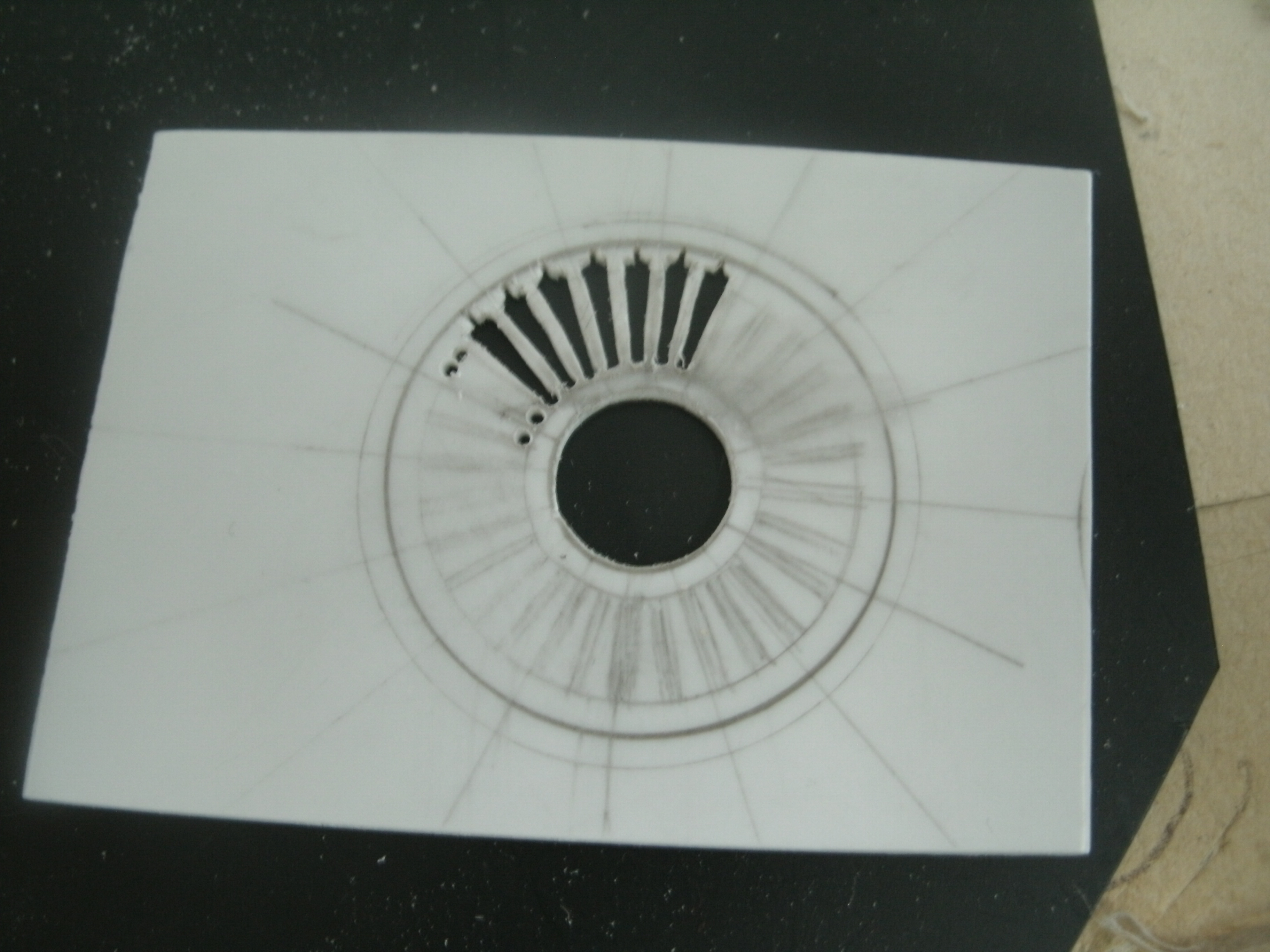

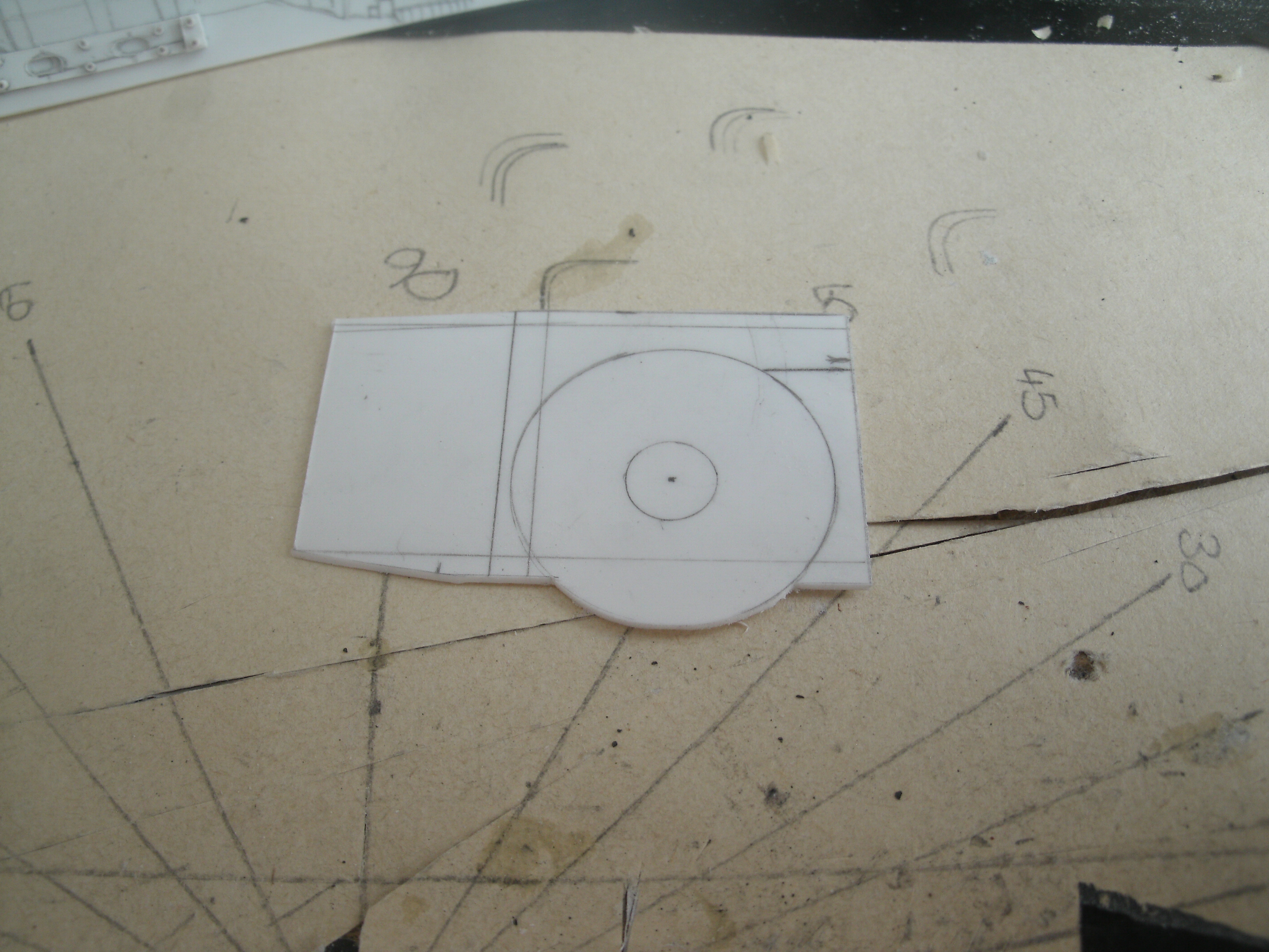

eh up all.

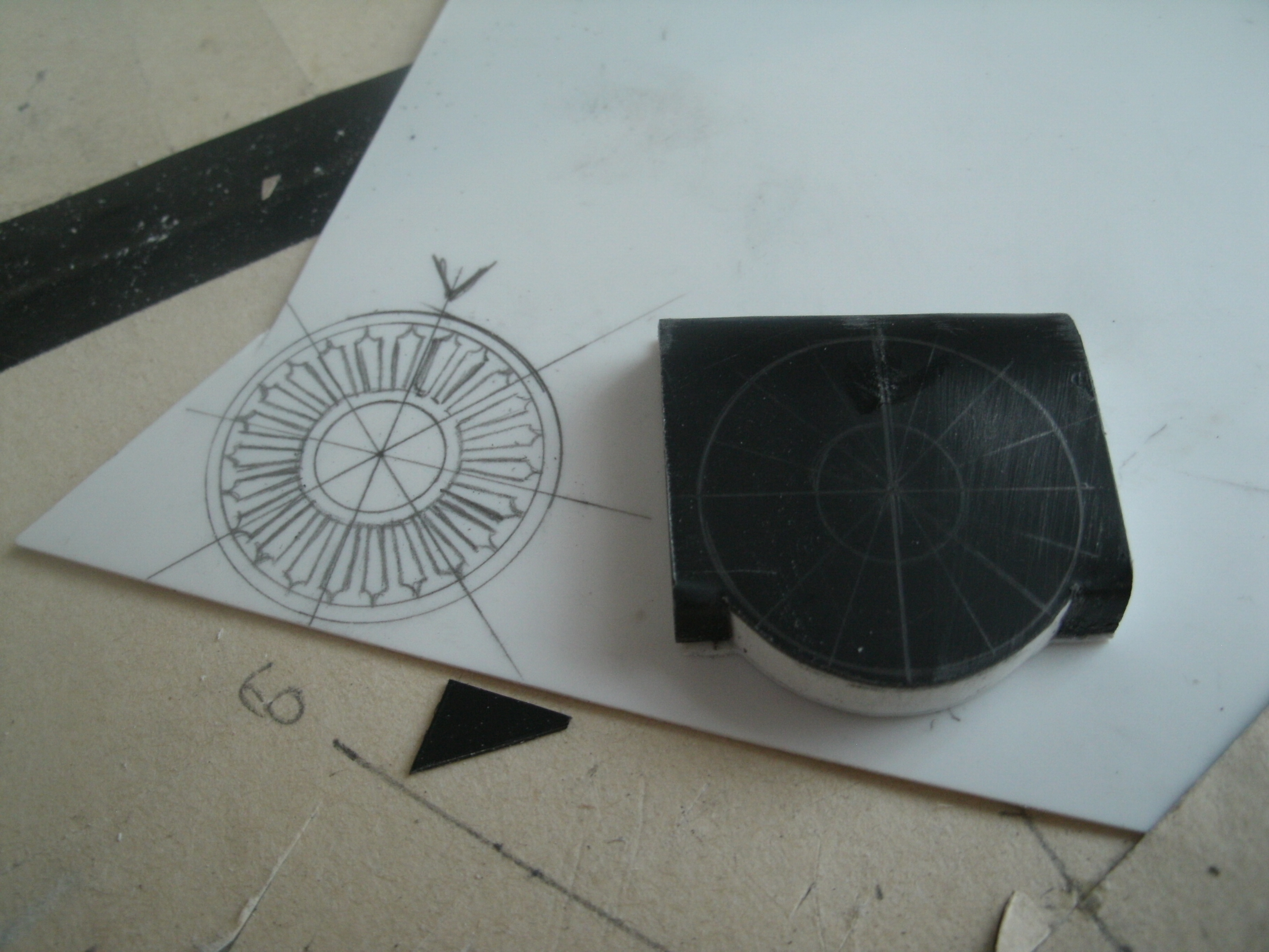

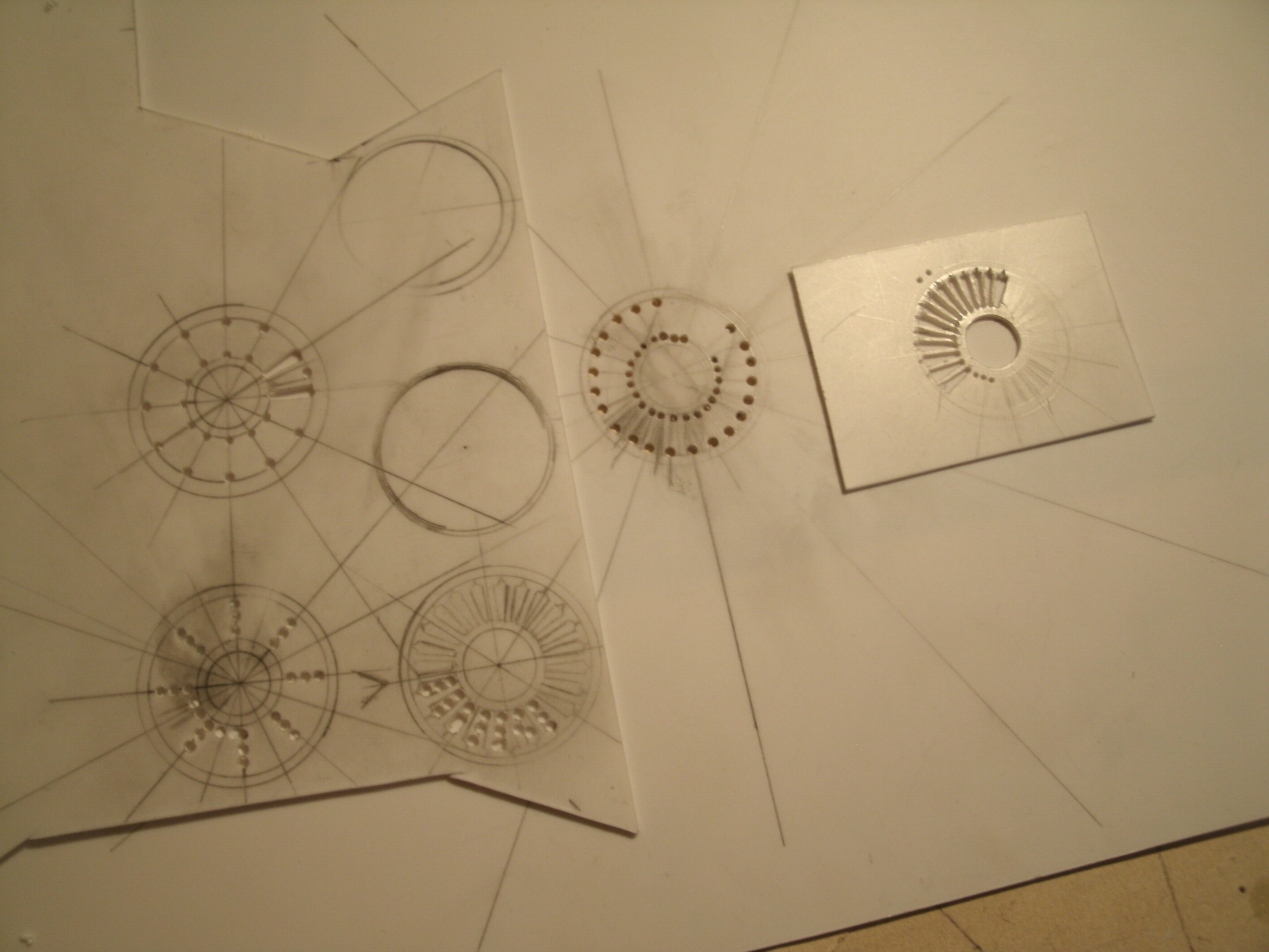

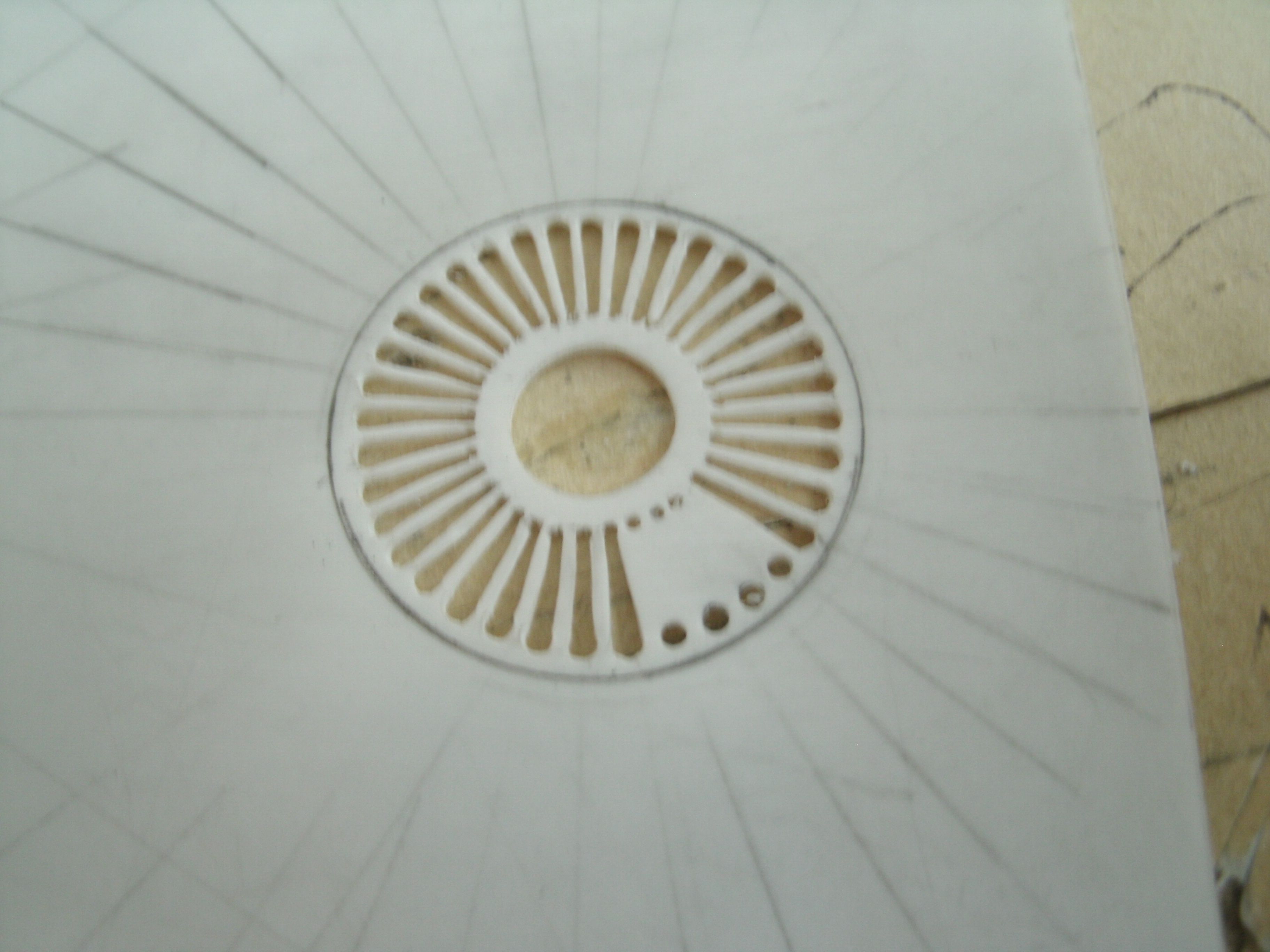

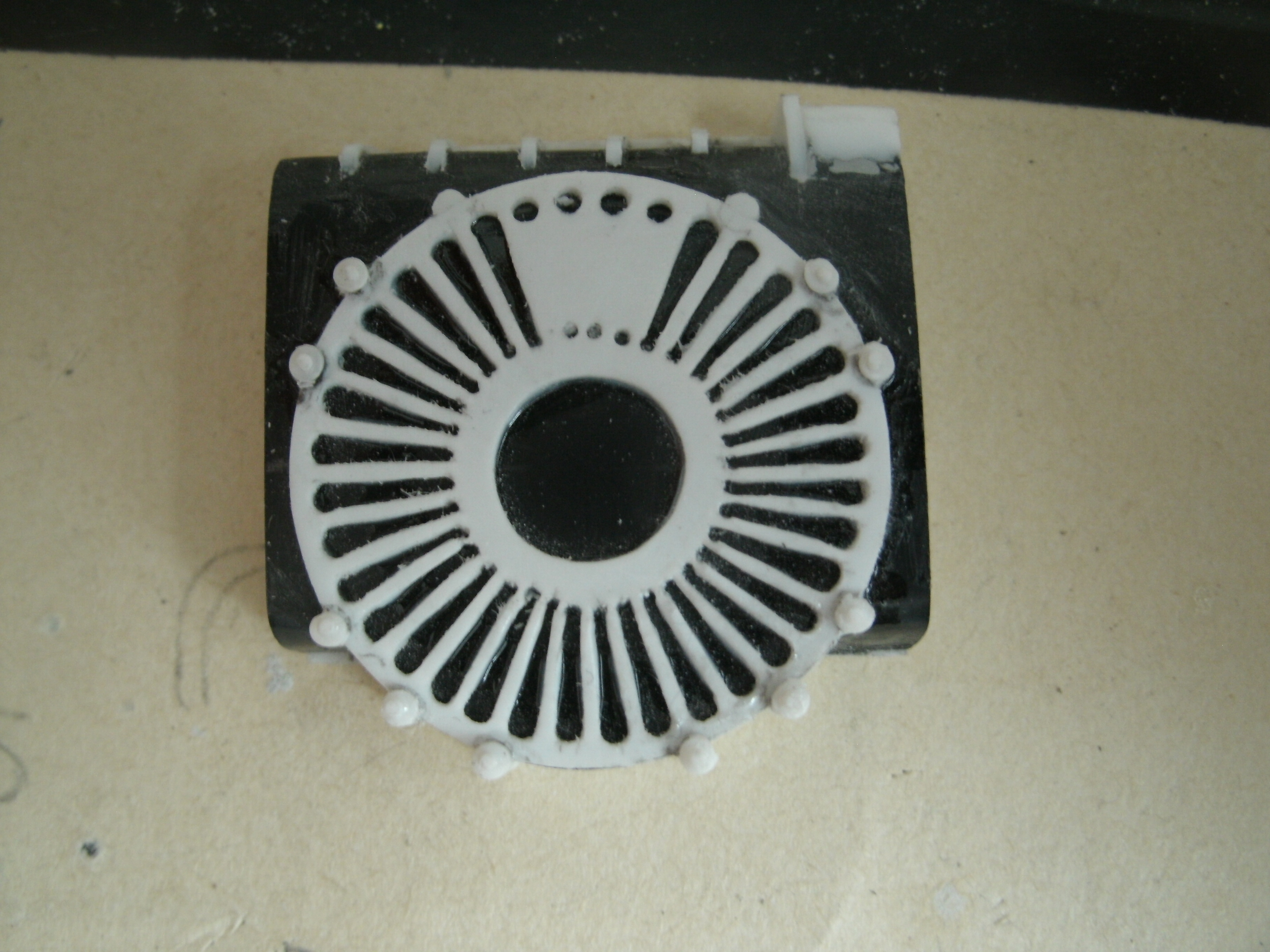

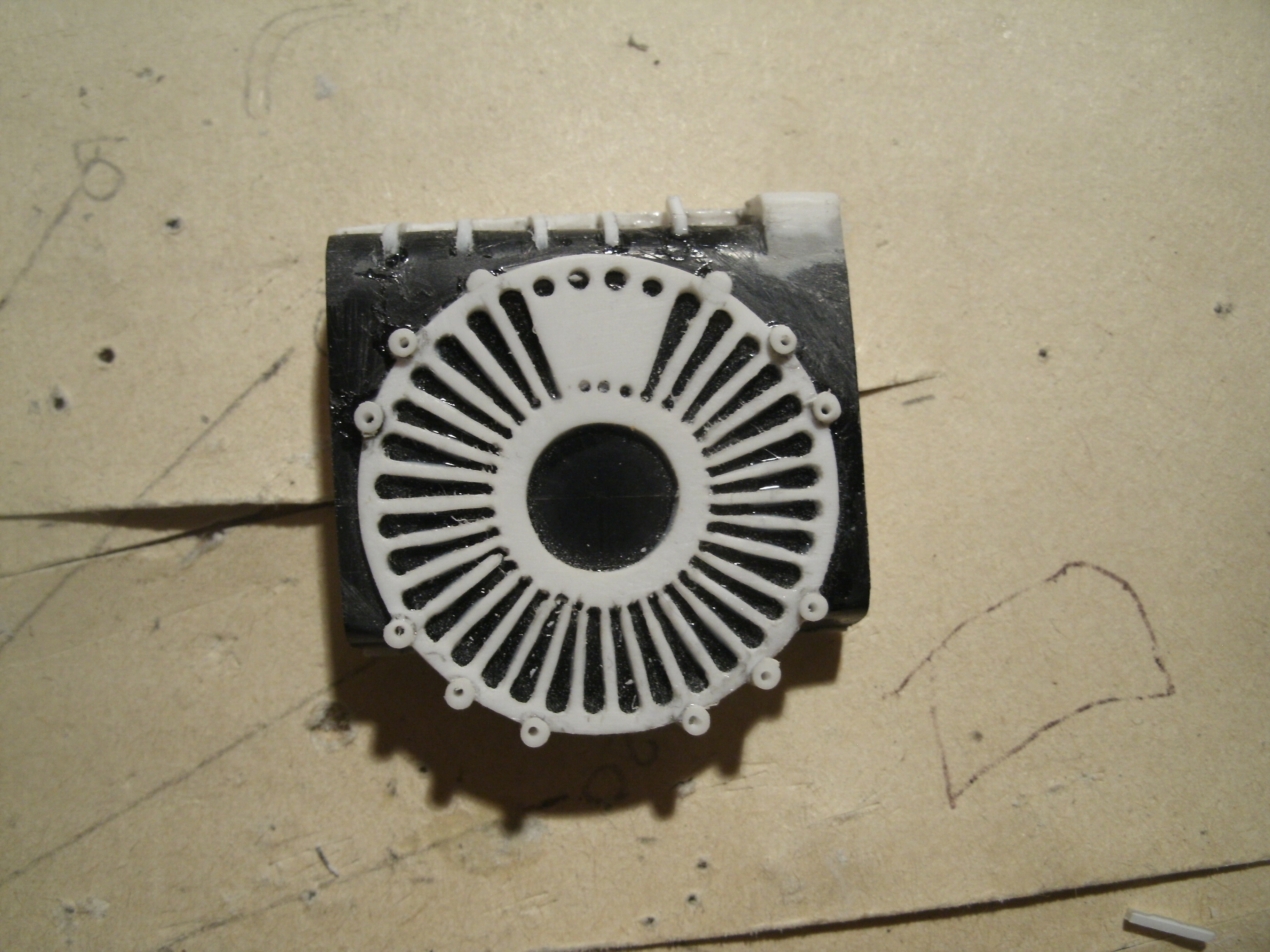

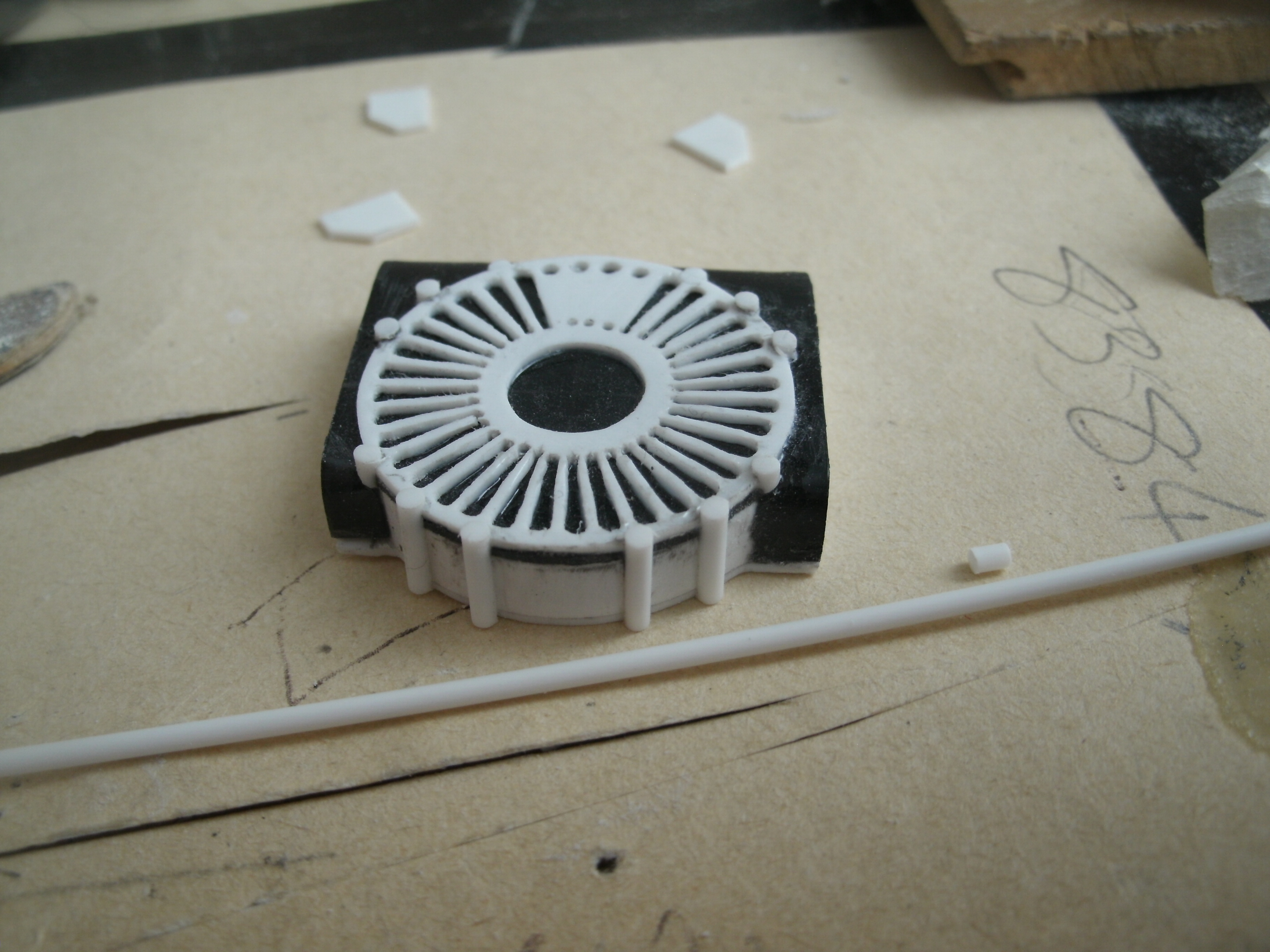

here is another update on my gearbox parts,first off i had to remake the circular part as i messed it up
i even struggled to draw up the template on my styrene.

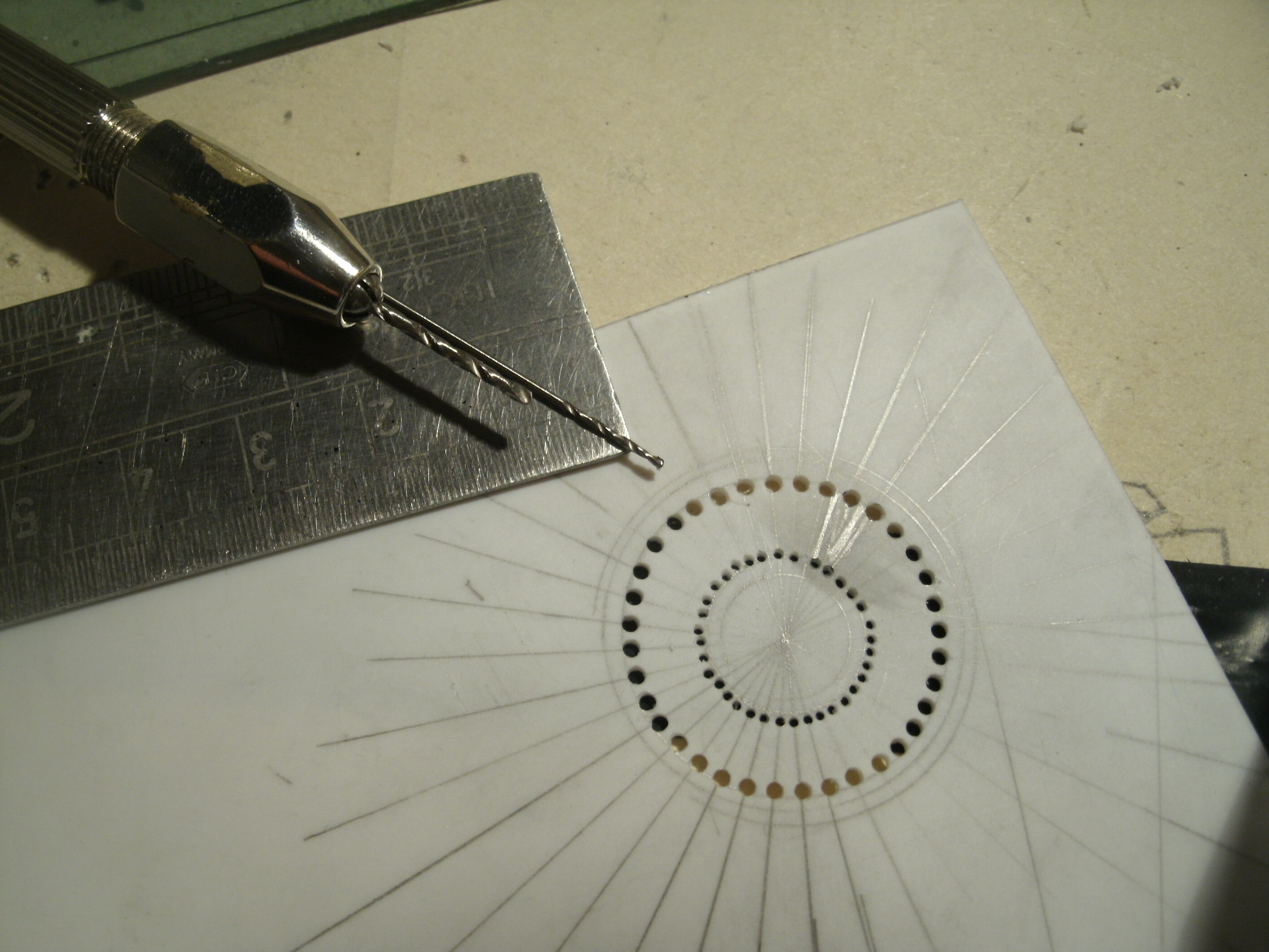

next i drilled out all the bits i needed before goin at it with my small knife.

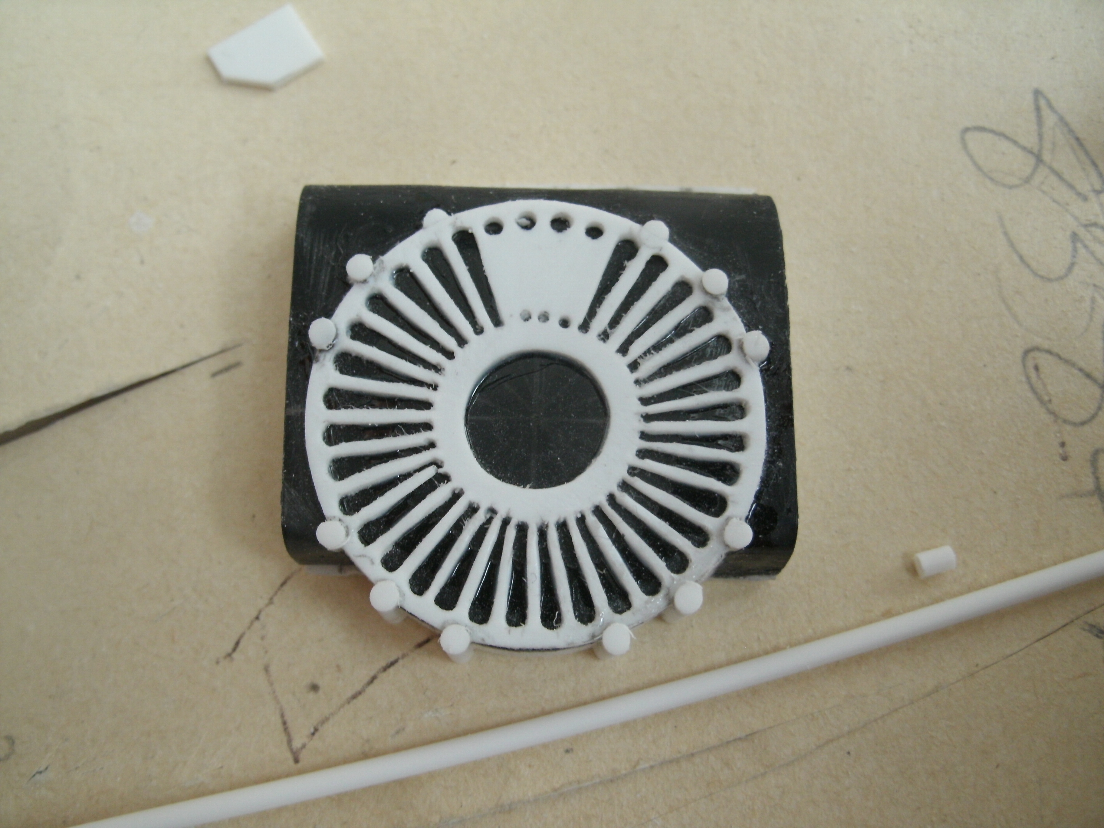

next i glued it into place and made up the bolt housings out of some 1mm styrene rods.
next i made the top fin parts and the small squared off piece which is in the top right corner
as you can see i drilled out the middles of the bolt housings so i could insert the bolts which are half mm styrene rod.
and finally i gave it a shot of primer,just to see if it`s all nice and neat with no little gaps.
well thats it for this update i`m gonna try to get some more done today or this comin week,hope you like the progress..
cheers for lookin...peza

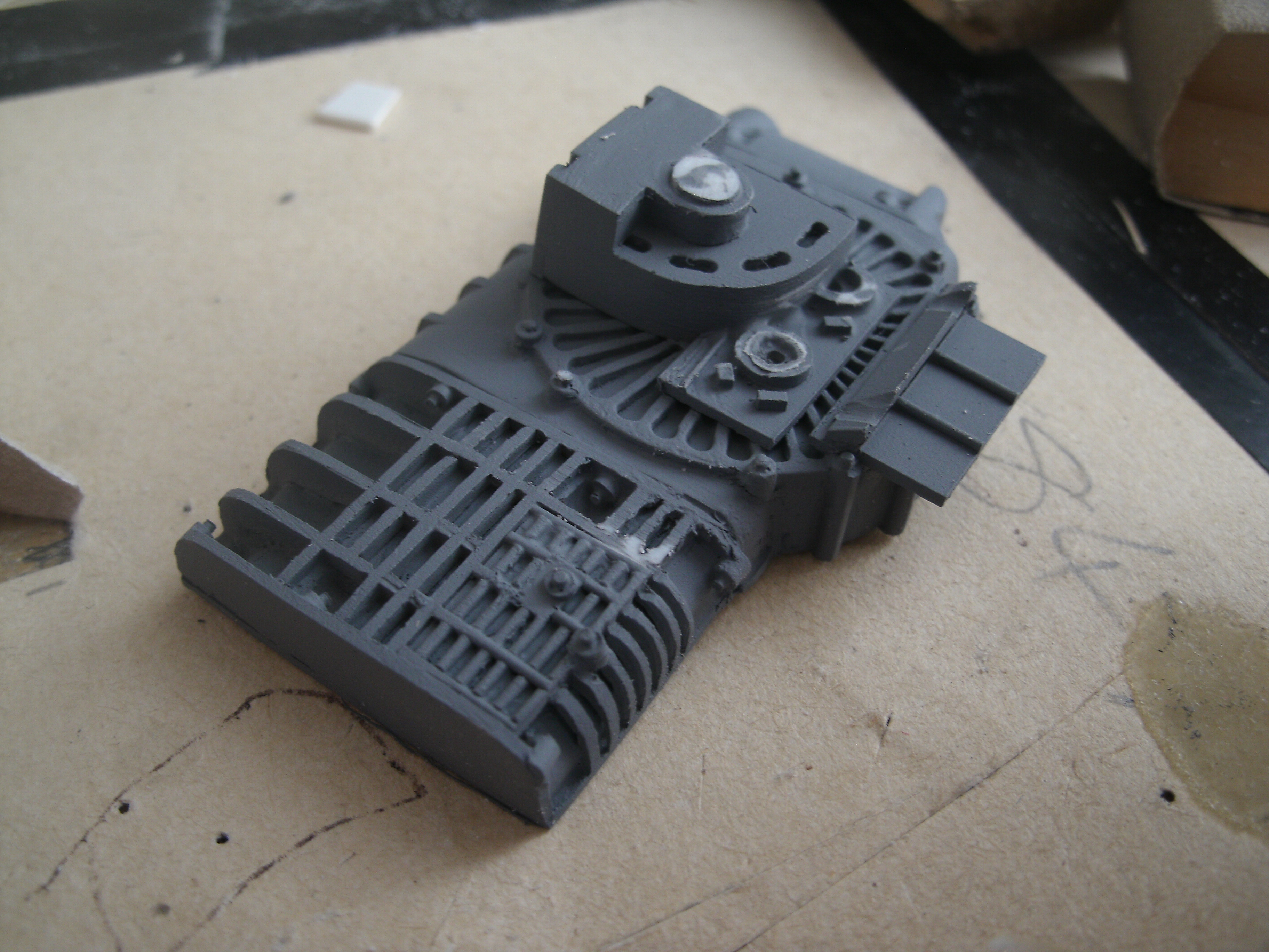

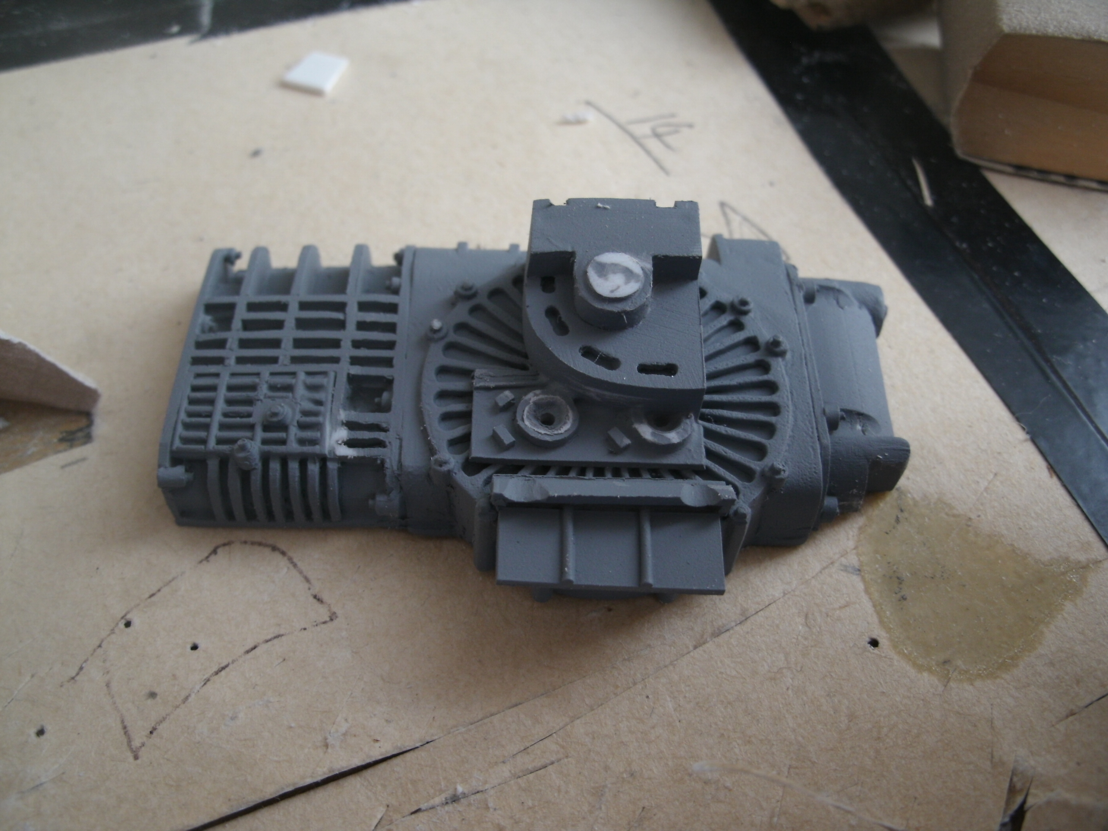

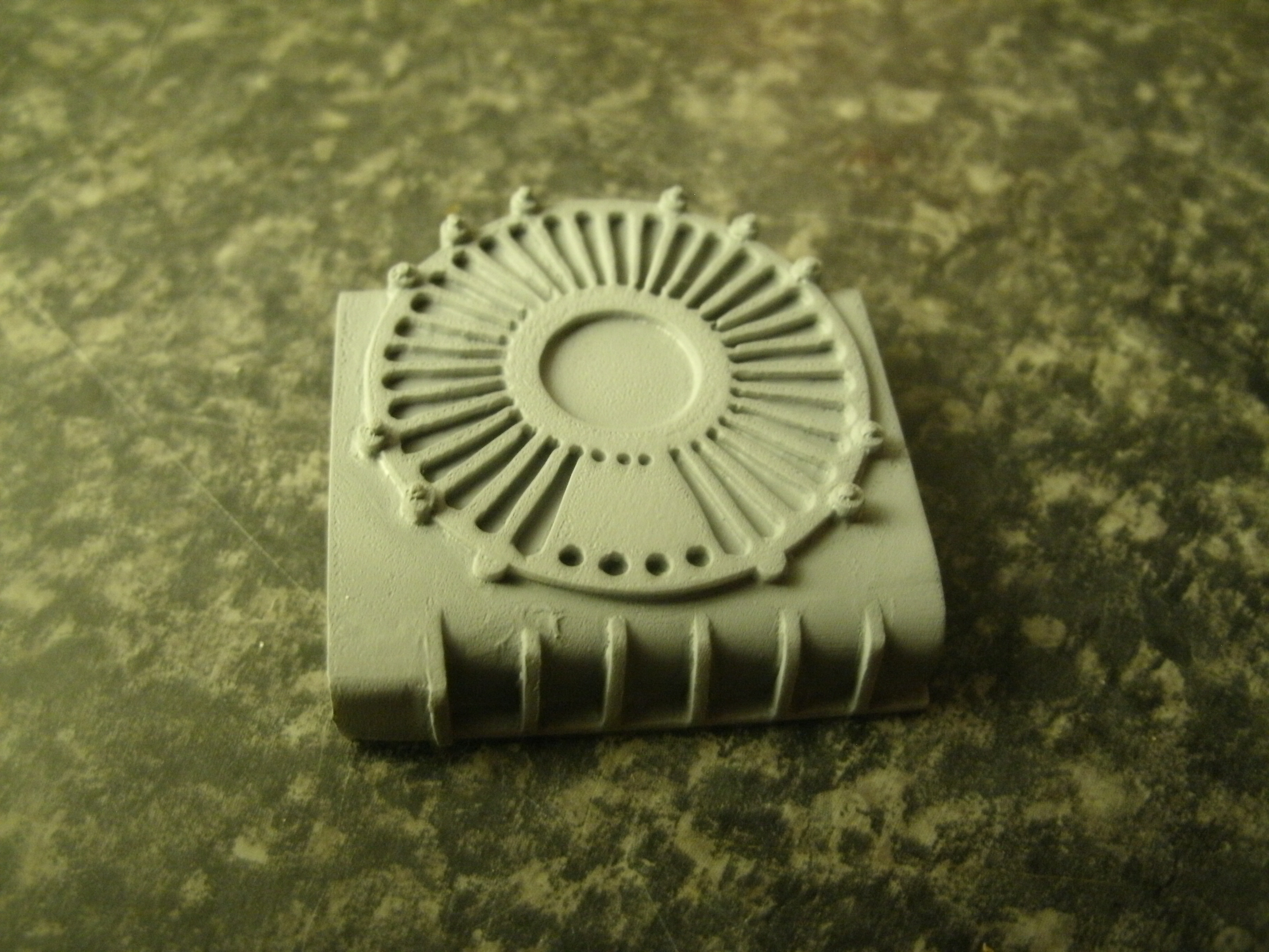

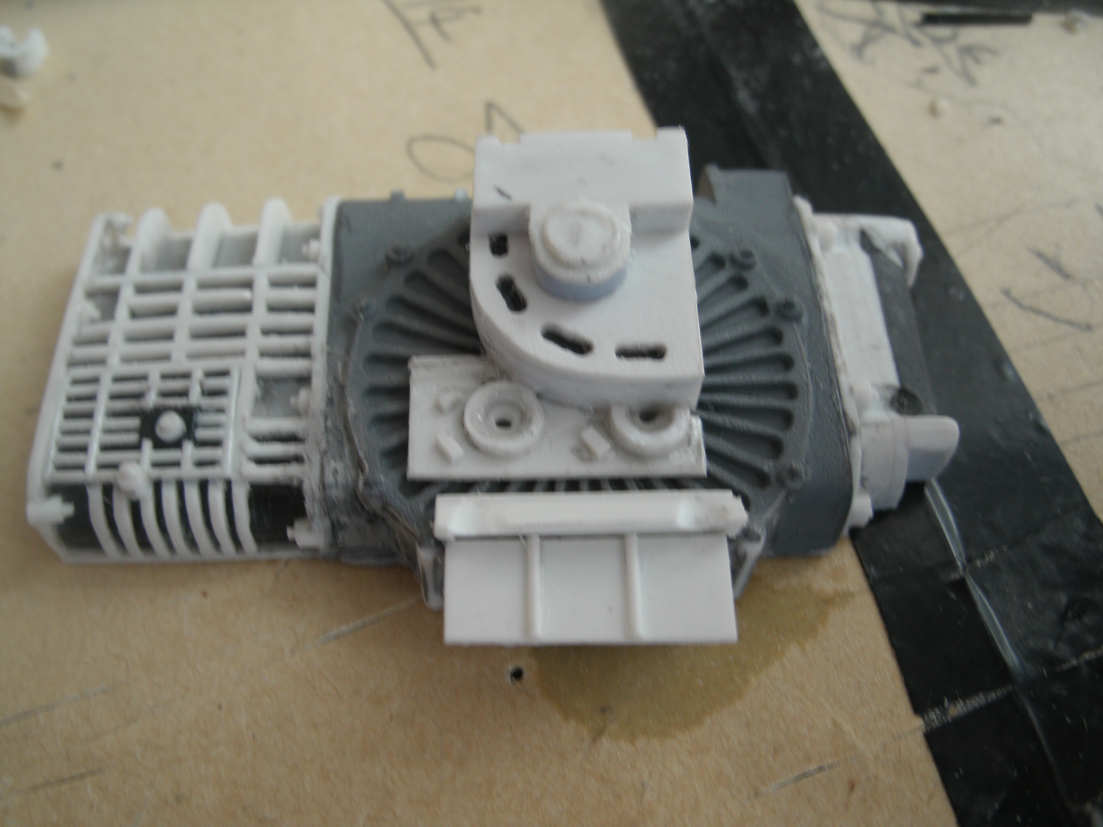

here's the finishin update on the gearbox section,

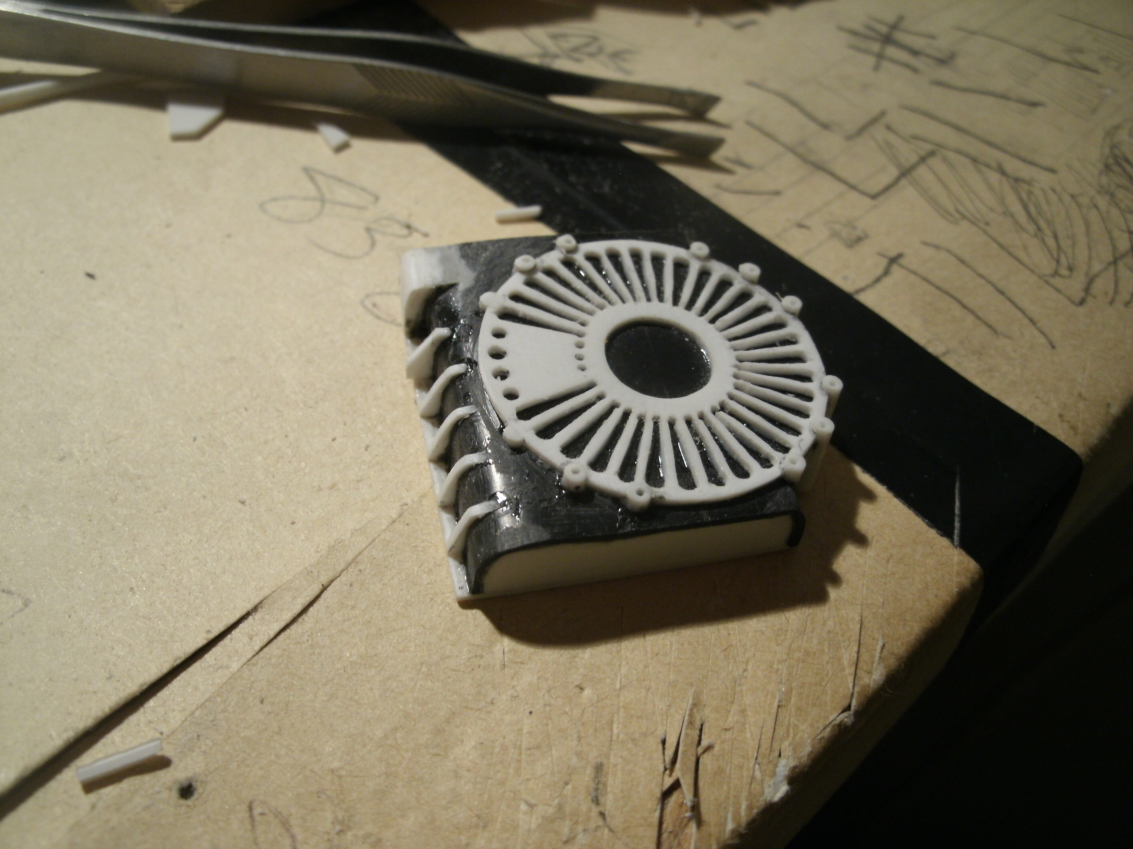

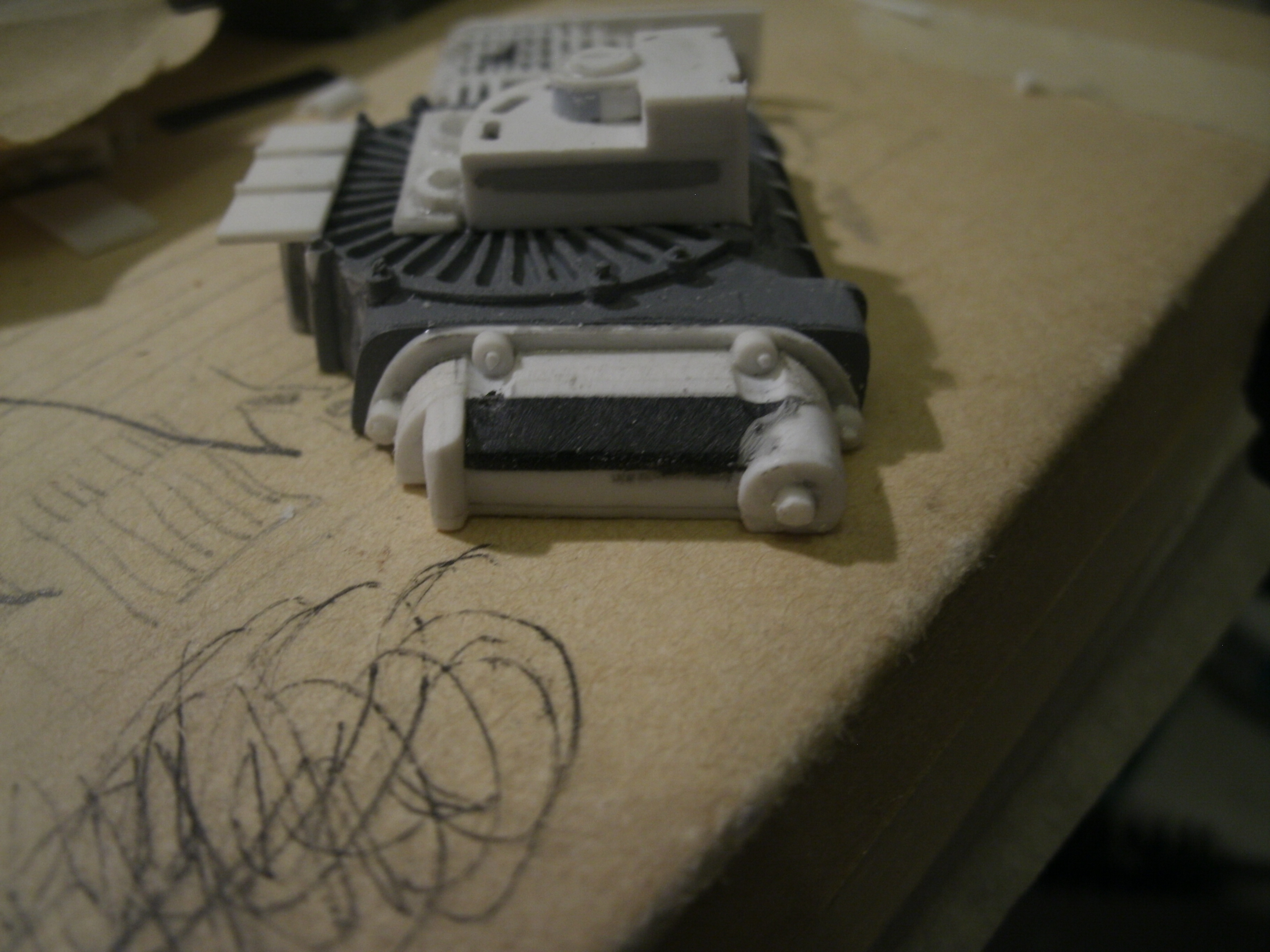

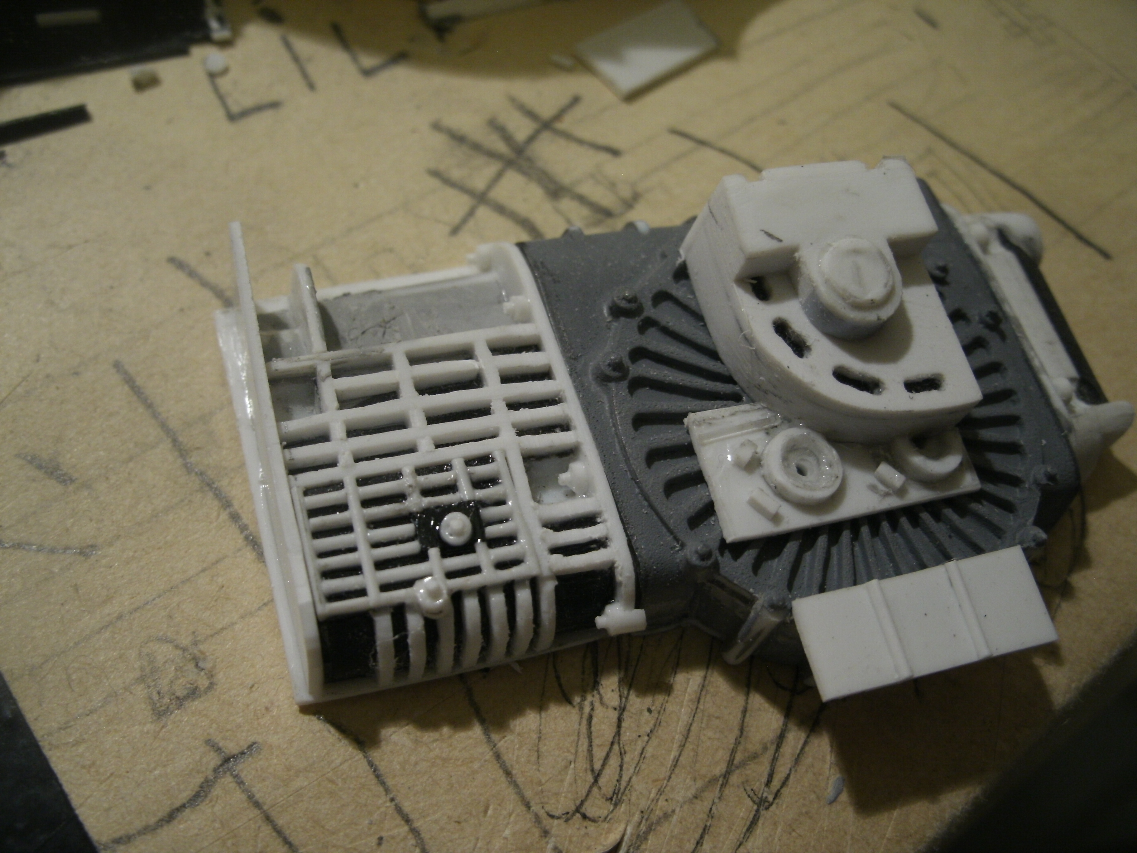

firstly i got 1 of the add ons done on the front of the circular bit and made a start on the front and back sub sections
well i carried on makin the back,with styrene and a lolly stick.

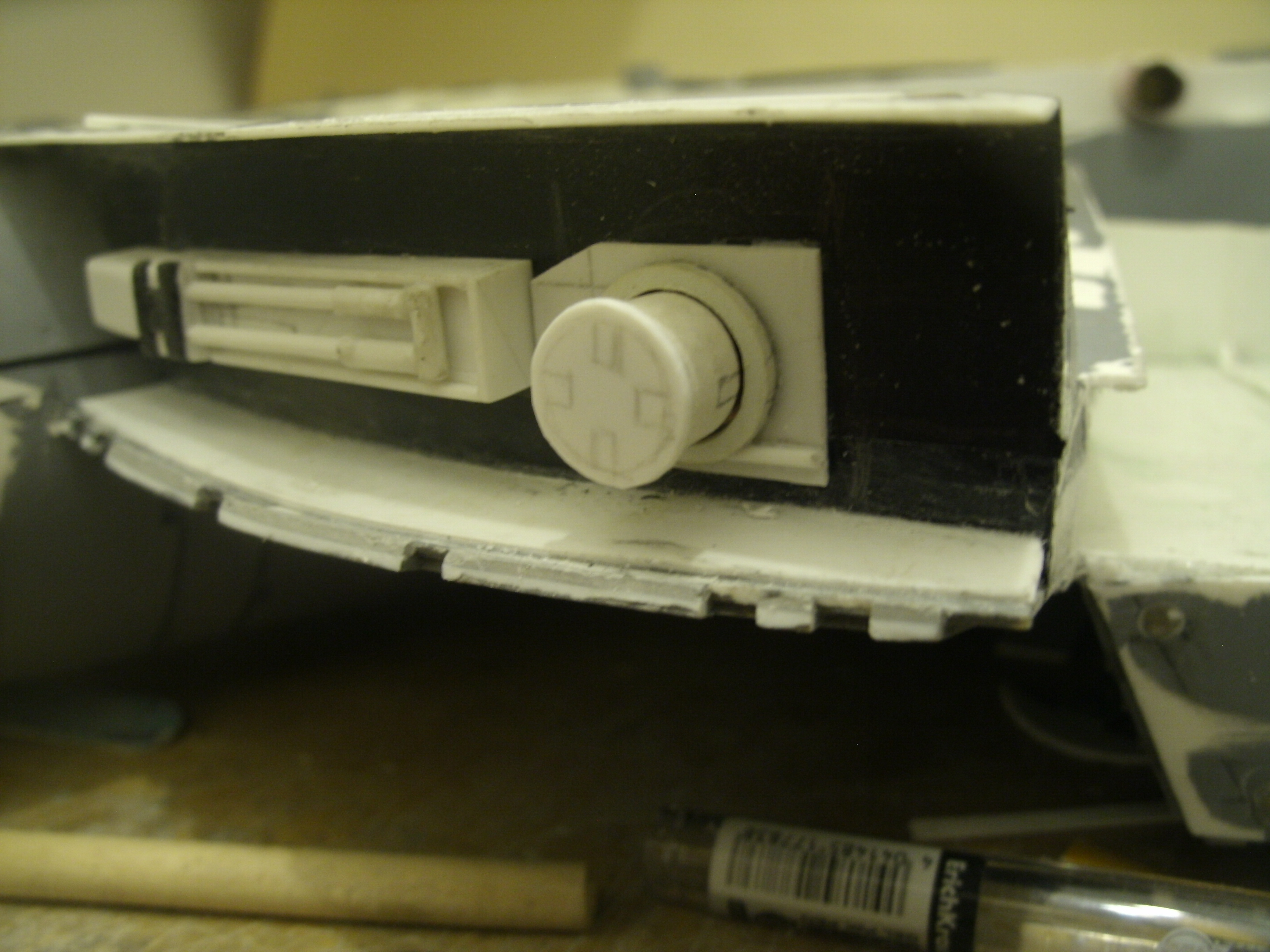

with that finished i carried on with the front section,i had to take my time with the detail on this bit..
where the bolts go on the main body of the front section it's dipped in a semi circle,so out with the lollystick again and some filler

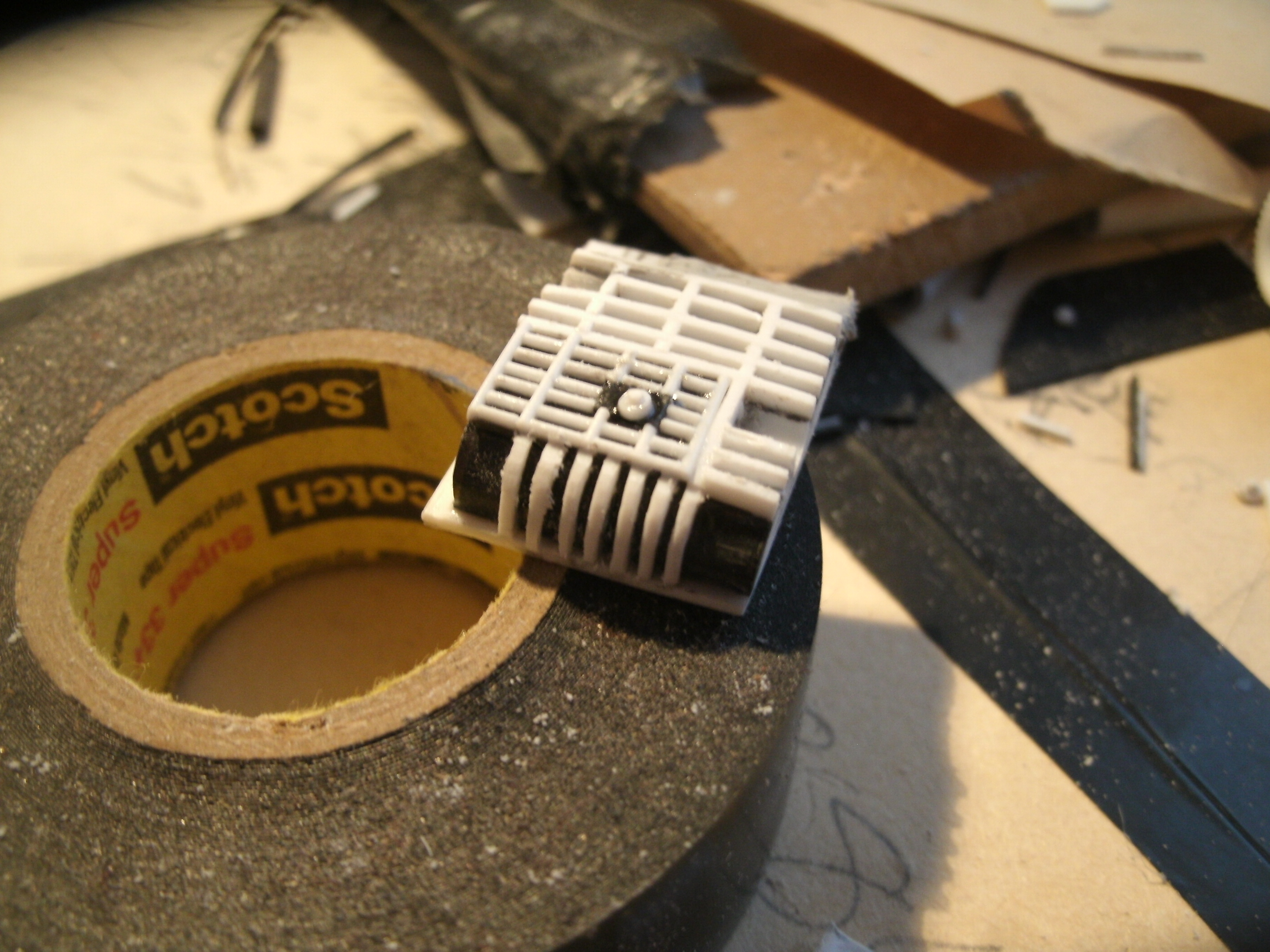

after that i started doin the ribs and there is a grilled bit which i made from half mm styrene and some half mm styrene rod,it was
very fiddly but came out really sweet.
as you can see i made up the bolts and got them on also.so i finished off the fins on the top front sub section and gave it
a shot of primer.
well that's it for this post i'll get some more done this week and i'll do another update probably next weekend...cheers for lookin....peza

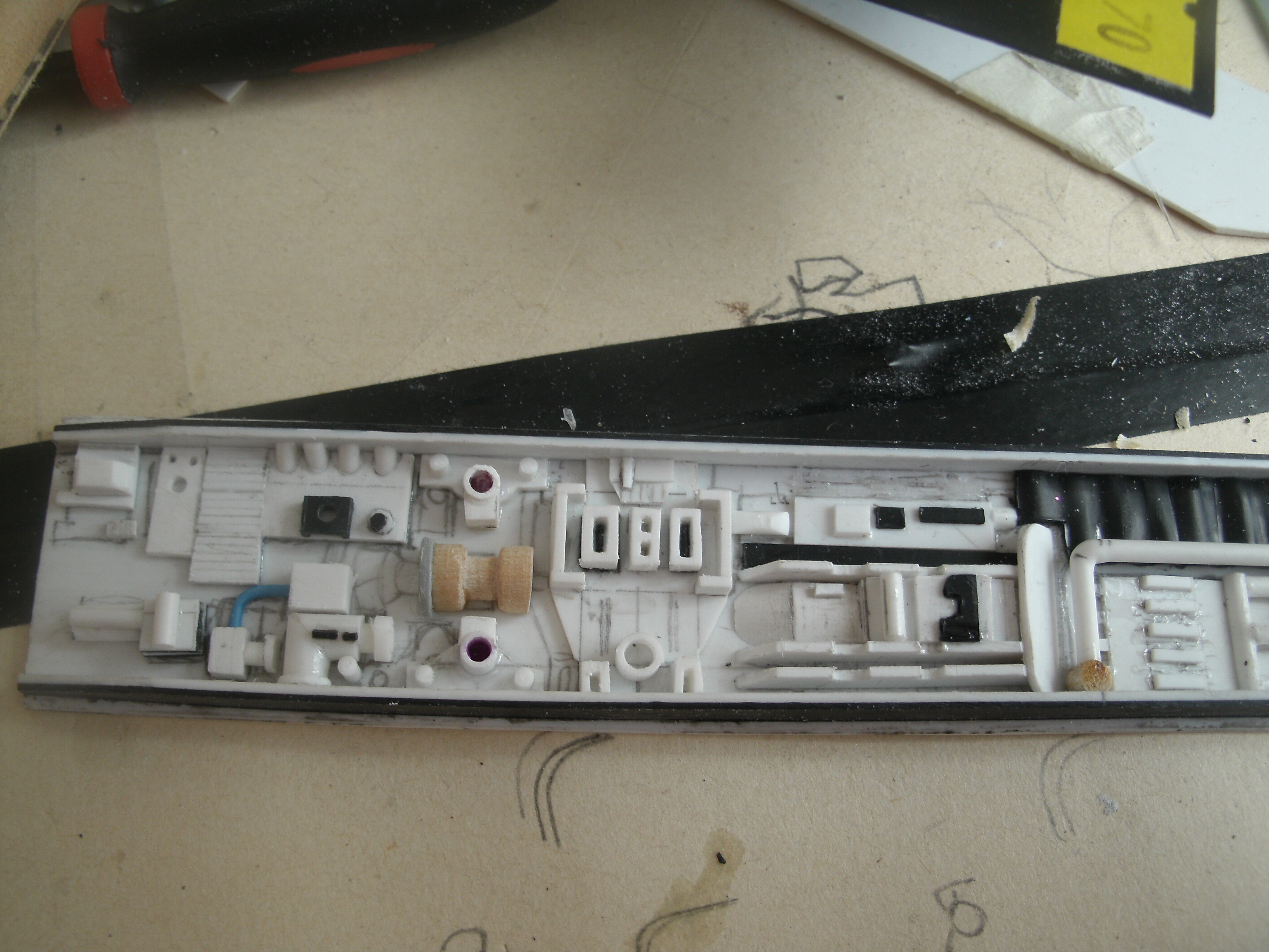

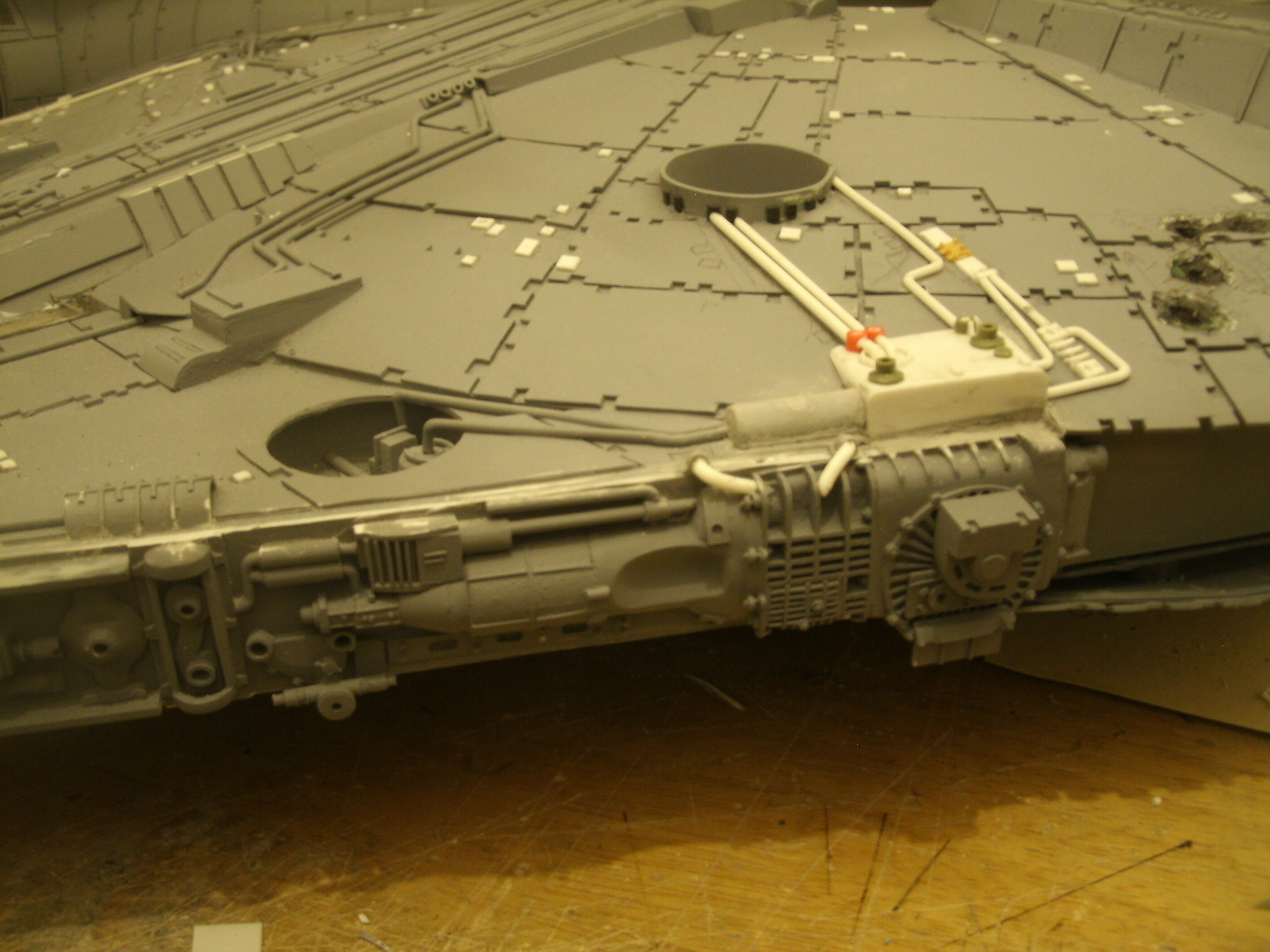

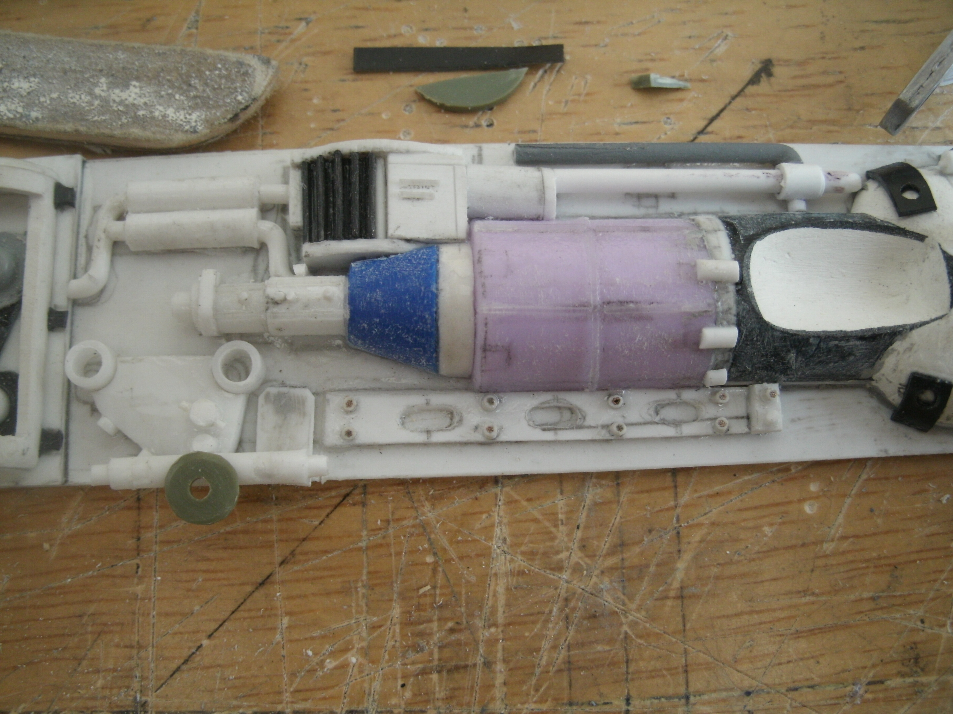

eh up all.

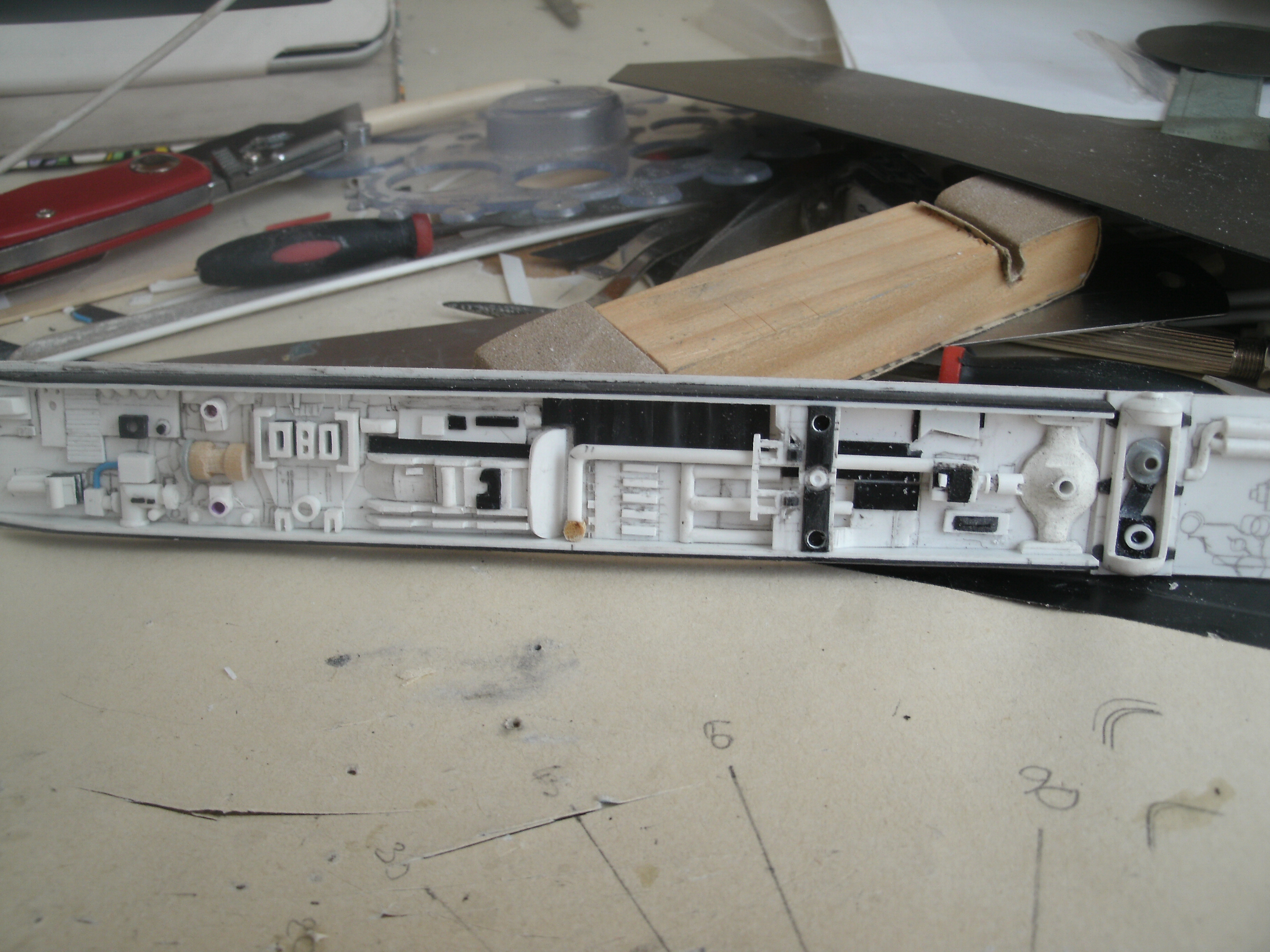

well its time for another update.

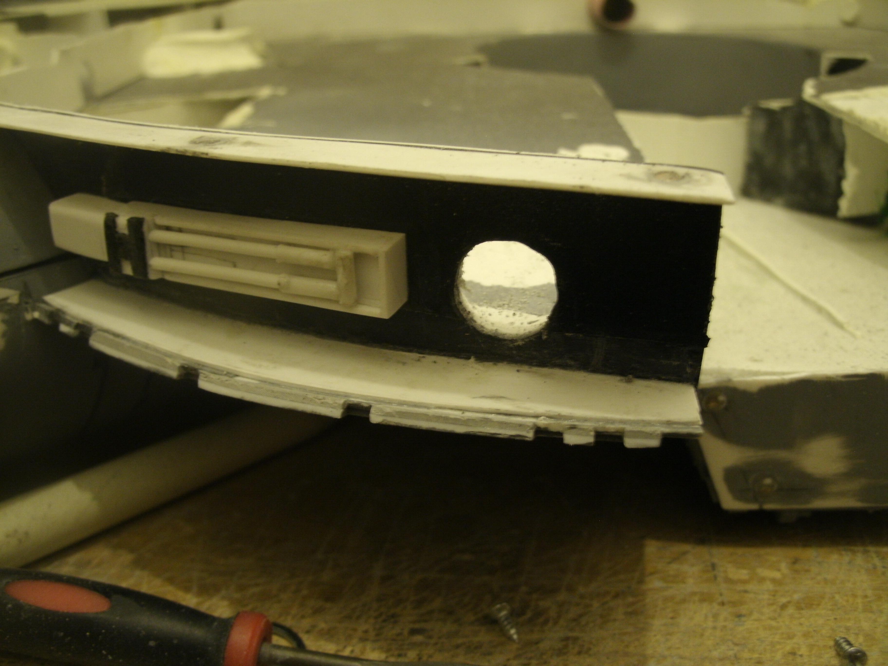

firstly i finished off the side detail,which i ended usin some lollysticks,pens and a piece of my little girls plastic gazebo framework.
next i gave it a quick tidy up and a shot of primer..
i then followed on fittin it in place and as you can see i made a start on some of the surroundin detail,but i stopped myself to concentrate
on the side detail between the cockpit and the dockin ring.

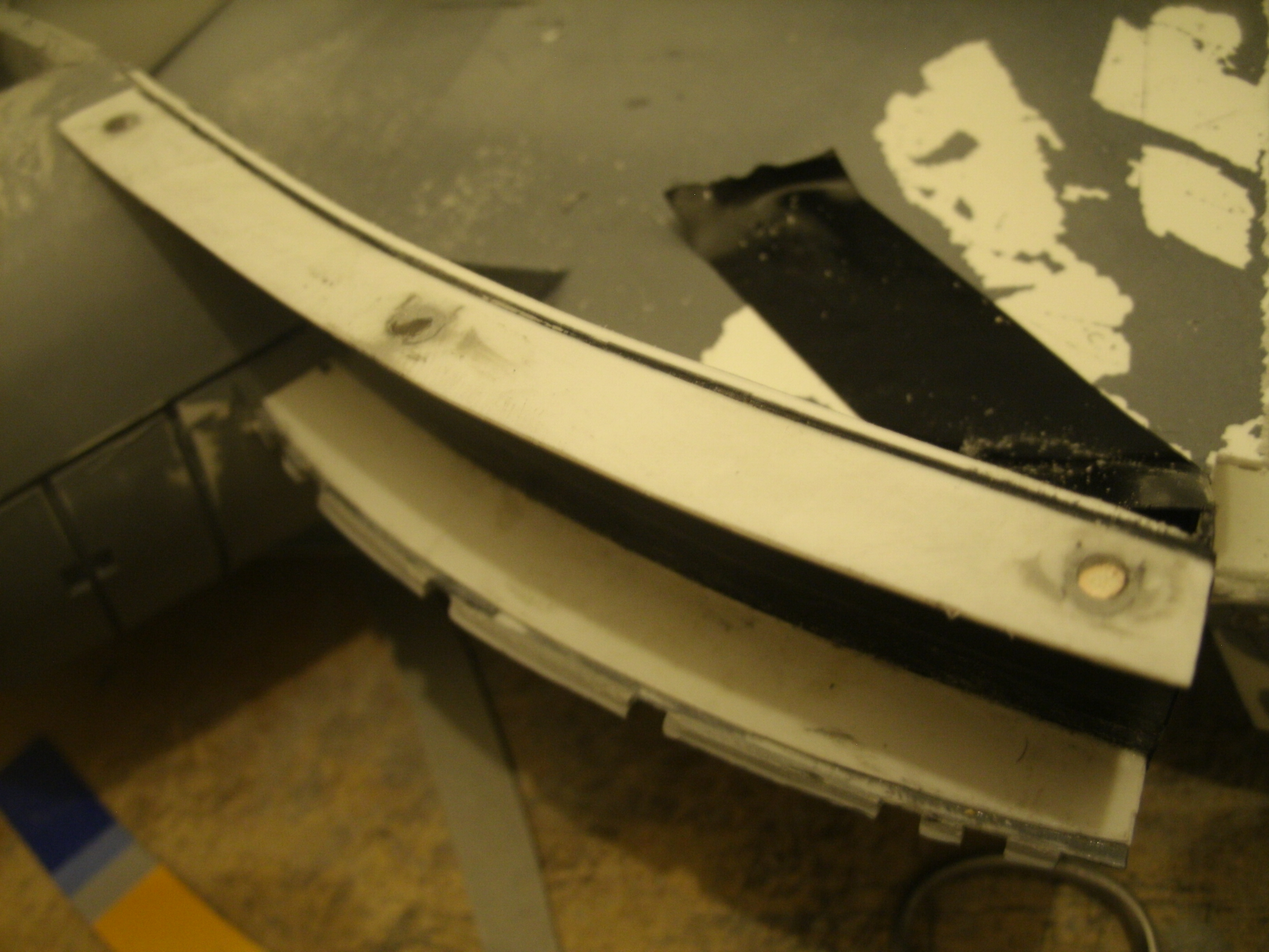

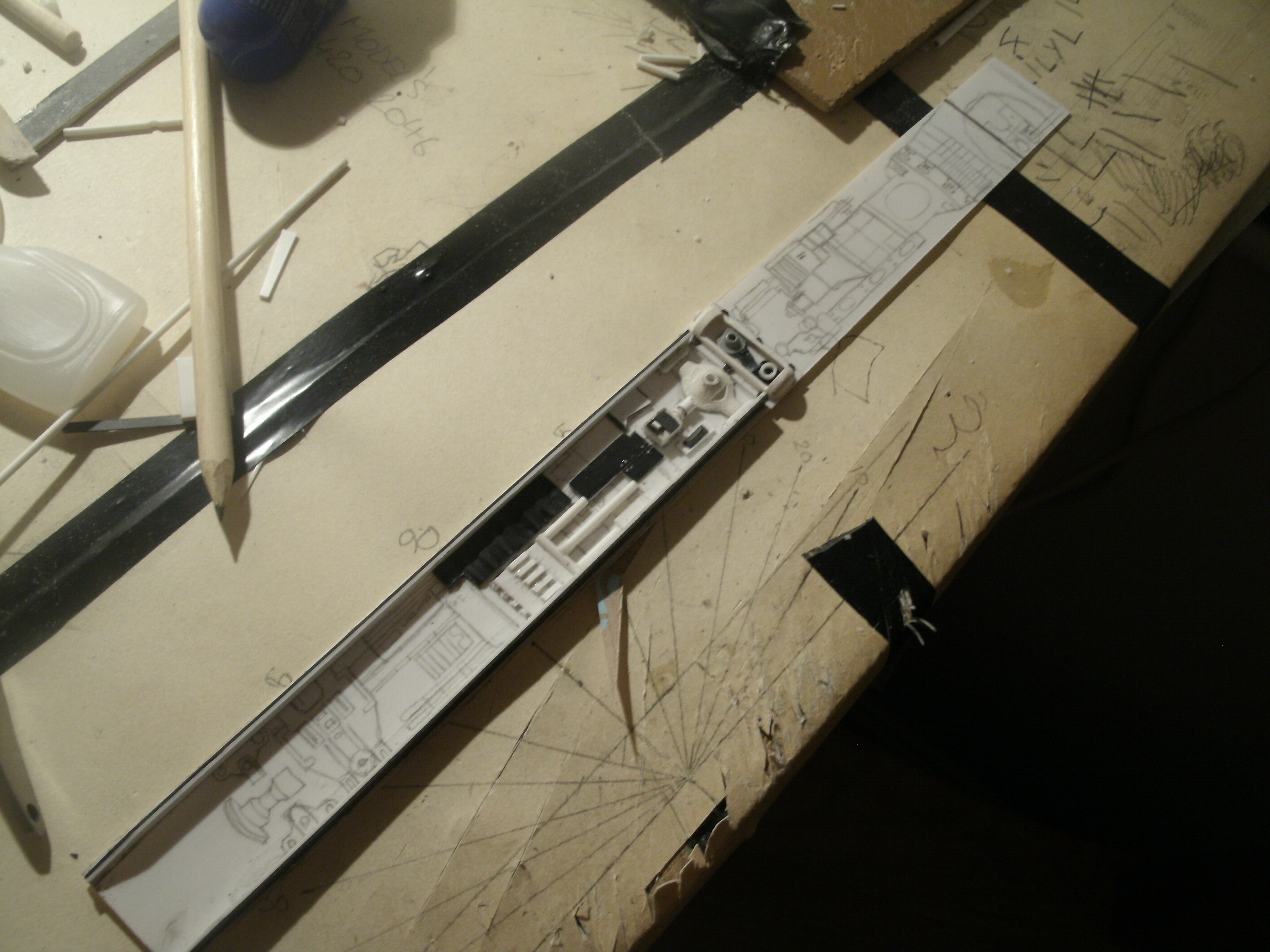

first off i made the backin plate which i made all nice and snug....but i realized that the model is made to open up for access to the
lights inside if theres ever a fault on them,so to start i had to split the backin piece into 2 and i used my magnets to seal them together

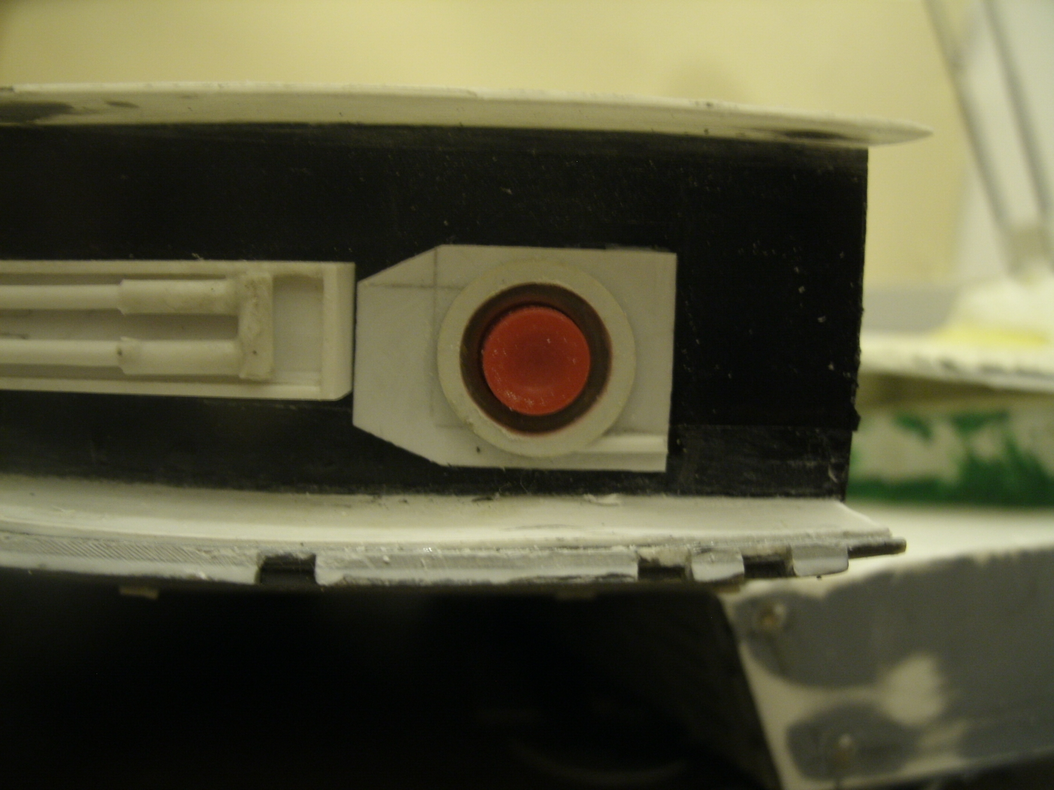

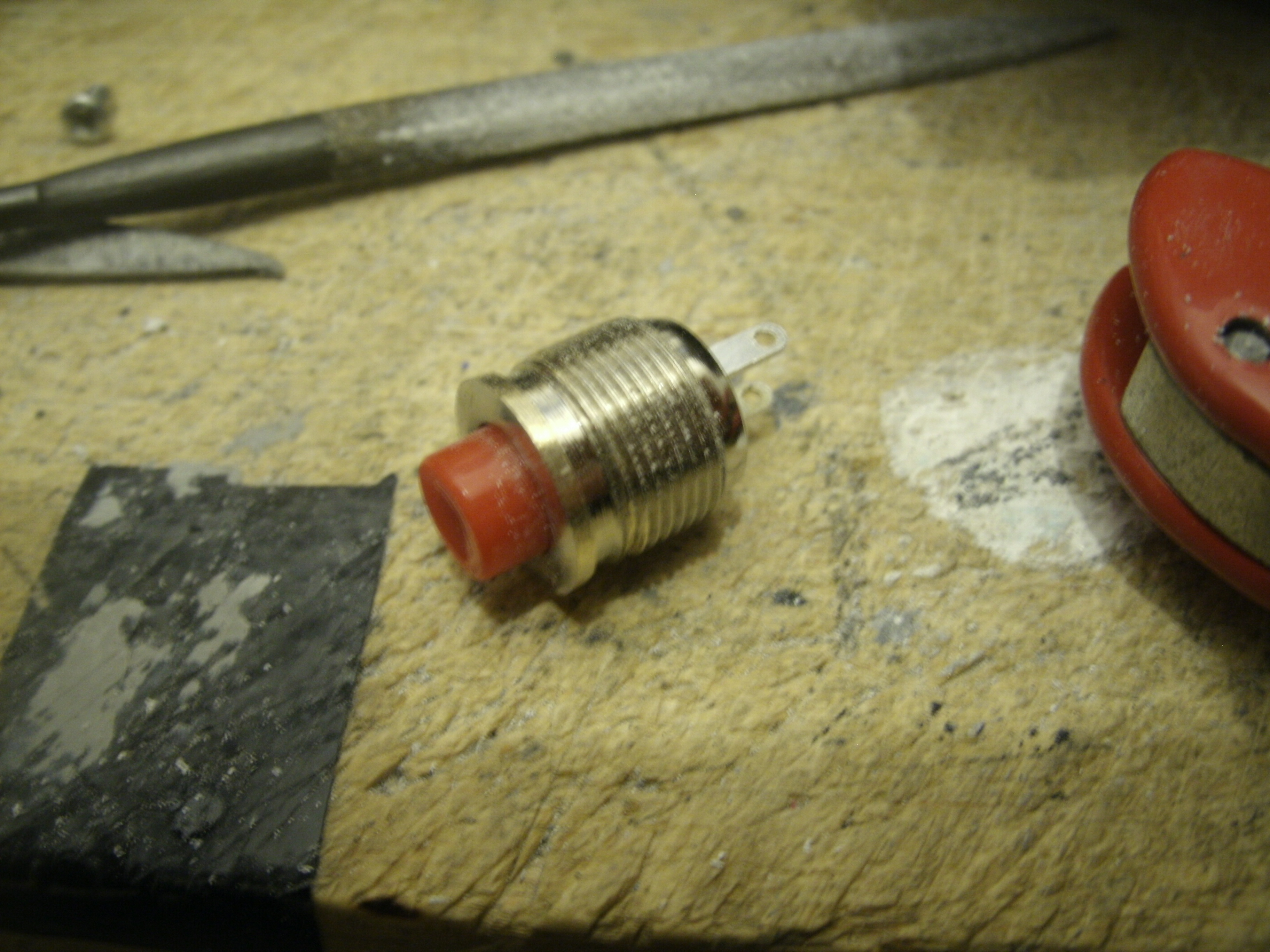

next i wanted to put a multi functional switch on the side but hiden in the detail out of sight and i think i came up with the right place.
i bought a switch and drilled out where its gonna go.
as you can see i made a start on the detail on the side just to give me the right placement.
and finally i got most of the detail finished on this side,i've only got some small pieces to go on but it's 90 % finished,hope you like the progress
well thats it for this update,i'm gonna get back on it this weekend and get stuck into it.....cheers for lookin...peza:cheers
