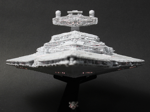

r0ver i think it just might - Here is what I got be removing the lower middle tabs so far from each of the 4 trench inserts. I also widened the tab holes for remaining tabs to help remove some of the stress bringing the bow up. Additionally i shaved the front peg down a bit and removed all the tabs from the top port side. Starboard side seems perfect, port side is still a bit curved but I think the clamp and glue final assembly will take care of that.
I noticed when i assemble the entire thing with the white light blocking interior parts the curve comes back a bit more. not sure if I will just sand away more or do the lighting without the interior parts and go the fiber route.

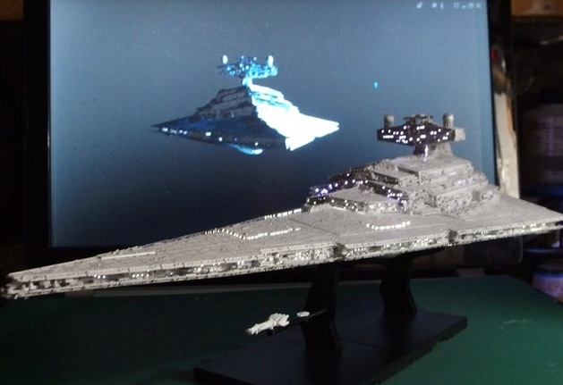

So the clear trench are used to re-create the light circled in Rogue One? Though its not so obvious in ROTJ.
The clear parts make it easier to give a light effect for an area with a spotlight on it?
A technique I believe called
essentially you put the LED on the inside right against the area, sand a bit of you light blocking away and the LED makes the plastic shine like there is a spotlight on it.
This is not my pic, but it gives the idea
