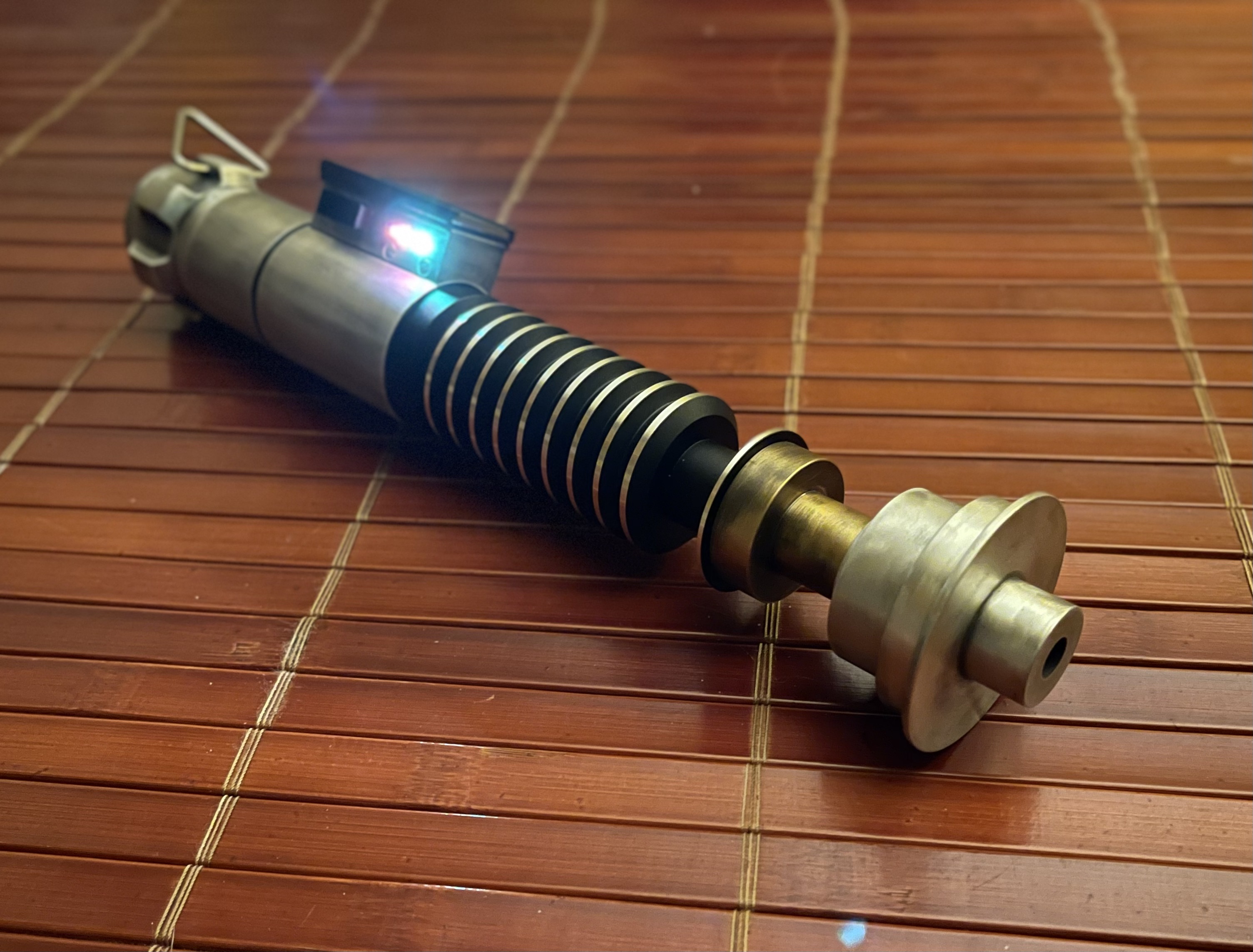

I am using just the one but I already stripped it ensuring it is right. The problem even if not using the extra screws is that with a narrow neck, every bit of depth helps.
Also noticed there is a wire jammed up under the control box creating a gap.
They sent a video how to access the area to tuck the wire back in, so that’s fixed.
Now I need to figure out how to remove that pcb ring to trim it down?
If you unscrew the grenade section, the wiring harness has a connector inside, unclip that and then the grenade section is free
You can then unscrew the brass neck from the grenade and emitter
How with the emitter free you’re going to have the wiring hanging out of the bottom of it, use a pencil to push the pcb connector out of the emitter
If you watch my over haul video I take it completely apart but leave the pcb connector inside
Hopefully it’s only tolerance tight and the installer didn’t use any kind of glue
Ok, I think it’s done. I was able to pry the pcb and ring out from the top. After inspecting and measuring, I determined that the ring made was fine in height but the tight fit was preventing the ring from sliding all the way to the bottom of the neck fitting. So I did some minor sanding of the ring and WD40 the neck. Then refit the ring and pcb. It still ended up in the same.location so I took apart the blade plug and used the tube as a setting device and hammered it with a rubber mallet till the ring and pcb sat to the bottom of the neck fitting. That seemed to have done the trick,
Now get that thing fired up!!

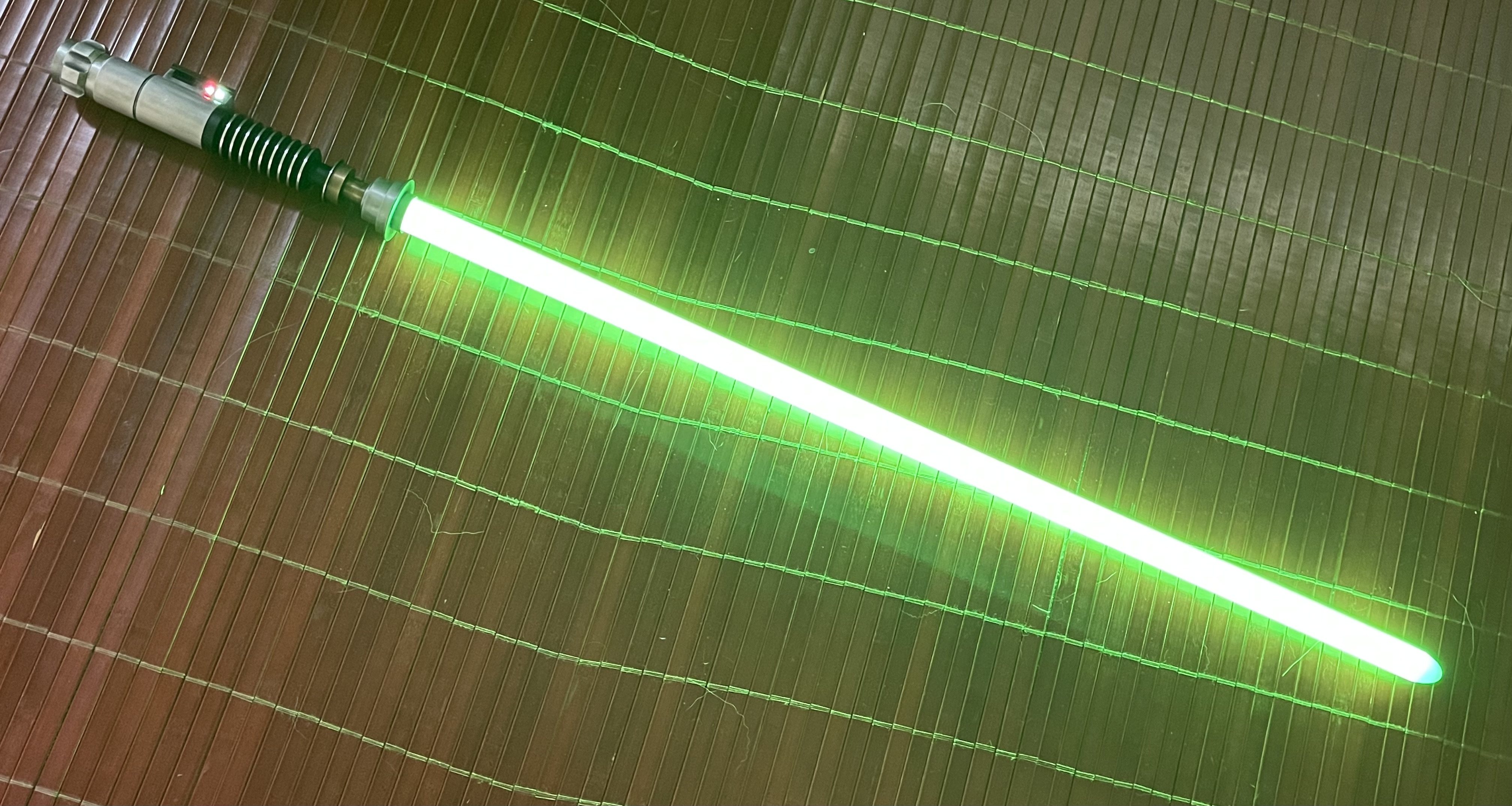

I decided to get this ROTJ Luke hilt because it seemed like a decent level of accuracy for a neopixal blade without having to spend around $1000. A lot of the lower cost Luke’s had weir shapes , proportions, v-rings, high chrome finish. I liked this one because you can replace the emitter and pommel ends to make it a nice display piece. I used to be turned off by the extended raised ring that adds support to the blade since it is not in Return of the Jedi but since it is now canon in Madalorian, I can deal with it.
I wish they would have just made a matte finish and not the weathered look but it is so much better than the high chrome of the other budget choices. I also could have done without the LEDs on the control box side lighting up while operational, but it is what it is.
Looks great.
You can dial back the weathering quite easily with some steel wool or scotch bright if you’d prefer it not be as weathered.
