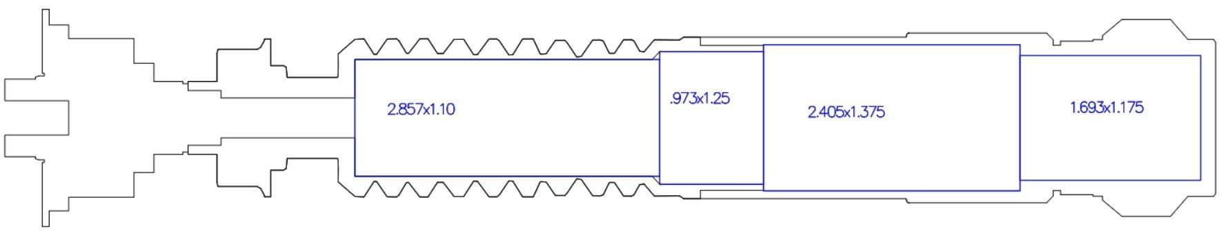

I am in the process of machining a “plug” that will fill the inside.
Then hollowing out the plug a little, I got some PMs about making a chassis and that’s not the case and my post could be miss leading
I plan on making a plug to weigh down the FX when done

I weighed my hilt down with a 5/16" steel rod running the length of the hilt, and slid various scraps of steel and aluminum over it, then secured everything with set screws.
One could grab some drill stops at the hardware store and use those to secure things to the rod, since they've already got set screws in them.
Just throwing options out there for folks who don't have the means to machine a perfect solid plug to fit all snug inside.
I DO have the means to machine such a plug, or plugs, but the solution I ended up using was far less time consuming.
I had planned to do this with mine (even have the rod already), but with a new Roman's V2 that's apparently going to be pretty hefty coming, I might just get that instead.
