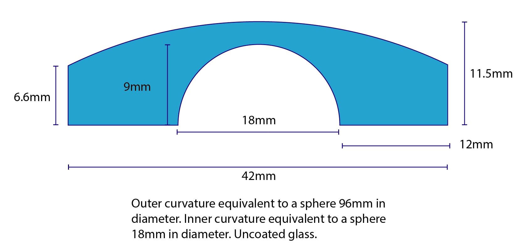

Okay, so I doubt this will interest many folks, but I've contacted a lens element manufacturer and I've asked them what it would cost to produce a dozen copies of an imitation secondary lens element. This would sit beneath the eBay-sold primary element. It would look like this.
However it'd end up around $90 USD, which is frankly a lot. But I thought I'd put this out there in case other folks might be interested. Anyone? :)

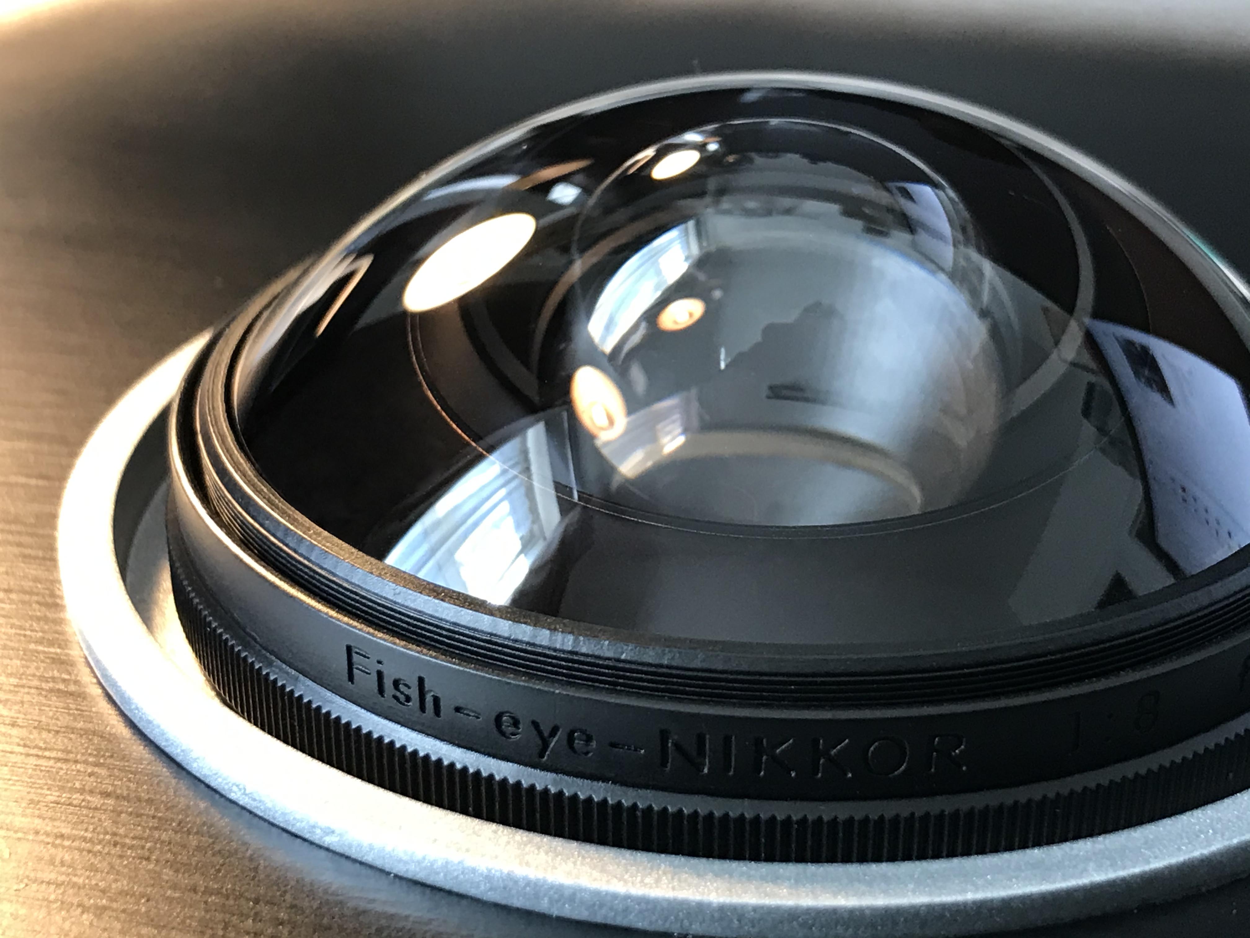

Anyway. These extra elements look pretty good underneath the primary element and with the outer 3D-printed rings to represent the lens barrels in place. I'm sure it's not like the real thing - sadly, I haven't got one to compare with - but it's something, anyway.
I'm going to have to reprint the bottom-most plastic piece. I printed it at an angle as a test, and ended up with raised ridges (seen as diagonal stripes across the bottom of this shot) that don't look great.

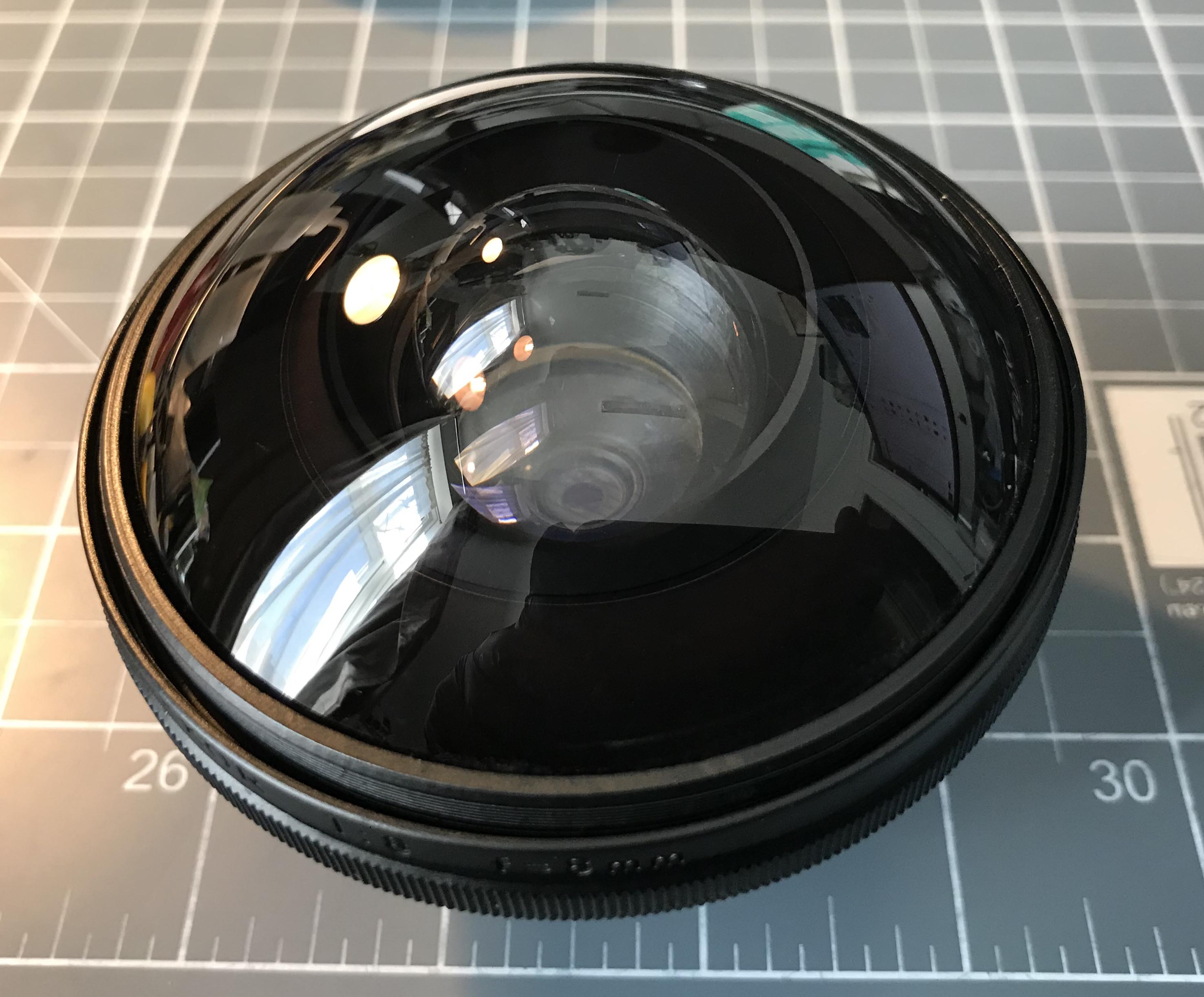

And here's the "lens" mounted in a 3D-printed ring, spraypainted silver to represent the aluminium ring. Not the greatest finish - I couldn't be bothered to dig out the airbrush and Alclad paint for this test, so it's just cheapass sparkly "metallic" silver paint. But it gets the idea across. The black plate is a piece of scrap dibond I had lying around. It was brushed aluminium, so I painted it semigloss Tamiya black, and cut a 95mm hole into the surface with a fake Forstner bit. Doesn't look half bad!
However, it's a problem to light. The cemented doublet lens element has a bad coating on it. When not lit it's okay, but when the light is shining through it from the back it causes an objectionable speckle to the inner surface. Urgh. You can see it here. That's a white LED behind a thin piece of red polyester photographic filter, located roughly where the actual internal red filter is located on the real lens.
Anyway. The whole thing is looking moderately convincing. There isn't as much light spread from the light as I'd like. It sort of ends up with a small dot of red light at the top of the lens, and there isn't much glow to it. But then, I haven't tried a real Nikon fisheye. Maybe they actually do that.

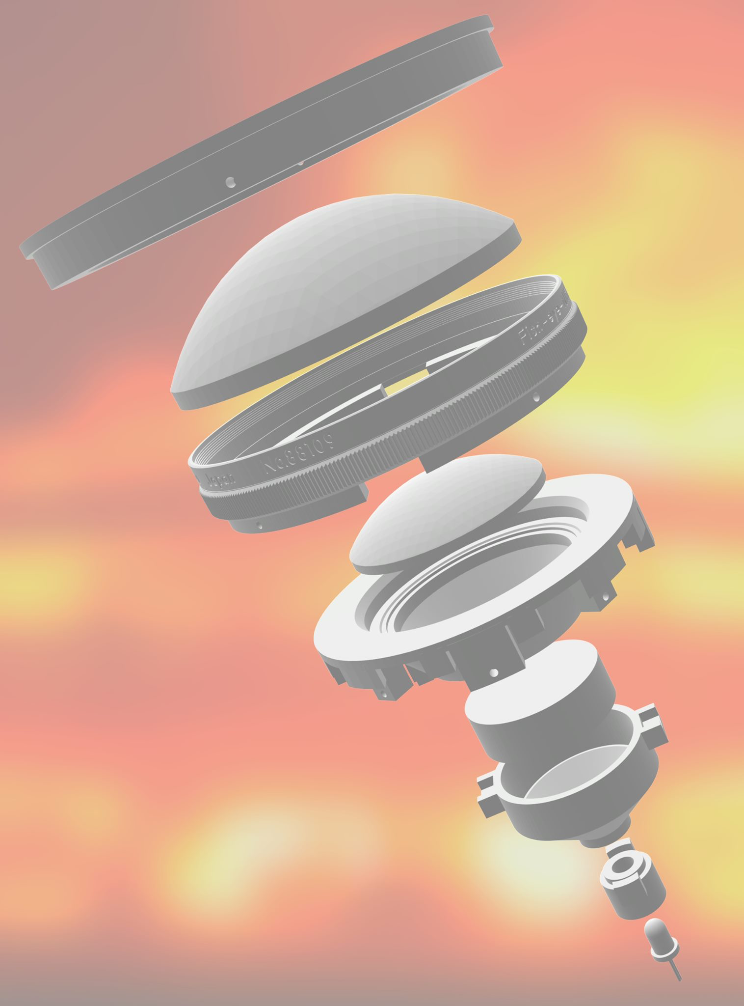

Oops - the inner lens ring is missing from my blowup diagram. Oh well. :)
